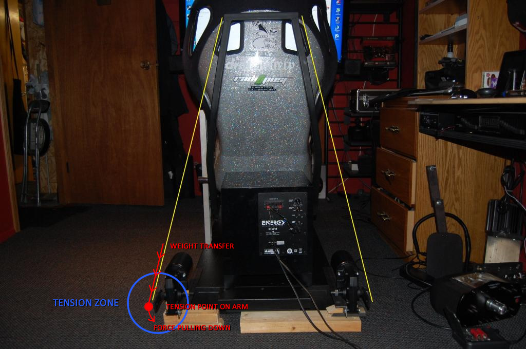

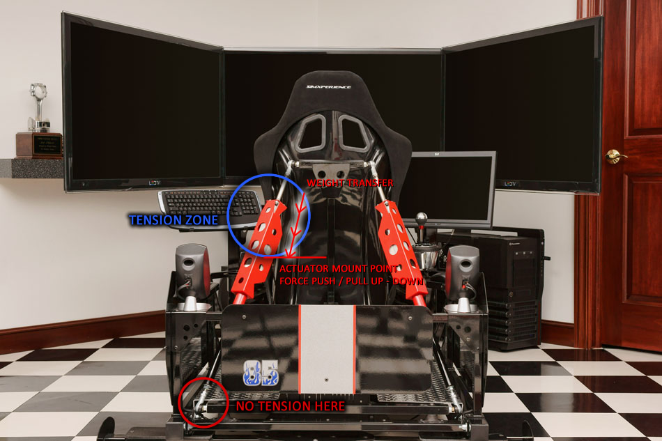

    @Nick Moxley
    Your angle in photo from page 3 and in this last photo is now different and bigger therefore making additional tension on the arm where the rod is connected and also additional load on the motor. The SimXperience SCN actuator is operating very different, it doesn't have an rotating arm like with DC motors where all the load and tension comes through, the actuator position is way up and it's rod is moving up and down so the tension and force is applied on actuator rod and there is almost no tension on the bottom connection of the rod because it is solid fixed, therefore the angle position of actuators are not that of the problem if they are narrow. But with DC motors the approach should be different.
    If there is too much force on your connecting arm, it could start to bend, and the narrower the rods are, the bigger the tension and the force is, so is load on the motors.

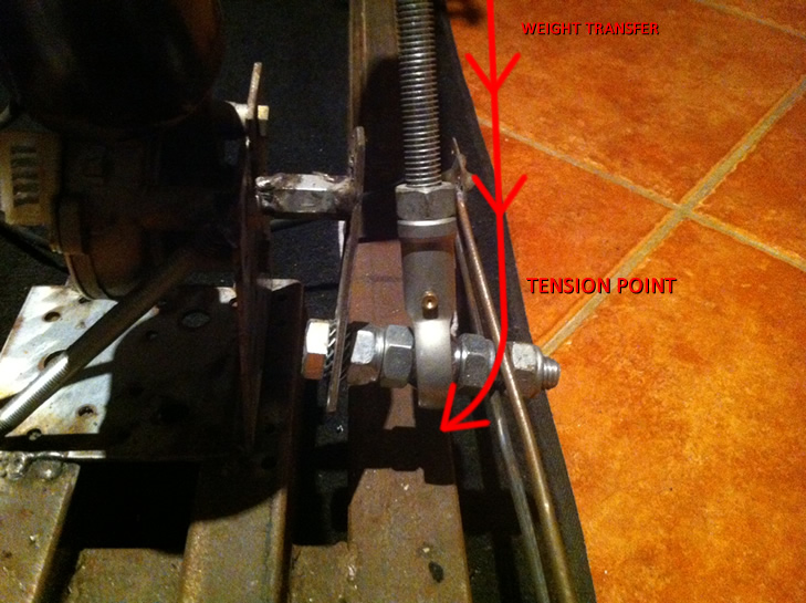

    Let me try explaining on the photos, here on your last photo, hoping you will understand the picture.
    And I'm saying this from my own experience, look what happened to me with one of my older testing build, I had also a narrow shoulder connections like you and I've learned something from that.
    Look how the arm got bended, I know it's not very thick but even so you won't noticed it right away, but after a week or two or three it will slowly bend under tension and the motors will suffer.
    It's just my advice, the best angle from bottom to shoulder would be 7-10° tops to avoid that tension, which in your photo from page 3 looks like, maybe that is why @eaorobbie agreed with, but on the last photo the angles are bigger.

    prodigy, Not even remotely worried about my lever's, they are Uber beefy. Did you not look at the picture at the top of this page ?
    Thanks for the tip on the 12mm pipe Dave, I think my modded Nuts will allow enough for the links to move as they need, If not pipe shopping i go.

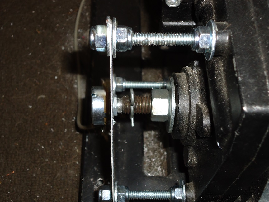

    Ok so i re drilled the bolts to .249 with a 1/4 bit in the drill press. No problems.
    JRK's are all wired up to power supply and motor's, Wires ran to the pot locations and everything else is basically ready to go minus Heat sinks for JRK's, Pots for motor's and power supply voltage mod.
    Pot mount

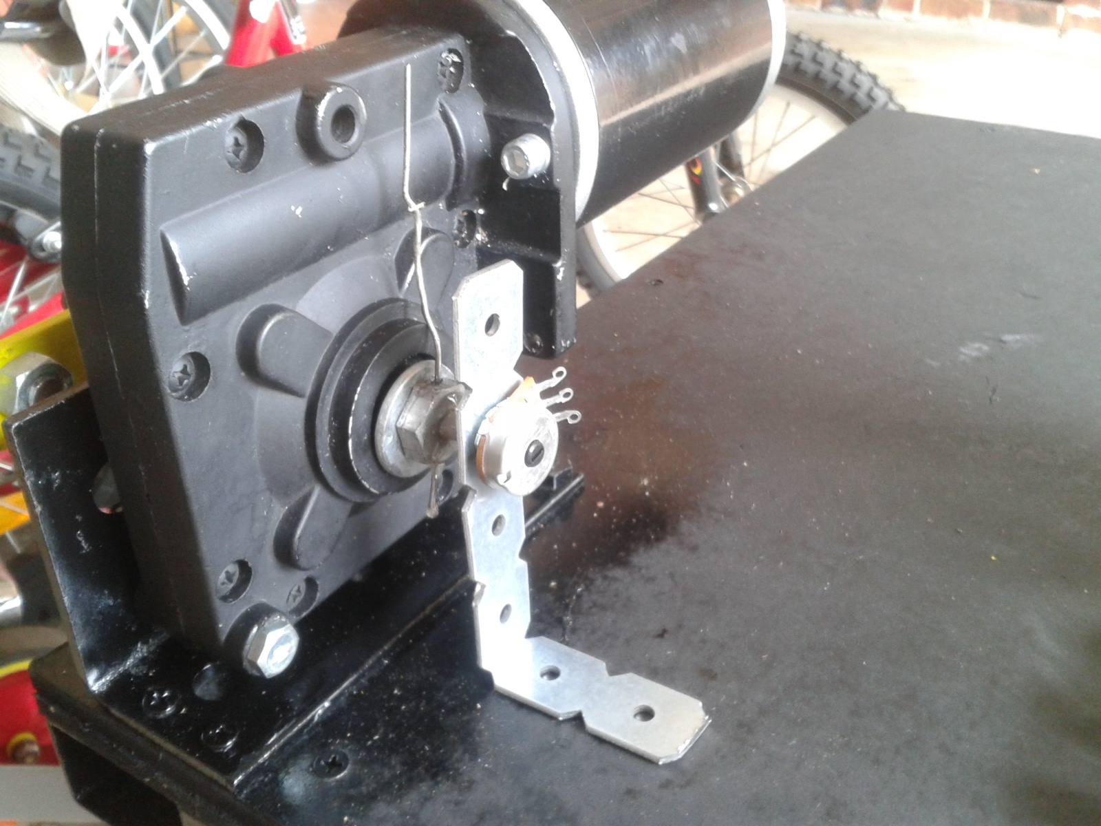

  16. bsft
    yep, that will do well.
    I cannot open the pic right up as photobucket is not letting me.
    drill a 2mm hole right through all the bolt and pot shaft and runa bit of wire through it to hold it as well.
    like in the pic above.

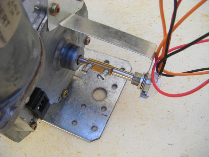

    I drilled a 6.5mm hole in my mount bolts, plus I use a flange of thin Ali to mount the pot to the motor, so if there is any flex in the motor mount to the frame mount, my pot will always stay in the centre of the bolt. I chose this design after seeing another do the same with his sim with the same motors.
  18. bsft
    I found that the way I did it is a problem and @eaorobbie is right. Mount the pot brackets on the gearbox housing. Having brackets mounted separately was causing pots to be pulled and pushed, hence breaking then at a rapid rate. I am going to buy more brackets tomorrow to mount pots onto gearbox housing. I will update a photo here and on desk racer thread.
  19. RacingMat
    2,233
    21,066Coins
    +2,092 / 21 / -2
    yes, I agree. The best way is to mount the pot bracket onto gearbox. :)
    another example for you Nick: 20130413154729-RacingMat-montage-potentiomy-tre-2-.JPG

    Thanks for examples guys. I honestly dont think my angle iron mount will be able to tweak or deflect any which way to damage the Pot. But I will definitely keep an eye out for any unwanted flex. Im just trying to run the forces through my head and cant see where the Pot will be under stress.
    BUT for the 2$ it is for brackets and the fact it'll eat up a little more time before the pots show up, Ill fab a mount off the gear box, I cant use the top hole due to my Motor locks needing to "clip" over the top of the box. So I plan to use the hole Right Under the Motor mount screw's to the gear box, a Simple 3" L bracket should reach fine.
