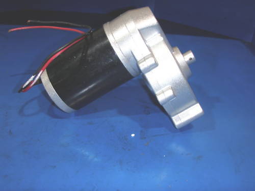

    Question for you guys, Trying to source some more motor's to build a buddy a rig and pgsaw doesn't have anymore of the motiondynamics style but happens to have these, From looking at the specs they appear to be exactly what were looking for, but with a different style gear box which we can work around as the rig hasn't been built yet.
    what do you guys think

  17. AceOfSpies
    AceOfSpies Living the Dream!
    May 8, 2012
    260
    Kilwinning, Scotland
    19,614Coins
    +244 / 1 / -0
    I've got 2 of these ordered. Just waiting on delivery. I've used the motion control motors, zyt90's, but they're just OK.
    Hopefully these will have a bit more punch!
    Mike :thumbs
  18. Nick Moxley
    17,056Coins
    +2,506 / 30 / -2
    Awesome, please keep me informed as to how they work out for you.
