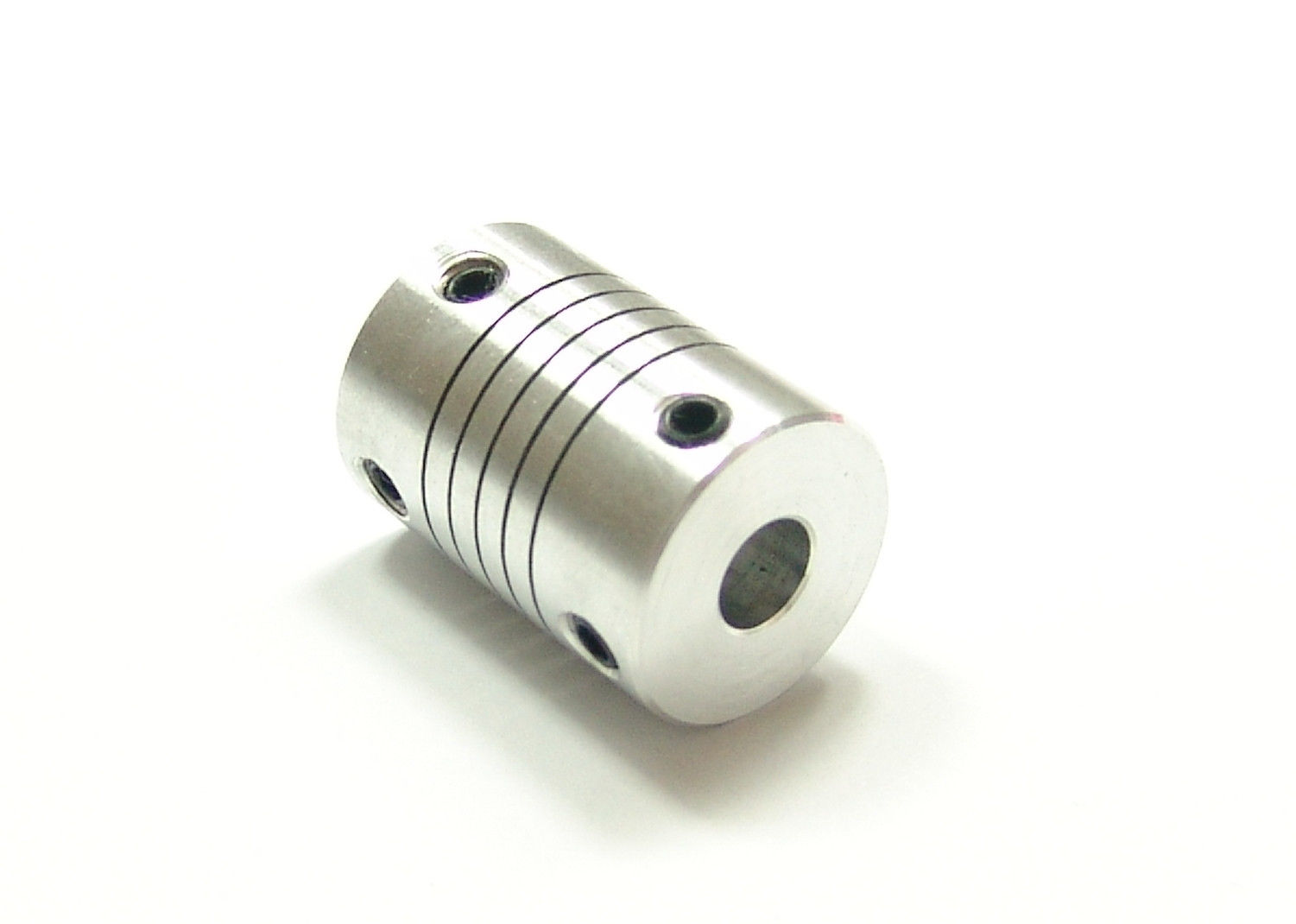

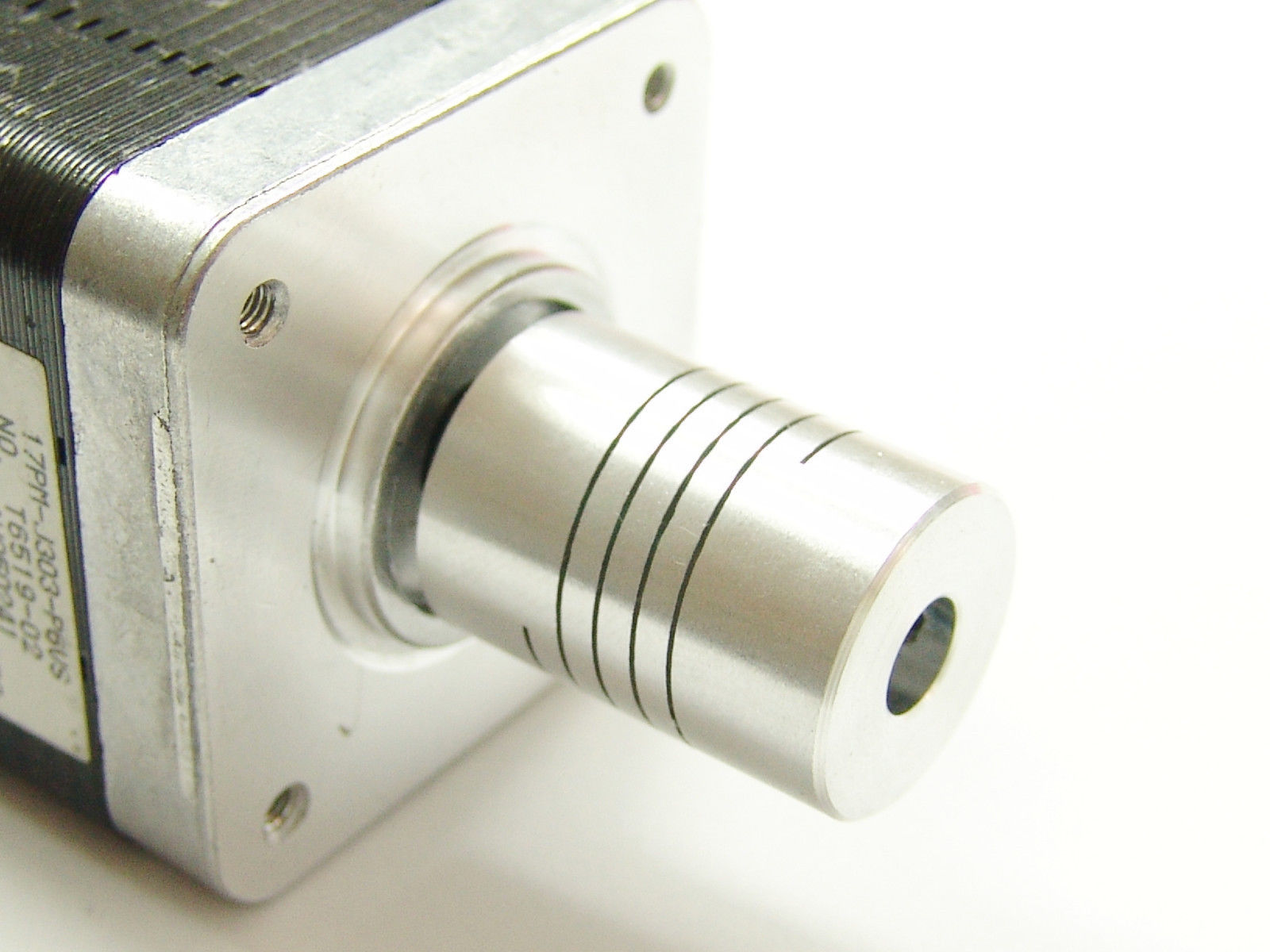

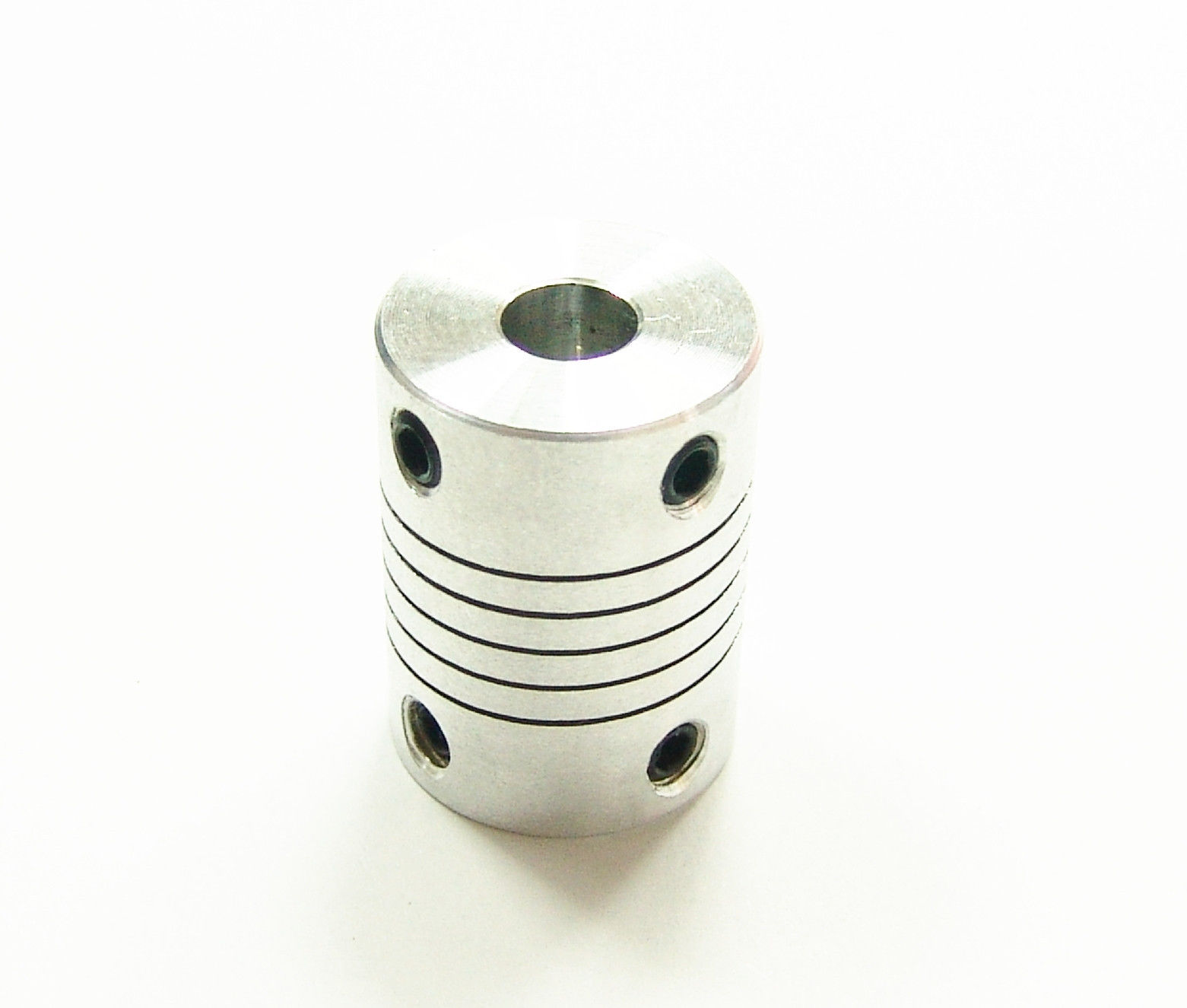

    Here's what I use and they do a fine job for any "out of round" shaft for pots. You can get then in different sizes on eBay.
    Flexible coupling, aluminum, two set-screws per in/out shaft to pot - total 4. About 6.50 ea.

    Interesting, might just look into those for the future . Thanks.
