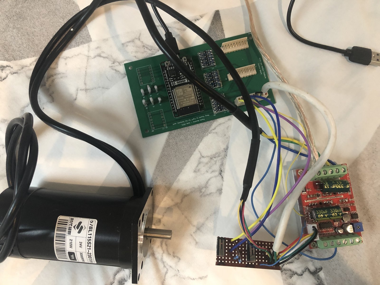

    I needed to try something different. Either new BLDC drivers, or something other than the arduino SMC3. New drivers will cost me $200, and take a while to arrive so I decided to try the other option first.
    As mentioned above, FlyPT's (pmvcda) system runs on an ESP32, and uses the motor hall sensor for positioning which has a big advantage for me.
    So I got PCBs for the ESP32 created at allPCB.com. Gerber file for this, created by @fcppenta (thanks mate) is in the link below. For a new accounts at allPCB the first order is free (including worldwide shipping with DHL) so they were created and delivered within a week! Wow!
    https://www.xsimulator.net/communit...hless-diy-actuators.10799/page-38#post-218195
    I've made all other connections, including limit switches, and uploaded the ESP32 code created by the genius @pmvcda (thanks mate) from the link below:
    https://www.xsimulator.net/community/threads/flypt-6dof-brushless-diy-actuators.10799/#post-139682
    There are still a lot of things that could have been done wrong, a lot of potential for crossed wires despite the PCB doing much of the connections work. My BLDC driver direction pin is active low, so will it run in reverse? Will it run at all? Will it go up in a puff of smoke?
    I'm a little afraid to find out right now, and running out of time. I'll recheck all connections, and give it a go tomorrow.
    [EDIT] The motor ran as soon as I powered it up. Next I pressed one of the limit switches, and the motor stopped (makes sense it was at it's limit). Unfortunately I have not managed to get it to run again. More effort is still required.

    PROGRESS I think... with one of the ESP32 boards connected to a Wantai BLDC driver, and after uploading ESP32 code by @pmvcda, via Arduino IDE, my motor now runs smoothly and completes it's calibration. Very happy about that.
    Tomorrow I'll try to go beyond calibration and see if I can get smooth movement via SMC3Util and Sim Tools input, and then it will finally be time to start building the actual frame itself, starting with the traction loss part.

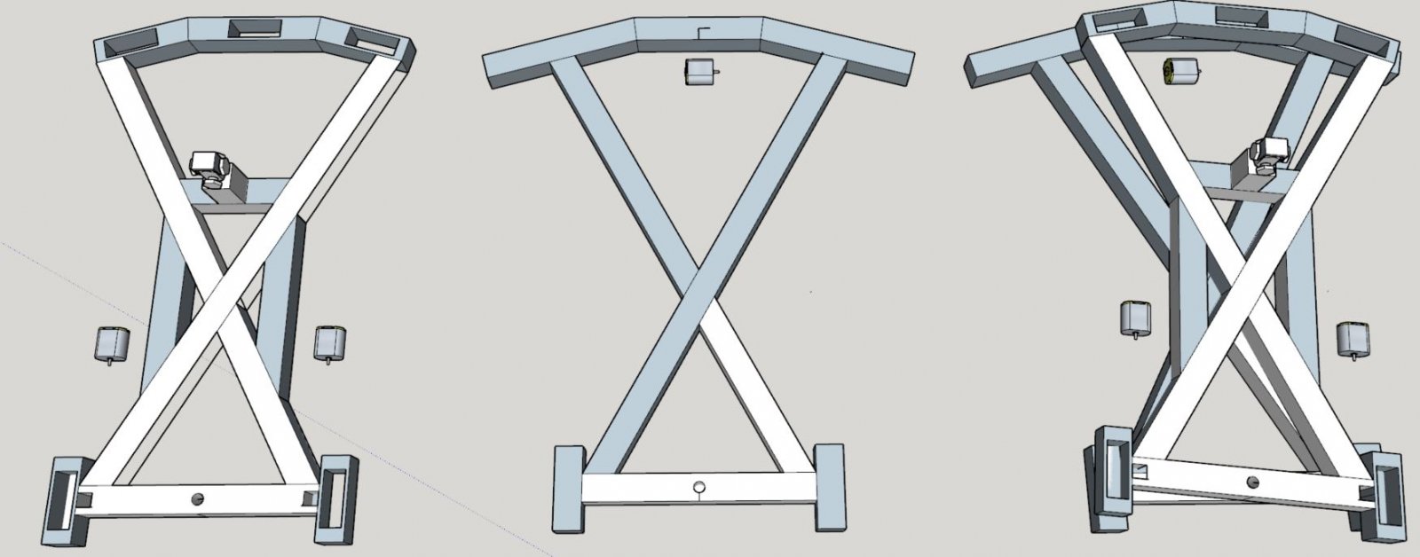

    I'm now moving on to building the frame, and I have redesigned it again for simplification. I needed to keep in mind that there must be room for the 3 motors where they are needed and to reduce overall height by allowing the motor arms can go all the way to the floor at their lowest point. The image shows the two components and then how they will work when mounted together.

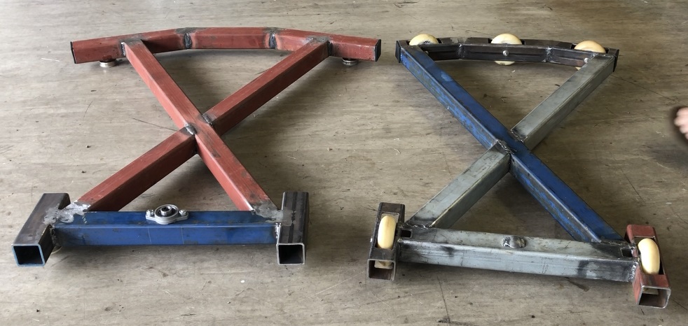

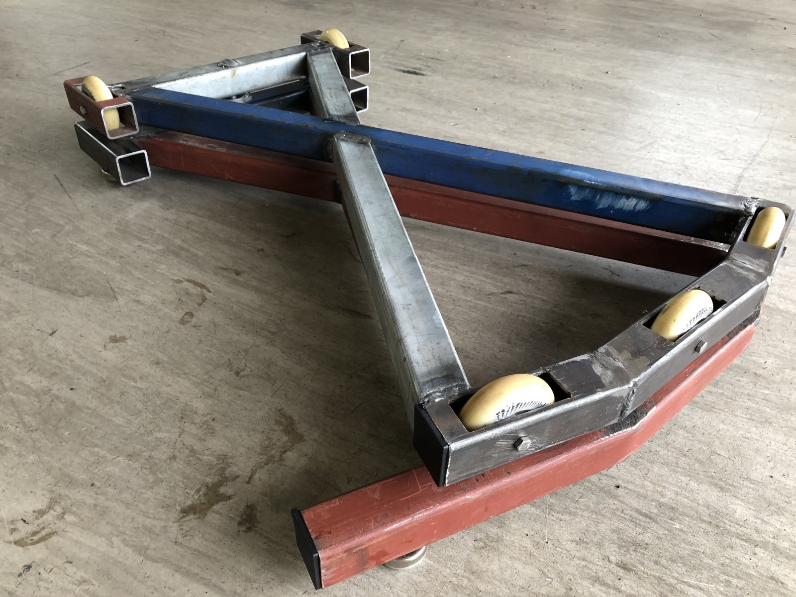

  6. John Snell
    John Snell Member
    May 31, 2021
    63
    192Coins
    +60 / 1 / -0

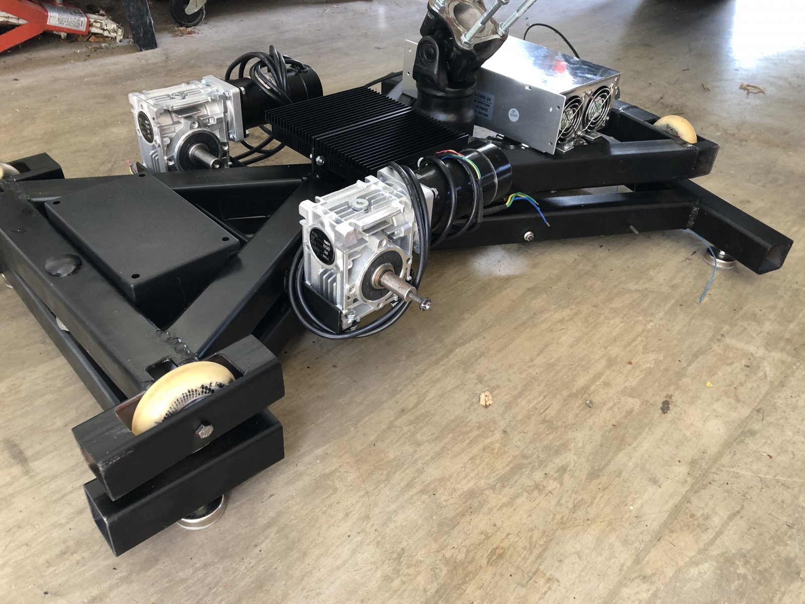

    Very happy to report that after a little more effort than expected (always the way!) I've now completed the physical build for the traction-loss frame. It seems to be working as well as I could have hoped. The remaining 2dof part will build on top of this and should be less of an effort overall.
    It will look a lot better after a coat of paint and some more end caps, but painting will have to wait until all hardware (motors etc) are mounted as that will require more welding.
    Things I learnt:
    • Getting the 2 frames flat and level was difficult. I clamped them together while welding but still needed to adjust the height of one wheel.
    • The wheels are difficult to fit due to needing spacers either side, inside the spare profile. Maybe need a better solution that putting the wheel within the metal profile.
    • I can't go roller blading any more (it's probably been 20 years now anyway)
    It moves so easily that I'm wondering if I use a wiper motor for this part... but then I will have an unused BLDC and driver. I guess I'll stick with plan A, and getting the motors attached, connected and tested is the the next step.
    • Like Like x 5

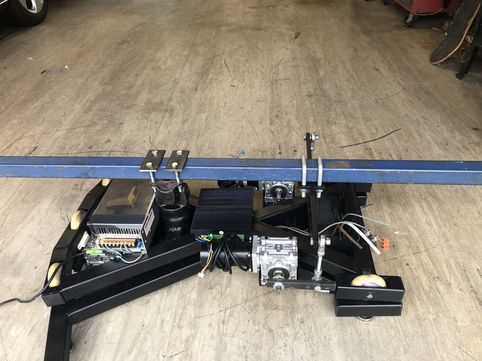

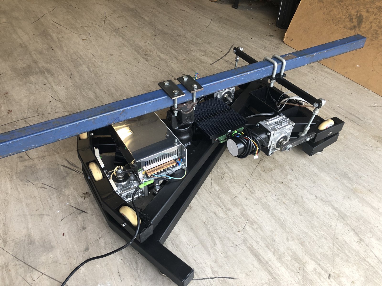

  7. John Snell
    John Snell Member
    May 31, 2021
    63
    192Coins
    +60 / 1 / -0

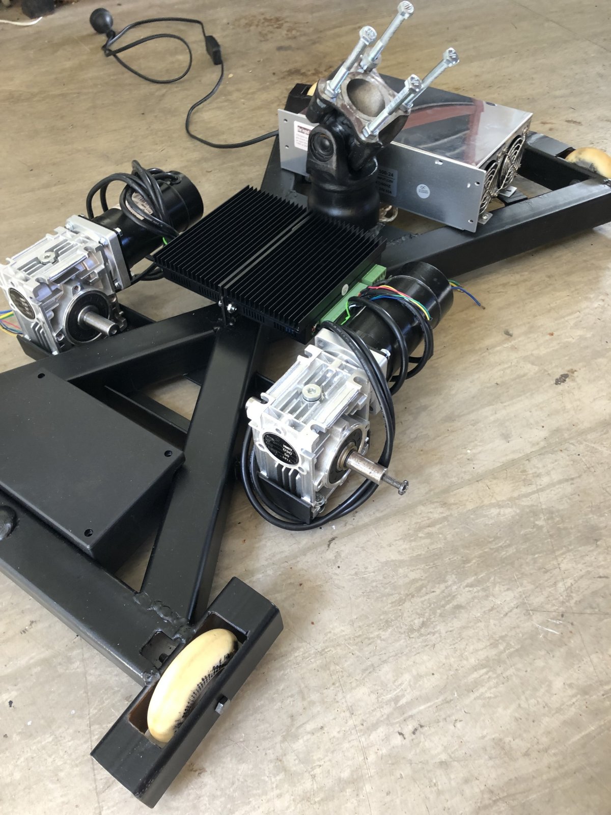

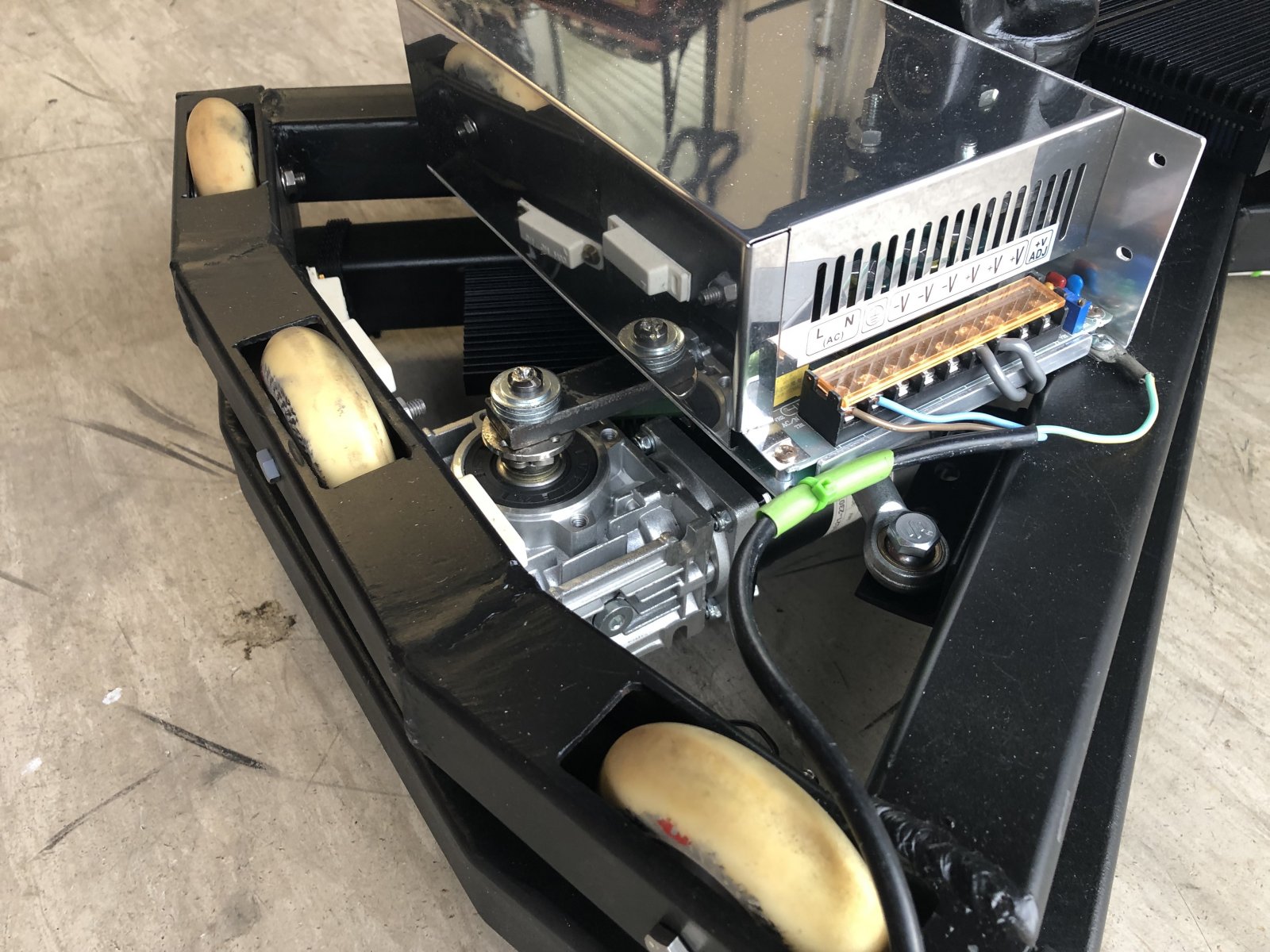

    Finally got nearly everything mounted, including all electronics and power supply:
    - 3 bldc motors/worm gears
    - 3 bldc drivers
    - 1800w 24v Power Supply
    - ESP32 electronics (in the plastic box at the front)
    - Limit switches
    Just wiring to go now. My aim was to make is self contained and relatively small in size.
    I still need to add the movement arms to the front motors (these will swing up/down close to the front wheels), and one last 40mm square bar which those movement arms with push up/down and which my existing rig will be connected to.
    Also, I now need to redesign/rebuild the entire pedal end of my existing rig quite as well due to a new set of pedals arriving tomorrow. That's the trouble with building things to fit equipment... doesn't work when new equipment arrives :-(

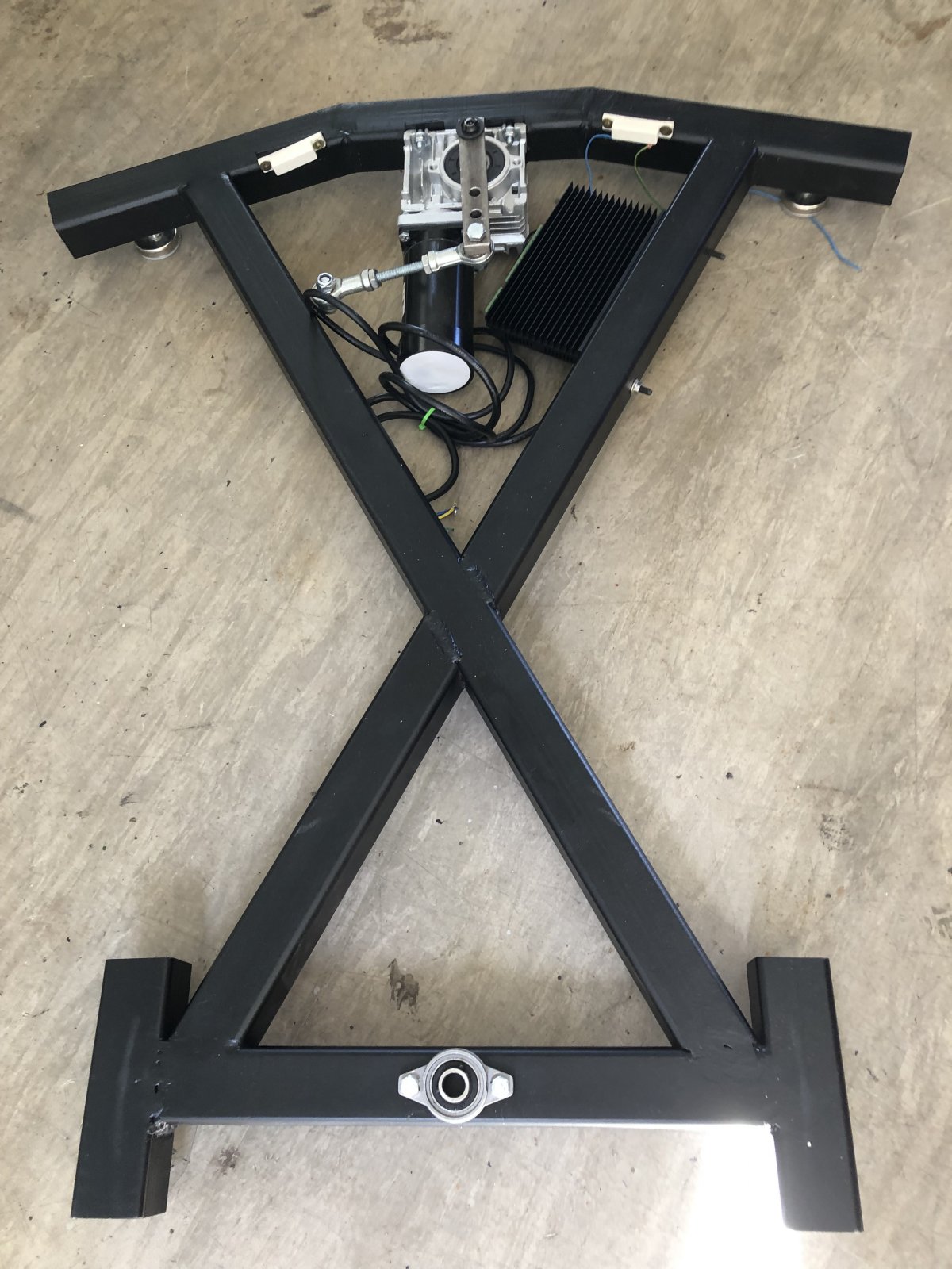

  15. John Snell
    John Snell Member
    May 31, 2021
    63
    192Coins
    +60 / 1 / -0
    Hi @workfayer. I'm very flattered that you like the design, thanks for the feedback. A lot of thought went into the criss-cross design so that the motor arms can swing low towards the floor without hitting the lower frame while swinging sideways for traction loss, as I'm trying to minimize the overall height.
    The Wantai BLDC-8015A drivers I'm using (the black heat sinks you can see in the centre of my frames) seem quite good, and are approx USD$20 per motor. From memory an oDrive is more than $200 for 2 motors, and I would need 2 of them.
    Yes my racing rig, which currently sits on the floor will be mounted on top of this unit as you know. I have recently completed the mechanical build (just wiring to go but other things like house painting keep getting in the way) so I can show you how it will work in the photos below. The blue bar in the photos represents the central bar of my racing rig (photos of that are in my first post). The blue bar is not the correct length, and I may still have an opportunity to lower the universal joint it will sit on. A rectangular frame should be able to be mounted in a similar way I expect.

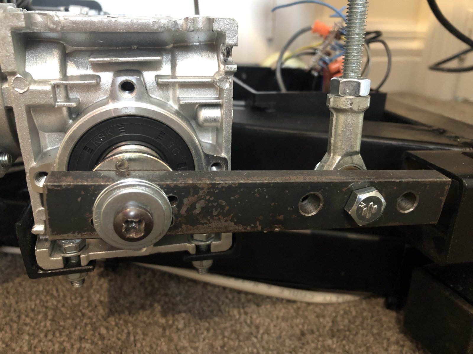

    Question: Does anyone know what the motor levers/cranks (see photo) are called, and where they can be purchased? Mine are DIY and I never want to do that again :)

    in my country there is no store or market for this type of part I think you need to order it from a company that does custom machining by sending the measurements to them
  20. noorbeast
    22,185
    154,750Coins
    +11,196 / 57 / -2
    Simukit sells a couple of different cranks, but as @workfayer it may be quicker and cheaper to have something made locally:
    https://simukit.com/gb/motors-and-cranks/15-crank-for-dc-motor-120w.html
    https://simukit.com/gb/motors-and-cranks/16-crank-for-dc-motor-440w.html
