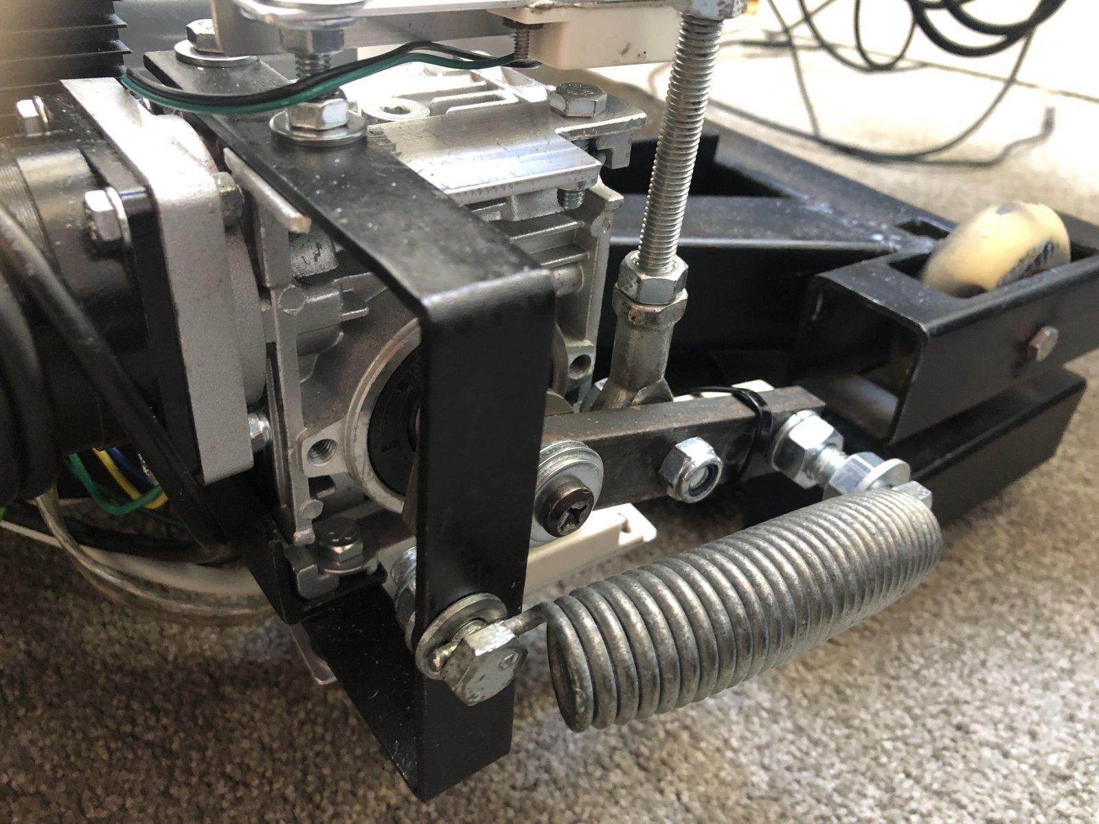

    I tried adding a little pre-load onto the actuators but I didn't really like the feel of it. Probably related to the type of motors, but during lowering of the front actuators I could feel a little jerkiness as the motors tried to limit the rate of decent/fall.
    In the end I went back to my bending spring idea. They are mounted but I haven't fully decided if they work or make enough of an improvement. For now they will stay.

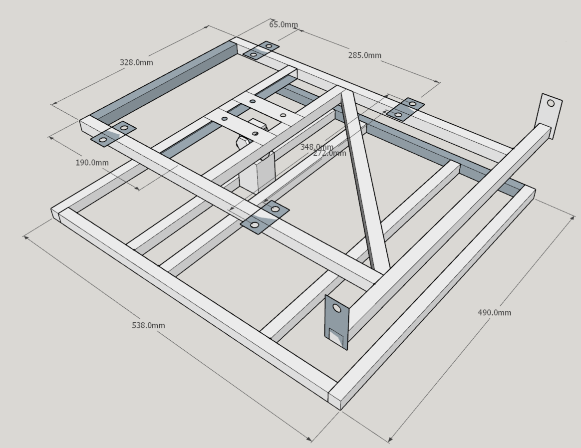

    I decided to use leftover parts to build a seat mover for a friend.
    The parts:
    - 2 x wiper motors used in my original proof of concept
    - 1 x universal joint from Nissan car.
    - 1 x Arduino and 2 x H-Bridge drivers
    - 2 x 300w Computer PSUs
    - Some 18x18mm box section steel
    The aim is to fit it to build it to dimensions that replace the seat riser in a GT Omega ART rig, shown below.
    Here's my plan so far:
    In testing, I found that one Power supplies cut out. I've added in diodes to block any reverse current but it didn't help, so next is a some over-current limiting circuitry.

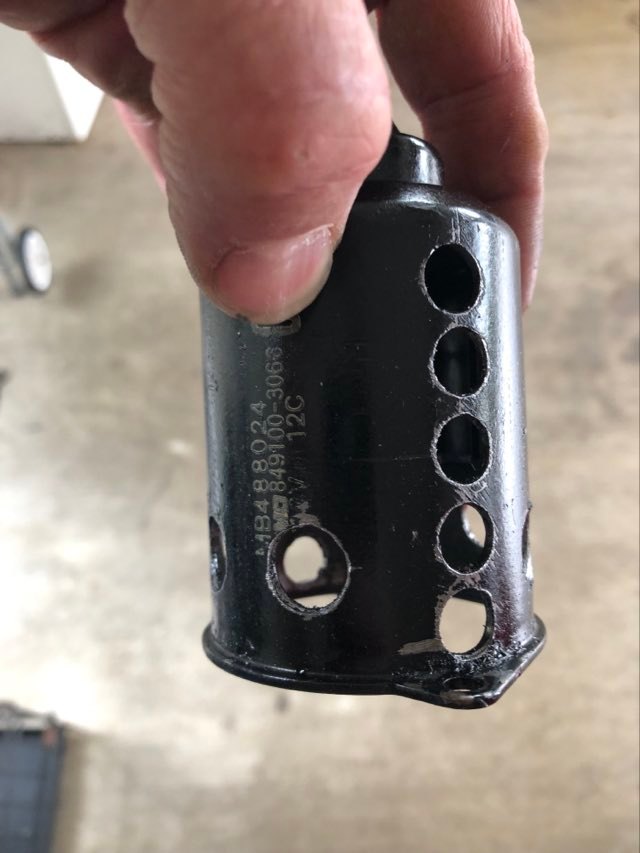

    I also found that one of the motors get's too hot to touch. Yes I know that wiper motors may not be ideal. Here's my attempted solution :)
    With this, and a small fan blowing directly on it the heat is reduced. I hope it's enough.
