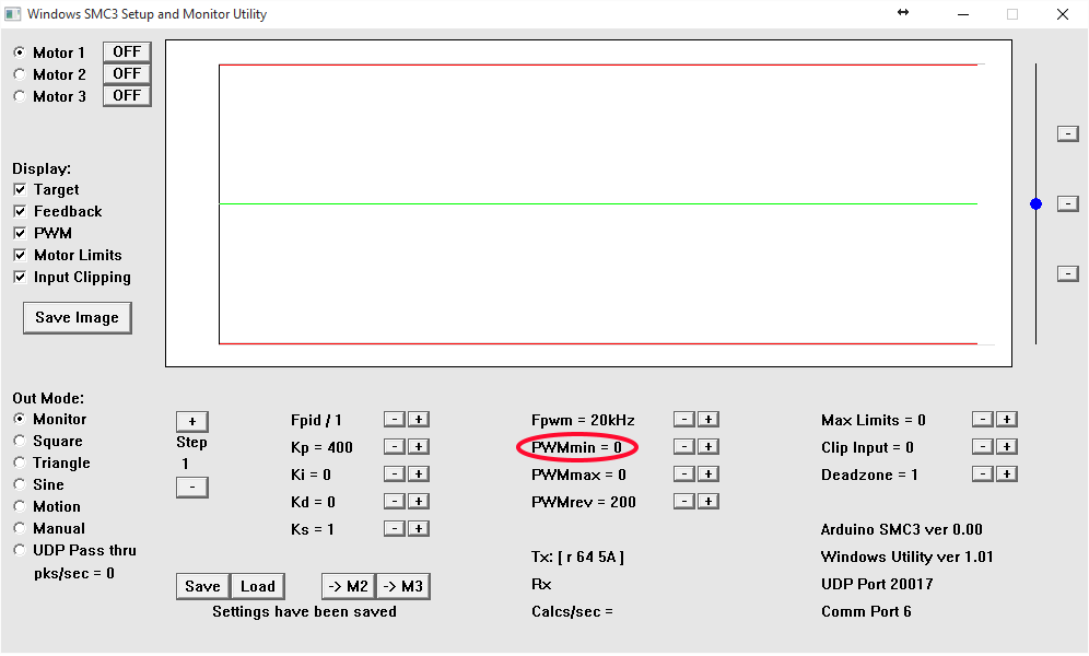

    Here the basic settings, PWMmax is set to zero, if you need power you raise it up.
  4. Deleted member 10067
    Thanks @Pit I'll stick these values in.

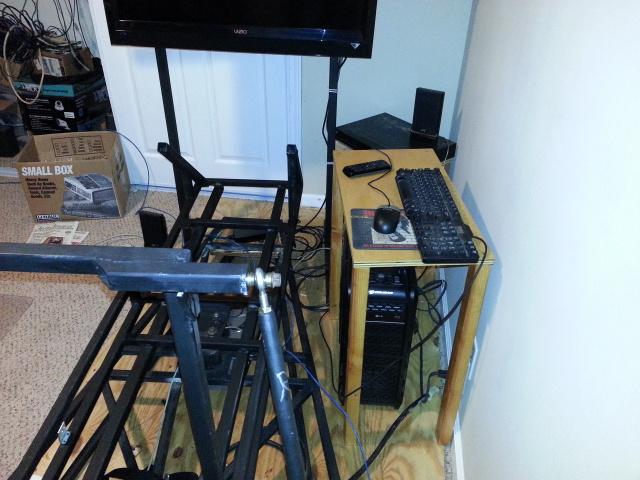

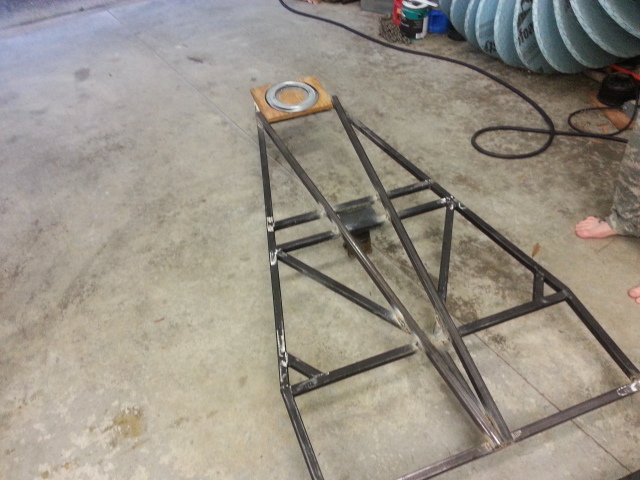

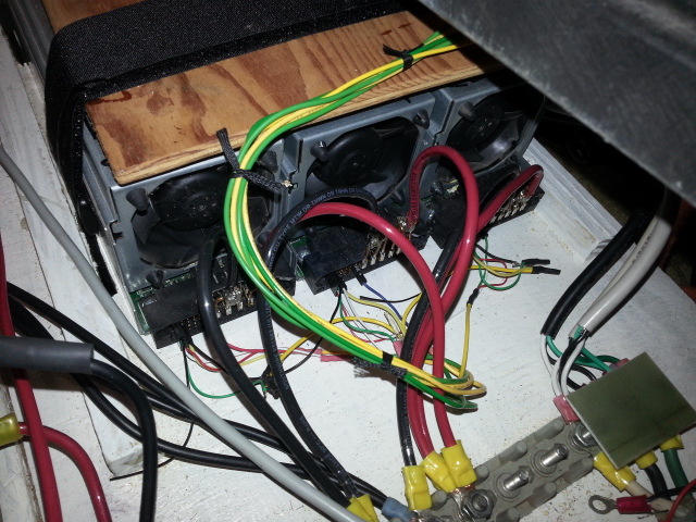

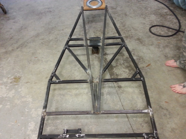

    Hi gang, I have spent the last 3 months moving. Moving sucks when you're old; check, a pack rat; check, lazy; check and a few other reasons I can't think of at this time. I bought a house from a flipper, bless his heart, he'd watched too much HGTV. So I spent 3 weeks fixing "stuff". I have never actually been as hot and sweaty; rained most every day. I wouldn't wish moving on anyone, enemies or not. The sim is in its "place". I was having problems with the motors being unstable and shaking. I determined that the rig was too flexible and added more steel tubing to brace it. This was the fix. The vibration was feeding back into the servo and making the shakes. I have been working on tuning now that the rig is much more rigid. It seems to be working well. Extra steel added to seat frame.jpg Extra steel added to yaw frame.jpg Game computer and sim, lots of heat.jpg Much more steel, rig is 20 pounds heaver.jpg Power supplies in parallel control wiring enabled.jpg
    This has been a fun project. Knowing what to buy was nice!

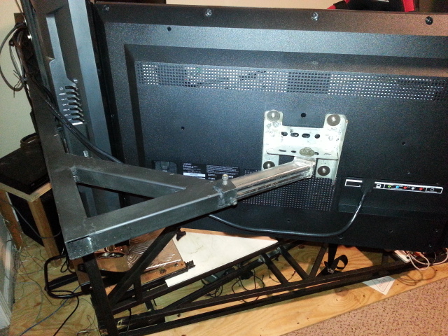

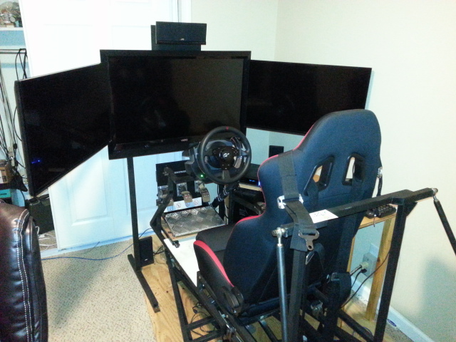

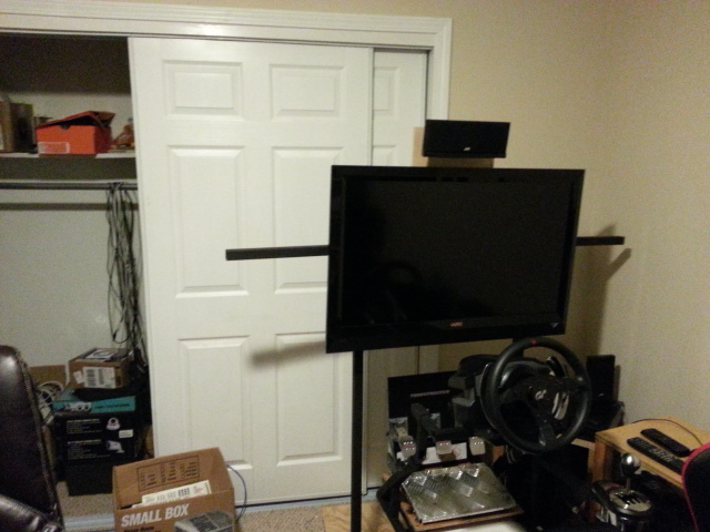

    Next sim mod is getting the triple monitor working. Cables came in today for the the two additional monitors. The mounts will be welded to the horizontal tubing. I am dreaming of 6dof already. 20160916_135722.jpg
    I have the clamp and mount designed. Now to find my cutoff saw.

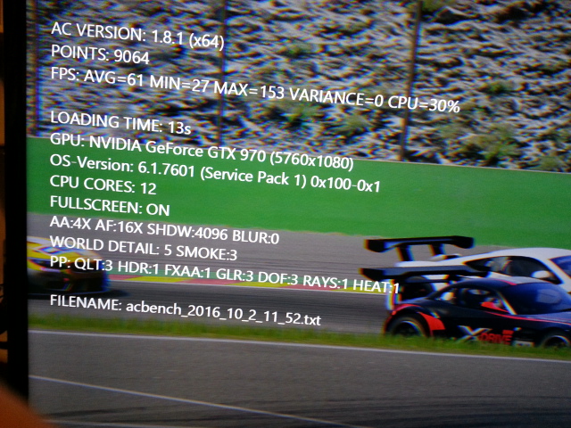

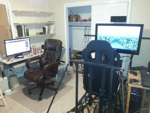

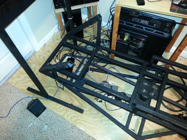

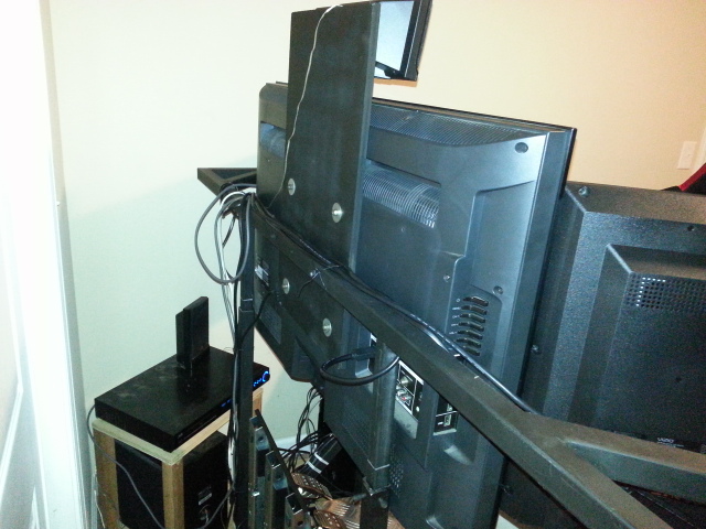

    Had some time; no that's a lie. I'm retired, I've got lots of time. Got the three monitor setup all welded up and a GigaByte GTX970 video card installed in the computer. Still working with settings, seems like surge and heave are the the two main forces for the driving sim. Getting it all "dialed in" is a long task. I have to go back and run sim with one force to make sure I'm still on track. Here are some more pictures. Benchmark AC.jpg Game computer and sim, lots of heat.jpg Main monitor.jpg one of the side monitor.jpg three montior setup.jpg Yaw section braced.jpg
    First picture is the benchmark test for AC. Next picture is room with my gaming computer and sim, then the next three pictures are the triple monitor setup.Last picture is the braced yaw section. It was too flexible, so I added 2 more sections of tubing. Later James

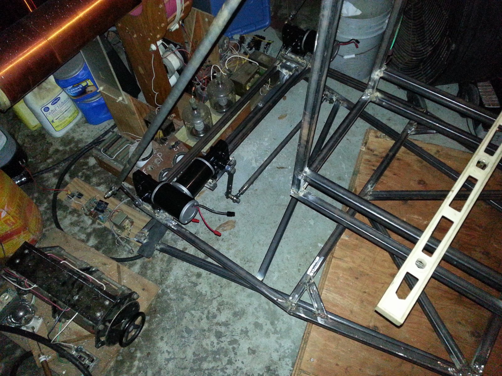

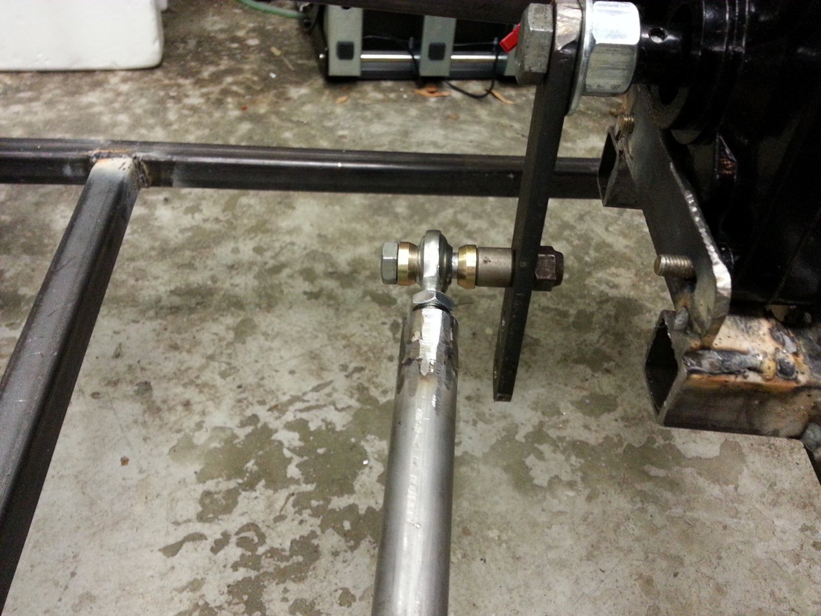

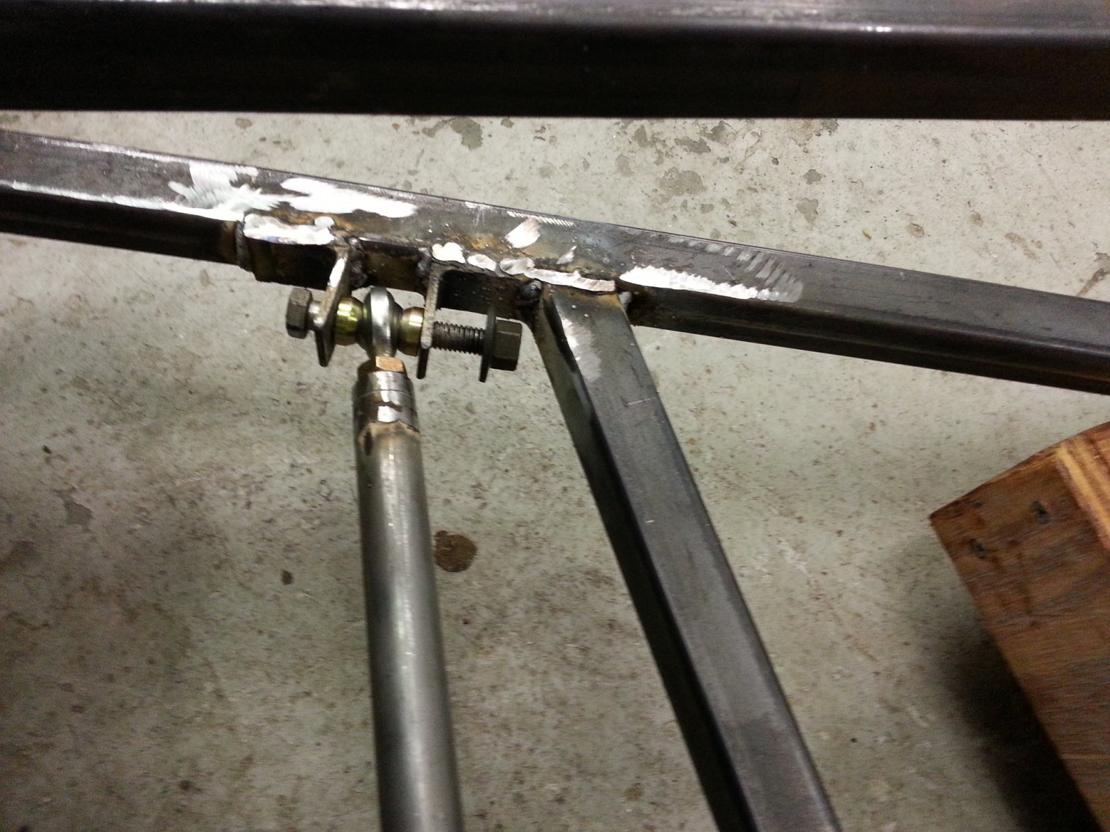

    20151224_081051.jpg 20151223_171137.jpg 20151223_171129.jpg Here are some pictures of the traction loss linkage:
    Still working on a video for you guys. Getting the forces adjusted correctly is the majority of the sim work.
