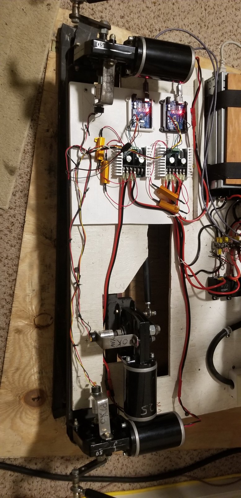

    I see it's been a while since I posted any news about my sim. Replaced the Monster Moto's with Sabertooth 2-35's. No more blown up motor amps. Installed high current relays in the positive power supply lead. I have instant stop. Much less wiring also. 20201008_133146.jpg
