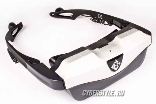

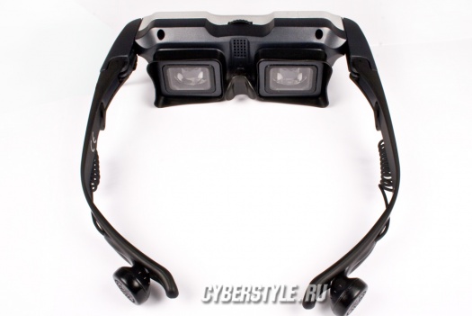

    A little later I will make another video with GTR.
    Instead mount the monitor on the platform, I want to buy now are 3d video glasses.
    And use freetrakir during the game.
