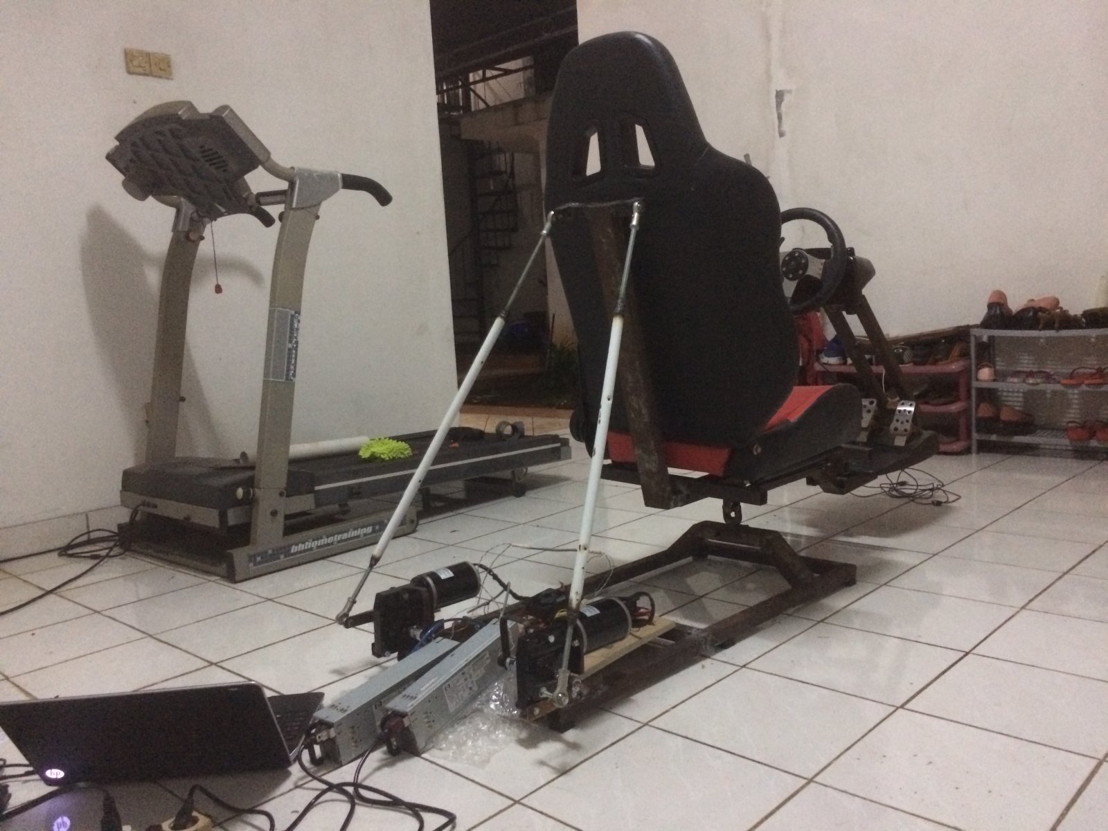

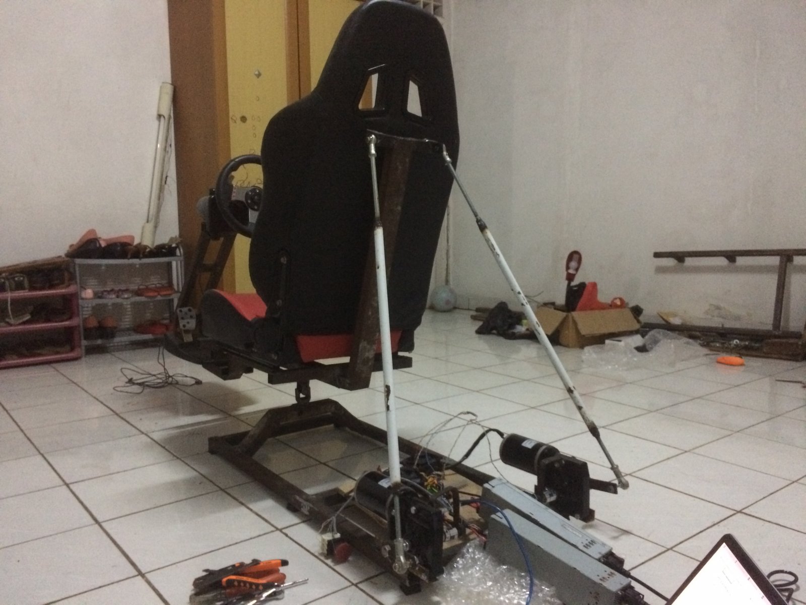

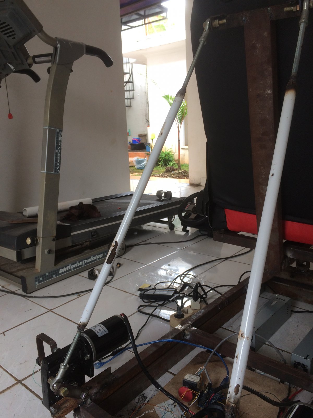

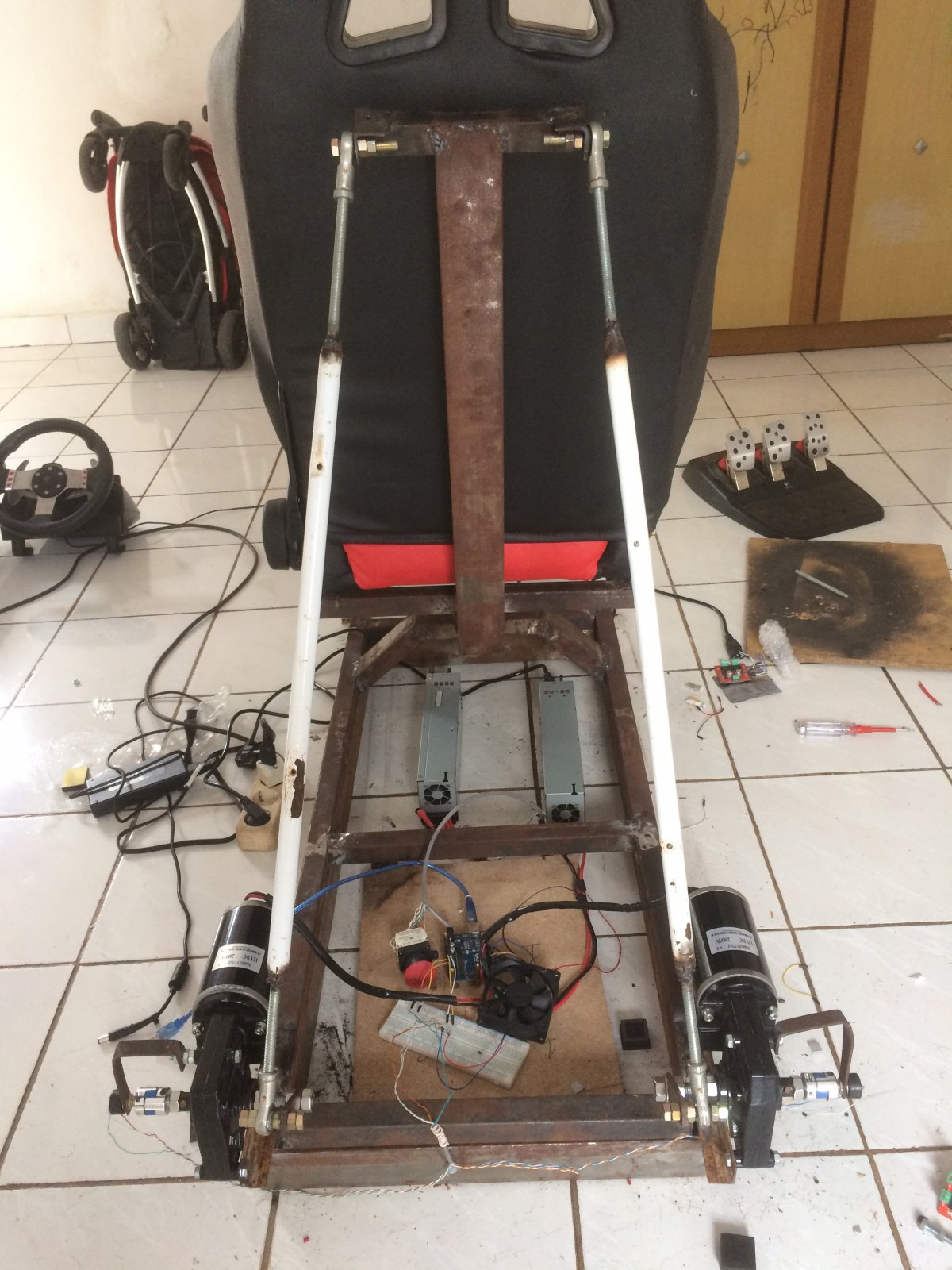

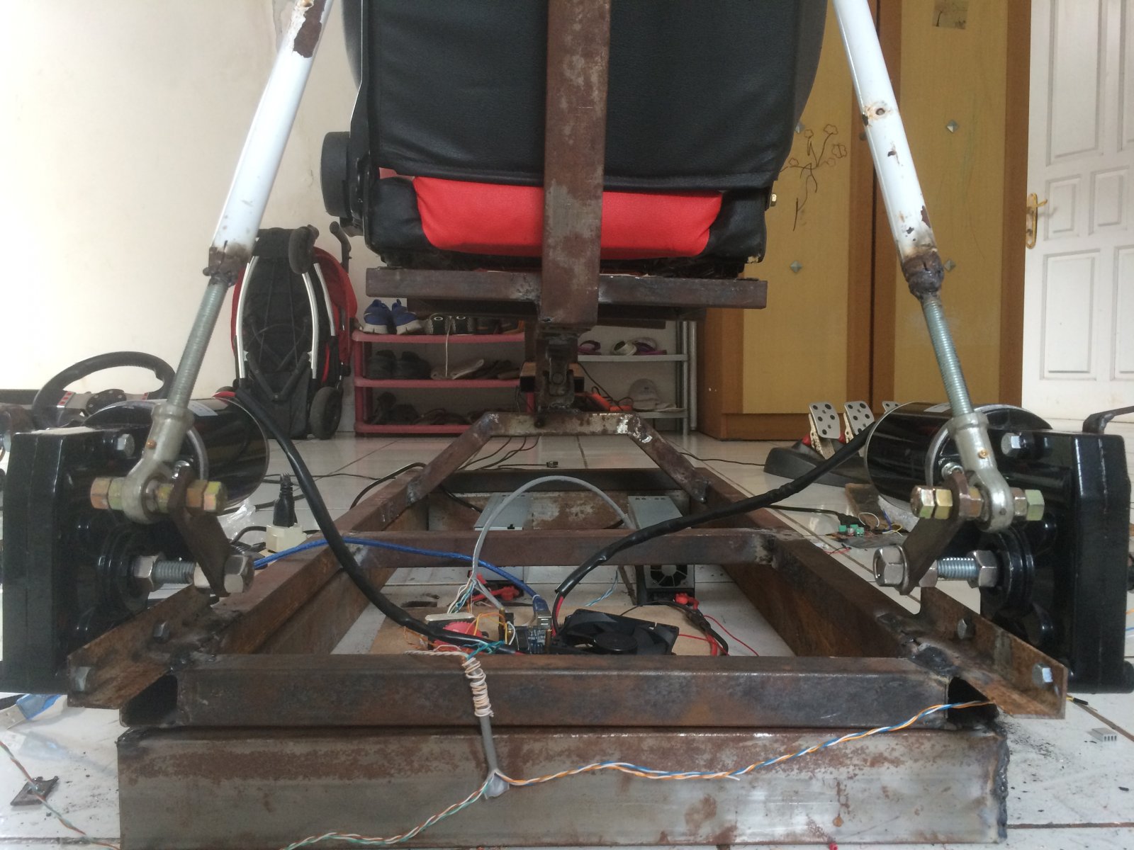

    Revise my motor position as suggestedby @Daguru , still have to improve structure rigidity because it flex so much, even after motor stop.
    Photo 10-22-16, 11 00 22 PM.jpg Photo 10-22-16, 11 00 33 PM.jpg Photo 10-22-16, 11 00 45 PM.jpg Photo 10-22-16, 11 01 00 PM.jpg Photo 10-22-16, 11 01 10 PM.jpg

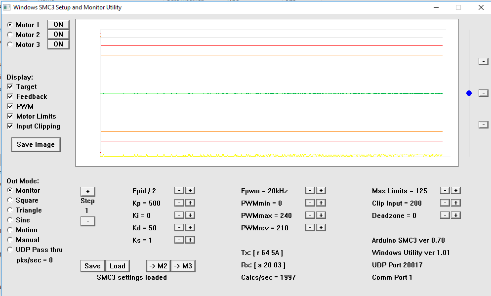

    Problem arise when after initial setup with SMC3 for Both Motor.
    MOTOR 1
    motor 1 is not responding to SMC3, whenever i rotate the lever to start position for short time it will follow target, but seconds later it stop
    MOTOR2
    Another problem from second motor, it always flick vigorously up to max limit causing motor turn OFF, whenever i rotate back to start position it always flick again. Try to reverse motor polarity, the difference only reverse direction of motor flick.
    So close yet so frustrating:sos
  6. Daguru
    Sep 4, 2013
    720
    Kitchen installer
    Wales uk
    461Coins
    +633 / 1 / -0
    Motion platform

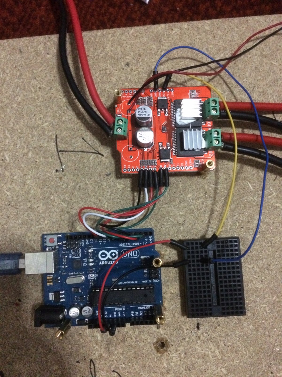

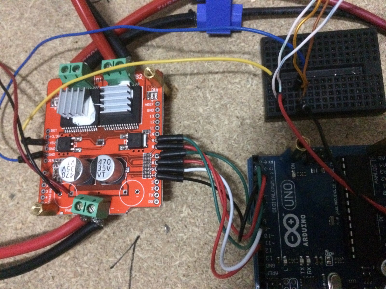

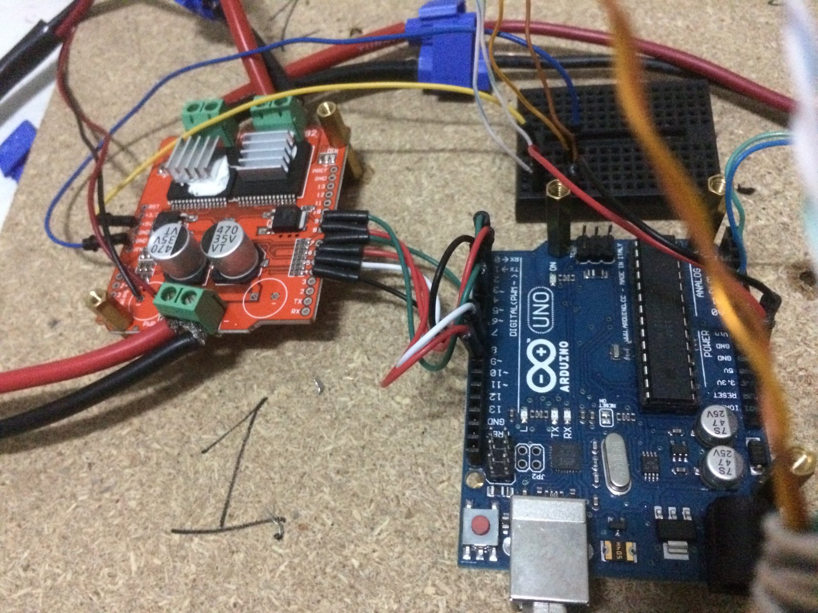

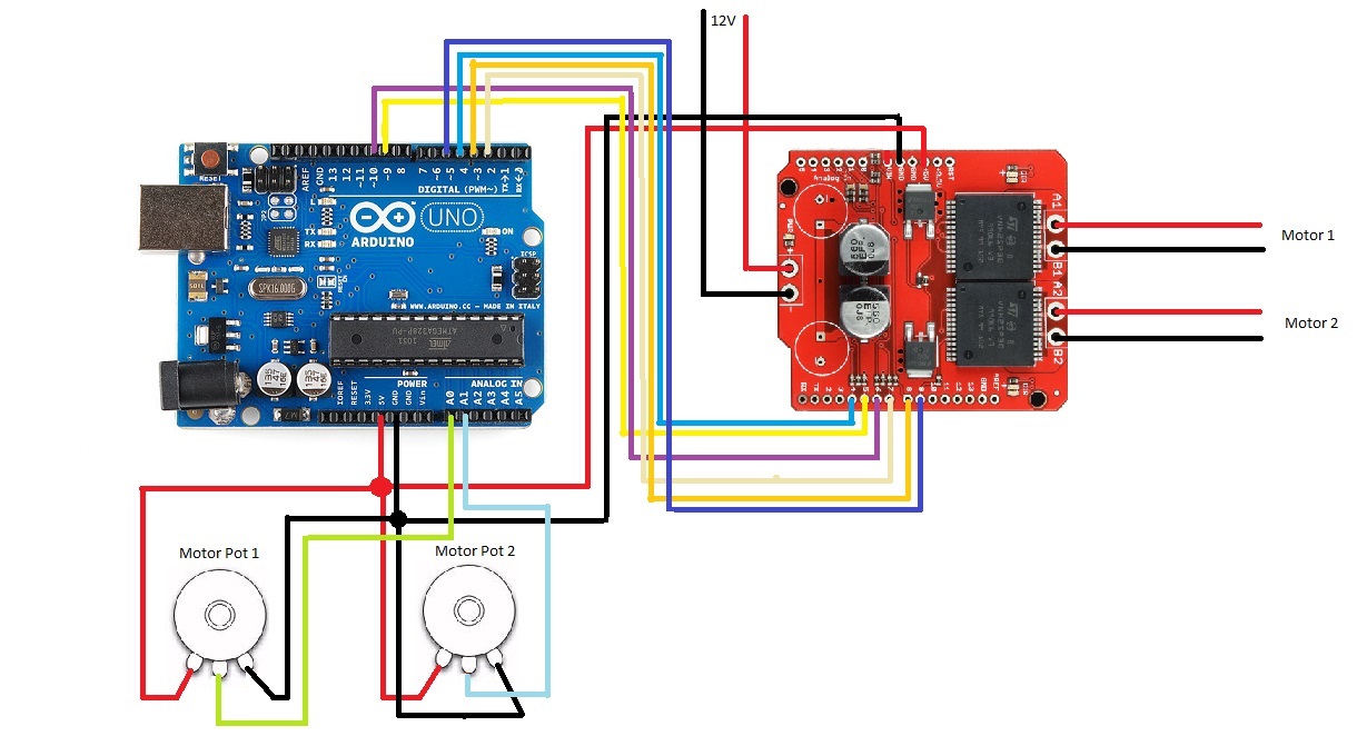

    Time to go back to basics And check all your wiring, can you post a picture of the wiring diagram you followed with some close ups of your wiring from Ard to MM ?
    And then screen shots of your SMC3 settings

    I am following this diagram @Daguru
    My setting just the same like initial setup setting in SMC3 thread,
    Photo 10-23-16, 8 02 36 PM.jpg Photo 10-23-16, 8 14 39 PM.jpg Photo 10-23-16, 8 14 48 PM.jpg
    Here's my actual wiring, so messy. But correct according to wiring diagram.
    Is it possible that my MM is error?Will try with another MM tomorrow..

    Hi it's a little to hard to see where all the wiring goes from the pictures only one picture shows the pots connected to the Ard can u confirm you are using A0 and A1 on the Ard for pots ?

    Pictures taken before i connected pots, yup i can confirm that A0 for Motor 1 & A1 is motor 2.

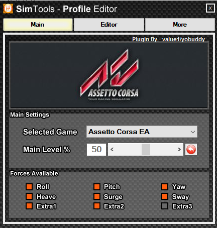

    21,721
    151,961Coins
    +11,061 / 56 / -2

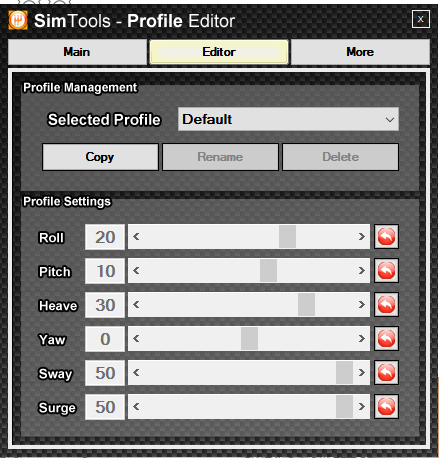

    Do you have the main level set to 50% for a reason? It will kill performance.

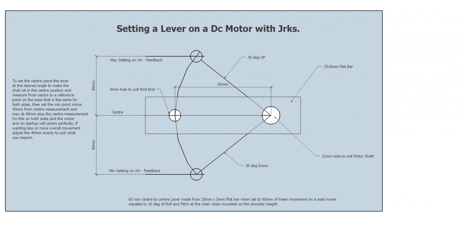

    Torque effectiveness drops off rapidly with more than about 38 degrees either side of 90 degrees for the lever to rod angle. It is hard to tell from the video but you seem to be using more than that.
  12. DonCorleonez
    DonCorleonez Member
    Mar 14, 2009
    80
    195Coins
    +15 / 0 / -0
    Thanks @noorbeast
    50% is from SimTools QuickStart for safety reason as this is my initial motion. Surely i'll max-ed the setting after this:).
    regarding that degrees, how to adjust it?by changing values or i have to reduce height of uni-joint?
  13. noorbeast
    21,721
    151,961Coins
    +11,061 / 56 / -2
    As you now know it works reset the Main Level %.
    The lever to rod angle is determined by the physical alignment of both and how far the lever is set to travel.

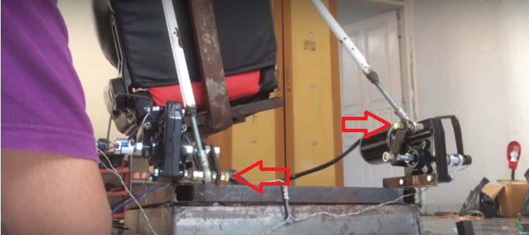

  14. DonCorleonez
    DonCorleonez Member
    Mar 14, 2009
    80
    195Coins
    +15 / 0 / -0

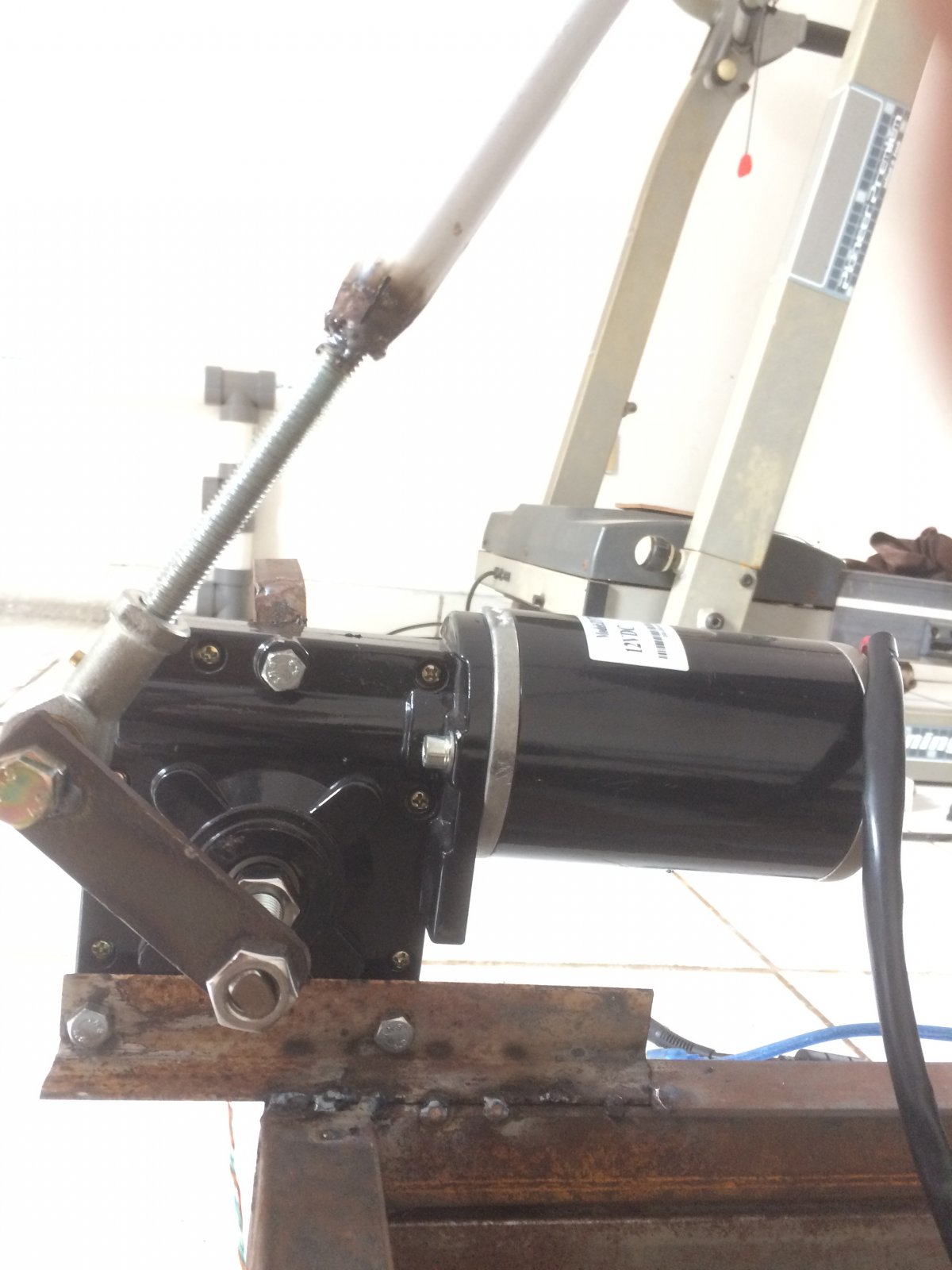

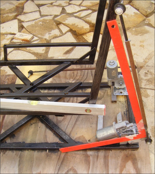

    @noorbeast can you point me which angle?
    is this one?
    this my "start" position of lever, 90 degree between lever arm and rod. So 38 degrees you talking about is +38 (up) & - 38 (down) from this position?
    And how to set how far it travel?from SMC3?Gameengine?
  15. noorbeast
    21,721
    151,961Coins
    +11,061 / 56 / -2
    This angle:
    Looks a lot here:
  16. DonCorleonez
    DonCorleonez Member
    Mar 14, 2009
    80
    195Coins
    +15 / 0 / -0
    After browsing the forum, is this what do you mean @noorbeast?
    is it correct?So what value i have to adjust to minimise lever travel distance?SMC3 values or gameengine values?
    and about my lever position, i refering to @RacingMat build tutorial
    90 degrees rod to lever.
    so which is better for my design?
    1. lever at angle making 90 deg to rod, or
    2. lever sits horizontally?
    and is it make any difference whether position of lever pointing outward (like my current design) or inward?
    thanks a heaps before for your support;)
  17. Nick Moxley
    17,056Coins
    +2,506 / 30 / -2
    Also Those motor mounts look WAY Too light gauge, When you sit in the seat, there will be Lot of twisting and deflection. IMO this needs to be fixed.

    Thanks for input @Nick Moxley, surely i'll change to thicker mount (actually already consider it from your build thread)

    I have my lever level with the ground. s0 40cm up and 40cm down from that point.
    And yes the Angle iron used on my rig is more than ample.

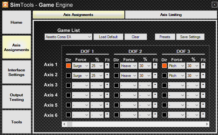

    After reading some documentation, i find that we can set lever travel by setting it in simtools "Axis Limiting", is that correct?
    so in your case (40up & 40 down) you set around 88% (assuming max 45 up & down) for both Axis in Simtools?
