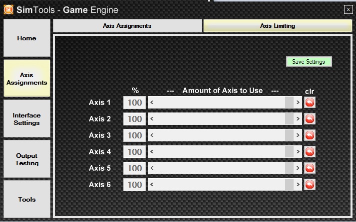

    NO you dont want to be "limiting" any axis in reality......the Basic setup for the lever's is performed **for me** in the JRK utility, Not simtools.

    you can use a feature that smc3 V0.7 has. use a pot to scale down (limit) the travel.
    Updates Version 0.7
    • Added a POT scaling input that can be used to scale the motion output based on the POT position
    • POT scaling can be setup as one of two modes - Linear or non-linear
    • DO NOT ENABLE POT SCALING UNLESS POT ATTACHED TO ARDUINO
    • AN5 used for POT scaling input
    • The non linear scaling is designed to try and reduce the overall motion but maintain the "smaller" movements as best possible - ie road noise and stuff, but scale back on the huge side to side motion you get in higher power cars.

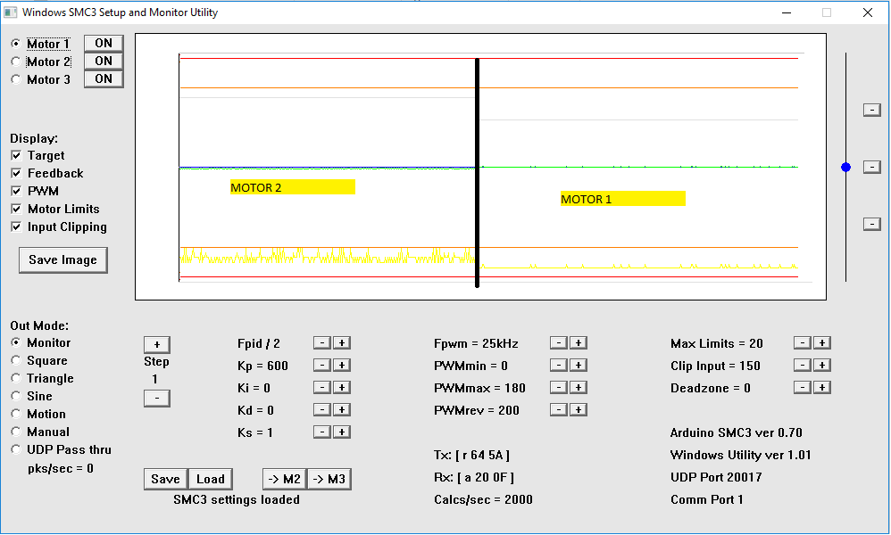

    any suggestion
    problem in motor 2, feedback cant keep up with target line,
    motor 1 relatively normal, always inline between target and feedback

    motor 2 mm behaviour
    motor direction indicator for motor 2 is not always blinking, when this happen, my lever keep hanging at up position. It came ON if "brought down" to "target" area by seat movement. and after that it'll off.
  8. DonCorleonez
    DonCorleonez Member
    Mar 14, 2009
    80
    195Coins
    +15 / 0 / -0
    Here is screenshot from SMC3, for Motor 1 & motor 2.
    As you can see, PWM graph motor 1 is relatively smoother than motor 2.
    I already switch pots, same thing happened.
    Replace with new pots in motor 2 same thing happened.

    Reload the SMC3 code to the Aduino and try again ... otherwise you may have a bad Arduino.

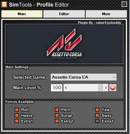

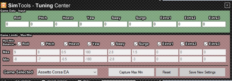

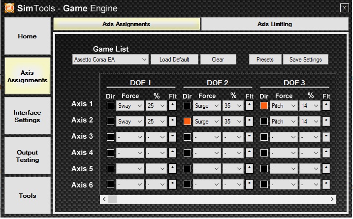

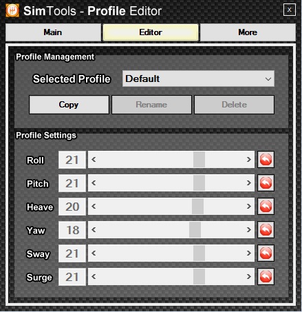

    UPDATE April, 24th 2017
    Hi all,
    i am back after thoroughly re-read every FAQ, every advice from my thread, and others thread.
    FINALLY MY SIMULATOR IS MOVING..YEAYYY!!!:cheers
    this is video of my sim in action
    and this is my setting
    Update from previous :
    1. Re-build my simulator to simple seat shaker (previous full frame).
    2. Re-make motor shaft from threaded rod to custom shaft (milling).
    3. Evaluate wiring.
    4. Evaluate @Wanegain arduino sketch (Min & Max pot. I decide to using +60 -60 degree movement, to prevent over travel lever).
    5. Will send my simulator frame to be powdercoated.
    6. Back to drawing board, traction loss coming soon (motor already on hands, board still thinking Sabertooth?JRK?).
    With current setting and condition, my movement as you see in video. I still learn to get finer movement. Playing AC for 2-4 hours (playing with motion sim is really addictive) my motor is Normal (even no warm), my Sabertooth is Normal, my PSU is Normal. the only problem is my PSU is very loud.
    Playing Dirt Rally with AC setting. Everything is warmer. I play only for ONE Stage (6-10 min).
    some question :
    1. I am thinking about giving some "safety protection" to my electronic configuration, i see several nice idea from this community (using car battery, fuse, even relay). i really want to put all that to may simulator (Overkill?). what do you guys think?
    2. Am my simulator eligible for free SimTools 2.0?
    That's all my current status. please dont hesitate to comment about my simulator (i really need input from all sim expert from this amazing community).

  20. Nick Moxley
    17,056Coins
    +2,506 / 30 / -2
    Lotus 125T = YUCK.....thats a far cry from a F1 car. I do not suggest basing ANY profiles on that monstrosity of a car.
    F138 if you want to test a legit f1 without worrying about the Hybrid management.
    Dont be afraid to crank on them Profile editor sliders.
    Ideally you'll want your Rock stiff F1's on the negative side and the Bubble gum soft Street cars on the Positive side. Essentially using the same tuning center values but covering the wide spectrum of suspensions.
