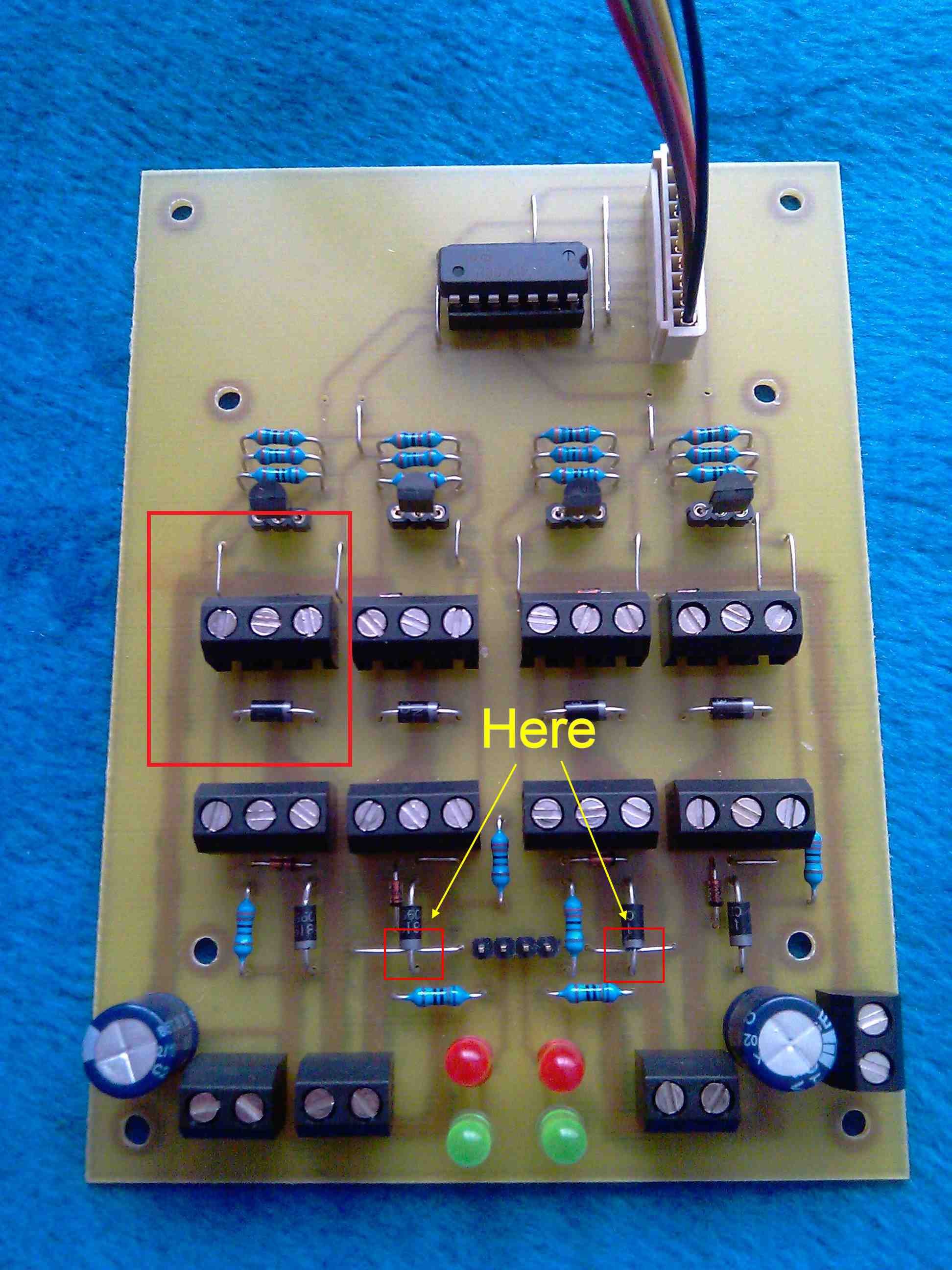

    hi today i have changed 4 mosfets!!!
    i changed alle irlz44n to irf44!
    when I connect everything to move the motors 30 seconds and everything goes all out!
    and the mosfet on the picture issssssss veryy very hot!!
    need help plz!!

    Hi Interview,
    have you checked where the diode and the links cross to make sure that they are not touching as in the photo they seem to be quite close. The link should be bent so it is under the plastic case on the diode and cannot touch the metal leads on the diode.
    Senetor.
  13. Deleted member 4120
    Deleted member 4120
    have all looked
    It touched nothing

    Only active component you didn't change are BC transistors, why don't you try that.
    And try to measure the diodes also.
