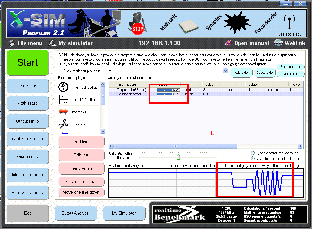

    It is really not as hard as you think.
    -Load Test Plugin, make sure you see Effect 21-40 moving when you move the sliders.
    -Create an axis
    -Add 1:1 G-Force to axis, select which slider should control it and adjust the endpoints.
    -You should see the graph changing as you change slider.
    -In USO now you have this axis (a01) that you can add to your output string.

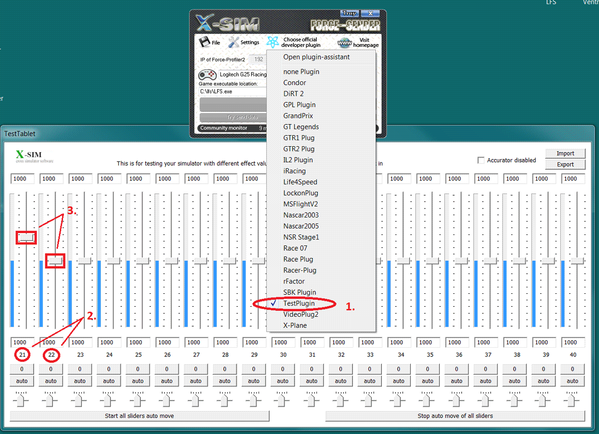

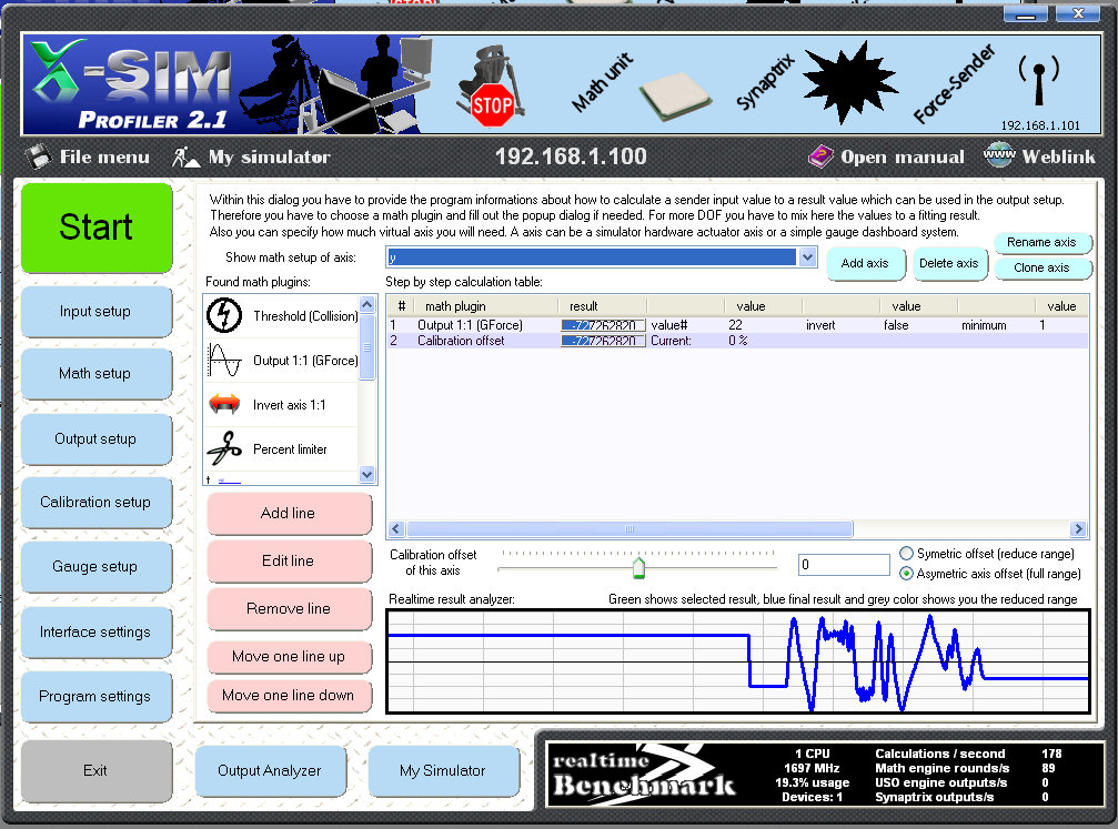

    1. Force-sender is running and I choose Test-plugin like Frakk suggested.
    2. I'm using sliders 21 and 22.

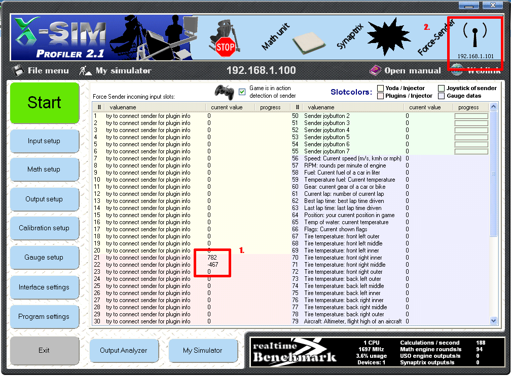

    3. When I manualy (or auto) move these sliders, I can see the values change in math section of profiler
    I'm showing next a couple of the profiler screenshots:
    1. These values are changing when sender sliders #21 and #22 are moved
    2. Connection is clearly OK
    Following are screenshots for both axis I made for testing:
    1. These bars are changing, and graph is displayed accordingly to sender sliders also

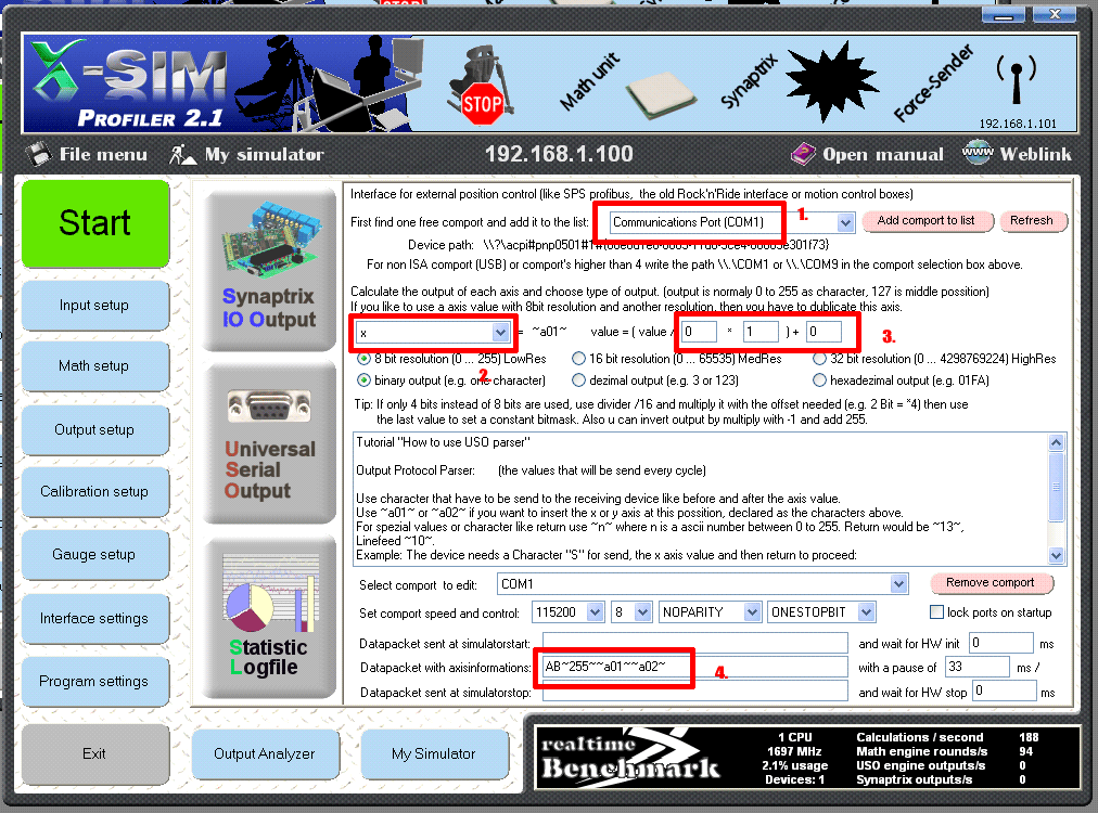

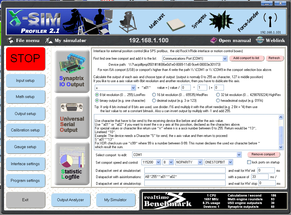

    Next is profiler output settings which is same for both my test axis x and y:
    And finally, when I hit the START button, there's no parsing or other errors, but also no change on AMC LCD :(

    I cannot find anything wrong with your software setup and USO.
    -Sliders are moving in Math
    -USO is set as per the AMC instructions
    -USO engine outputs at 30 with 33ms delay
    You are transmitting the right information from what I can tell. I would be more concerned about the circuit.

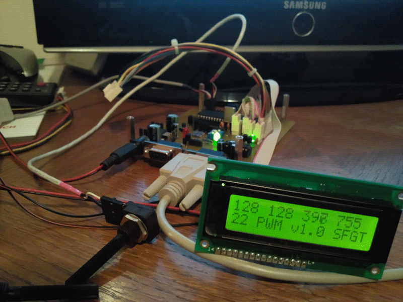

    I've flashed the AVR with 18.xxx FW and put 18.xxx MHz crystal and after restart I can control the AMC input values 8)
    If we ever meet I would like to bye you a bear Frakk :cheers:
    I started the LFS plugin and managed to see the change on LCD. It now makes sense to play with proper settings and build my own profile, but not until I test the HB.

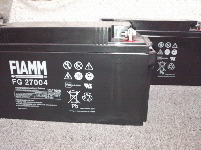

    And here are my two 70 Ah cuties (valve regulated lead acid batteries):
    I only need to make a charger circuit for them. I will use LM317 for that and 12V from my AT PSU which I'm already using for AMC and LCD.

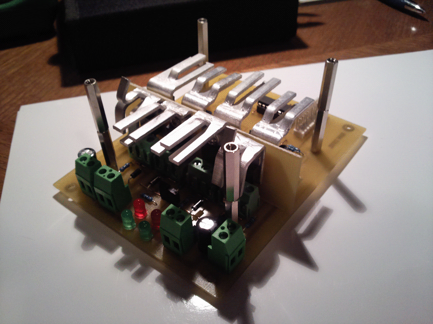

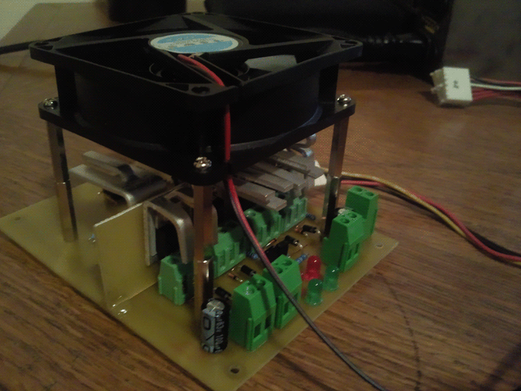

    Cant help comment on your cooling on that h-bridge fermevc. It looks like it goes across the sides, or is it an isolating material?
    Thanos vrote:
    You can place a cooling plate but it should placed only on opposite placed pairs (one IRFZ44 and one IRF4905). I show in the next photo the pairs that you can connect together (circled and colored blue).
    http://www.x-simulator.de/forum/tronic-s-diy-dual-mosfet-h-bridge-dsmhb-t820-70.html
    Fred

    Don't worry fredspeed :)
    The plate between the MOSs is peace of PCB after etching (leftover).
    I needed something to isolate so I grabbed closest thing around :)
    My terminal connectors are bigger than Thanos's so MOSs came very close to each other, and I didn't had any spacers or little tubes to fix it.
    So, this is just a precaution and to make the whole thing stiffer.
    Thanks for your concern.

    Good to hear changing the frequency fixed the problems. The At8535 was never meant to run at 22MHz, and I could never figure out why it is even an option. It just gives headaches for everyone.

    You don't need an LM317 regulator to charge the batteries. 12V is not enough to charge them anyways, the regulator will only drop this voltage.
    I just connect the 12V ATX PSU directly to the battery and it keeps it charged to 12V. To fully charge it you need ~14V-15V.

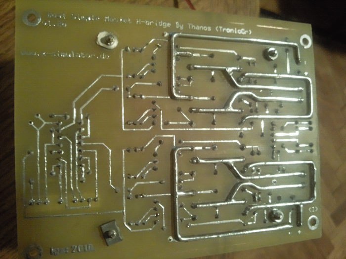

    here is my board (solder)
    [​IMG] [​IMG]
    was yesterday put some solder to.
    but it has not done anything!
    as soon as I plug a little poke hear the little LED to light up.
    Yesterday evening I went for 14 MHz down!
    and it did not help: (
