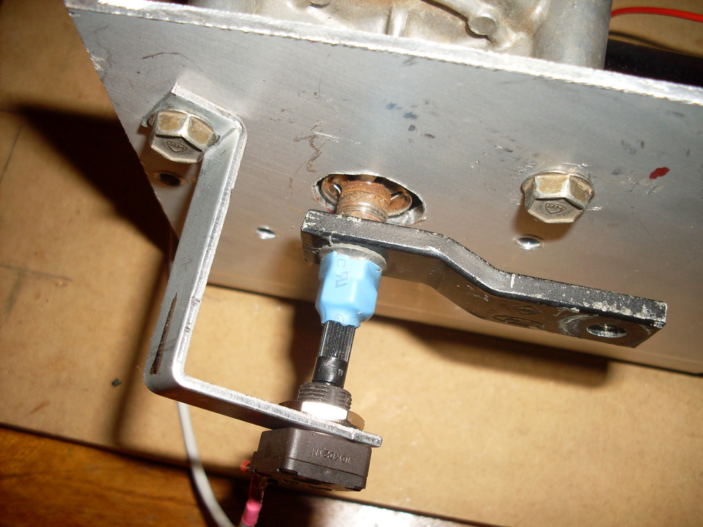

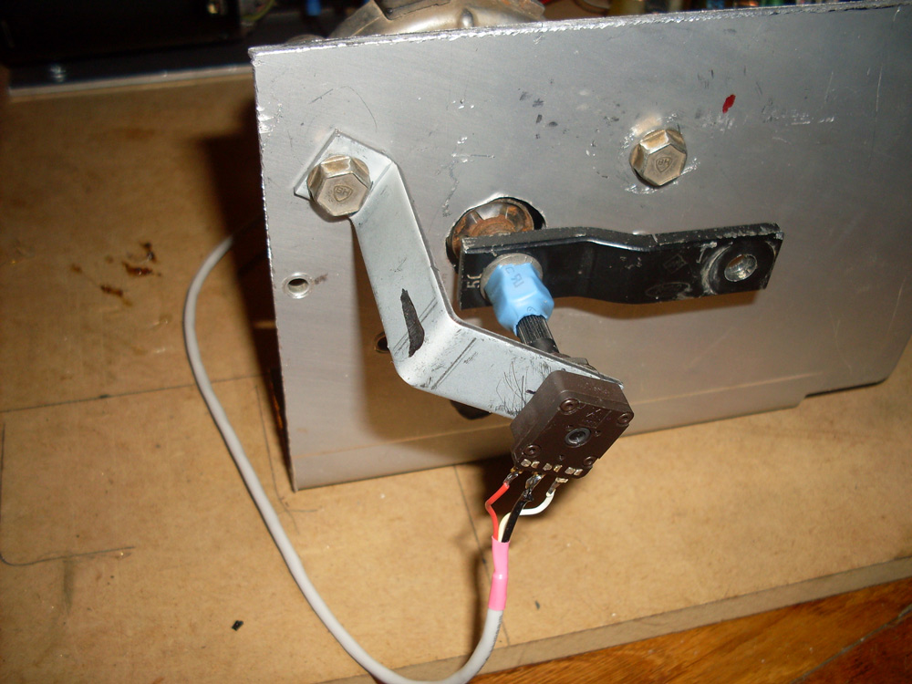

    I've found the way to connect the pots with motor shaft :)
    I think this setup will last, because previously I've used some hot glue to make a connection, and during first test, connection come loose, and motor shaft slammed into bracket holding the pot :(
    I've quickly jumped to turn off the power, and checked the mosfets touching the heat sinks.
    One of them got so warm, and I'v said to my self - this one is dead 100% :blush:
    Few days later, I've made proper connection, and did some tests, and everything is working OK :clap:
