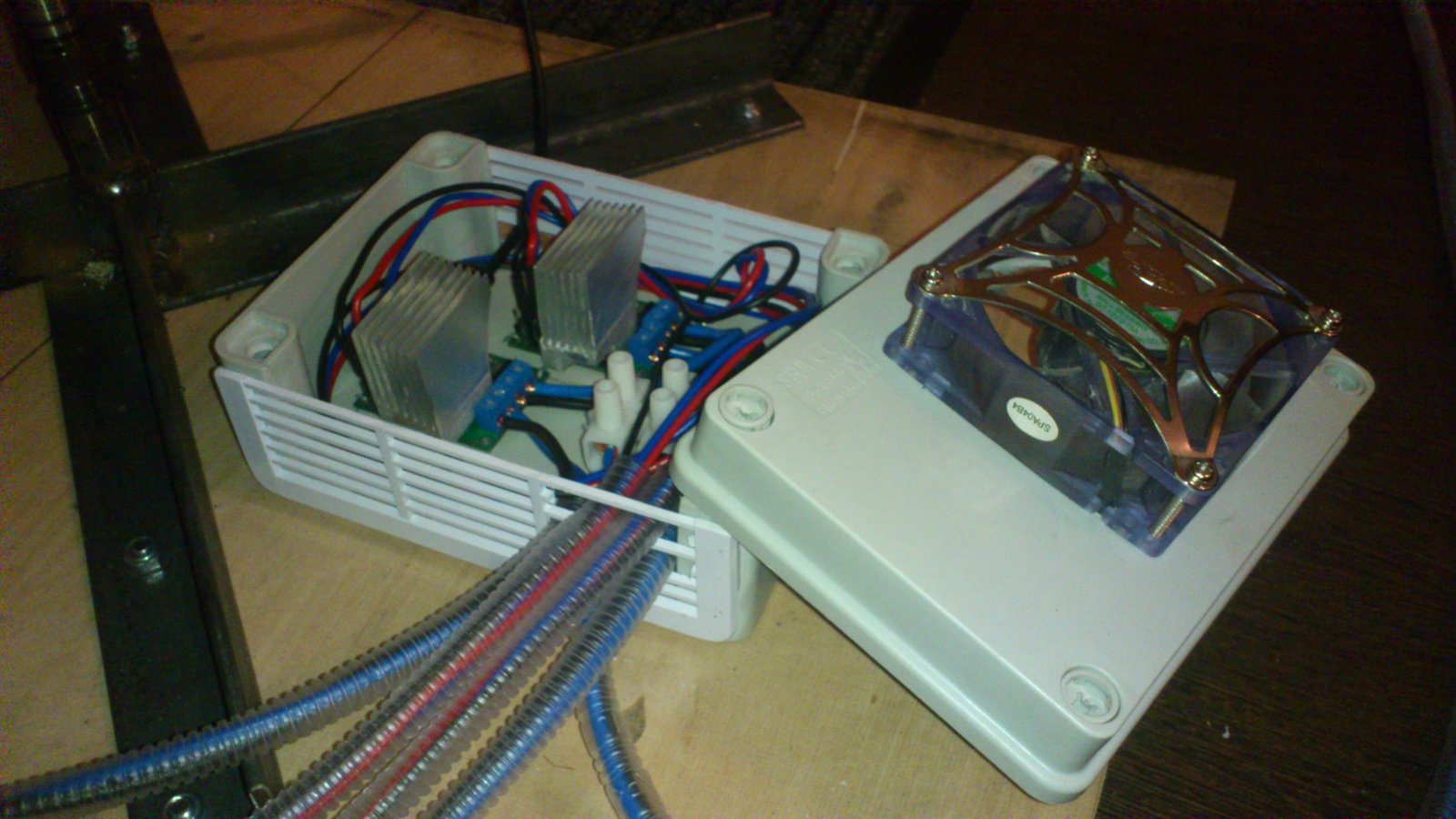

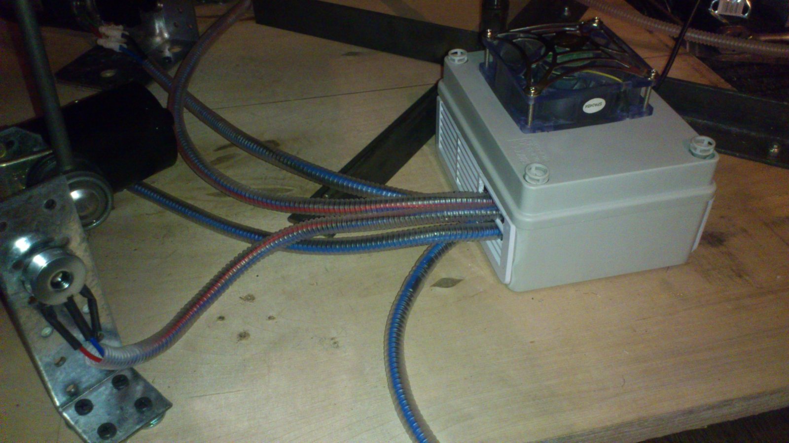

    Finished with electro box, using some electric connection box, cuted sides an added plastic grills, also fan on the top. For now fan is connected straight to the input, later will add switch for it(if needed). Also tidied all wires to sleeves:
  2. Historiker
    2,163
    9,211Coins
    +2,177 / 19 / -1
    Nice looking box, I like it!

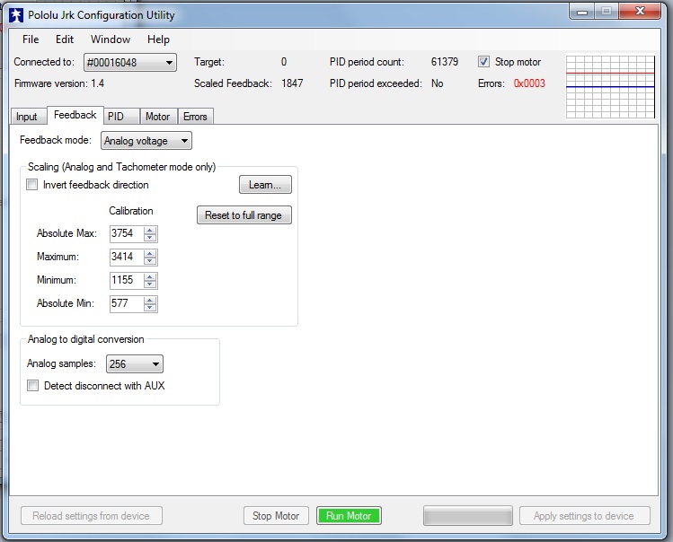

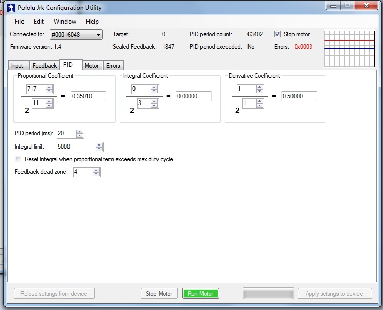

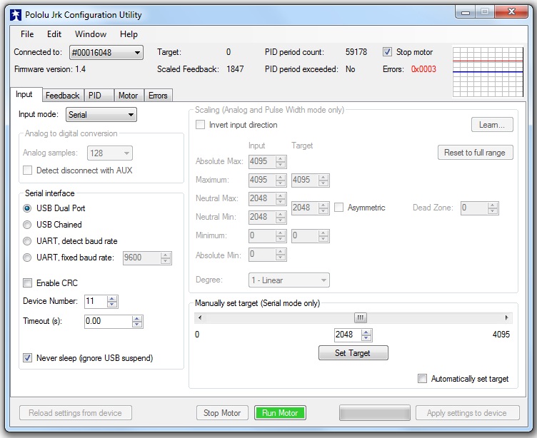

  4. bsft
    Please post pics of your jrk settings.
  5. kurgine
    kurgine Member
    Feb 24, 2014
    45
    510Coins
    +22 / 0 / -0
    2DOF, 3DOF, DC motor, JRK, 4DOF

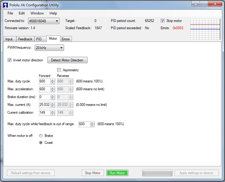

    Here they are:
  6. bsft
    that will work on wipers, maybe you need to look at your profiles for motion, something may not be right there.
    Best post them as well please

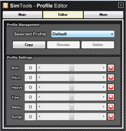

  7. kurgine
    kurgine Member
    Feb 24, 2014
    45
    510Coins
    +22 / 0 / -0

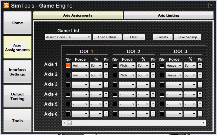

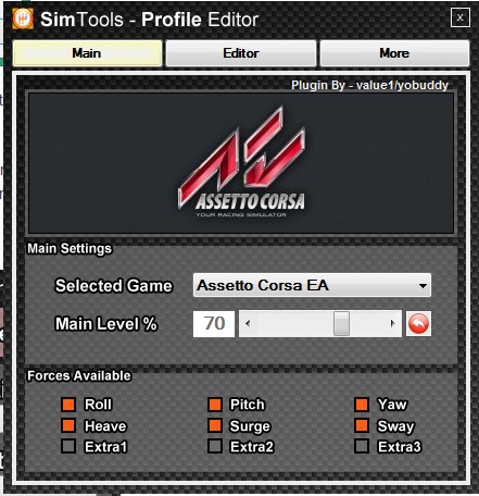

    Was trying to use different % on axis, 1 axis or 2 axis, all axis. Have 70% on main and in editor everything in 0, was trying MinMax tuning, it changed movement from big sways to smaller sharper. But it still half of the lap goes leaned to one or another side or moving where i go stright i mean i dont see those moves possible on the road :)
  8. kurgine
    kurgine Member
    Feb 24, 2014
    45
    510Coins
    +22 / 0 / -0
    Solved, loaded one of the presets and find out that have to invert one axis on the Surge :) Now it makes sense...

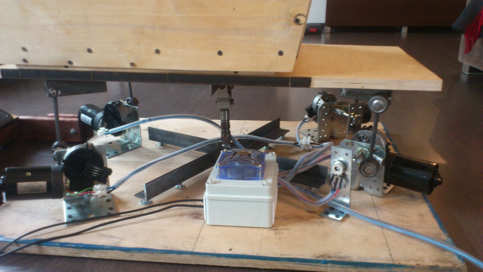

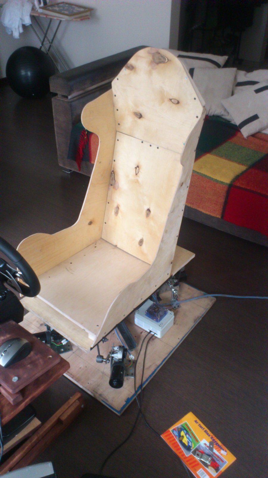

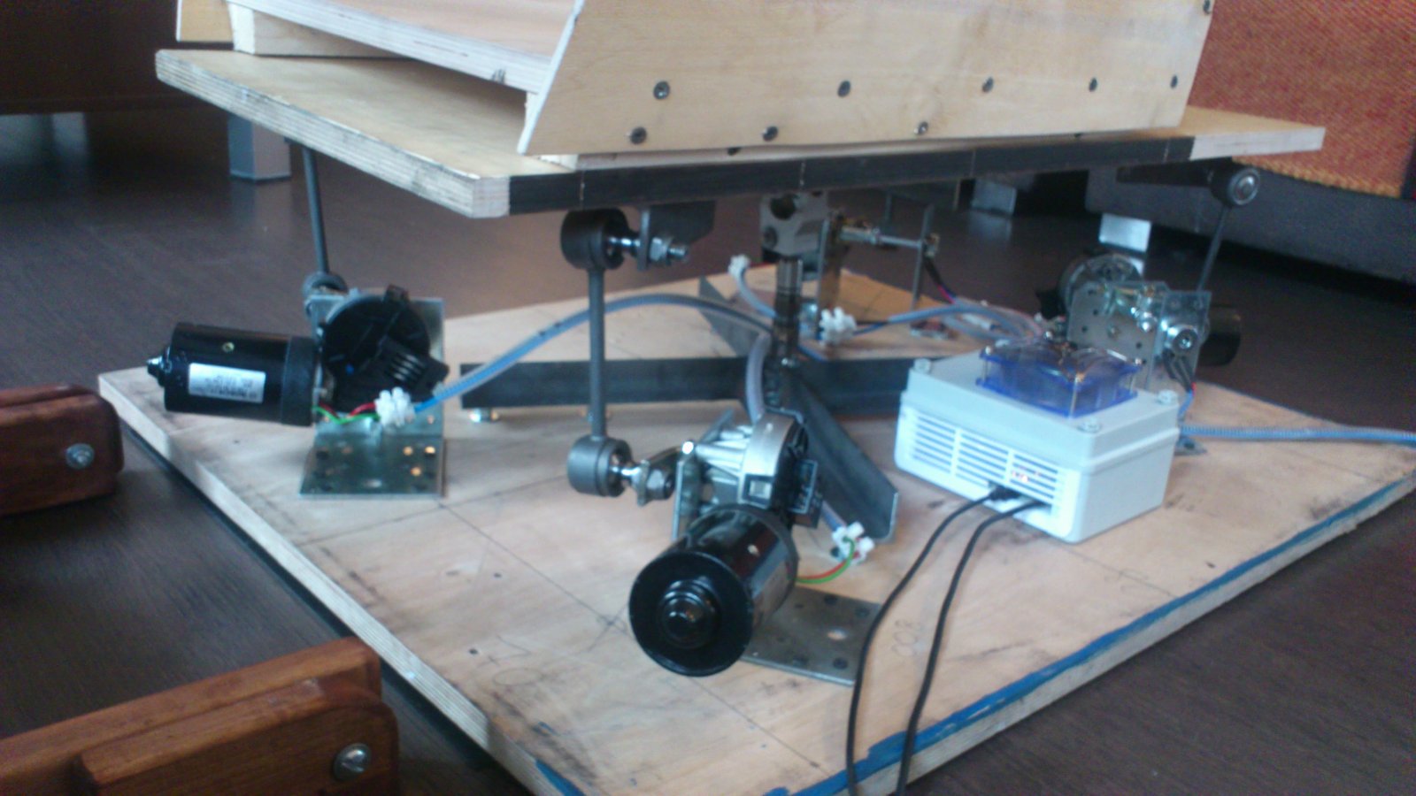

    Have update of my build and this time big one :)
    Finished my double motor setup, so:
    1 JRK + 1 Pot + 2 motors as onegroup on the output, it works.
    At the moment giving maximum that JRK can regulate which is 38A for group of two motors. It is strong, much stronger then it was with one motor. Even if i will not use unlimited amperage from JRK's and will run only on 38A it was realy worth to try. It broke shoulder bones on Asseto Corsa when go out of the track, with 100% in main and 10 to the effects(surge+sway 60% on axis), so had to do 70% in main to continue testing :). My seat is still plain plywood as had no time for upholstery and sometimes it really hurts:
    A lot of movement, which is fast, much faster then before, but still can feel a bit of lag, specially if compared with the wheel. Still have done nothing with profile, so hope it will be better after setup.
    Now can start to think how to put wheel and pedals on the platform, because finaly i believe that it will be able to move it all.
  11. bsft
    Nice job there, DERIY inspired a lot of people with his design.
    If you go full frame, you will need to move the pivot point forward to get the balance right and best move the motors further forward as well, to lessen the load on the wipers.
    Yes the JRKS can really kick when they are running right.
    Do you have a video in action yet?
    Cheers, David.

    The only benefit that it can be made cheapo, using same wipers motors and strong enough(i hope) to move full rig. Need nothing additional only +2 motors and have twice stronger movement. After i try when it was done with single motor it doesnt feel like it could move me with wheel and pedals. And i want full rig not only seatmover. So till ill get motors i want and i need for this setup that was cheap and simple solution. Now i can continue idea and build full rig which i will use later when will get Motiondynamic's. With seatmover i would need to make another temporal something which i would throw when motors will come.
    About balance, im going to make rig half lying position similar to RedBull Sim, just pedals will be lower in line of seats lowest point:
    And i am afraid that balance will differ depending on the height of driver. Dont want to raise seat up because of weight inertia.
  15. bsft
    In that case, shoulder mount motor at rear would be best.
  16. eaorobbie
    20,506Coins
    +1,687 / 23 / -2
    Ok some testing in the Jrk settings are needed, to reduce the lag and bring the speed of the motors finding position up to an acceptable speed.
    Now I would setup the configuration utility, jump on and start one motor and move it via the slider in the utility.
    In doing this look at the graph, best to double click it and only turn on the scaledback value and the target value, you need to modify the pid so that the two lines come to as close as each other, in a perfect world these values should be the same, but a 5-10% error is acceptable, with a few hours of fussing over it and new hall effect pots the error was reduced under 5%.
    Now the slider can be controlled via the keyboard too, page up and page down steps the movement, and home and end makes it go to the min and max.
    Now I test this and if the error is too high, I adjust my P value up and test again, and again , now its getting closer and faster but notice some spikes in the graph on the end movement, ok Increase D a little, ok smoother.
    Now I tend to push the P an if it seems to occilate , I know I have gone too far.
    The Pid you are using is a base to start from, and is for 180rpm motors not 30-50rpm motors which will require a stronger PID.
