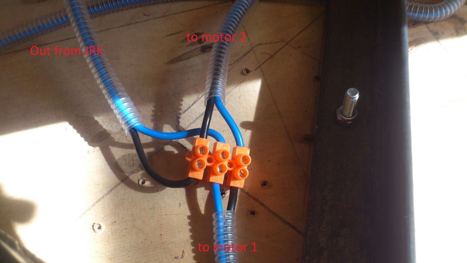

    I am afraid that wiper motors can drain more then 25A each, so when doubled it would be more then JRK can handle, and if i dont have such suply of power from PSU that should protect controllers.
  2. bsft
    it will not protect the controllers. What would happen is the power supplies will be overloaded and shut down, and the jrk would try to overload itself by trying to drain power thats not there and shut down.
    Its like running a too small power supply in a computer with a big graphics card, fine for net surfing, but as soon as you start a game, it tries to drain power it doesnt have and shuts down.
    As said, reducing power will not help. It only drains what it needs. If you have wipers pulling more than 25 amps each, thats fine, but as you have 2 motors per controller, you are pushing the jrk too hard. It will survive, but as soon as you put in big motion, it will keep shutting down or simply stop working until you reset it.

    I run a 600camp car battery on my set up with 2 jrks , no issue to report, both pull in the 45amp range in direction changes, but only running single motors on it. Best to use a power supply that has a proper filter in and out line as when most H Bridge , Jrk included they all produce back current down the power feed to charge RC type battery setups, ie when motor spins down under gravity and not via power, most intelligent controllers do this in order to lengthen the battery life, its why when std psu from computers are used, people report they get hot and sometimes shut down , its because of the charging current coming back down the line.
    This is why I have always recommended either a power supply with internal protection or placing a DC battery in parallel with a psu , others have found a way to include a resistor and diode into the power circuit, I like the dc battery cause if a jrk get hungrier than the amps my psu can perform at it will draw it from the battery vice a versa if the jrk pumps amps back to psu it is captured in the battery and the psu stays nice and cool. Protection.
    As for running two off one still not sure that's a good idea, wiper drawing more than 15amps be surprised maybe only if the lever was locked and it was about to burn out they normally run in the 5-8amp range so expect double that on stall current.

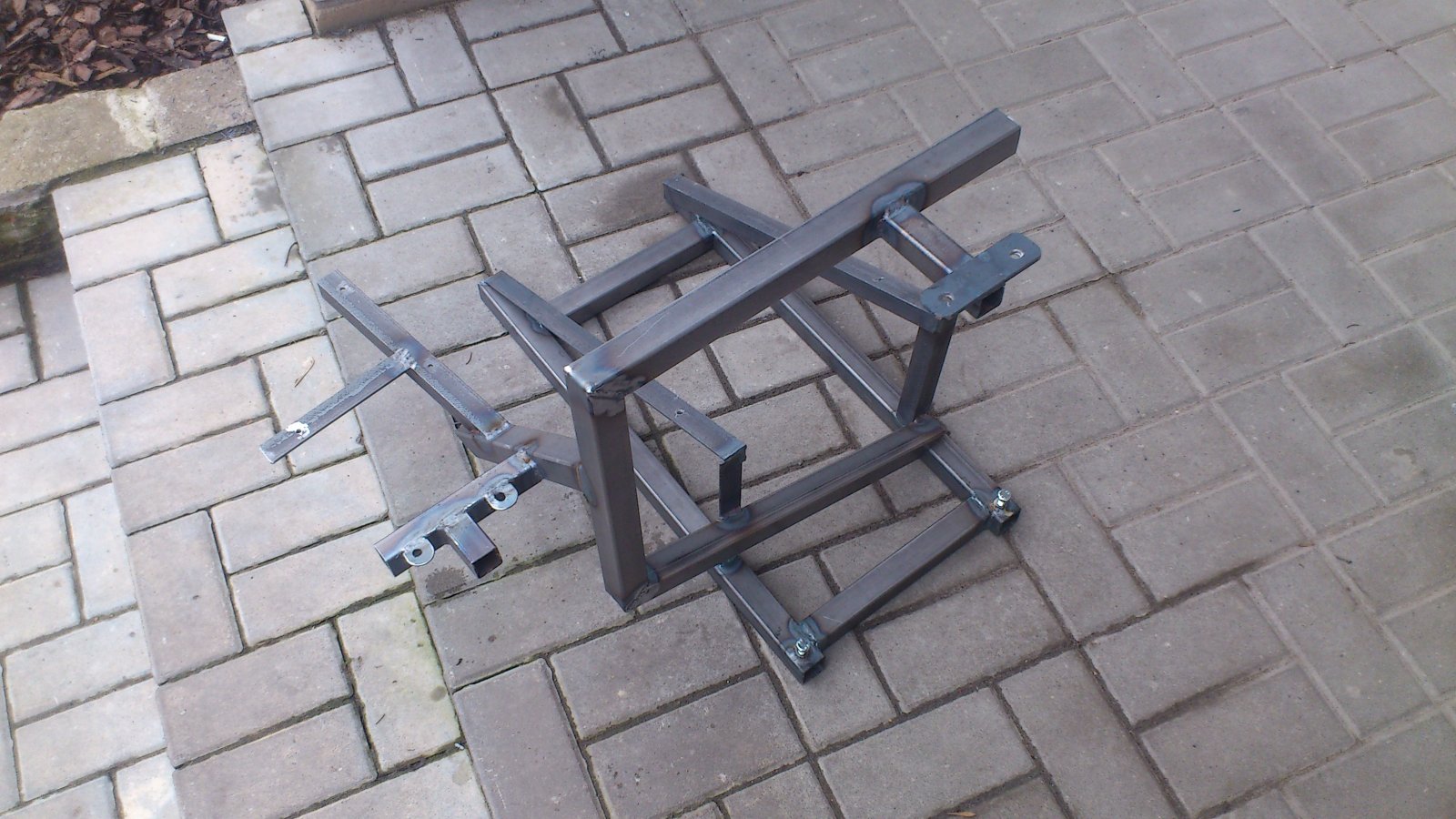

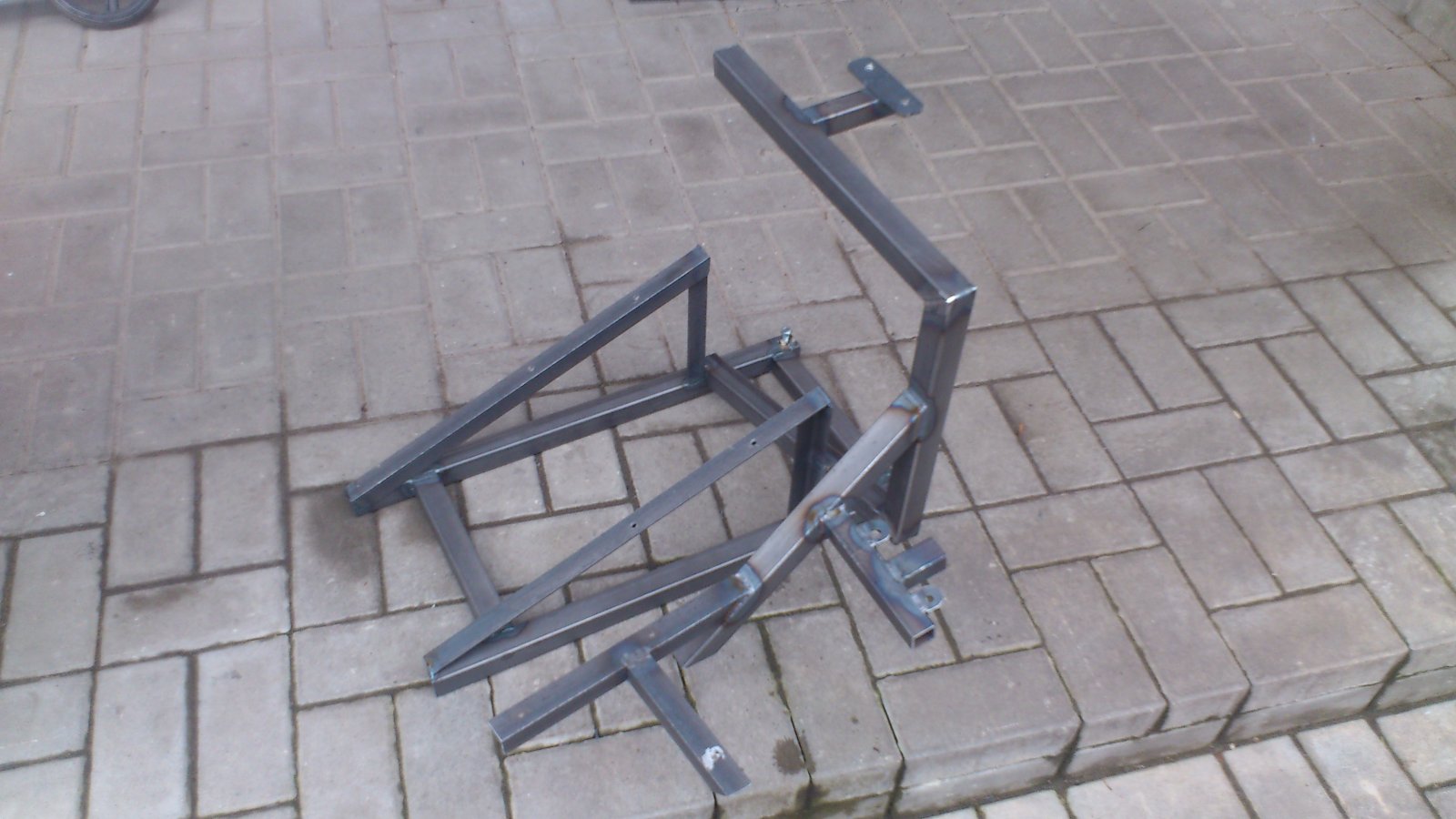

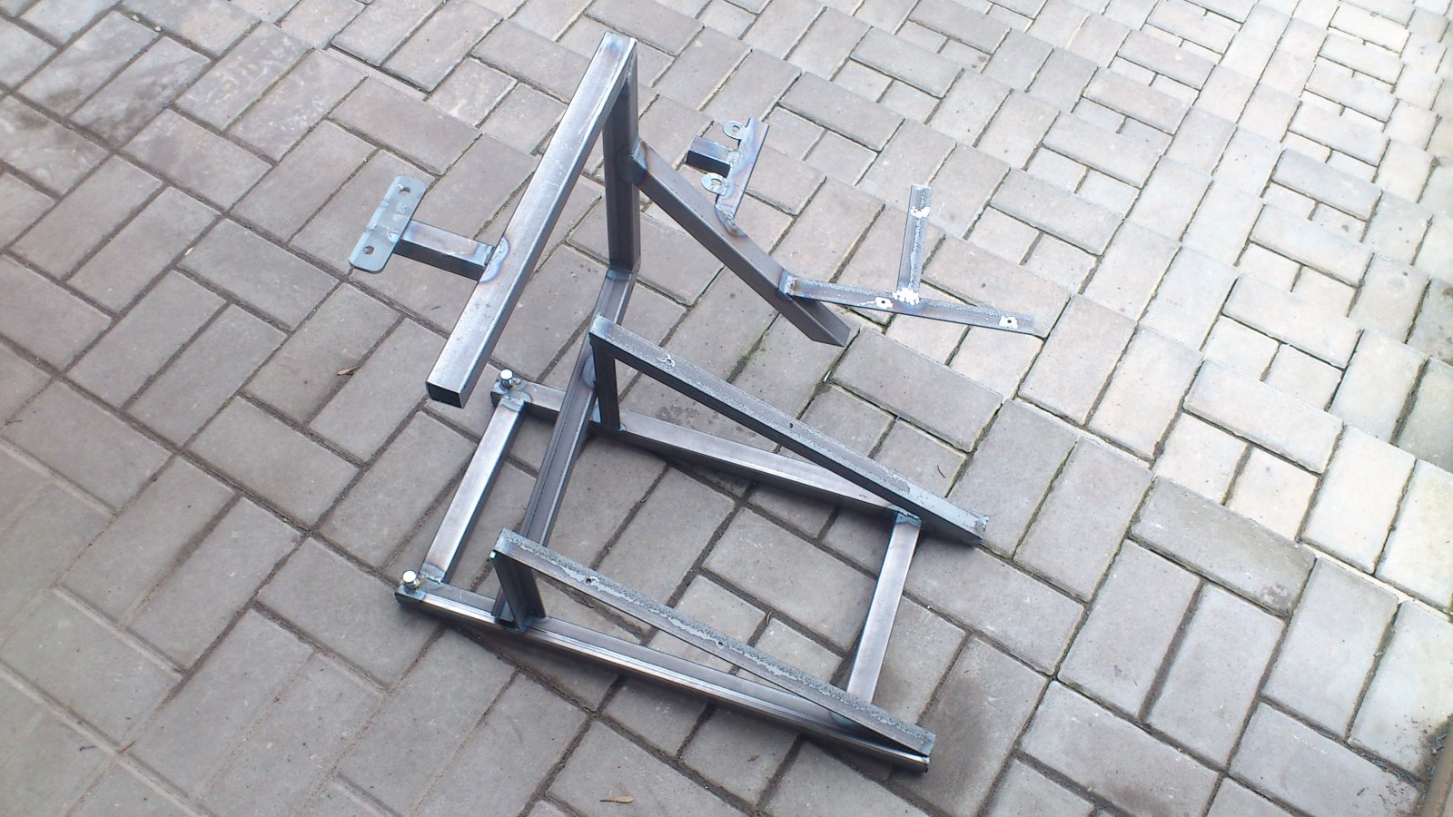

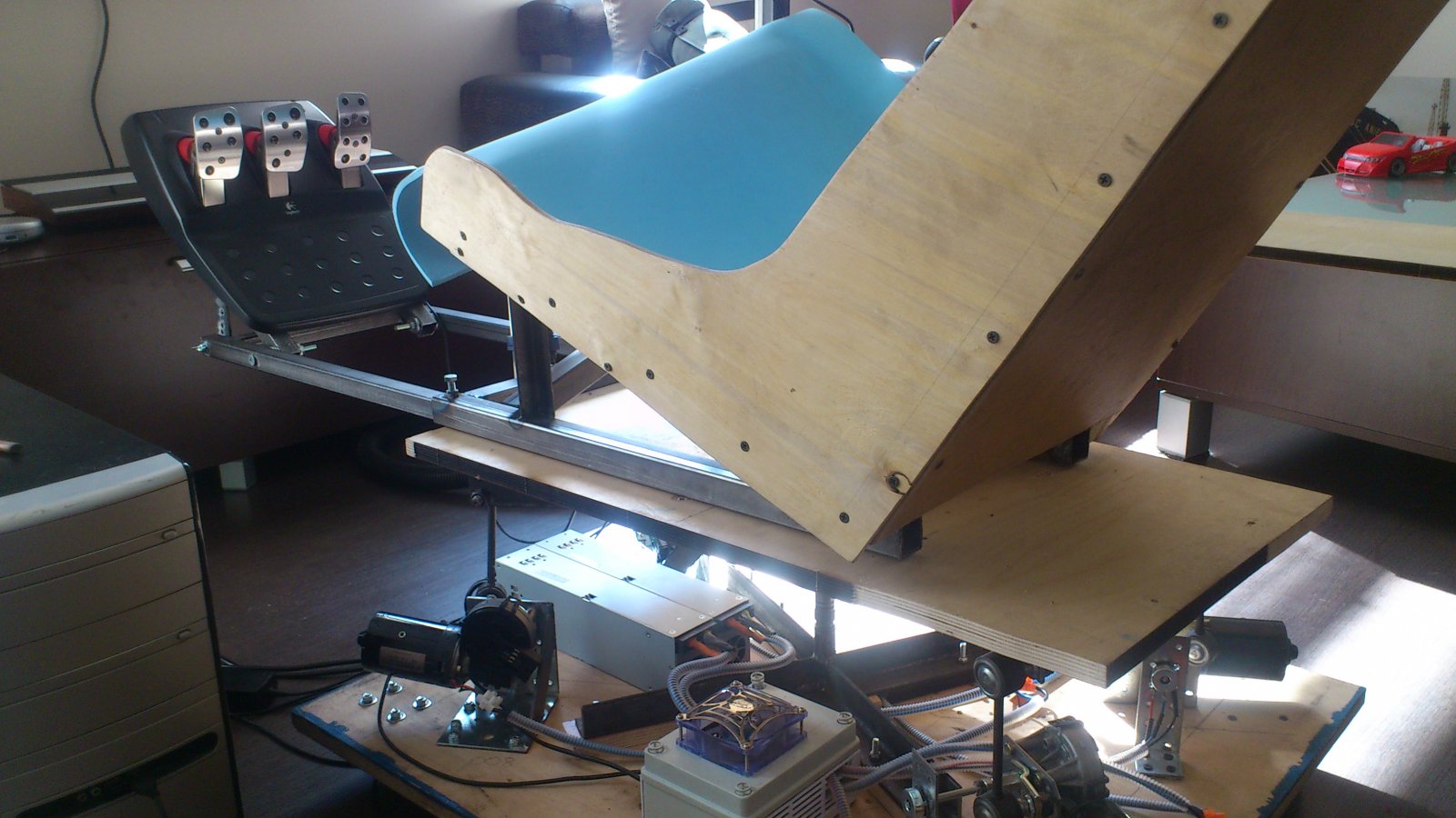

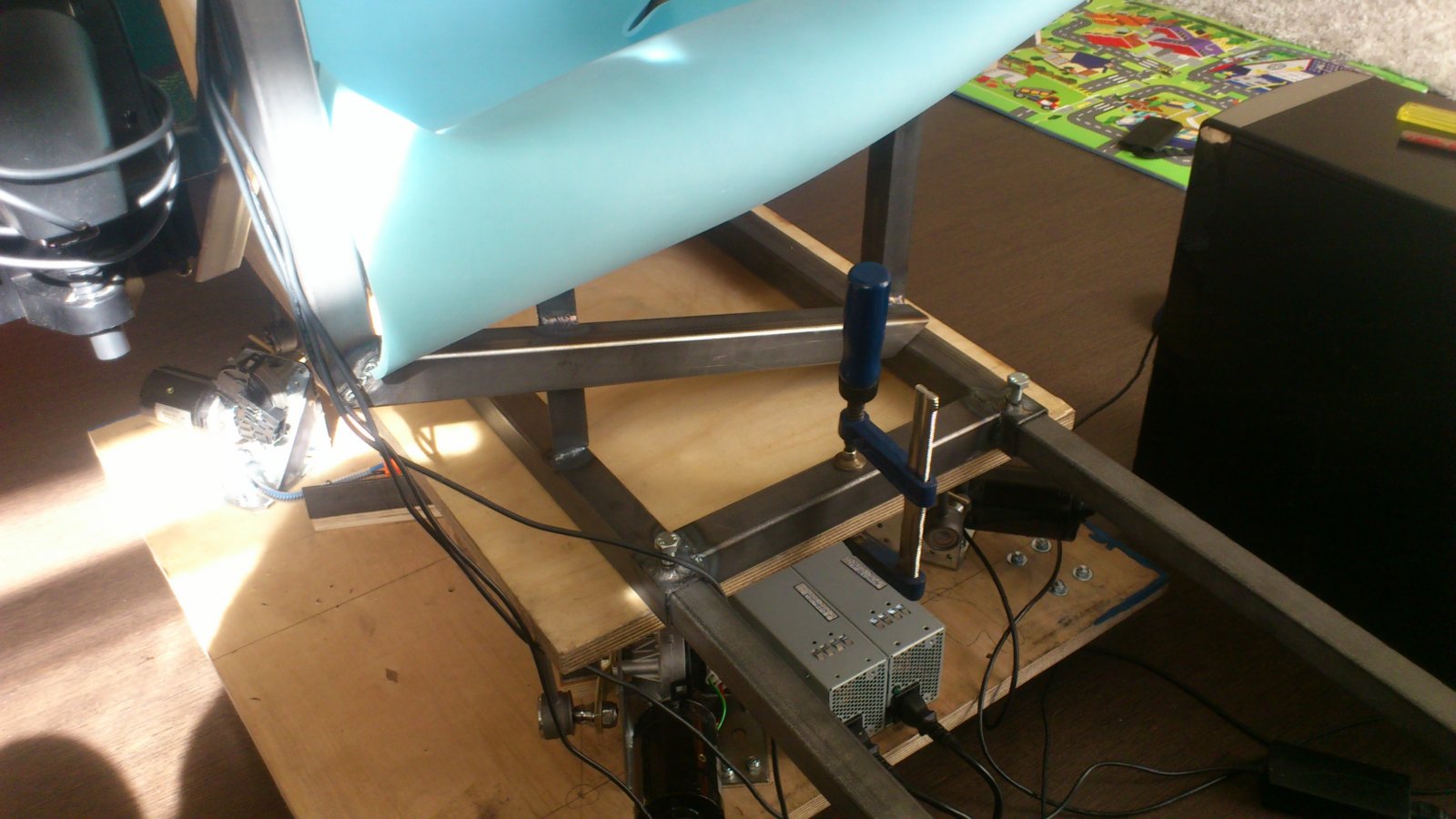

    Almost finished with my rig, have some updates. It was all cool until i put metal rig construction on top of platform and troubles started. From the start it was running ok and after 2-3 minutes of continue working motors start to jitters and jerk. Just a bit and then more and more and in few next minutes it was impossible to use rig as it only was jittering and jerking with very slow motion. I find 2500-5000 errors "motor controler" in JRK utility after 2-3 mins of work.
    At first i thought that problem was because i did not done ground insulation on the motors and my motors work with opposite polarization, so when changing polarization in one group of two motors it somehow gives errors. I disassembled everything cut contacts inside CEP motors board and after punting all together had same issue. Then changed placement of the front motors so all motors was running with same polarization, same issue. Then i decided that this is because of the load, again disconected everything so motors could spin freely, it worked much longer but after 4-5 minutes again jittering and jerking start to show up. It was ok with one motor but if 2 conected to one output had errors in the controller. Description of error on the polulu site gave no sugestion or initialization of the problem. After some time spent in the robotic forums i decided to change connection of the motors from parallel which i had to serial. Motorai Serial.jpg Solved. Finally it runs like one big motor with double winding. Run it 3 evenings without "motor controller" errors.
    Also spend a lot of time with PID setup, but find nothing better then "default" wiper setup 2/2 0/3 1/1, it is a bit laggy but anything stronger or more precise makes movement jittery and unpleasant.
    Another thing i find out. All the time from the begging i was trying setups with "Assetto Corsa" It was very dificult ansd have still unfinished with my profile(it is done best i can do, but not as i really like) because limits are so small and cant make precise movement. When i start to work with "Race Room Experience" it was like day and night, just from the beggining without any adjustion movement was smooth and deep. Have only these two games yet but wonder if all games have so different telemetric data? Also is it possible to enter decimal numbers in the "Engine Tuning Center"? Like i need to put 1.5 it allows me to do so bet when i press "save" it fixes it to 15.
    Now some pics:
    Metal construction of of the rig:

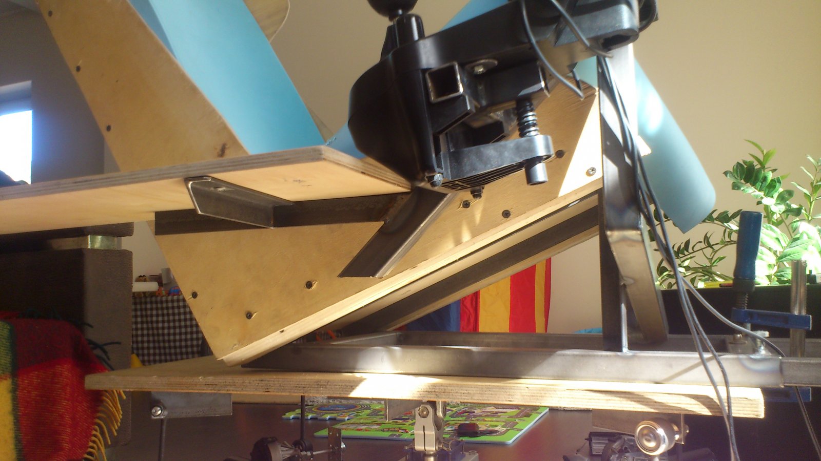

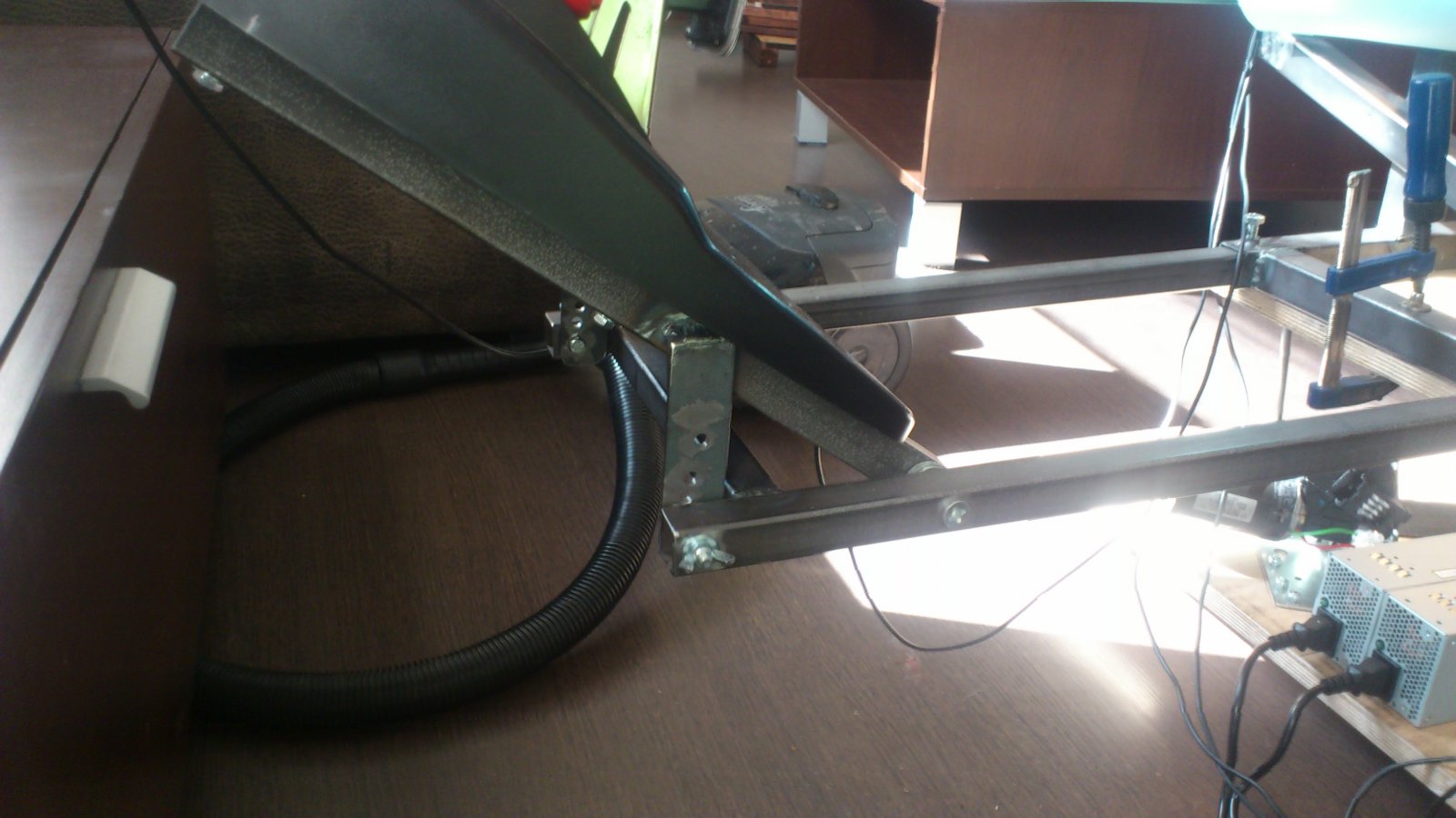

    Pedal adjustment:
    Made rig possible to use for person which is much longer then 192cm which is my height and shorter then 130cm which is height of my 2.5 year son( just need big pillow on the seat as per high of the wheel), also when need to store it, extra length of the tubes can go trough at the end, so rig can be very compact.. Length adjustment:

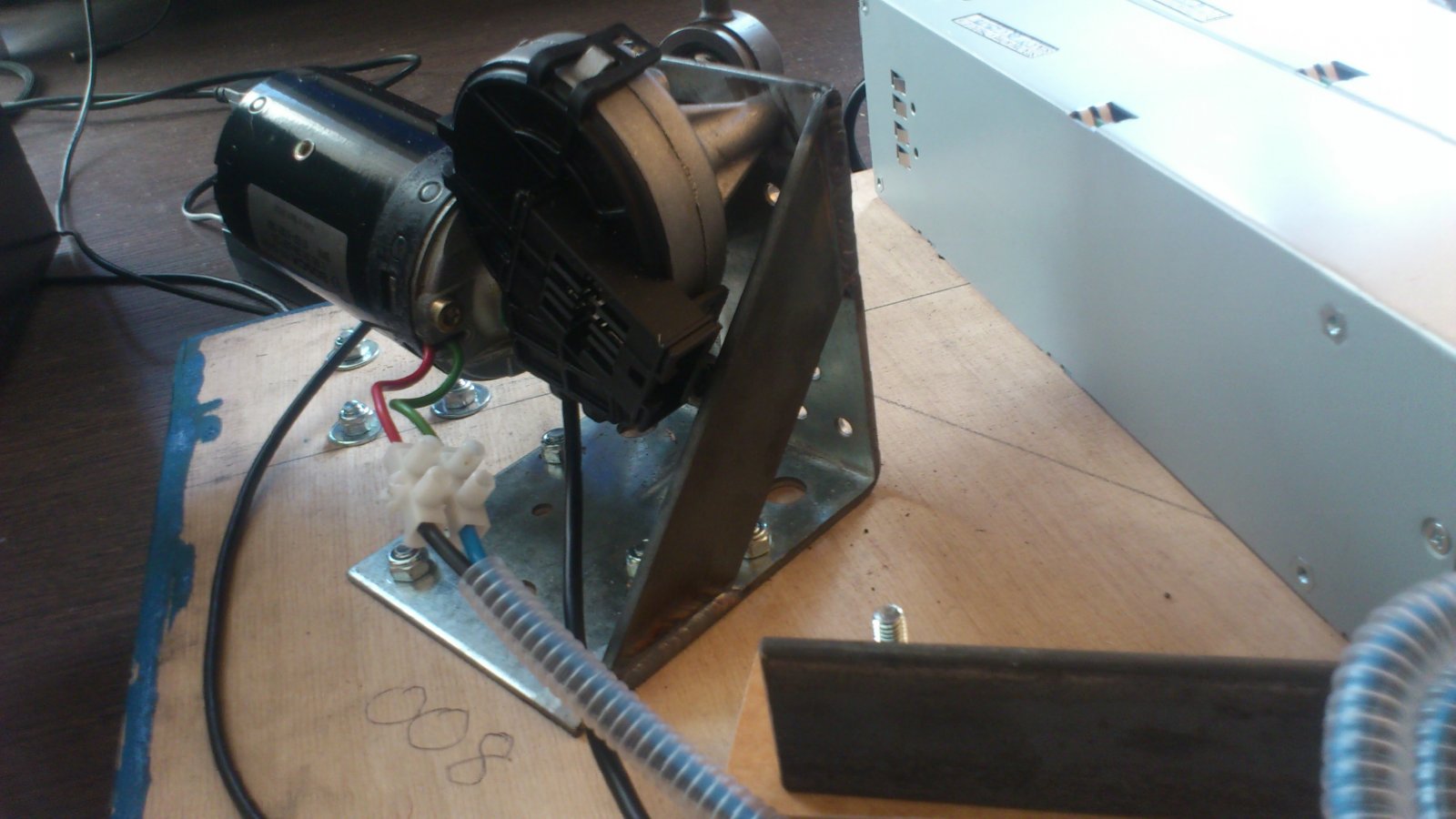

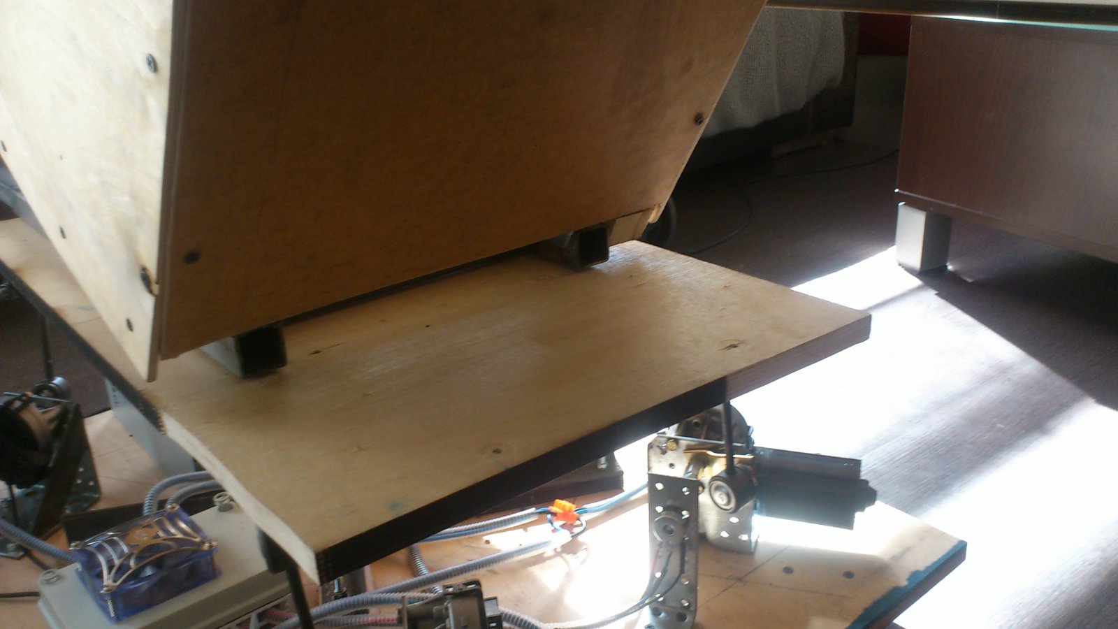

    Had to make reinforcement for the motor brackets, had issue with my pot connections when motors start to sway on bigger movements:

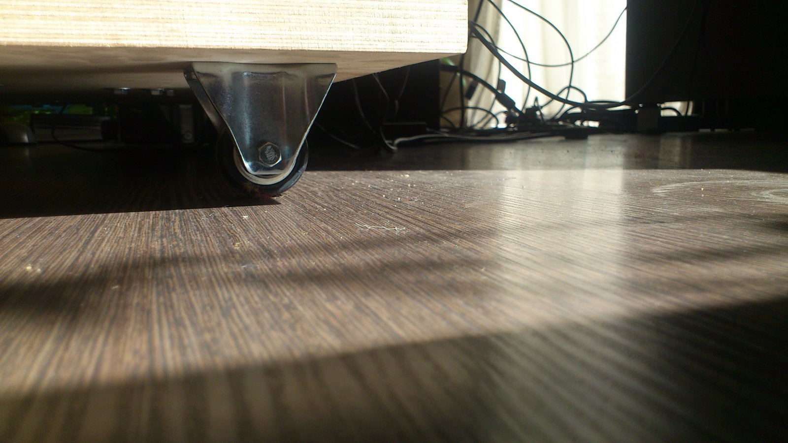

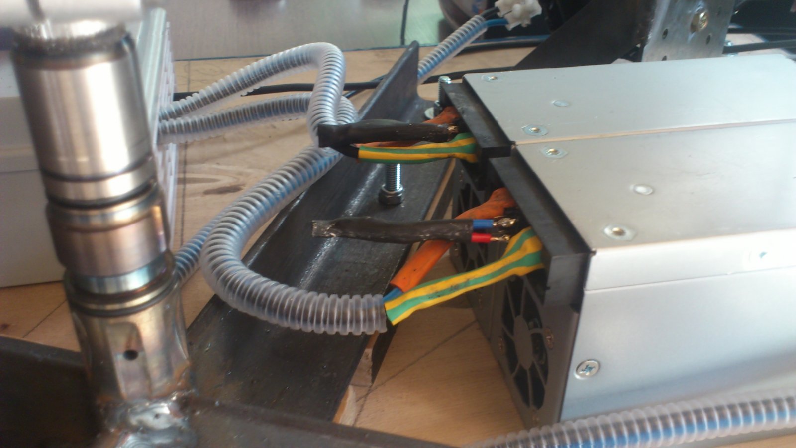

    Finished DCM600 conversion connected pins 4,6,8,10 together, so have working PSU with quiet fan. Running JRK on 0.00 amperage which is unlimited without any isues. Only few times i heard that PSU fans start to work harder, all thsese times i have been leaned over seat to look at the bottom. It is nice that When it overloads i can hear how PSU motors starts to spin LOUD :)

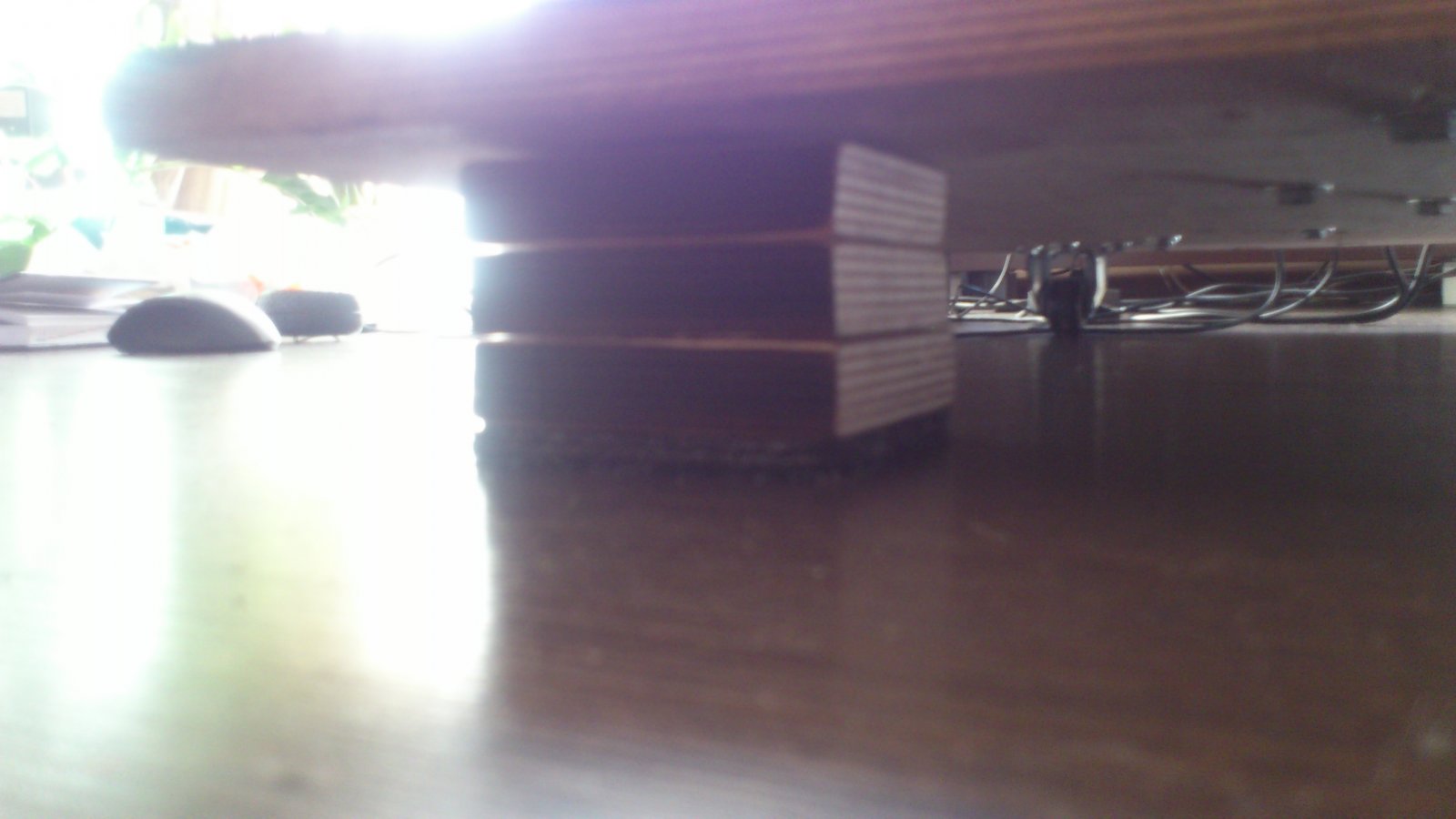

    Also made whole setup easealy movable with 2 wheels in the front and 2 square blogs at the end, it rised whole setup by 6 cm but i can move it in the room without much troubles.

    Well done its alive, had my doubts a single Jrk will run 2x dc motors, very well done a new concept working.:thumbs

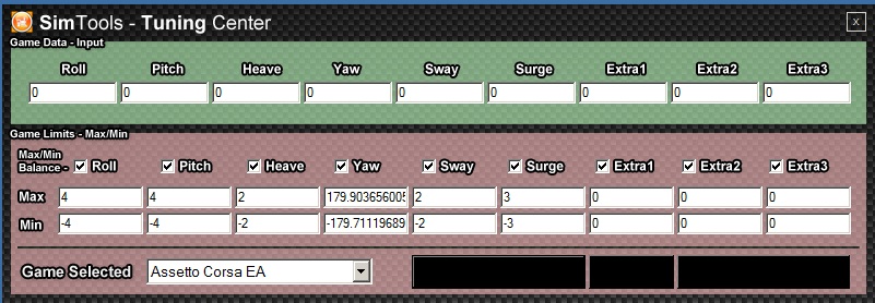

    I have 4.xxxxxx of Surge in tuning center min/max after capture. And cant really feel it works. It is still too low if i lower to 3/-3, but it is too much if i do 2/-2. Cant make it 2.5 or 2.75 as when i try it, it allows me, but after i press save it saves fixed number without dot like it makes 25 or 27 from 2.5 or 2.7. Also i noticed that center uses comma and i cant press coma just dot.
    Another thing i dont see lower buttons in tuning center, i see buttons but they are black, i know meaning of them only because i saw it in documentation description, cant see what is written there. Not sure if that is my pc or something wrong with the soft.
    Still learning which number does what in all 3 programs, would be nice somewhere to see logic, which does what and sequence.
    Not sure what is difference if i lower numbers in axis assigment or in manager editor. And how to limit single DOF, lets say i want Sway to move in less amplitude, if i lower assigment or editor it becomes also slower and less powerfull, but i like force just not so much in movement to the sides. If i put axis limiting im loosing in Surge too. Filters like boundary will simply cut force at the top if i understood it correct.

    Thats weird, I can type 2.3 exactly in both boxes in tuning centre , then i press enter, then I save and it saves them as is, it doenst change them.
    Perhaps post a pic to show us.
    Boundary is a good filter, you get full motion to the point where it settles those extremes. I use it to help stop overshoot on my frame.
    Personal opinion in setting motion, have a play around and test results.

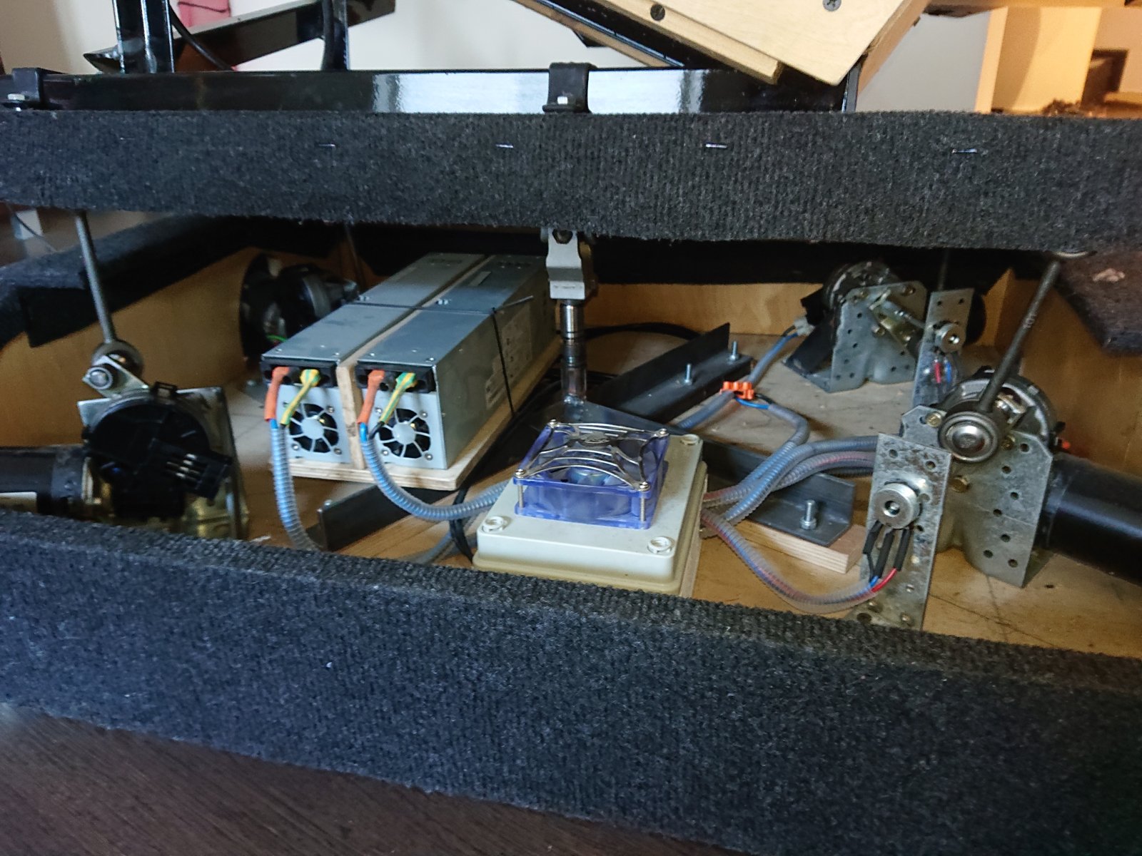

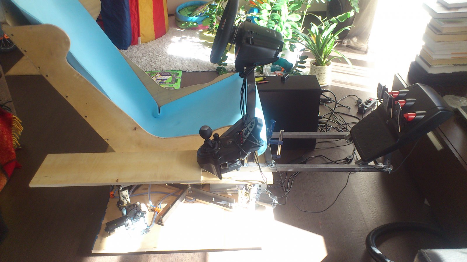

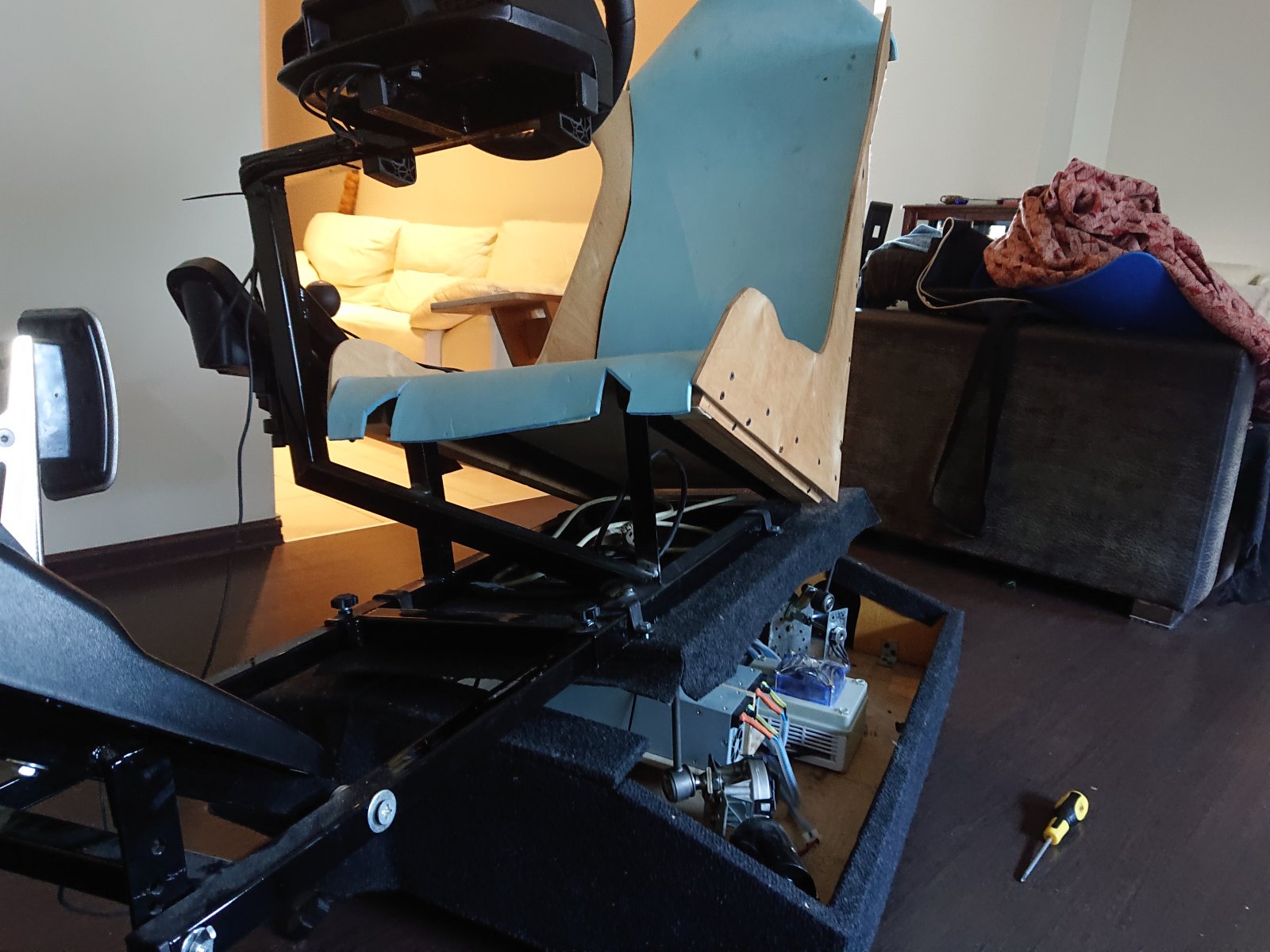

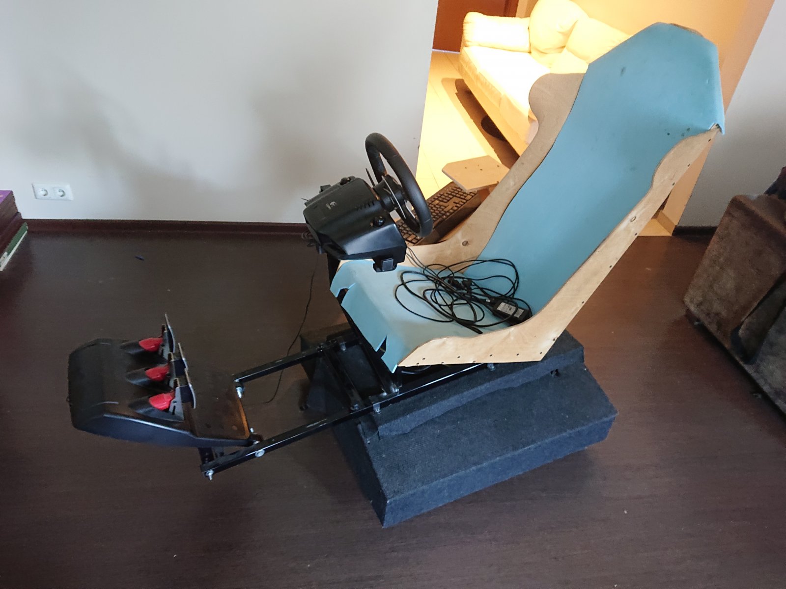

    Hello to everyone. Was absent for some time. Had my rig sitting in the corner for some time. It is actualy finished, was working great and shaking strong. However my new borns were freaking out from noise and action so had to put this project aside for some time. Now decided to renew it. All hardware is as it was left so i strongly believe it must be ok. Only what is missing is software and knowledge how to set it up. Five years past, i am looking now at all this dont even know where to start. Need to gather files for JRK's wake them up and Simtools of course. Do not remember a thing about it :)
    To refresh some information:
    My final rig runs on 4 wiper motors cross connected to help each other as 2 motor wiper variant. JRK controlers with server PSU for each. It all sits on centered column joint. Self made seat. Adjustable legs. And still same old Logitech 27.
    Adding some pics of how it looks right now.
