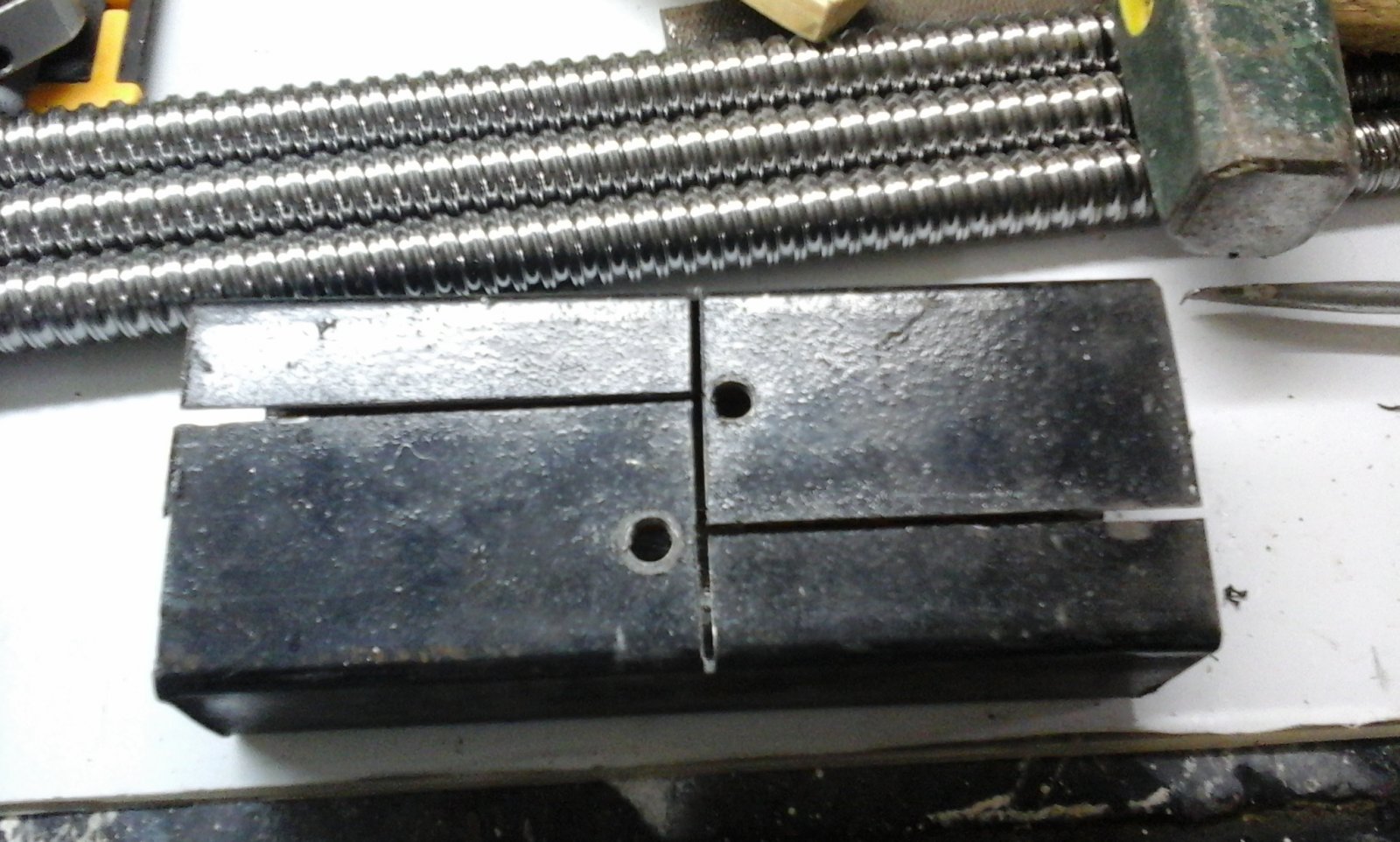

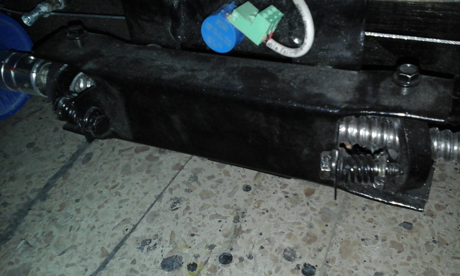

    I've finished preparing the mounting for the screwball nut all three of them ... just modified the old ones .
    from this ...
    like so ...
    into this ... see how easy to move the entire cockpit back and forth "Dusty weather so squeaks will be lubricated " .
    Next ... to the lathe for end machining the screwball shafts bearing and motor coupling ... " I bought them by length - Not machined "
    the center shaft is 118cm ... the front and rear shafts are 91cm . "Custom + cheaper":D .

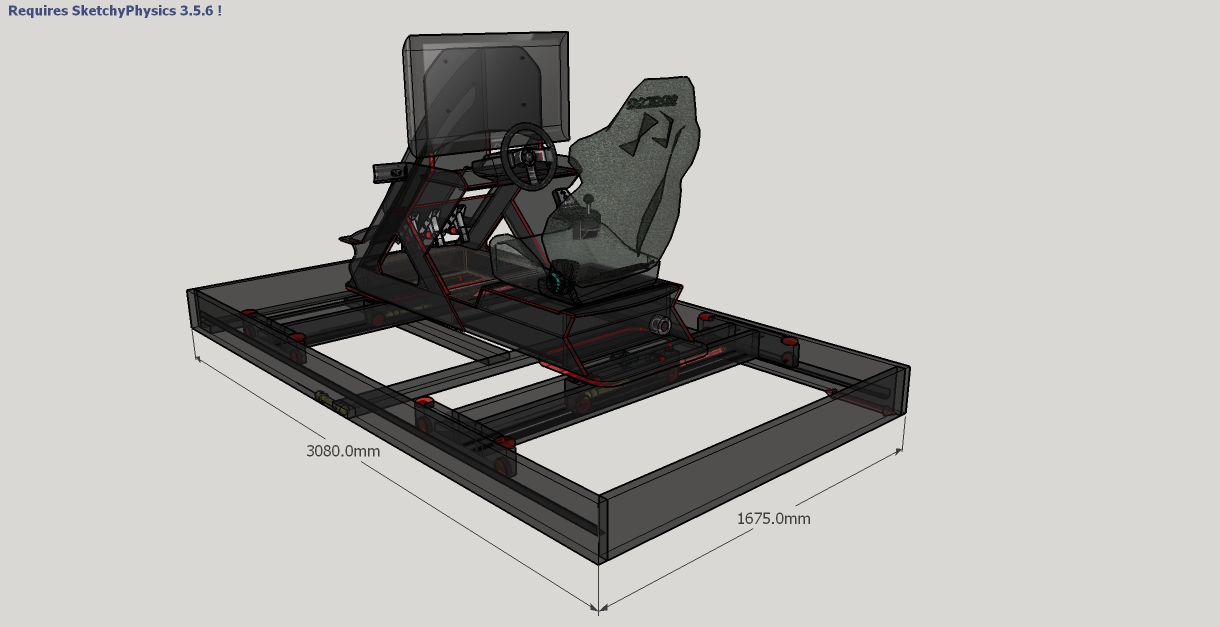

    Actually you'll find it was bigger in dimensions in the original skp file ... the base was 3 m. by 1.76 m. :)
    @cthiggin ... yes Surge/Sway/Traction loss like this one ...

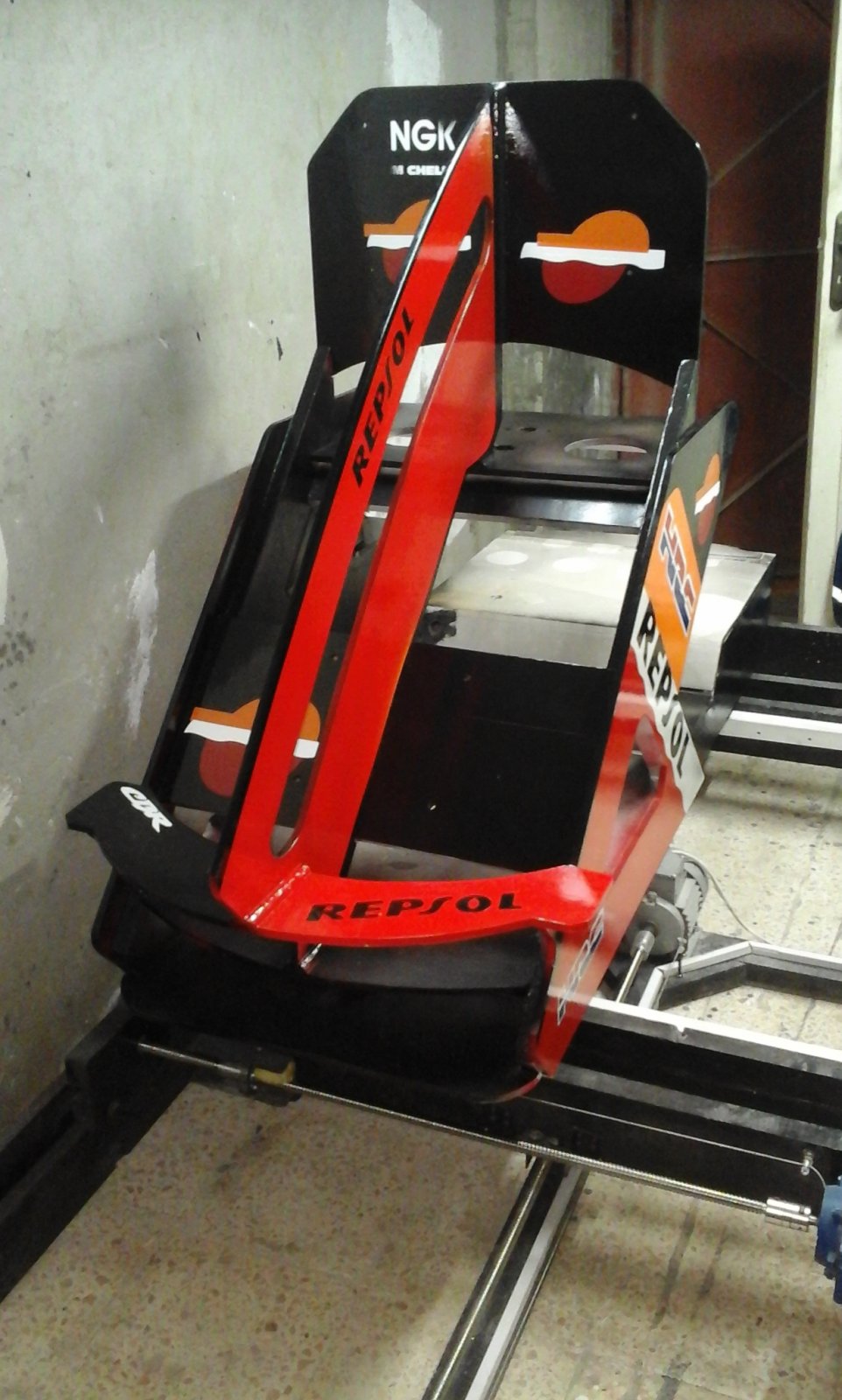

    Painted and the ball screw shaft installed ... waiting for the SimTools sticker and some printed vinyl logos ;) .

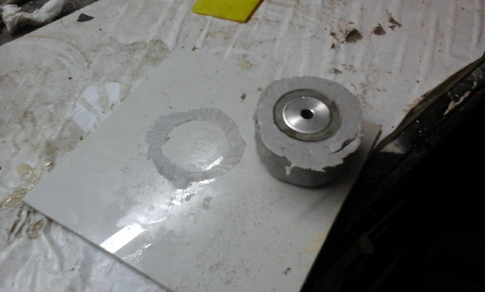

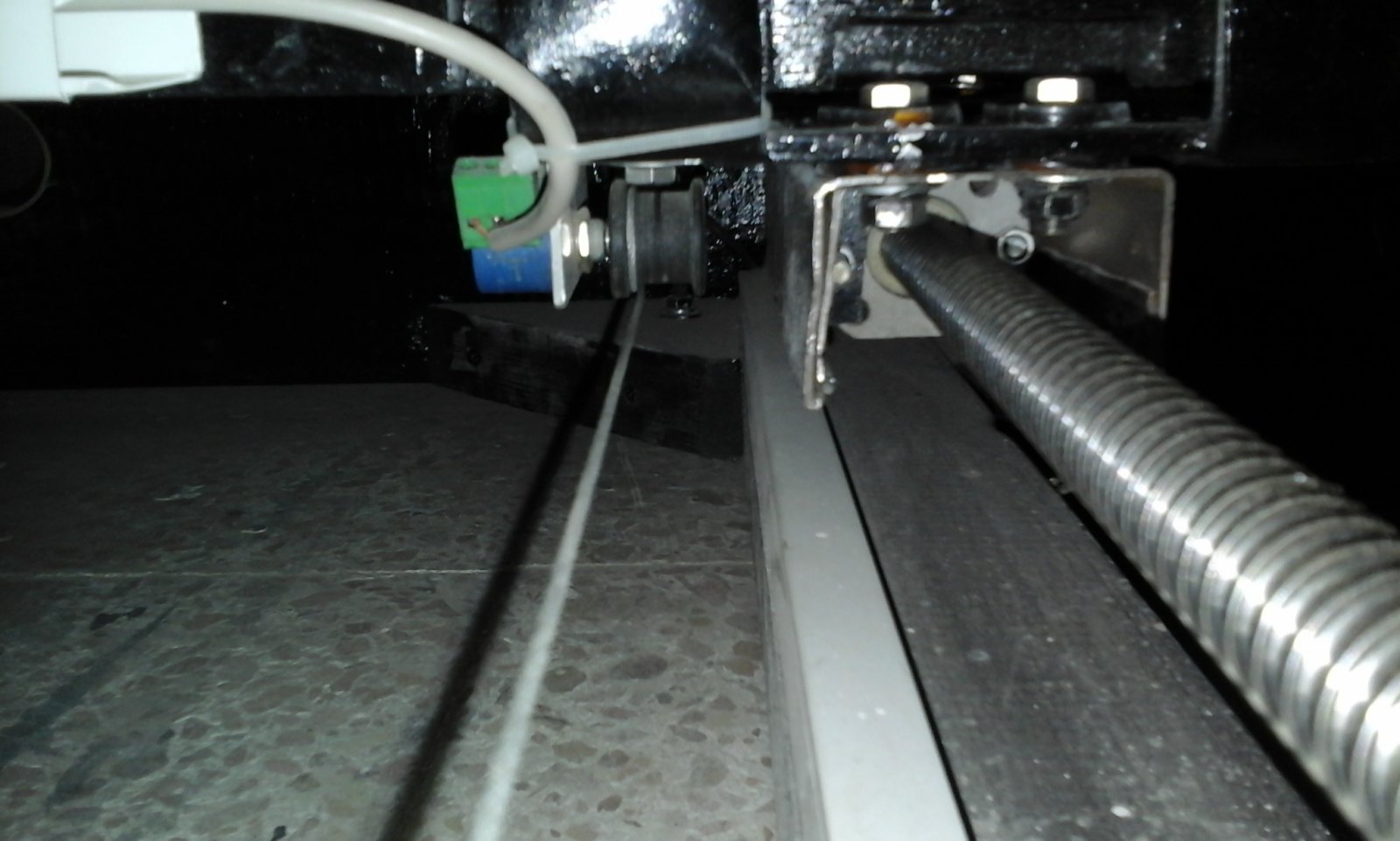

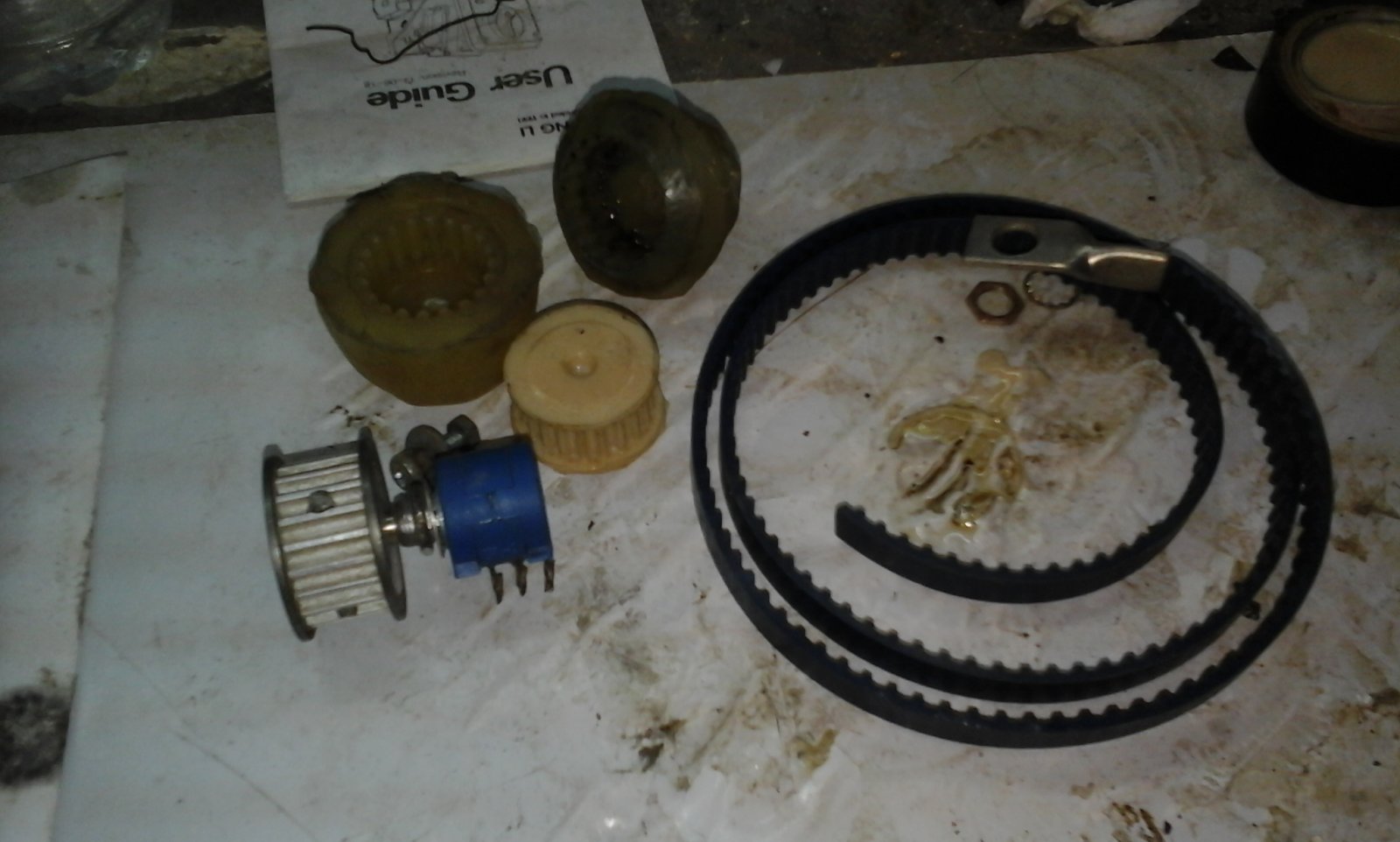

    I have a problem with this wire and roller feedback setup ... it is sometimes loses its position and causes the platform to crash to the frame front end ...
    So, I've decided to change it to a timing belt and a pulley ... wait for the cloning steps of the pulley :thumbs .
    Edit: the white silicon mold in the picture is an old shrinked one and gave me a smaller pulley that the belt is not compatible with .

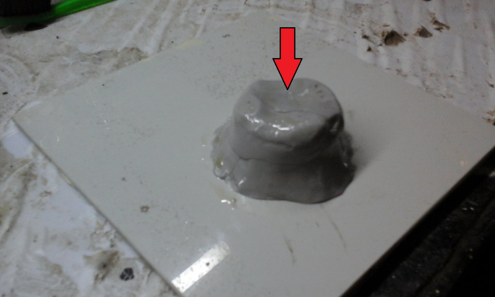

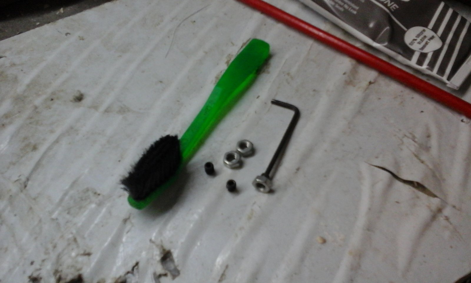

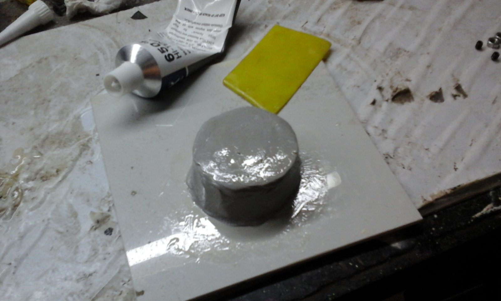

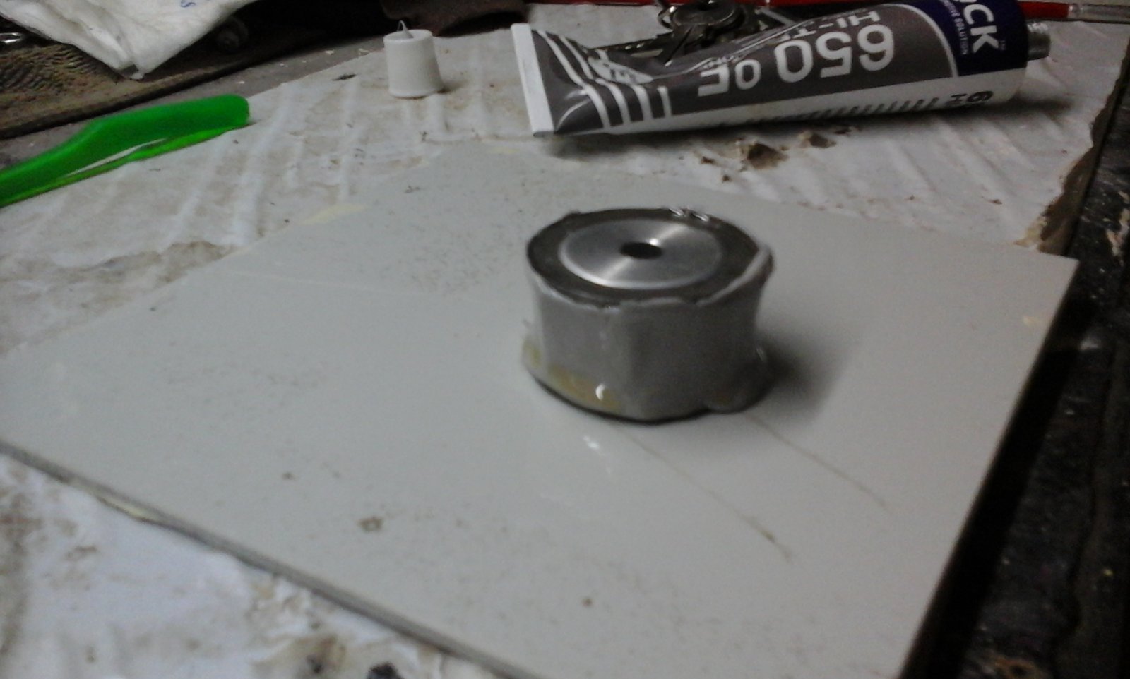

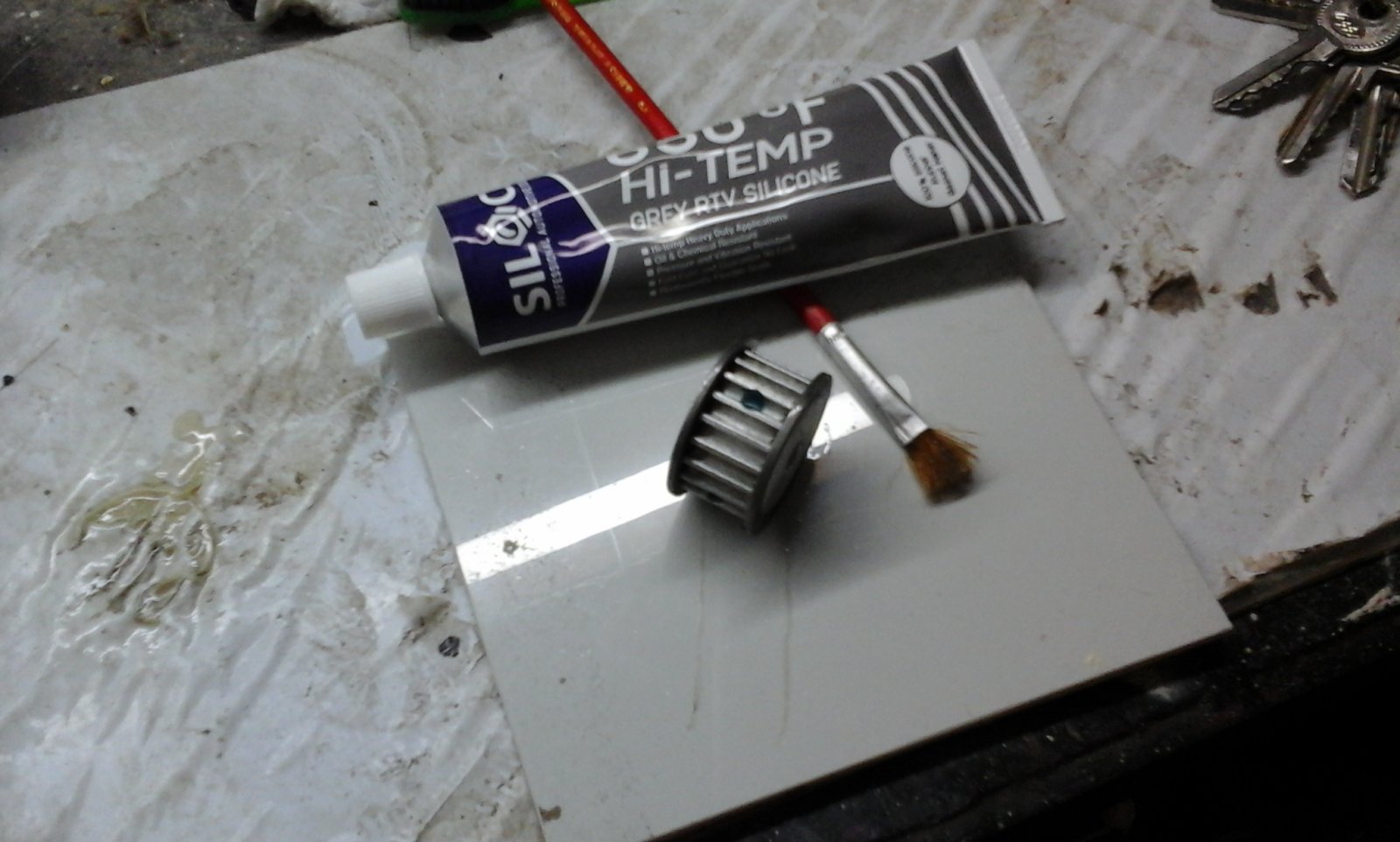

    For cloning the aluminium pulley which I need three of it ASAP ... I decided to make a mold for it to cast it with polyester + baby powder as a stiffing filler ... I know this trick will work as I've done this procedure hundreds of times long ago cloning broken printers parts and gears ... gust using the appropriate material for casting the final part that makes the difference ... So, let's start .
    1- I blocked the unneeded extra hole with a clay and lubricated the pulley teeth with a mineral oil like used in car motors .
    2- forced a good amount of silicon with my oiled fingers through the teeth and the main hole all the way deep to pop into the center ... that is to give me the interior negative shape output ... which will give me after cating hole where you put your eline key to fasten the pulley to the pot axis " a nut will be built-in and used here too" ... more details for this point on the casting post .
    3- Oiled the plan sides of the pulley and the plastic base and pushed the silicone a little down "Red Arrow" through the pulley center big hole to make a center drilling bit guide for future drilling the pot axle path with a 6mm drill bit .
    4- continued layering silicone with my oiled fingers and a plastic peace until a top leveled surface is achieved ... leave it to cure about 24 hours .
    5- prepared the nuts and the fastening screws for casting ...
    See you in the casting post ... :p

    In building my actuators I tried lots of different methods for feedback, ended up also going for a timing belt and pulley setup - has worked perfectly for about 6 months now.

    Sorry guys : An honest mistake has been made ... that is due to the rush for putting all the steps in one post ... I didn't leave the silicone first layer to cure first thin give it the other layer ...
    so till now the internal layer still didn't hardened enough ...
    see you soon ...
