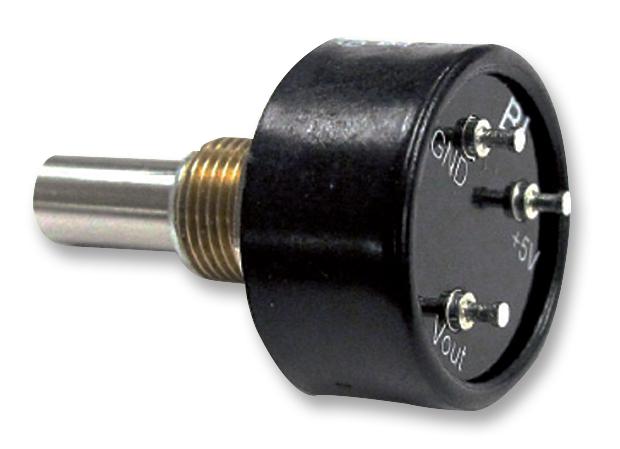

    Why not direct mount the Hall sensor rather than use gears? It is simpler and the Hall sensors are accurate enough.

    I had to use more than one turn on the timing pulley and hall effect sensors are just 360 deg. max.
    22,185
    154,750Coins
    +11,196 / 57 / -2
    How many degrees does it currently rotate? Is it possible to get it back to 360 by using a bigger idler pulley, with a direct mounted Hall sensor, would it physically fit the design? Just spit balling simple ideas, as gears would work just fine.

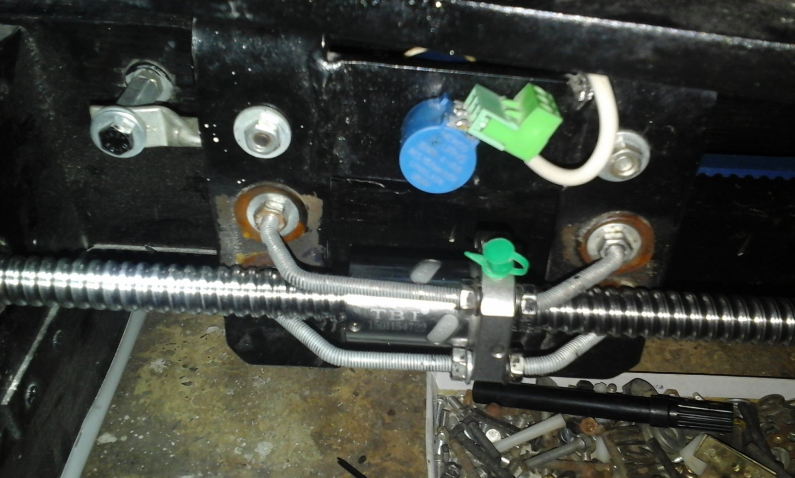

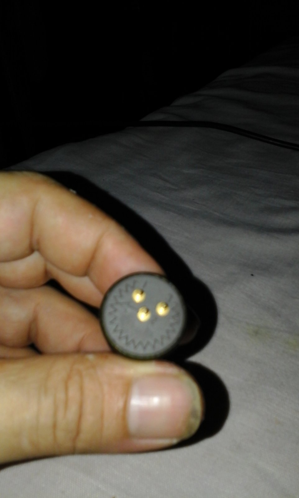

    @noorbeast ... allow me to elaborate more ... all 3 axis now have a big travelling distance about 90cm or so which occupy about 8-9 turns of the old 10 turns pot , and with a 2.8 cm diameter timing pulley and belt ... the blue pot worn out internally from all the back and forth movements ... But gave me a very good motion resolution which I can't give it up ...
    I've searched the market locally today and didn't find the required Hall effect sensor like the one you guys are using ...

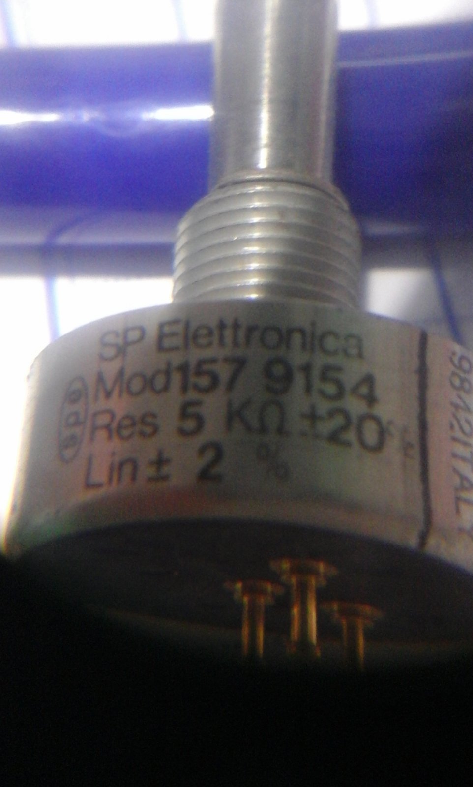

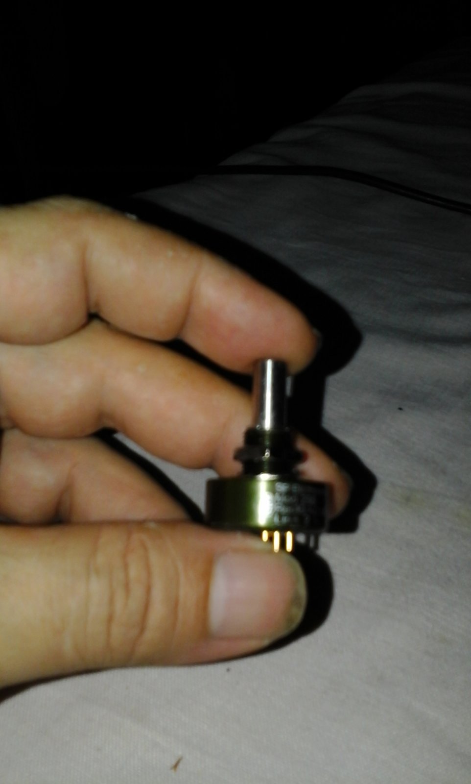

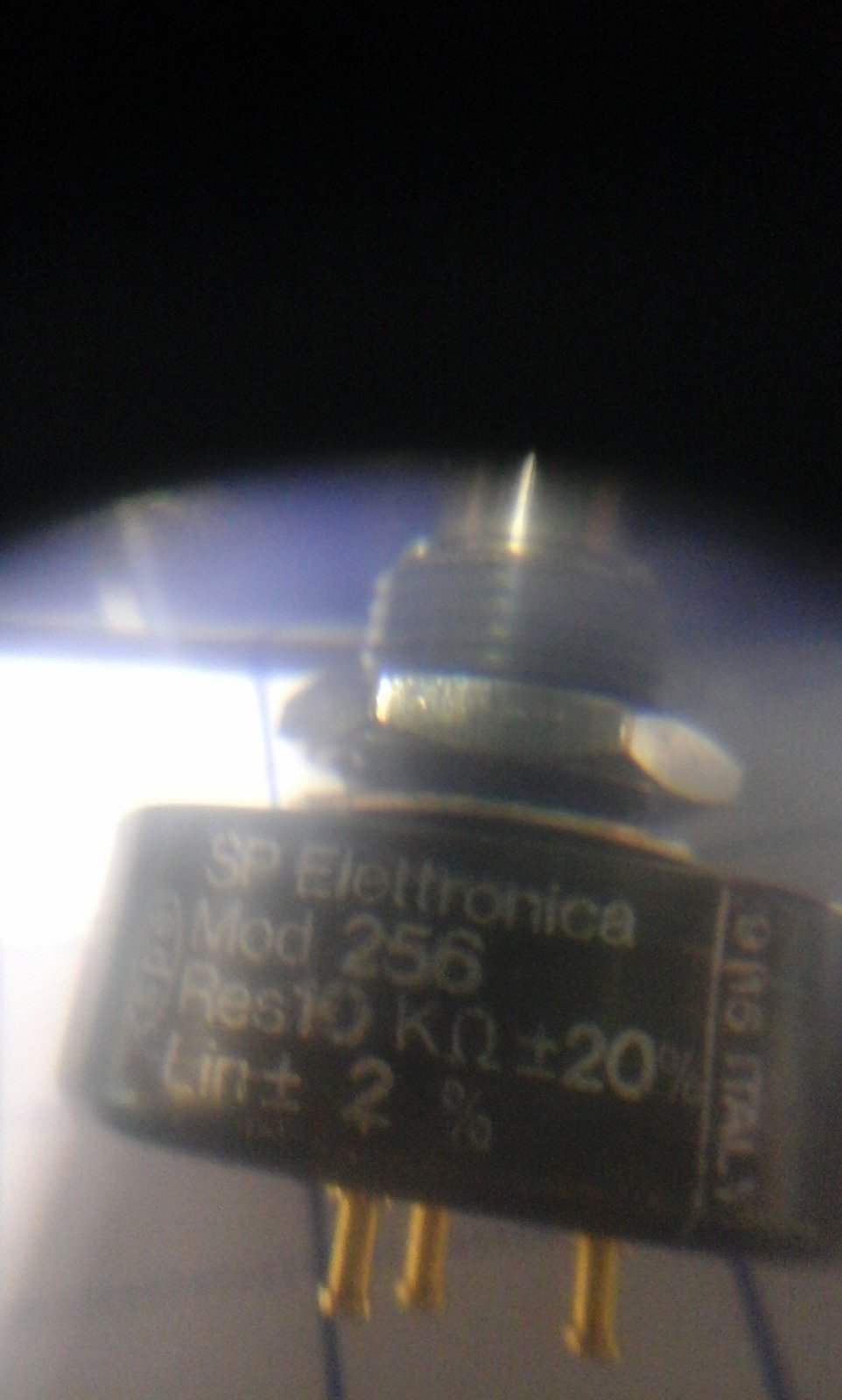

    But I found something that can really makes you wonder where was that before ... a Precision Industrial Potentiometer 5K ohm and 10K ohm without polarity restriction for the 5 volt and ground connection it also works on the 3.3v of the Ard. ... endless rotation repeats itself every 180 360 degree [ working area ] .
    the same configuration as Mod 157 datasheet but with a 10K ohm resistance ...
    http://www.vishay.com/docs/57042/157.pdf

    I'll try with a bolt and nut to have about 10cm or so linear motion out of a rotating bolt ... then convert this 10 cm to a 180 degree on the pot axle with a plastic disk or something ;) ...

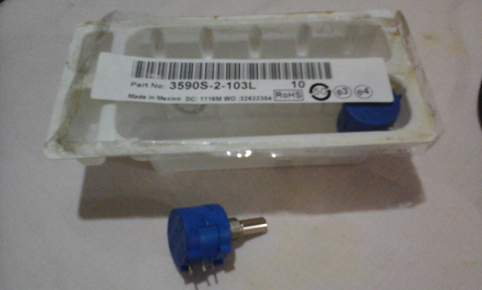

    Not sure which 10 turn pots you have been using but I found that the type with metal brackets holding the body together have never given me any problems on my rig at all. They have the same Bourne model number so I am not sure how to tell them apart other than the metal bracket. I do not have access to my platform right now, sorry that I cannot post the exact model number that I am using.

    Yes, I know that metal bracket model and this is what I've been using ...

    But I'm really cornered right now :( ... replaced the erratic pots with a same blue old ones and experimenting on the new halleffect pot how to get an easy DIY firm reduction gears from 10 turns to 1 in such a tight space ?
