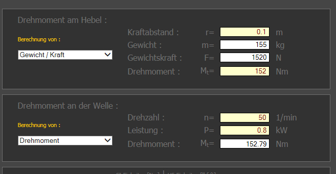

    I found a simple Homepage calculator :
    http://www.wolfgang-frank.eu/drehmoment.php
    it Looks good, so he tells me, with 50 NM for the Motor, i can lift 50 kg on a arm with 100 mm ( 10 cm )
    That Looks good. ?! is this right ?!

    So it Looks very simple ...800 Watt DC gearmotor , with 3000 rpm and a ratio 1:60 is really powerful :)
    He tells me 150 NM ! ! But the Hongkong man tells me "only" 100 NM
    So 150 kg each motor, for 10 cm radius ( = 200mm way ) 450 max load platform .... so when i use it with only 200 kg should be ok in every action on a safe way ?!
    I can help them also with a little springs-things ?
    better less weight (help with spring(s) ) for every thing, Ampere, for motor, for speed, for electronics ...right ?
    And worth thing, when i spend much money, and I want/need more kg power up ... I make 8 cm arm ... or 7 ....
    ( worth theory, before i do everything to garbage :) )

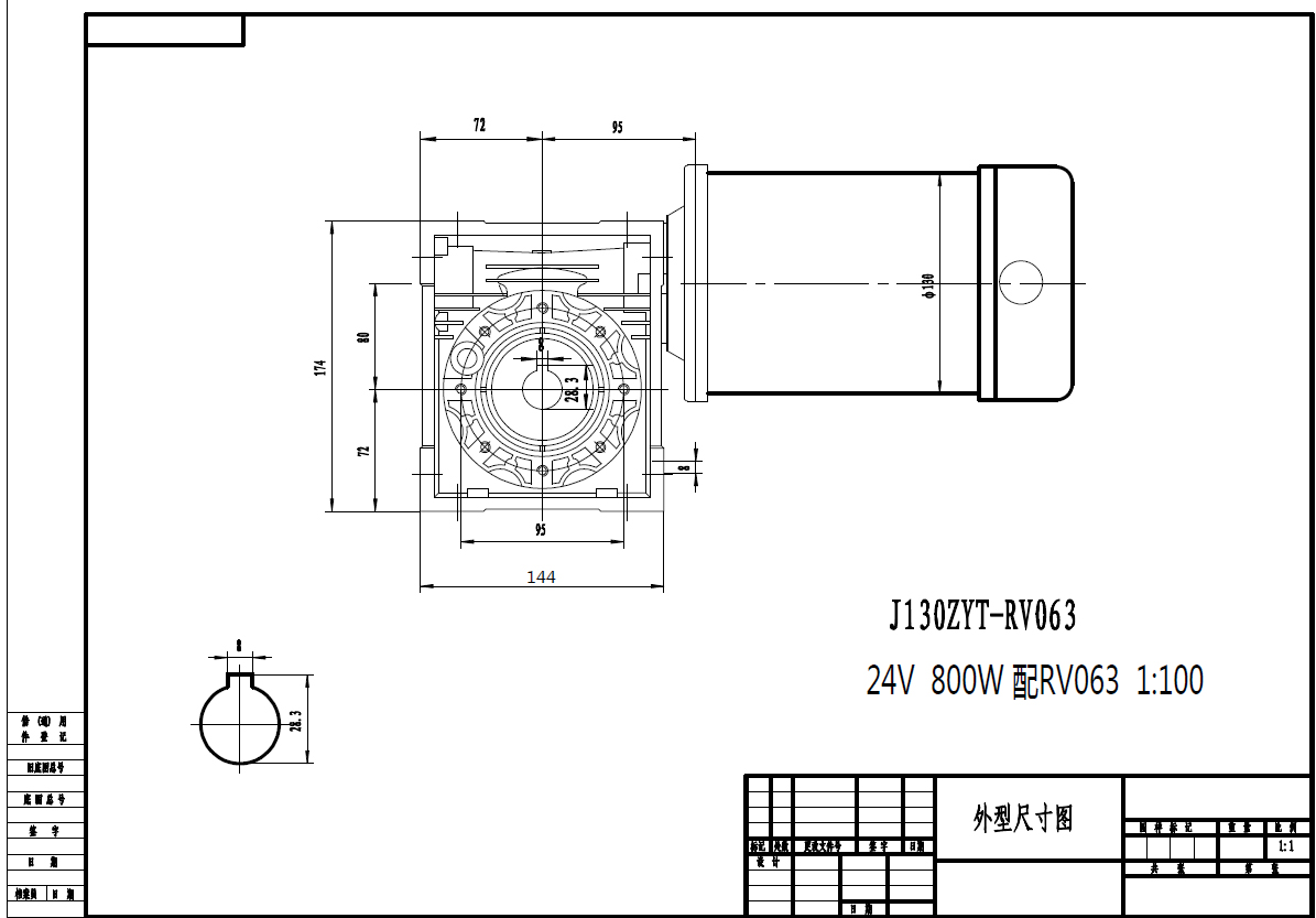

    So I buy it now ....shipping is not really cheap ...but it is like it is ...
    130ZYTRV063 1:60 24V 800W 50rpm $280.00 3 $840.00
    TNT freight cost for 60kgs $430.00 1 $430.00
    Summe $ 1.270,00 USD
    Hope it will send immdiately :) :)
