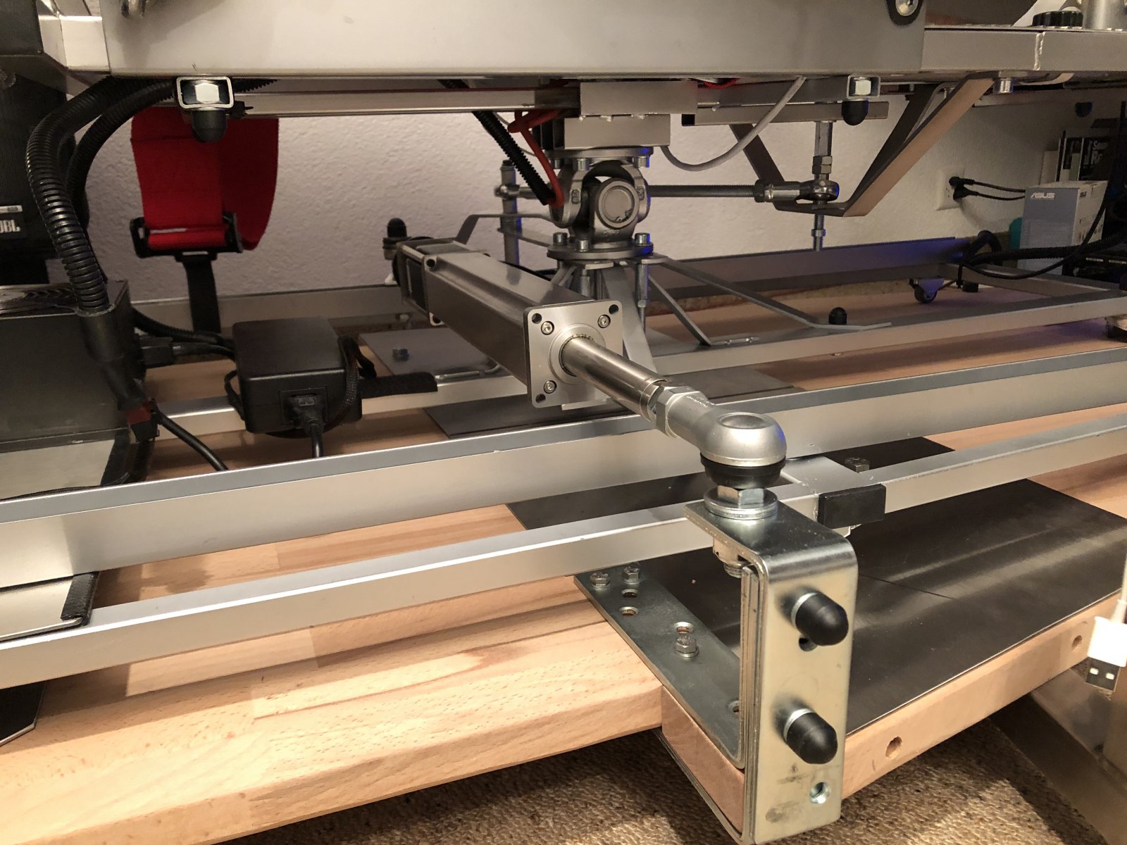

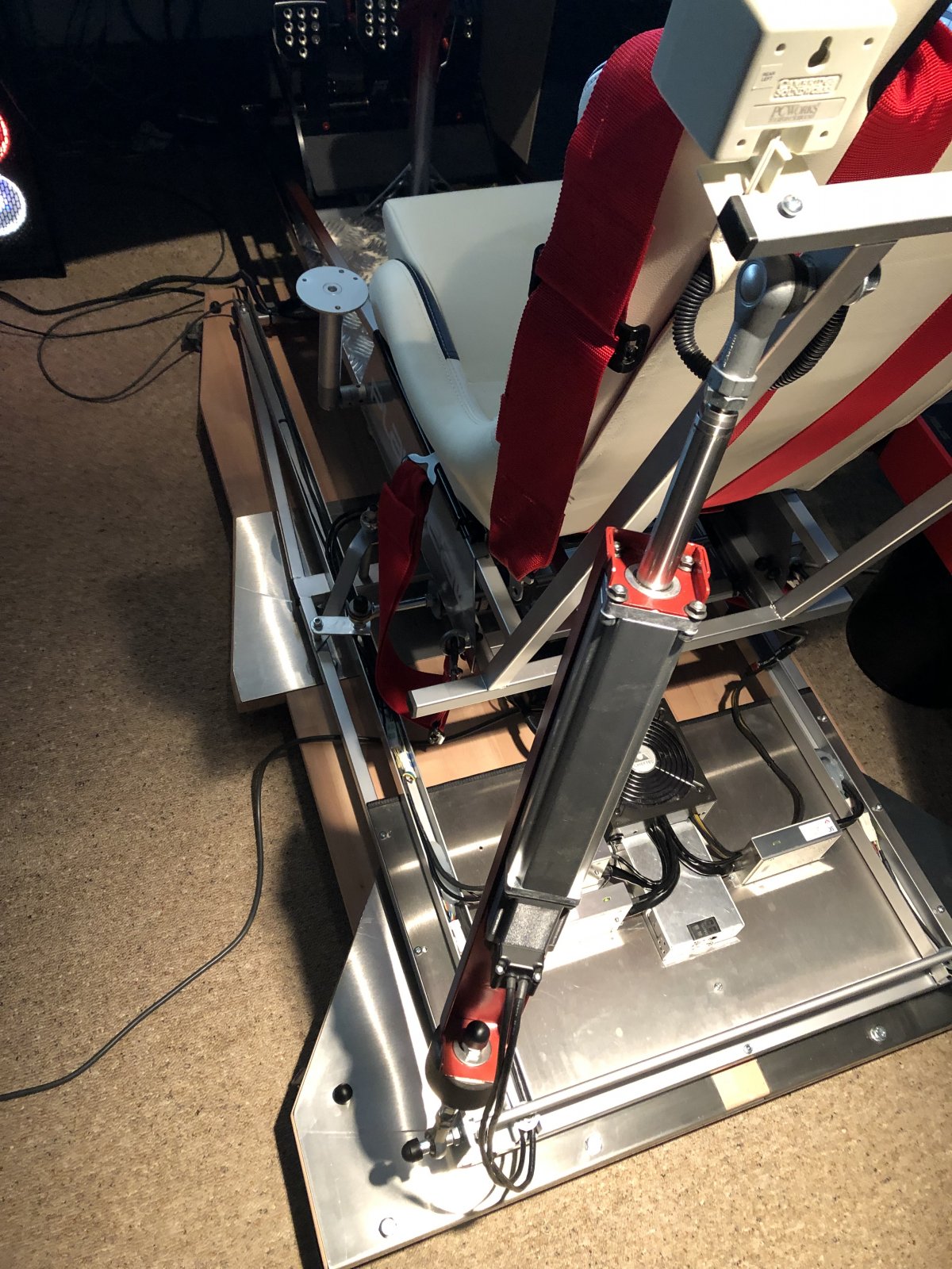

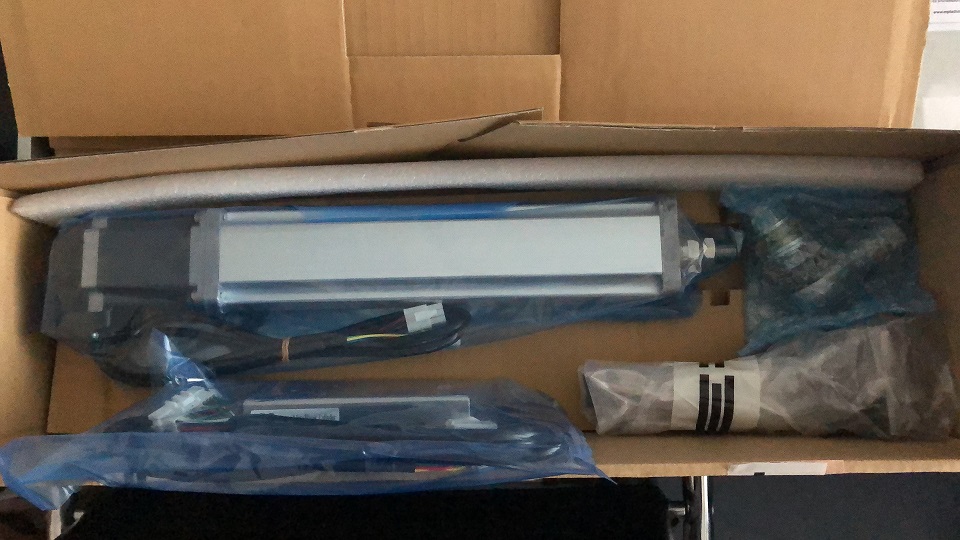

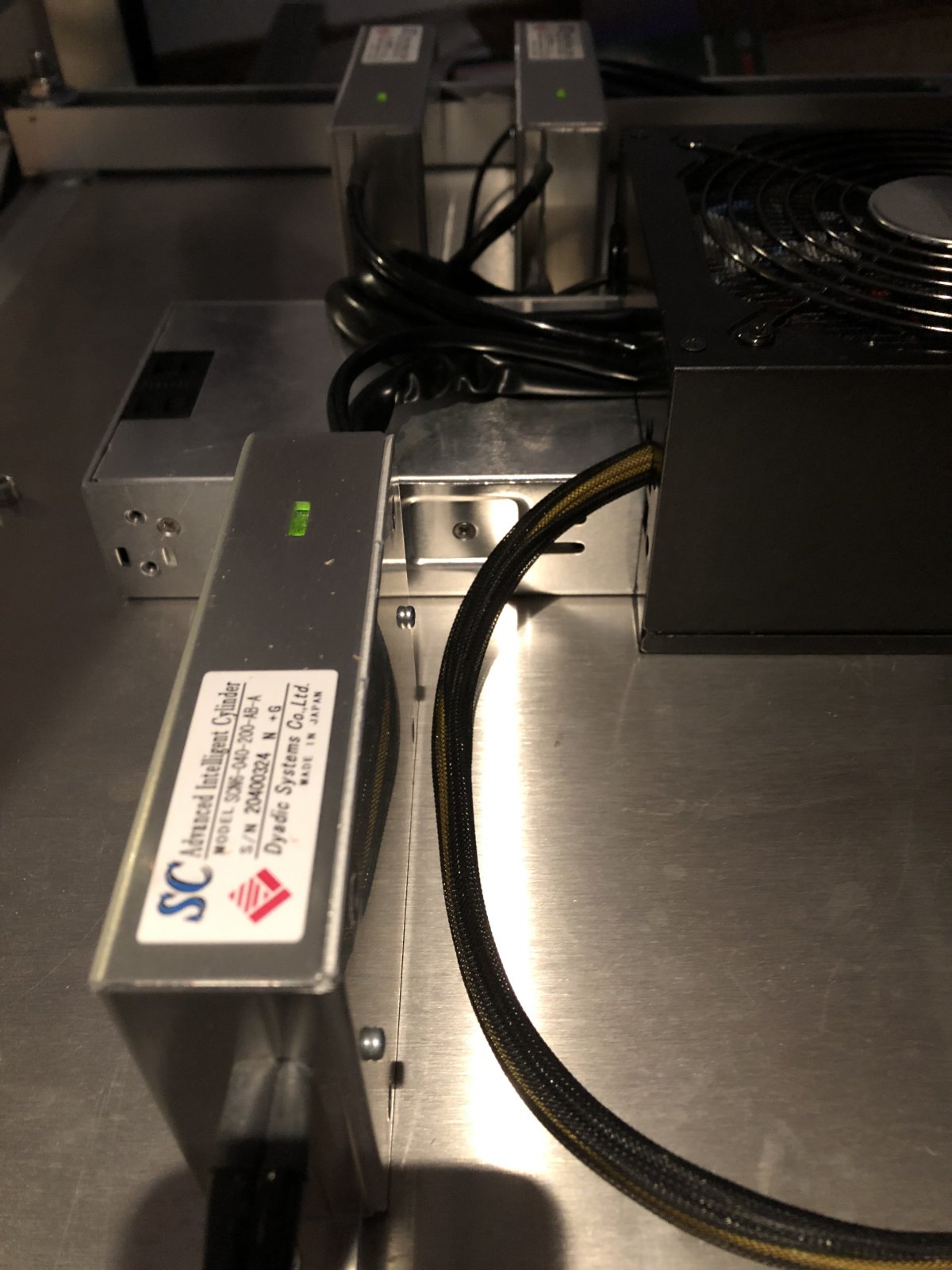

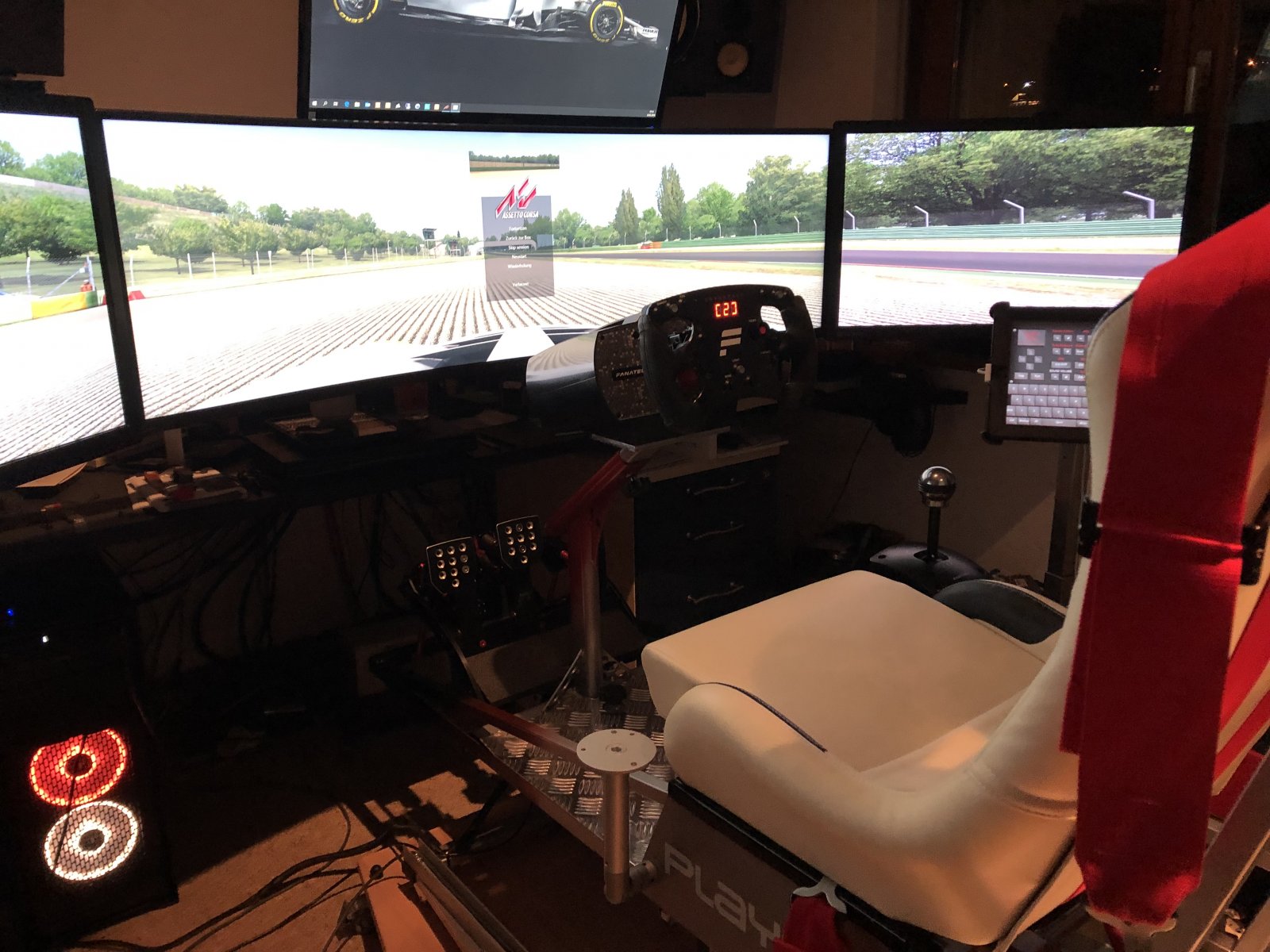

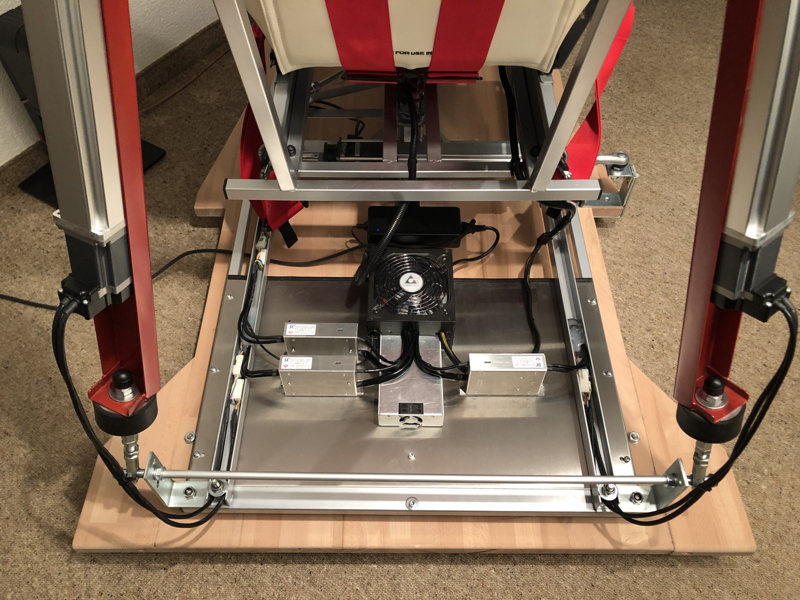

    I finished my test with arduino and MecVel actuator. Although I was able to reduce the problem with the interferences with a ferrite ring in the engine supply, but the engine was too slow. Thank you all again for the help.
    I have decided to order another SCN6 actuator:) To my delight, he arrived before Christmas …
    The third controller and Motor mounted
    On each side the range is 19cm:grin

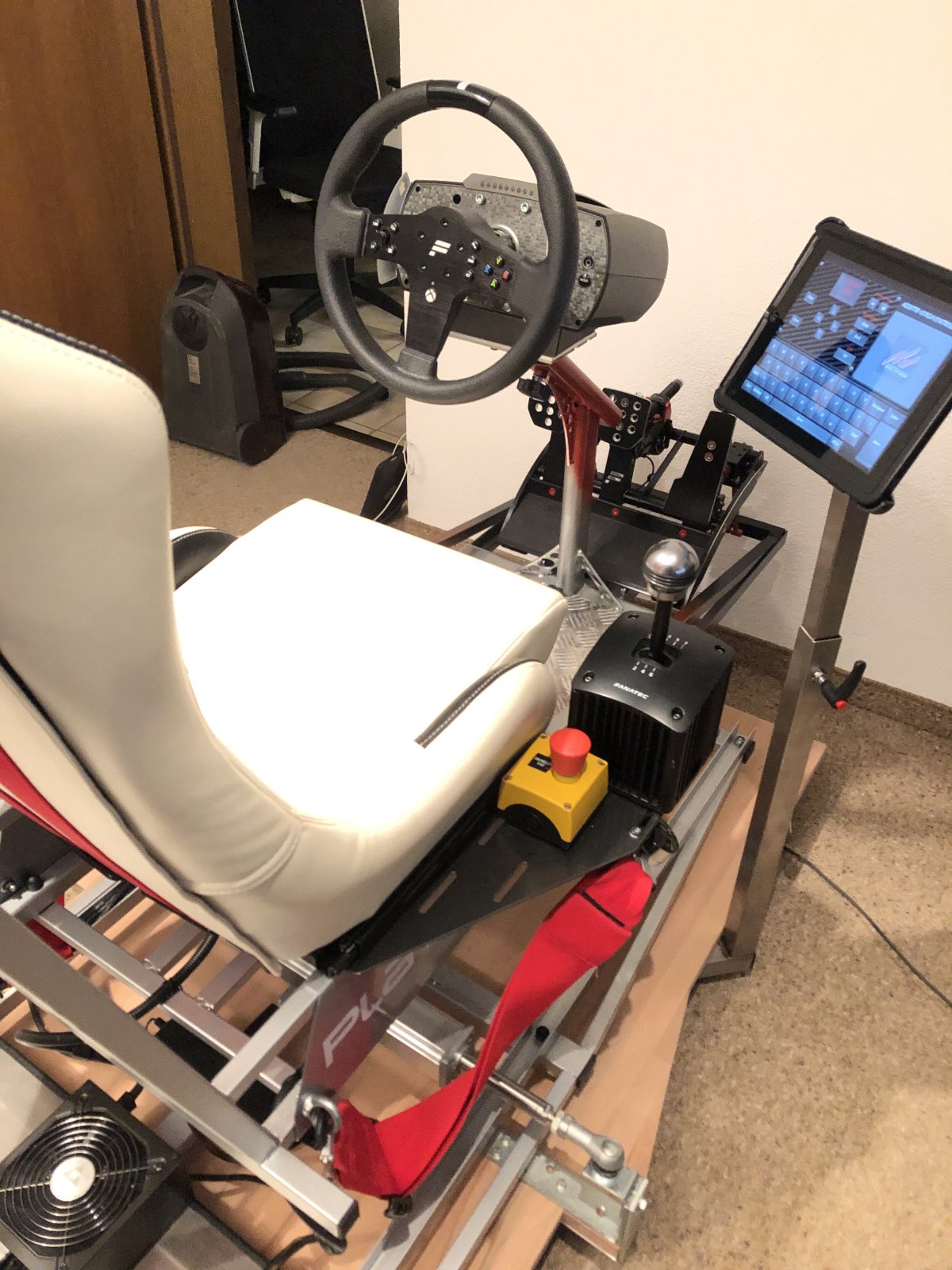

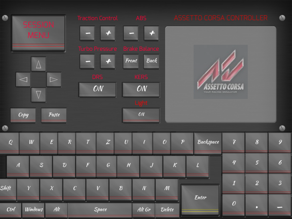

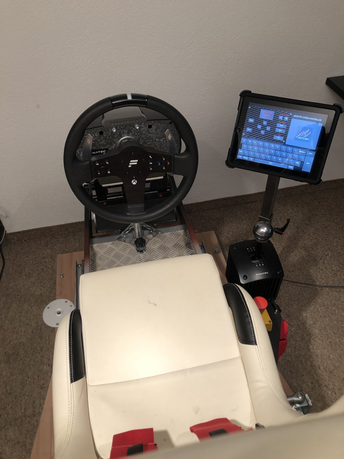

    At this moment I would like to present my keyboard/mouse alternative. I have assembled a controller with an old iPad and the app "CCP". This is really a cool thing and working properly.

    My equipment:
    3x SCN6-040-200-AB-M
    1x Mean Well MSP-300 power supply
    1x USB-Com485 Plus2
    1x 485 to USB Converter
    1x emergency switch
    1x Playseat Evolution with Gear Holder and Seat slider
    1x Turn One Oreca Store Belts
    1x Fanatec CSL Elite Wheel Base
    1x Fanatec ClubSport Steering Wheel Formula Carbon
    1x Fanatec CSL Steering Wheel P1
    1x Fanatec Club Sport Pedals V3
    1x Fanatec ClubSport Shifter SQ V 1.5
    A lot of square tubes & threaded rods, screws and ball joints and of course a universal joint.
    And last but not least: a lot of work. But it has paid off and brings a lot of fun:grin

    The Ipad idea is a great one. Nice work.

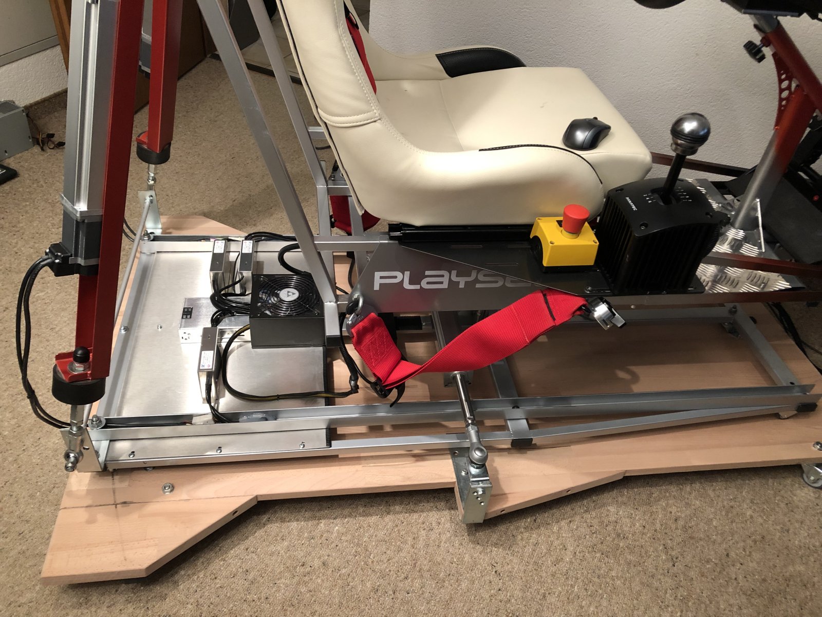

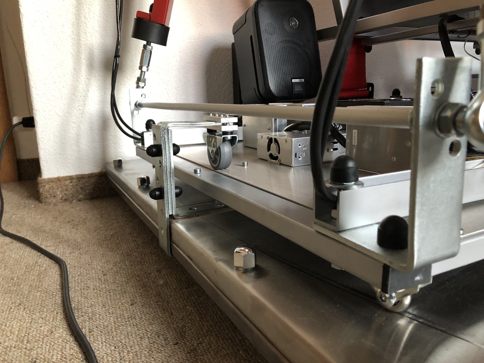

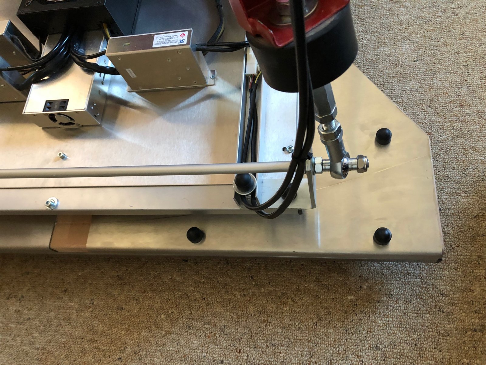

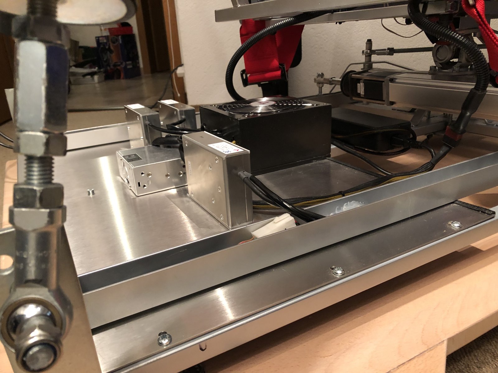

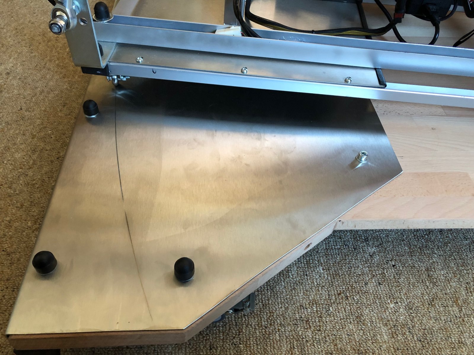

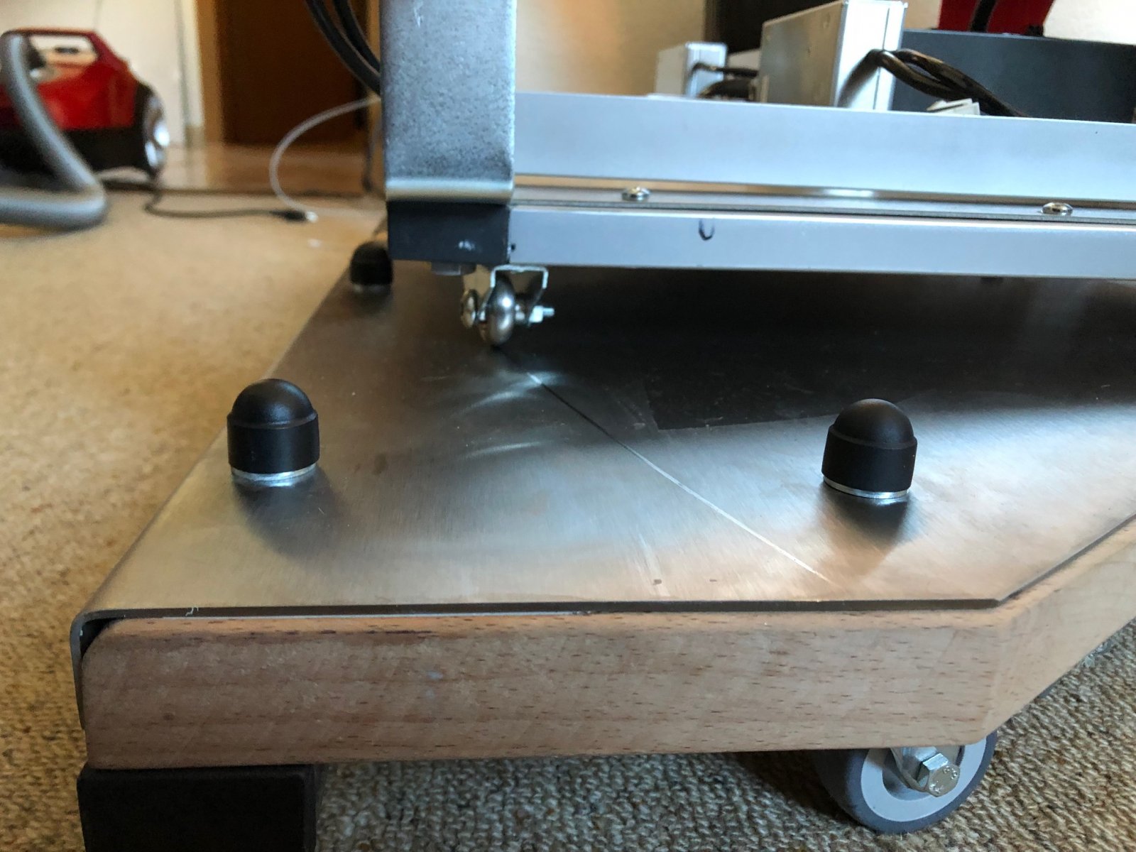

    An update to reduce noise and roll resistance.

    Looks promising, but I think roll is set way to high as if the car banks, or?

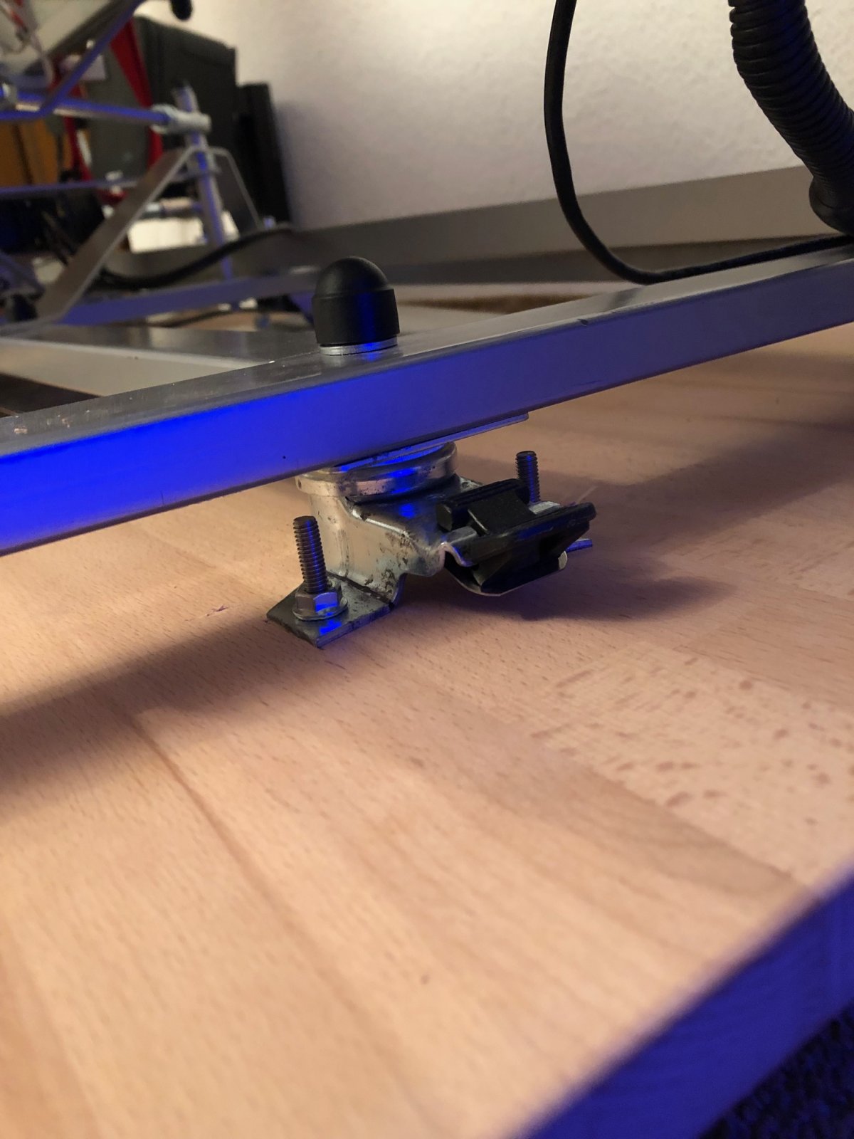

    A recent video from my simulator with traction loss
  11. Pierre Lalancette
    Dec 11, 2016
    1,012
    Tech Artist
    Quebec, Canada
    8,052Coins
    +947 / 6 / -0
    3DOF, DC motor, Arduino, 6DOF
    Small suggestion. At the back, in the center, you could add an arm and a rolling ball that would press on the top of the moving plate, to keep it down when theres a big change off direction. Once in a while, your lower rolling balls lift up on a big move.
    Really nice rig.
  12. highi
    highi Highi Racing Simulator 17 Gold Contributor
    Jul 8, 2017
    31
    8162 Steinmaur, Switzerland
    133Coins
    +37 / 0 / -0
    3DOF, SCN6, Motion platform
    Thanks for your feedback. I also noticed that my substructure is too weak for these forces. I think I have to redesign it. Man must have something to do otherwise the project is over. Who wants that? Your idea with the arm is also an option, probably with less effort.

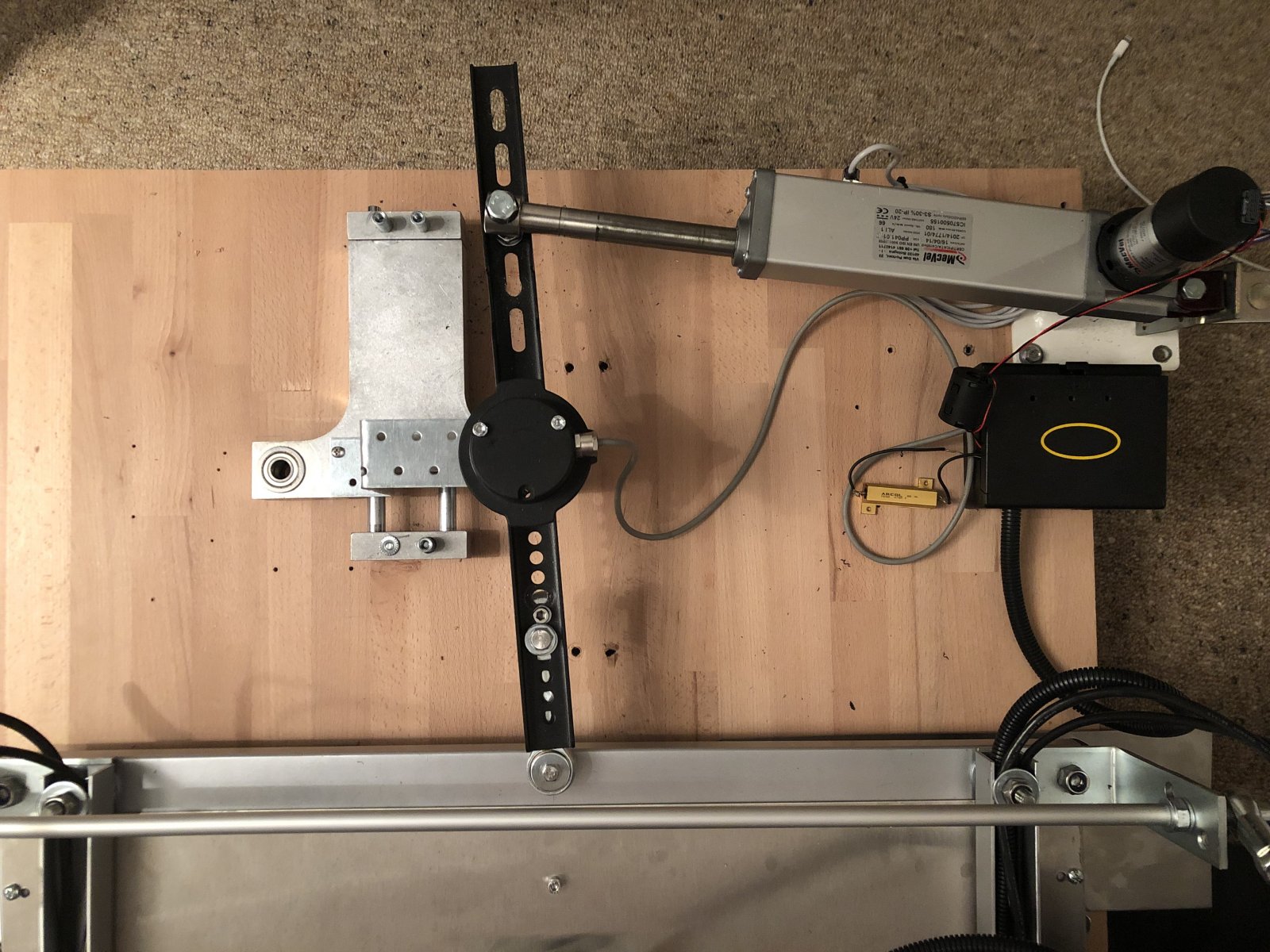

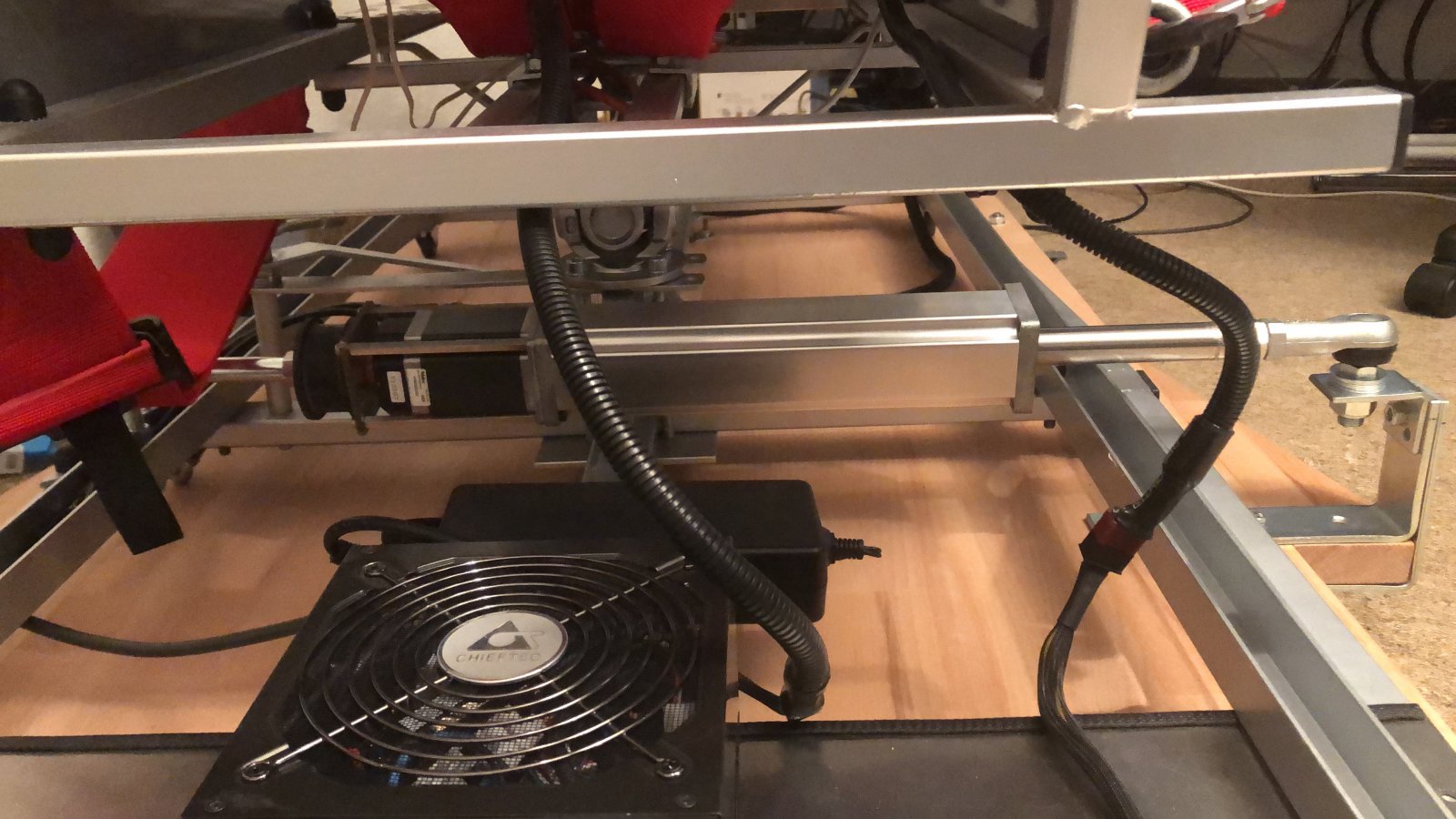

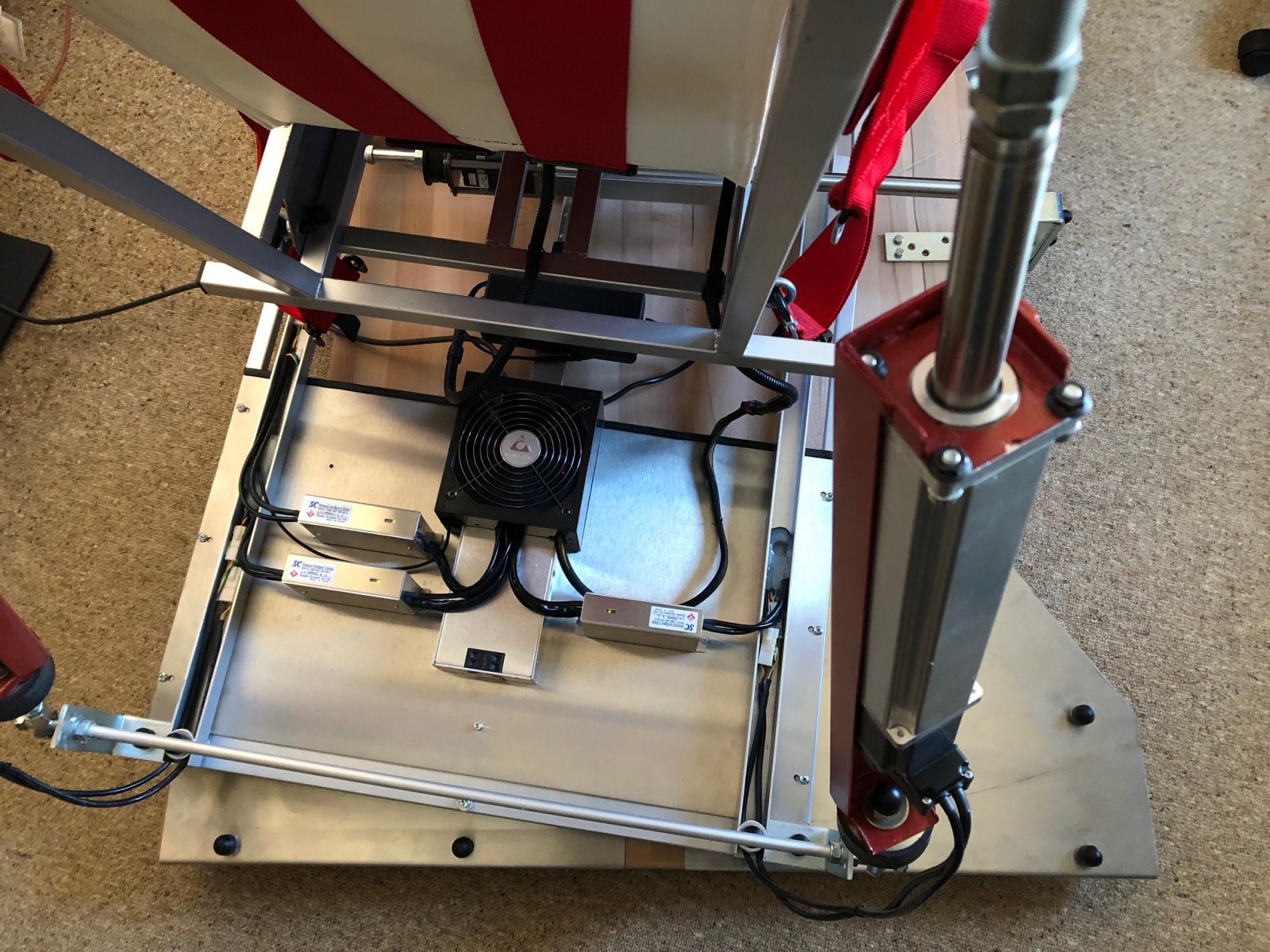

    How exactly is TL achieved mechanical wise. I can see tracks from what I think are two rolls...how does pulling (?) from the sides work? Really looking to get TL as well for my rig. Your implementation looks exactly right
  15. highi
    Jul 8, 2017
    31
    133Coins
    +37 / 0 / -0
    The substructure is stored in the middle in front, in my case on a caster without a roll.
    I have mounted behind the universal joint a linear motor which makes the movement sideways.
    This position is only possible with a motor that has enough power. Of course, there are other ways to implement the sideways movement. Just search for traction loss in this community.

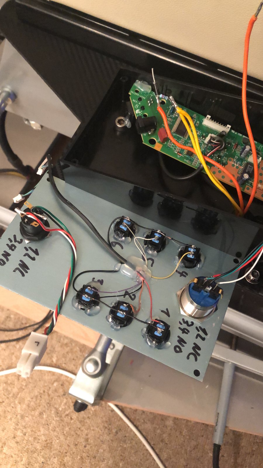

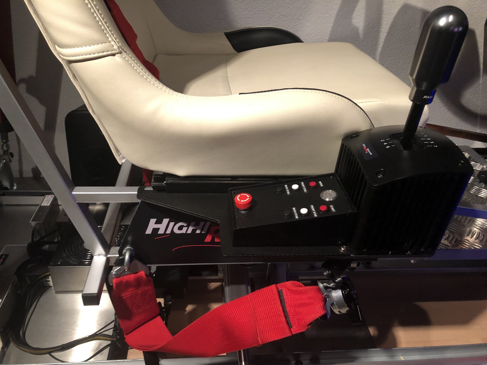

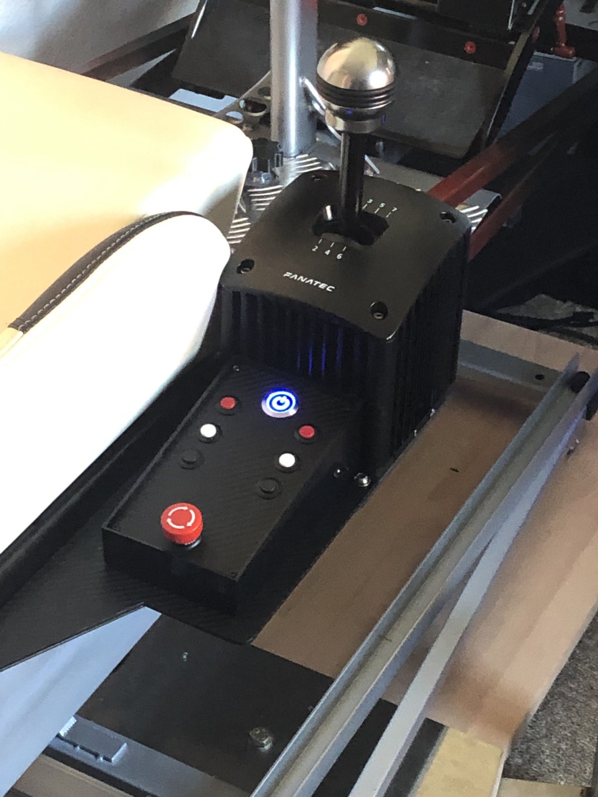

    I have made some improvements:
    1. I have an arm and a rolling ball mounted in the middle of the back to prevent lifting of the substructure. (Thanks to Pierre Lalancette)
    2. I reinstalled the gear lever and built a tunnel console with the PCB from a WingMan Formula Force GP

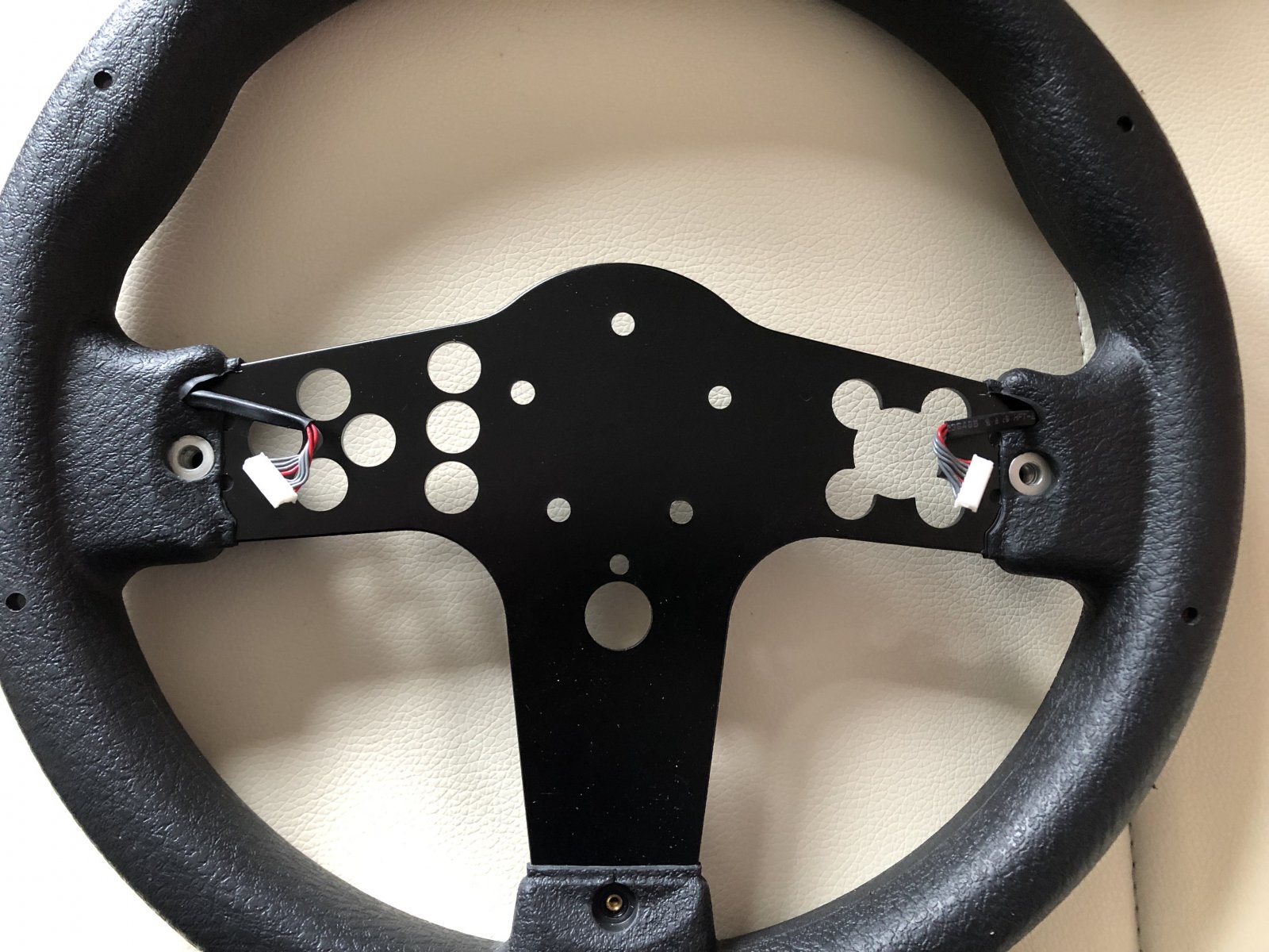

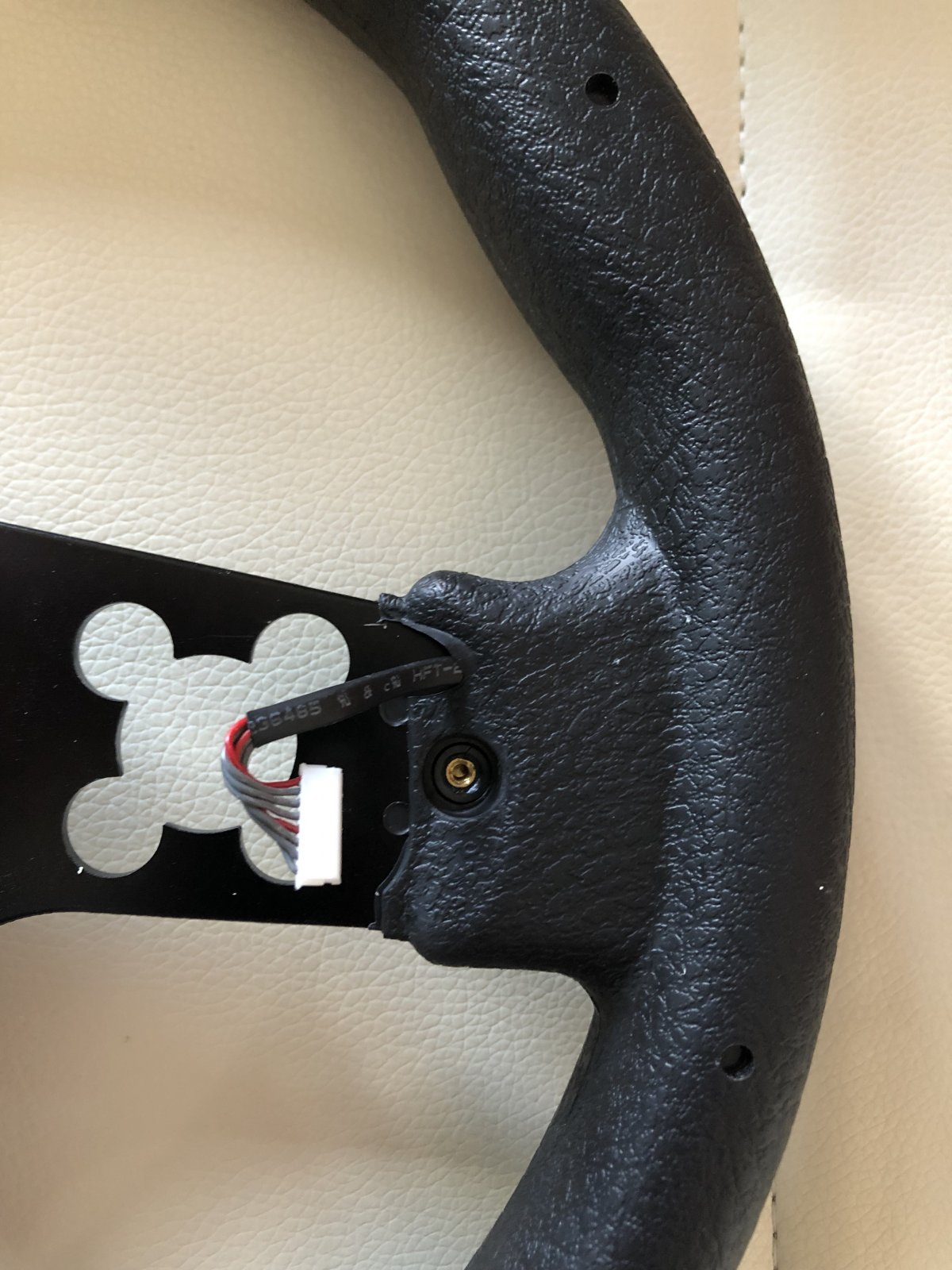

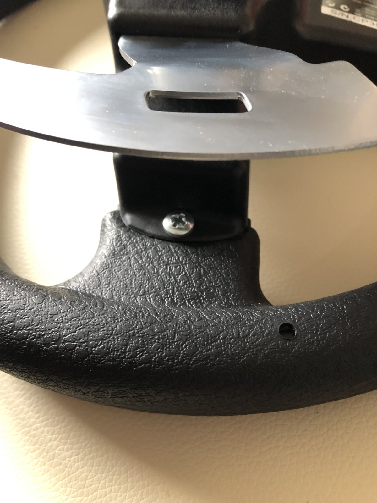

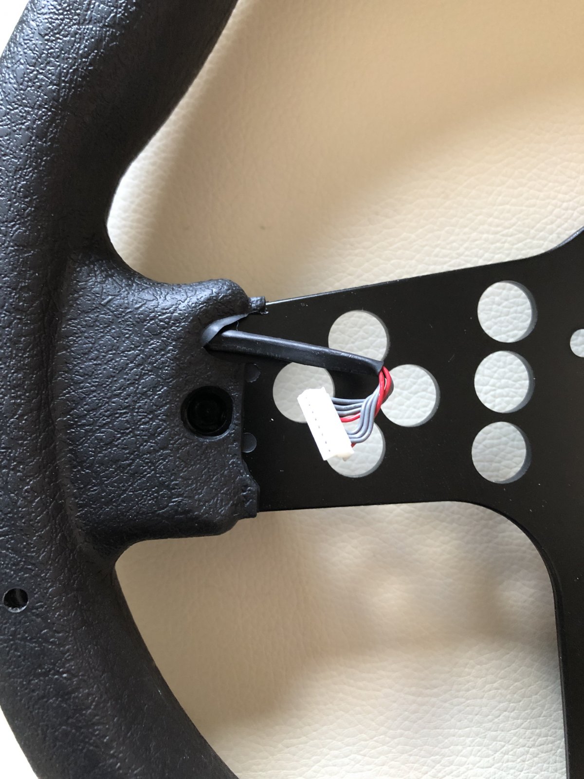

    Another story that has nothing to do with my rig but may be useful to someone:
    After a few hundred kilometers, a threaded bolt broken from my Fanatec P1 steering wheel:
    IMG_4944.jpg broken threaded bolt
    IMG_4945.jpg original threaded bolt
    IMG_4950.jpg After the drill out and installing larger (M5) threaded bolts (Tubtara)
    IMG_4952.jpg Mounted with M5 screw gives optimum stability

    Yes, the part has enough power. The fan has never turned on. Therefore, I assume that the performance limit is far from reached. You always have to include the simultaneity factor.
