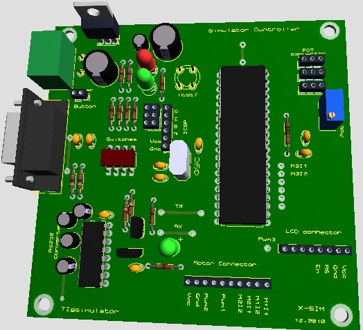

    I am working on a new AMC Controller. Based on Tronicgr's AMC card. I only moved the unused pins. Now the board is only 10cm*10cm, Ready for 3 motor setup. Except the firmware...

    HI Pathetic may i ask what software you used for your pcb design and presentation ? regarding the above PCB layout picture :) Cheers

    good job bro. protel pcb?

    The designer is labcenter proteus ISIS / ARES :)
    I build this it is working i am now adding new components.
