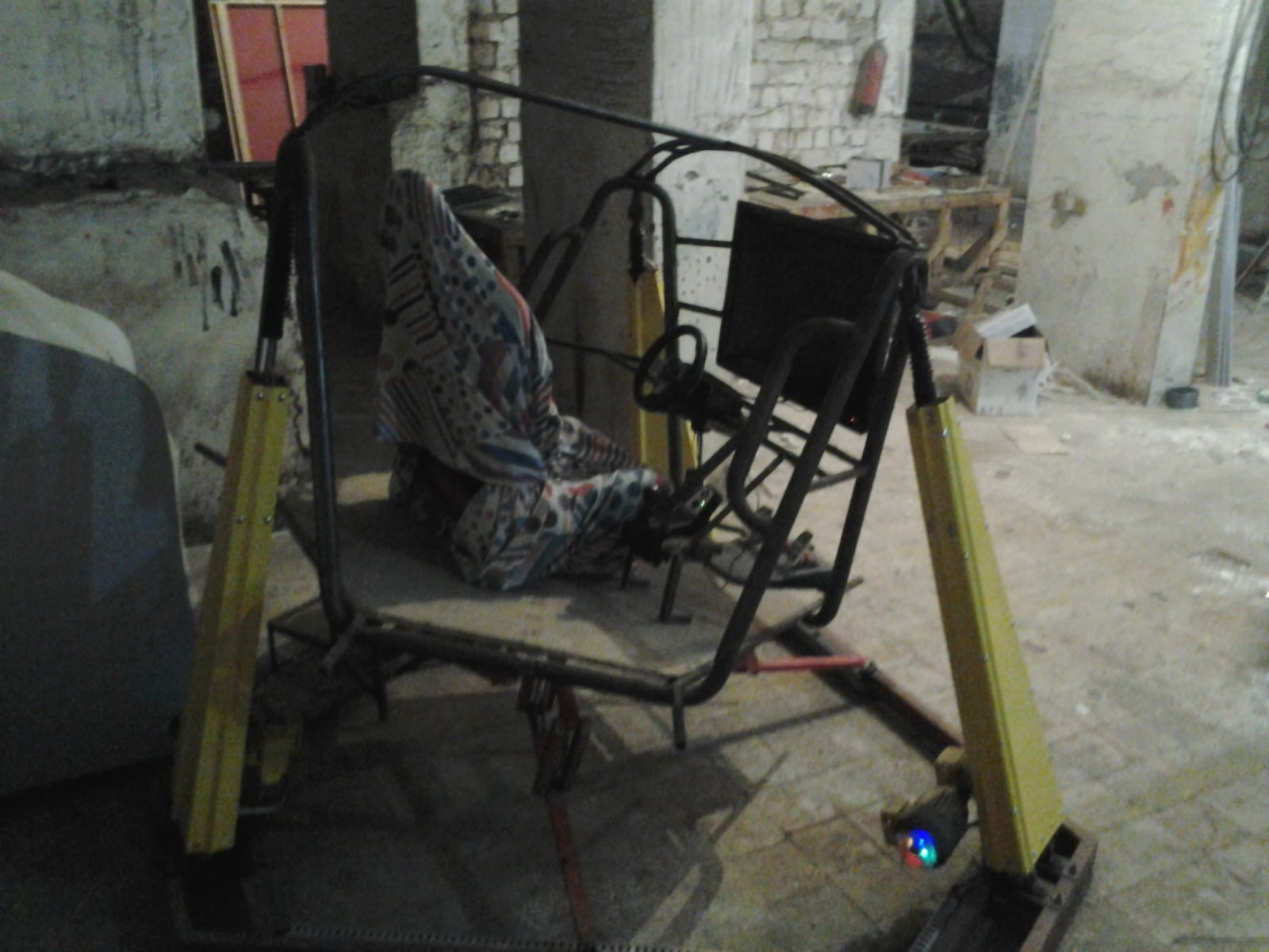

    I Love the 3 DOF Simulator! What are you using? Specs for your simulator?
  5. speedy
    speedy Well-Known Member
    Feb 1, 2012
    1,193
    Alexandria , Egypt
    7,948Coins
    +1,287 / 10 / -0
    Thanks @Albertus ...

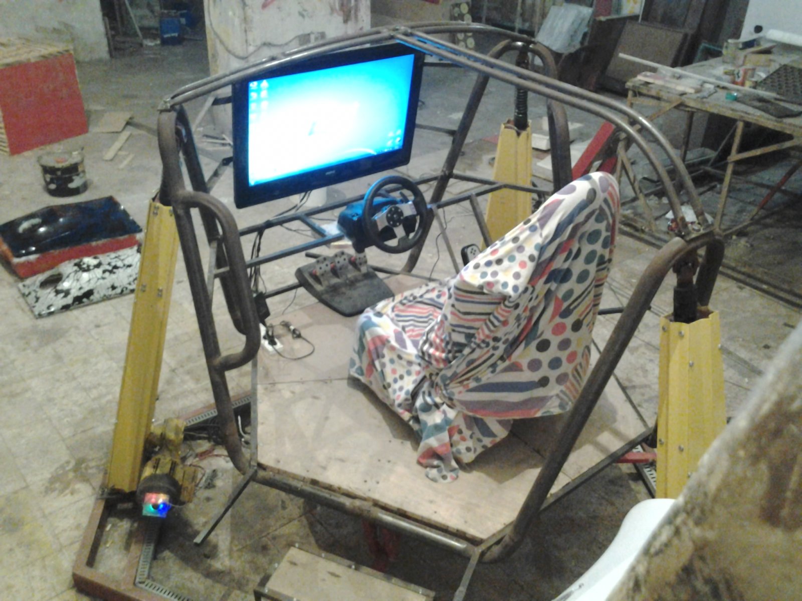

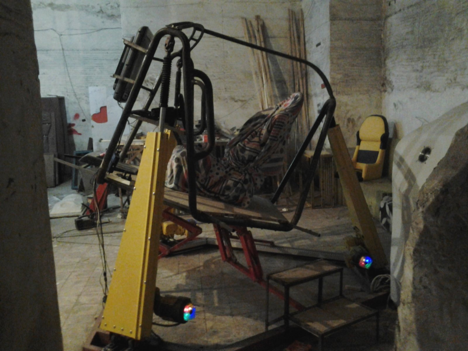

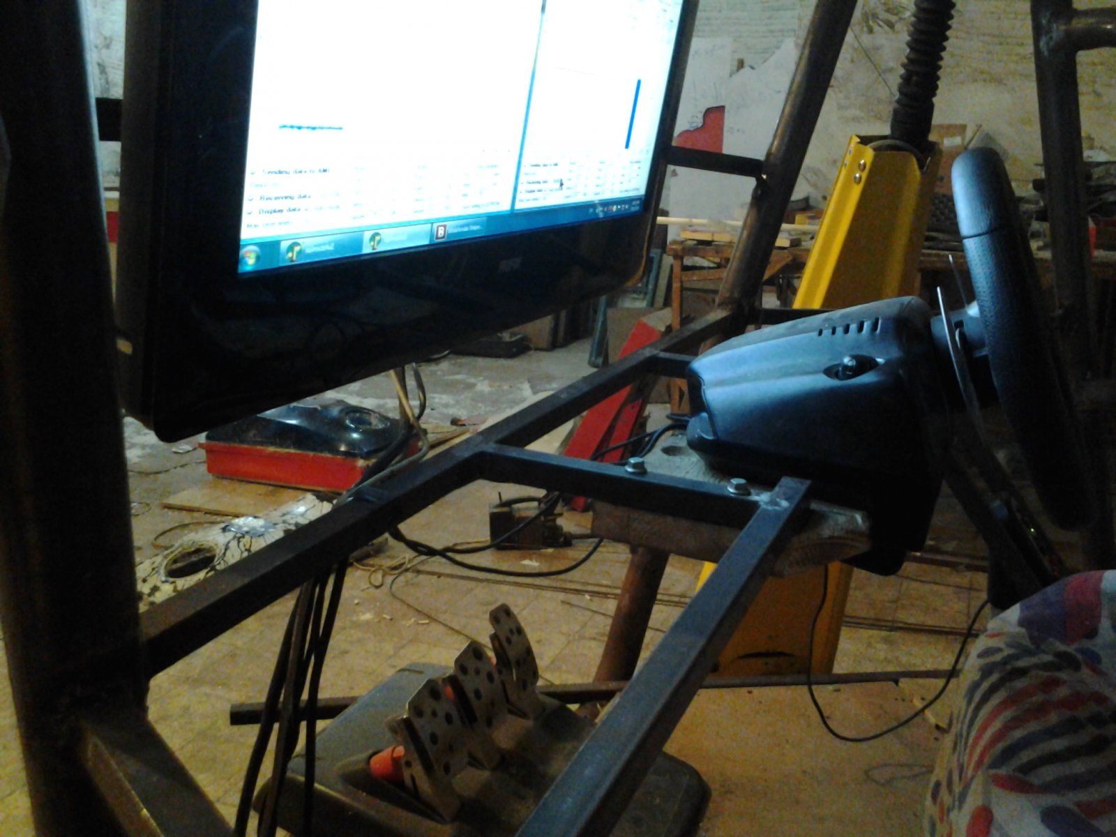

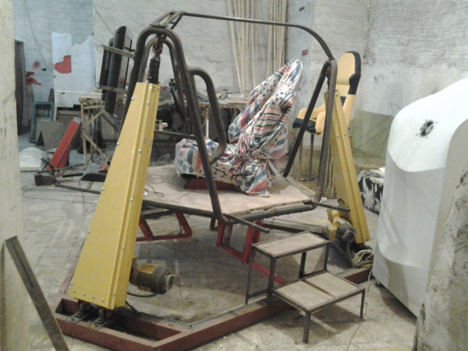

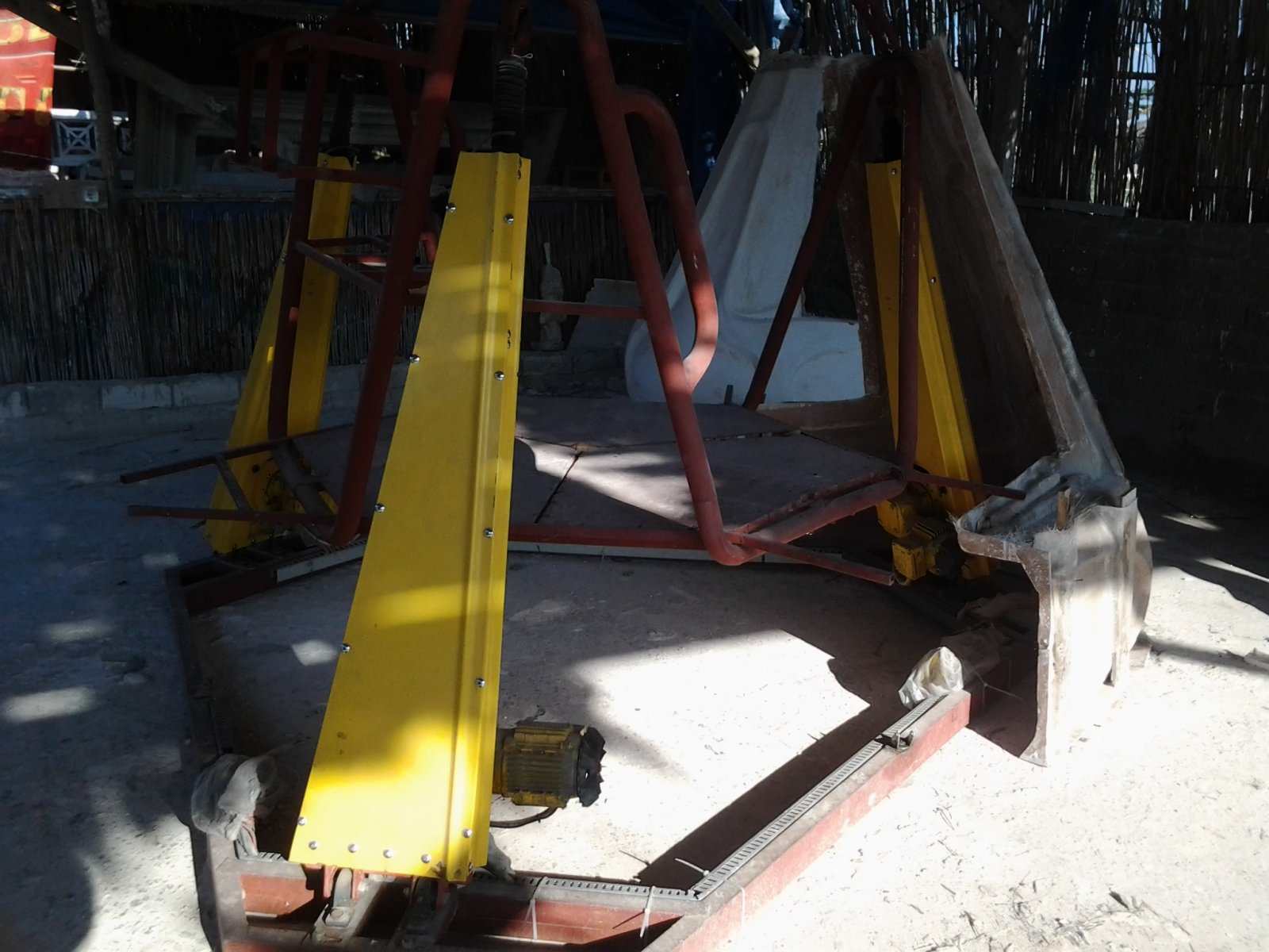

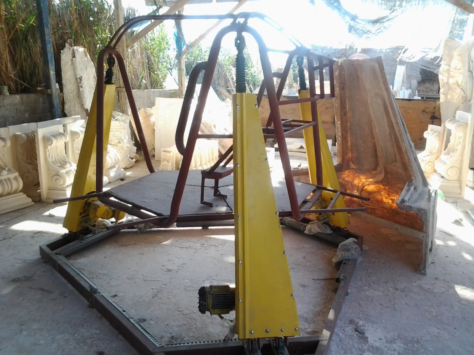

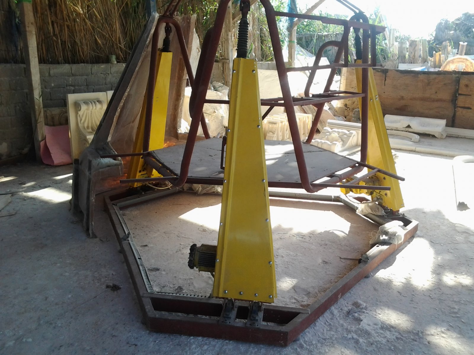

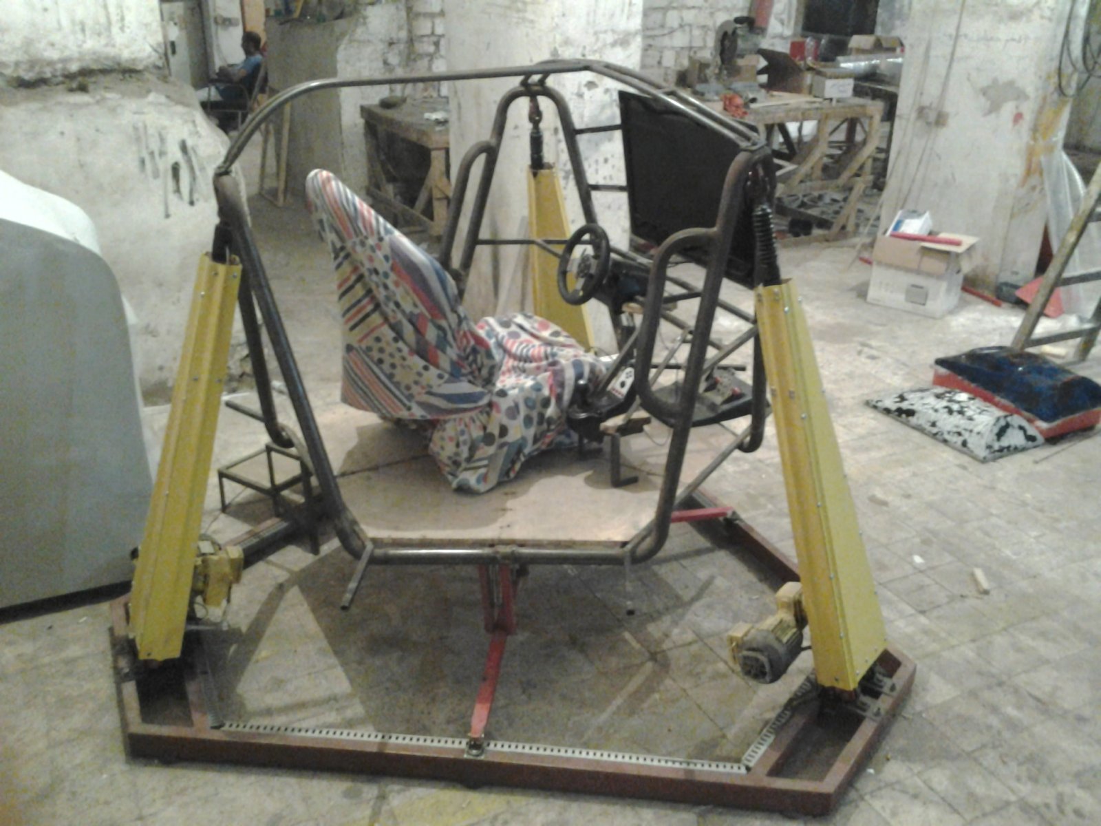

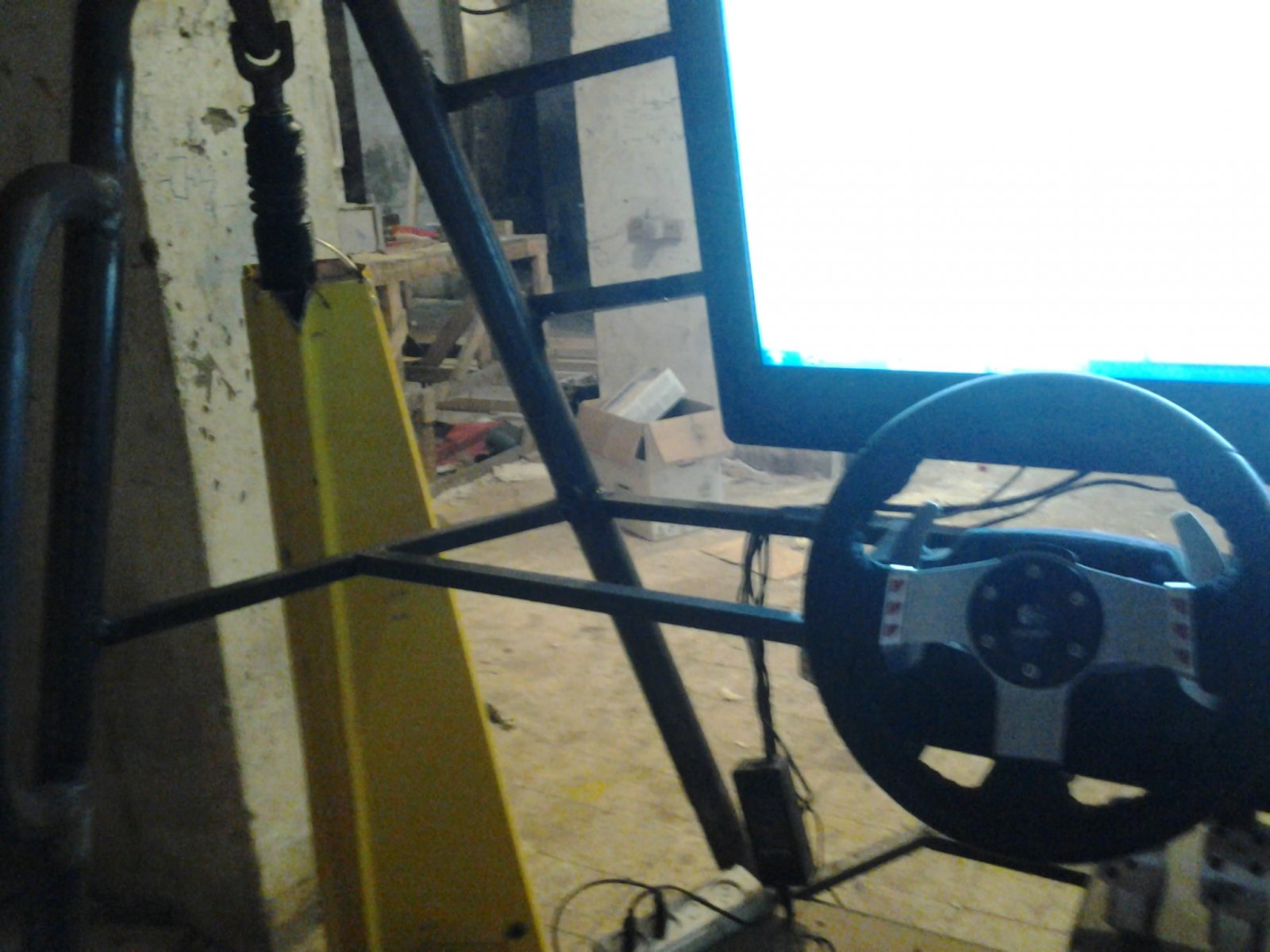

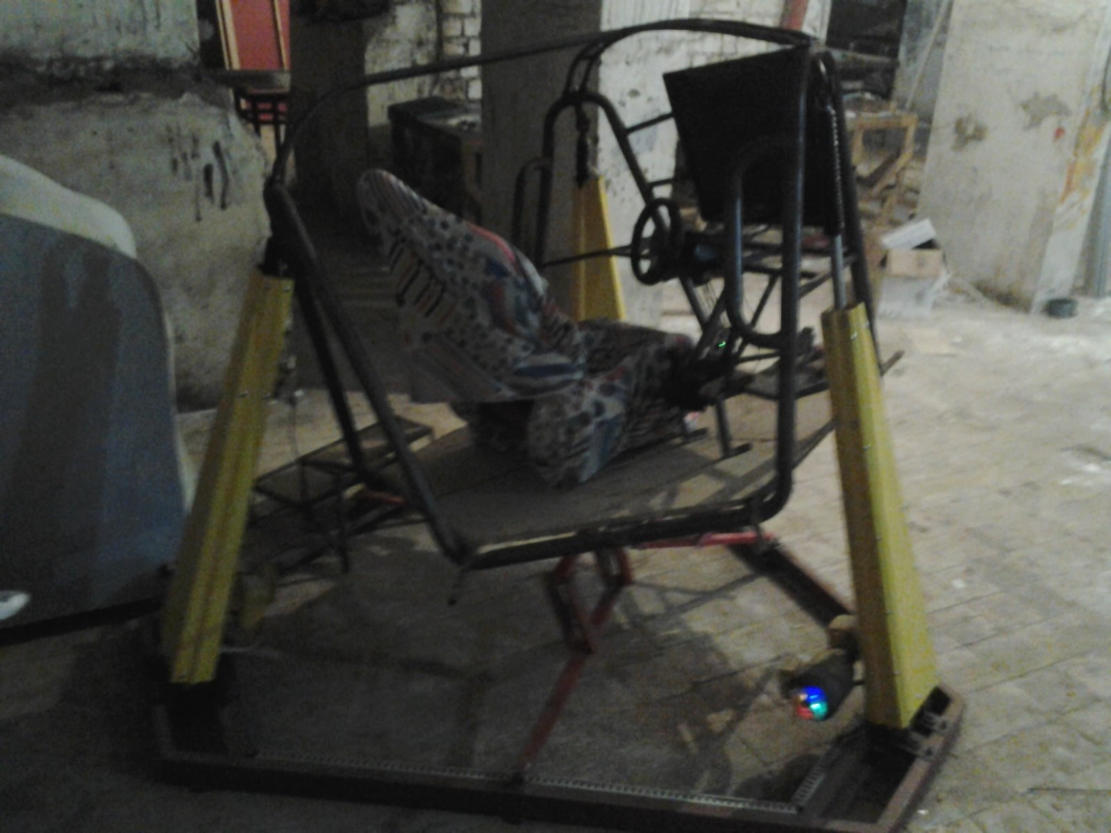

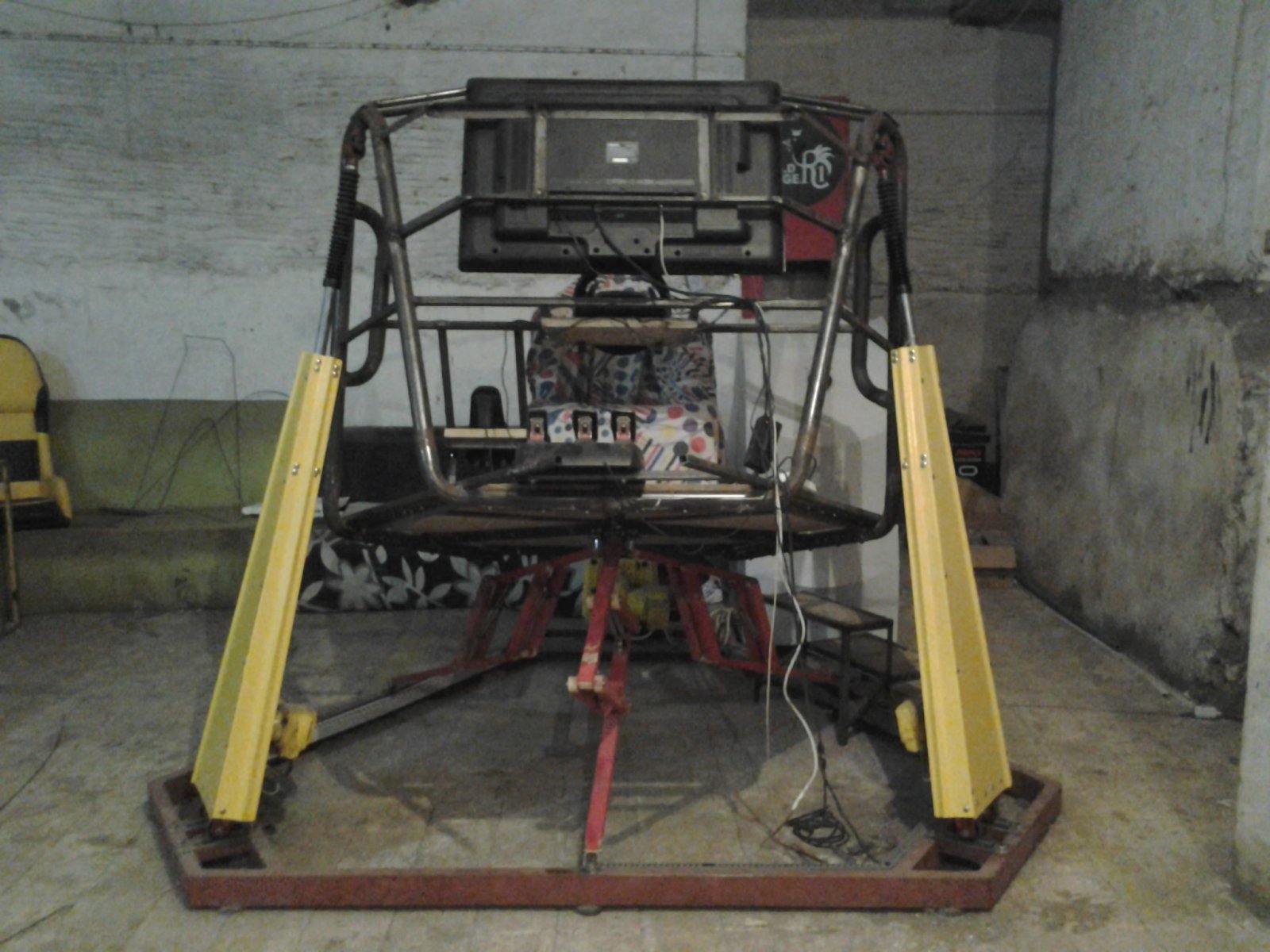

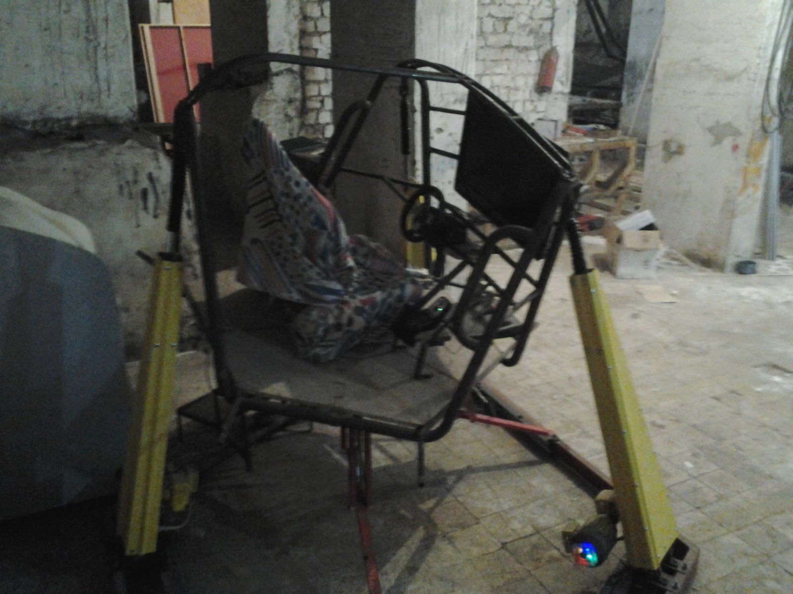

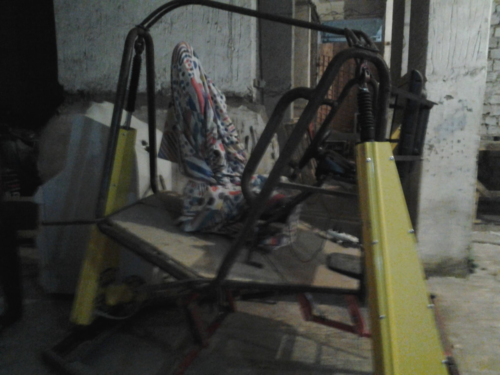

    General specs as a start is :
    - A tower PC which is running the Live for Speed Game and should have Sim Tools program soon ... "right not it is using an old simulator program " ...
    - 2DOF two controller cards similar to the Old AMC1.5 but with modification all over it that converted it into a perfect solution for All DIY'rs "I'm preparing to publish it soon " ...

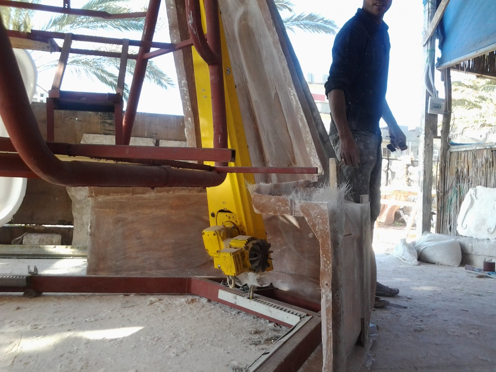

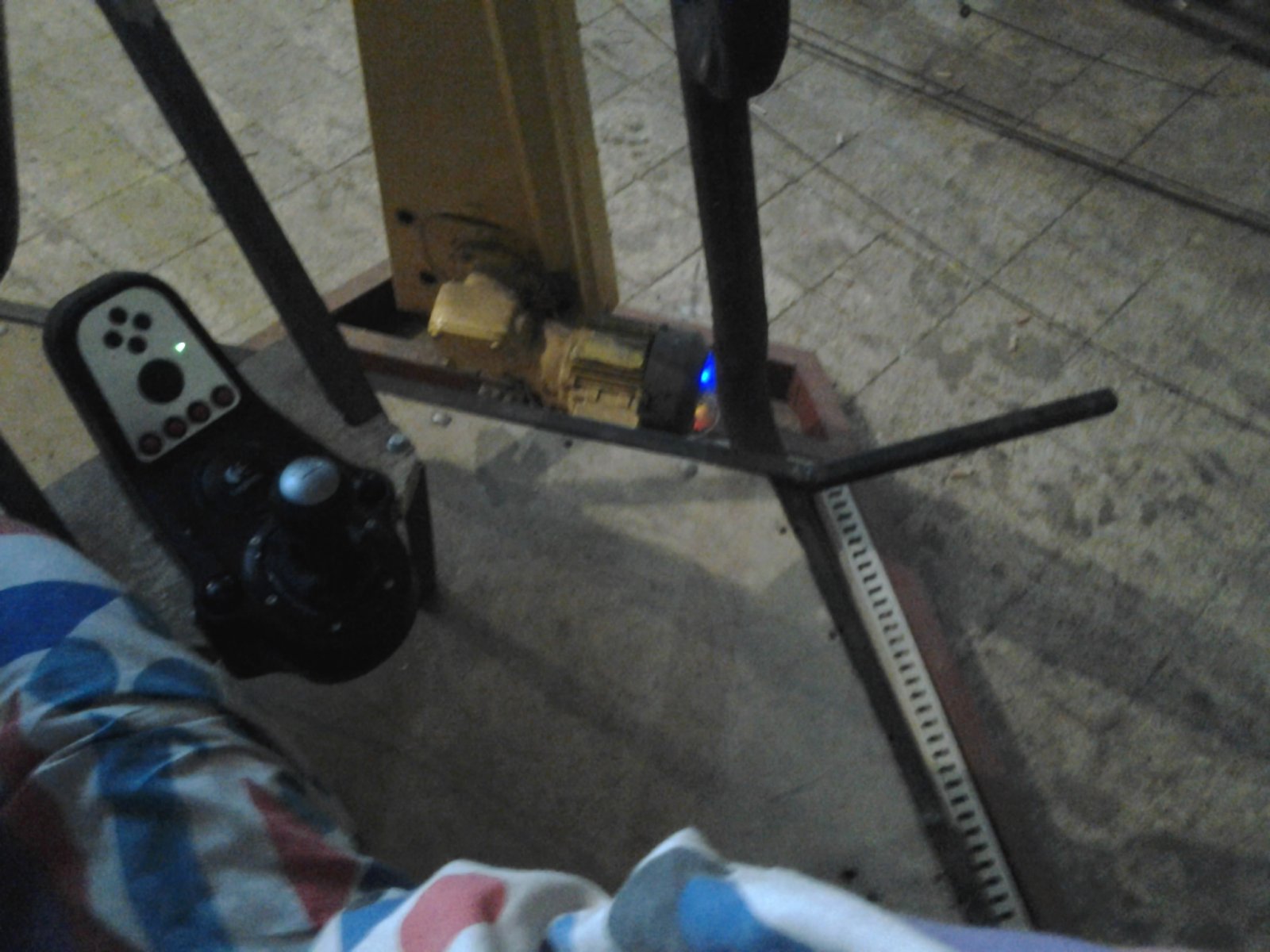

    - A modification to the output signals since I'm not using DC motors with H-bridges ... I'm using 3 VFD's "Variable frequency drive " that controls 1/2HP AC geared motors ...
    motors are with sprockets and a driving chain driving a sliding up/down shaft that provides the platform with motion ...
    - Now preparing the simulator to be a closed capsule with all car interior design Speakers, Dash board, center console, ... that will make driving more realistic including the ambient air speed to be variable with the car speed or using it just like an internal AC "air condition" of the car ...

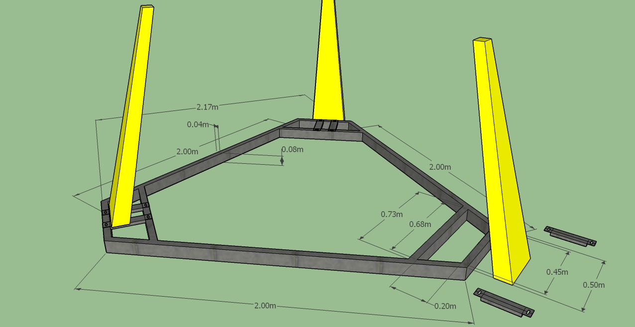

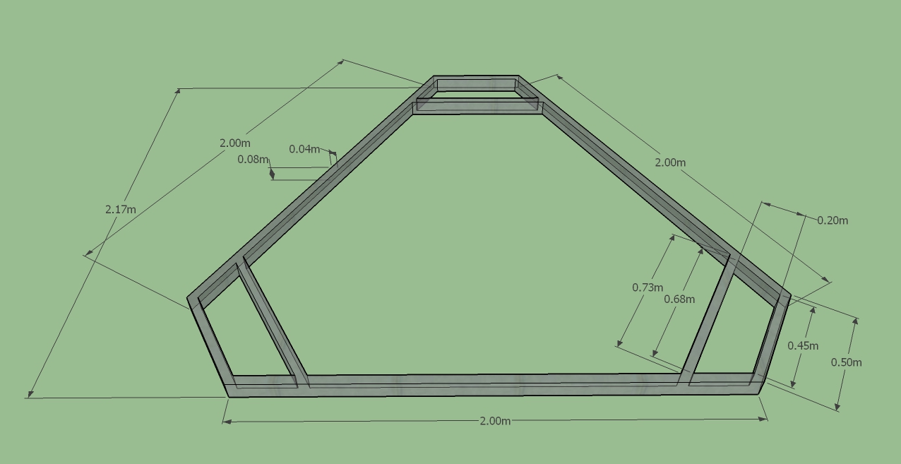

    Hi Every one ...
    Since I didn't document the cutting and welding of this Sim ... I'm getting started into drawing the beginning structure of the base ... here is what is so far playing with the sketch-up 2014 .

    Hi Speedy,
    I'm going to enjoy watching this thread of "your actual build"....
    BTW - Are you using the "free version" of Sketch-Up or did you go the 500.00 route??
    Have a blessed one,
    Tom

    Thanks Tom ... and enjoy watching my friend .:popcorn
    yes I'm using the free version as I came across some videos explained the basics of it :grin ... so I had a solid start " I guess " .:blush

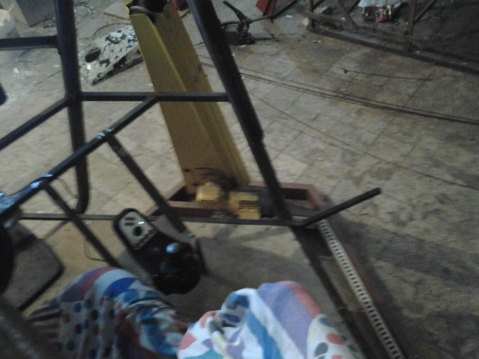

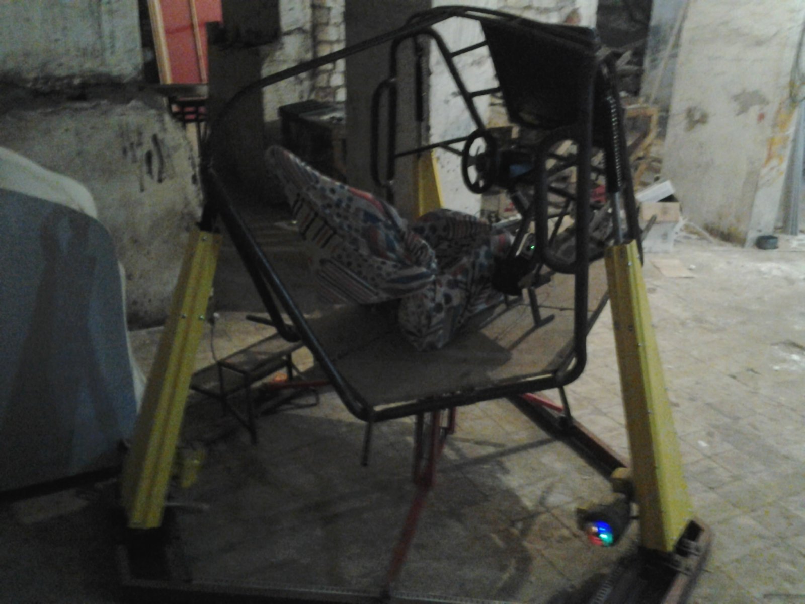

  10. speedy
    Feb 1, 2012
    1,193
    Alexandria , Egypt
    7,948Coins
    +1,287 / 10 / -0

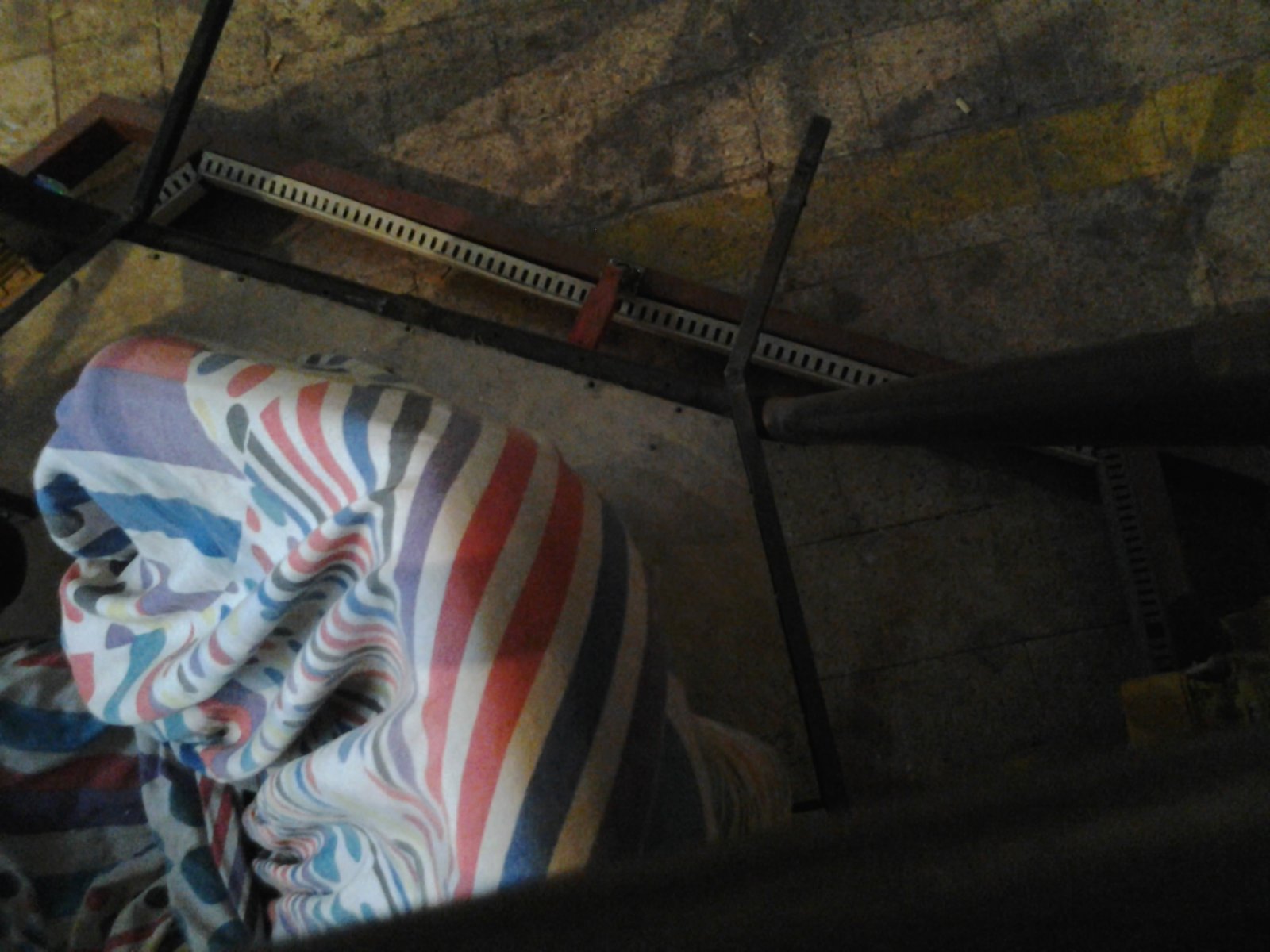

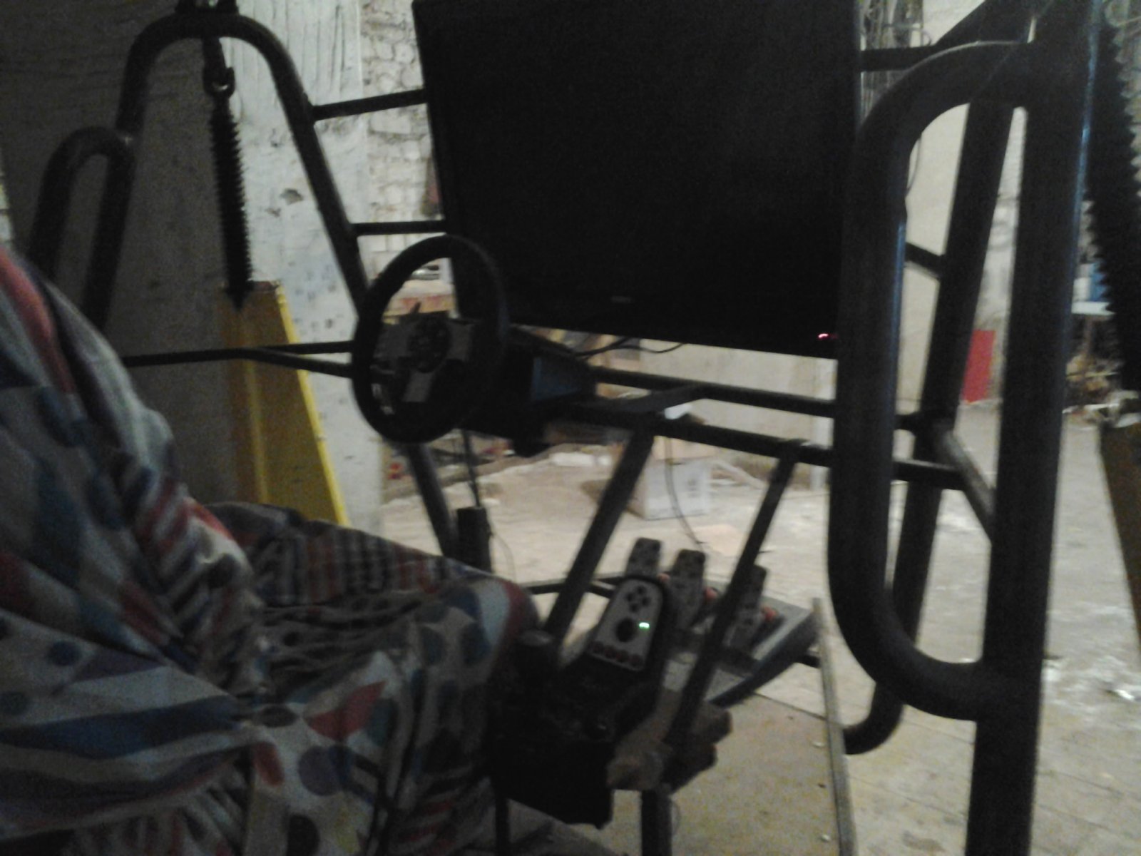

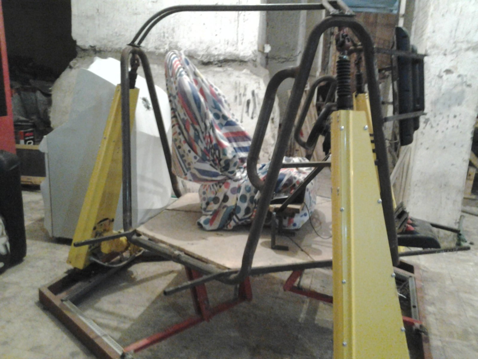

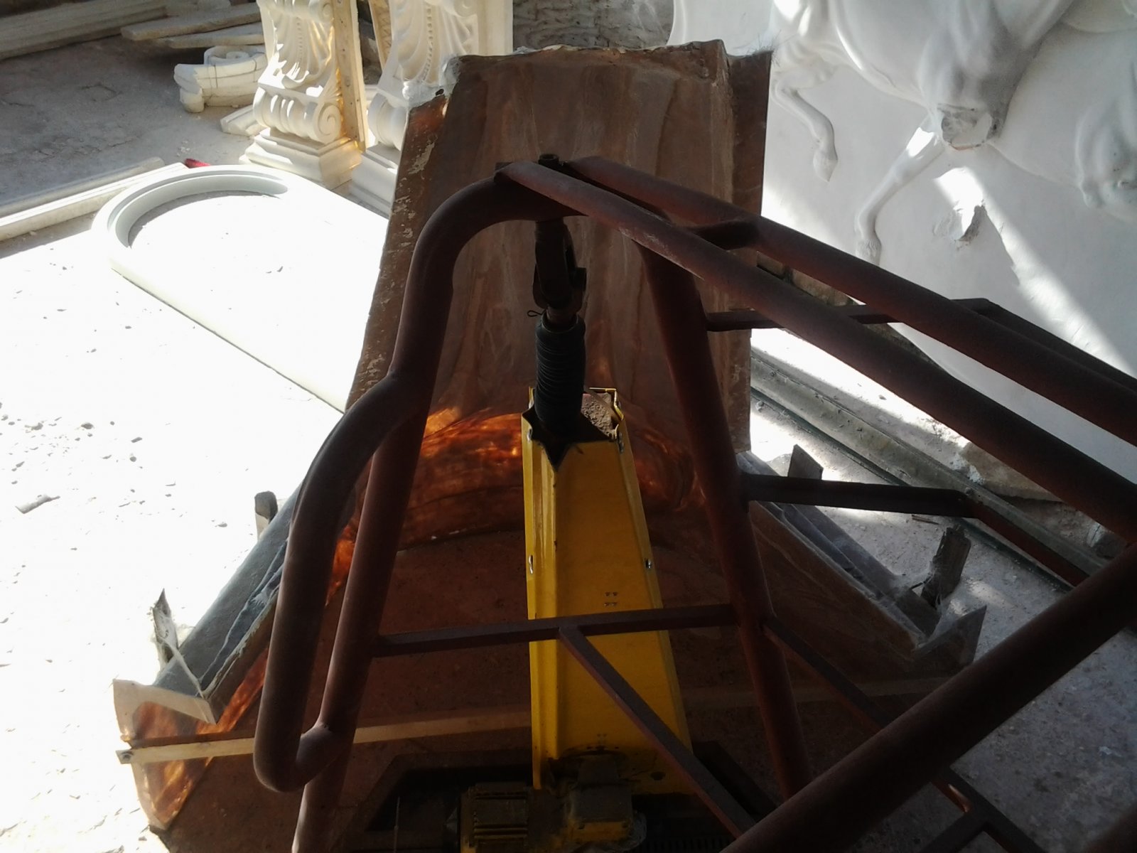

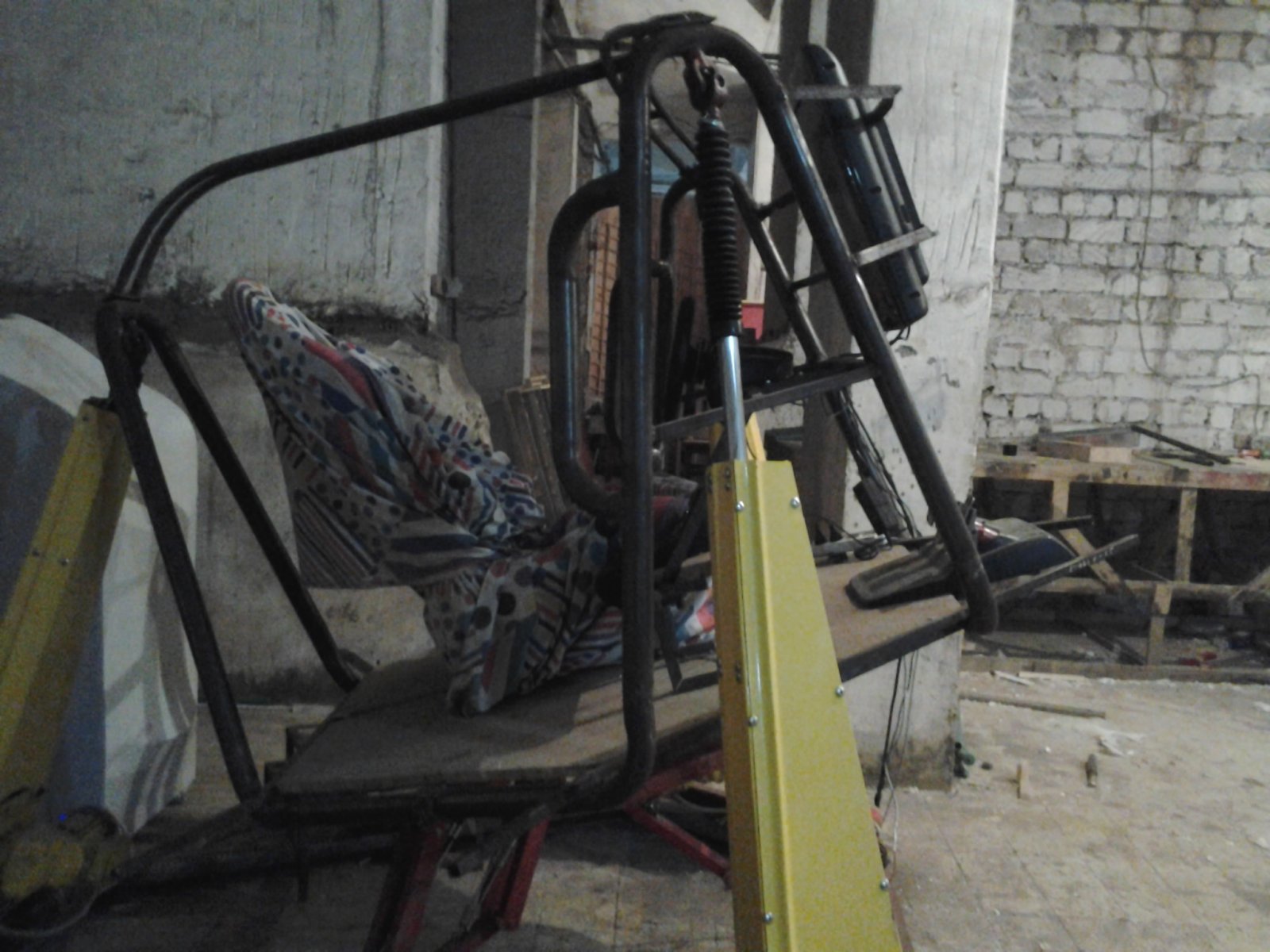

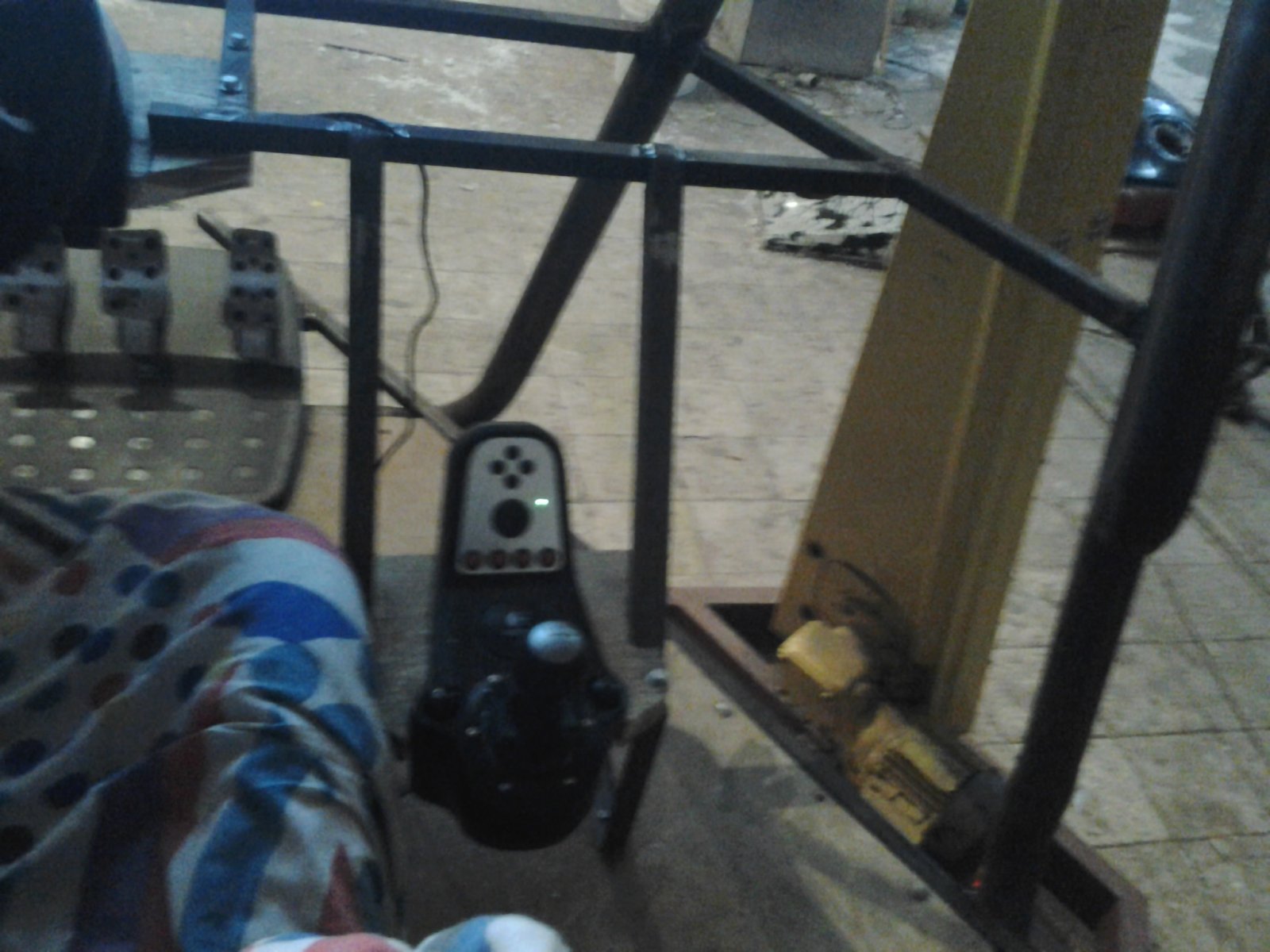

    Wow guys ... I found my lost treasure ... my old 2GB SD phone memory is working ... it seems that only its converter was defected ... It contains tones of things ...
    here is my first metal bender and the welding shop ...
    here is my first testing for actuators under full control from the computer ...
    some photos ...
    2013-07-07 16.06.11.jpg 2013-07-07 16.09.29.jpg 2013-07-08 16.07.05.jpg 2013-07-08 16.07.48.jpg 2013-07-08 16.08.50.jpg 2013-07-12 00.33.58.jpg 2013-07-12 00.34.11.jpg 2013-07-12 00.34.39.jpg 2013-07-12 00.35.47.jpg 2013-07-12 00.36.07.jpg 2013-07-12 00.36.24.jpg 2013-07-12 00.36.39.jpg 2013-07-12 00.37.23.jpg 2013-07-12 00.37.48.jpg

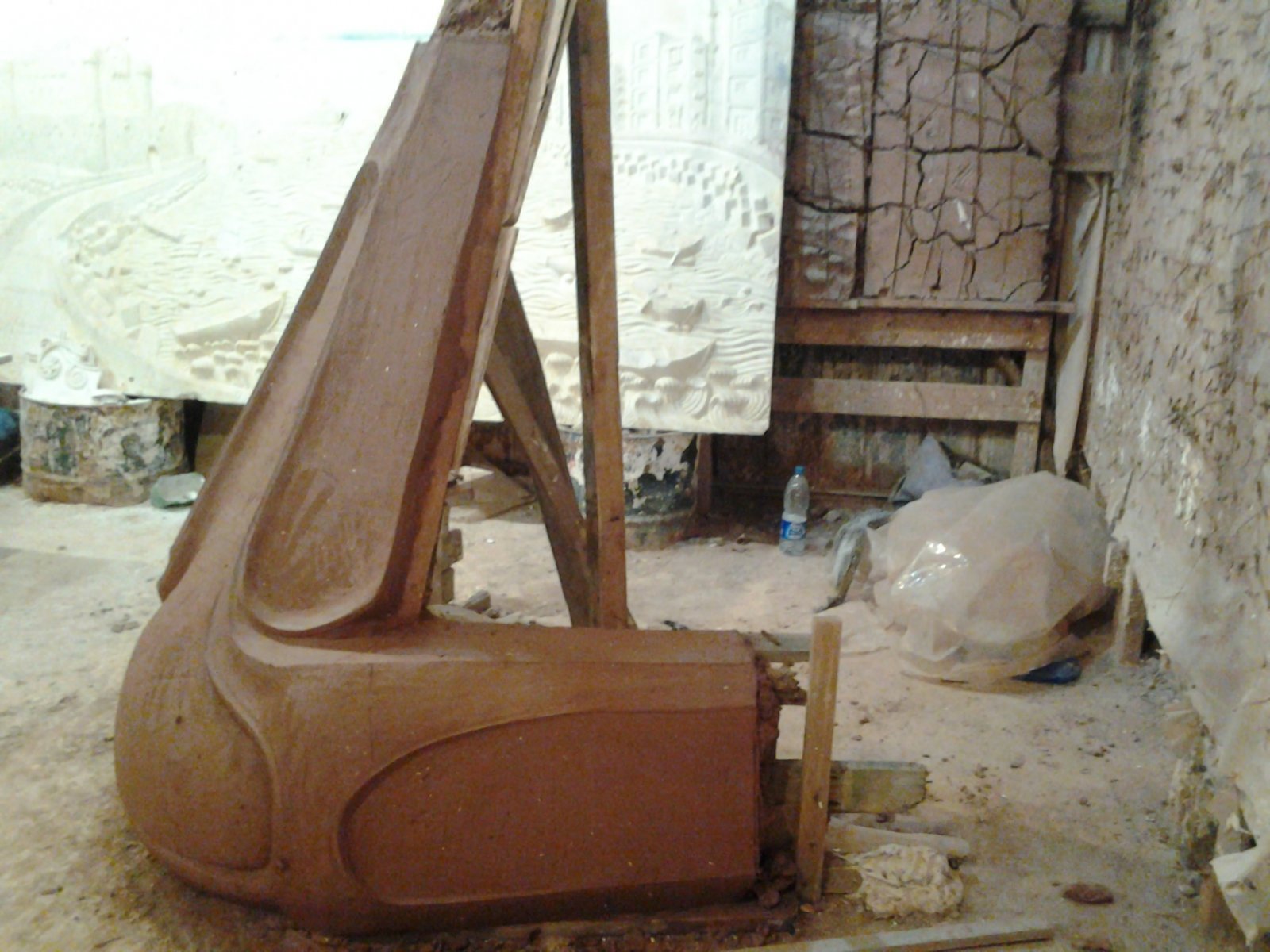

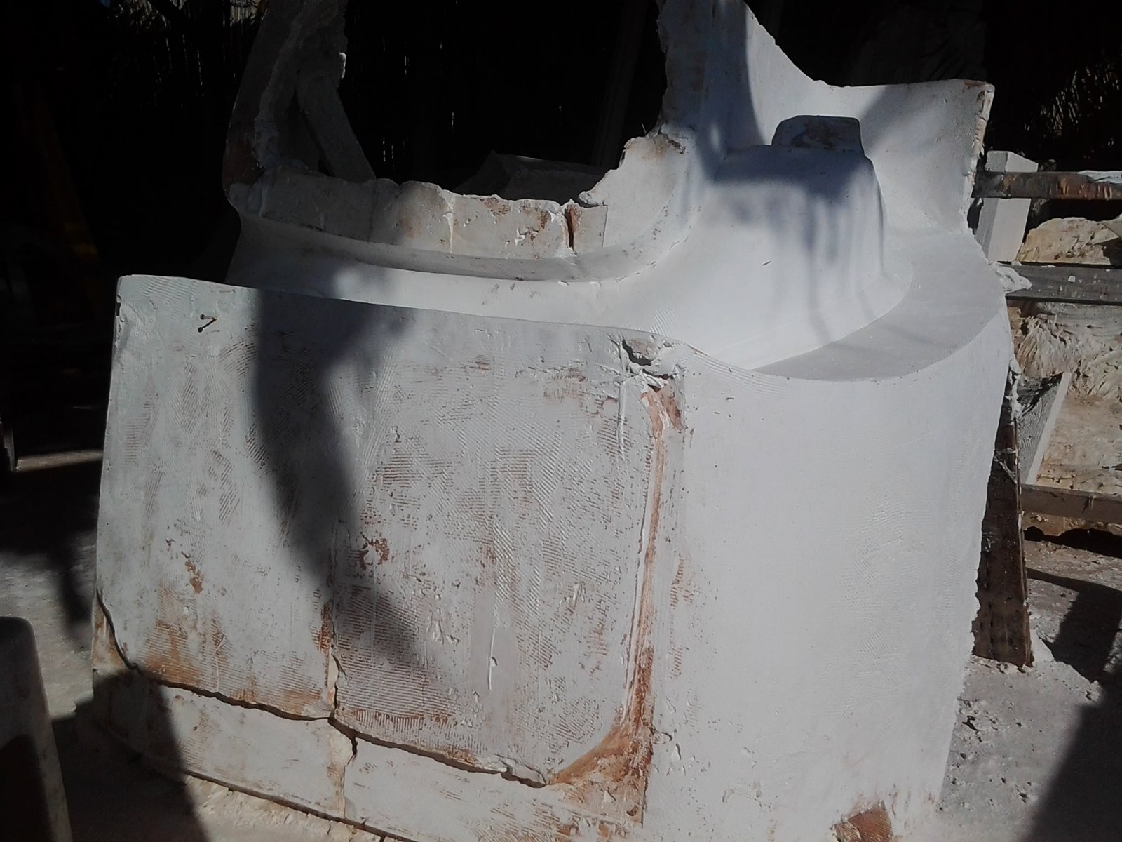

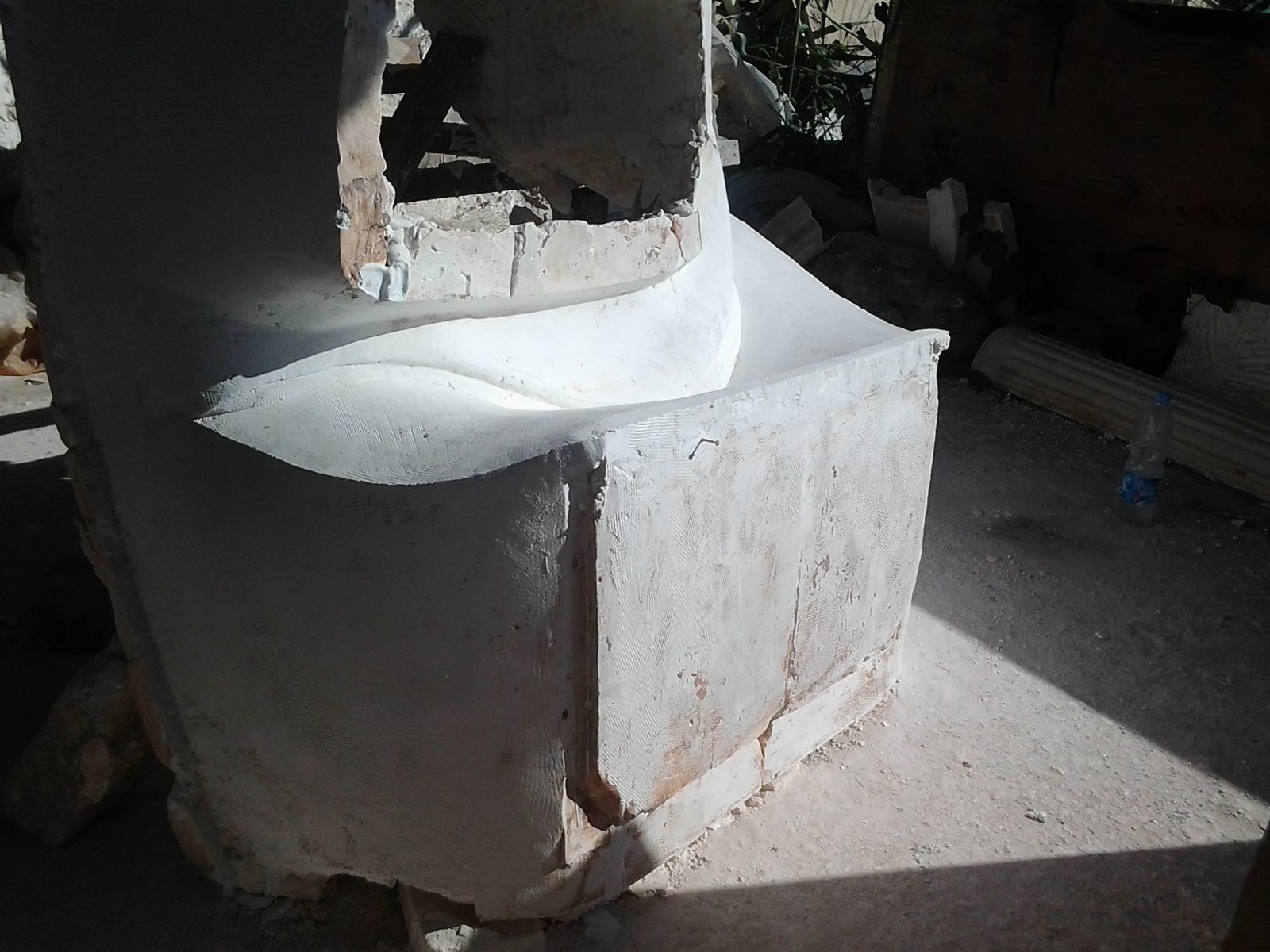

  12. speedy
    Feb 1, 2012
    1,193
    Alexandria , Egypt
    7,948Coins
    +1,287 / 10 / -0

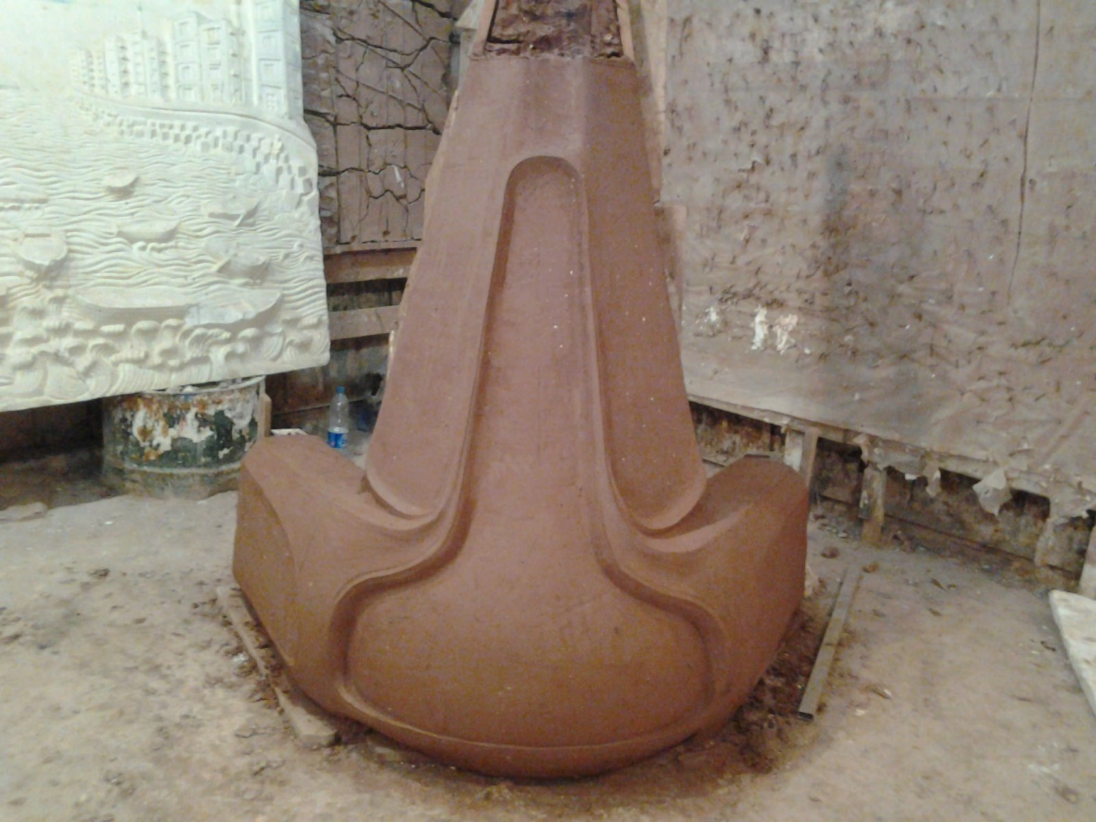

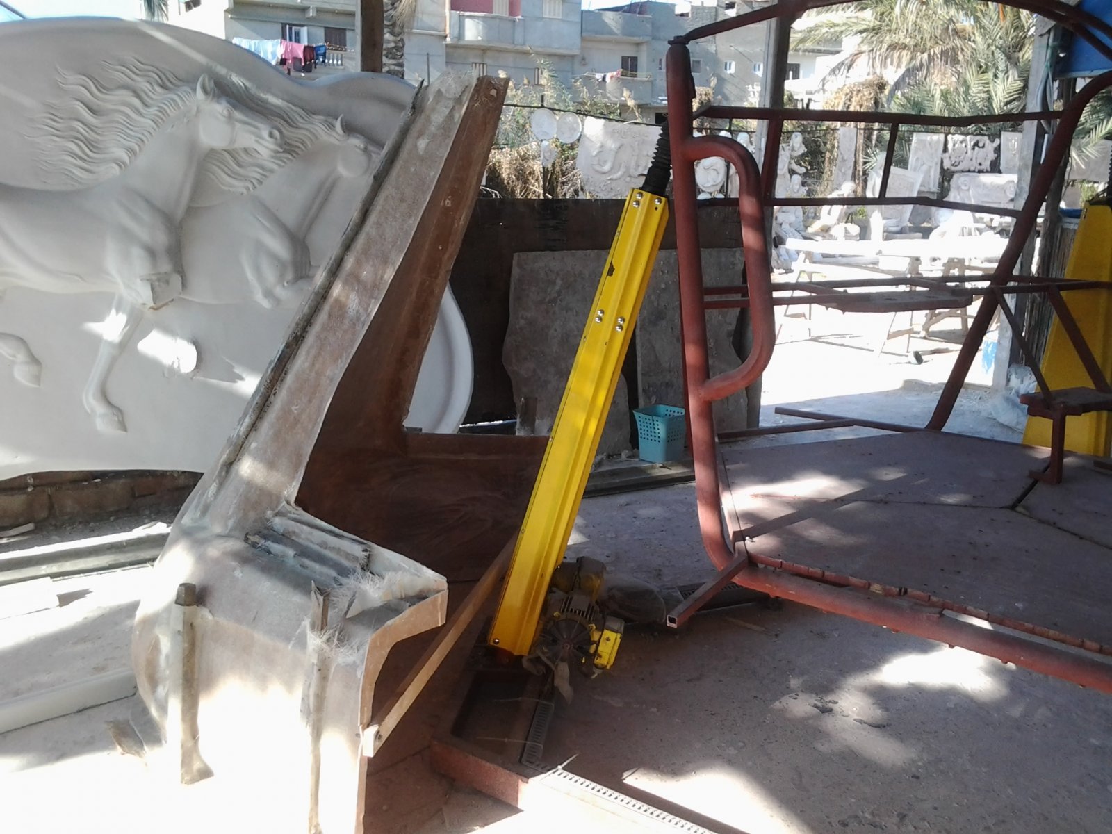

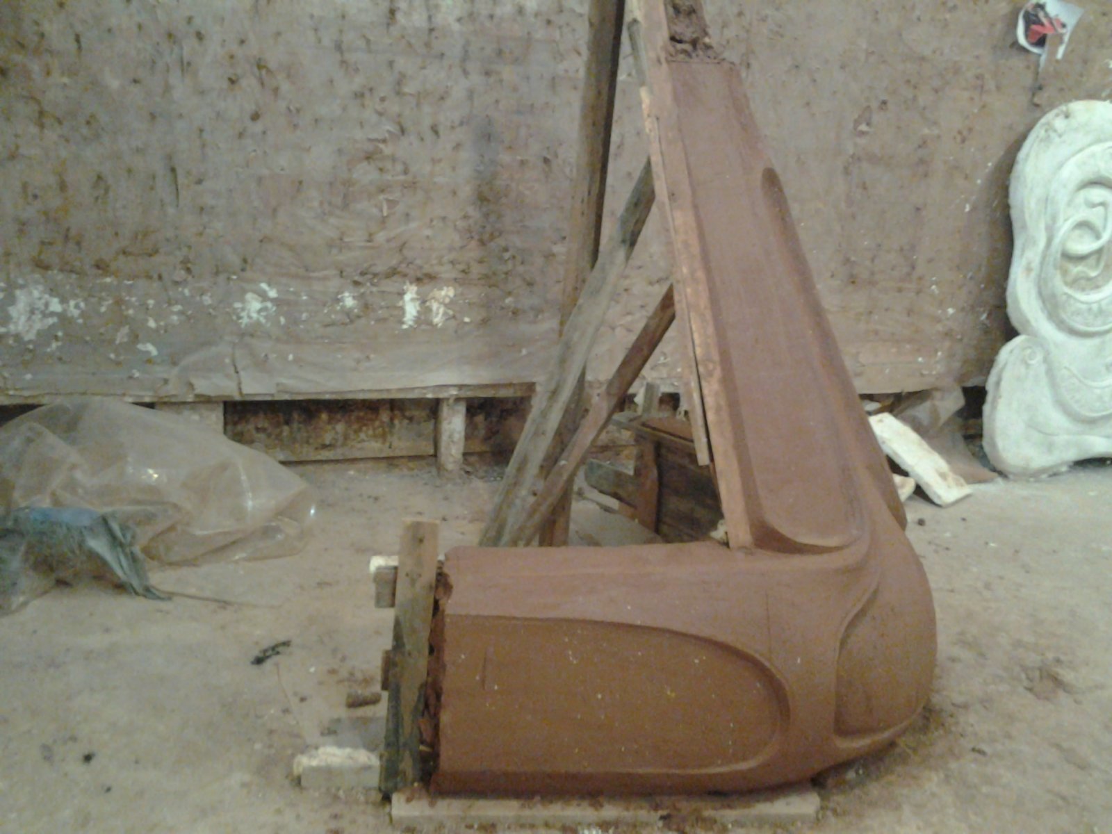

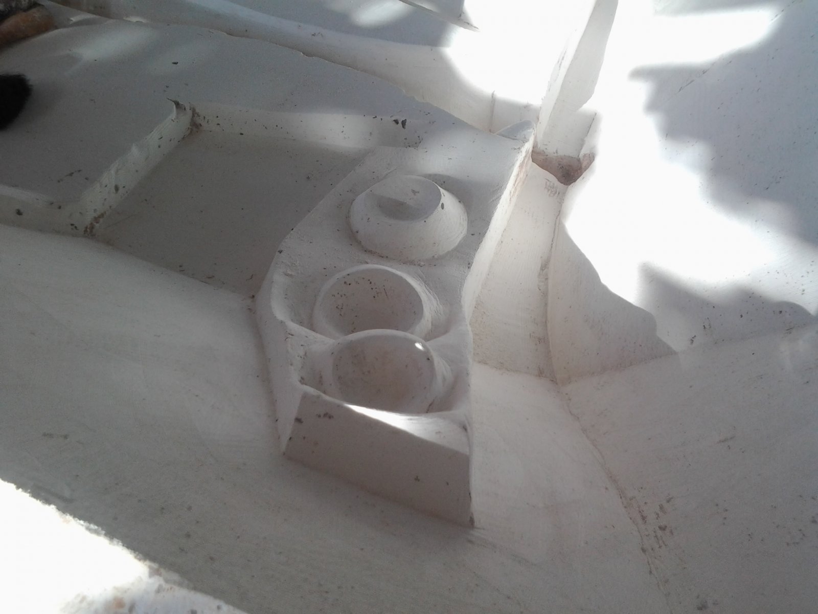

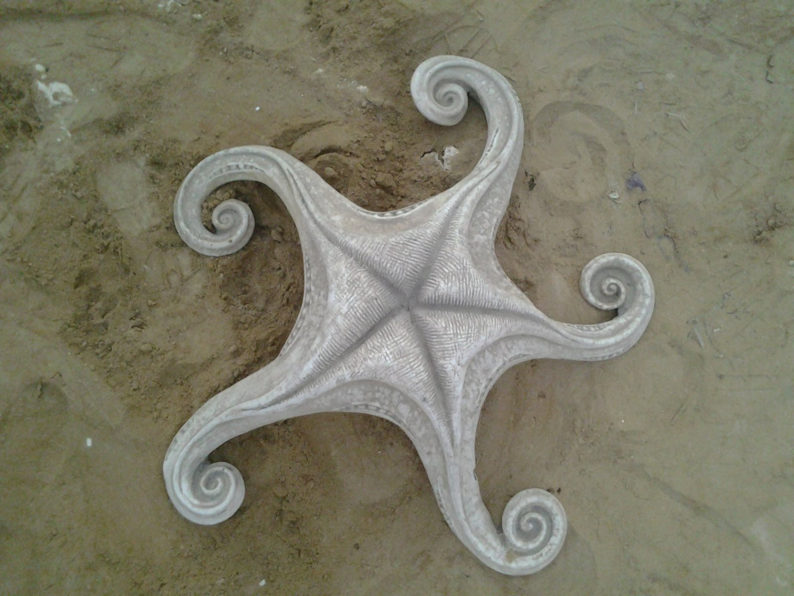

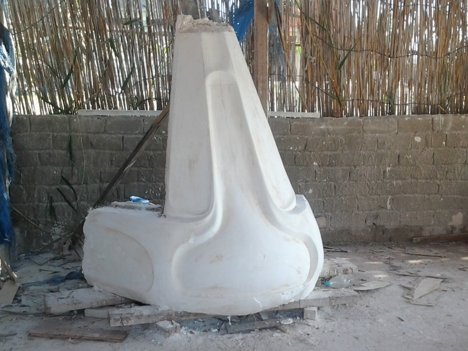

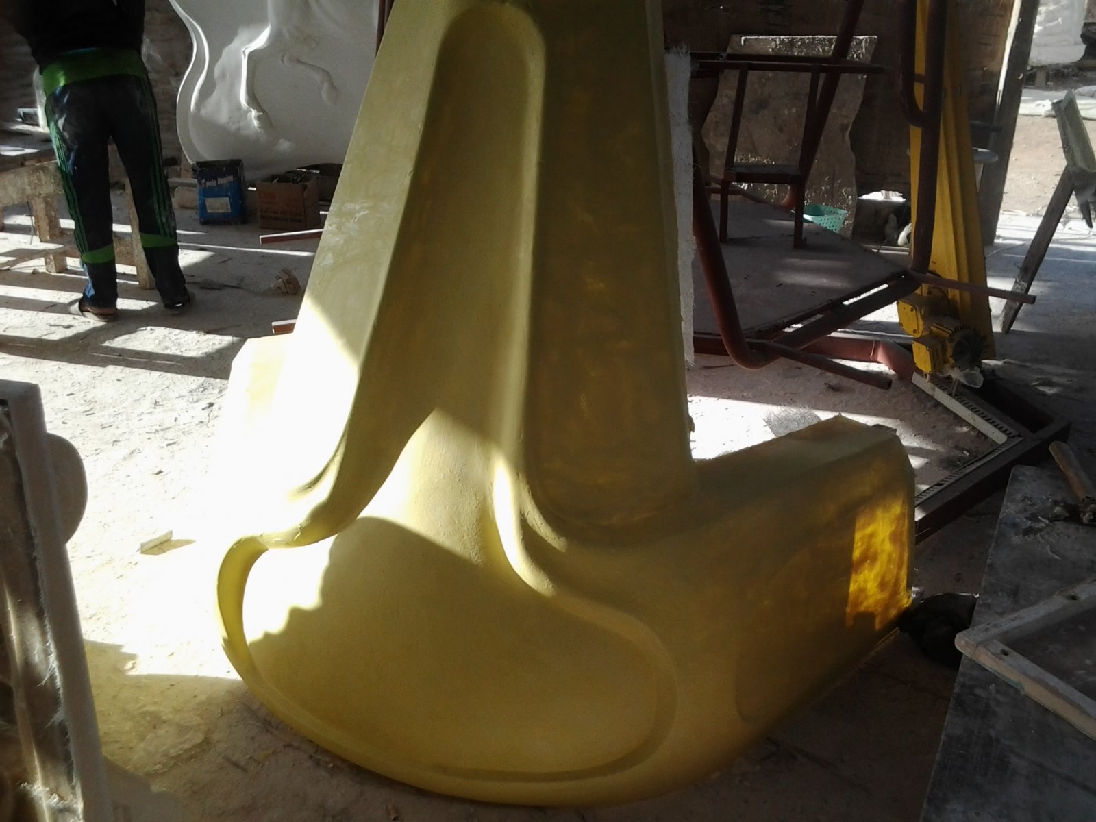

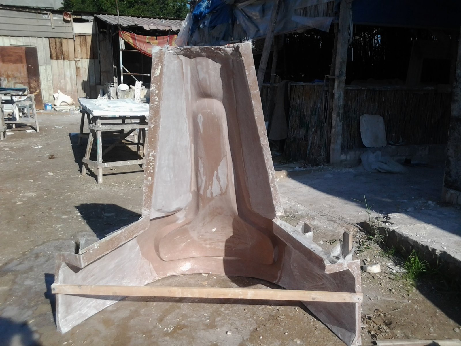

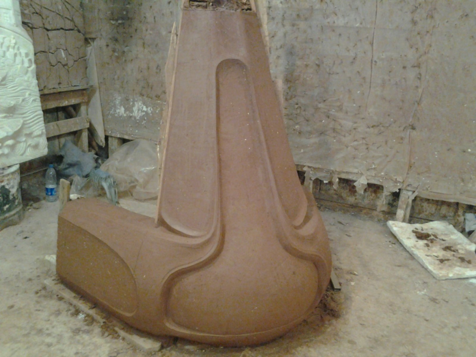

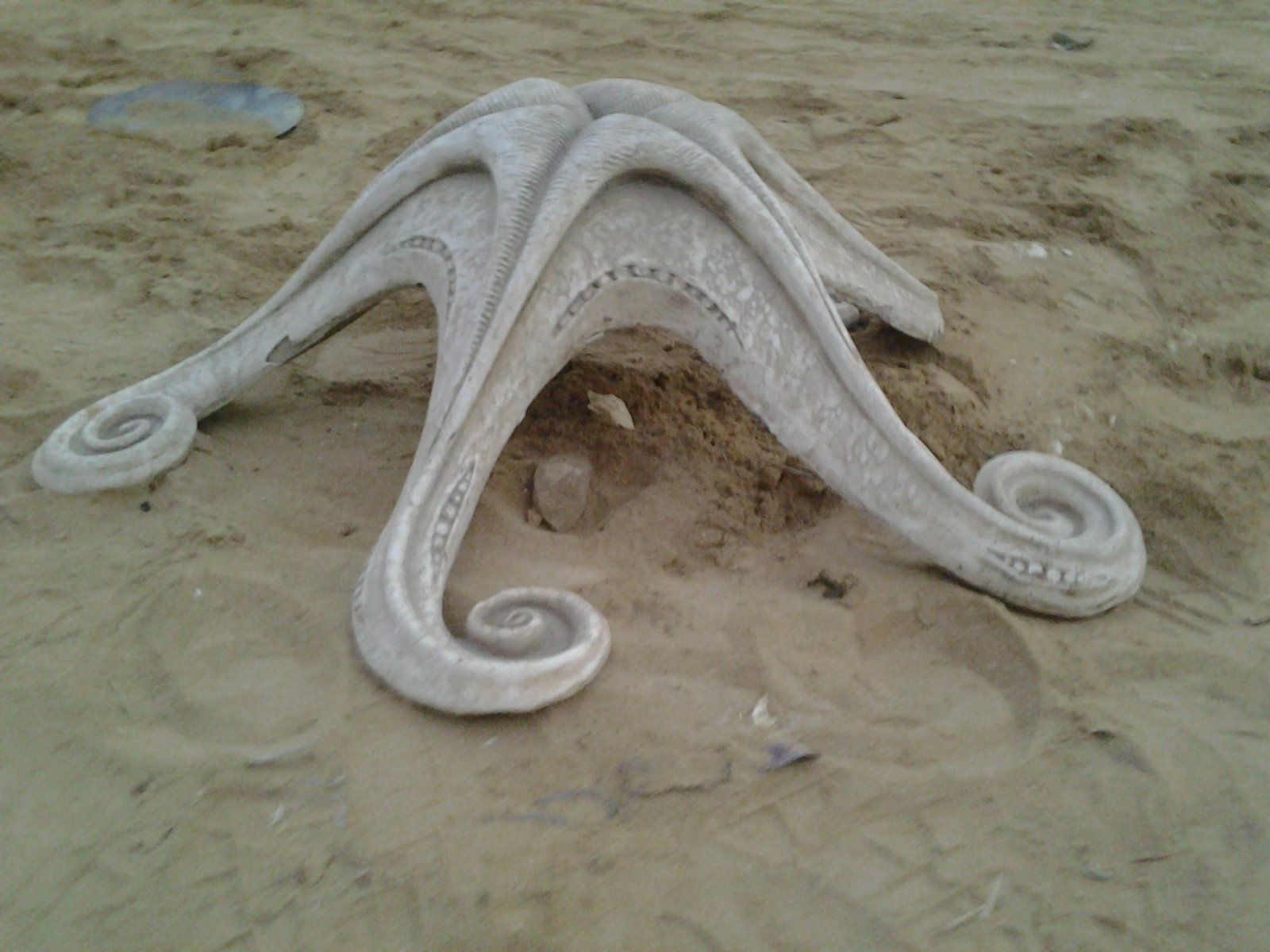

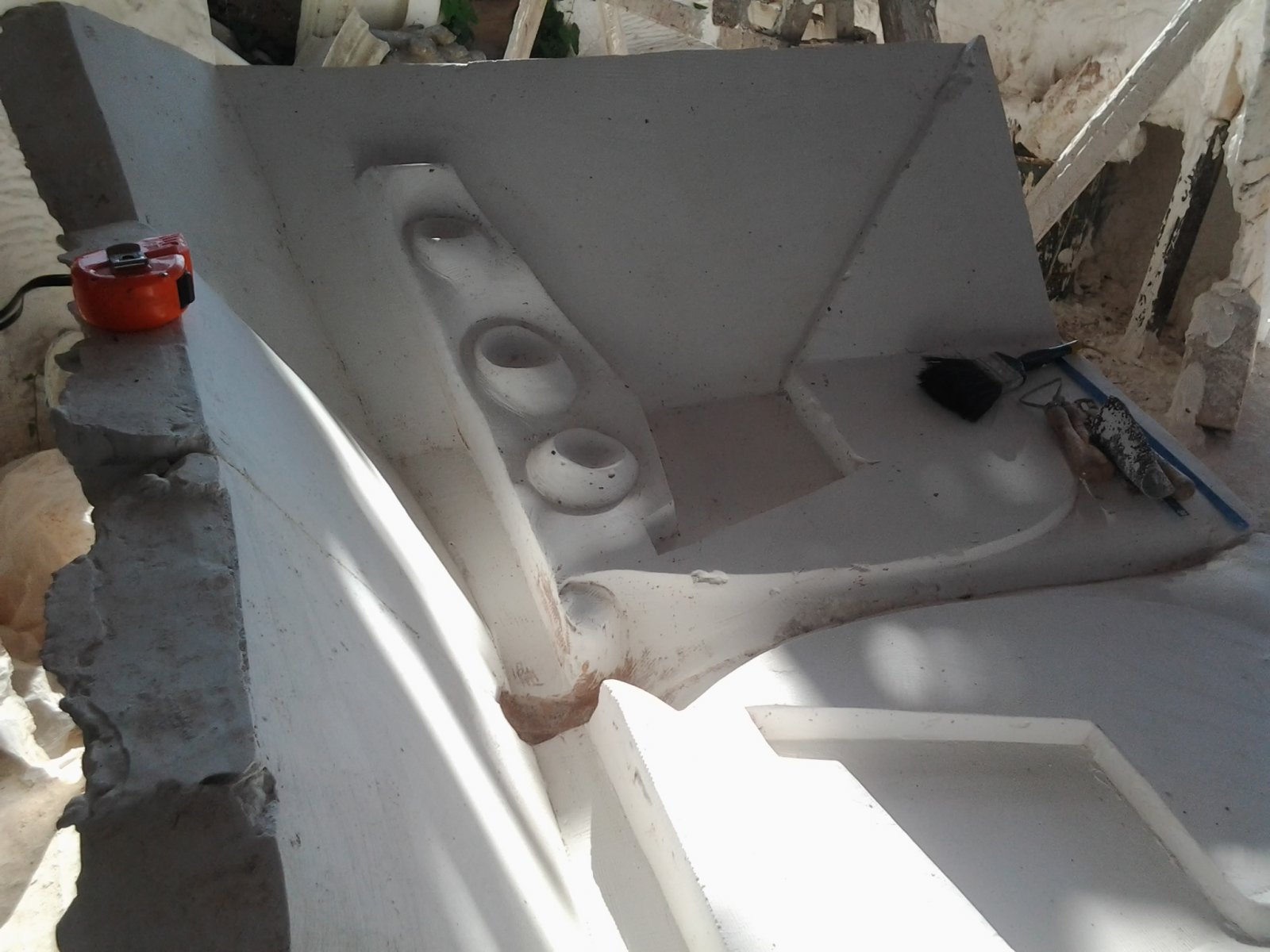

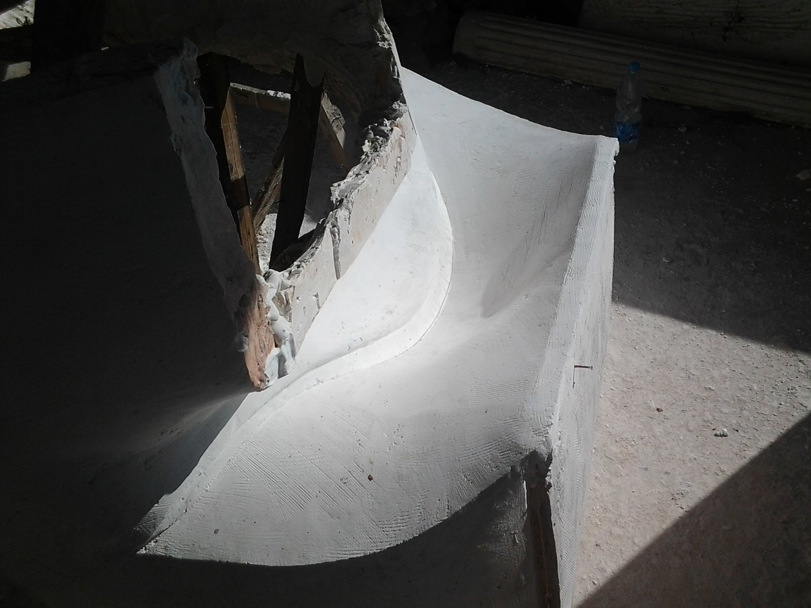

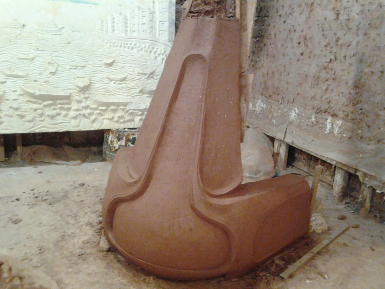

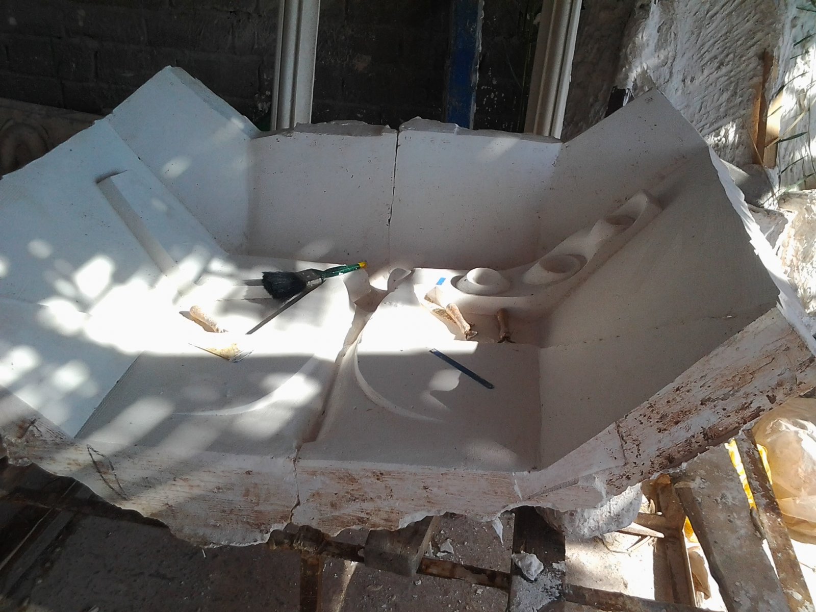

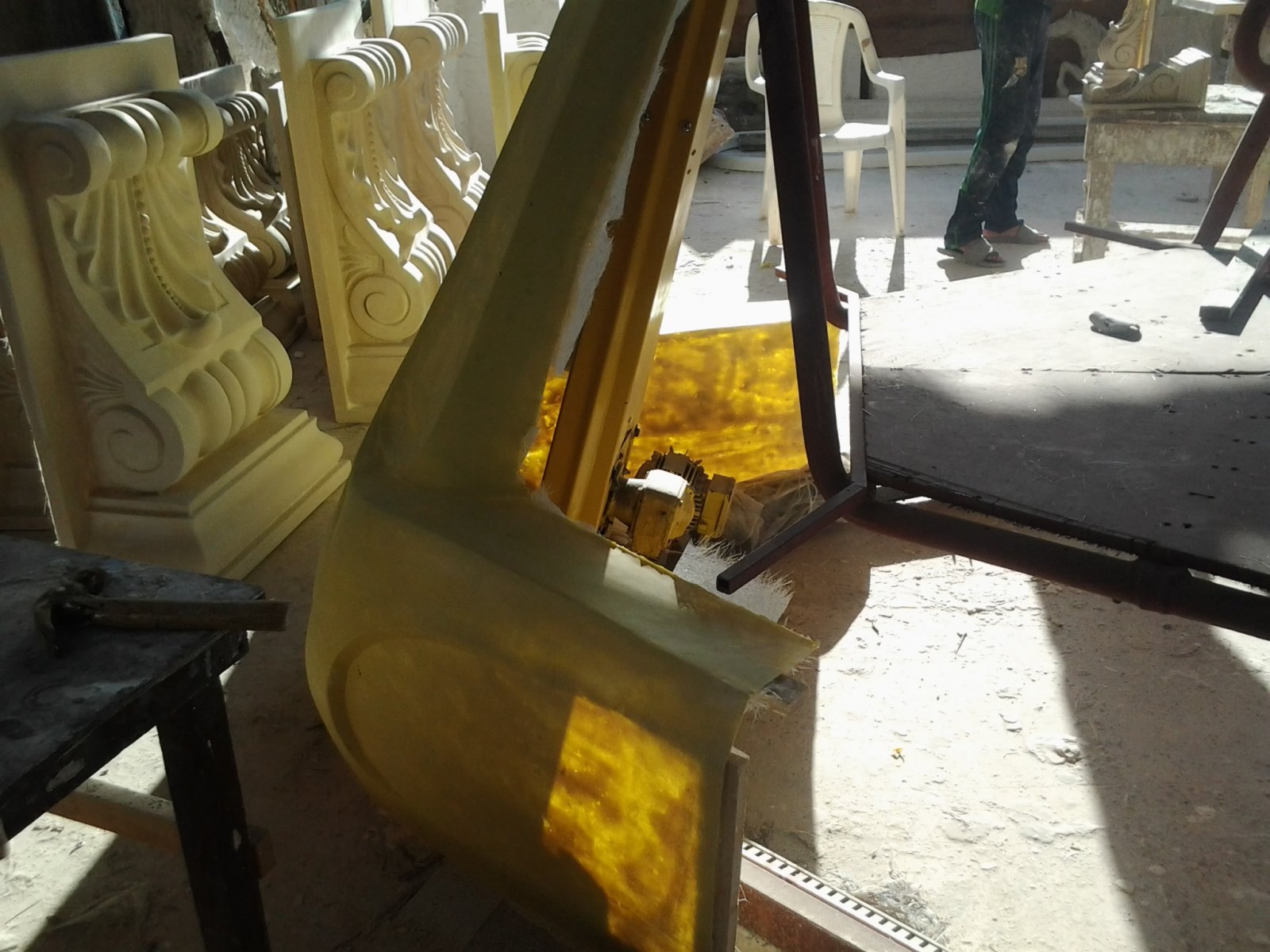

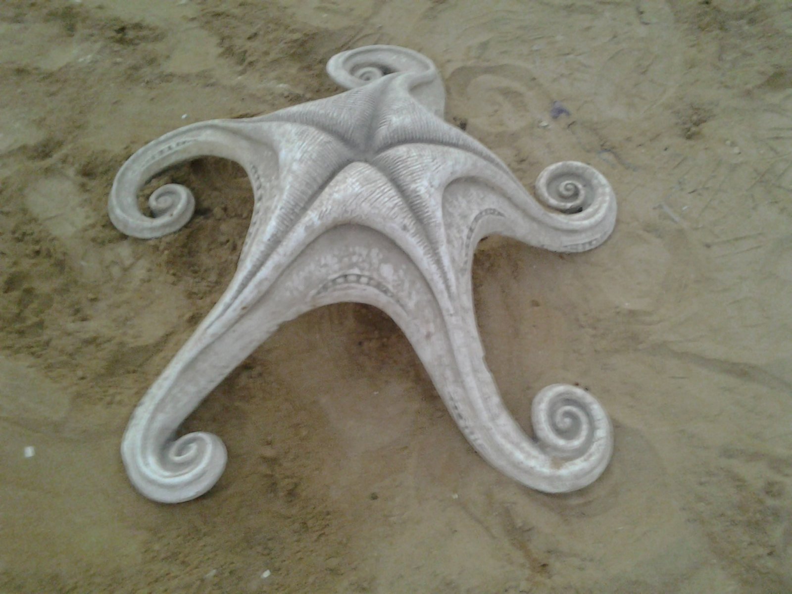

    @pitstopp ... you're going to Love this ... every one else too :thumbs
    Mud sculpture ... One of my friend Atelier.
    2013-10-31 17.22.57.jpg 2013-10-31 17.23.14.jpg 2013-10-31 17.24.03.jpg 2013-12-29 17.59.53.jpg 2013-12-29 18.00.49.jpg 2013-12-29 18.01.09.jpg 2013-12-29 17.49.08.jpg 2013-12-29 18.00.23.jpg 2013-12-29 18.01.38.jpg
    2nd Gypsum form ...
    molding form ...
    2014-02-19 15.23.39.jpg 2014-02-19 15.23.55.jpg 2014-02-19 15.24.24.jpg 2014-02-19 15.28.05.jpg 2014-02-19 15.28.29.jpg 2014-02-19 15.29.07.jpg 2014-02-19 15.31.01.jpg 2014-02-19 15.35.46.jpg 2014-02-19 15.36.13.jpg 2014-02-19 15.38.17.jpg 2014-02-19 15.39.41.jpg 2014-02-19 15.41.31.jpg 2014-02-19 15.42.00.jpg 2014-02-19 15.42.33.jpg 2014-02-19 15.42.50.jpg
    molding of the sides cover ... sorry the first 30 sec :grin I was looking the other side .
    2014-02-24 16.11.21.jpg 2014-02-24 16.13.29.jpg 2014-02-27 16.16.22.jpg 2014-02-27 16.17.59.jpg 2014-02-27 16.19.28.jpg 2014-02-27 16.20.26.jpg 2014-02-27 16.22.11.jpg 2014-02-24 16.12.02.jpg

  15. speedy
    Feb 1, 2012
    1,193
    Alexandria , Egypt
    7,948Coins
    +1,287 / 10 / -0

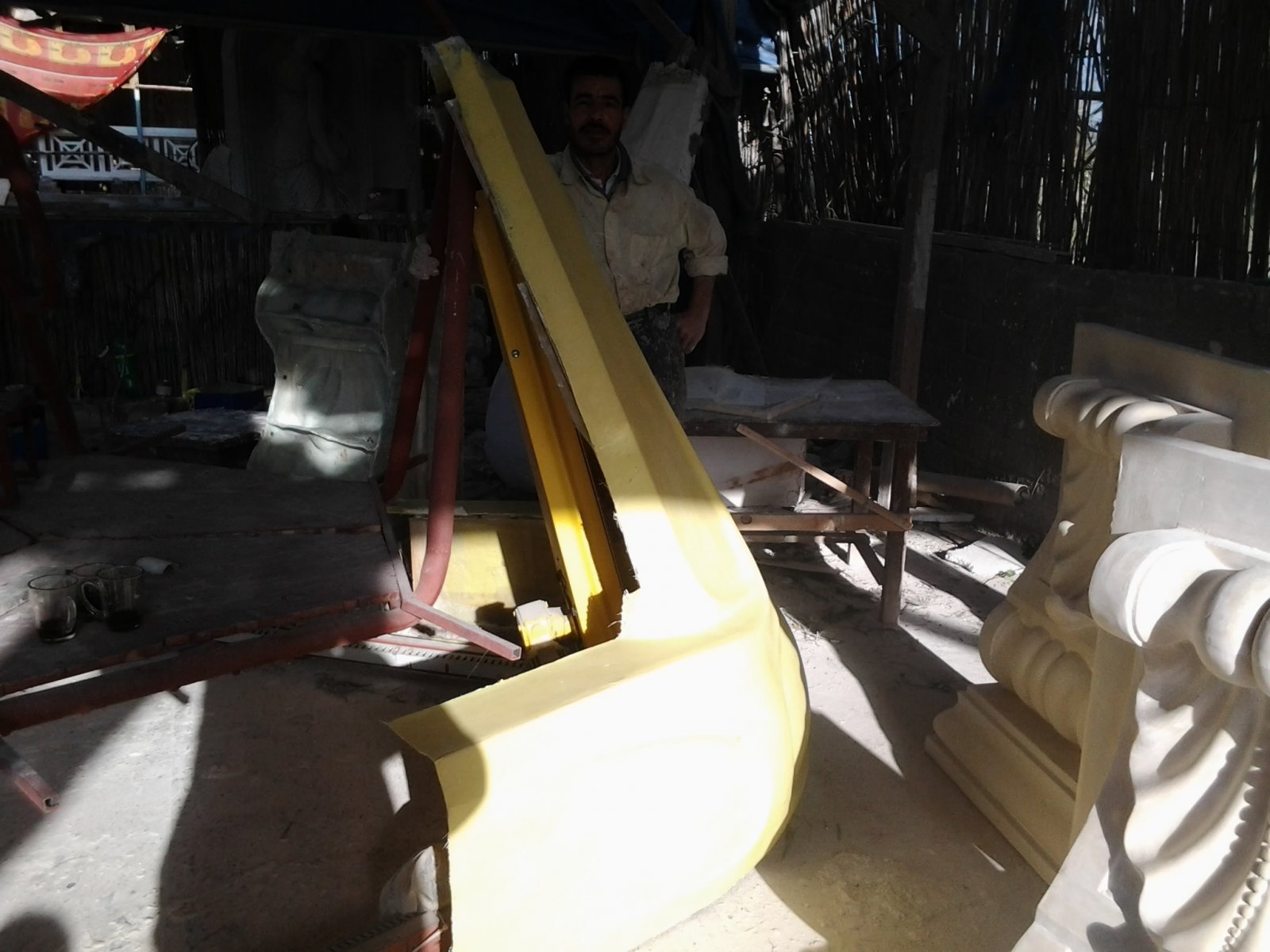

    Thanks guys ... really appreciate your replies ... from my behalf I'm very lucky having you all too ... Good Friends worth a lot.
    Congratulations to me for photos and videos are back :grin ...

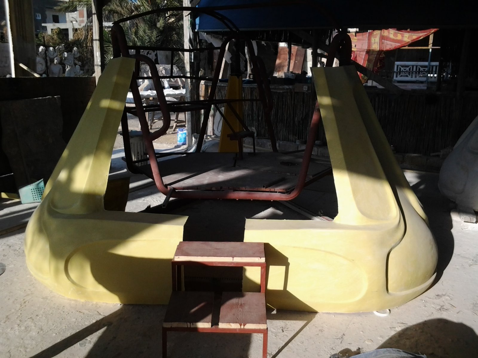

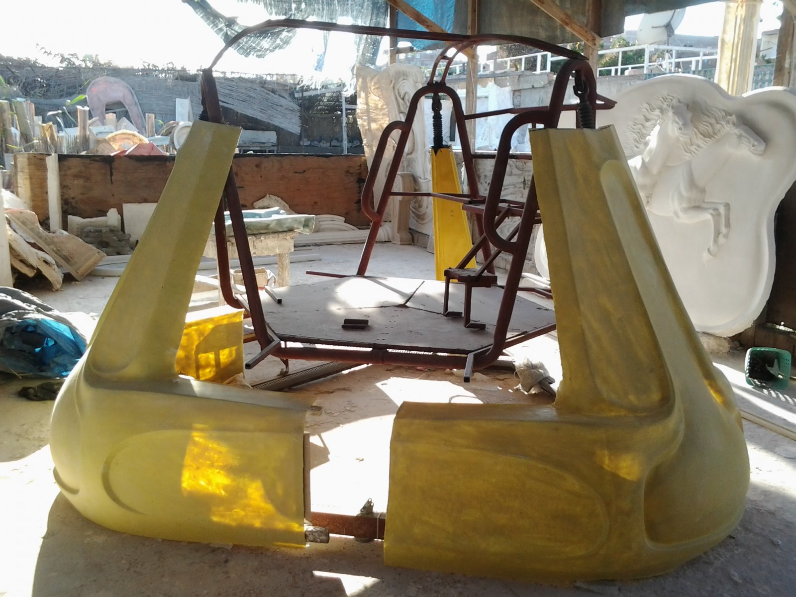

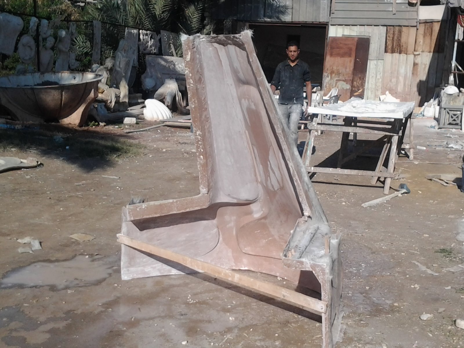

    Thinking big is NOT my idea Mike @AceOfSpies ... The Sculptor nick name "Meto" the one with the brown jersey and blue jeans in video ... one day "10-15Y" he asked me to make hem an "Electrical Control Panel" for a big sculpture of Egypt mainland with flashing and running lights details for demonstrating the pipe lines of a petroleum company named SUMED " Suez-Mediterranean pipeline" that runs all across the country from the Red sea till the Mediterranean sea ...
    The sculpture is presented in front of the big owners in one of the company events and was a Big Magnet to Every one in the presentation meeting ... and a smash hit for Meto :thumbs because he is a good sculptor .
    Now when I asked Meto for his help doing the fiberglass dashboard ... He insisted to make it a full scale capsule ... what should I say then ?

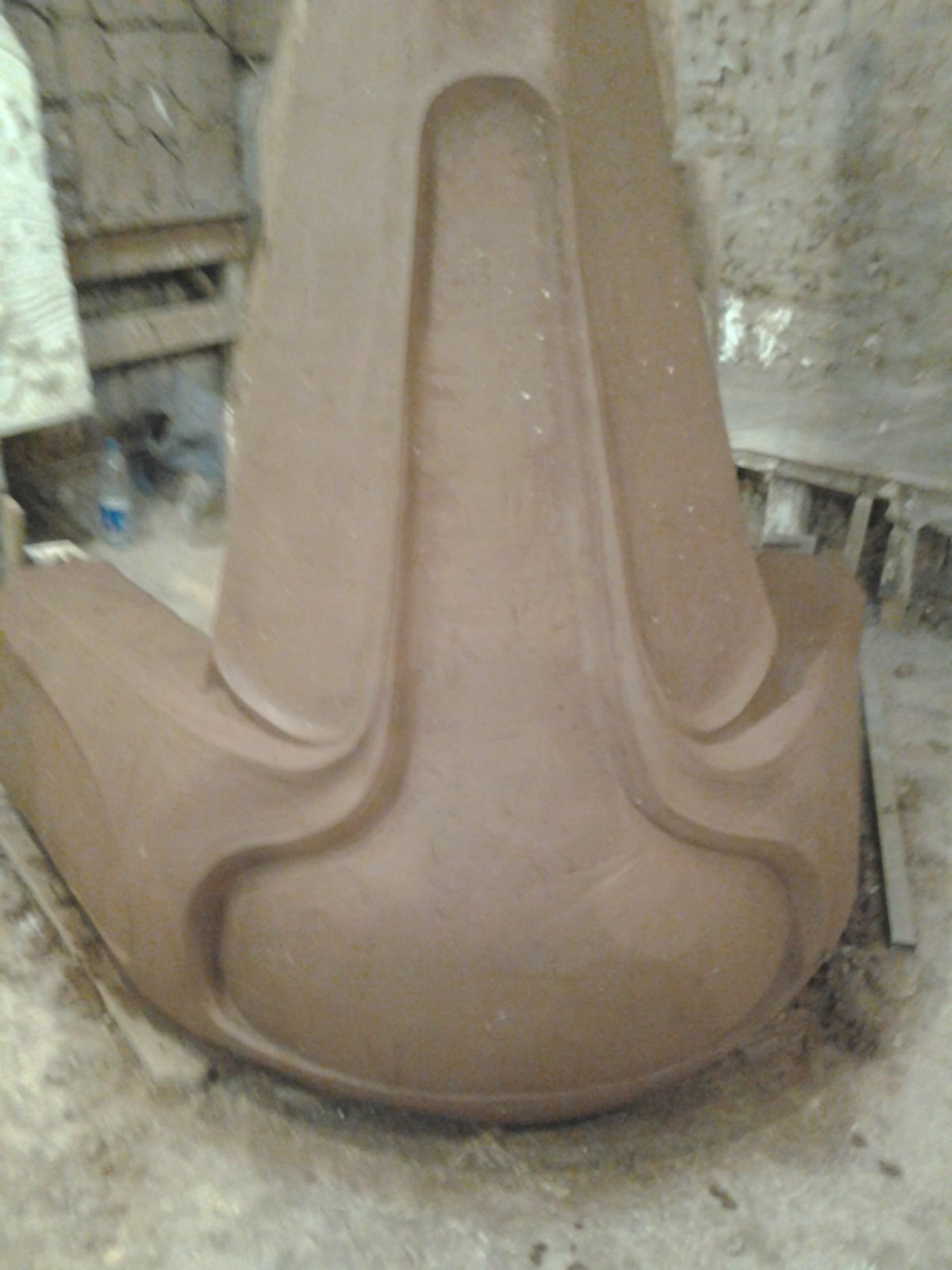

  16. speedy
    Feb 1, 2012
    1,193
    Alexandria , Egypt
    7,948Coins
    +1,287 / 10 / -0

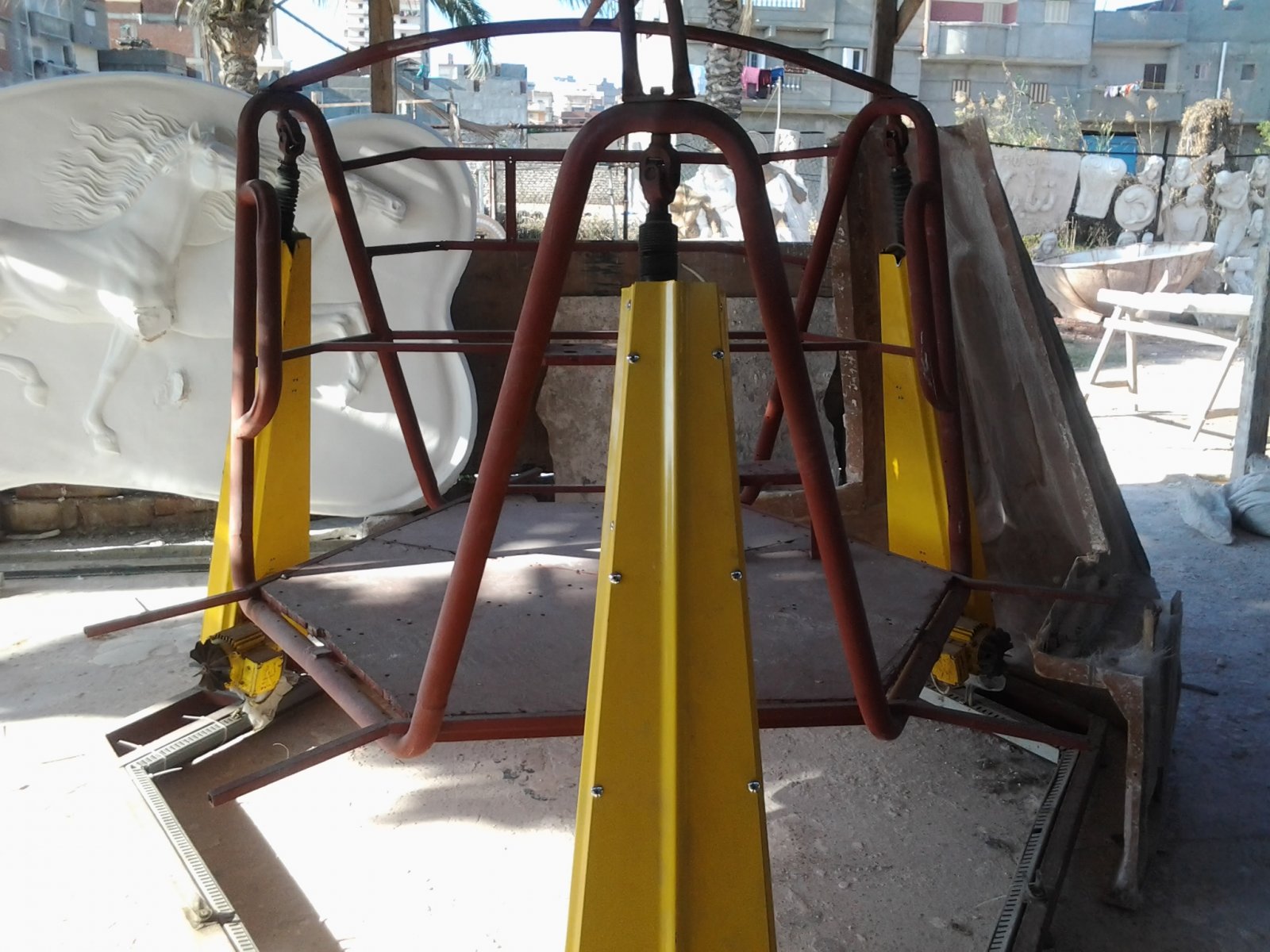

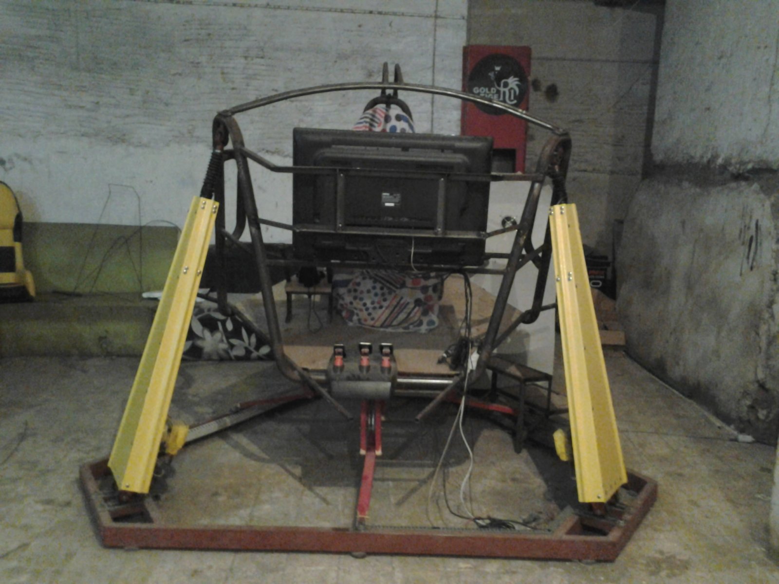

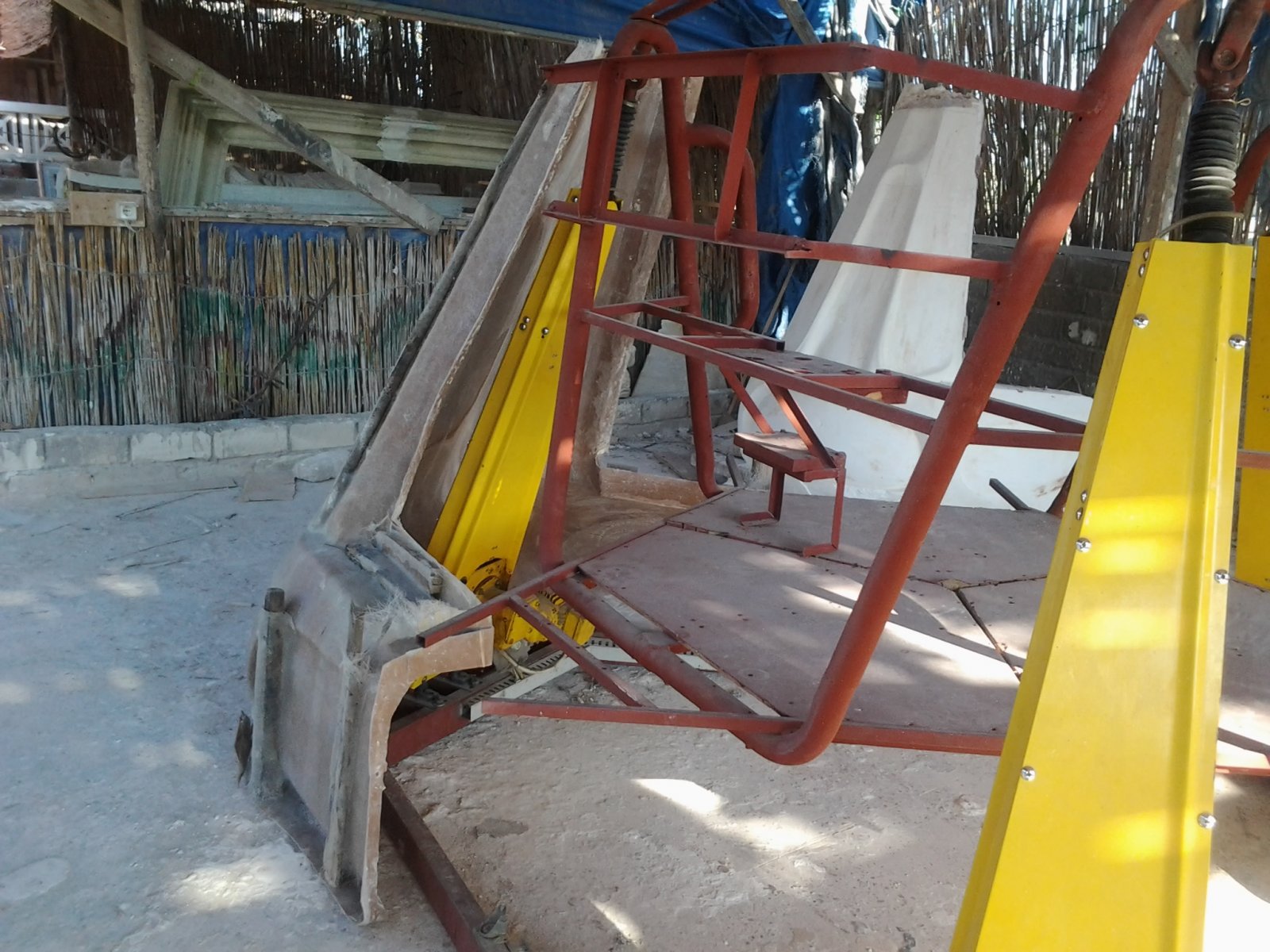

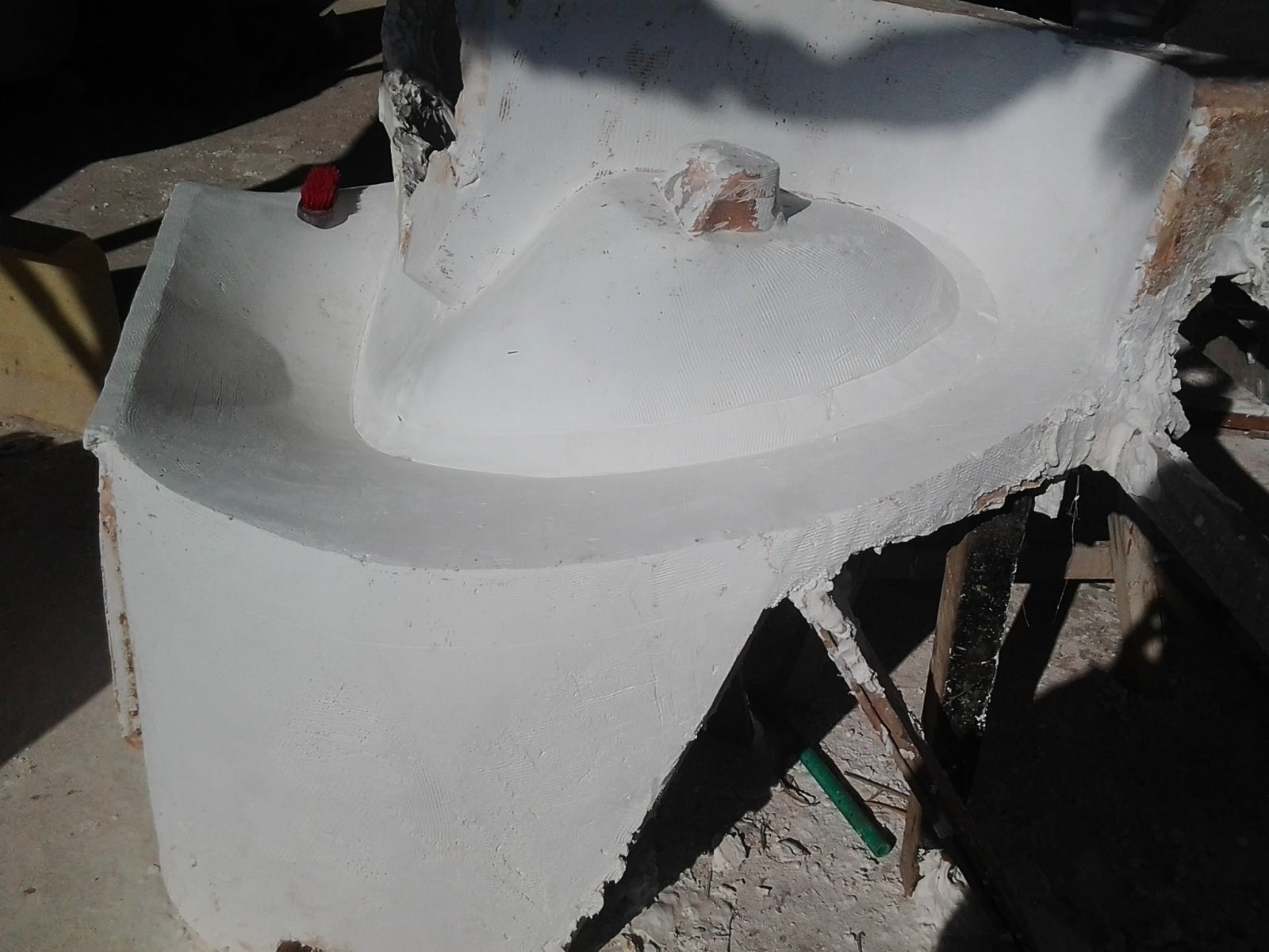

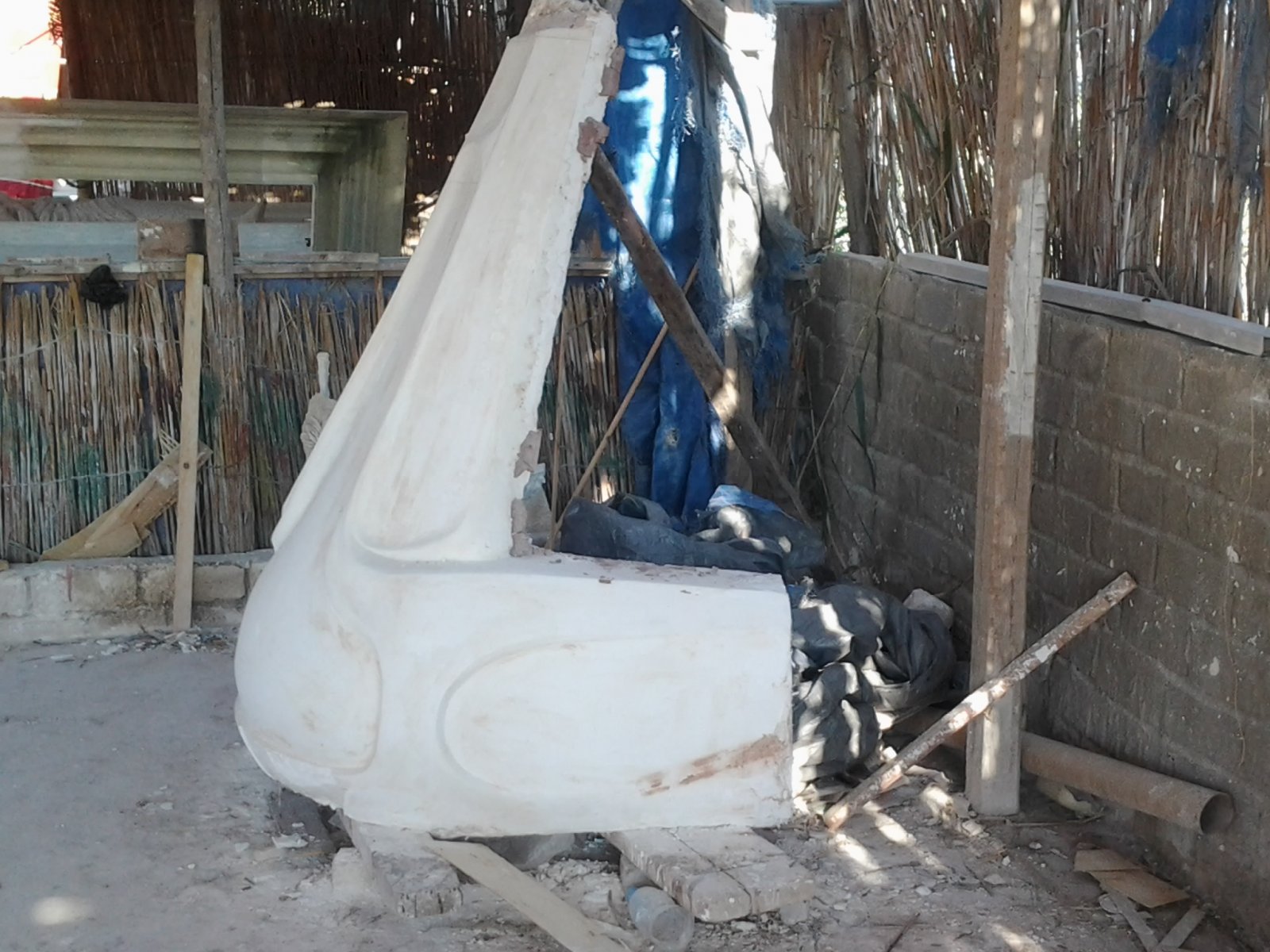

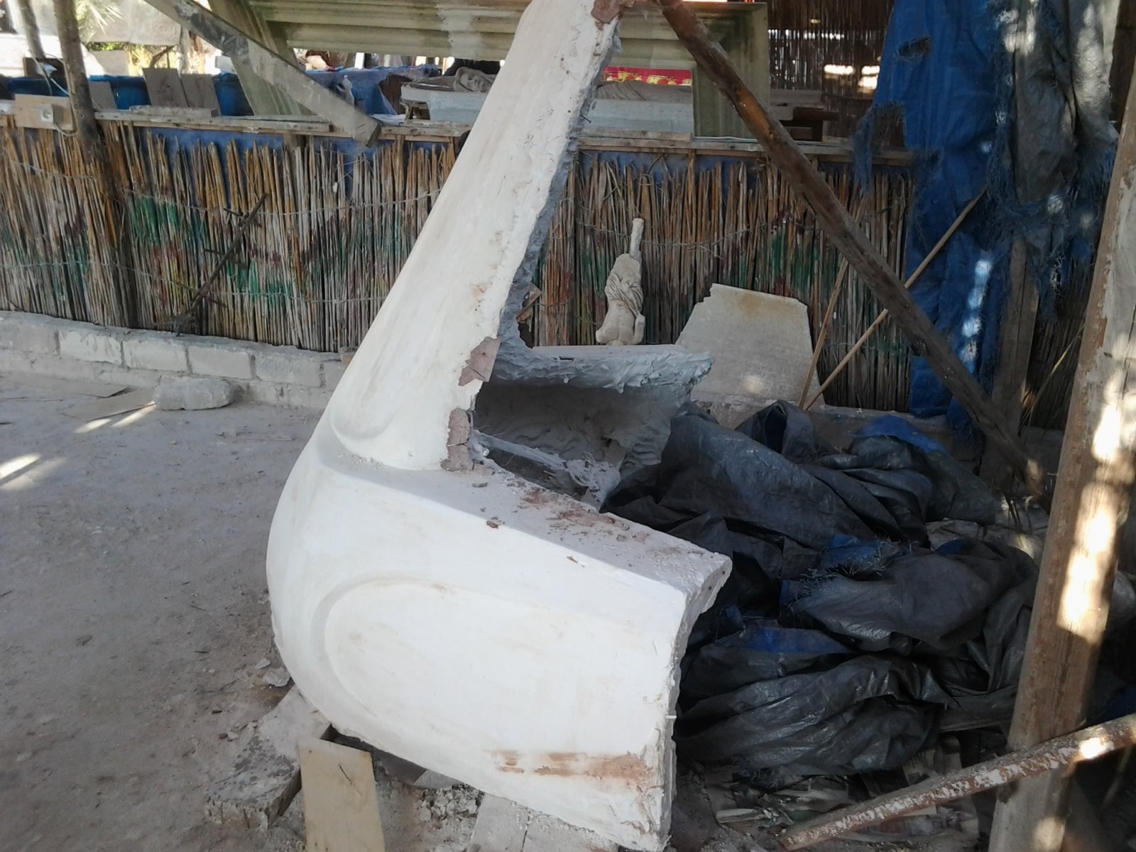

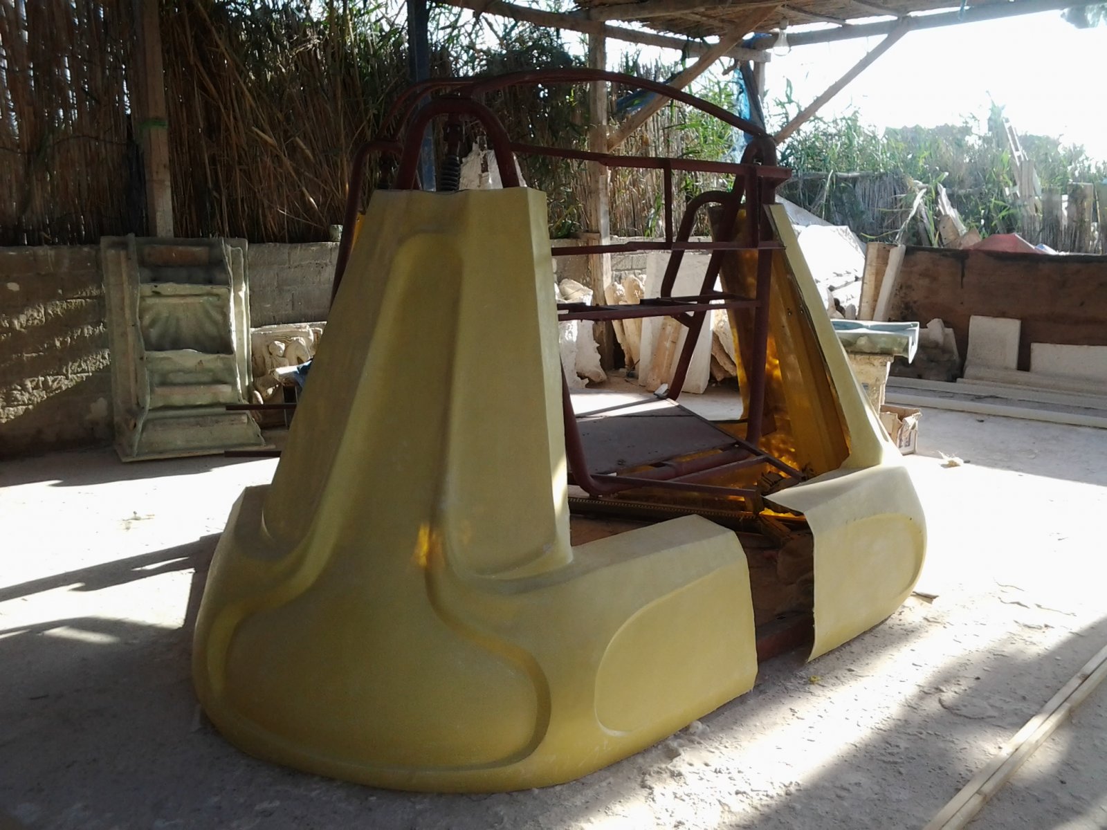

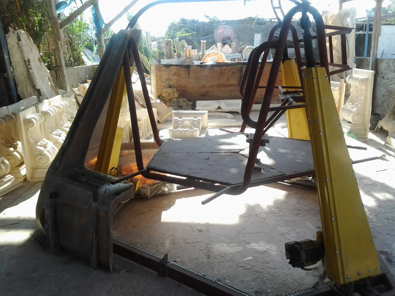

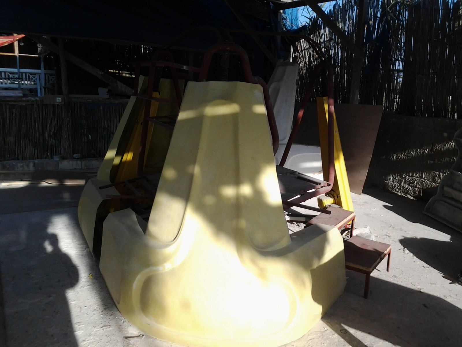

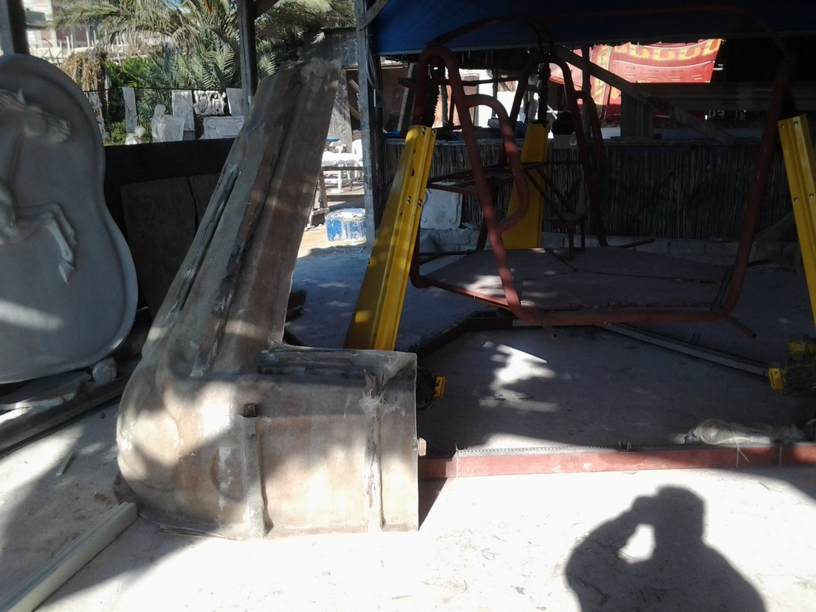

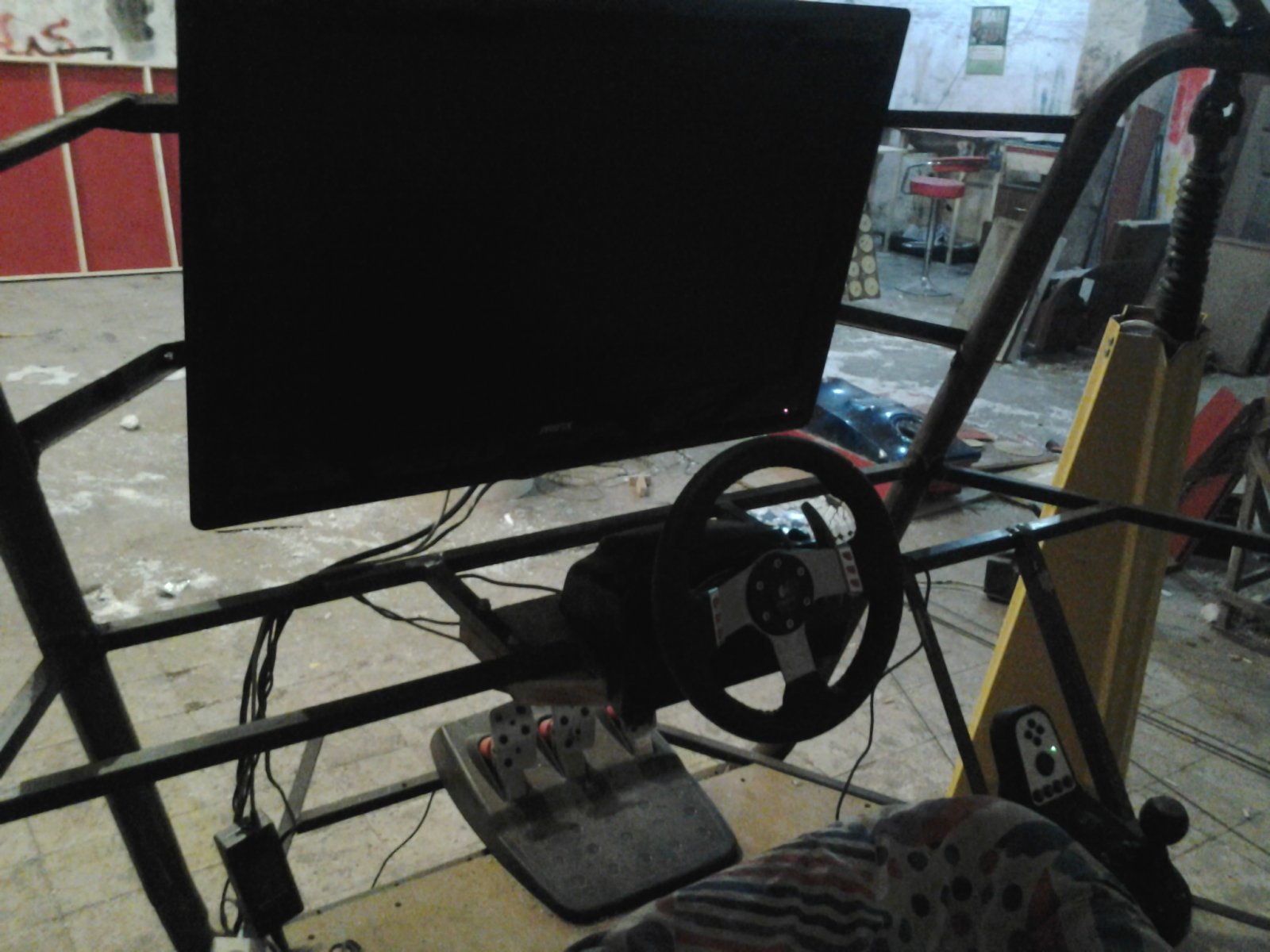

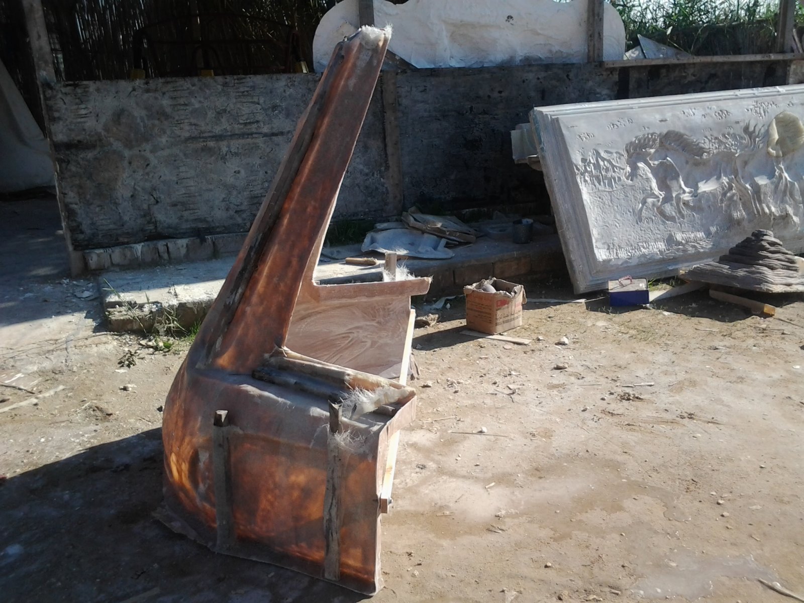

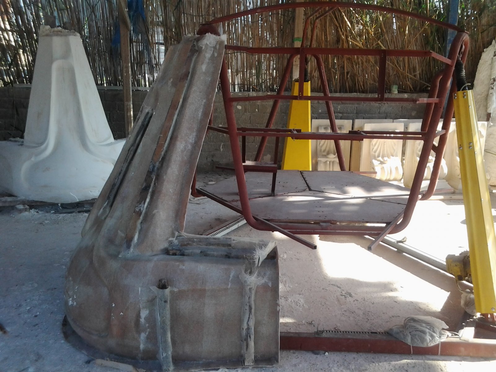

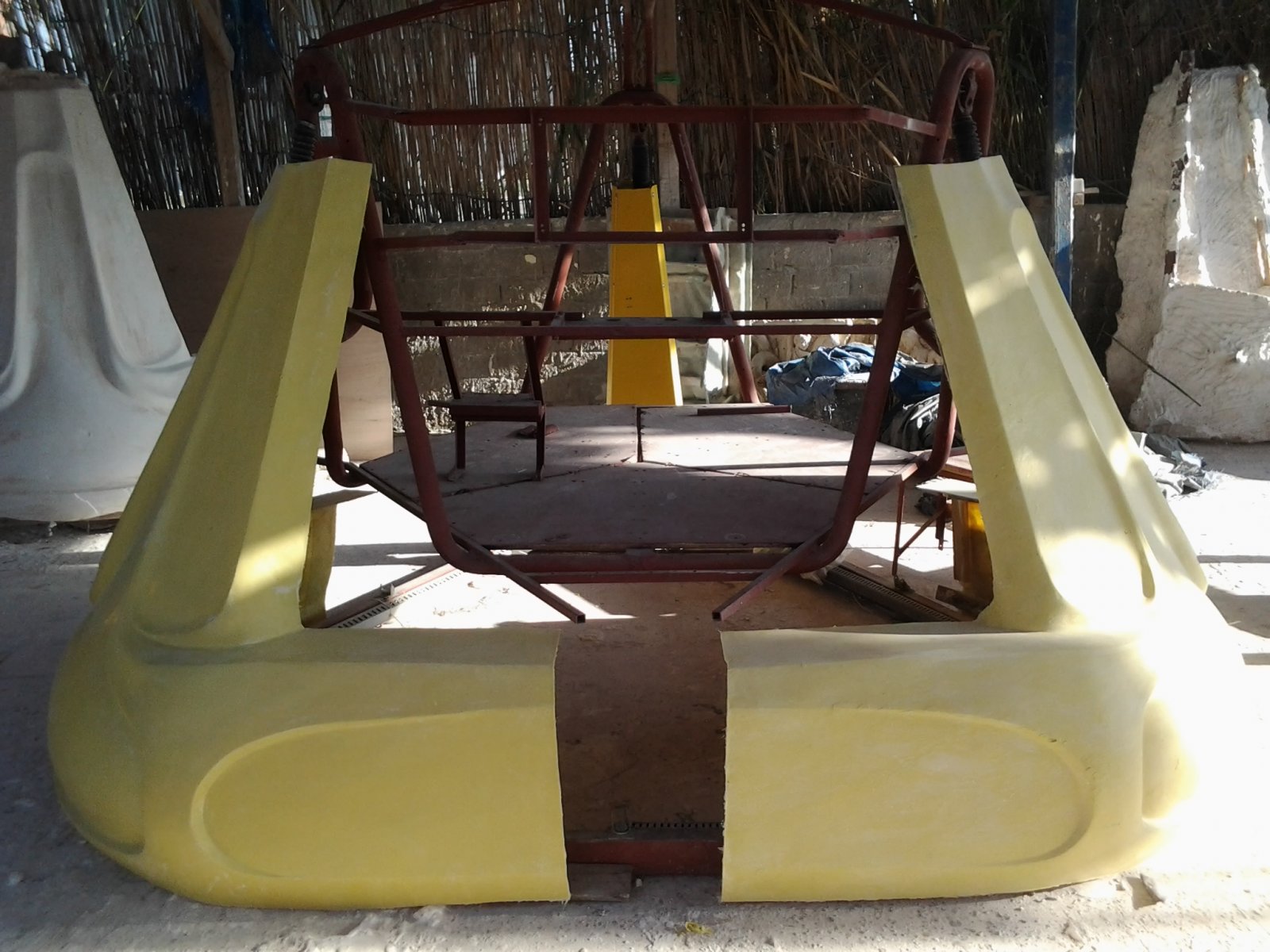

    More work progress with the dash board and the front end ... please note that all shapes are in reversed form ... some missing sections will be copied ...
    2014-04-26 15.48.04.jpg 2014-04-26 15.59.00.jpg 2014-04-26 15.59.19.jpg 2014-04-26 15.59.37.jpg 2014-04-26 16.01.14.jpg 2014-04-26 16.01.56.jpg 2014-04-26 16.02.12.jpg 2014-04-26 16.02.37.jpg

    Yesss @vulbas & @RacingMat :thumbs ... welcome to the club:grin ... wait till you see the roof and the Ferrari like door ... then we'll all get crazy ... :cheers
    I'm going to do some synthetic leather coating for the interiors and the dash board ... plus a center top console with lights "above your head " ... plus some decoration so you're like riding a real car ...
    Have a nice day every one and I'll enjoy your guiding comments .:thumbs
