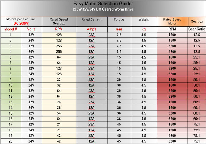

    Have a look at the chart I posted, the torque depends on the gearbox ratio.

    well what your opnion about model no# 19 .
    12v and have 45 NM torque which i think it's enough to load more weight. but you and bsft said before go for shoulder mount with ratio of 60:1
    this motor have 75:1 and the speed of the gearbox is 45 rpm. have to order this or go to more gearbox speed?
    thnx in advace.

    Not for sheer lift, they will not do it. Use 240v motors.
    And do not run 12v through a 24v motor, waste of time
