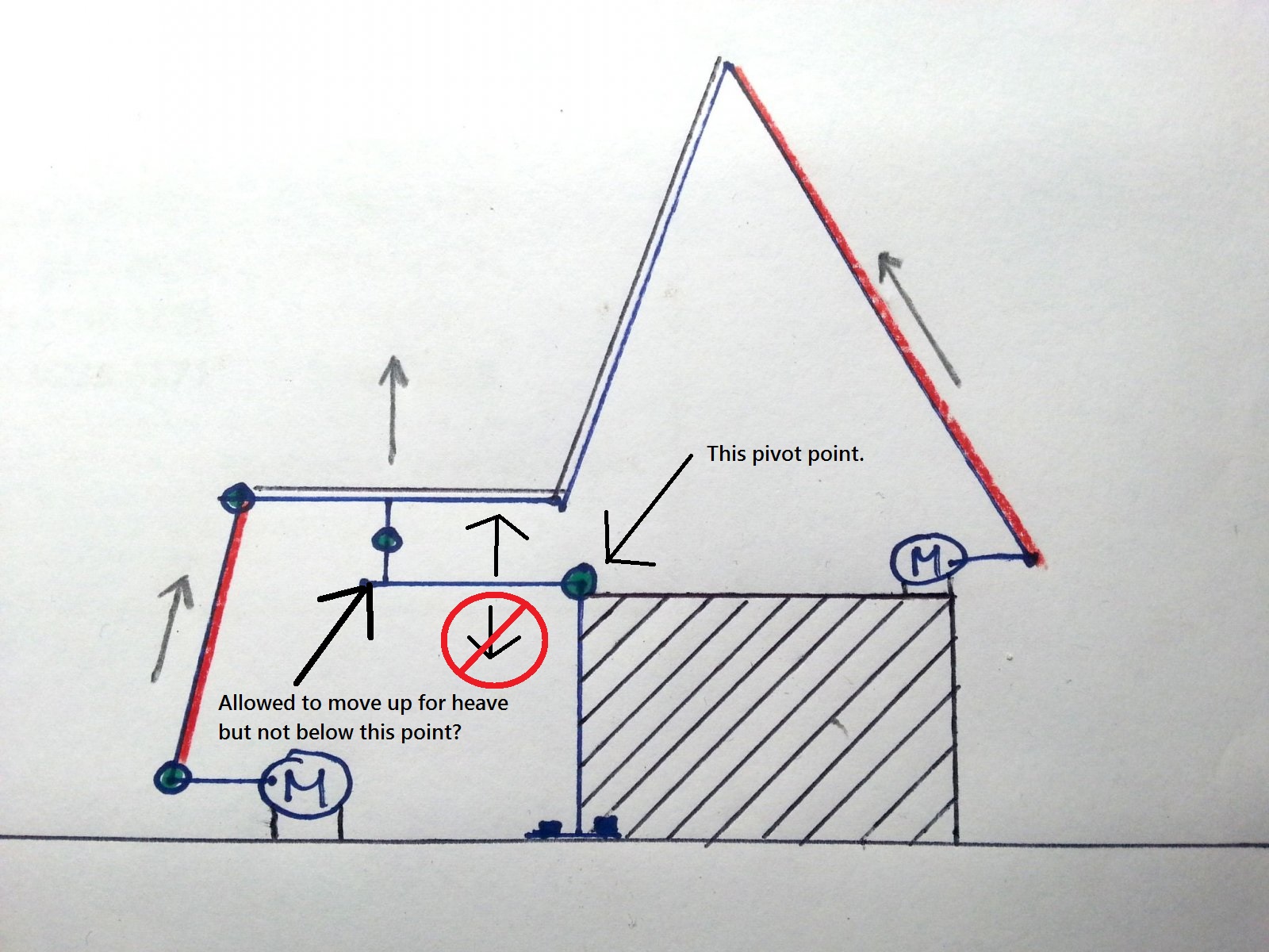

    I hope this paint fits your request, a detailed video will be taken soon.
    Please keep in mind, this design is not mentioned for flight simulation due to the offset. For us racers the offset is negligible because we do not need much lifting.
    PS2: the distance between the bottom of the seat >-> joint >-> platform where the joint is mounted should be as little as possible.

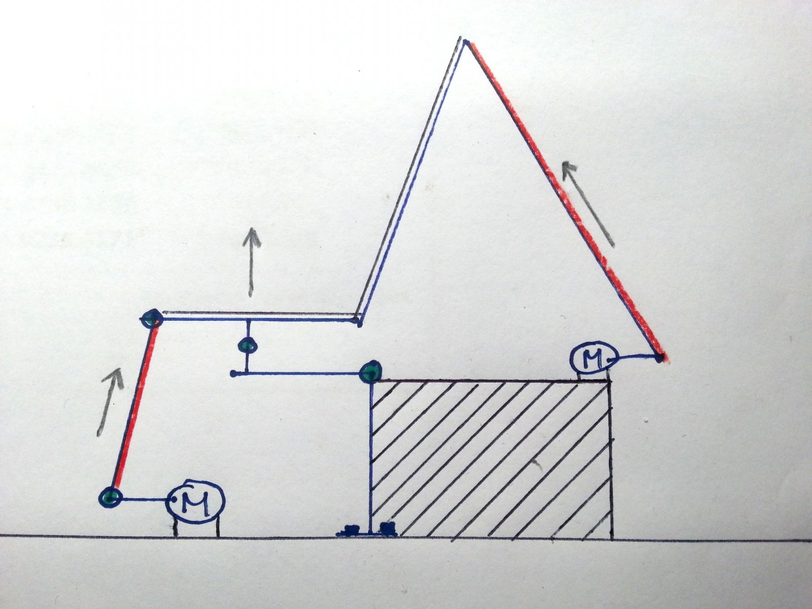

    Regarding PS3, is the heave motor on the left, holding the seat in position during the time here is no heave movement (i.e is it under constant stress)
    or is the pivot (green circle in the middle of the pic) only allowing movement upwards, so it locks when it is at the horizontal position and the heave motor rests? (Sorry if it confusing, I added a pic to try to clarify the question)
  5. Pit
    3,007
    30,501Coins
    +3,098 / 31 / -0
    The heave motor is holding the seat all the time, yes. If you will use 300W motors they will fail probably, or you use a longer lever to reduce the weight on the motor itself. NTL much of the weight will be reduced by the middle joint and by the motors at the back.

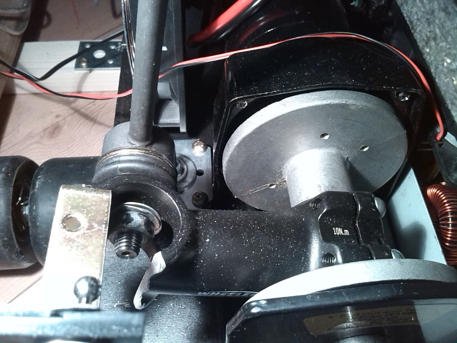

    @Pit I'm planning to build a 2DOF seat mover using winch motors for my first motion sim. Do you know about what your gear ratio worked out to be?
  13. Pit
    3,007
    30,501Coins
    +3,098 / 31 / -0
    Hi @Ben V the gear ratio of my winches are not known but the rpm: 23. That means a relatively slow turn, but winches are very responsively. Due to the strong motors they produce a big amount of Nm (750W max would be equivalent to 1PS) , so you can compensate the lower turning speed by using longer levers. In my case my levers are 13cm long - already too long so I had to reduce the max. power (= turning speed) because they became too fast at least.
    Using winches you have to keep in mind:
    1. winches are louder than other industrial gear HQ motors and there are some actions to be taken to reduce the noise.
    2. winches are heavy
    3. winches need big PSUs and each winch atleast one PSU
    4. my type of winches are offered at every corner - if one winch will fail also no problem to get any replacement parts.
    5. if you are lazy (like I am sometimes ;) you can use a handlebar stem onto the pulley. The diameter (31.8mm) of the pulley fits exactly to the stem of a mountain bike.
    PS: this lever is shorter as the seat levers at the back, this winch is to be used for a separate heave which does not need big moves.
    6. you'll need a strong motor driver, the jrks are too weak here, each winch needs two MotoMonster working in Dual Half Mode.
