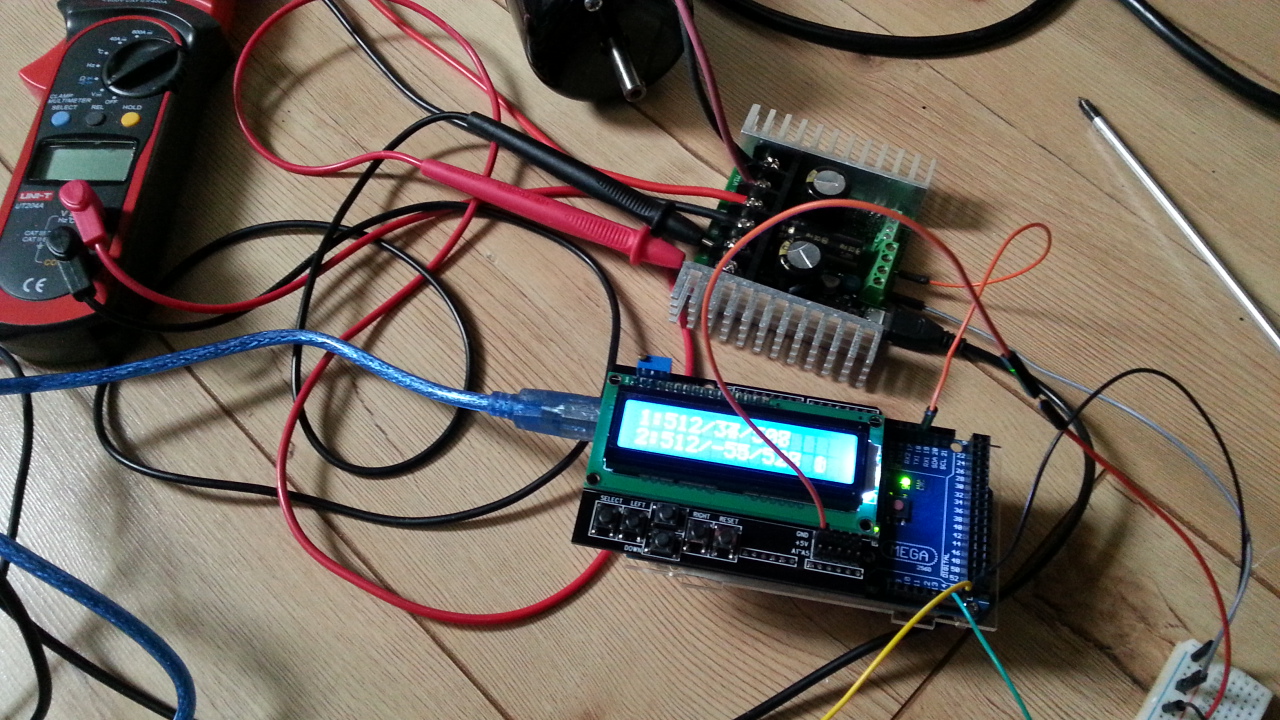

    It works, and the specs of this combo are pretty impressive. On the other side these are expensive gadgets :)
    All credits to @vthinsel (original thread)
    THe Platium Edition (;) ), which I am using as vthinsel has suggested, shows some nice features. The Sabertooth 2*32A has a Baud rate of 115200 to the MEGA and the loops takes 0-1ms on MEGA only.
    C&P from the original posting of @vthinsel:
    Main advantages of Arduino MEGA 2560:
    • 4 Serial UART, allowing 115200bps end-to-end (one used by USB, leaving 3 full COM ports for your design). This means we can achieve sub 1ms latency between SimEngine output and sabertooth input
    • LCD/Keypad Shield compatible
    • Lots of available pins (both digital and analog) to add a TM1638 dashboard for example :D
    • 256Kb flash / 8Kb SRAM / 5K EEPROM (versus 32/2/1 for a UNO)
    Main advantages of Sabertooth 2*32
    • USB port to configure/monitor
    • 115200 Serial packet mode (with CRC)
    • same price as 2*25 !!!
    • Intelligent user mode to implement specific behavior
    • Can absorb regenerative current using resistors
    I am using a LCD display as well:
    The LCD will allow you to
    • edit all PID parameters for each DC motor
    • edit your pot min/max/deadzone values
    • edit your global deadzone
    • change the sabertooth type
    • Set standby values for each motor
    • Change number of reads done on pots (average system)
    • Reset EEPROM to default values (recommended for first time load)
    • Show in realtime the value sent by SimEngine, the PID value calculated and the pot value (as well as loop time)
    The next steps are to configure and to tune the settings.

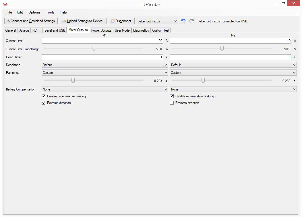

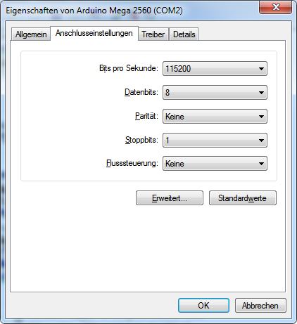

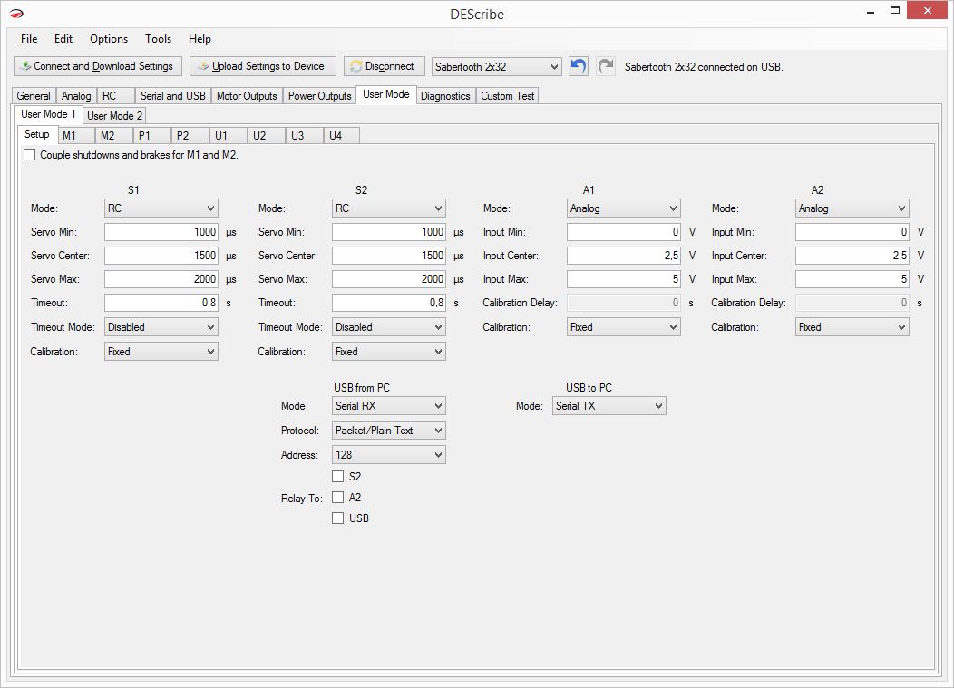

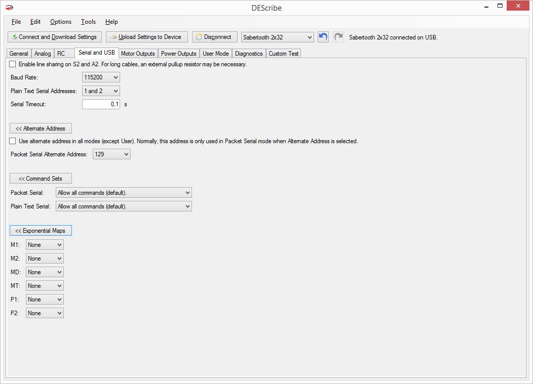

  6. Pit
    3,007
    30,501Coins
    +3,098 / 31 / -0

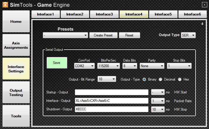

    I continue here, because I dunno if the issue is a SimTools, Ard oder whatelse issue. Please @Wanegain @vthinsel @yobuddy @value1 @BlazinH @eaorobbie @speedy have a short look at this.
    After running into USB troubles (constantly loosing USB devices) I could sort it out - the issue was a wrong 2.0 USB driver (using one HUB was showing the behavior) .
    As far as you probably know I am using the Ard (MEGA 2560) and Sabertooth (2x32) code from @vthinsel for the sway and surge tables. http://www.xsimulator.net/community...rduino-uno-mega-and-sabertooth-with-lcd.6747/
    After a short time while driving on the rig the Ard (MEGA 2560) hangs, the Sway and Surge tables are both stopping at the same time. I have to disconnect the Ard or disabling/enabling in the device manager to get it working again.
    This does not happen (!!) when I am using ONLY one table (BTW all other forces and motors are working, they are running on different bridges and ards).
    This did not happen when I was using the SMC3 code and the vnh5019 drivers (Ard Uno R3).
    Only if both tables are running the Ard hangs, mostly when I am accelerating and the sway tables goes to the right side (right corner)
    Tables are stopping even if I reduce the power on the Sabertooth, so IMO no power supply related issue.
    Settings of the Ard as @vthinsel in the original thread has advised.
    Speed Ramping: 0.2s (Describe Software) -
    K =0.30
    Prop = 3.50
    INt = 0.20
    Der = 0.20
    Thank you all.

  7. Wanegain
    Wanegain Active Member
    Nov 6, 2013
    562
    Bruxelles
    2,013Coins
    +300 / 2 / -0
    Your Ard Mega is crashing ?
    Is this an original or a copy ? I noticed some trouble with chinese copies sometimes when they need to send serial data (I think it's only in rx mode in this case)...
    Can you see a red led (blinking maybe) on the Sabertooth ?
    I don't change the K value, I only set Kp, Ki and Kd.

    Try to set a lower speed for the communication between Simtools and Ard (38400 for example, you need to edit the sketch).
  15. Pit
    3,007
    30,501Coins
    +3,098 / 31 / -0
    Hi guys tried all except the lowering of the baud speed (too busy at the moment but tomorrow I will check this out), the behavior happened at the same place - the rig goes to the right side and at the end of the percentage range of simtools it stops.
    Probably I should set the axis limits under axis limiting instead within the forces as a percentage.
    Those two things I will test tomorrow. At least I will try out an Ard Uno R3 to be sure the MEGA is working finally (or not).

    If you are using the timeout feature now on the sabertooth is appears that it is not timing out. Therefore the ard is still sending serial data. And if you're still running vthinsels moded xpid sketch, the ard must be sending the correct data because it uses packet serial w/ checksum so it wont react to bad data. It sounds more like an issue in the sketch to me. But something else you could try since you still have two unused UARTS on the mega is to move the sabertooth to Serial2 or Serial3 instead of using Serial1 and see if the issue persists. Just change Serial1 commands to where you move it to in the sketch.
    ps. I use 115200 baud without issue
