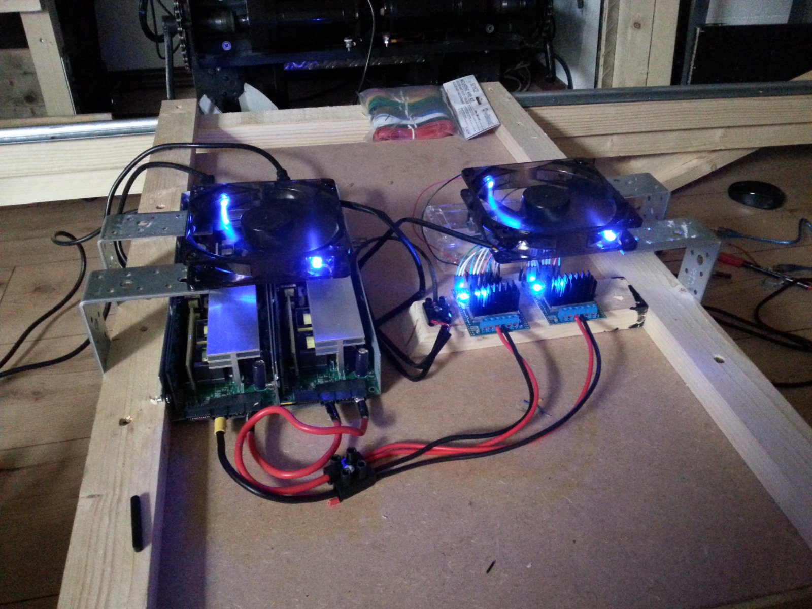

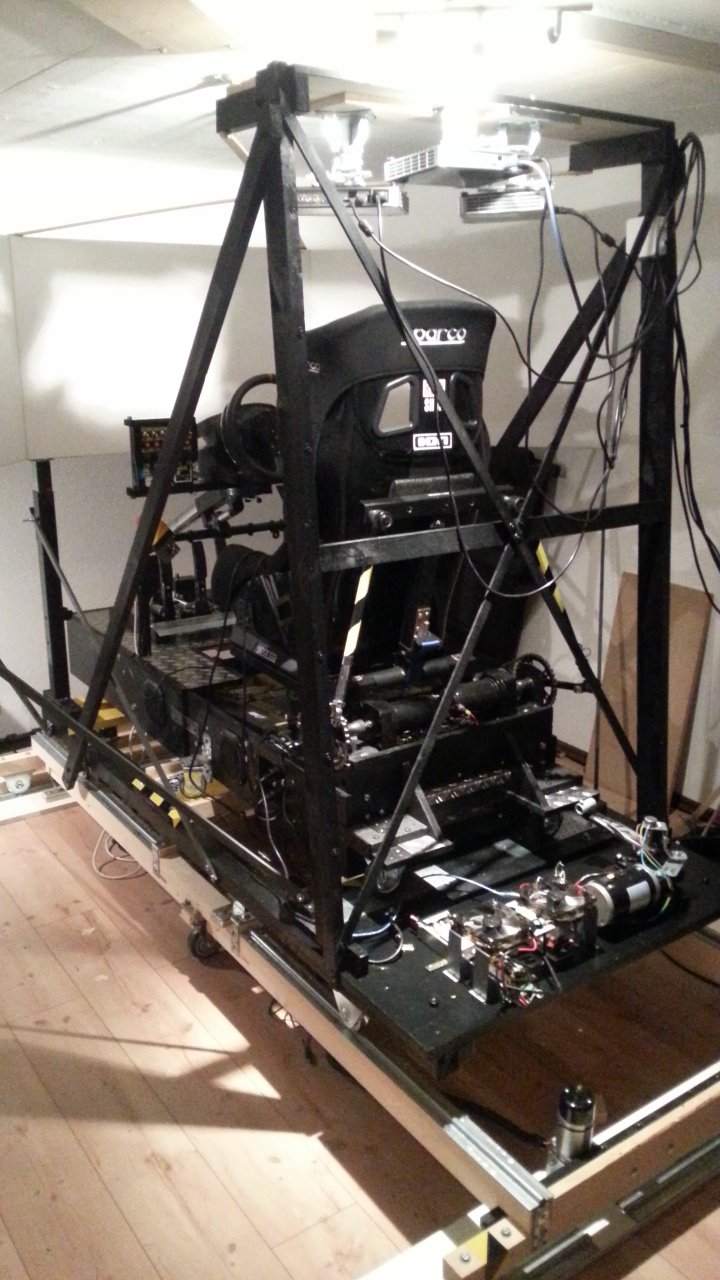

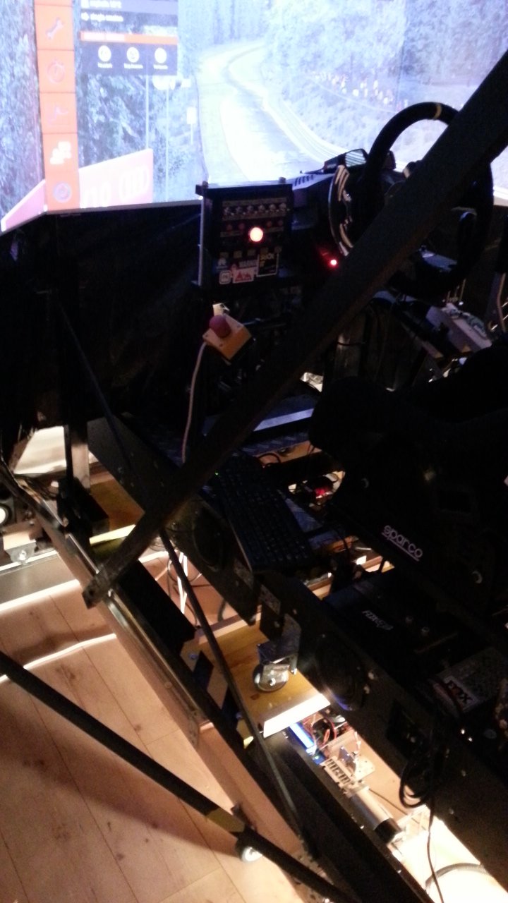

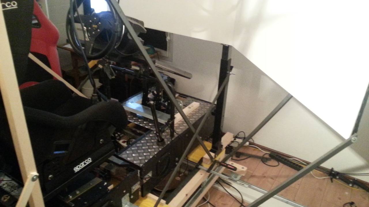

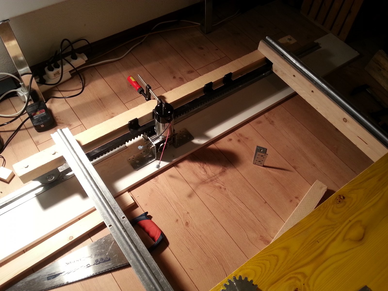

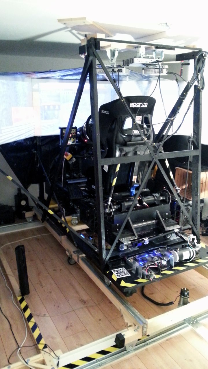

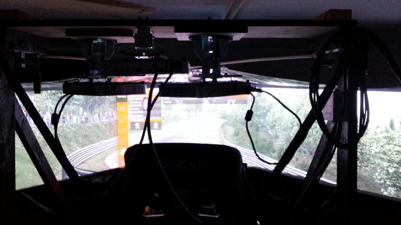

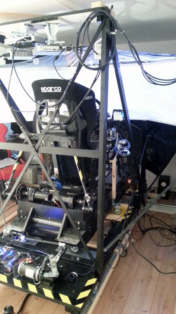

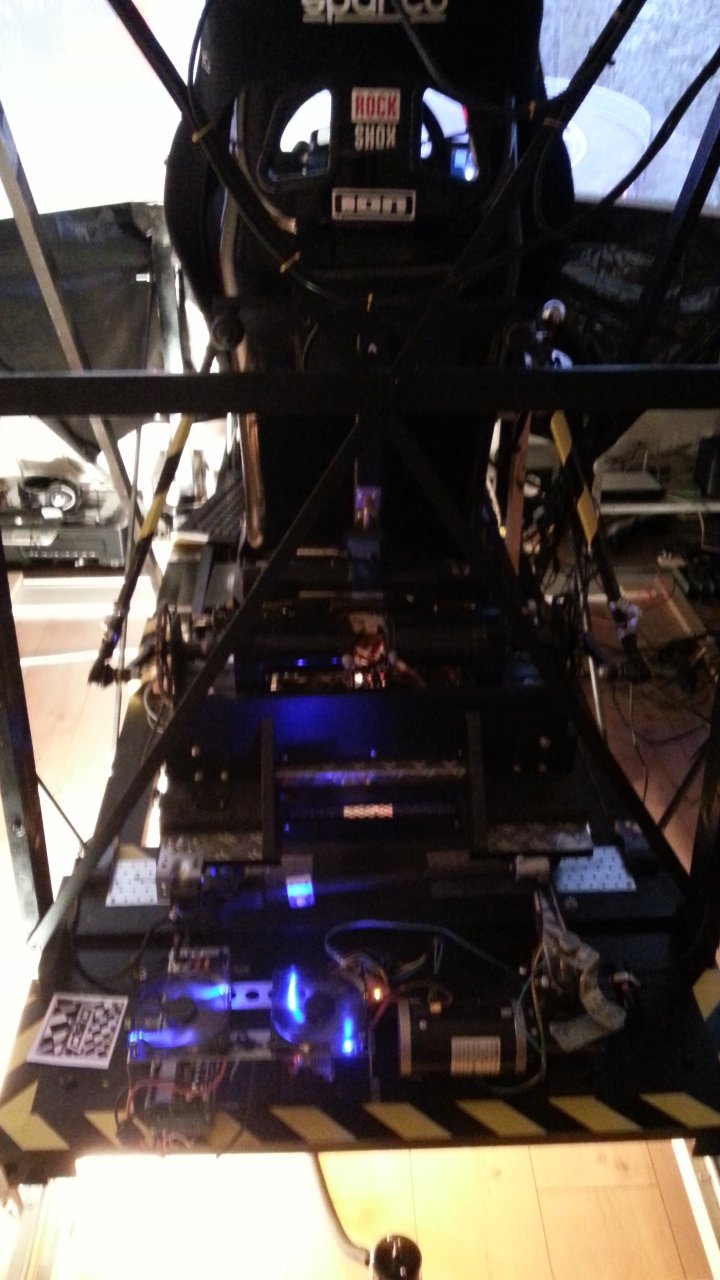

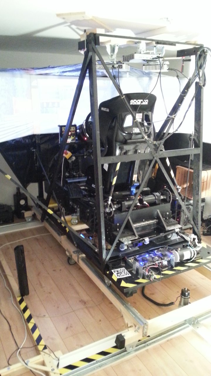

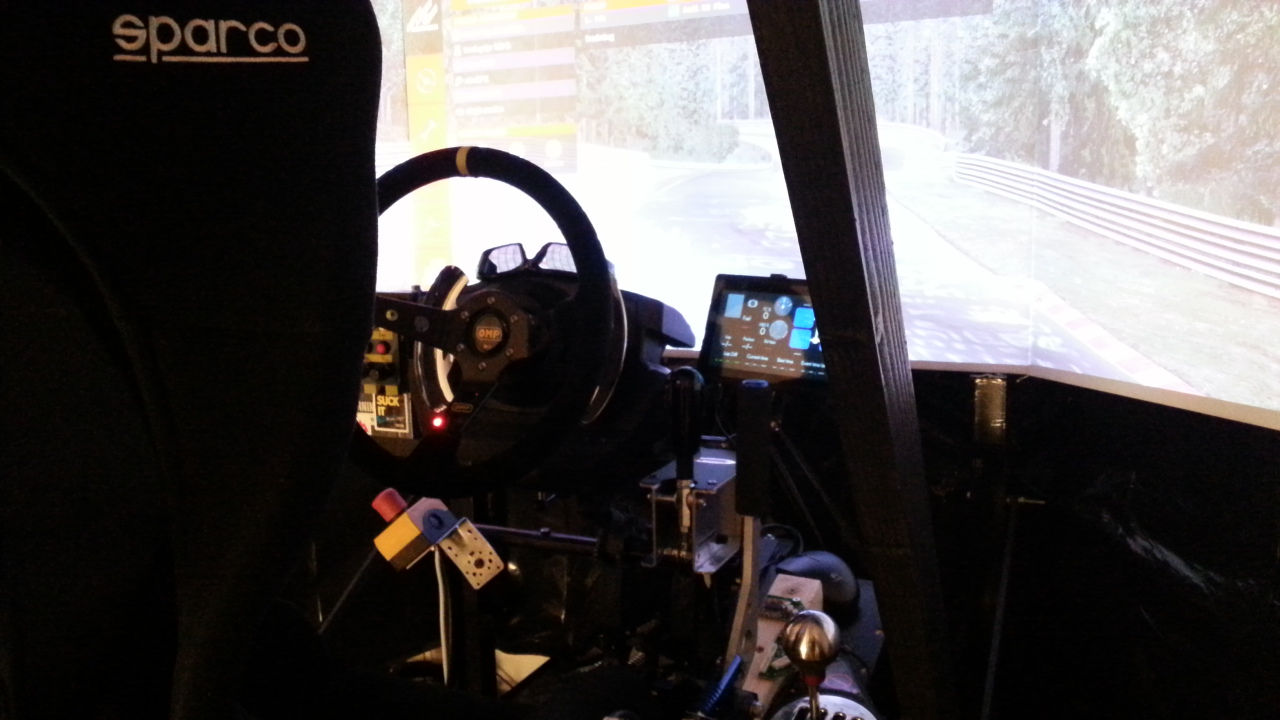

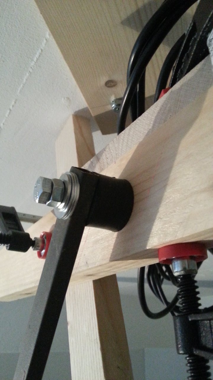

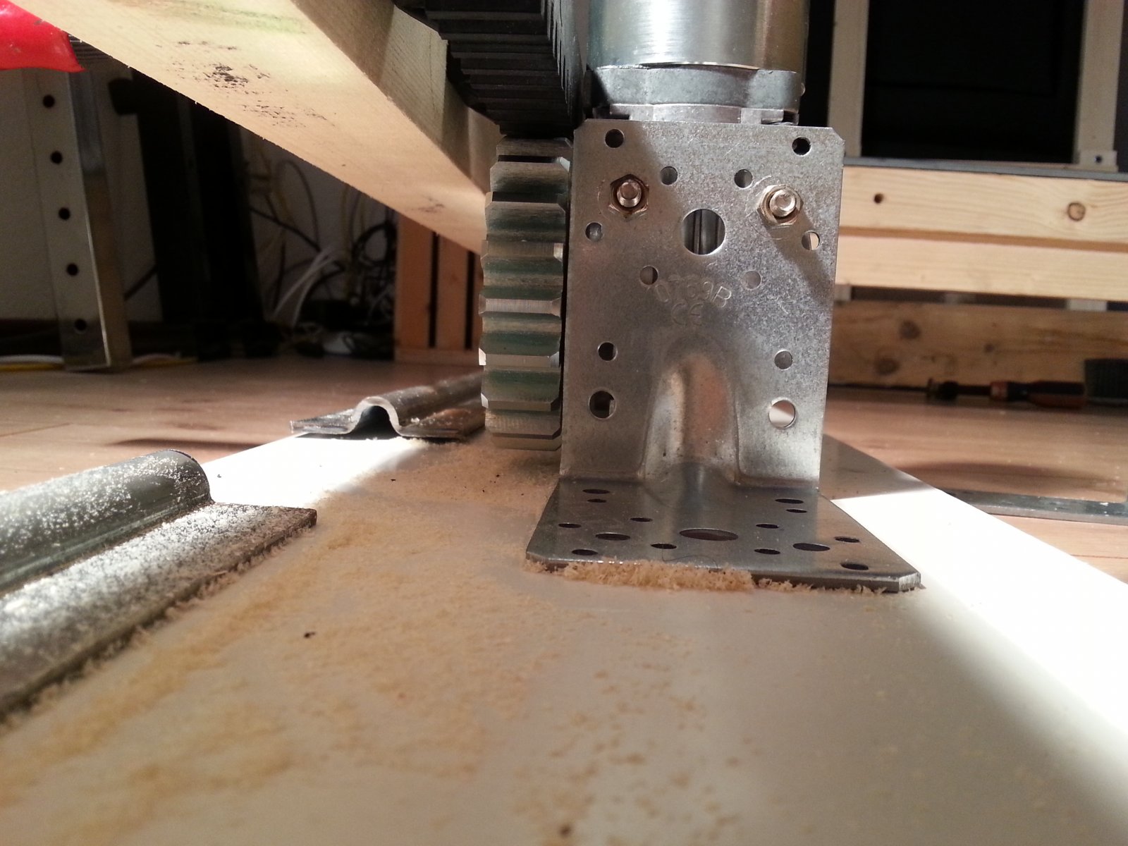

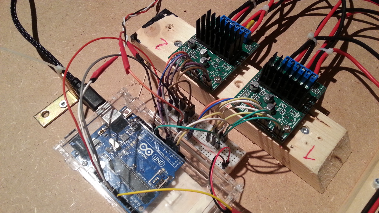

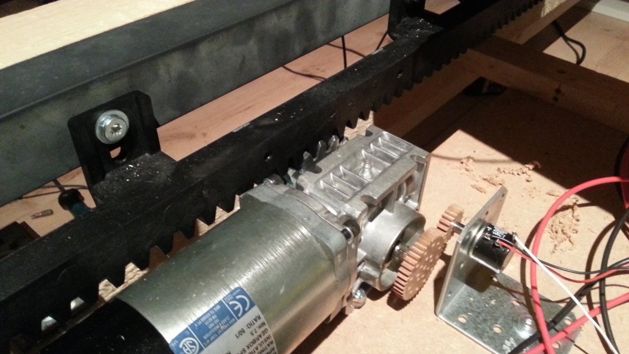

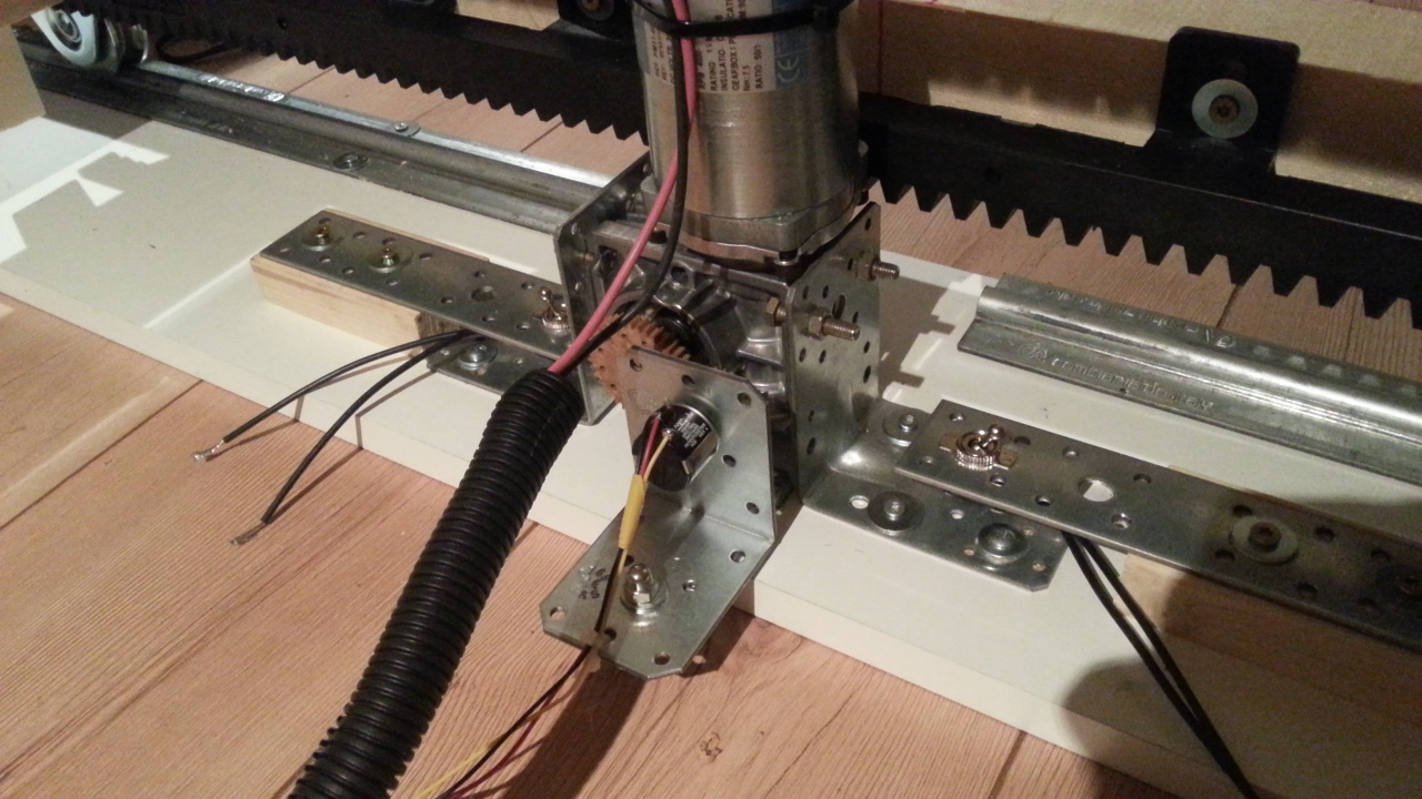

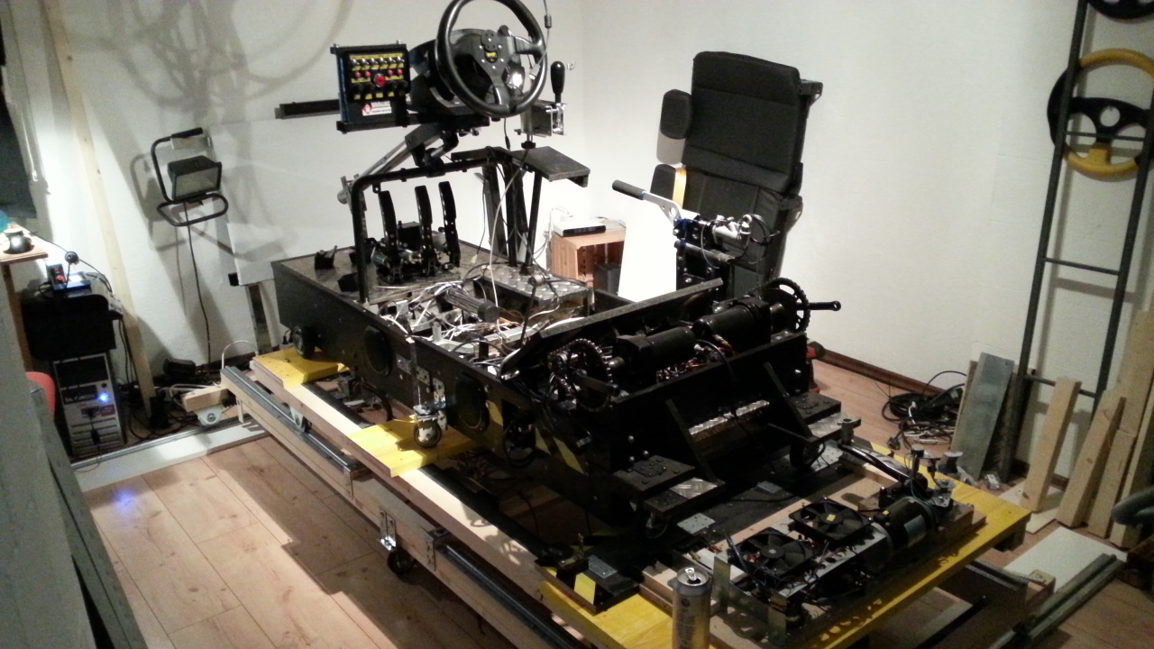

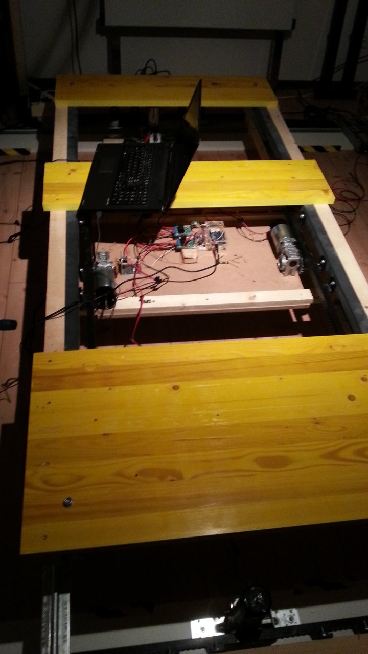

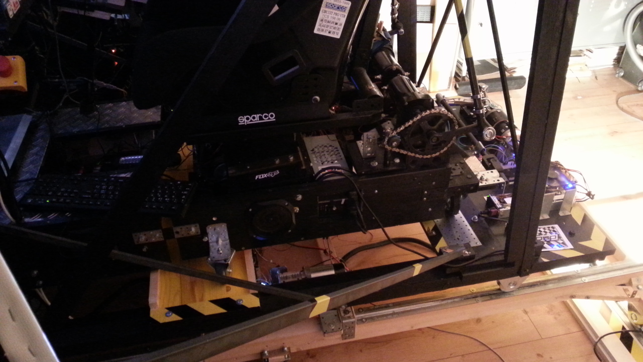

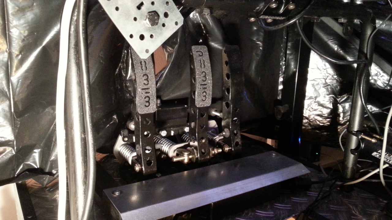

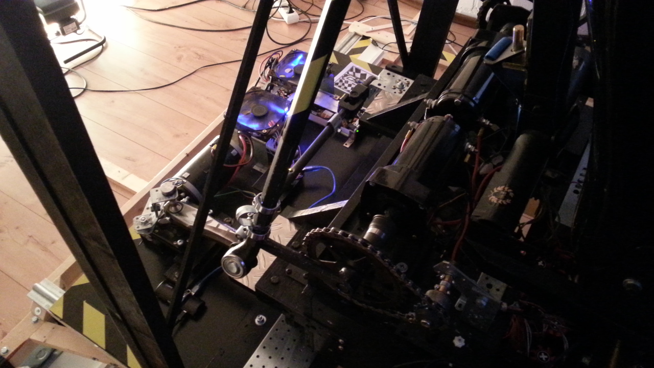

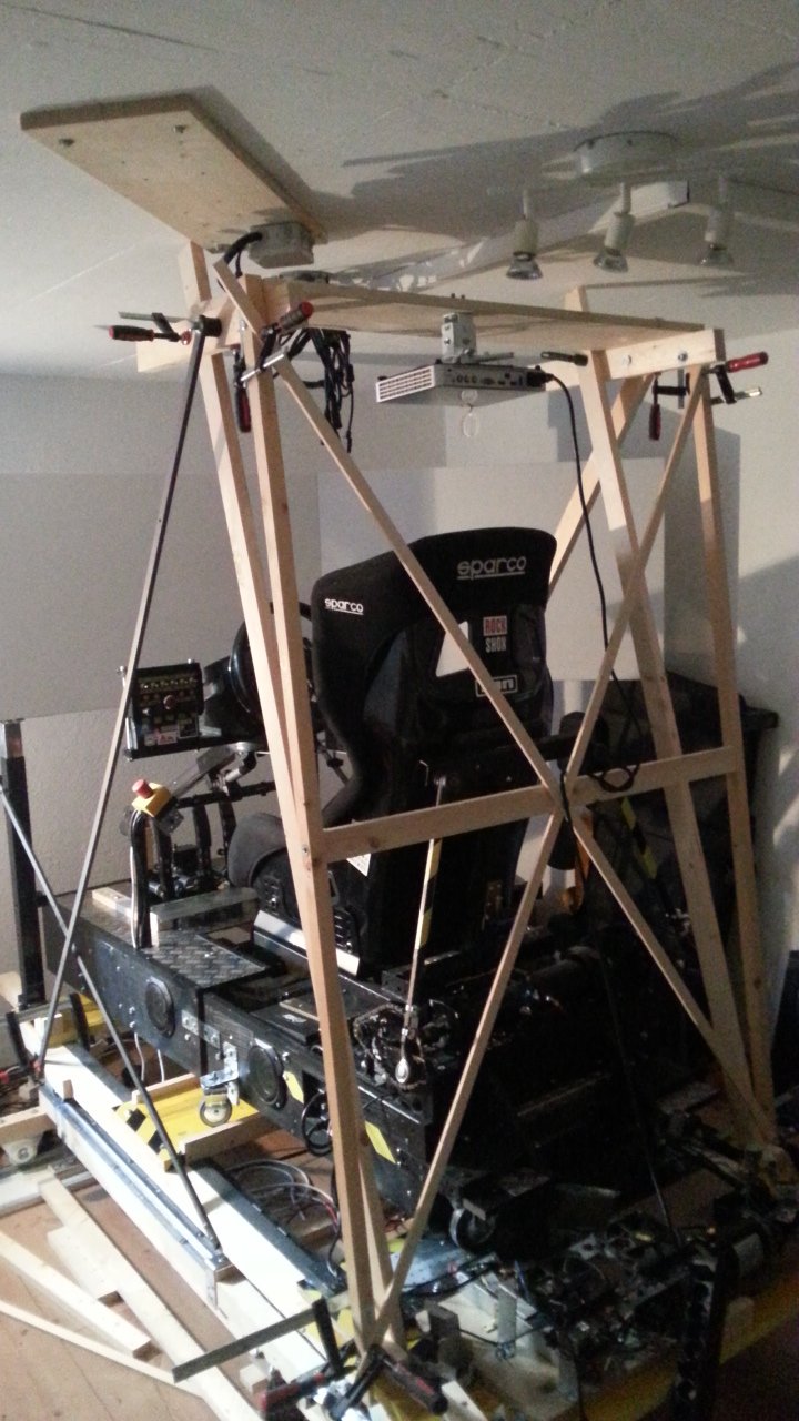

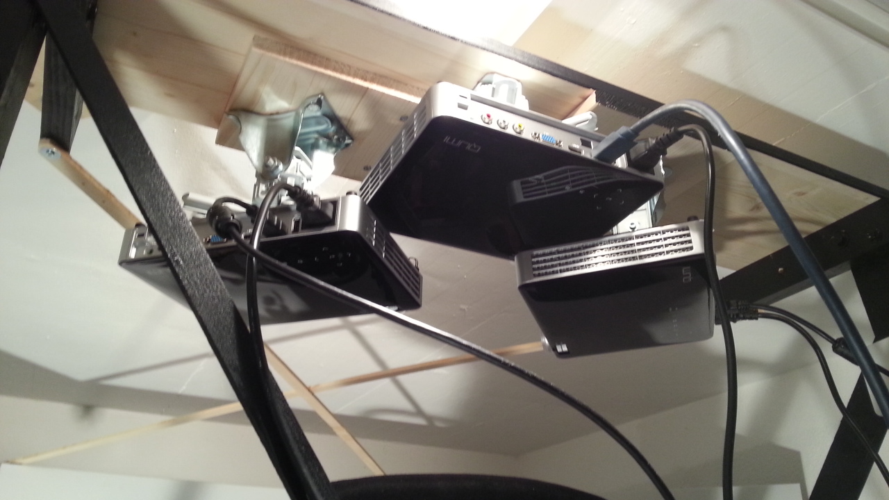

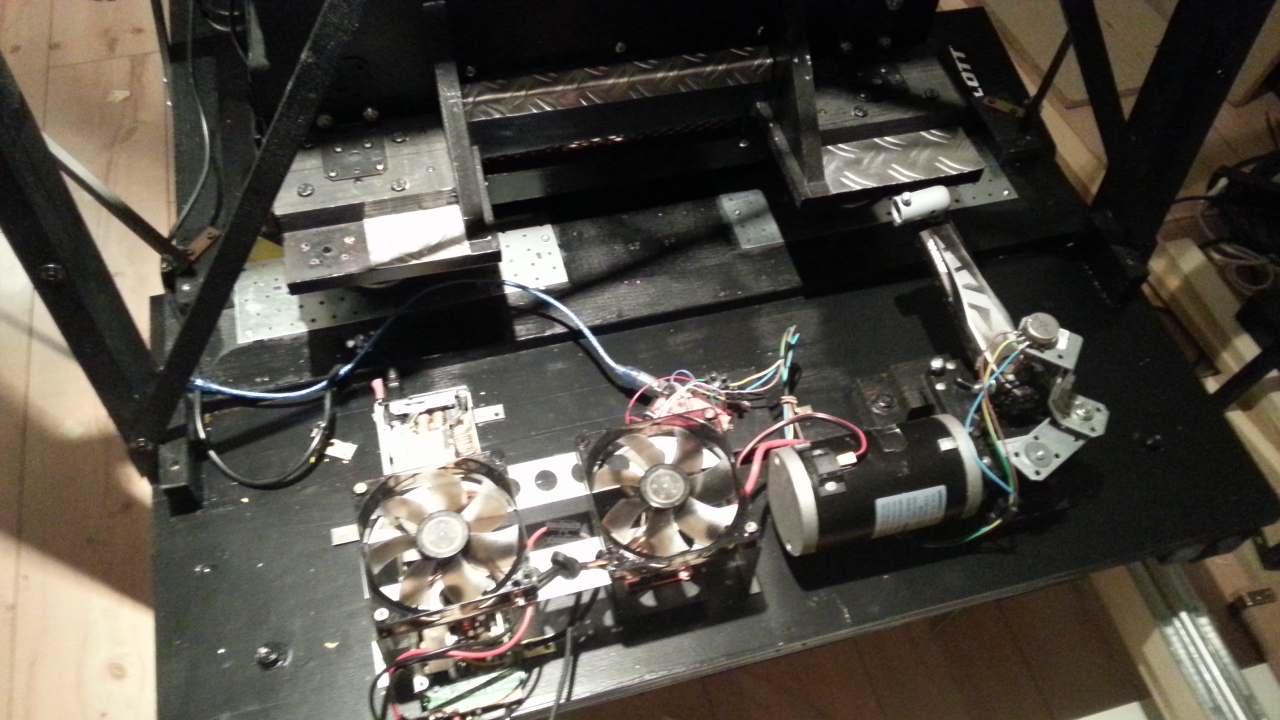

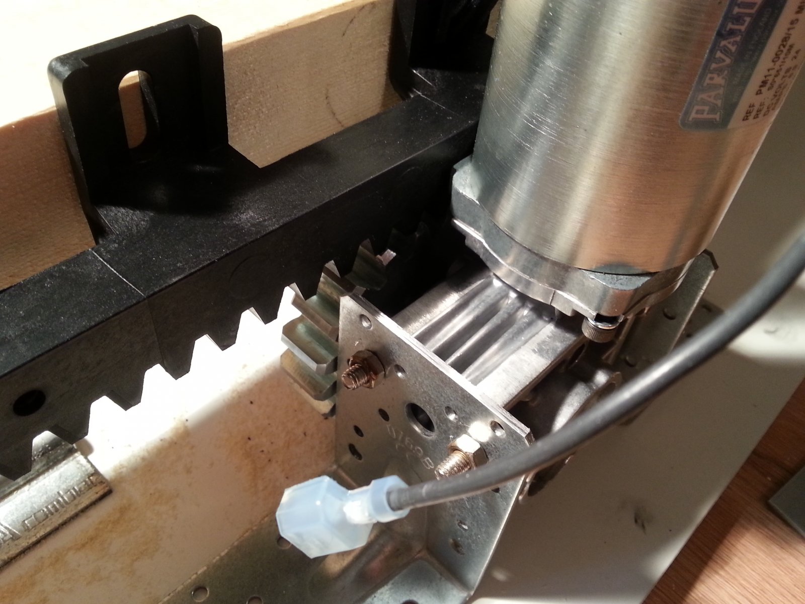

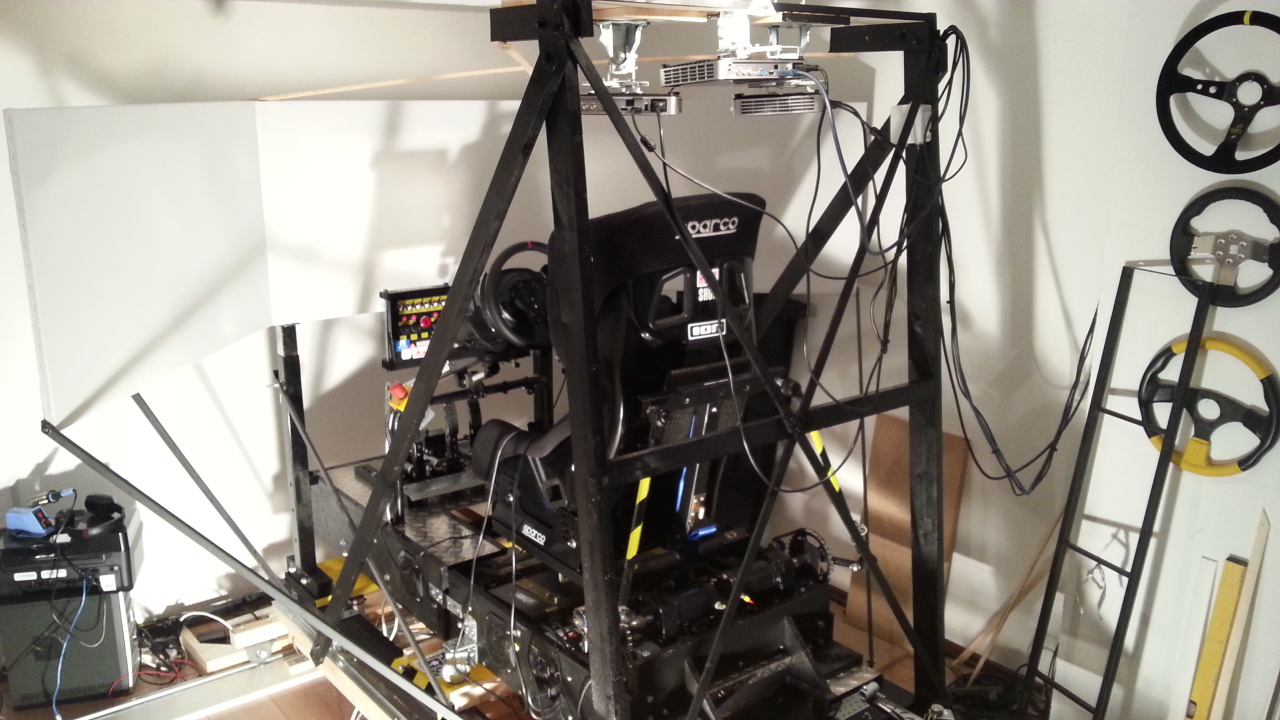

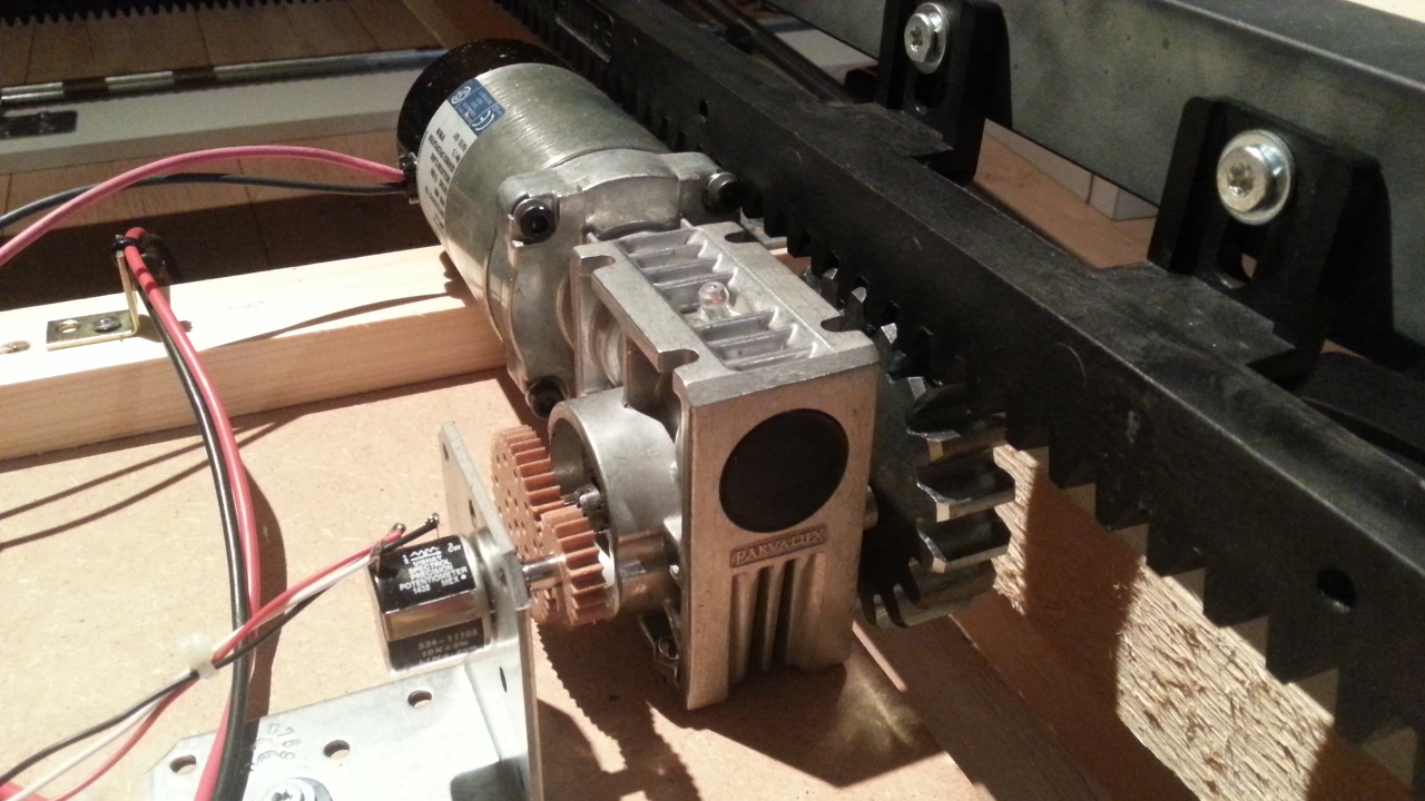

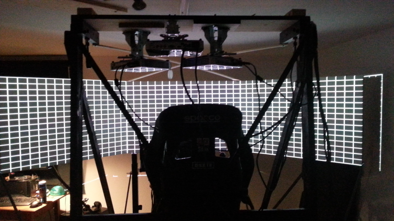

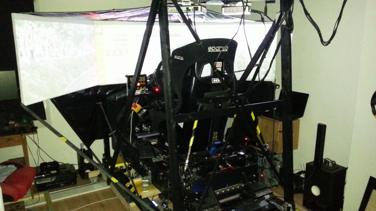

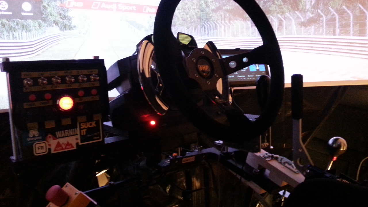

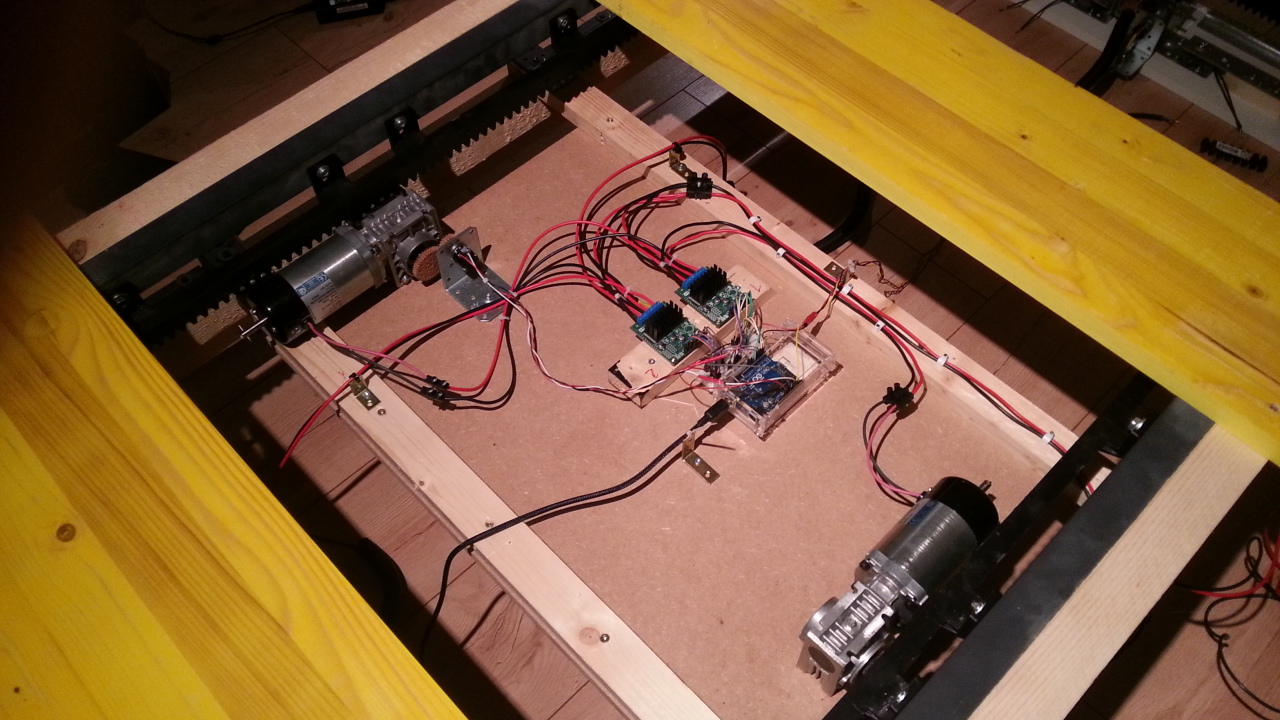

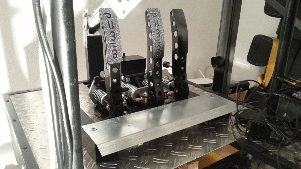

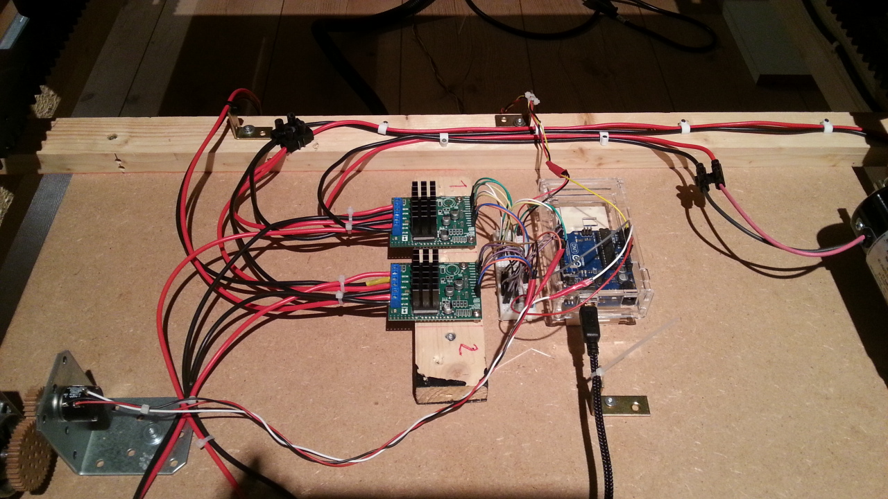

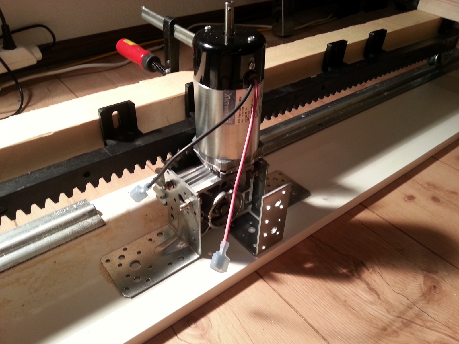

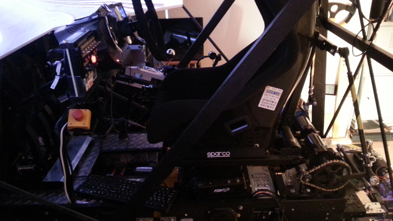

    Some taken photos from the building in one thread.
    20150823_104300.jpg 20150823_104306.jpg 20150823_104340.jpg 20150823_104349.jpg 20150823_104415.jpg 20150824_171009.jpg 20150825_185740.jpg 20150831_131201.jpg 20150901_075446.jpg 20150901_075626.jpg 20150901_075637.jpg 20150901_230140.jpg 20150901_230152.jpg 20150901_230233.jpg 20150901_230249.jpg 20150901_230259.jpg 20150903_222948.jpg 20150919_215419.jpg 20150919_215425.jpg 20150921_185948.jpg 20150921_185956.jpg 20150921_190018.jpg 20150927_214555.jpg 20150927_214608.jpg 20150927_214659.jpg 20150927_214711.jpg 20150927_214741.jpg 20150927_214815.jpg 20150927_231645.jpg
    11.jpg 11a.jpg 11b.jpg 20151205_111143.jpg 20151205_111237.jpg 20151205_111309.jpg 20151205_111318.jpg 20151205_111325.jpg 20151205_111333.jpg 20151205_111418.jpg 20151205_111448.jpg 20151205_111456.jpg 20151205_111545.jpg 20151205_111614.jpg 20151205_111703.jpg 20151205_111712.jpg 20151205_111734.jpg 20151205_112029.jpg

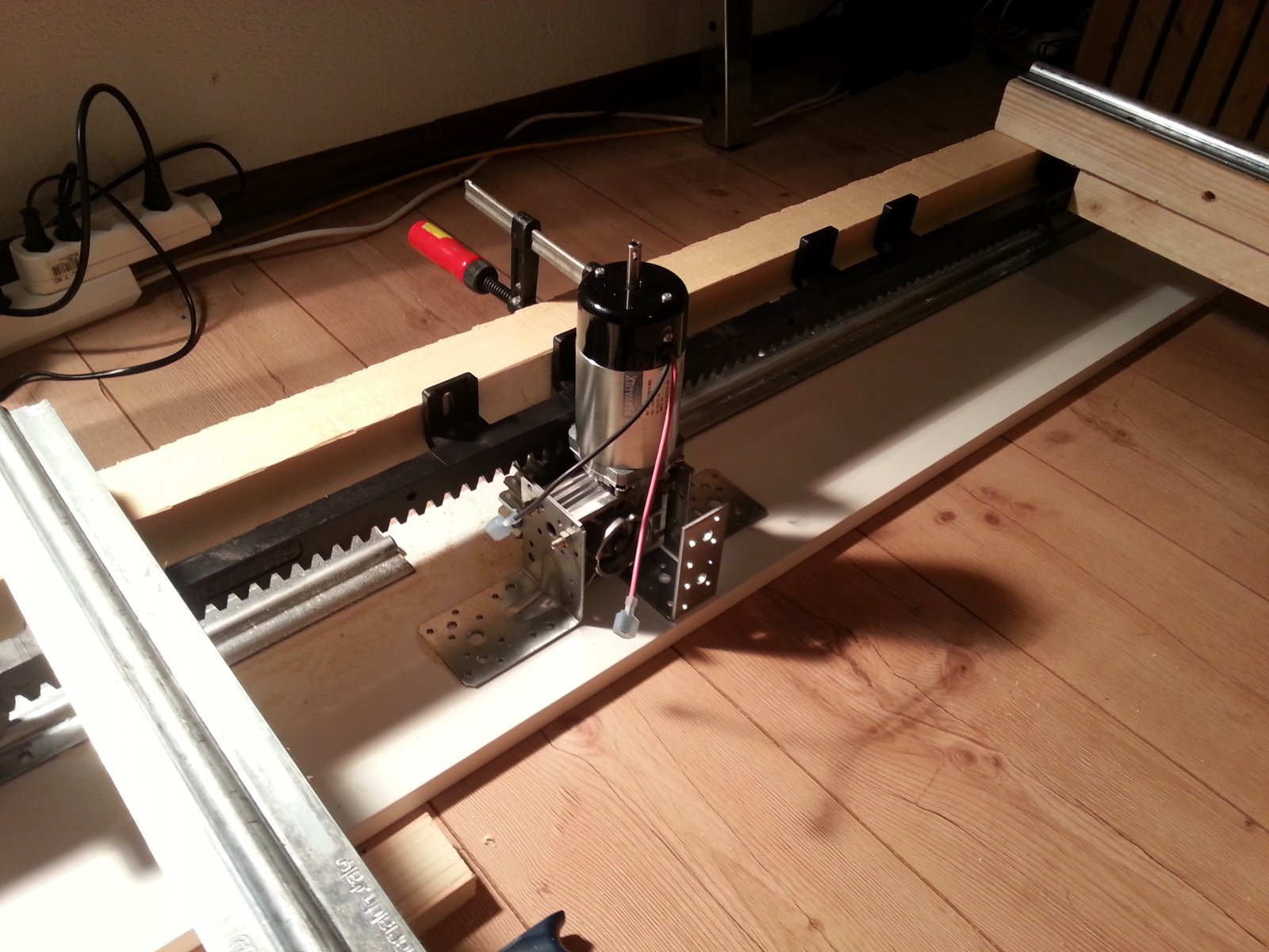

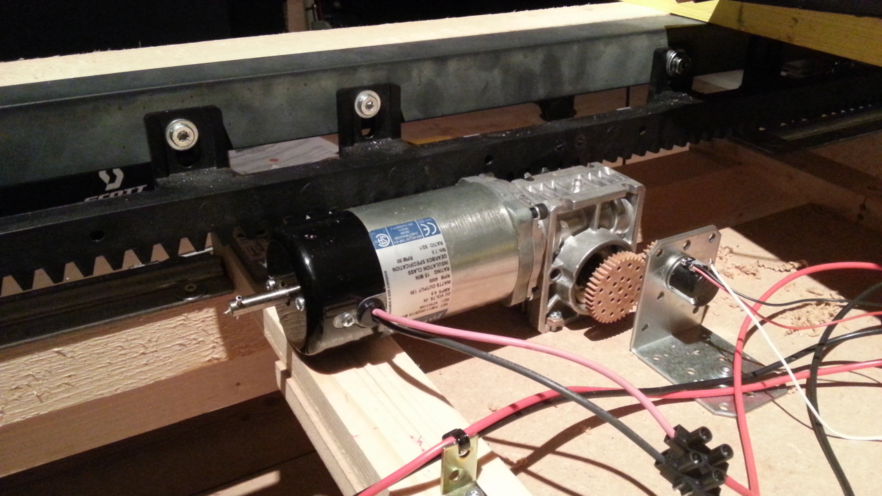

    Crazy installation :eek: !! Incredible work o_O
    Where did you get the rack and for what price ?
    Now I'm waiting for a video in action :popcorn
  4. Pit
    3,007
    30,497Coins
    +3,097 / 31 / -0
    lol, at the moment I am "touched" by the new code of vthinsel (using touchscreen LCD instad of the LCD), and I struggle with the LCD because something hangs-up...
    You mean these racks I assume:
    https://www.attas.de/shop/de/Torzub...ange-Modul-4-Befestigung-nach-oben-Kunststoff

    Buddy, due to the rail system and not yet working washout I was waiting for a beta version written by yobuddy which he has now ready (SimTools 2 Alpha status). Unfortunately I am extremely busy at the moment for testing with, I have only tomorrow and Saturday, then I am going abroad for a few days, I am back on the festive period and then I will upload any videos. Promise!

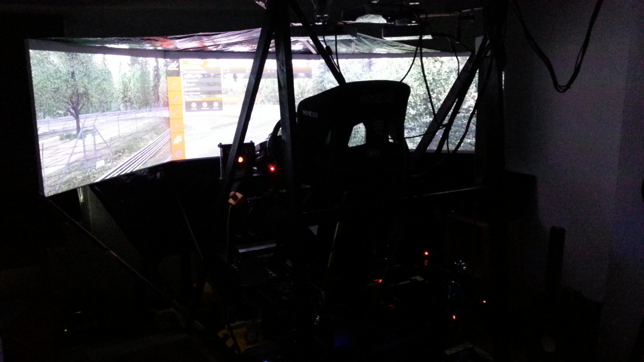

    Very first testing of SimTools 2 Alpha. There are so many different settings to test that I have headache now...lol

    wowzers @Pit thats a serious rig :D love it , cant believe how big that beast is and how much movement there is !!
    Is the surge and sway fast enough do you get the feeling of it properly ? it does look so smooth though great job :)

    I am using the new washout filter, that means a different logarithm as we know without this filter. Without filter the speed is way faster, but it feels not logically because while accelerating the rig goes forward, then goes backward before shifting, then goes forward while accelerating etc. Th new washout filter of SimTools2 works already very well, I have to fiddle out the best settings and this needs time. I'm testing since 3 days only so there is more space for optimization for sure. There are dozens of possibilities, which influence to each other and I have to learn yet.

    BTW @SilentChill if you turn off the sway and surge rail system - the rig feels dead - totally dead. It is not the mass of acceleration, it is the fact that the rig is moving - and that fools the brain massively, because we adapt the acceleration by seeing on (in?) the game to the acceleration of the surge of our rig.

    Please keep in mind the washout is still in alpha - and my video shows only one kind of settings which is not the final setting for sure. There is pretty more potential and testing and tuning needs a lot of time. :)
