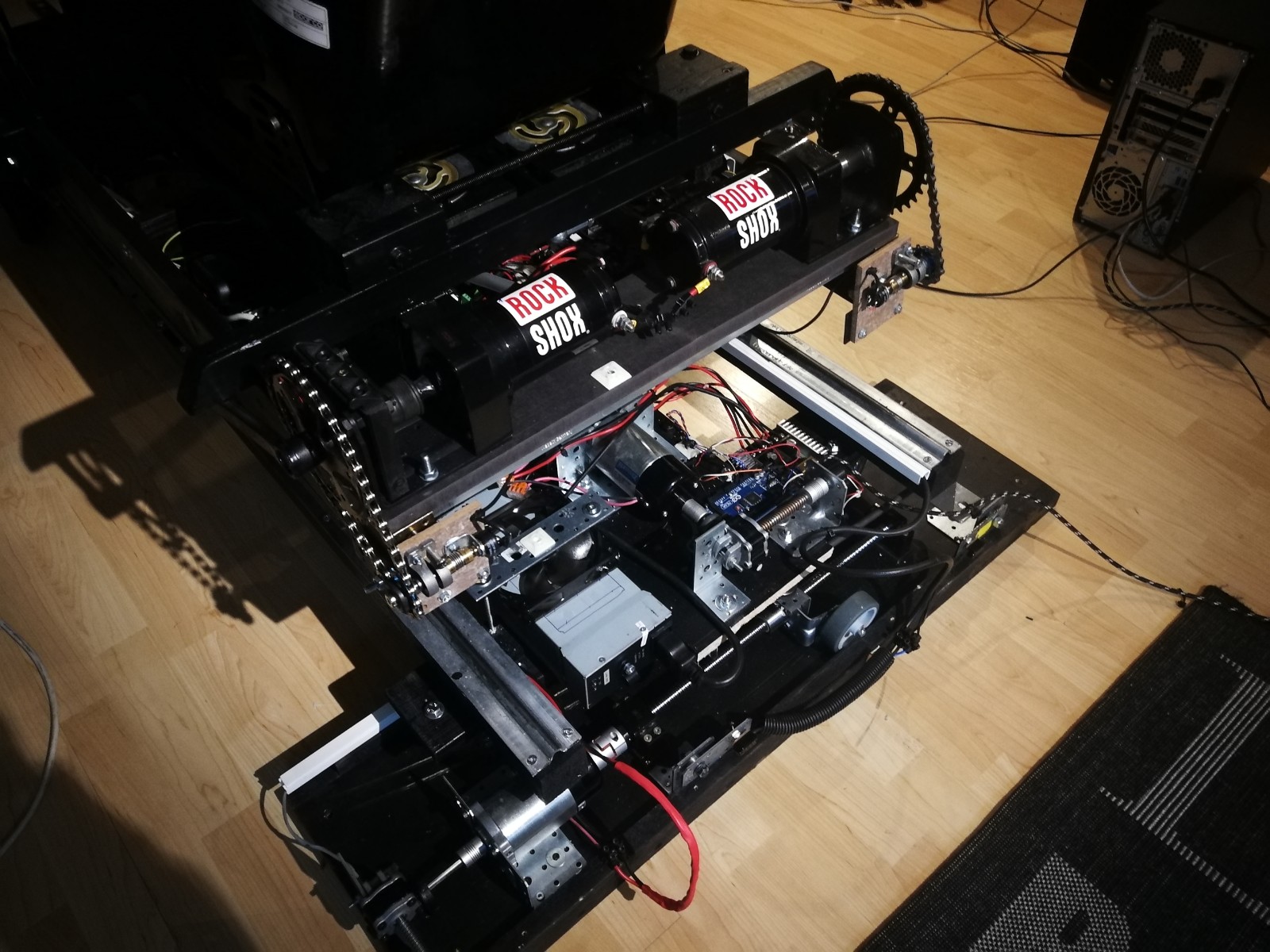

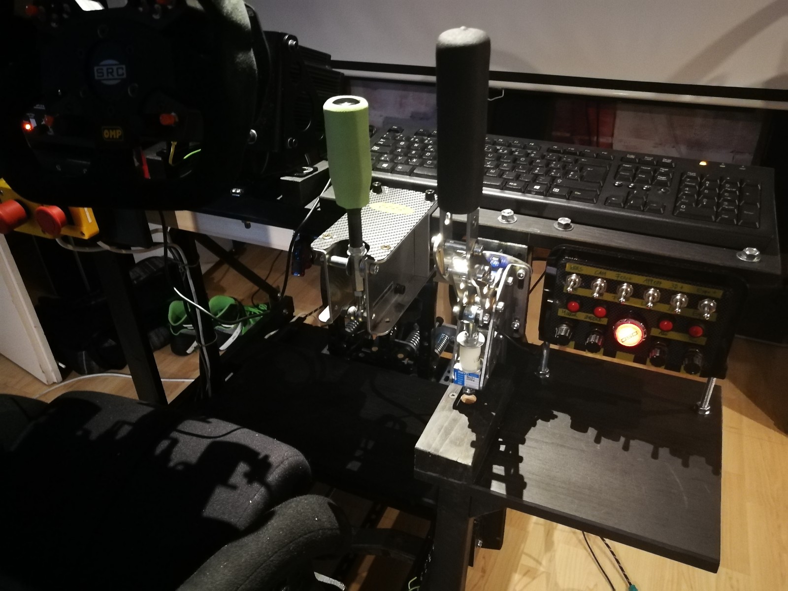

  8. Pit
    3,007
    30,510Coins
    +3,098 / 31 / -0
    Since 2013 on simulation building, this year a lot of rebuilds, optimizations and shifted to VR only. Videos are to come soon. Also see first posting for more pictures.

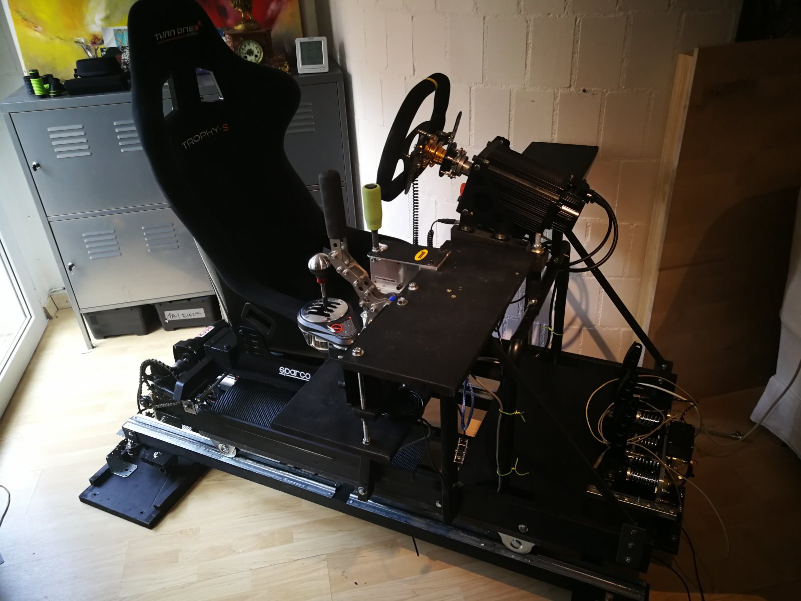

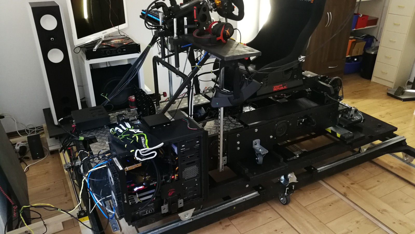

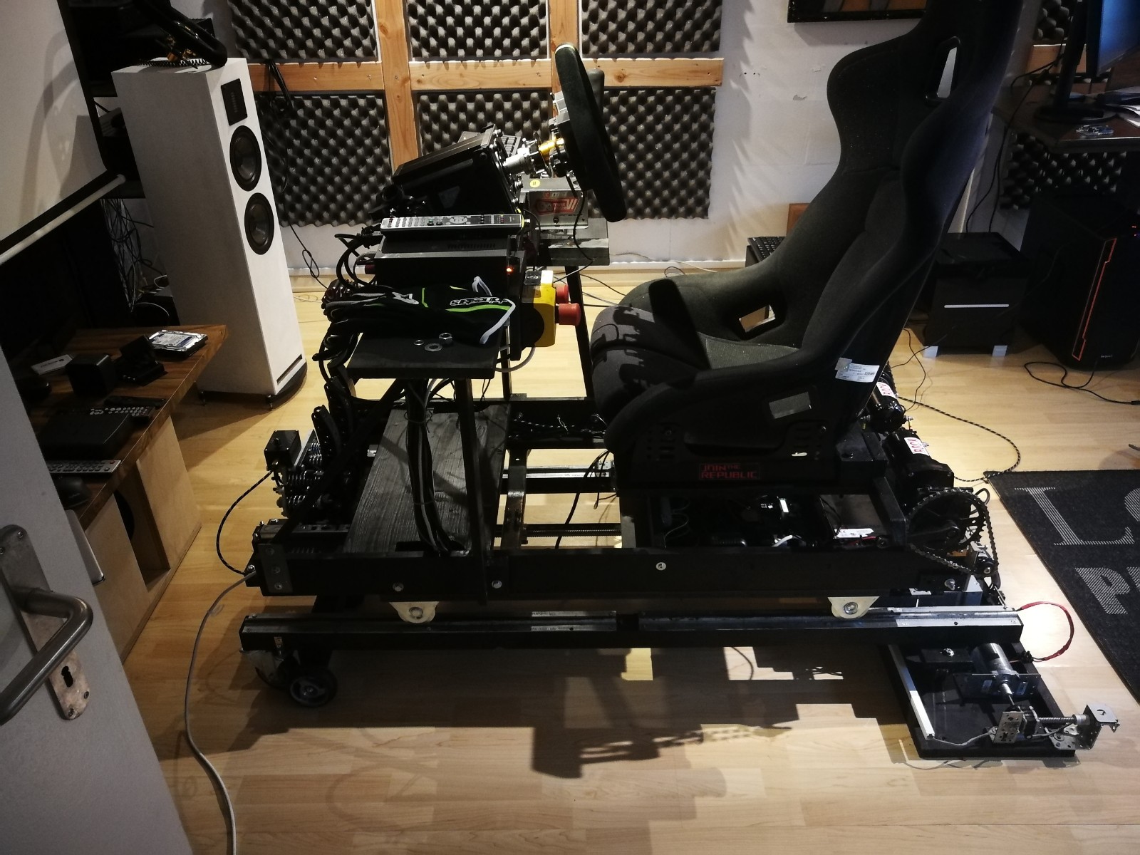

  11. Pit
    3,007
    30,510Coins
    +3,098 / 31 / -0
    hi folks, just a small update, I disassembled the complete rig and relocated it into an other room. The new size of the rig is just the half as before! :grin No sway table anymore, no extra heave underneath the seat. Whenever I used the headset these movements were causing nausea so I decided to rebuild it completely from scratch. The rig is no way much more easy to drive and makes more fun than before. Also I can move by sliding it over the floor from one corner to the other. For small races I use a projector (configuring and testing), apart from that my Pimax headset. It was a great and fun time to build one of the heaviest race rigs ever for home using, but it was toooooo big and one room was "lost". I promise I will upload a video soon, because of covid-19 I am off at the moment, so a lot of time to do so.
    Before:
    Now:
