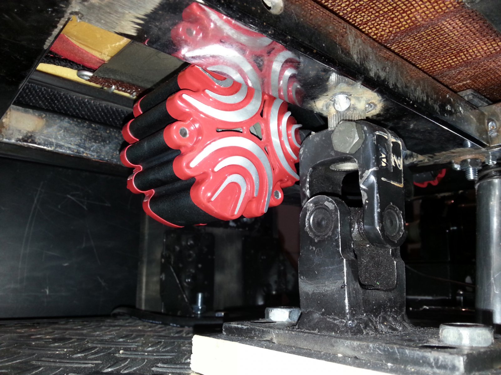

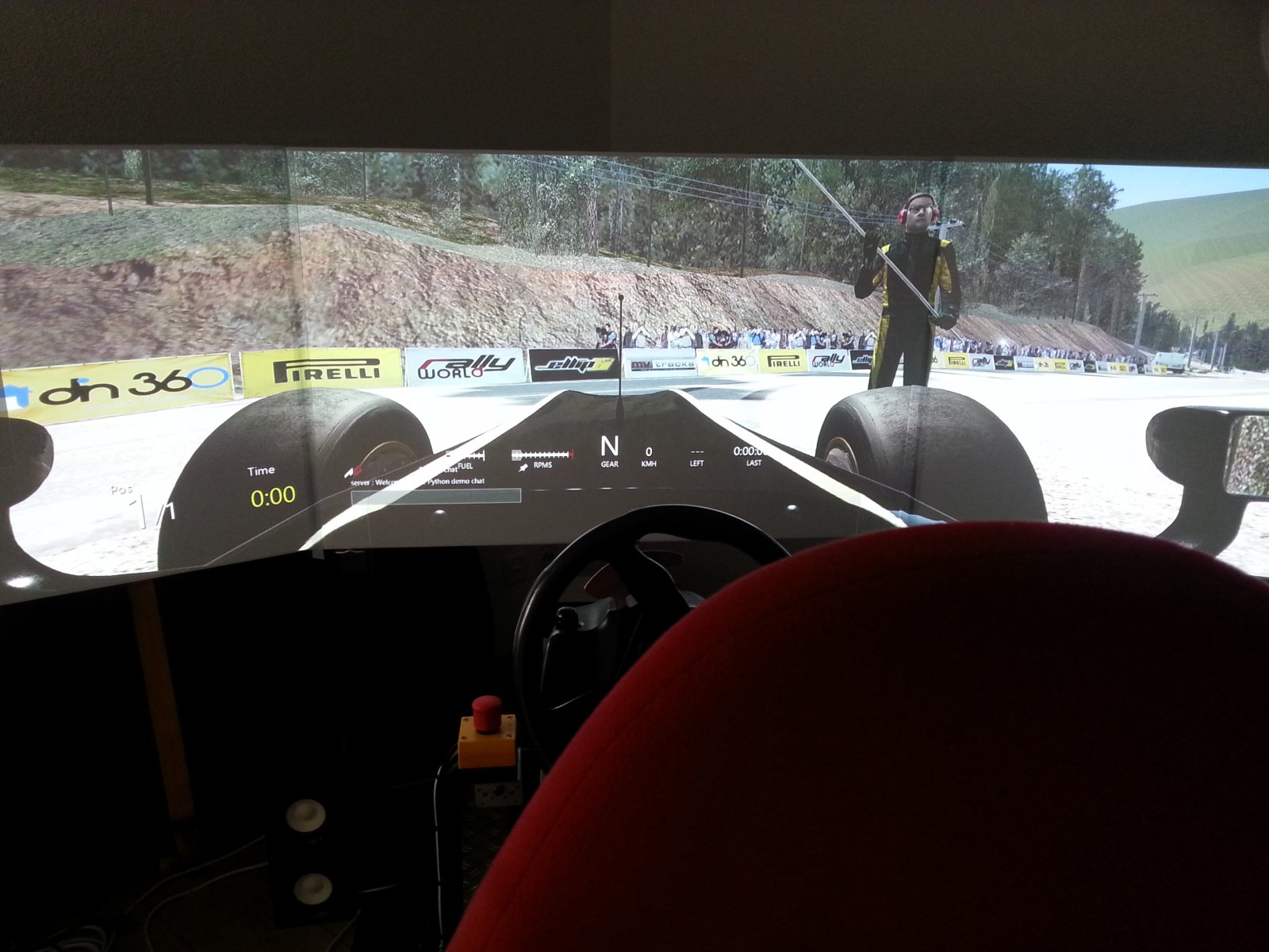

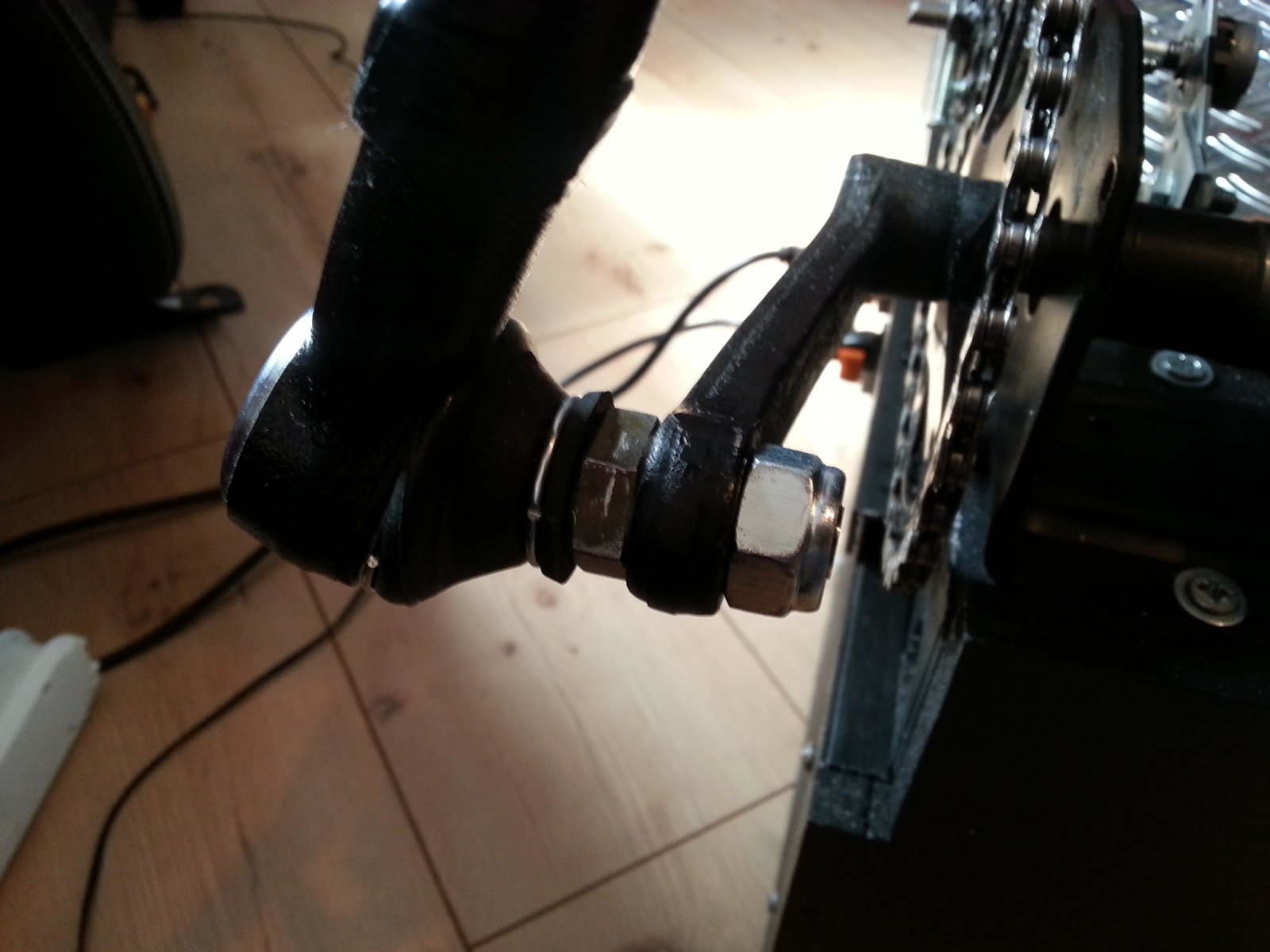

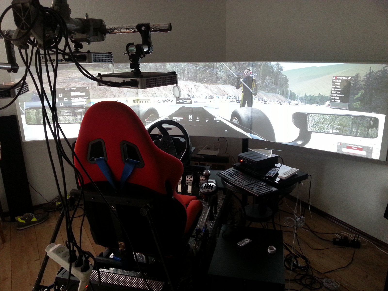

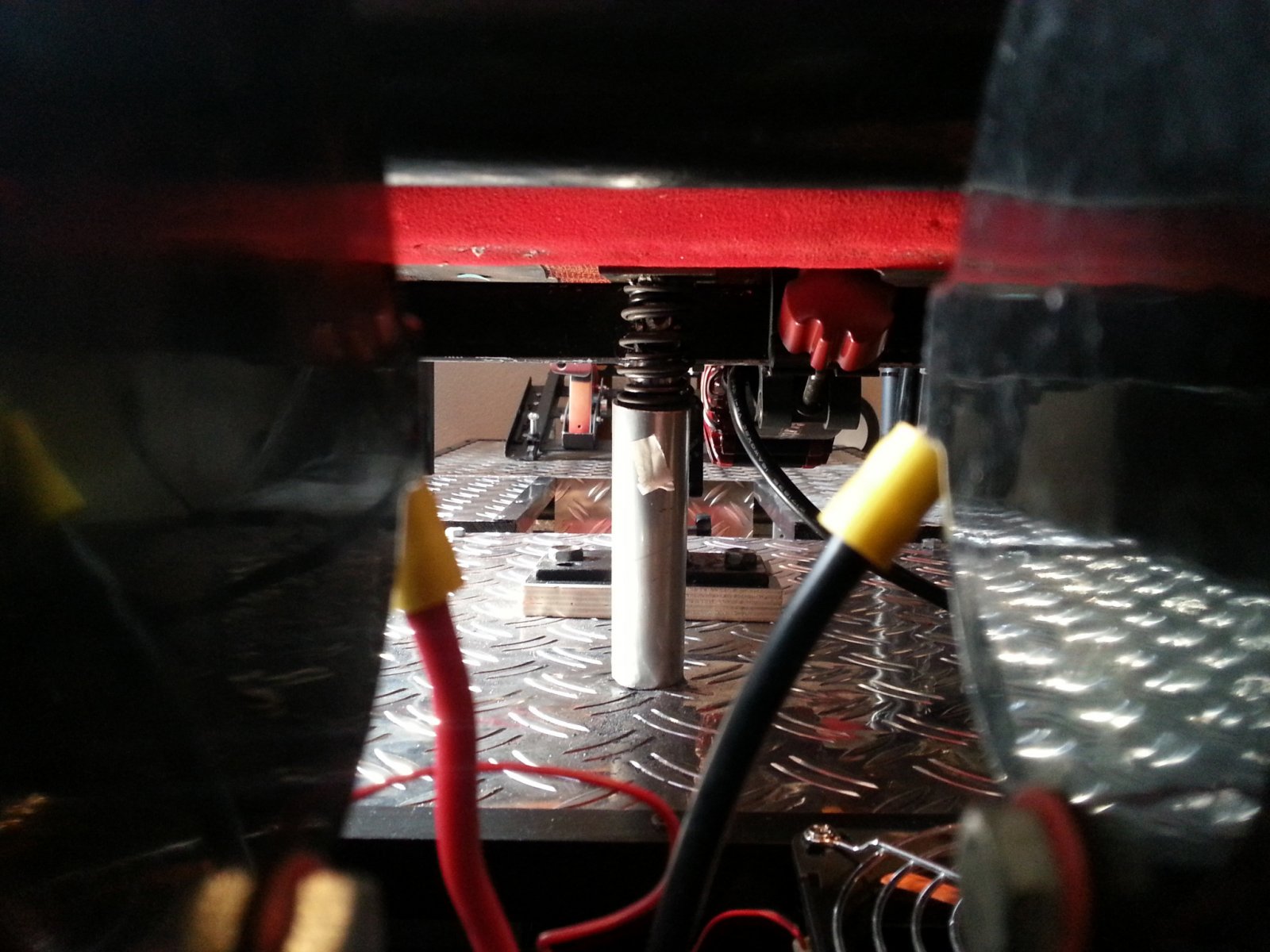

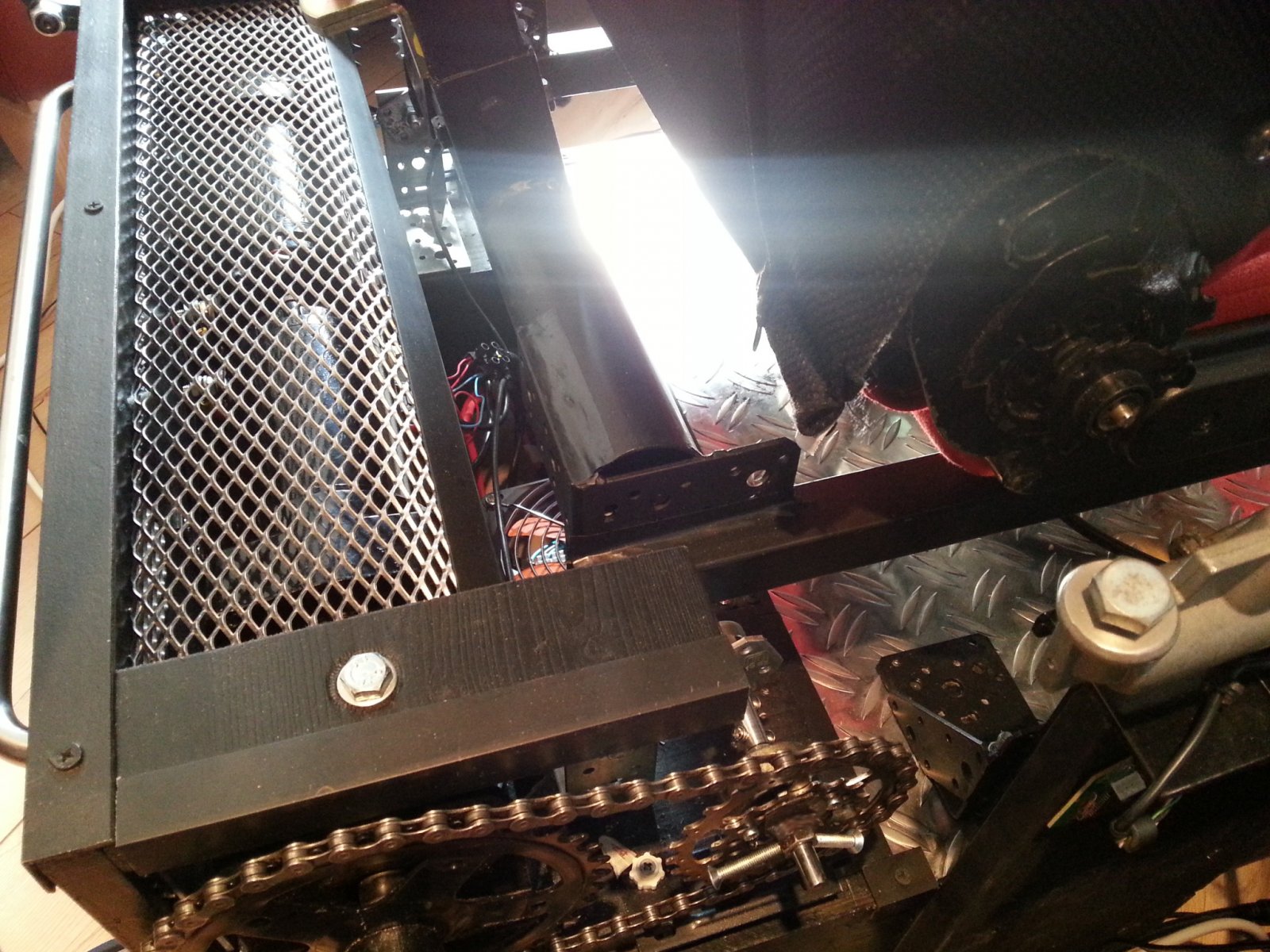

    Some shots before I will update the first posting.
    20140602_170017.jpg 20140602_170121.jpg 20140602_170215.jpg 20140602_170453.jpg 20140602_170625.jpg 20140602_170842.jpg 20140602_172335.jpg

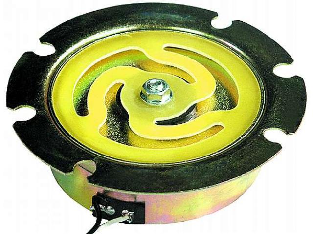

    Days after intensive testing the Nordschleife (AC) the rig did not crashed or damaged. The forces are really very very heavy for now.
    Next step: I bought the simvibe software 2 months ago due to simtools does not support (yet) any bass shaker and ordered 4 bass shakers extra to the existing butt kicker:
    o 100 Watt
    o 4 Ohm
    o 28-55Hz
    Finally I bought the app dashmeter pro. New pictures or videos to be uploaded soon.

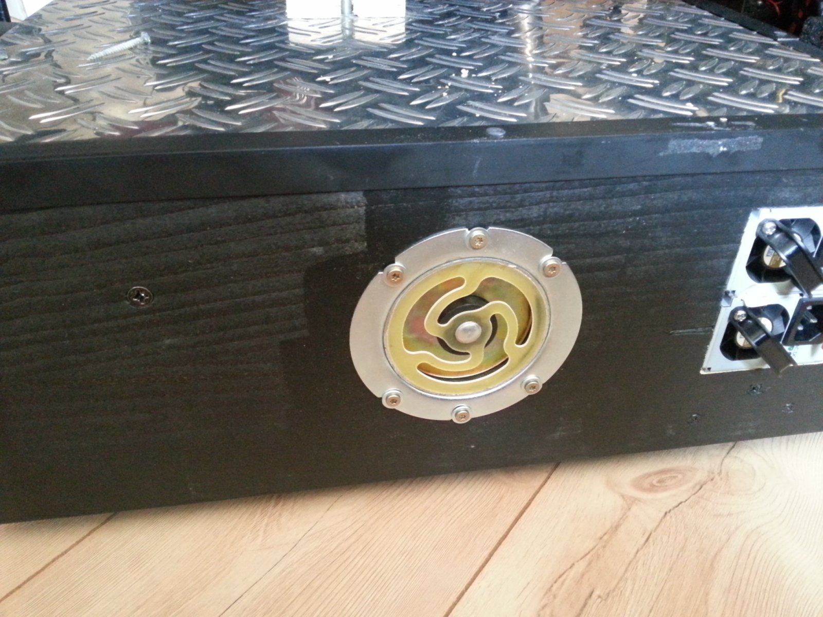

  7. Pit
    3,007
    30,510Coins
    +3,098 / 31 / -0

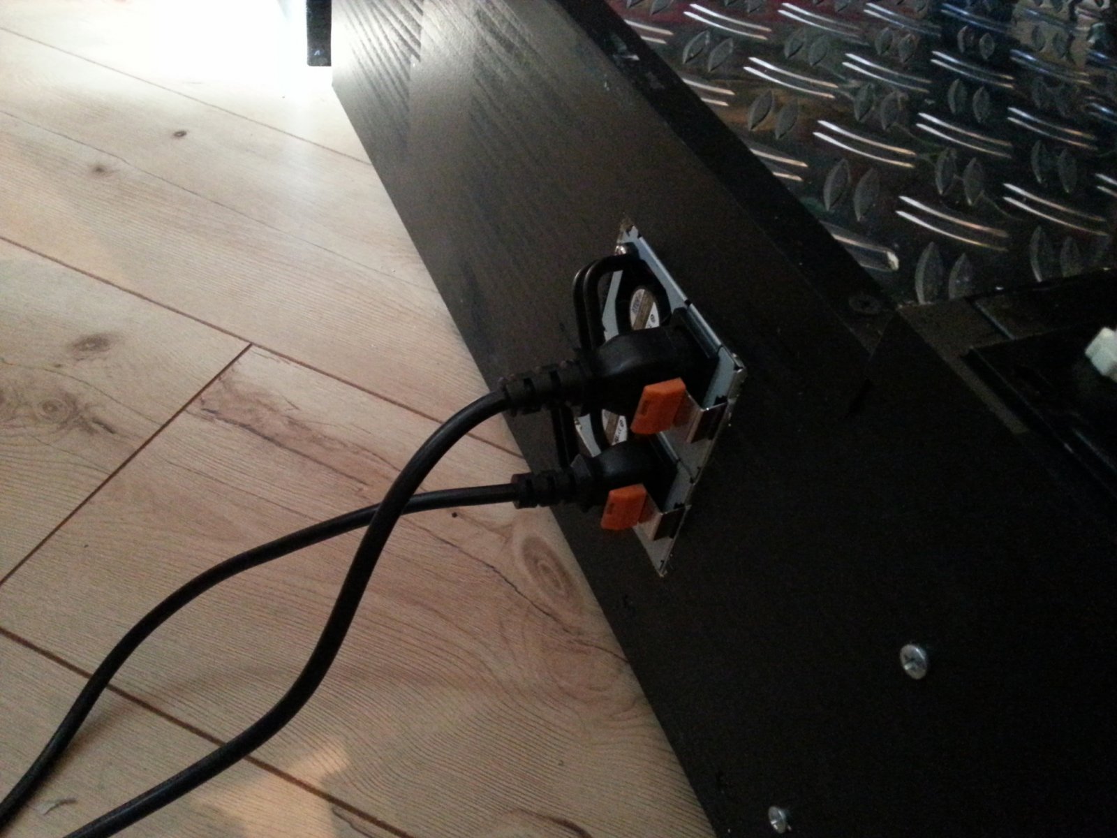

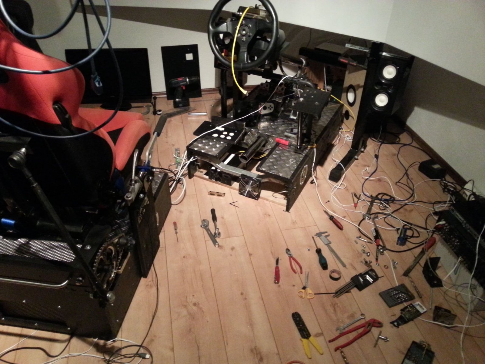

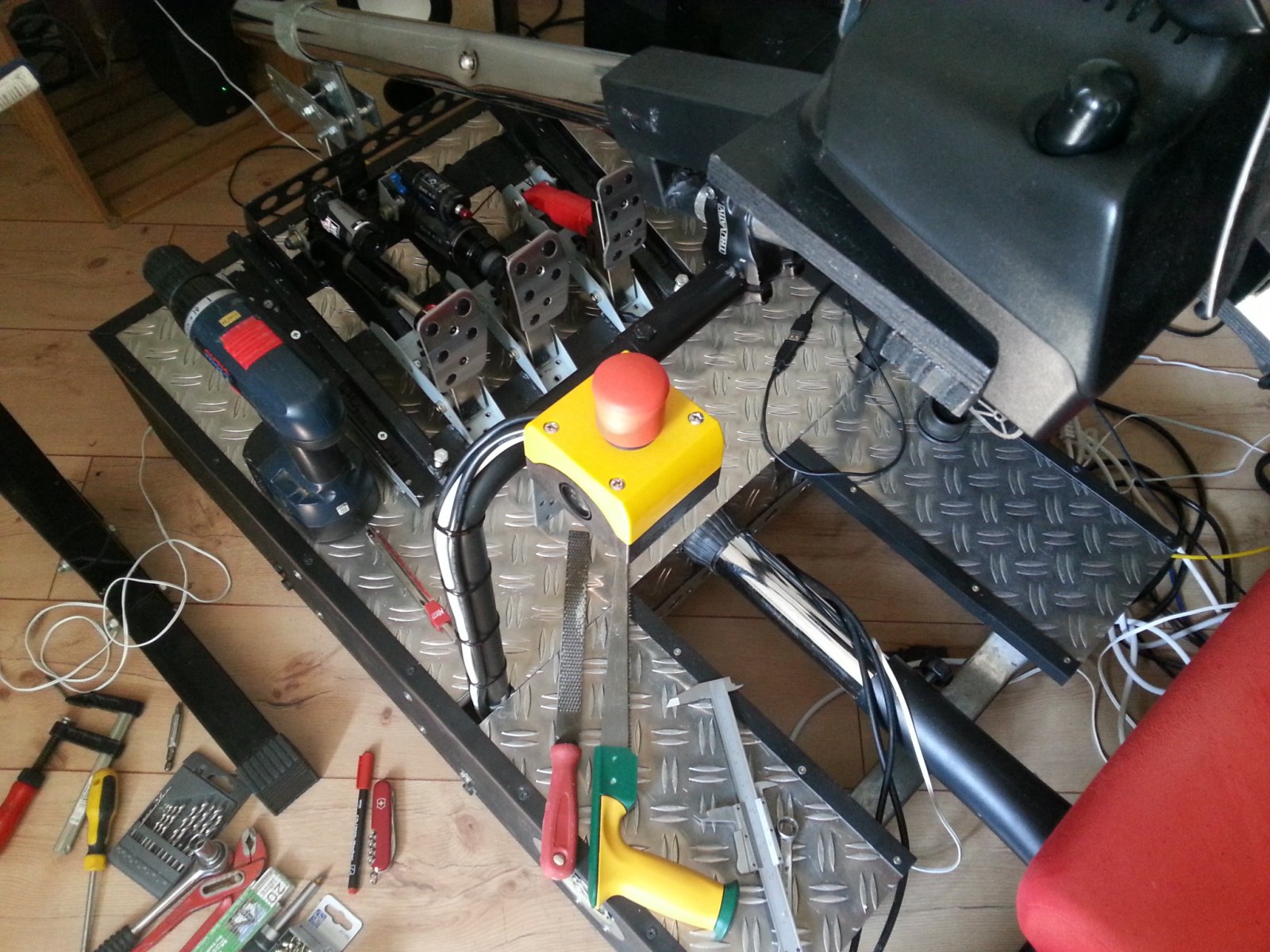

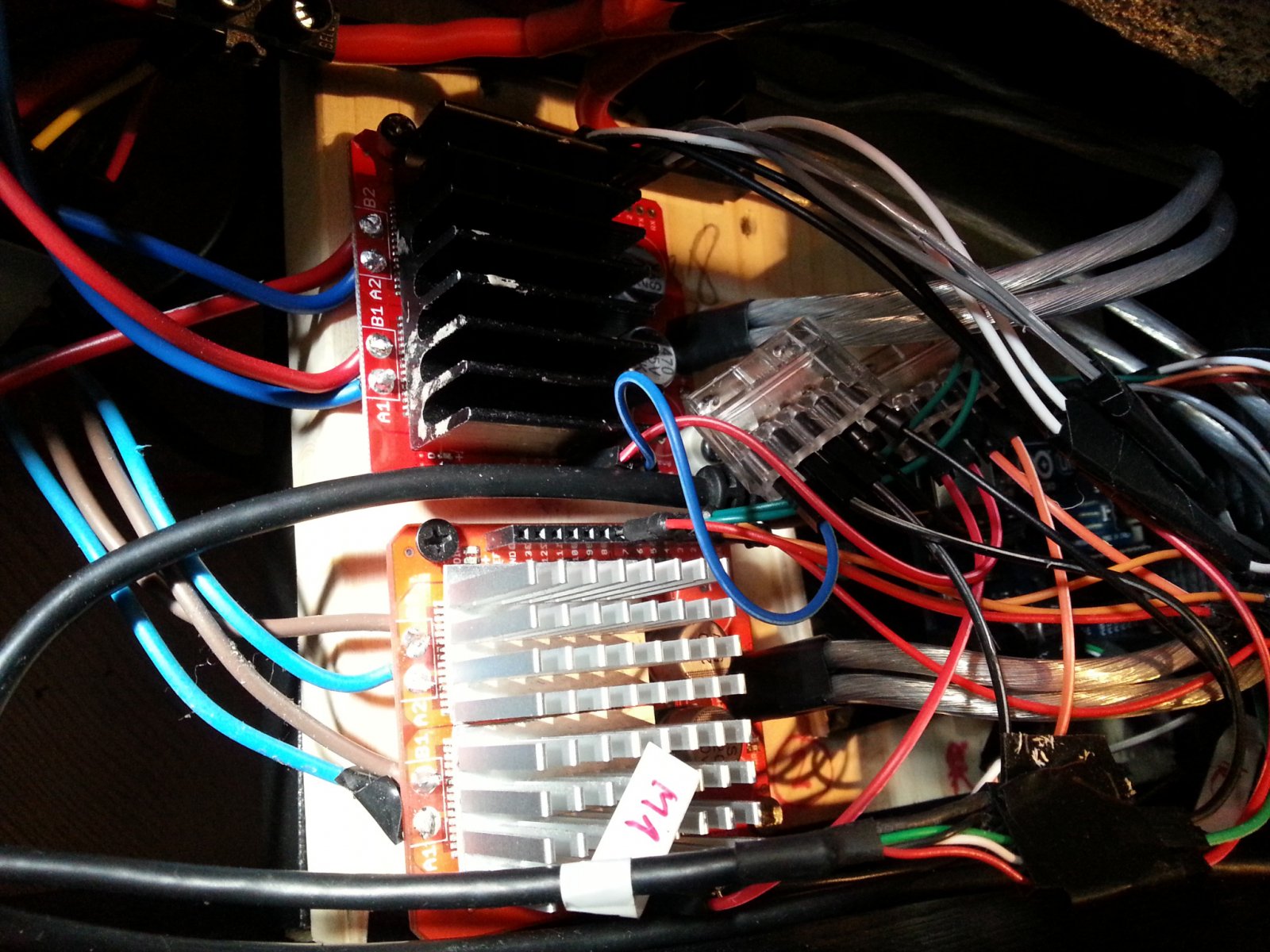

    Update: waiting for an amplifier bought at ricardo.ch (like ebay), built in two of 4 tactile transducers or bass shaker or whatever this piece of more reality is named...

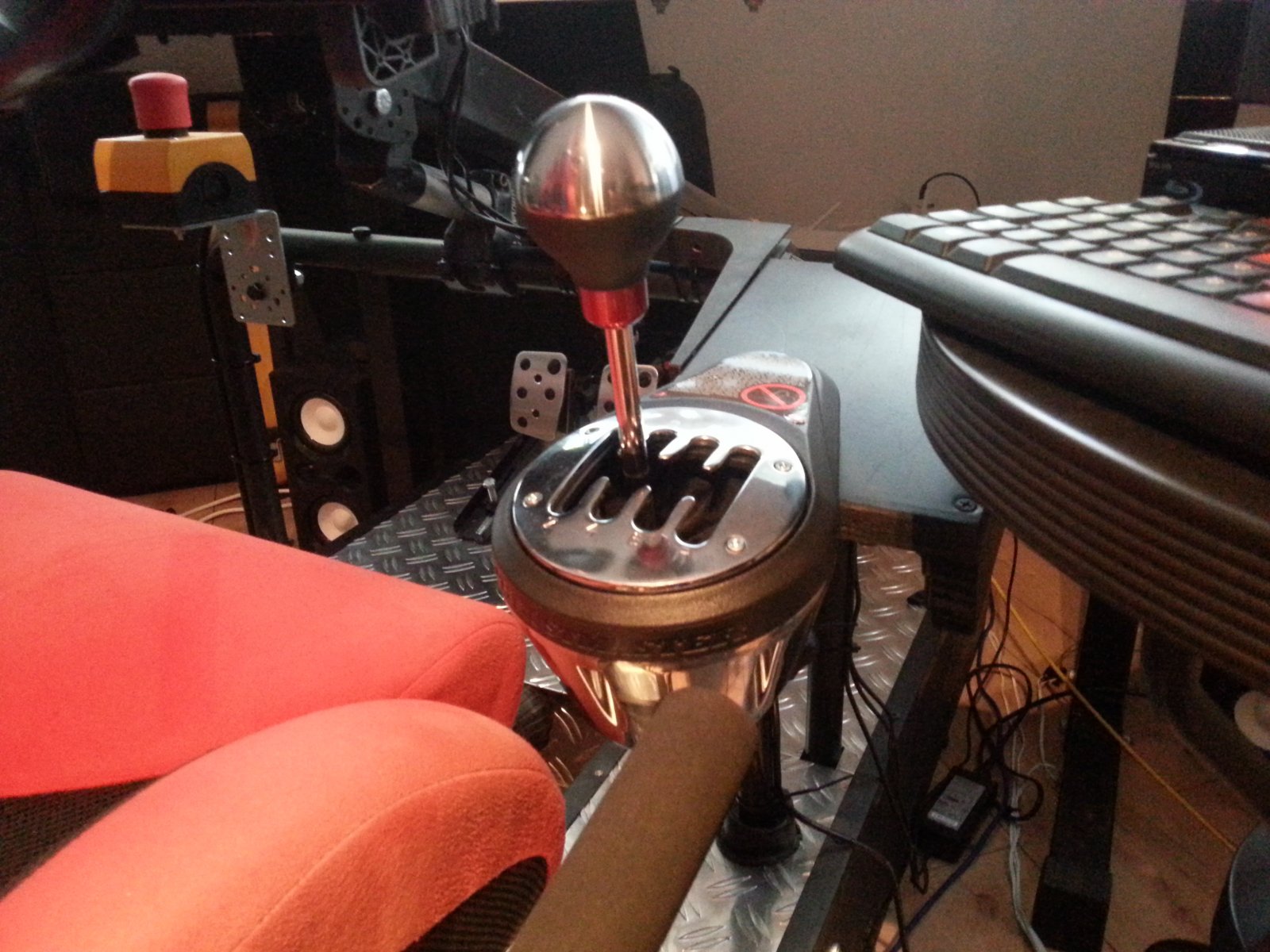

    Furthermore mounted a kill switch or "mushroom emergency button" (LOL).

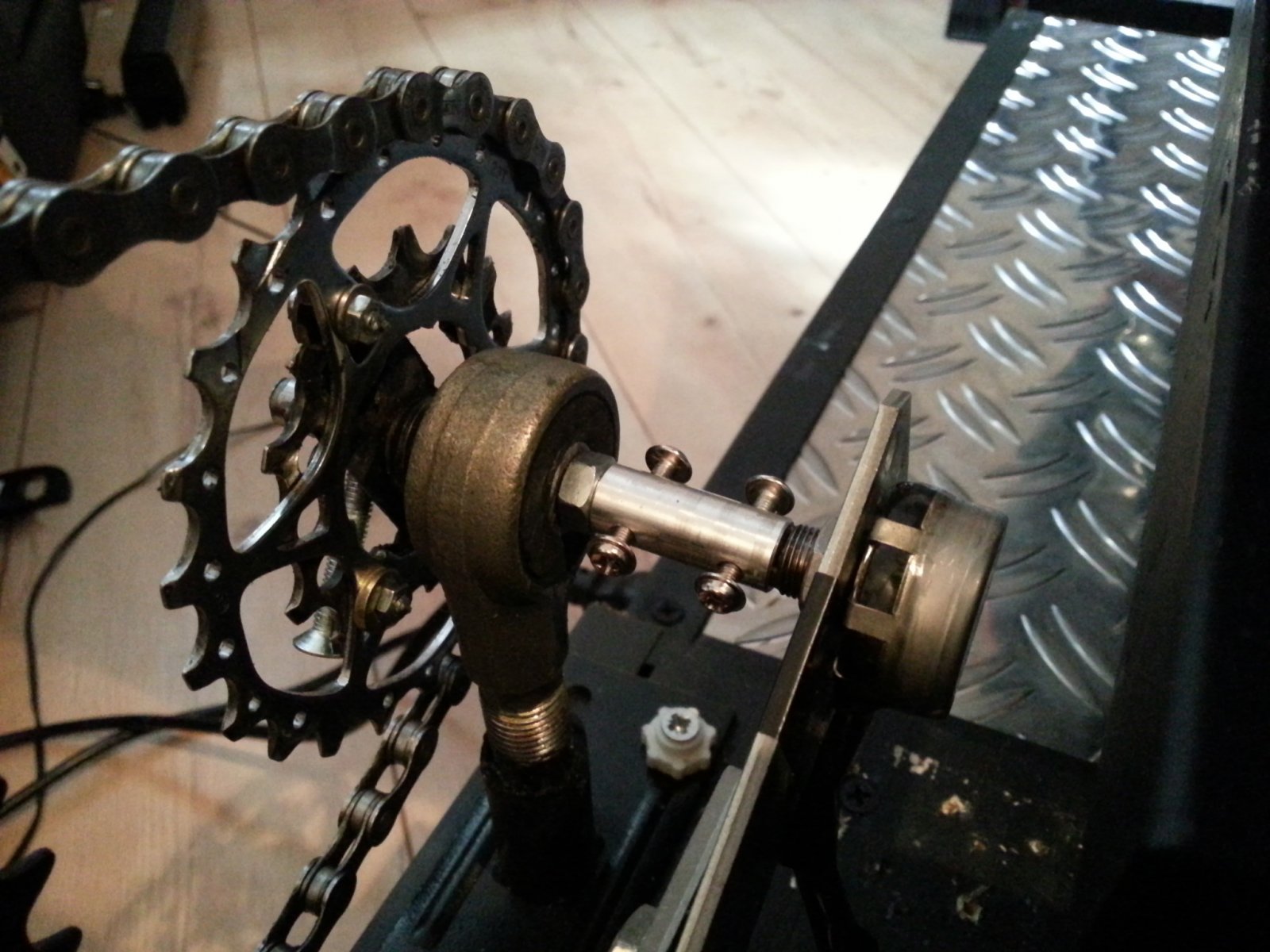

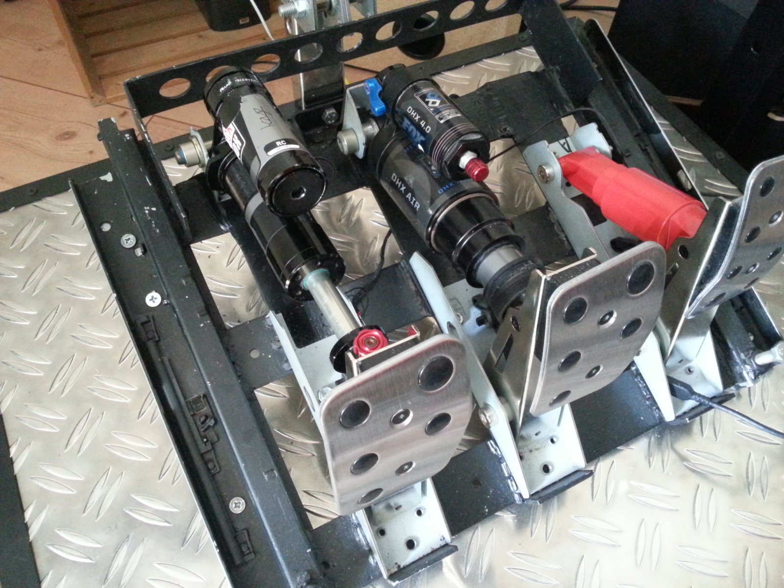

    Finally the original clutch by Logitech has been replaced by a bike damper. After modifying it the clutch works really impressively:
  8. eaorobbie
    20,503Coins
    +1,687 / 23 / -2
    Need that Oh S&*T switch can save your sim or even you.
    Pedal mod what a top little addition, I had been tossing up of a hydraulic mod or just changing the springs, convinced me that a better idea and I know where I can get those parts for almost nothing, mmm now where are me kids bikes , heehee.

    Assembling...

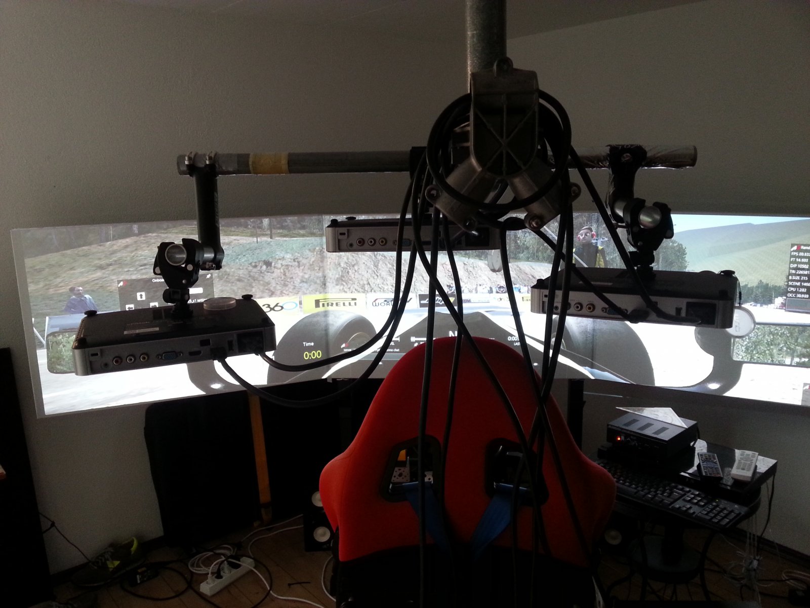

    Update 20.7.2014: tomorrow three Qumi Q7 as a trade to the Q2 will be delivered, so I can finish my rig at least. Later I will update the very first posting.

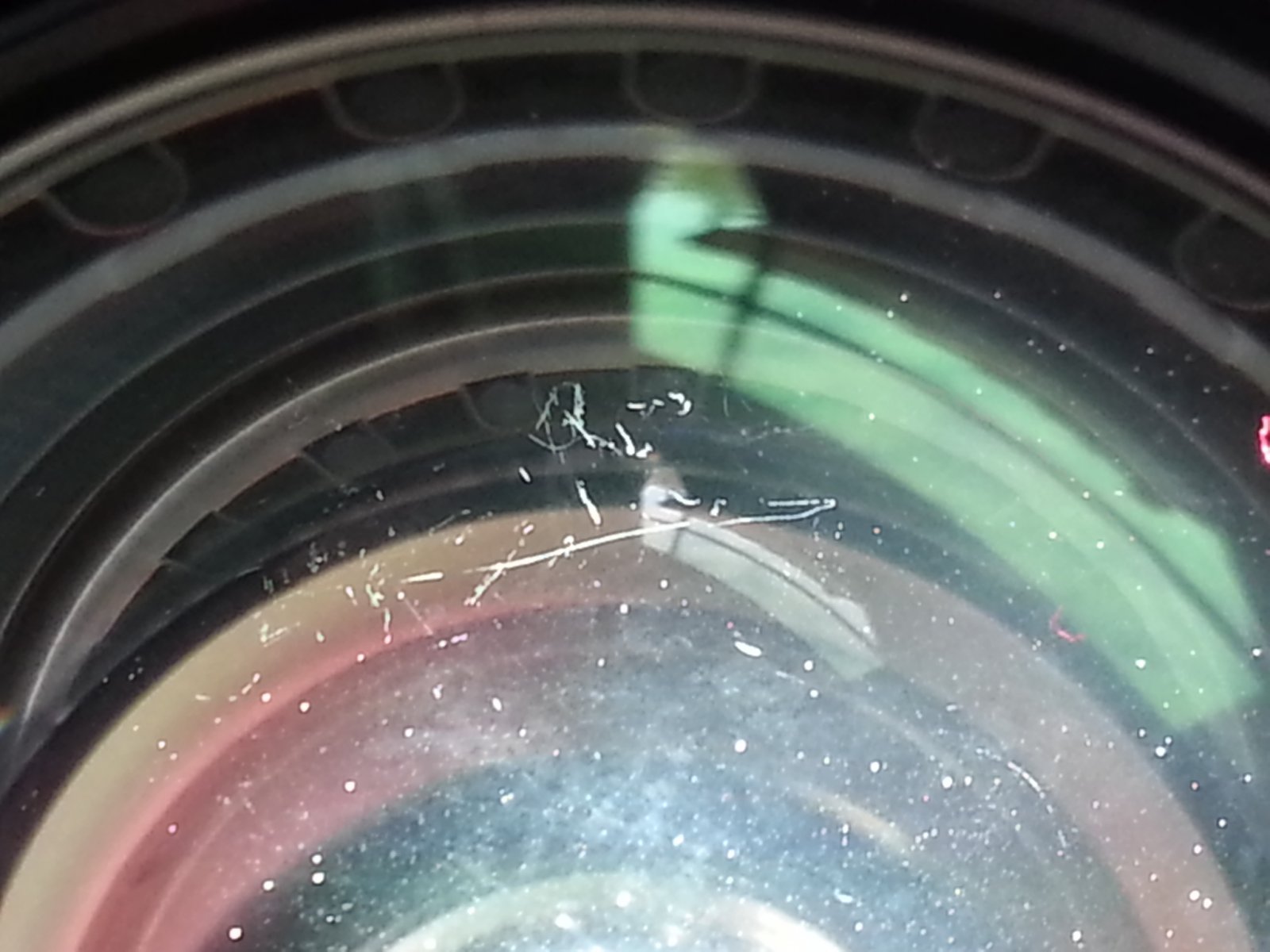

    Update 24.7.: the Qumis Q7 have been delivered today, BUT what a bummer one Qumi Q7 is defect again, shows only a red colour. :((((((((

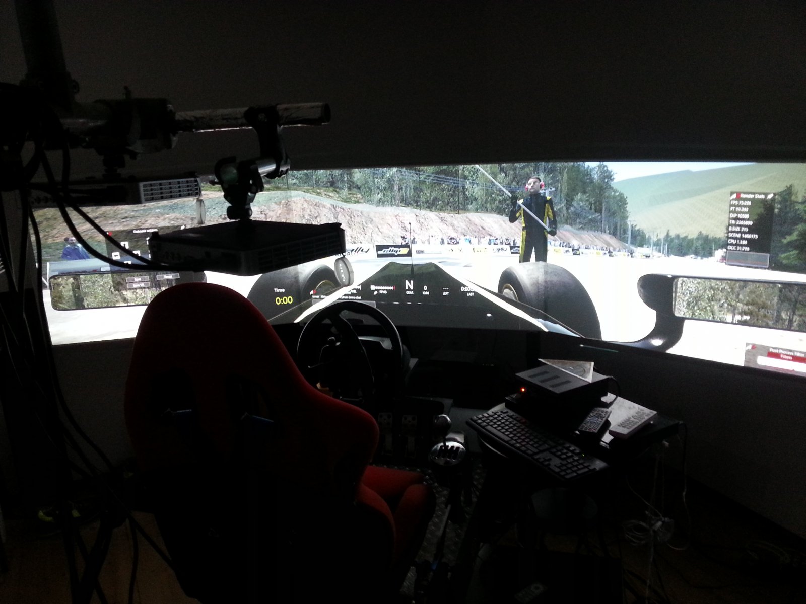

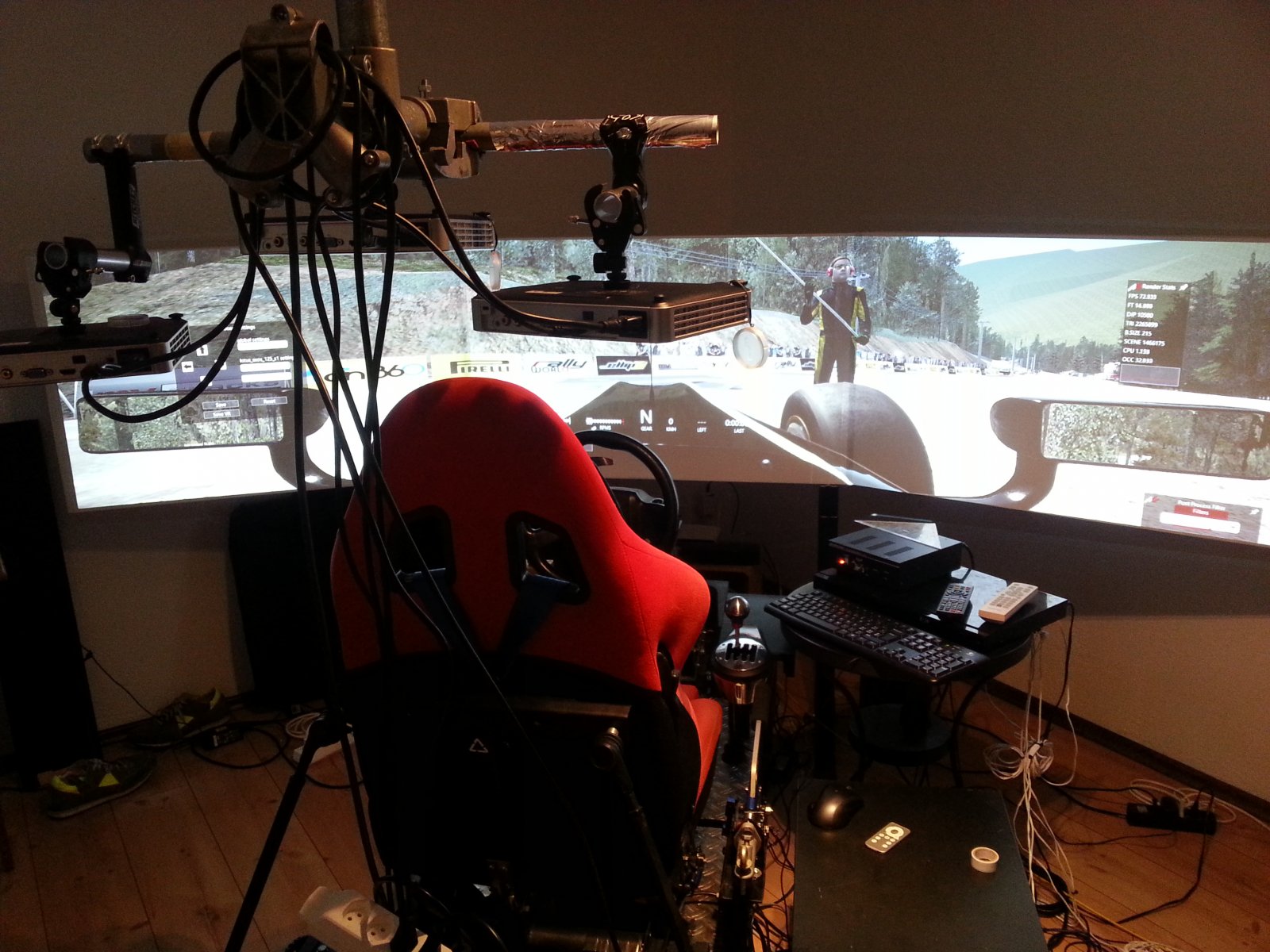

    So here we are with the latest news from the headquarter of high technology simulation of Switzerland :p, where I am sitting and stunning...after one Qumi was dead already after unpacking (only red colour), I found a loose screw inside of another Qumi. Not bad that fact, all the worse the lens of this Qumi has small scratches...already reclaimed and confirmed :-/ So I am waiting and waiting for once upon a time in future, when I can - eventually - drive using my 3 screens.

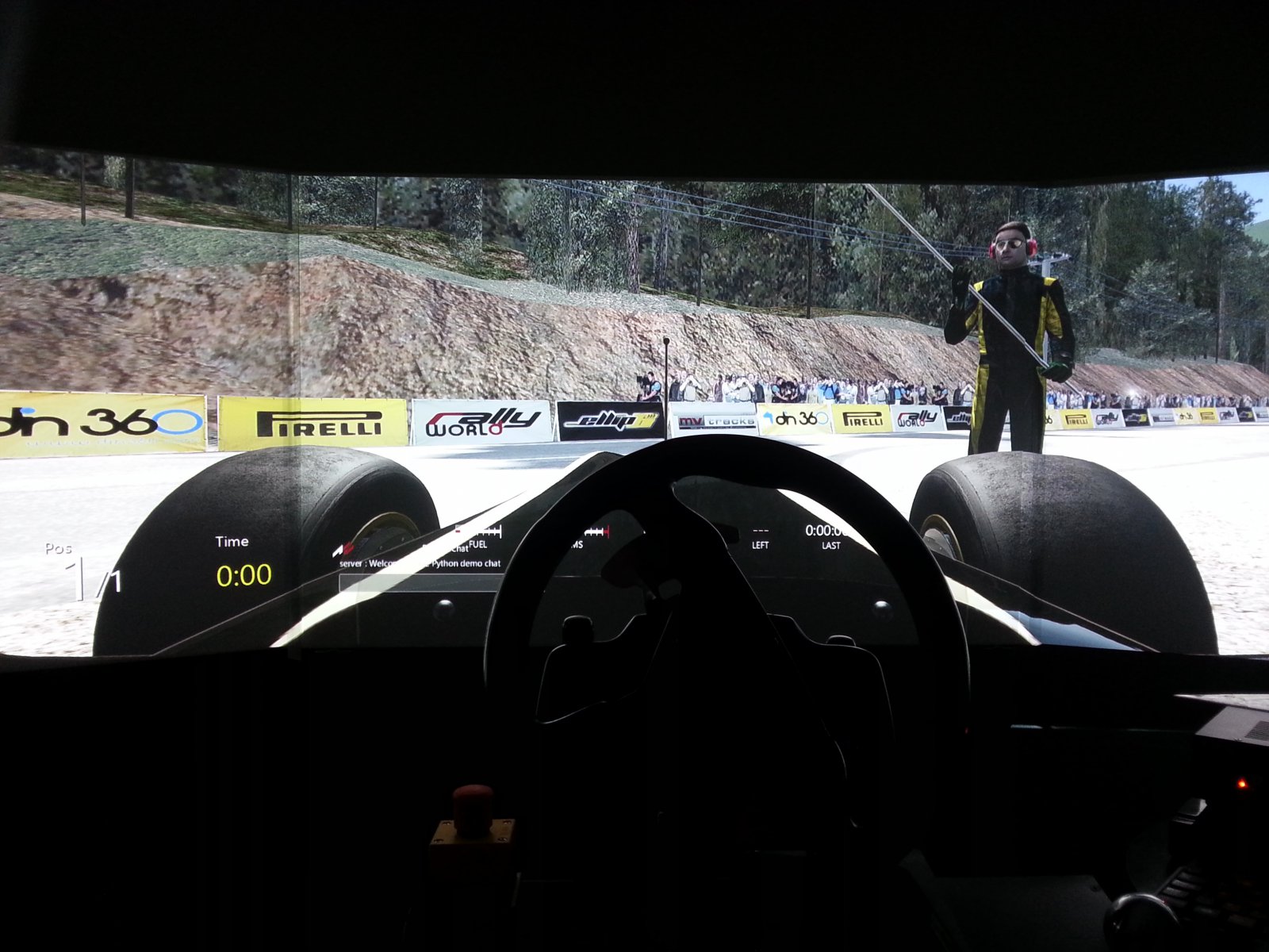

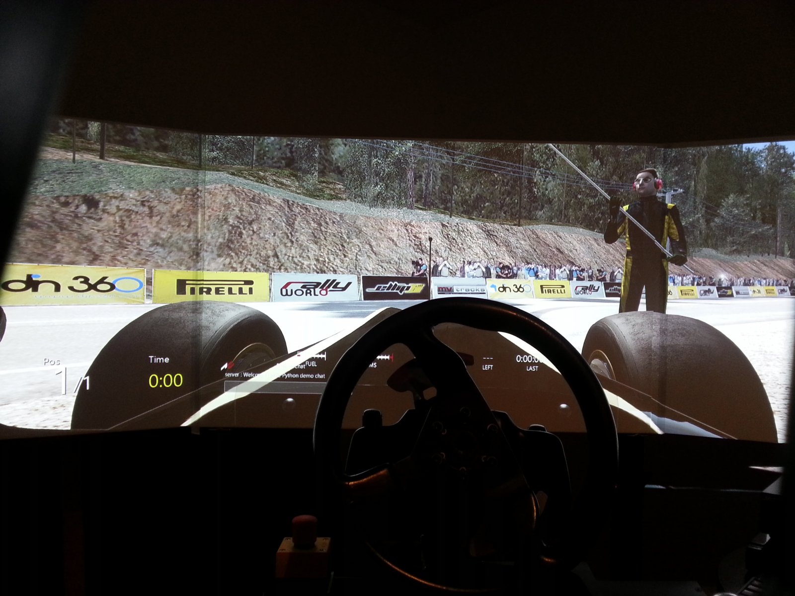

    Back from the holidays. Got the Qumis Q7 now working, really exciting experience!
    20140811_193026.jpg 20140811_193036.jpg 20140811_193057.jpg 20140811_193130.jpg 20140811_193144.jpg 20140811_193240.jpg 20140811_193254.jpg 20140811_193336.jpg
