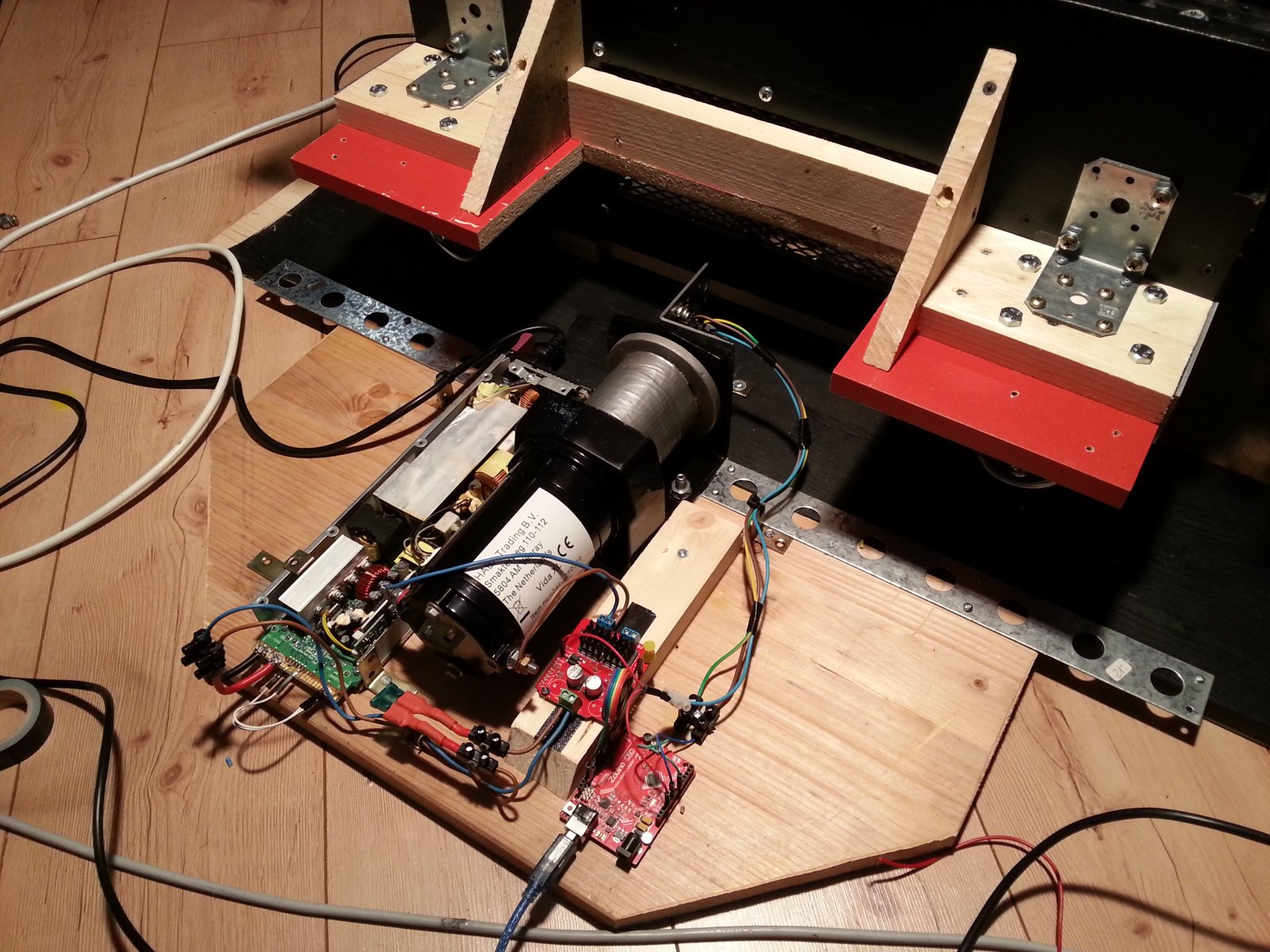

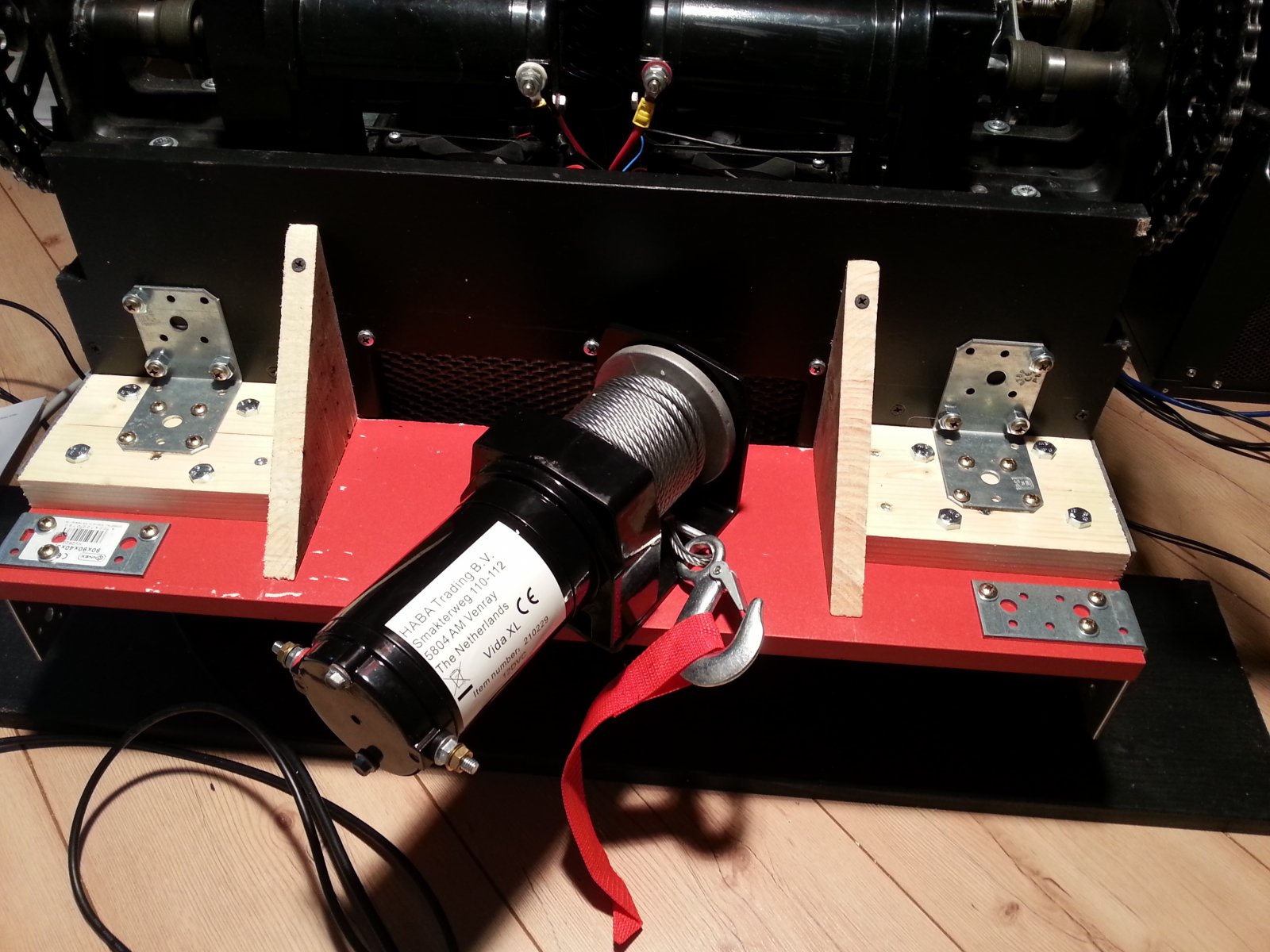

    Preparing for traction loss.
  14. Pit
    3,007
    30,510Coins
    +3,098 / 31 / -0

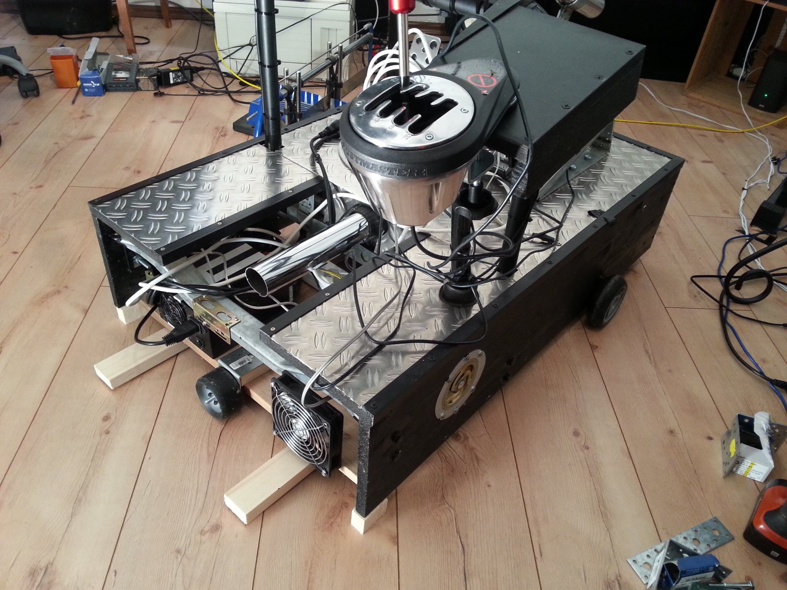

    Mechanical part is ready, now follows the electrical part. No painture yet...wait if it works at the end and then I will paint :)

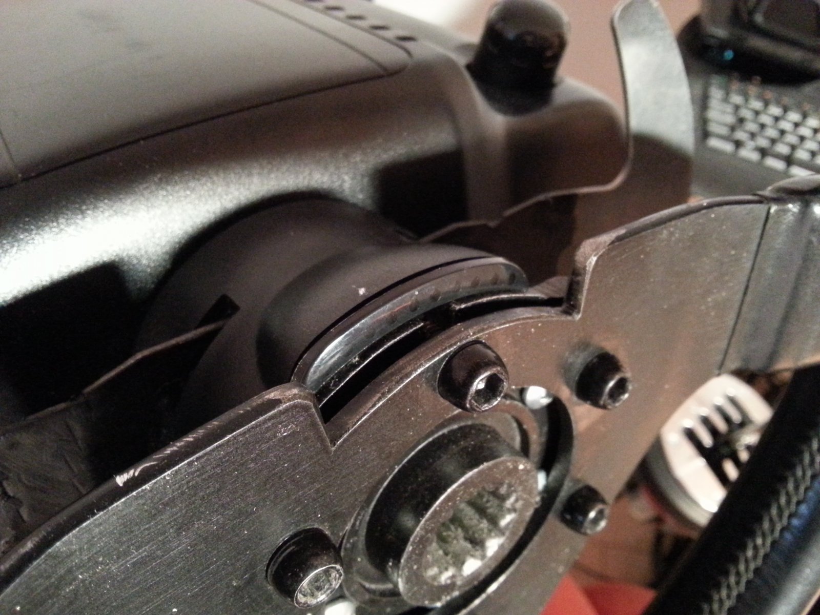

    The third baby has been delivered, only $55!
    And now with the original LED panel of the G27:

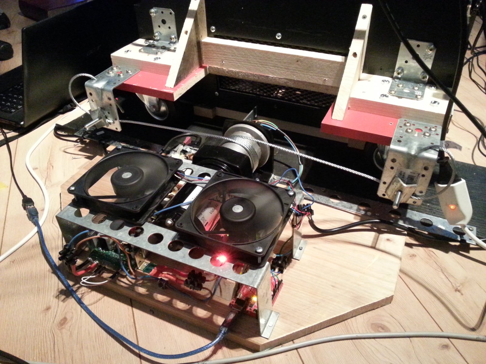

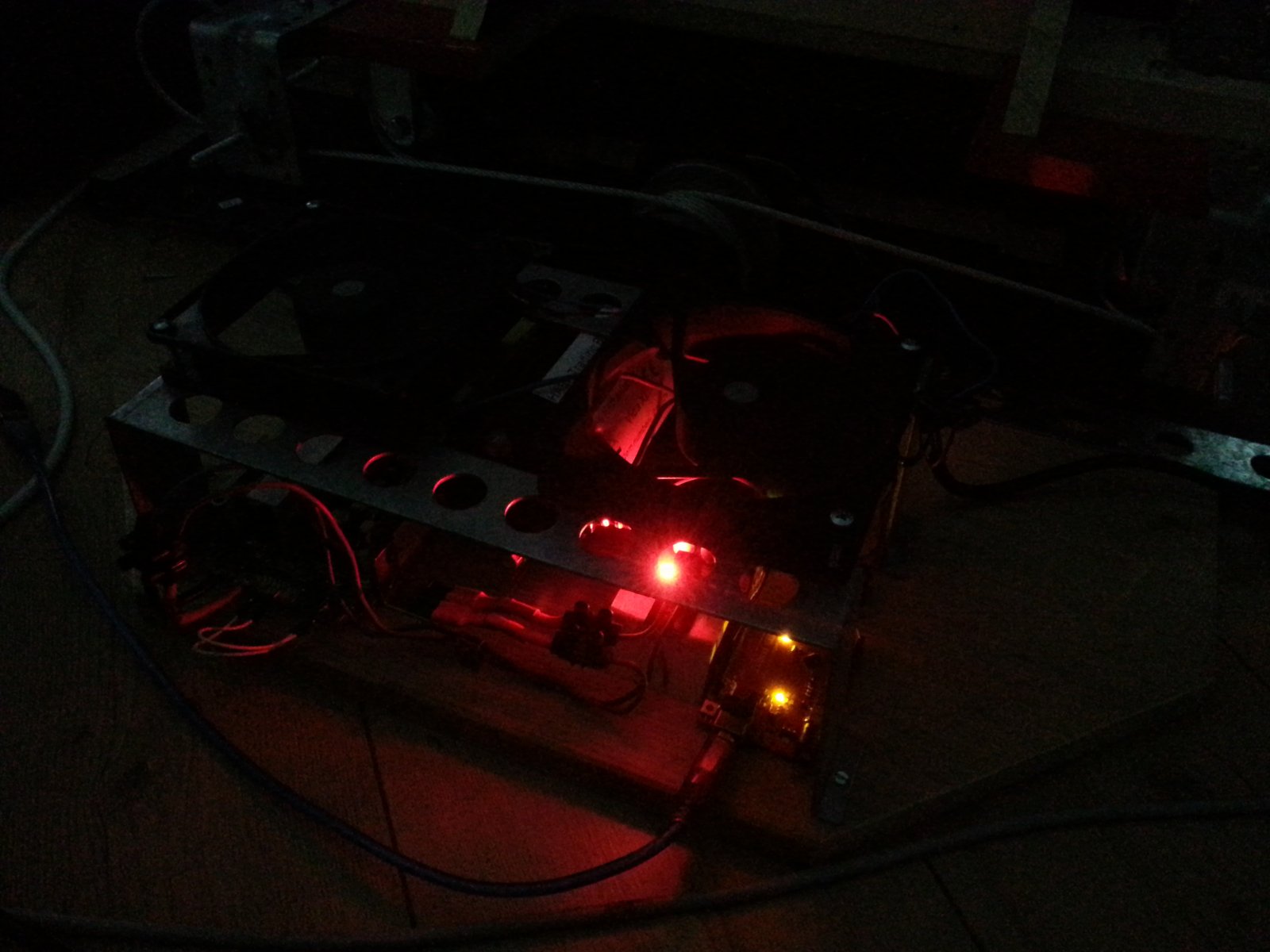

    No painting and sanding yet, no case and no design. I will give a repaint later if all is working fine.
    I do not know if my experiment will work...this evening I will know more :oops: (or not). There is something missing, without it no traction loss would make it possible. Could you imagine what it could be? :)
  17. RacingMat
    2,233
    21,082Coins
    no chain, no gain! ;)
    a cable maybe?
  18. Pit
    3,007
    30,510Coins
    +3,098 / 31 / -0
    [Quite right! You are the winner :cheers And it works in deed. The winches makes a very big noise, the other ones are less noisy especially because I tuned them a little bit (more grease inside). There is more optimizing potential for harder turns but I am on track :)

  19. Nick Moxley
    17,057Coins
    +2,506 / 30 / -2
    interesting concept, But wowzer's is that motor loud.
  20. Pit
    3,007
    30,510Coins
    +3,098 / 31 / -0
    Unfortunately it is loud but it will be better when I changed the plate where the winch is mounted (stone instead of wood) and opened the winch for greasing the planetary gearbox. These correctives result in less noise.
