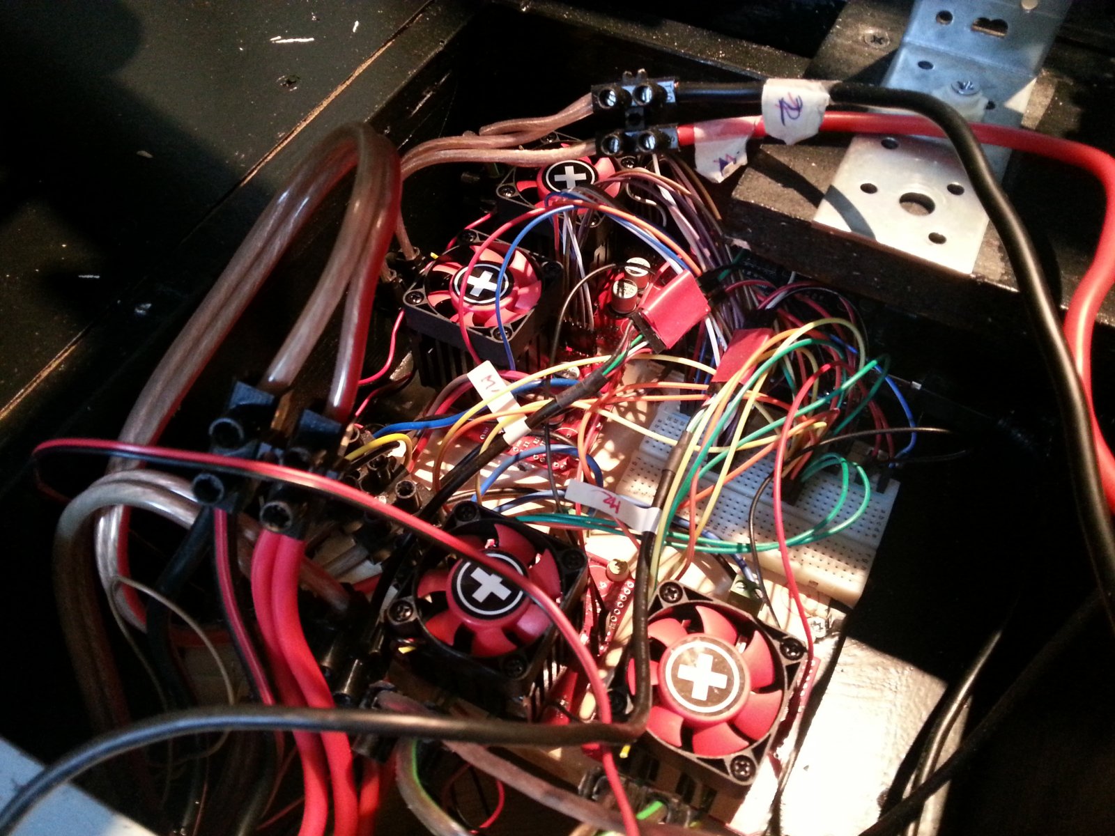

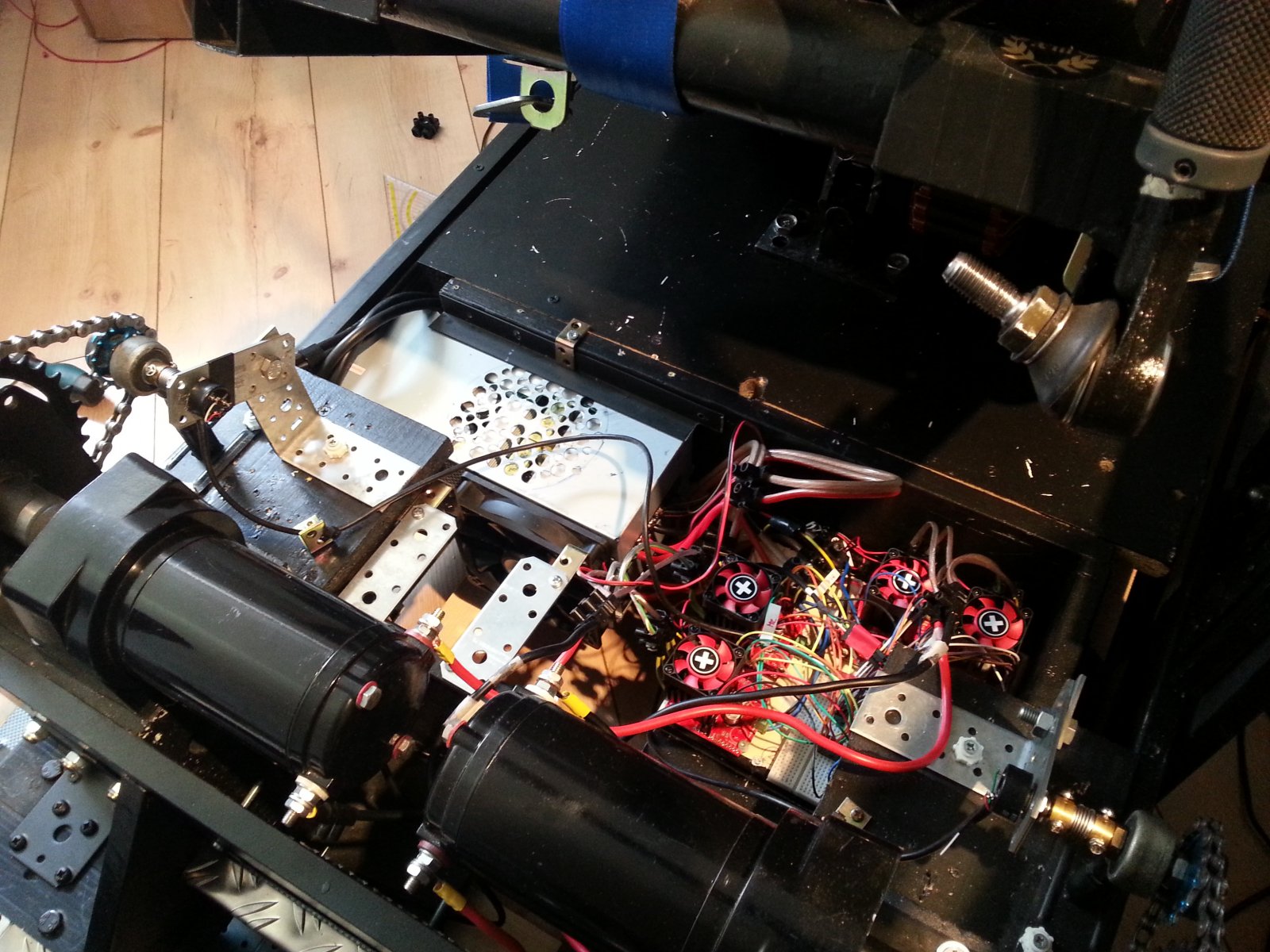

    One MM was stopping, after a short check I got this:
    To much power :) (or badly wired...)
    21,890
    152,971Coins
    +11,115 / 56 / -2
    Run it hard until it breaks...at least that is the simple end of things going wrong ;)

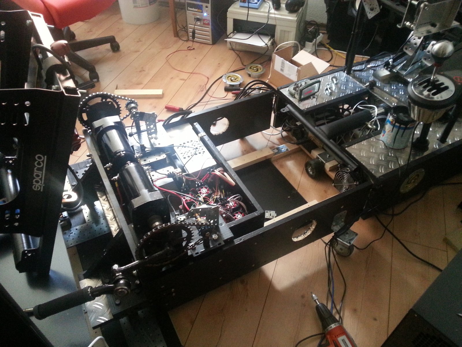

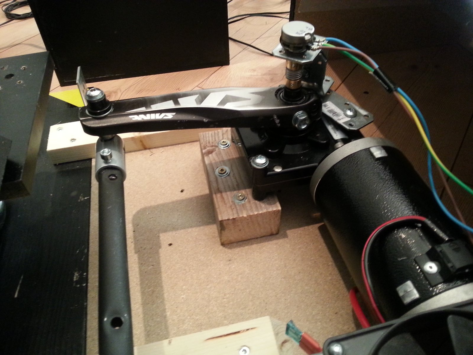

    Traction Loss rebuild:
    The DIY universal joint will be replaced soon by ball joints. BTW the new motor is great!! If my winches will die once upon a time (which I do not believe so) I will replace them, too.
    21,890
    152,971Coins
    +11,115 / 56 / -2
    Nice job Pit.
    I am guessing the new motor is also a lot quieter than the winches.
    What is the lever arm that you have used, it looks nicely sculptured?

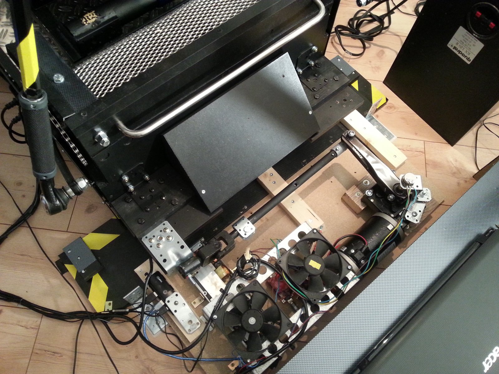

    oh yeah ;)
    it is a crank from my old downhill bike (Shimano Saint)
    21,890
    152,971Coins
    +11,115 / 56 / -2
    A bike crank...a very cool bit of re-purposing.
    So what is the CTC of the crank and did it need any modification to fit the shaft?
  9. Pit
    3,007
    30,501Coins
    +3,098 / 31 / -0
    The diameter is not equal to the shaft. I used some spacer and I had to drill out a bore to fix the crank:

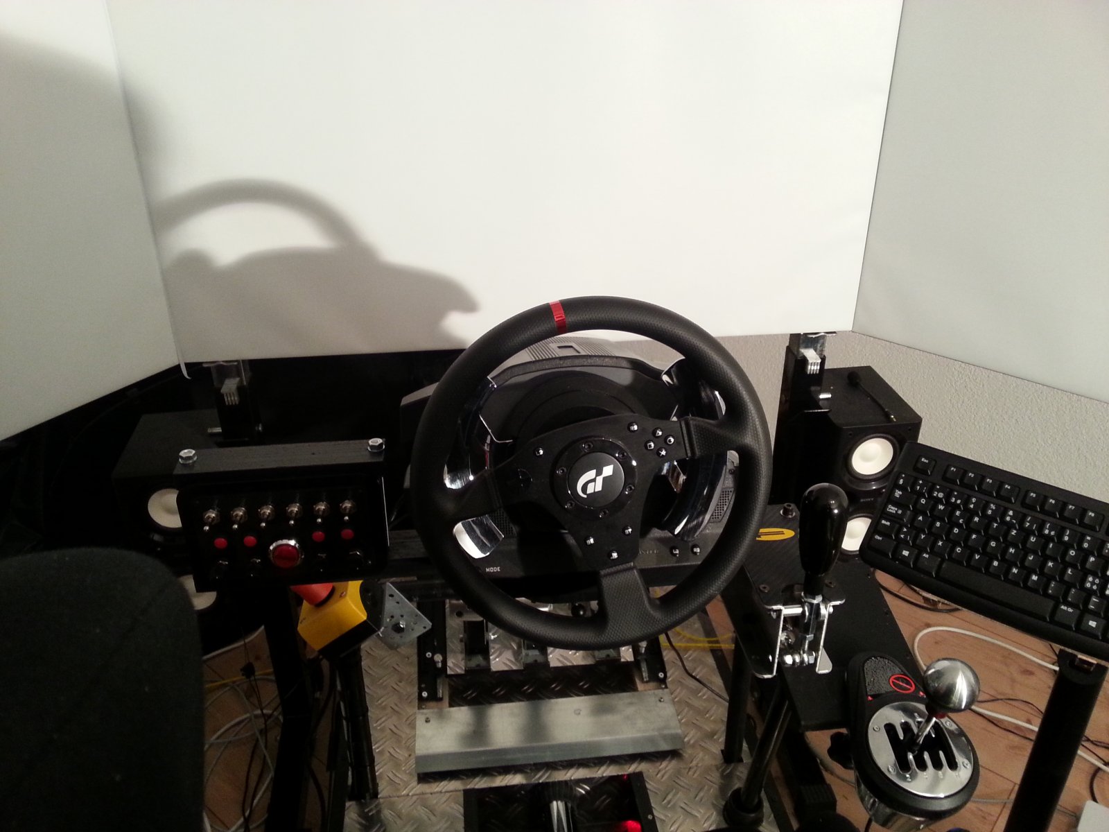

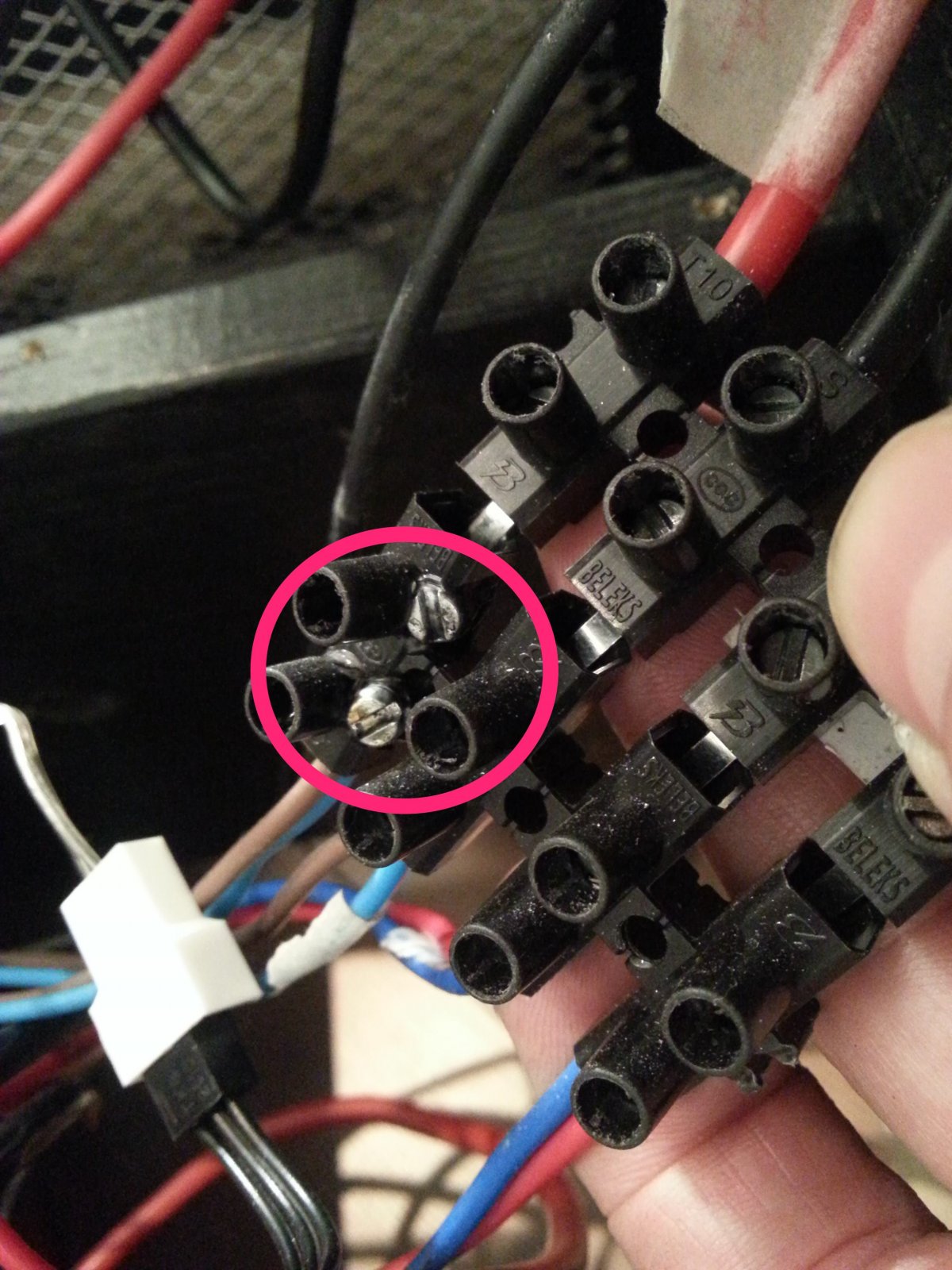

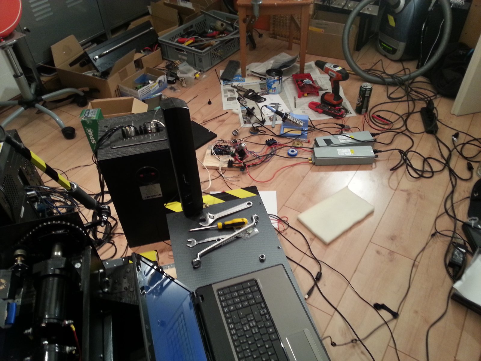

    Hi all, today the FrexGP seq shifter was delivered, what a peace of craftsmanship! The button box from DSD was already here so I was going to complete my rig:
    After all parts have been assembled I started the rig, and...one motor failed. For now I could solve the first issue (one +5v wire was loosing a contact), but after testing all I got only 9.6 V instead of 12v from one MM. Still looking for the issue... :)

    day after day your sim gets even better.
    try a different psu if you haven't already done that and take a measurement from your psu with some load on them.
  13. Pit
    3,007
    30,501Coins
    +3,098 / 31 / -0
    PSU works fine, I welded all again and controlled all so far, but the f"ç%"ç MM wont go higher than 9.6v. Tomorrow I will check it out in the "standard" mode, not as a half bridge config.

    Update: instead of one 2000 watts server supply DPS-2000BB now two of them (I already bought two).
    One PSU only fails on Nord (Pagani Zonda R or Mazda 787b...). Please keep in mind my motors are very powerful and if I would use "standard" motors with up to 350 watts one psu would do the job. I attached again the MM bank - as we say usually: "cubic inch capacity is replaceable with nothing but more cubic inch capacity" :) (not seriously but effectively)
