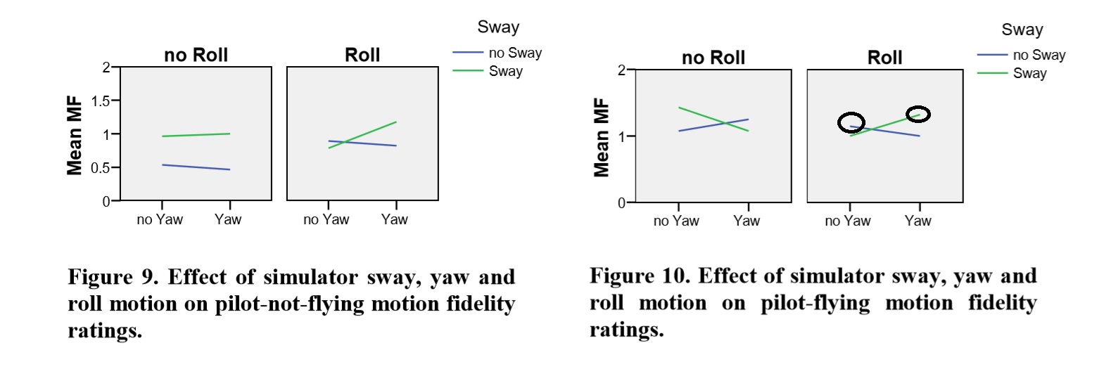

    I may consider 3DoF instead of 6DoF, with relatively large range of roll and pitch (say +/- 45 degree). I rule out the Sway and Yaw dofs based on my recent findings...

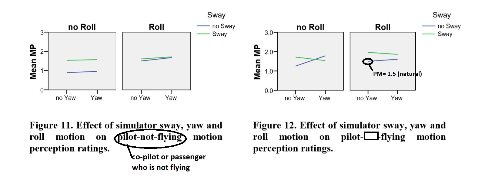

    I did some online search, and found a paper publish recently on experimental tests with a large group of very experienced pilots on a 6DoF commercial twin jet engines simulator plane:
    https://reports.nlr.nl/xmlui/bitstream/handle/10921/1430/TP-2016-629.pdf?sequence=1
    On the Motion Perception (MP) rating, the results show that without sway and yaw the MP is actually better around 1.5 (natural) --- not too weak and two strong:
    (Update: sorry, PM=2 is natural, with sway in this case is actually better, because of sided wind).
    On Motion Fidelity (MF) Rating, the results show that without sway and yaw the MF is slightly lower than with sway and yaw:
    This is not important to me since I would not use real equipment with realistic FFB as they do. Also, I am not a pilot so I really have no experience and could not tell too much about Fidelity anyhow.

    Look interesting! You have to note that this is only a decrap maneuver that was performed in a normal Level D flight simulator. The maneuver was always controlled and executed within the flight envelope.
    Result: The roll axis is more disturbing and translational forces help the pilot.
    But, uh...
    imagine what happens when this happens:
    This manoeuvre without roll axle would hardly cause any stress - the pilot would act as he has trained.
    But with roll axis he would probably pee in his pants! And may he would even overreact...and we are only talking about 45° bank.
    I tried this maneuver myself in your A-320 Level D Sim (max. roll angle 22°)...forget it, has nothing to do with reality.
    In summary: is even 45° roll angle enough? I'm not sure, if you want real flying fun you won't get around 6dof + roll/pitch with ~70° angle, imho.

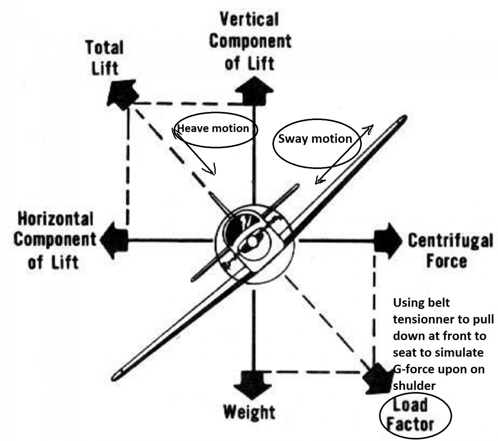

    Not sure if any one could make a 6dof rig with ~70 degree roll/pitch. I would guess it is hard to do so and probably very expensive.
    Even though if have such platform being built, my concern would be on the SimTool SW itself, which does NOT use mathematic model of 6dof to calculate the translational movements (heave, sway, and surge). It simply let user apply arbitrary fix weights on 6 actuators. Most of people just uniformly assigned to all 6 actuators. Thus, it cannot produce translational motion correctly. Flight sim based on a rigid body as roll/pitch/yaw, the coordinates are fixed on center of body as rolling/pitching/yawing hence the translational motions are referenced to the center body (airplane/pilot), not to the ground.
    For an example, as shown below, with 45 degree banking for a turn:
    Say, if the plane needs heave up for 2 inch, the SimTool just cannot accurately feed the data to the rig doing so. It will lift rig up for 2 inches that will actually contribute to both heave and sway motion from plane/pilot point of view. Similarly, if the plane needs to sway 2 inch, it will move rig right/left for 2 inches that will also actually contribute to both heave and sway motion from plane/pilot point of view. This is because SimTool does not calculate each actuator actual movement in order to make correct translational movements from plane/pilot reference.
    I guess I may think of just making 2DoF (roll/pitch) with max up to ~60 degree (that is feasible), then add air bladder under seat for heave and a sway rail mounted under seat for seat sway motion. Does this sound good?
