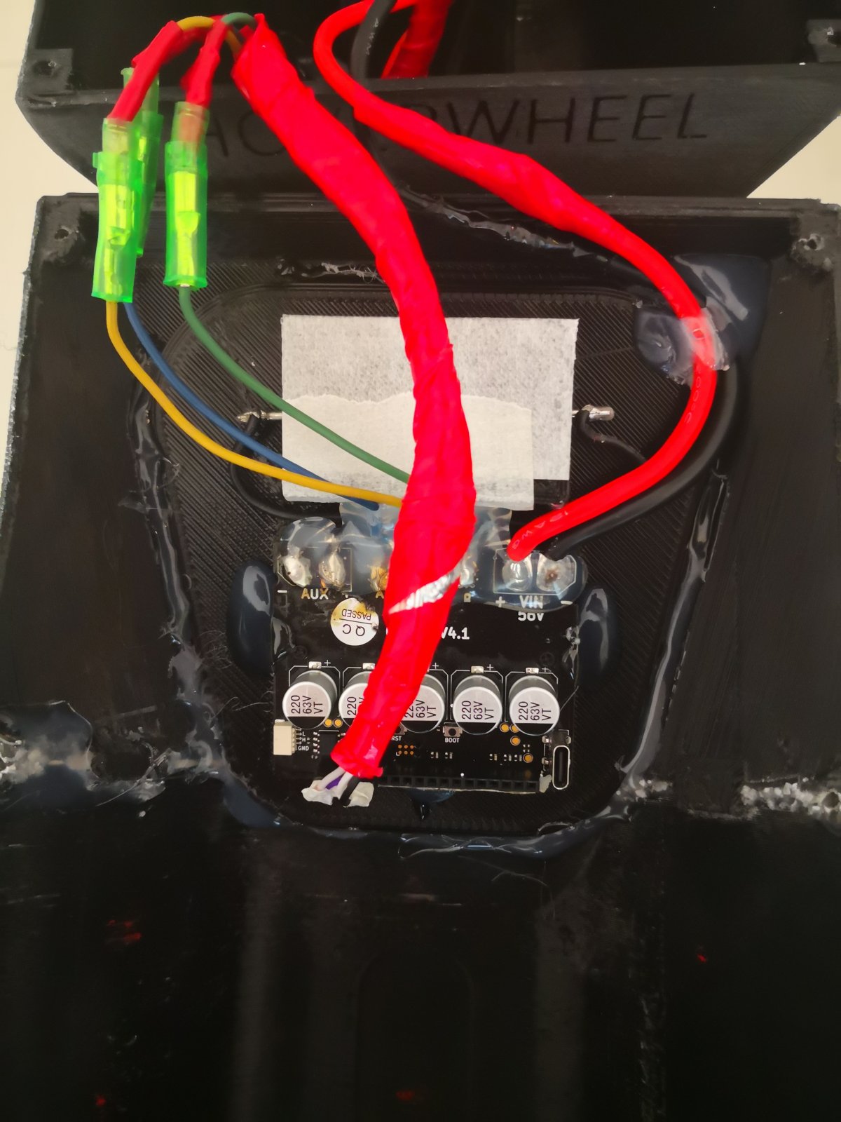

    What kind of pulley you use here? And how you attached it at the back of the hub?

    I am currently printing all the parts for this (almost done), what screws (type, length, diameter) do you use for the assembly? It looks like it uses no nuts, so just threading in the plastic? Does it hold up over time? Thanks, great work!

    I was going to put threaded insert into the build, but the Amazon guys was taking too long. But so far the enclosure is holding up well, since it doesn't have much movement. I did add a small hinge to back to facilitate working on the internal, simply using magnet to keep it closed, easier to open and close without the need of a screwdriver

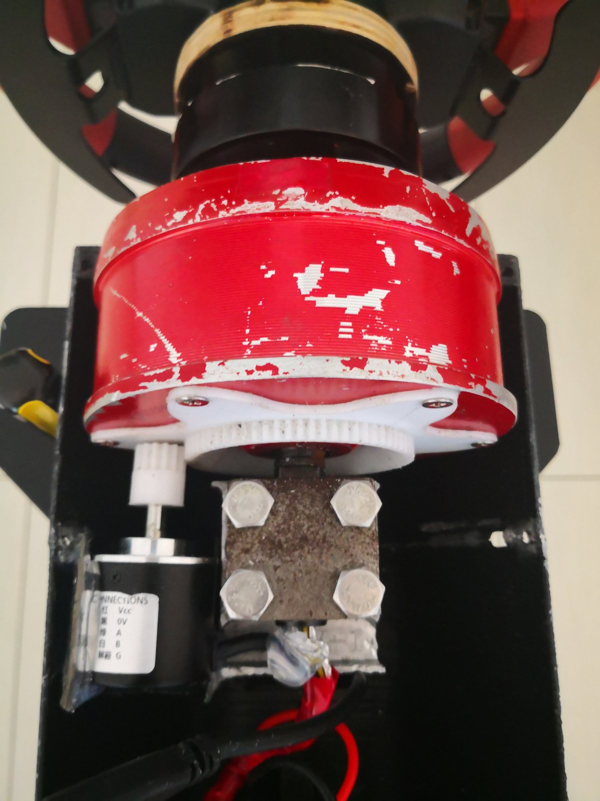

    Hi all,
    I will post here a SolidWorks assembly with the encoder mount that i designed. This is tested, it works good. The cog wheels do not mesh 100%(of the surface) but i have tried to make it skip gears, and couldn't make it.
    These brackets were printed with 40% infill i think , solid enough. Encoder cog wheel was pressed on the shaft, and motor cogwheel was bolted with the 6 bolt of the hoverboard motor cover.
    Thanks, and good luck !
