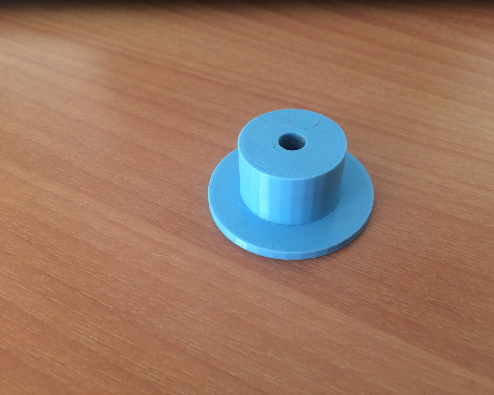

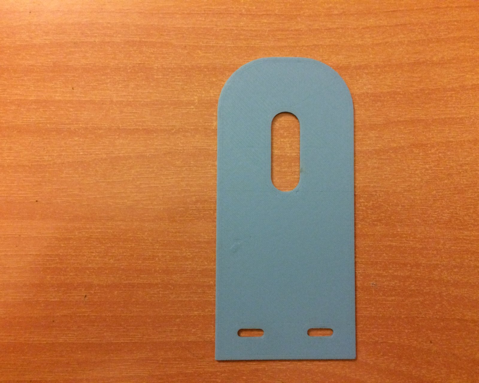

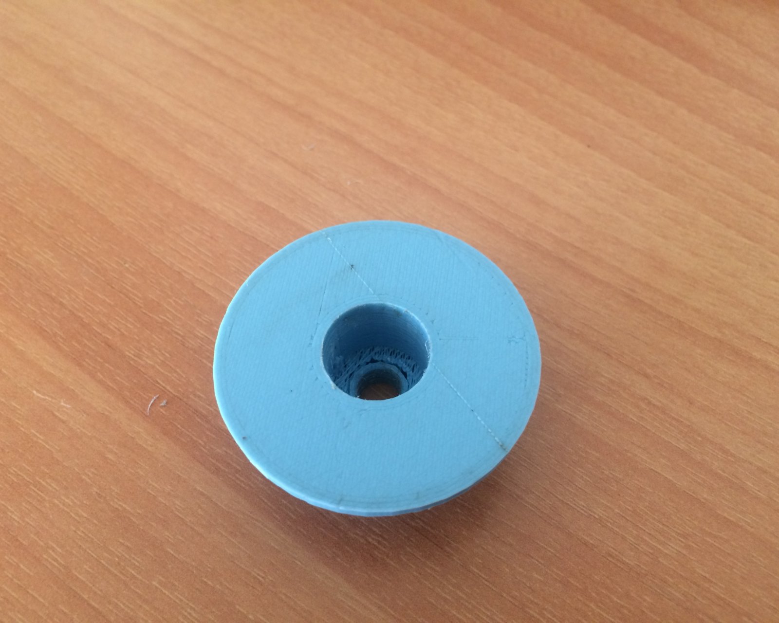

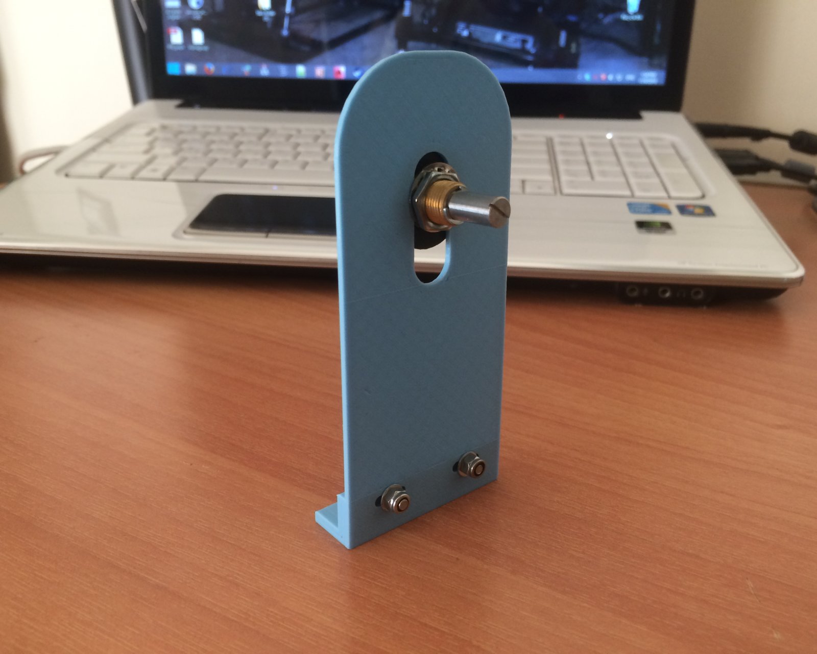

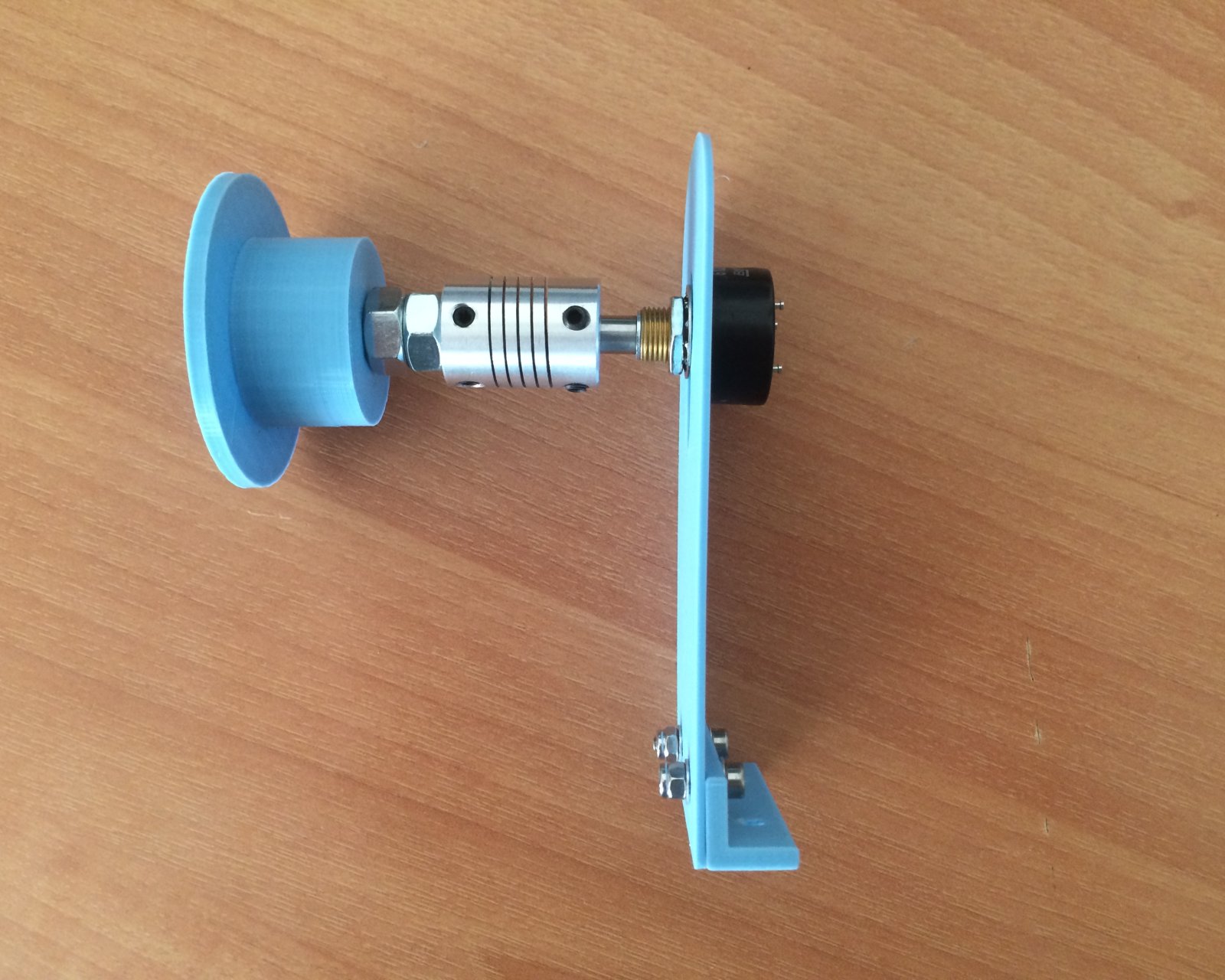

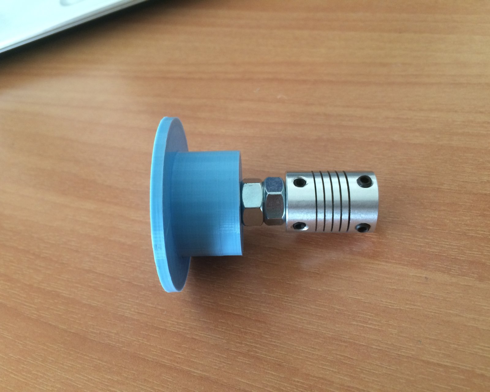

    here is how i mounted my hall effect potentiometer to my wiper motors
    i have attached the STL files if anyone needs them.
    the inside diameter for socket allen screw head and the thing that sticks out from the motor is 17.15mm
    there are tw0 files for the motor part.one for 6mm and one for 8mm
    for the motor part i have drilled a hole and screwed it to the motor so it can't slip
