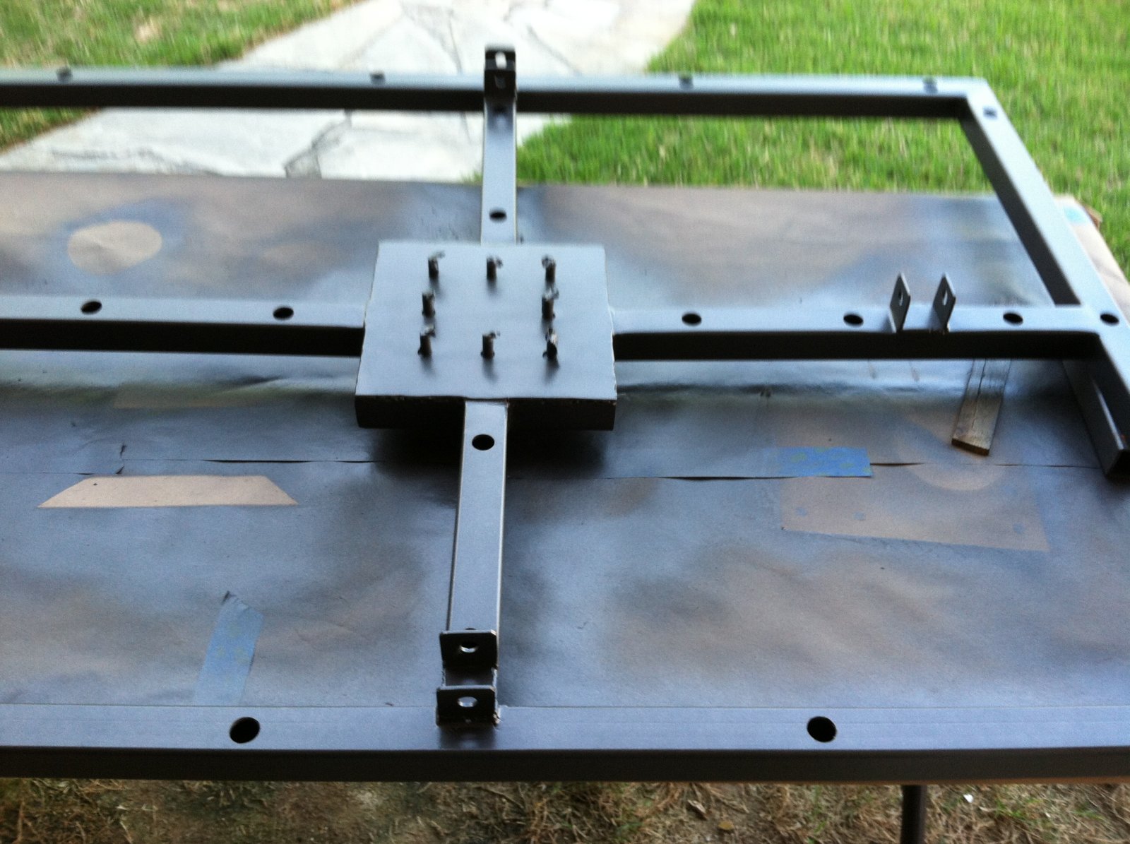

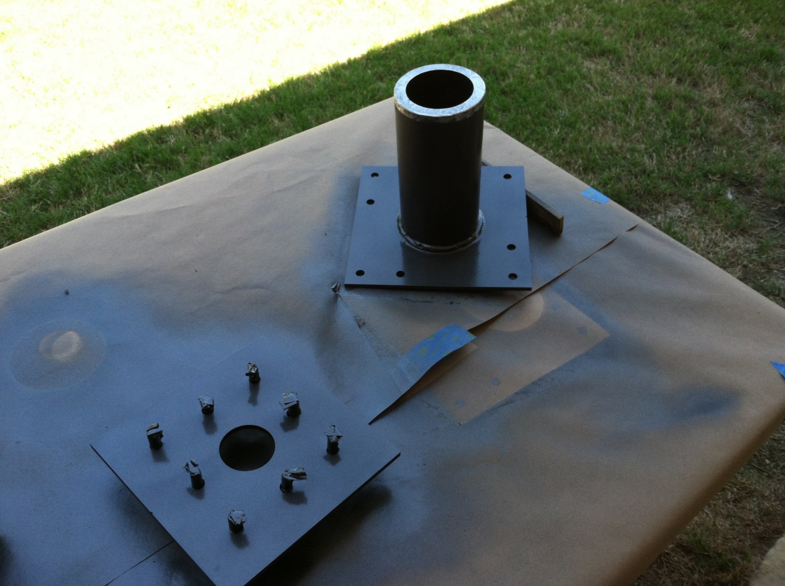

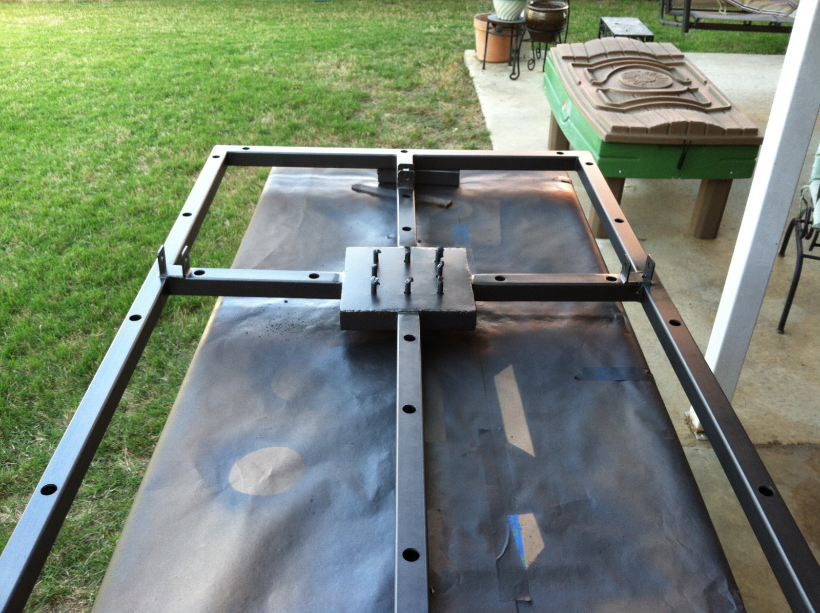

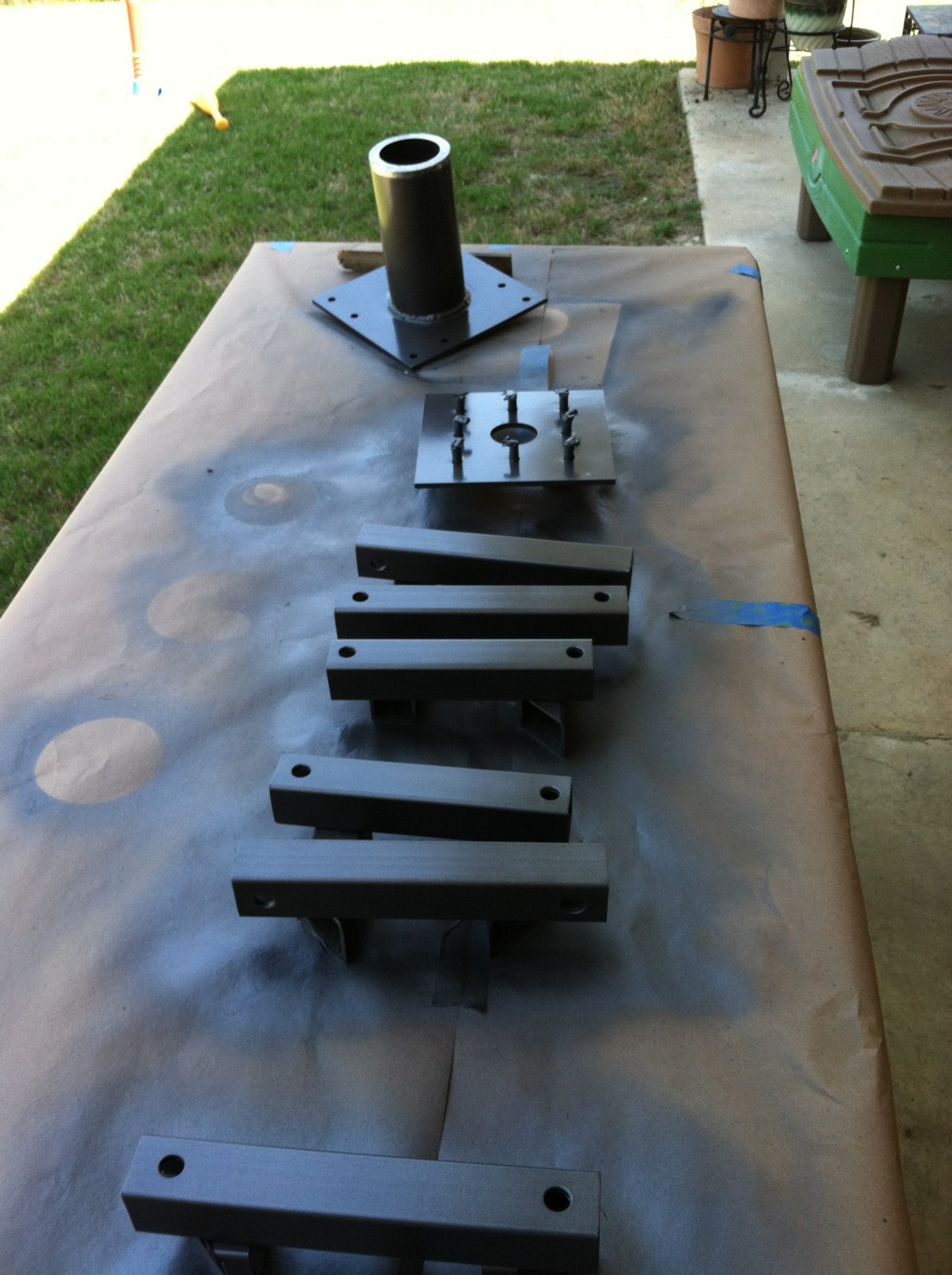

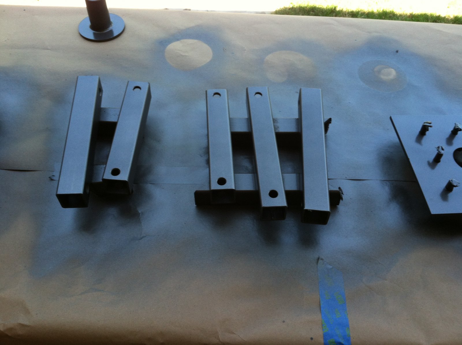

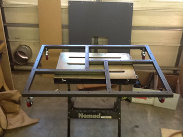

    Base Unpainted 2 - 020814.JPG Base Painted 1 - 020814.jpg Base Unpainted 1 - 020814.JPG Frame - Angle for Caster - 020714.JPG Frame Angle with Caster - 020714.JPG
    UPDATE - A few more pictures.
    Well folks, I "have" been busy somewhat. Weather won't allow me to paint the base steel frame - it's holding me up but I'm sure it will happen.
    I have cut the 3/4 MDF for the base steel platform cover, round-cornered with router, drilled the holes to match platform base for bolts & nuts - also used forstner bit to countersink my attachment holes so they
    will accommodate my 3/4" vinyl hole covers - middle pic is with the base cover painted and ready to go - as soon as I can paint my base steel.
    The bottom two pictures - left side, I have welded and ground the angles in each corner to accommodate my casters. Bottom right pic, I have temporarily attached a caster for fit "and just to make sure".
    Guys, I'm really having fun and the ol' brain juices are starting to flow once again.
    I am going to open up a new thread in the "Questions & Answers" section - I would like you folks to see if I'm on the same page with my gearhead/pot setups, and other questions as I'm getting into some areas of the build that I need other thought processes.
    I will continue to post pictures and updates here, as they happen.
    Thanks so much and have a blessed one.
    Tom

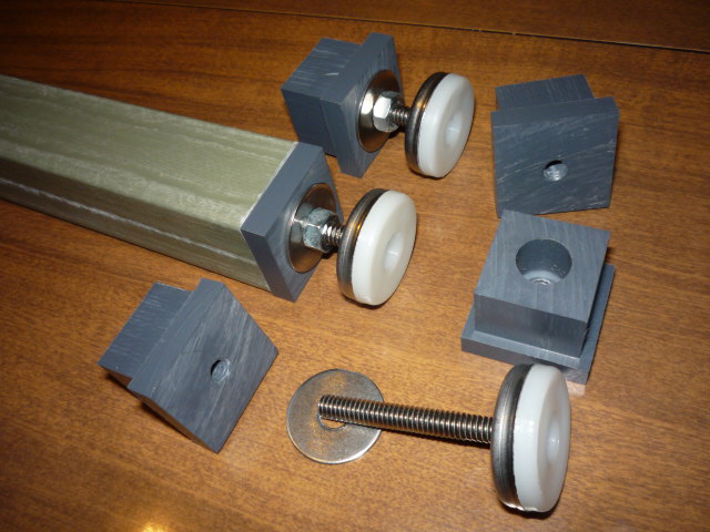

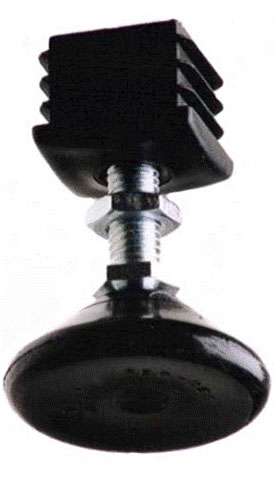

    Second ... Casters with breaks are good ... But, Are you going to use these caster wheels for all the base corners ?!!
    I guess it will not be good for overall simulator stability on the ground and will not withstand the pouncing forces during playing the games ... to make the frame stationary you may use this .
    And Pleeeease upload the future plans to make us think with you ... Thinking is the fun part for all of us ... and we are not in a sim building race ... wait for the clouds to pass some of us are freezing right now :confused: ... Don't push onto yourself too hard ... a step forward from you is big enough for all of us .

    Yes, lockable casters are on all four corners. There will be times that I will need to move the simulator. I will be using metal "cups" that the casters will sit in, making it stationary for simming.
    I will complete this build - posting pics whenever it's valid and not pushing too hard, but staying busy. Since I've started, the juices are flowing and I just can't wait to get more time to work on it. As stated, it's un-seasonably cold here right now. We normally have some 70+ degree days, but not for the past two months. When I get one of those type days, I will paint the metal base frame and mount the MDF base cover.

    I used 1.5 x 1.5" steel - it's walls are 1/8" thick. Bitch to cut on a chop saw - but a pleasure to weld.

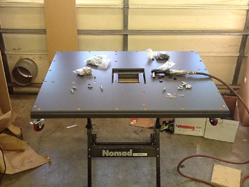

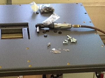

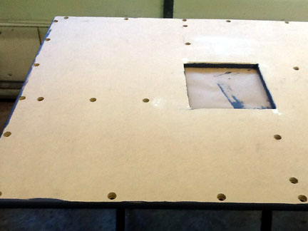

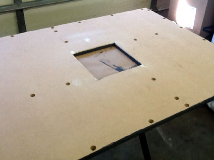

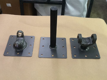

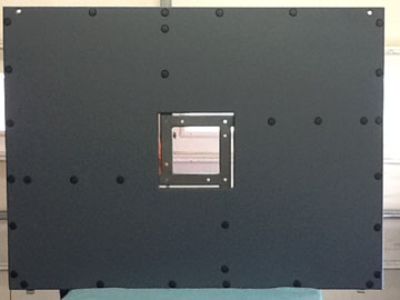

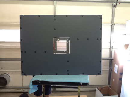

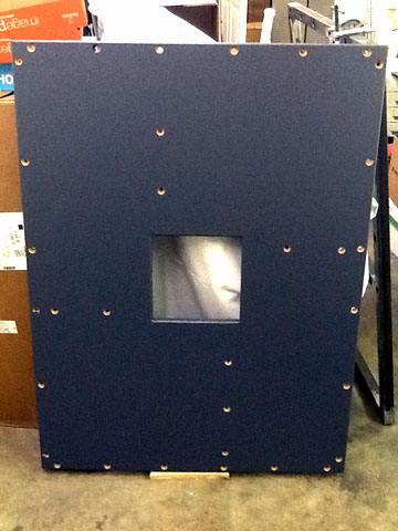

    Base MDF - Ready to Install 2 - 022814 (2).jpg Base MDF - Ready to Install 3 - 022814 (3).jpg Base MDF - Ready to Install - 4 - 022814 (2).jpg Finished Base 1.JPG Finished Base 2.JPG Spline - U-Joint Painted - 022814.JPG
    BUILD UPDATE - MARCH 10, 2014
    Hi Folks,
    Pics of completed platform base, w/hole plugs - no visible bolts or nuts - plus protects from moisture, potential corrosion.

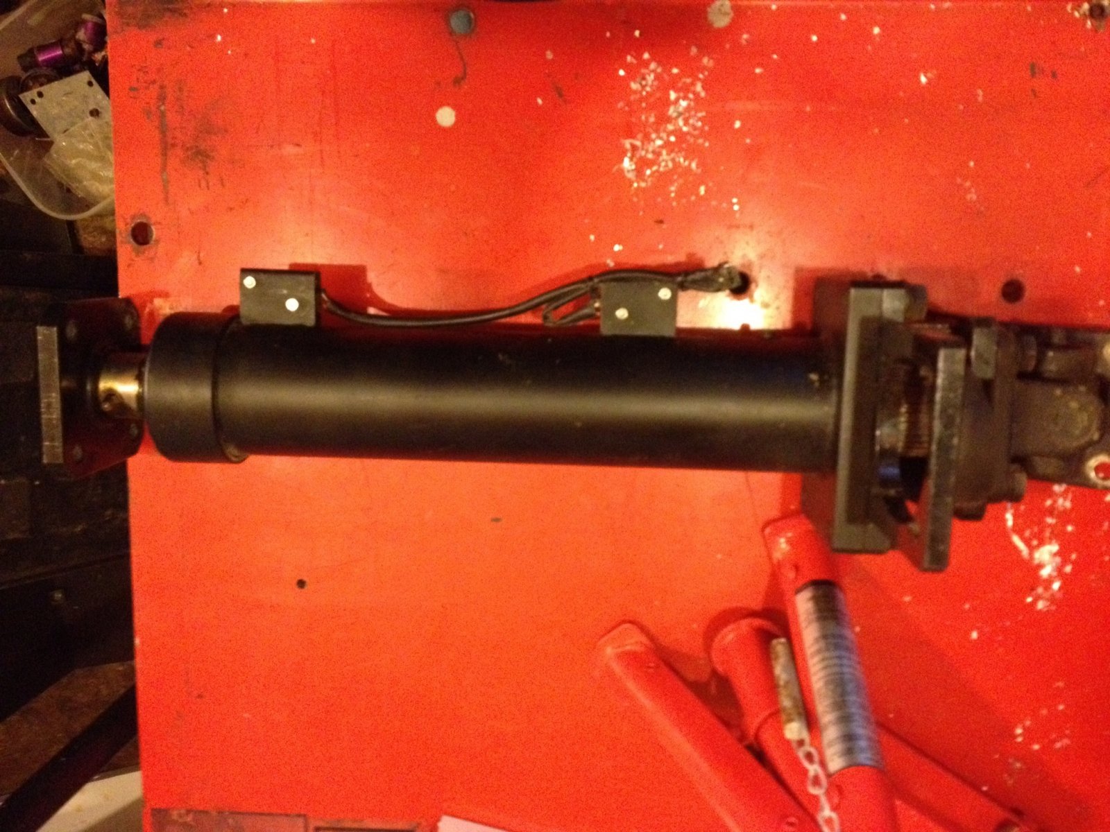

    Pic of spline shaft / u-joint, welded and ready for future part of build.
    I am now working on readiness to order a compression / assist spring - All you folks have been so good to educate me in the Q&A Thread of this build. Sure has saved me a multiple of mistakes for inexperience - and a ton of things I had no clue about. THANKS to all of you.
    And, I started working on the gearshaft arms -
    Later this week, health prevailing, I will do a mock-up of motors/gearheads on base platform.
    Thanks so much for looking and staying with me on this project. Me "thinks" we will have a nice flight sim??
    Have a most blessed one,
    Tom

    Looks good, have you built the top & bottom frame to the same size? Also what do you plan on building ontop of the base? Some kind of enclosed cabin?
    rgds
  13. cthiggin

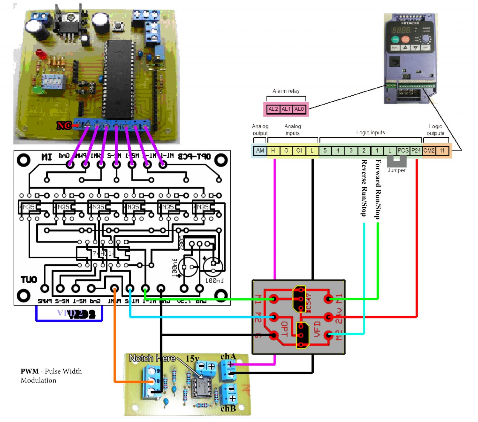

    Let me say this - "me" thinks an all-in-one board is being evaluated for AC's and multiple DOF's....
    Attached is a photo of a wiring diagram put together by another member that WILL work for AC's as it is..... I think the "one" evaluating the all-in-one board would like to just consolidate all the hardware into one unit....we'll just have to wait and see...but it's doable now....and the future looks very promising...
    Stay in touch.

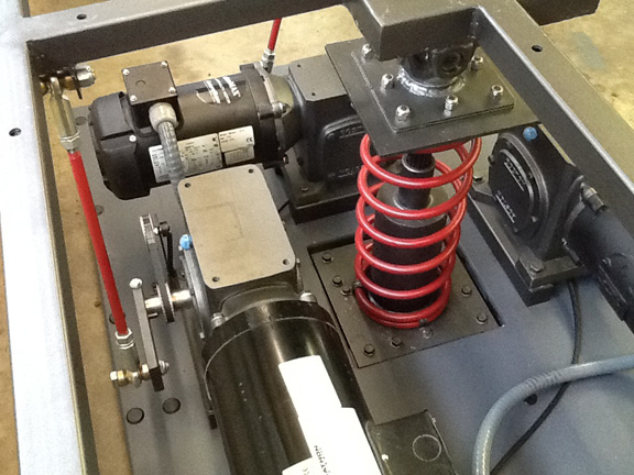

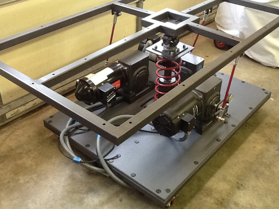

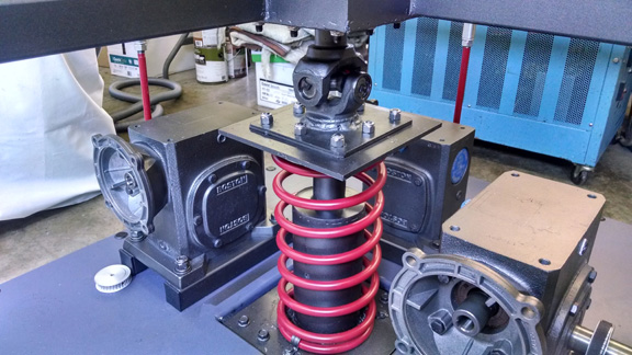

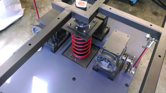

    Hi folks,

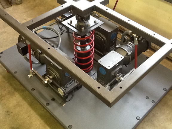

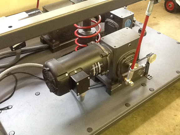

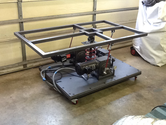

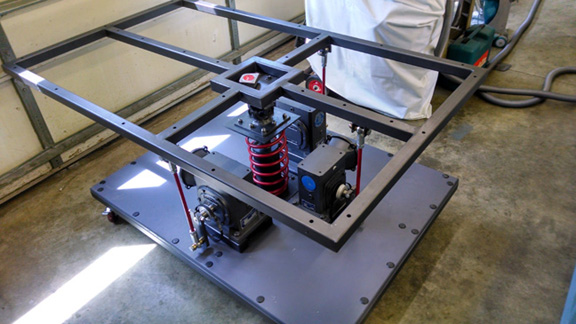

    Been a "Long Time" in process and updating here........so, to bring you up to date.
    Many Saturdays and some evenings, and the mechanical portion of the build is finished.................
    What is left to do:
    1. Electronics - (yobuddy and speedy are helping me with this)
    2. Install finished MDF Top to platform
    3. Install RS1 Sim Cockpit
    4. Build and Install stand for 42" TV
    Then the "fun" will really begin.
    I also want to thank so many of you for your encourage and help along the way. Without the help, I would have a very bad abortion on my hands.......but, "me thinks" it has turned out pretty good and hopefully
    will be one of the best performing platforms out there????
    What I have learned this past 6 months cannot be measured.........I do know one thing though - I would have made some minor modifications that would have made the build easier and less expensive........but
    such is the price of experience.....but, overall, I am pleased!
    The pics are some of painting, some of platform with gearheads / crankarms mounted / some in finality with motors/pots installed and wired.......many photos were lost when I changed from my iPhone to a
    Android Razr..........after the fact, Verizon told me they were "gone".........so be it.
    Many blessing to you all! Tom

    well done! it looks very nice! and strong :cool:
    how did you design your spring? something available?...
    thks
