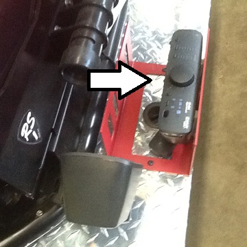

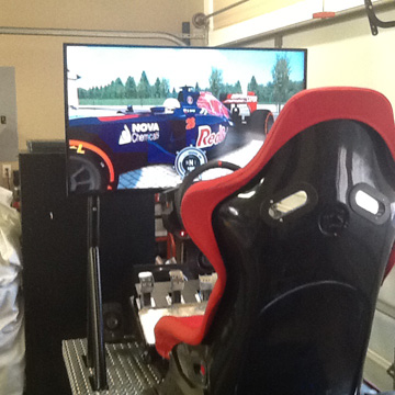

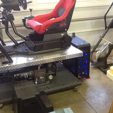

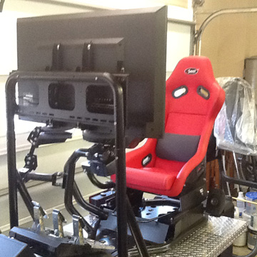

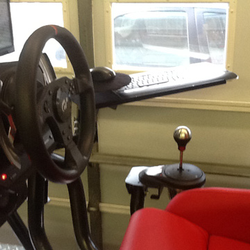

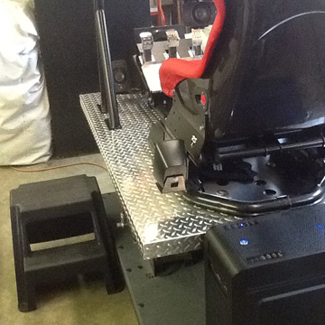

  15. cthiggin
    cthiggin Active Member
    Jul 1, 2012
    672
    Self-Employed
    Montgomery AL USA
    15,210Coins
    +435 / 0 / -0

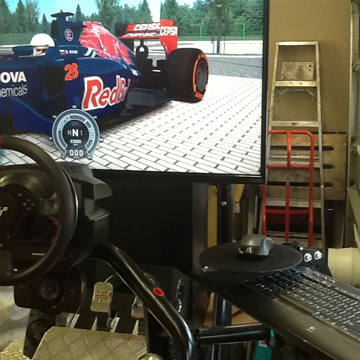

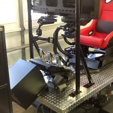

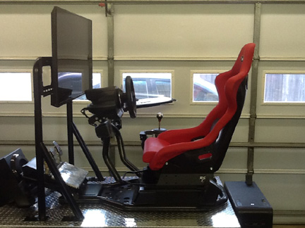

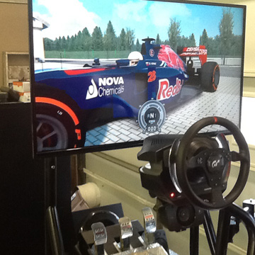

    IT'S 95% FINISHED..............FINALLY!!!!!!!!!!!!!!!!!!!!!!!
    Hello my friends.............................I've been promising to send pictures, I know for at least 6 months of my on-going build............WELL, it's 90% FINISHED, and I can use it in a static MODE, so at least I can learn to drive in AC - already have 8 years in FlightSim, so at least I can fly............
    What I have done:
    Platform / ac motors-gearheads / pots / belts / well, everything mechanical is done - used diamond-plate on platform top -
    Rseat RS1 / TM T500 / Logitech 906 Surround / 42" Samsung @ 1920x1080 / Wireless Logitech Keyboard/Mouse / Assetto Corsa & PCars Software
    My Custom PC Build - 4790K OC'd @ 4.9 Mhz - H-105 Corsair Liquid Cooling / 1000 W Corsair PSU / ASUS X79 Deluxe MB / Corsair Vengence Memory x 16 gig / EVGA 779 Classified GPU
    Thermaltake V-Core Case - Win 7-64bit OS
    I have spent countless hours drilling etc. to hide wiring as much as possible - (Me hates wires showing) - About 8 months to build - ALL of last year - (spent 4 months traveling back and forth
    with a terminally ill Mother)
    WHAT STILL NEEDS TO BE COMPLETED:
    1. ButtKicker Gamer - Ordered but out of stock.....
    2. ARD UNO is flashed with SMC3 Firmware..............Thanks to @RufusDufus for helping me out on this - as I am a pure dummy on electronics............
    @yobuddy is working on two Opt-PCB Boards to complete my electronics........thanks to @yobuddy and his encouragement, I got off my butt and started my build.
    Our SimTools expert - very smart fellow - I thank him for his help and encouragement - and putting up with my silly questions and inpatience...again, I thank him.
    I also want to very much thank @speedy and @BlazinH for their help and encouragement - AND to ALL my forum friends........thank you for a wonderful site and
    the help you give.
    Hopefully you will enjoy my journey with the following pictures.
    Many Blessing,
    Tom

  18. speedy
    speedy Well-Known Member
    Feb 1, 2012
    1,193
    Alexandria , Egypt
    7,951Coins
    +1,288 / 10 / -0
    Whaaaooooouuuuu ... That is a very nice-looking hard work that is Definitely Well Done :thumbs
    Perfect usage of the metal pipes ...:thumbs
    Simply Love it ... I would buy it for a 150 G ... Ple:grinase .
    Believe me Tom ... It is really quit different feeling when driving with motion.
    So keep up the perfect work until it is really fine tuned .
    How much is the top platform weighs now ?
    Best regards
    Spe;)edy
  19. cthiggin
    Jul 1, 2012
    672
    Self-Employed
    Montgomery AL USA
    15,210Coins
    +435 / 0 / -0
    Thanks so very much Speedy for your kind remarks...........and to all the other folks who have responded with kind works and "stickies"...........sure appreciate it.
    Speedy,
    With ALL of the equipment on platform PLUS all 213lbs of "me", it comes in at 420+ lbs.......and in your spring calculation for me and my heavy duty motors/gearheads, should not be
    a problem at all to move it.
    I am "really" anxious to get it "moving" to complete the package.
    As stated, @yobuddy is building the two Opt/PCB boards for me, and I think they replicate your "all-in-one" boards........not sure, but I "think" so....
    Haven't heard from him in about three weeks, so I don't know the status of his build..... I have ALL my other hardware for the control box ready to go.......
    I would like to pm you in the next several days as I have a couple of questions about my VFD's and how to effectively program them......"your" VFD's nomenclature is a little different than mine,
    so I may ask you for al little help if that's ok.....just don't want to mess anything up at this point.
    Again, THANKS to all that have responded and to those members that did no respond...........I appreciate you taking the time to ponder.
    Many blessings to all,
    Tom
  20. speedy
    Feb 1, 2012
    1,193
    Alexandria , Egypt
    7,951Coins
    +1,288 / 10 / -0
    Oh yes any thing you need ... and by adding "ponder" to my favorite English word list :) ... I have some small questions ...
    I'm not sure but I didn't see where that SimTools will work with 64-bit windows ... did you tested it ?
    Is the hole platform stable enough with these wheels specially when getting ON and OFF the chair ?
    and I guess the wireless mouse and the keyboard will tumble when moving ...
    and What is this Rascal unit ? is it related to the speakers ?
