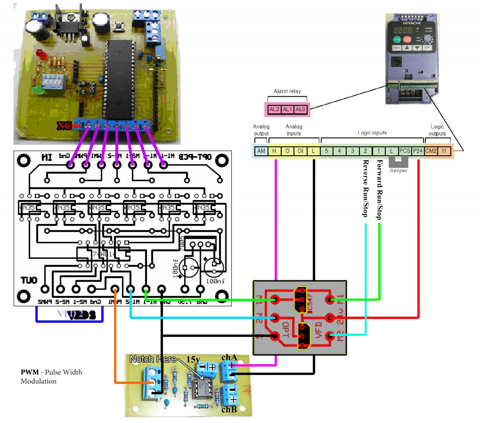

  11. RacingMat
    2,234
    21,094Coins
    what's new about this all-in-one board to drive Inverters VFD?
  12. cthiggin
    cthiggin Active Member
    Jul 1, 2012
    672
    Self-Employed
    Montgomery AL USA
    15,210Coins
    +435 / 0 / -0
    Consolidation of multiple boards into one.
    There is another Opt-PCB board in the works that will be a shield to fit the Uno.
    I am using the Uno, SMC3 f/w, and 2 Opt-PCB's at this time.
  13. RacingMat
    2,234
    21,094Coins
    and what kind of board for 5V PWM (from Arduino) to Analog 10V, please?
  14. cthiggin
    Jul 1, 2012
    672
    Self-Employed
    Montgomery AL USA
    15,210Coins
    +435 / 0 / -0
    RacingMat,
    Please Note: @speedy built these two Opt-PCB Boards for me as I am a neophyte when it comes to electronics. Wiring a house, I can't be beat, but electronics, again, a neophyte.
    I use a 12V PSU to power the Opt-PCB Boards. It's a real slick set-up.
    Sorry I can't be a heavy hitter in electronics to tell you how the watch is made, but being honest here.
    Tom

  16. RacingMat

  17. TFOU57
    TFOU57 Member
    Mar 30, 2009
    164
    Thionville - France
    5,723Coins
    +16 / 1 / -0
    2DOF, AC motor, Arduino
    @ RacingMat
    I am also looking for commercial turntables already assembled to order 220V three-phase frequency inverters
    - Platinum command to the direction of rotation (0V and 10V) with inter lock
    - Platinum 20kHz PWM for speed control (0V to 10V) as precisely as possible
    In my case I use Arduino Due that work 0V to 3.3V and 0V to 5V step
    On your post at the bottom of the linked page that you communicated us face a commercial platinum interface
    "PWM 0-10V Analog to Digital Signal Converter Module PLC MACH3"
    http://www.xsimulator.net/community/faq/pwm-to-analog-signal-to-drive-vfd.202
    Strong point :
    Prices and ready to use (deck assembly)
    Weakness for my taste
    - Low frequency PWM control dimmers
    "PWM range of receiver frequency: 1 kHz - 3 kHz"

  18. TFOU57
    TFOU57 Member
    Mar 30, 2009
    164
    Thionville - France
    5,723Coins
    +16 / 1 / -0
    • Low Frequency PWM control inverters
    • Only 100 voltage levels to control the speed of the drives
    "Resolution: 0.1V"
    Additional questions
    "PWM of1 kHz - 3 kHz" = audio frequency?
    "Resolution: 0.1V"
    • + or 0V?
    • What is the IC giving this resolution?

  19. RacingMat
    2,234
    21,094Coins
    Resolution: 0.1V between 0 to 10V
    this resolution is on speed control so I don't think it's bad.
    The PID loop will have 100 values of speed to reach the position.
  20. TFOU57
    TFOU57 Member
    Mar 30, 2009
    164
    Thionville - France
    5,723Coins
    +16 / 1 / -0
    You're right, but the accuracy of 0,1V can also be a sign for a 0,1V voltage instability between two consecutive signals at a frequency of 3 KHz max.
    The maximum frequency of 3 KHz, is not yet in the audible range?
    For my part, I have just seen that this card would be inappropriate because his INPUT PWM goes from 0V to 4,5V and I wish to use my Arduino Due to 84Mhz but which operates in PWM 0V to 3,3V.
    Texte original
    Tu as raison, mais la précision de 0,1V peut également être un signe pour une instabilité de tension de 0.1v entre 2 signaux consécutifs à la fréquence de 3KHz maximum.
    Cette fréquence de 3 KHz maximum, n’est-elle pas encore dans la gamme audible ?
    Pour ma part, je viens de voir que cette carte ne conviendrait pas car son INPUT PWM va de 0v à 4,5V et je désire utiliser mon Arduino Due à 84Mh mais qui ne fonctionnant qu’en PWM 0V à 3,3V.
