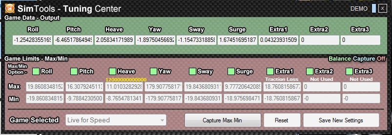

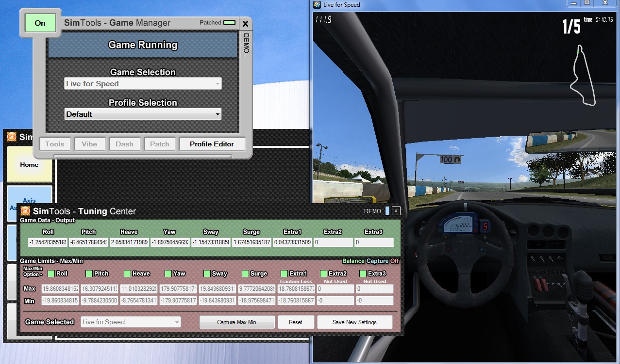

    Speedy & folks,
    Worked last night on a profile for AC - made very little progress.
    From what @speedy has told me, V2.0 is "very sensitive" to AC Motors........................well, that's to say the least.
    I "may" be doing something wrong..........but for me, the setup that worked in v1.3 does not work the same way in v2.0.
    I cannot get any "change" when lowering the overall sim in GameManager. Due to a back problem, I get my profile set up and working correctly, save,
    AND then if my back is flaring up, then I turn down the overall % with Game Manager which "has" worked fine............can't do it that way now.
    What I am having to do, is INCREASE the smoothing, sometimes up to 90%, in GameEngine to tame it down.
    Any ideas / or / my mistakes, please reply.
    IF this is the correct behavior of v2.0, then I know what I have to do with this version.
    Thanks, and I WILL upload a video as soon as I am dialed in.............
    Tom

    There is no problem @cthiggin having the forces 90-100% smoothed from all the additional details to suite your driving needs .
    you may also need to add some "Zeros" in the tuning center to lower the game output after driving a full loop for capturing min and max .

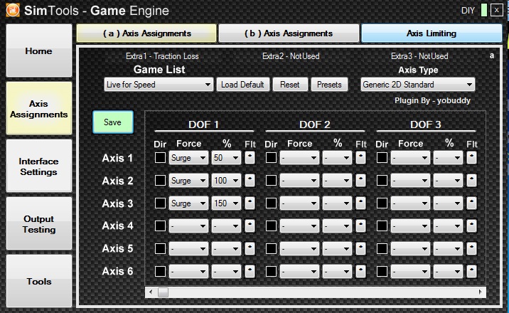

    That is like picture related to these Yellow numbers if you increase them by a zero/s or two and save ... then the incoming future game values will be lower thus the sim will react slower .
    Every thing is the same adjusting system buddy ... But, and as you may have noticed that any force can go up to 150% of its original value .

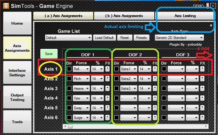

    [​IMG] Speedy - in v1.3 - I understood DOF % was the amount of AXIS you wanted to use in Percentage -
    PLEASE CLARIFY: Your picture above tells me "that I'm inputing % of FORCE of Axis -Not amount of Axis used. If so, then I can understand why we would want to go higher
    in "Smoothing" in v2.0 versus less in v1.3???
    Please let me know on this.............

    YES Exactly that :thumbs ...
    The DOF % is the selected force value ...
    The smoothing % is how much that value will be smoothed ...
    The Axis % is how much physical range of that axis that will be used ...
    Furthermore as next picture :
    - DOF 1 - DOF 2 - DOF 3 - ..... - DOF 6 are the main 6 forces "Degree Of Freedom" plus the Extra 1 ,2 ,3 forces that could be combined , assigned , reversed , and added with different values for each Axis ...
    - Axis 1
    Axis 2
    Axis 3
    Axis 6
    are the actual available axis used for any simulator that can provide motion to it's platform ...
    - Each Axis line of 6DOF's at the end will sum total gives its output to its specifically assigned motor in the interface settings ...

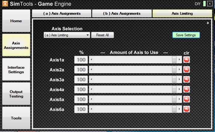

    - For Axis mechanical limitation its actual physical range can be limited by the Axis limiting tap ...
    - For the overall game behavior adjustments could be done via the main level in the game manager profile editor unless you need to change the behavior of a specific force you add zeros to its previously saved value in the tuning center so any new value will be smaller thus the simulator will act slower for that force only ...

    One more tricky thing may not been clearly explained before ...
    you can scale the DOF up/down per axis without losing details with smoothing it ... in three working arias :
    - [Normal] If you use 100% strength of any DOF force assigned with a 100% usage of the Axis movement ...
    SimTools will distribute that 100% strength over that 100% distance resulting of a 1:1 movement .
    - [Zoom In] If you use 50% strength of any DOF force assigned with 100% usage of the axis movement ...
    SimTools will distribute that 50% strength over that 100% distance resulting of a 1:2 movement [ stretched up movements over the required distance ] .
    - [Zoom Out] If you use 150% strength of any DOF force assigned with 100% usage of the axis movement ...
    SimTools will distribute that 150% strength over that 100% distance resulting of a 1.5:1 movement [ stretched down movements over the required distance ] .

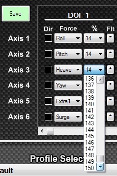

    +1,139 / 5 / -0
    But if we shouldn't exceed 120% for single axis, what's the point in having the chance to go up to 150% for one single force?
  15. yobuddy
    51,533Coins
    +5,204 / 19 / -0
    Lets say you are running 2 simulators from SimTools.
    One from axis assignments A and one from axis assignments B.
    Should the A guy want more roll that the B guy, you can do it because of the 150%.
    I hope that makes some sense lol.

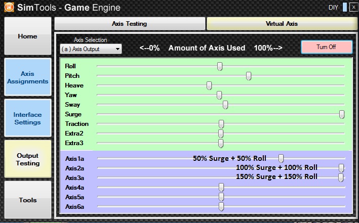

    @cthiggin ... Maybe I was wrong with some statements before. So let me rephrase with simple examples to eliminate any difficulties for you ...
    Scaling forces ...
    Test : By using Only Surge with different DOF% values over Axis 1 [50%] & Axis 2 [100%] & Axis 3 [150%] ...
    and watching what happened in the output testing with the same car accelerates ...
    more axis movement is achieved ...

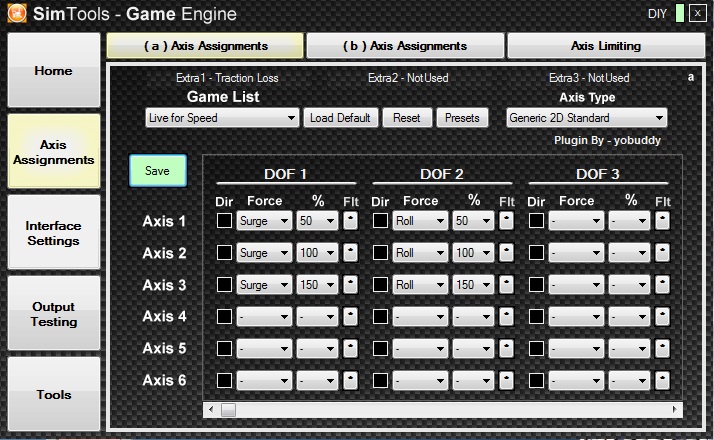

    Mixing Forces ...
    Test : Using the same Surge as above and adding the same % of Roll for each axis ...
    more reasonable action is added to Axis 1 ... Axis 2&3 are clipped to the max with aggressive action .
    And so on for adding more forces to the same Axis ... @Blame73 the total % shouldn't be more than 150% .
    Scaling Axis ...
    Test : Using the same 100% of Surge limiting Axis 1 [50%] & Axis 2 [75%] & Axis 3 [100%]
    motion is scaled down to the required Axis limiting with NO clipping ... with ability to use 150% of Surge to get more action as in Axis 4 .
    That leaves me with a question to @yobuddy ... How much is the available force %ge before the cutoff ?
