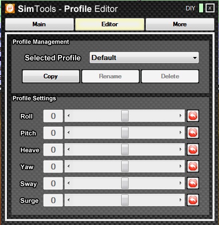

    You can get that extra 50% from the profile editor for each force individually ...

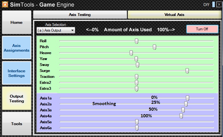

    Smoothing test :
    Smoothing filters are used as 0% Axis1 , 25% Axis 2, 50% Axis 3 , 100% Axis 4 ... with 100% Axis limits
    All Axis go to the same point but with a respective time latency to smoothing % ... I've captured the output testing photo so quickly as car was accelerating . so to differentiate the 4 slider's position per the same time .

    Remember, this adjusts your max/min values for each DOF on the fly.
    So if you had a max min of 20/-20, adjusting it can get a new max /min of 10/-10 to 30/-30 for that DOF.

    Not really. I don’t think you completely understand what I mean. The axis that end in letter a and the corresponding axis that end in letter b use the same tuning numbers. In order to make the b axis output more or less force than the corresponding a axis, you have to scale from the a axis tuning numbers since you can’t set b tuning numbers. Actually you could but then the a axis would have to be scaled from the b axis.
    Using the profile editor scales both axis a and b together so while you could use it to increase the b axis to over 200% by scaling up a 150% max setting (I think), it would increase the a axis proportionally as well which is not desired when you’re attempting to get your b settings where you want them in relation to a settings.
