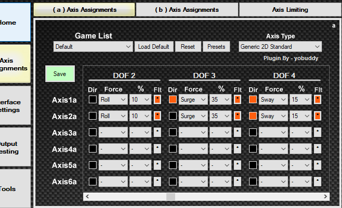

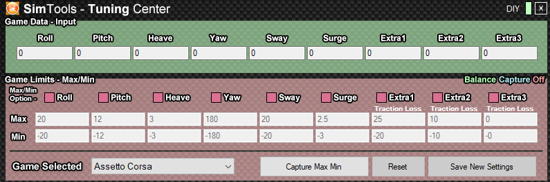

    Finally my rig works with Assetto Corsa. I turned off sway, because it felt like old car with really soft springs ( maybe wrong settings, what do you think?). I think my roll is not enough. Over all I am very happy. :)
    There are 2 laps on Nurburgring:
    21,633
    151,455Coins
    +11,038 / 56 / -2
    Please post pictures of all of your settings, including what you had for sway, as turning it off you are losing a lot and it is likely your settings require further refinement, see the FAQ tuning tips and do each axis one at a time: https://www.xsimulator.net/community/faq/steps-to-create-a-motion-profile.228/

    May I suggest Filters should only be used as a final tuning step with respect to a well refined motion profile, and that further work is needed to refine yours.
    The Axis Allocations for Roll and Sway look too low and the Tuning Center value for both too high, with pitch an heave not shown as being configured at all.
    As per previous advice I would suggest following the FAQ tips to refine your motion profile: https://www.xsimulator.net/community/faq/steps-to-create-a-motion-profile.228/

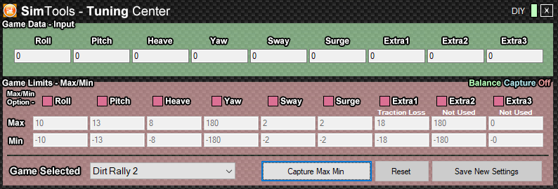

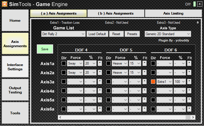

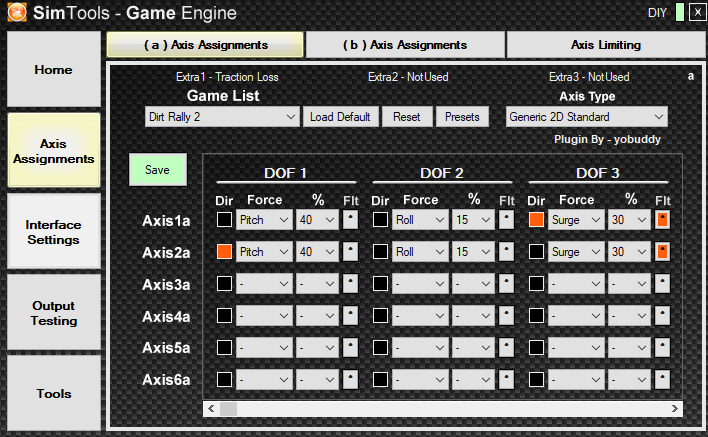

    I will be back to Assetto Corsa, but today I configured setup for Dirt Rally 2.0
    My settings:
    I used 5% filtering for surge, because gear shift was too snappy. With 0% filtering and 5 max/min values gear shift was perfect, but acceleration and deceleration near to zero. Pitch, Heave, surge and traction loss are perfect, but I have the same problem with roll and sway like in assetto. I used this time more axis allocation like you suggested. Using only roll, sway is ok, but when I use every DOF it is overdone like a lot. I think my rig doesn't have to use much axis allocation for roll/sway to get good resault. I will try using more min/max values for surge when using every DOF, maybe it will help. Thanks for your support :D
    21,633
    151,455Coins
    +11,038 / 56 / -2
    My guess is the sway TC value is too small.

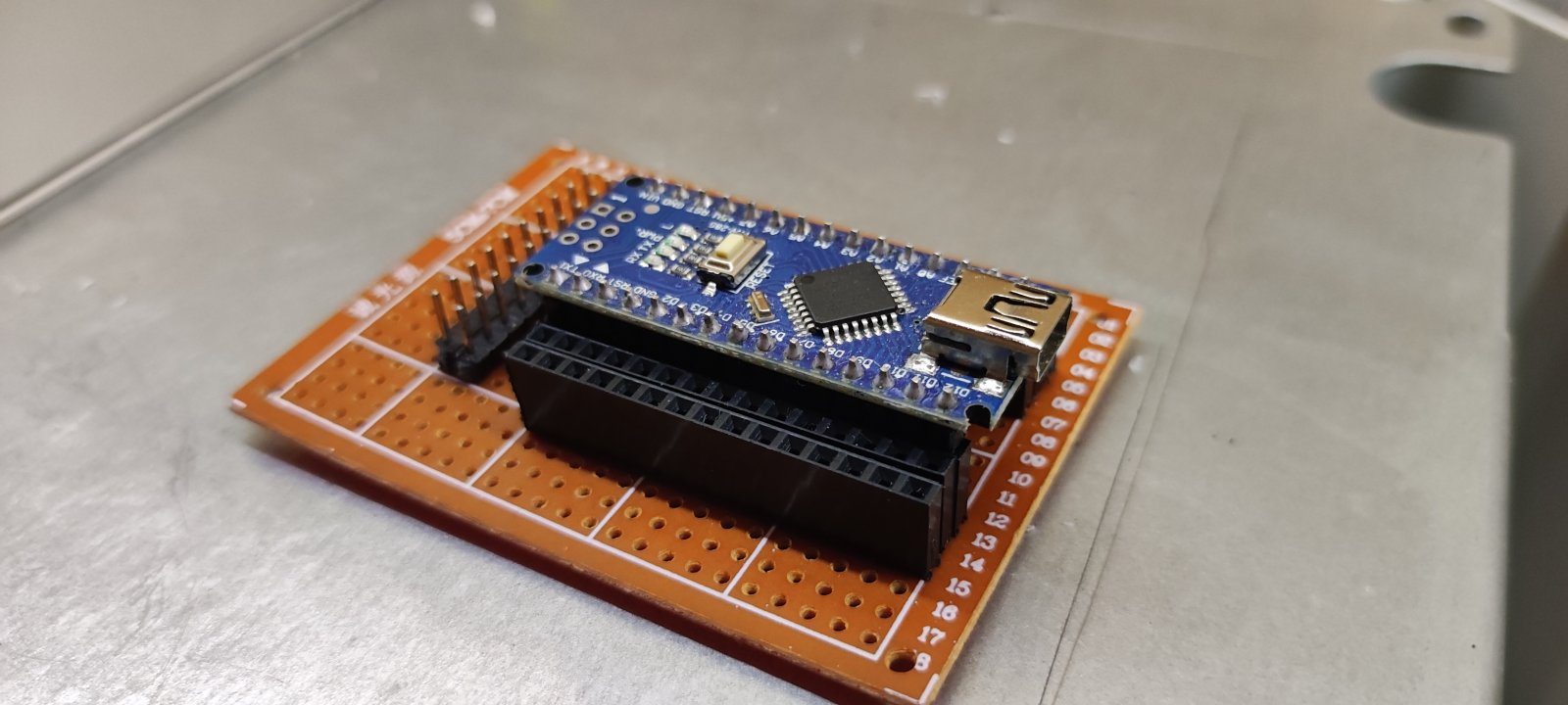

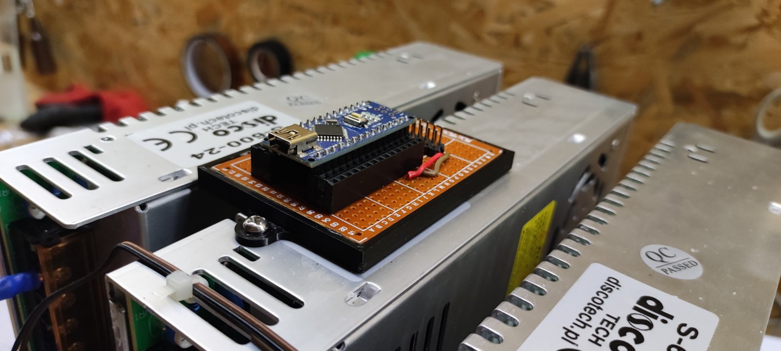

    Hi @Mechatronik. Hope you're doing well. How's your rig currently? I supposed you're using nano as the microprocessors, may I know which code that you've loaded into it? Because as far as I remembered I was having trouble uploading Smc3 code into nano, due to the difference in their timer.
    It would be grateful if you could kinda upload your code here, if there are any tweak have been done there.
    Thanks dude
