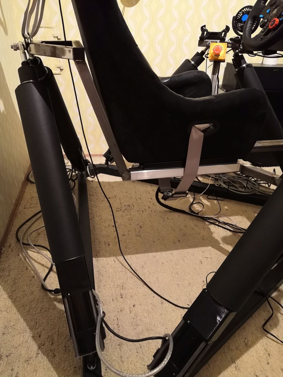

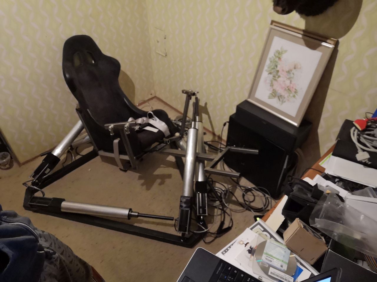

    Hi folks
    In my holidays i have time to test the rig.
    Yesterday i made the first drive in Dirt 2
    Today i tried AeroFly FS2 with minor success.
    When the Airplane is moving slowly to any direction, the rig is stuttering a lot.
    Only if the spike filter is active, it moves continuously and smooth.
    I made a video:
    I´ve used Mover 3.3.5 and the same settings as in Dirt2
    Has anyone an idea where the stuttering is coming from?
    Kind regards and marry x-mas
    Peer
  3. Pierre Lalancette
    Dec 11, 2016
    1,012
    Tech Artist
    Quebec, Canada
    8,052Coins
    +947 / 6 / -0
    3DOF, DC motor, Arduino, 6DOF
    I don't remember what controllers you are using. Every choppiness in my rig came from calibration of the SMC3 Fpid not being high enough. Mine is 5.

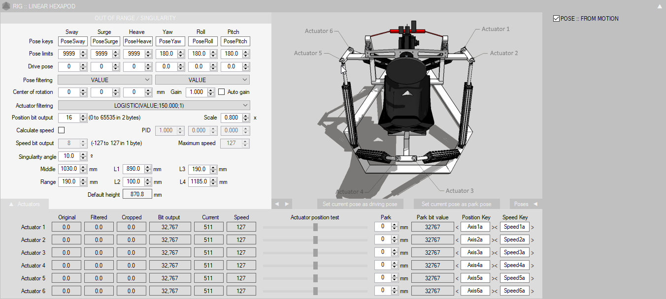

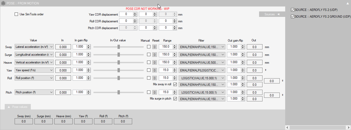

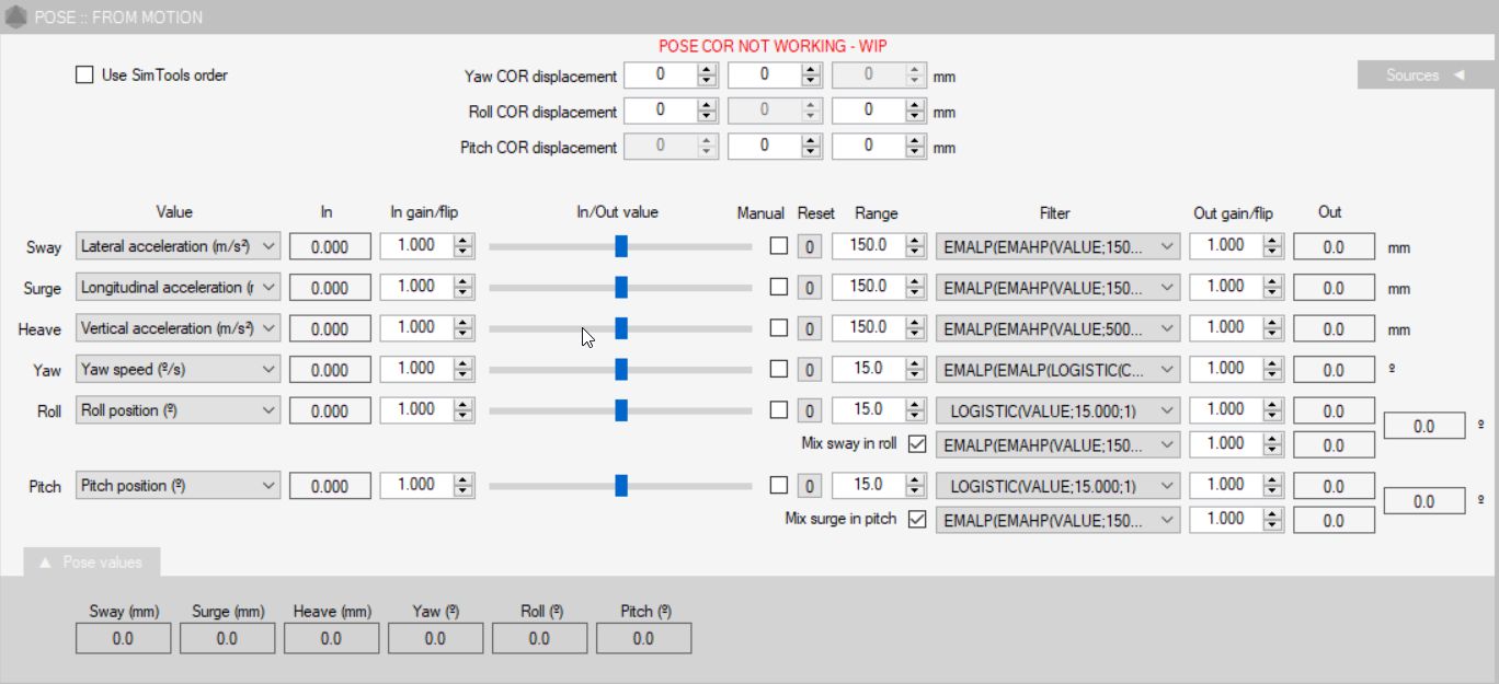

  4. C1500
    C1500 Active Member
    Nov 19, 2018
    165
    1,120Coins
    +86 / 1 / -0
    AC motor, 6DOF

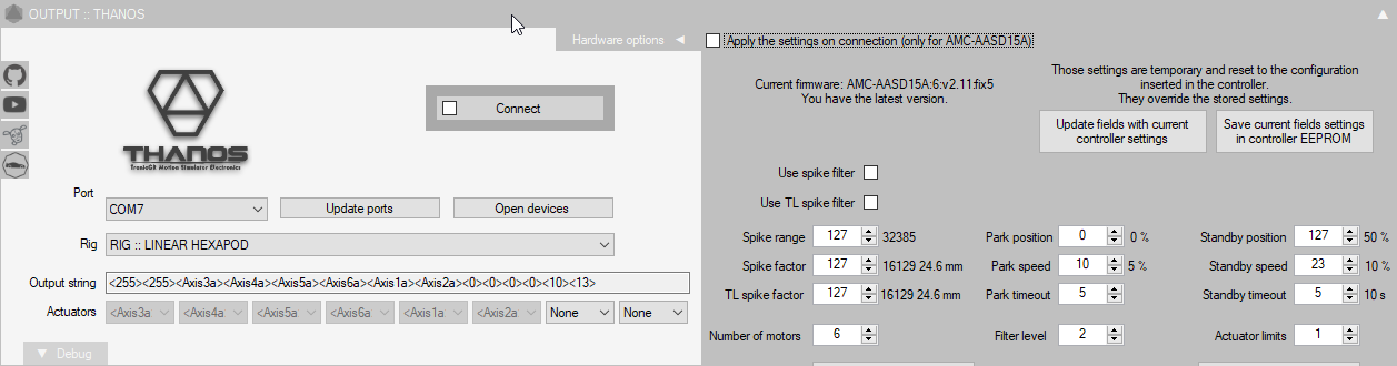

    Hi @Pierre Lalancette
    I use Thanos AMC AASD15A as controller
    Another Test today shows me that the stuttering is not made by the AMC AASD15A
    I have deactivated the spike filter in the AMC and there was no change in stuttering
    Maybe the filtern in Mover generates the stuttering
    Here are my settings in Mover:
    Output: OUTPUT __ THANOS.png
    Rig: RIG __ LINEAR HEXAPOD.png
    Pose: POSE __ FROM MOTION.png
    The filters are set like this:
    Sway = EMALP(EMAHP(VALUE;150.000);150.000)
    Surge = EMALP(EMAHP(VALUE;150.000);150.000)
    Heave = EMALP(EMAHP(VALUE;500.000);500.000)
    Yaw = EMALP(EMALP(LOGISTIC(CUBIC3(VALUE;0.000008);12;1);300);300)
    Roll = LOGISTIC(VALUE;15.000;1)
    SwayInRoll = EMALP(EMAHP(VALUE;150.000);150.000)
    Pitch = LOGISTIC(VALUE;15.000;1)
    SurgeInPitch = EMALP(EMAHP(VALUE;150.000);150.000)
    Or could it be a problem with the data from AeroFly FS2?
    @pmvcda : Hi Pedro, do you have any idea?
    @SpidiHD : i bought them at AliExpress
    Kind regards
    Peer

    You should try to remove all the forces but one, to see if it comes from a specific force.
    In the output, try to change your logistic by a spyke, just to see.
  6. C1500
    C1500 Active Member
    Nov 19, 2018
    165
    1,120Coins
    +86 / 1 / -0
    AC motor, 6DOF
    Hi Pierre
    I have deactivated ALL filters in Mover
    Every Filter is set to "Value"
    But the stuttering is still present.
    Also the deactivation in the AMC AASD15A does not help, it is always stuttering.
    So I'm starting to think it's really coming out of the game.
    Next test is to test my normal used settings but a Joystick as input
    Hopefully someone has another idea.
    Kind regards
    Peer
  7. Pierre Lalancette
    Dec 11, 2016
    1,012
    Tech Artist
    Quebec, Canada
    8,052Coins
    +947 / 6 / -0
    If it comes from the game, that means you can uses filters to smooth it out.
    Better than comming from your rig.

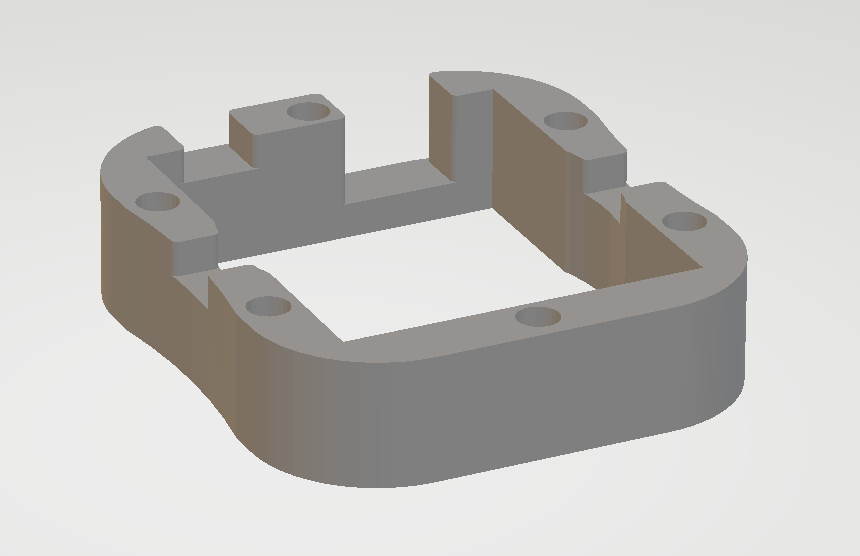

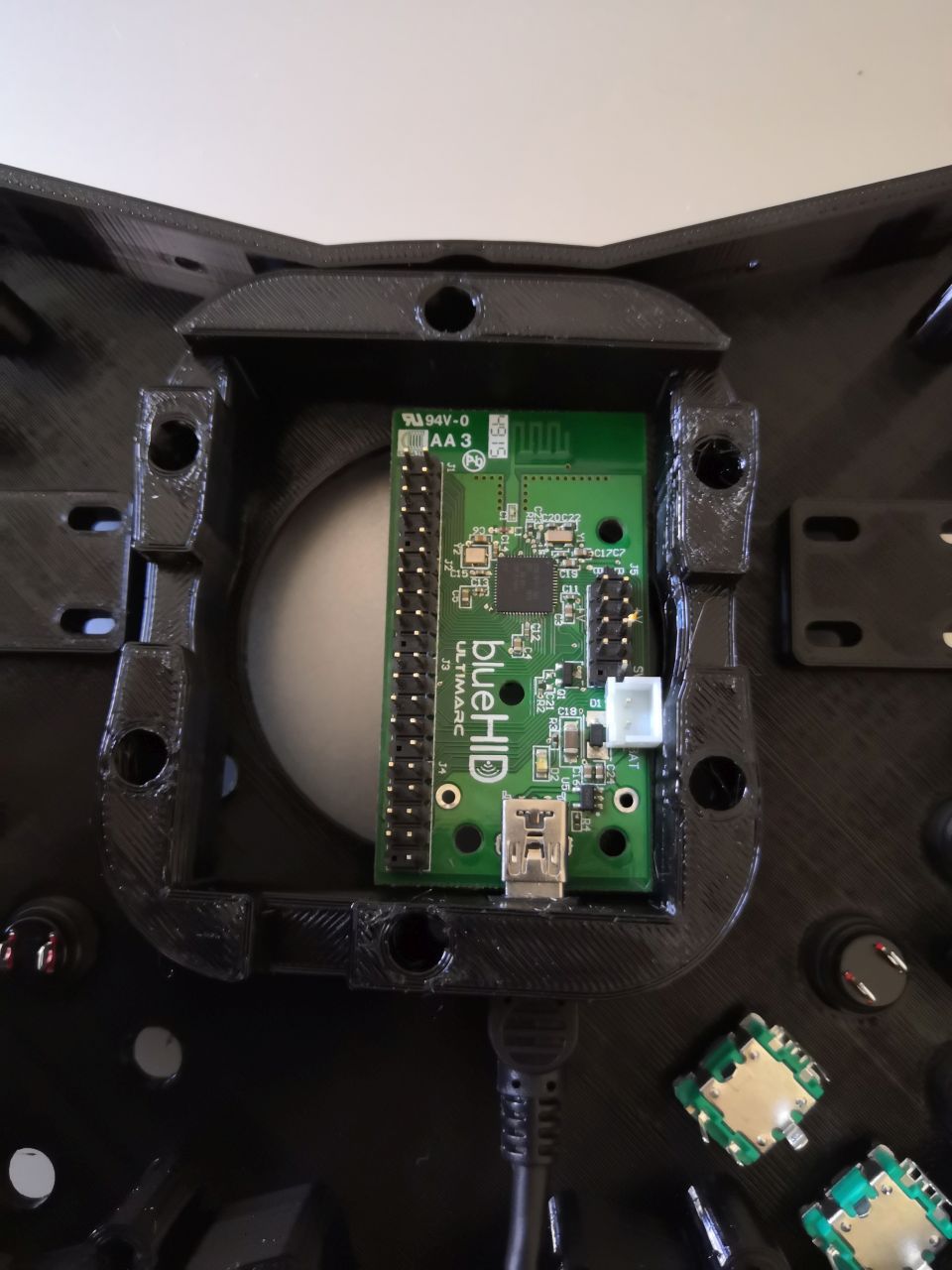

  9. C1500
    C1500 Active Member
    Nov 19, 2018
    165
    1,120Coins
    +86 / 1 / -0
    AC motor, 6DOF

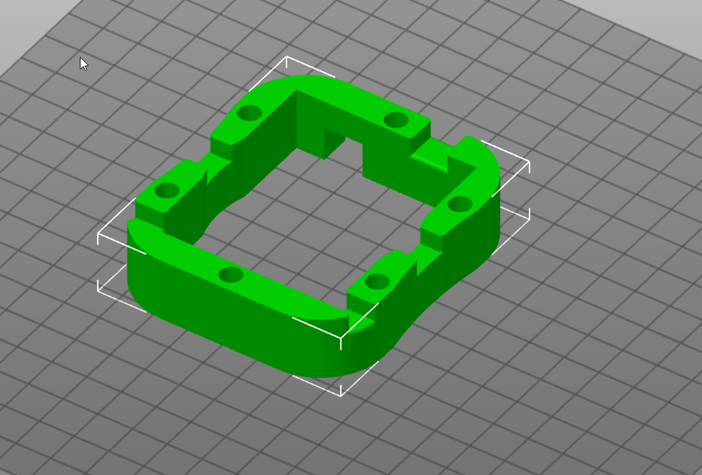

    Hi folks
    I have optimized the ring a bit, now it fits perfect for me.
    Here you can see it:
    And how it fits:
    The USB Cable give good stability and holds the blueHID in place.
    The cables from buttons and encoder can be routed to the blueHID through the 5 cutouts.

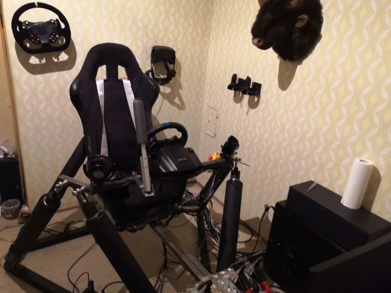

  12. C1500
    C1500 Active Member
    Nov 19, 2018
    165
    1,120Coins
    +86 / 1 / -0
    AC motor, 6DOF

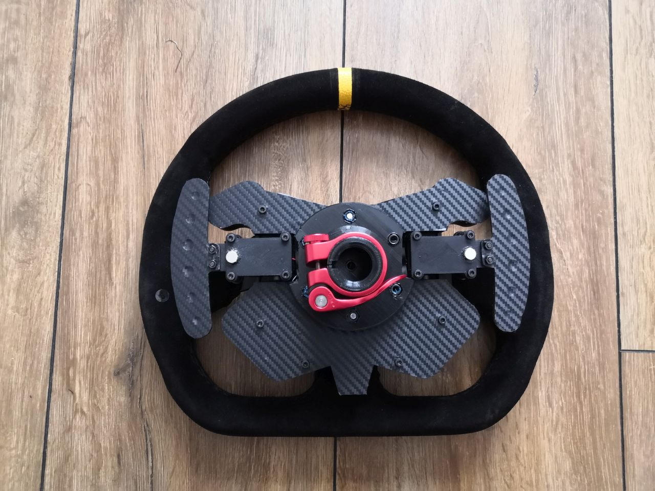

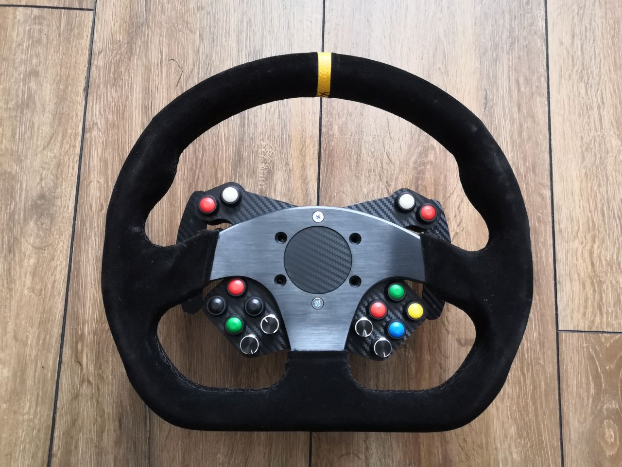

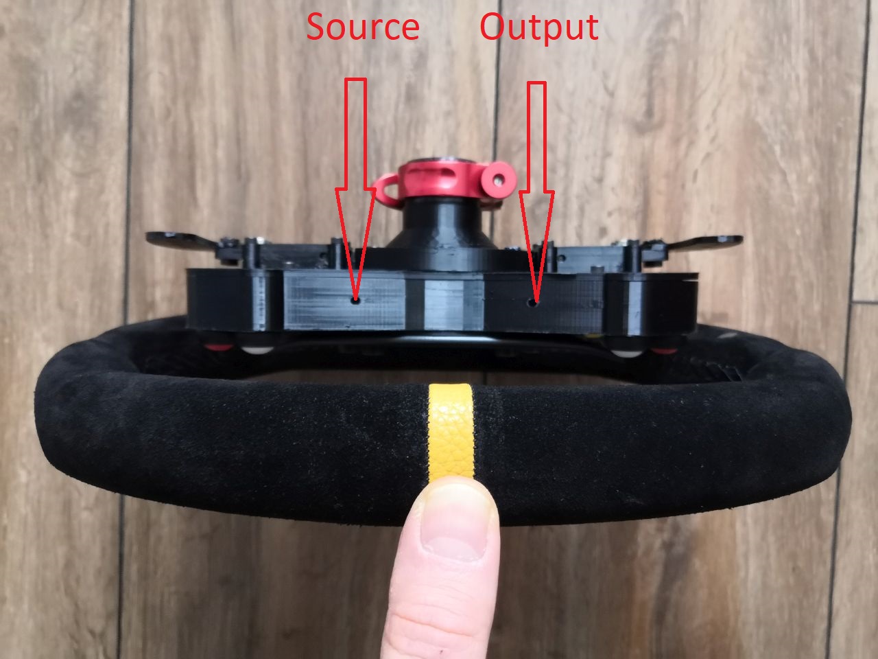

    Hi folks
    my new wheel is ready for race:
    Yes i know that there are some screws missing. That´s the problem during lock down in Germany.
    But i have planed the next update in a few days ;)
    There are these 2 holes on the topside of the button box, I had no idea what to do with it.
    Until i had perfect solution: drill up to 7mm an put in 2 extra buttons.
    These 2 buttons will send "ALT+S" (Output) and "ALT+O" (Source) to control FlyPT-Mover from the wheel.
    oh shit, i forgot that the motor is still "waiting for pickup"
    So the first test-drive will follow later.
    greetings
    Peer

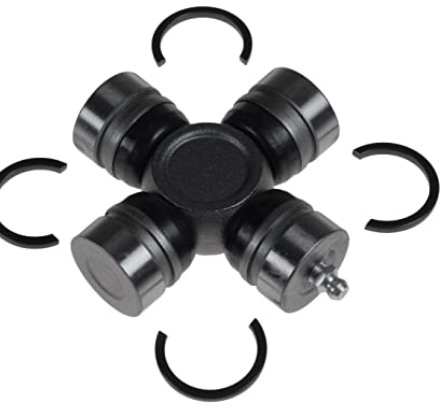

  13. C1500
    C1500 Active Member
    Nov 19, 2018
    165
    1,120Coins
    +86 / 1 / -0
    AC motor, 6DOF
    Hi folks

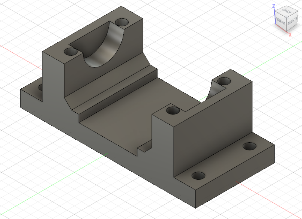

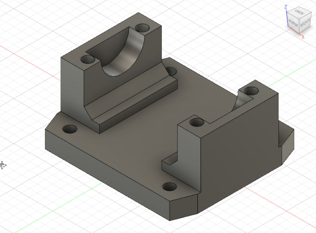

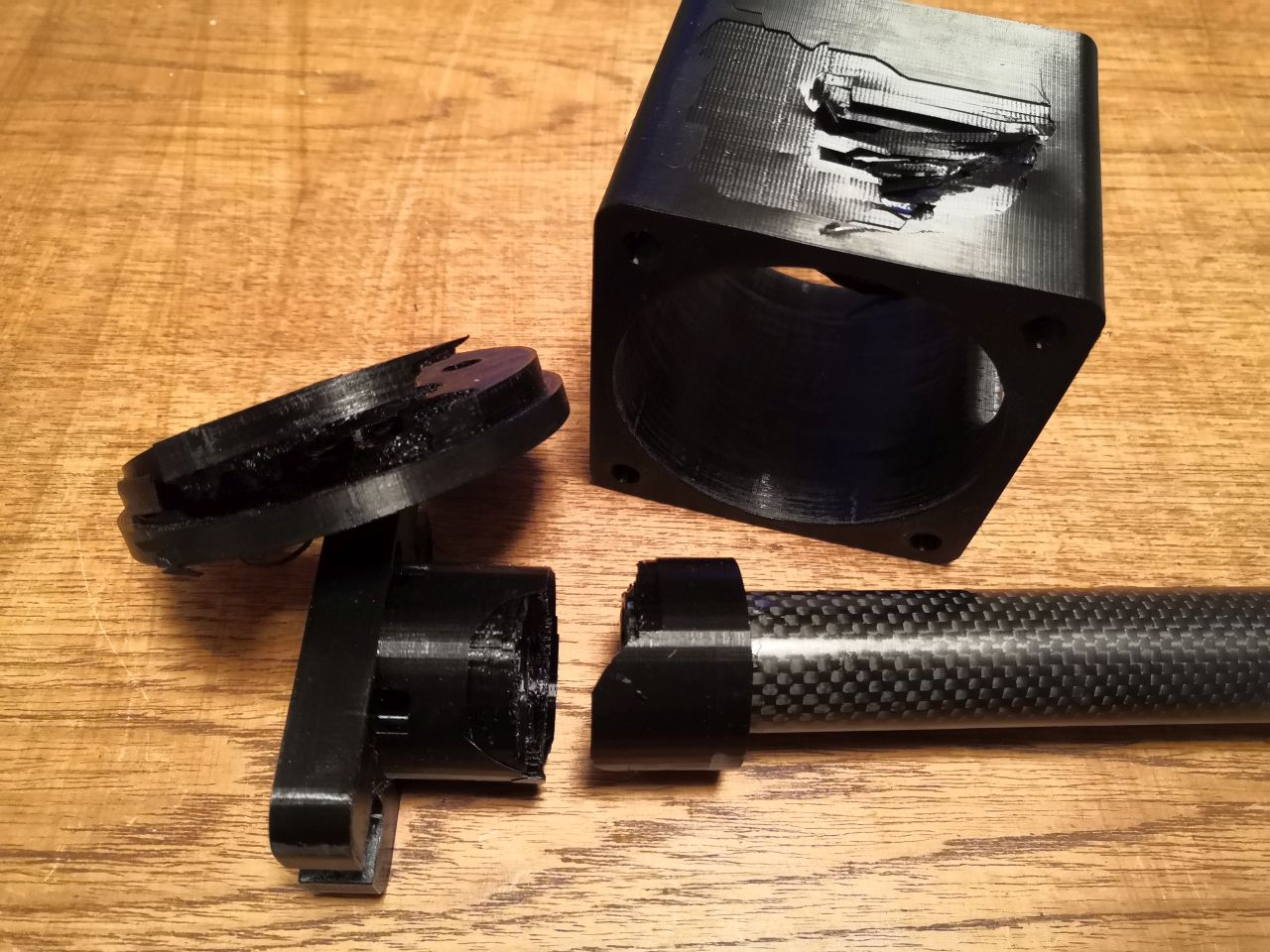

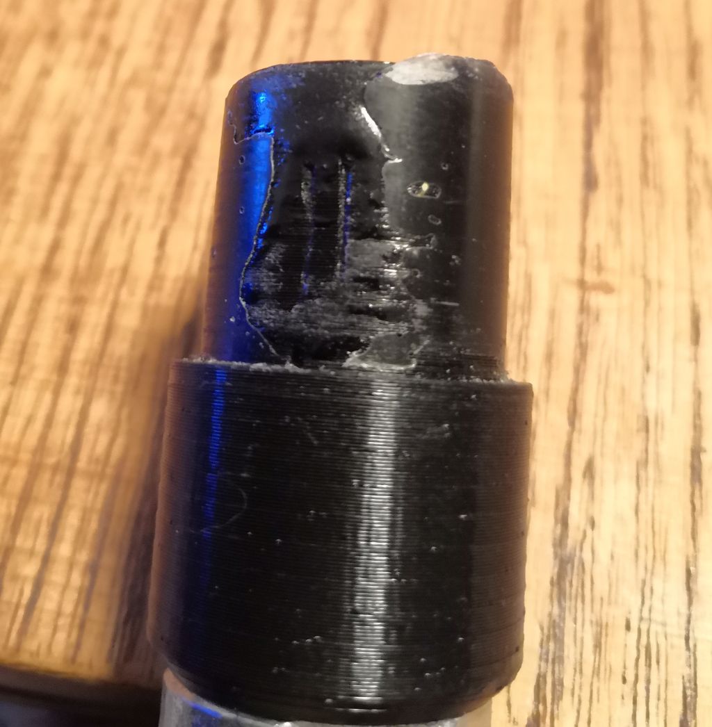

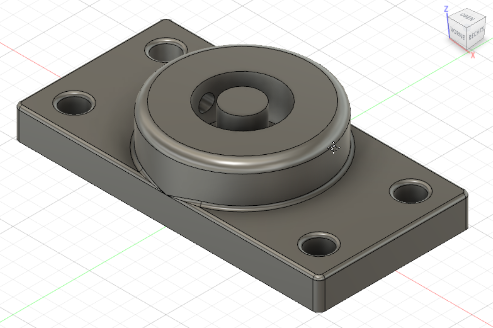

    today i planed to get rid of the movement of the universal-joints i use.
    I don´t know how it is called in English so I made a short video:
    First idea was to make a better connectivity to the frame and I printed this part:
    But still a short time later (3,5 hours printing) I saw that there is still a lot of movement inside the universal-joint itself.
    So I have decided to make a complete new construction.
    Lower Frame mounted to the main-Frame:
    Upper frame mounted to the motor:
    And in between - the new universal joint: (Mazda: 0604-89-251A)
    To fix it in place:
    All Parts will be printed with 100% infill.
    So lets print again and wait for the ordered parts.
    BTW: still waiting that my motor for the OSW will be shipped.:mad:
    Due to new year holidays there is delay. :(
    What do you think?
    greetings
    Peer
  14. Pierre Lalancette
    Dec 11, 2016
    1,012
    Tech Artist
    Quebec, Canada
    8,052Coins
    +947 / 6 / -0
    This is exactly how I did it.
    The only exception is that aluminium parts were done from the printed design.

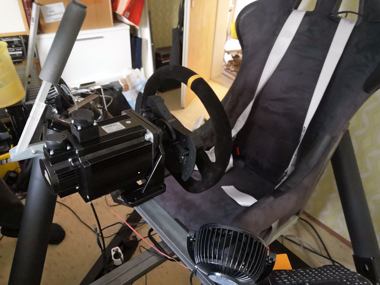

    Today only a short update about OSW
    I got a laughing fit when I unpacked the Motor 130ST. :grin:grin:grin:grin:grin
    It is "a bit" bigger than I thought. :(;):)
    Here a impression of the first mount trial ;)
    Since the steering wheel is very steep and also a little too low, I have printed a spacer.
    It is an ~10° turning and 20mm lift.
    Unfortunately, the screws no longer fit and I have to get new ones.
    Then the further assembly takes place.
    The STM32 runs and I have made the first attempts to turn.
    more to come....
