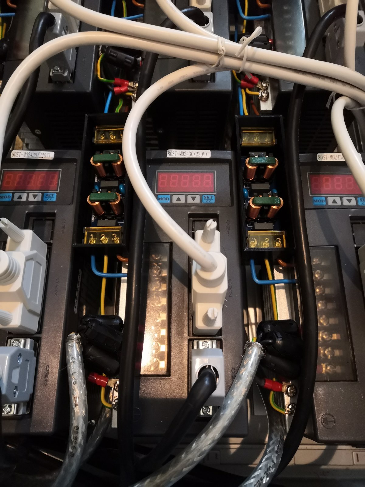

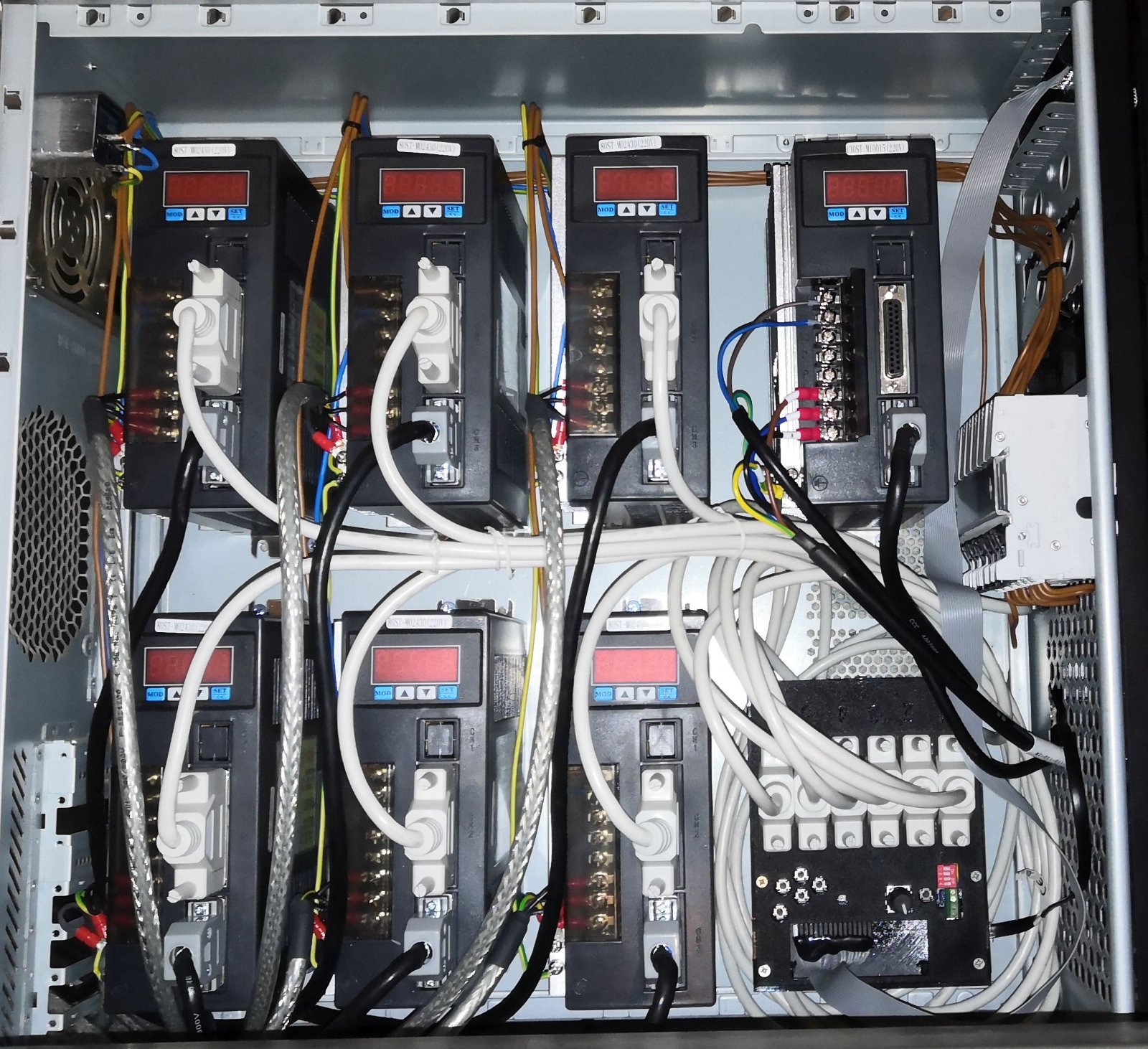

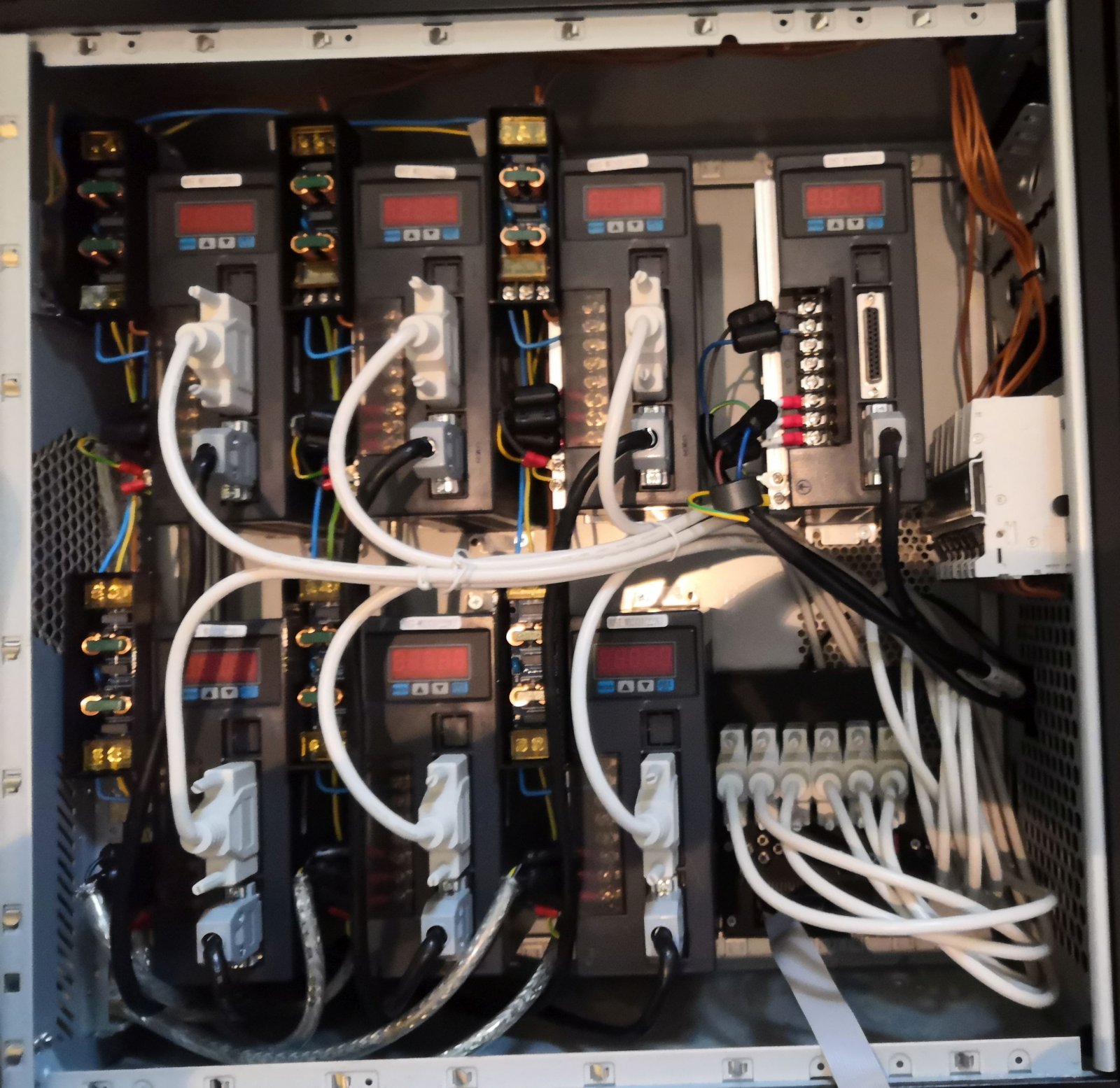

    Hi Folks
    Maybe you have seen my FS2 Test disaster.
    So i am still in debug mode ;)
    After printing the broken parts the printer is still busy.
    I want to get rid of the EMI sound.

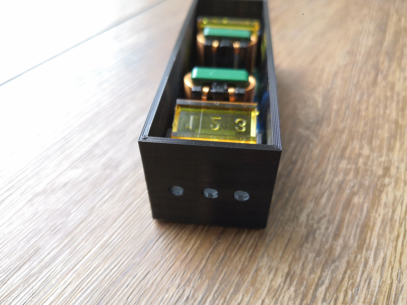

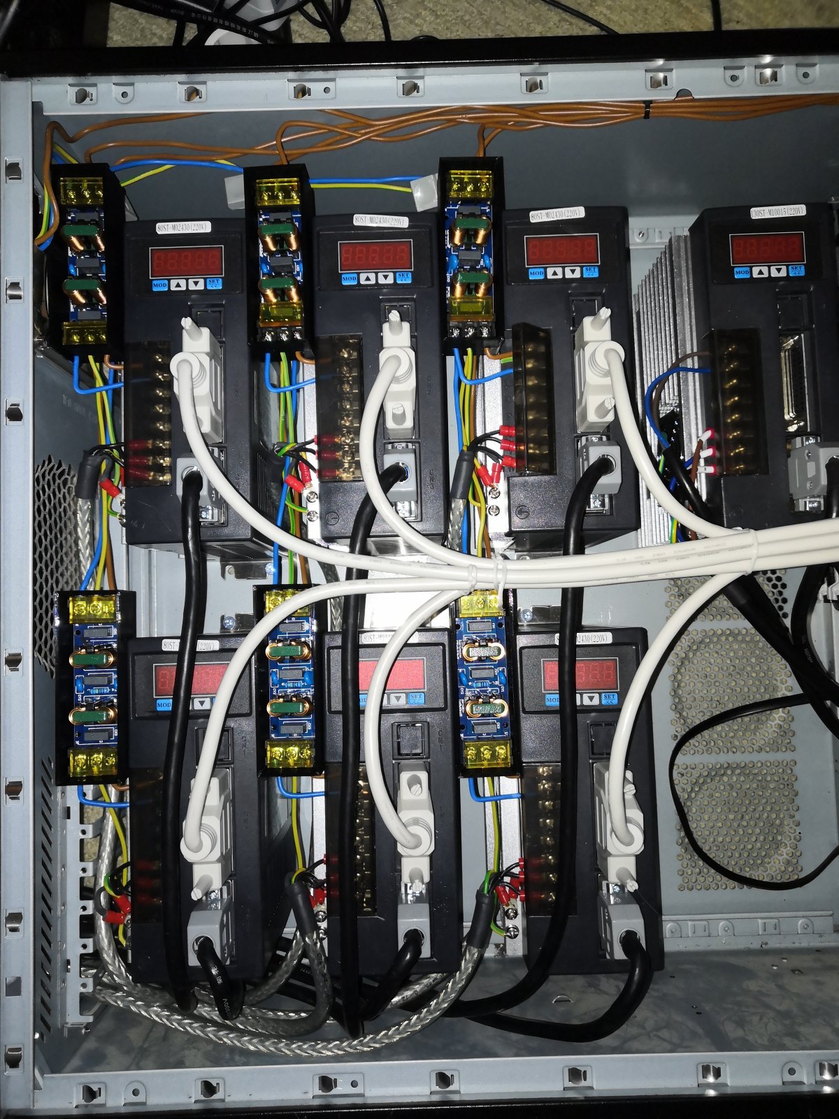

    so this is what i made:
    This was the initial situation:
    Only one EMI filter in the left top corner

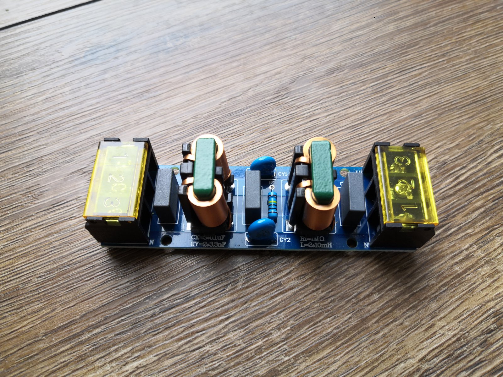

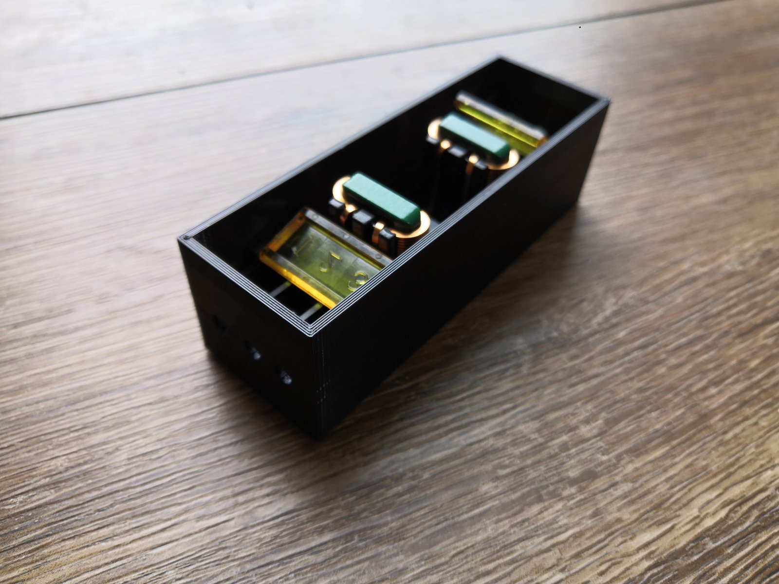

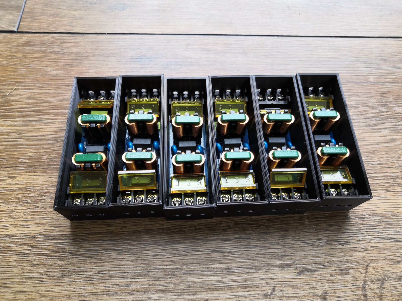

    So Amazon delivered this:
    six 25A EMI filters
    And i printed a little bit:
    after a major rewire it now looks like this:
    EMI Test will follow later.
    Regards
    Peer

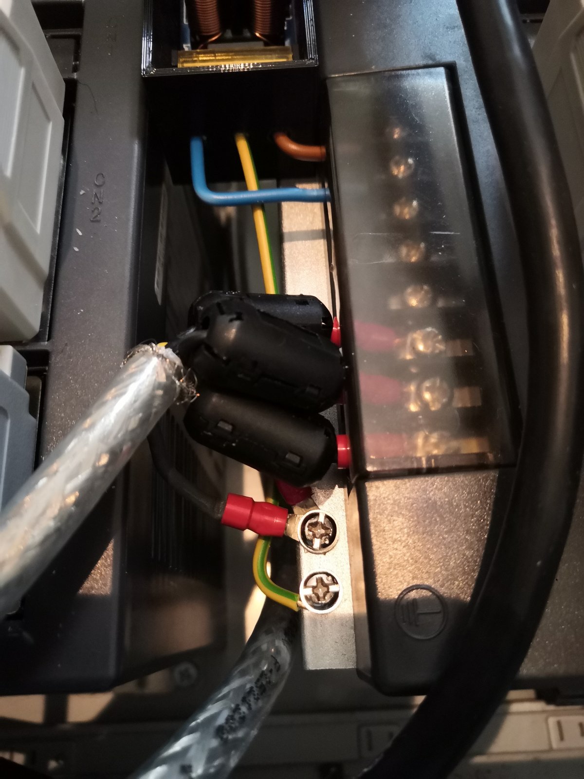

    Next step in EMI-Wars
    Every line to the motor gets a ferrit ring for filtering
    So the first 18 ferrit are assembled ;)
    All power cables to the motor are shielded from the beginning of the project.
    The shield is connected to the coolingplate at the same point as the earth contact of the power-input-line.
    If this does not help, i have no more ideas ;)
    Test and results will follow
    May the EMI force be with me *lol*

    Hi Folks
    Sorry, i forgot the detailed pictures of the ferrit
    Here they come:

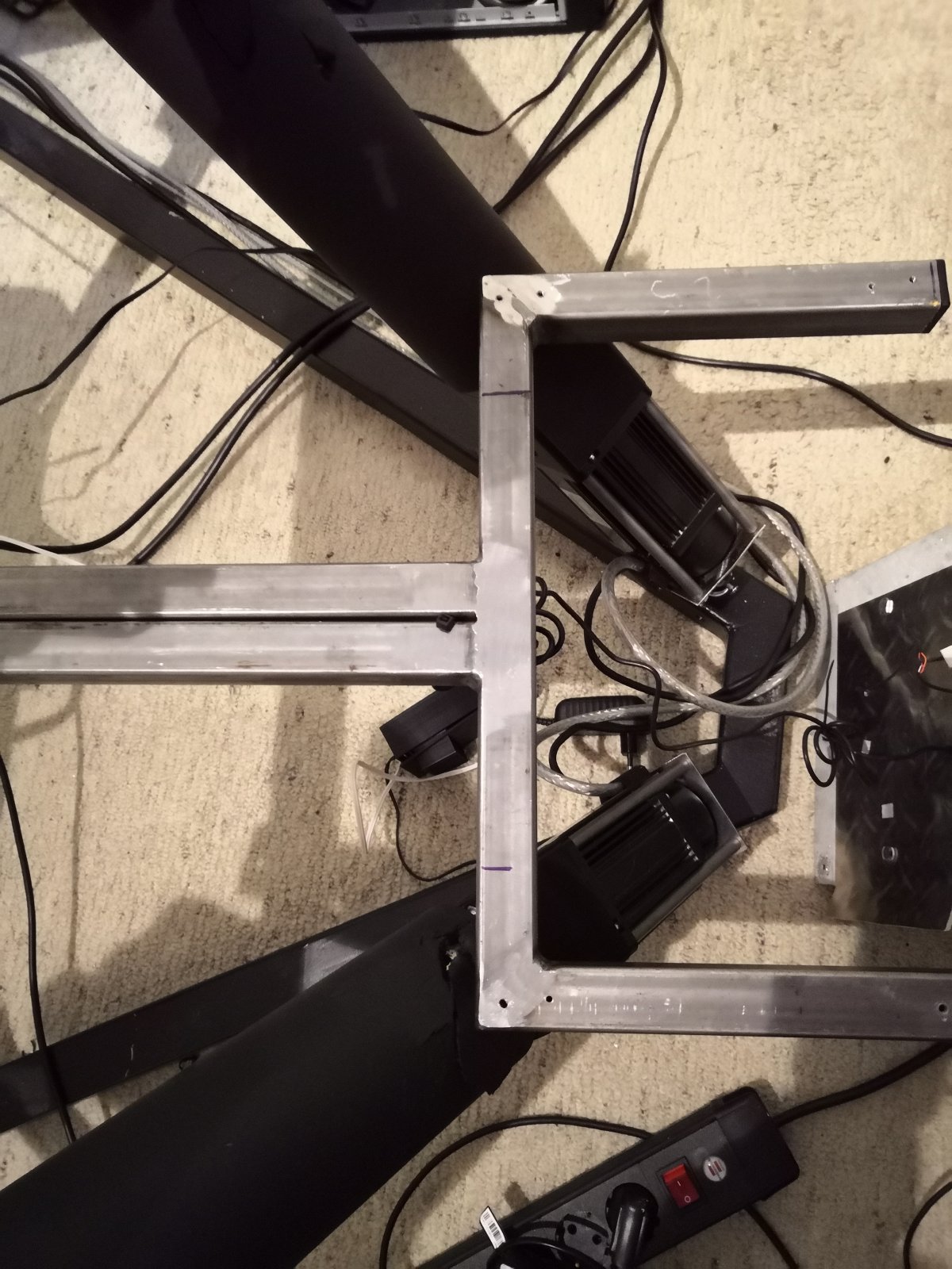

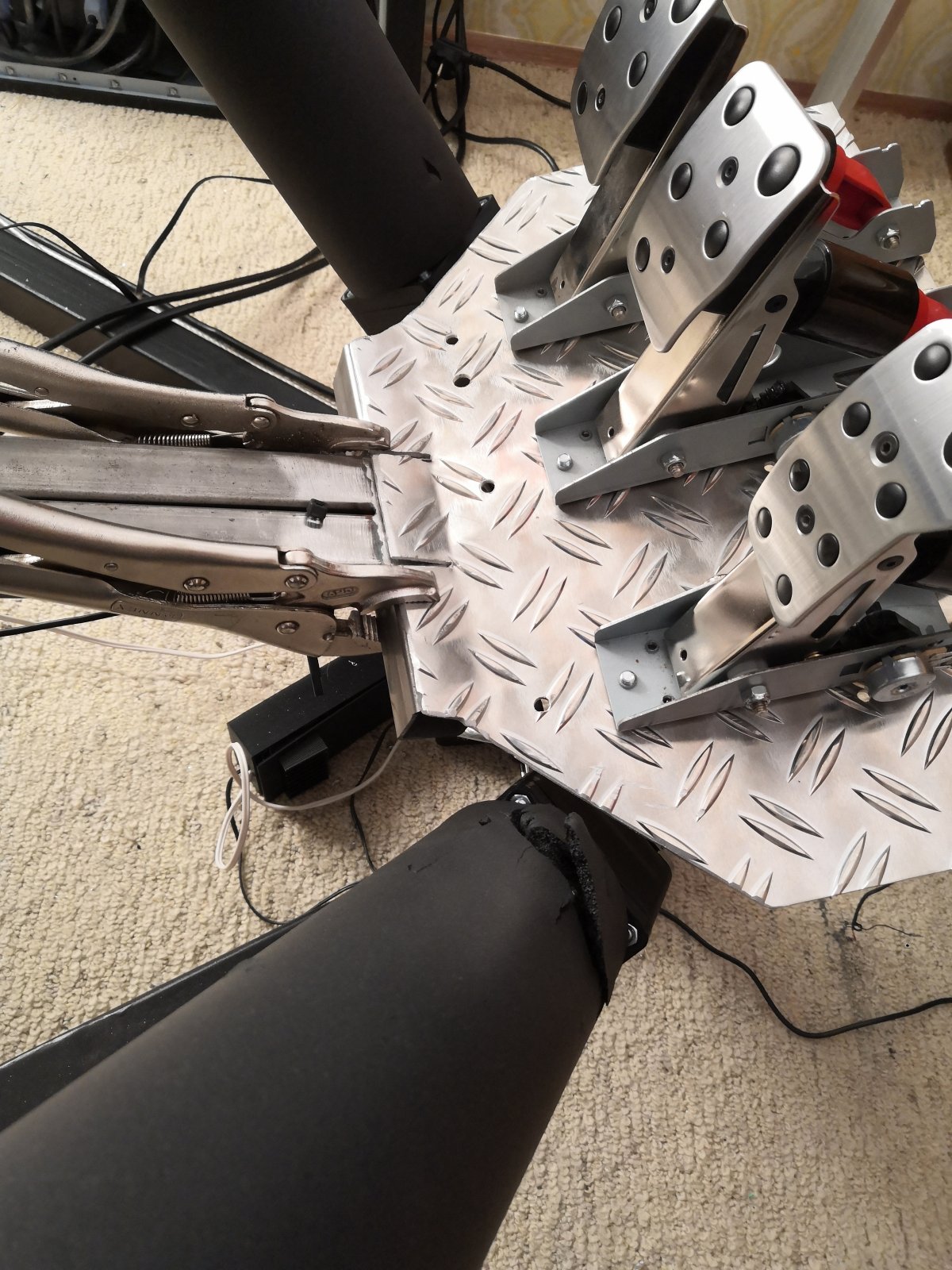

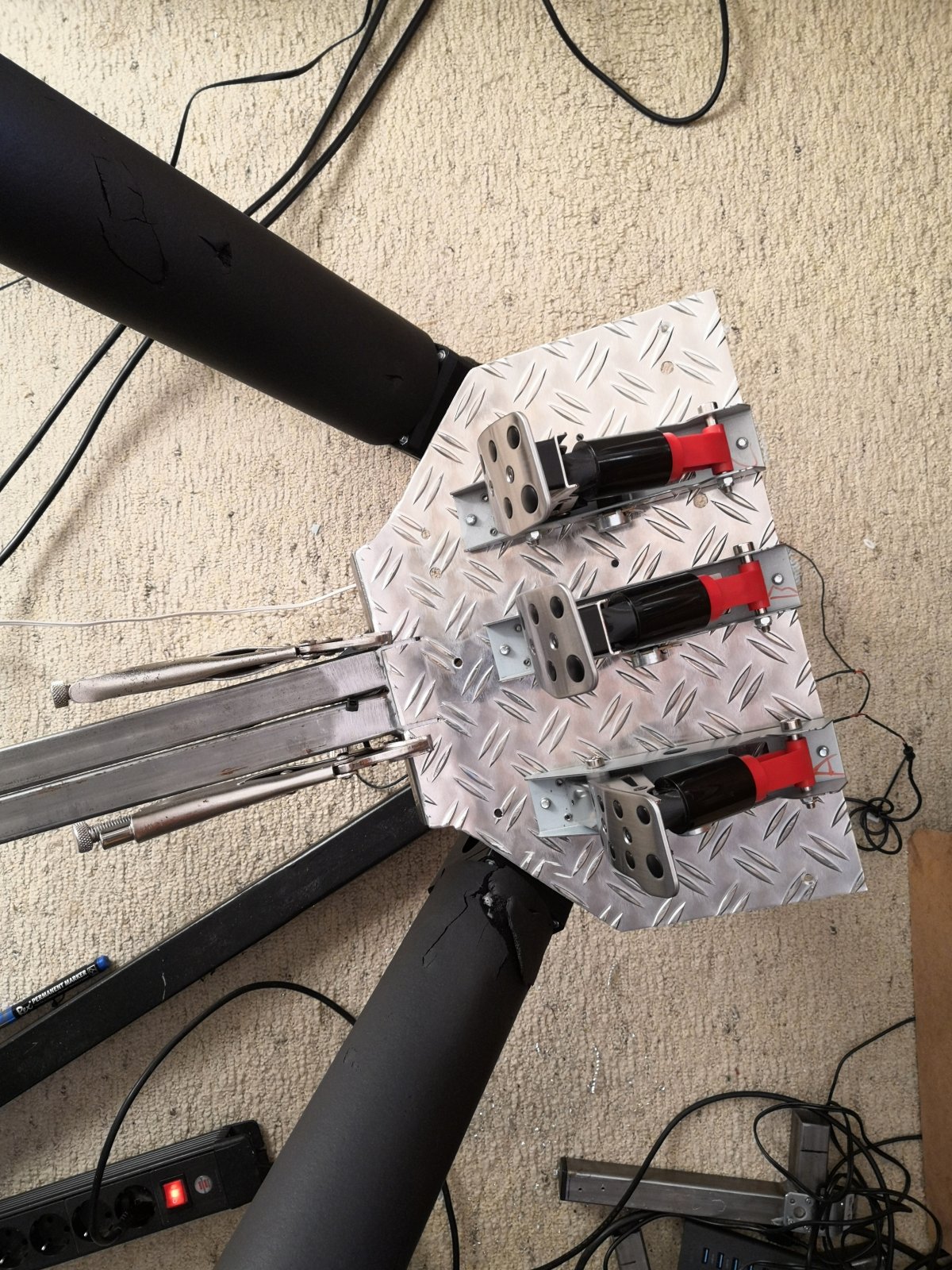

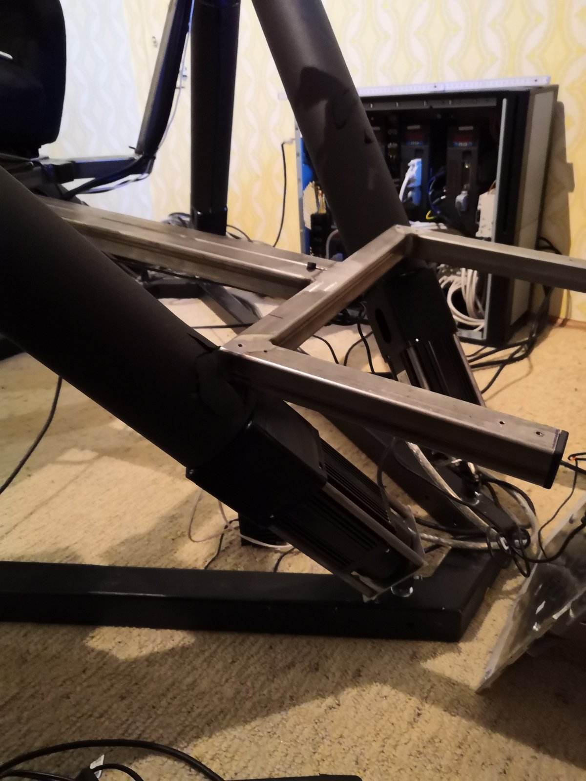

    An there is a new question.
    What is the worst case position for a 6DOF rig and the front arm for the pedals?
    After my last crash I´m a bit worried about a possible next crash.
    So I wanted to test the maximum.
    Is it right, that it is the worst case, if only one of the motors 3 or 4 (the motors on the back side) are on maximal position, and all other 5 motors are in lowes position?
    I´ve tried to move in this position manually but i cant reach maximum.
    The plate with the pedals get in contact with the aluminium tube just like in last crash.
    it looks like this:

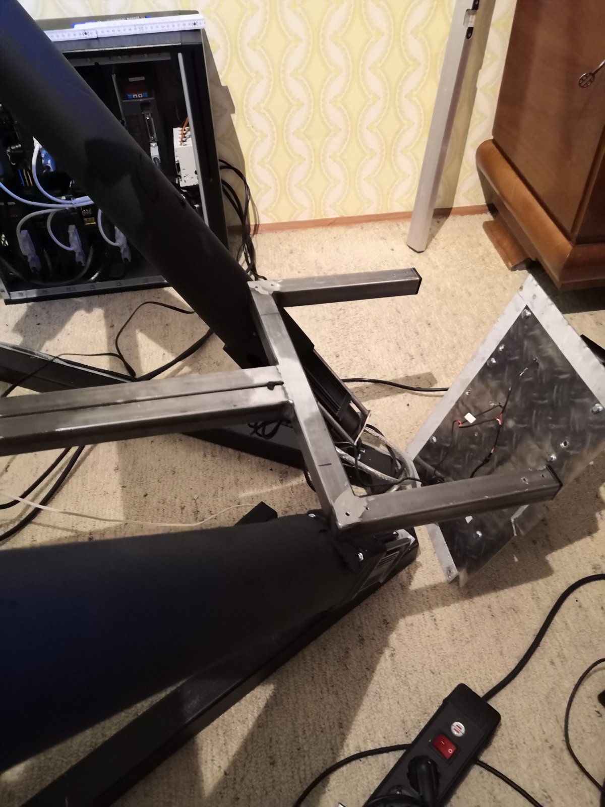

    I will cut the frame on the blue lines and will test it again
    Then the arm should have enough place to move in the worst case position.
    This should prevent me from the same crash again
    What do you think?
    cheers
    Peer
  8. Pierre Lalancette
    Dec 11, 2016
    1,012
    Tech Artist
    Quebec, Canada
    8,052Coins
    +947 / 6 / -0
    3DOF, DC motor, Arduino, 6DOF
    You simply reduce your rig movement so it doesn't append again.
    Reduce the range of the actuators.
    Pierre.
  9. C1500
    C1500 Active Member
    Nov 19, 2018
    165
    1,120Coins
    +86 / 1 / -0
    AC motor, 6DOF
    Sorry Pierre, but:
    NO !
    NO !
    NO !
    That is NO solution !! *lol*
    I had only 22cm complete movement when I made the last pictures.
    So I cut a bit an it looks like this now:
    In this position motor 4 is moved to 39cm and all others are at 0cm
    So I think this is my absolute worst case.
    The software-limit is set to 38cm.
    But now I have to stabilize the pedals because the frame underneath is missing.
    Now i feel a bit saver for the next testruns.
    But sill in debug mode ;)
    cheers
    Peer

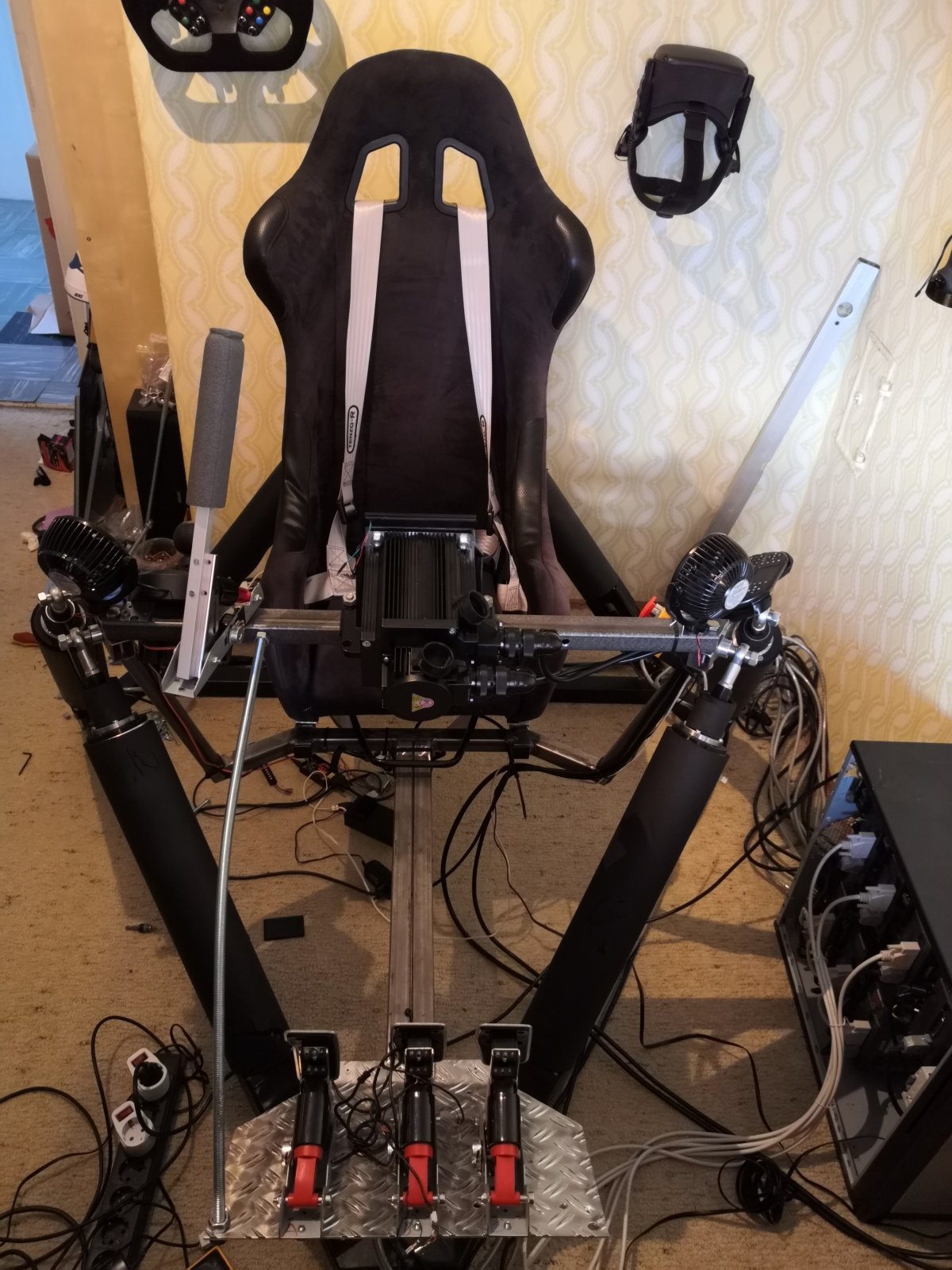

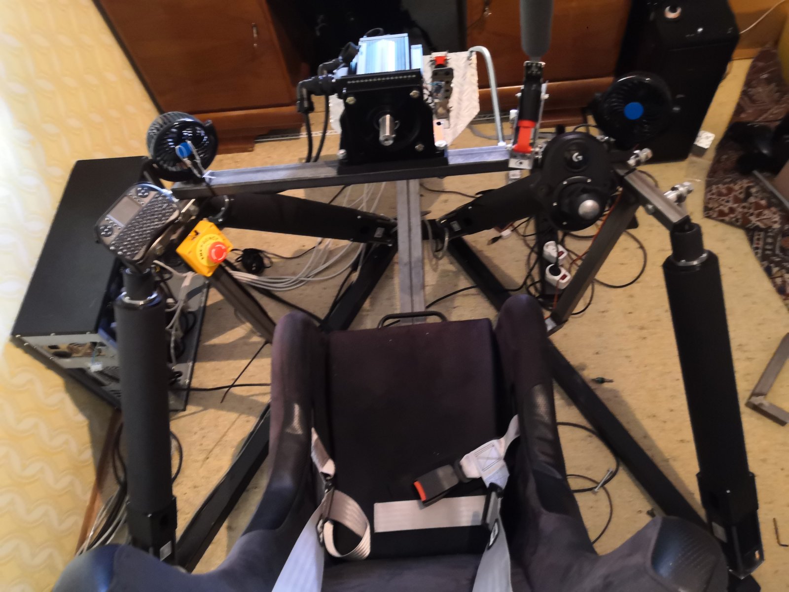

  10. Thanos
    Jul 6, 2017
    1,379
    Electronics Engineer
    United States
    2,917Coins
    +1,079 / 10 / -0
    Something is wrong on your geometry. Can you post some photos of the whole platform?
    The cockpit can be recessed in the top triangle, but not too much that the pedals footrest will have change to hit the actuators body...

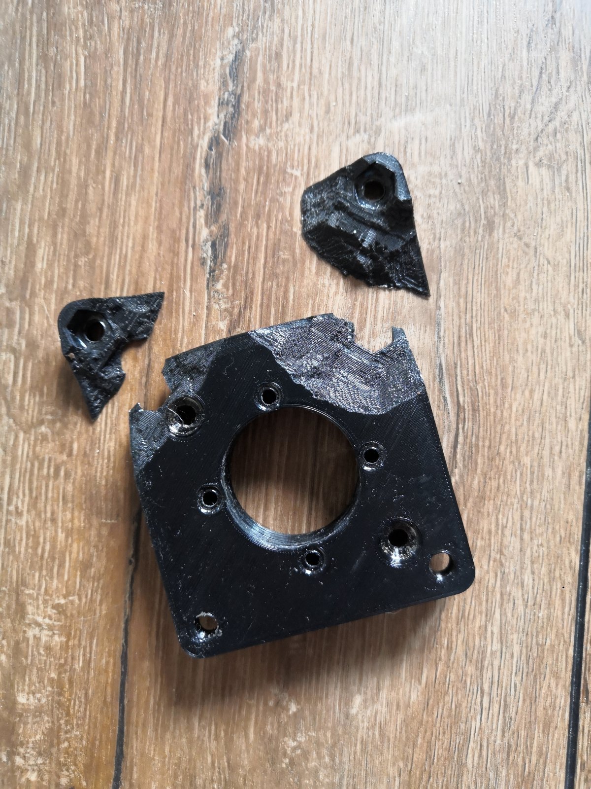

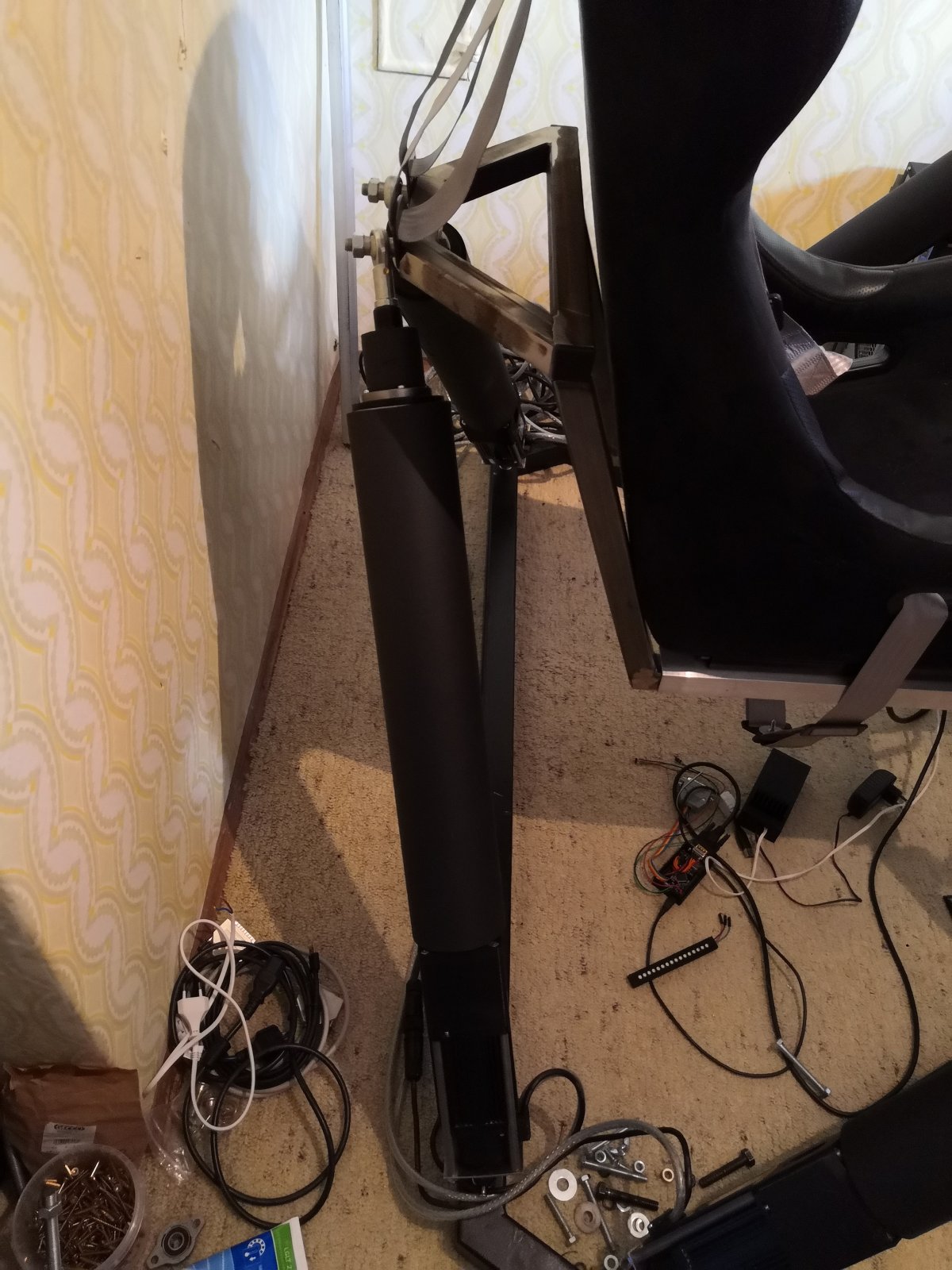

    Hi folks
    After printing the broken parts and reassemble it, I recognized another unknown sound while moving the rig manually.
    The Problem was found really fast. Another broken Part in the left-back actuators.
    The lower ball-bearing-holder was broker.
    While disassembling the actuators I found also a loosen screw witch normally holds the ball-screw in the ball-bearing.
    Now everything seems OK

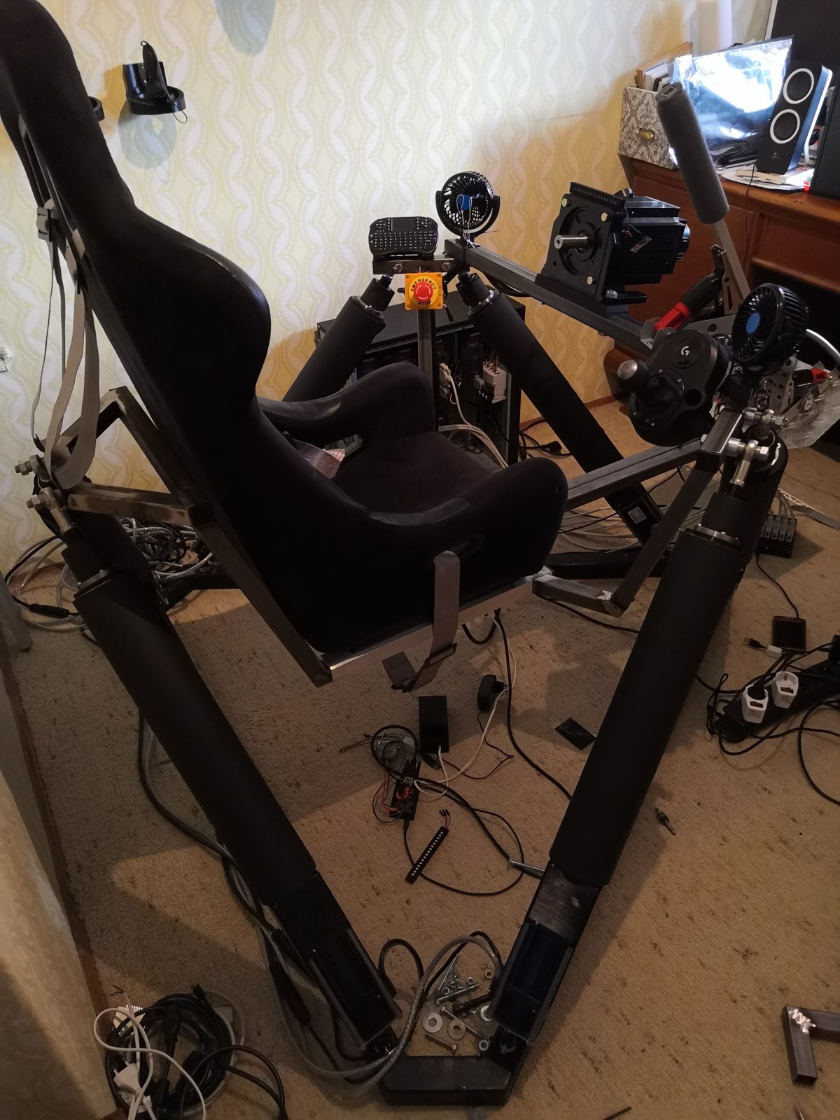

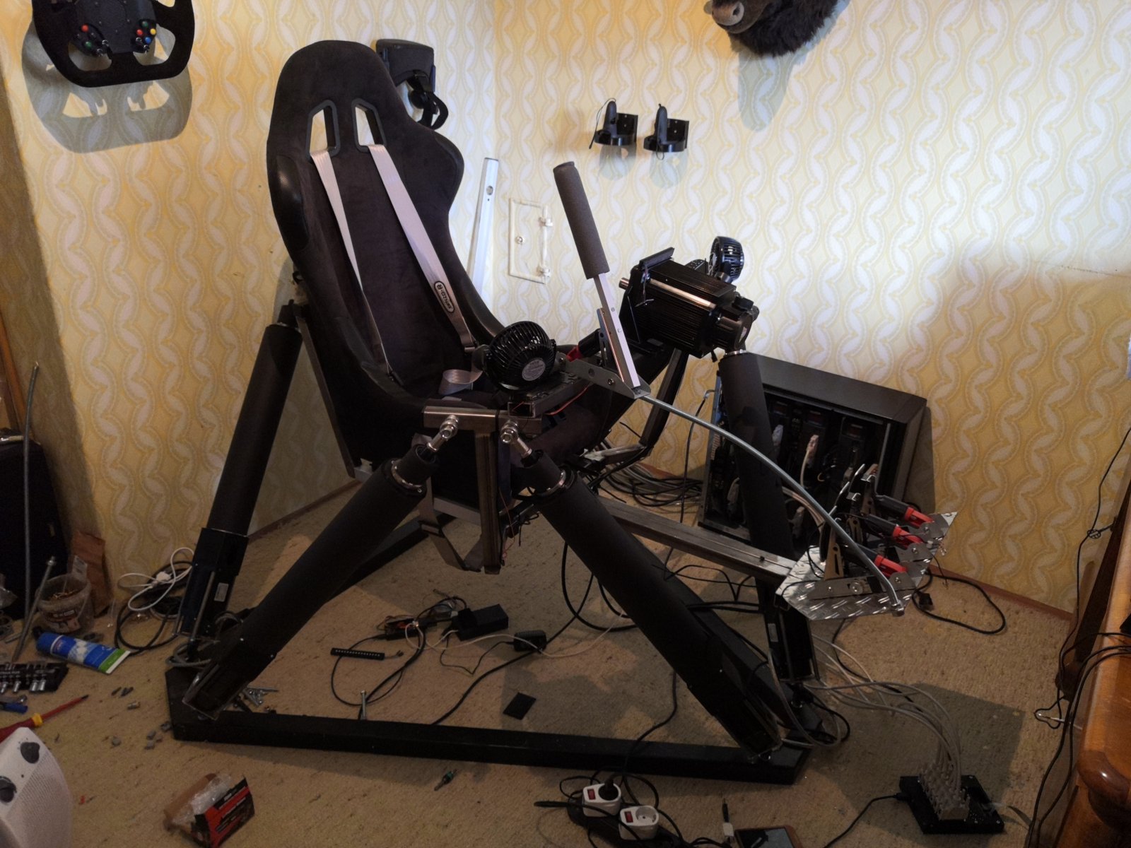

    Hi @Thanos
    Here are some pictures of the rig.
    Unfortunately I did not get to clean up yet ;)
    What do you think?
    Is there a big mistake in the geometry?
    Can you please also confirm my settings in AMC:
