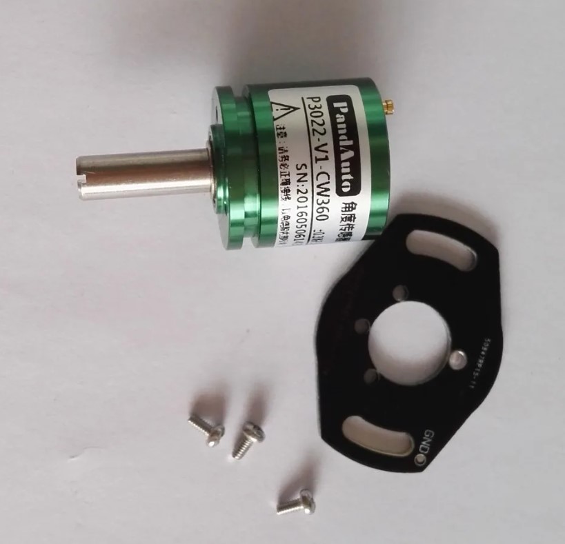

    Excellent work, very clean and with few elements, congratulations, a question if you can, but what type of potentiometers are you using? I'm trying with softpots but in addition to wearing out they are also unstable in my opinion.
  4. m50b20
    m50b20 Member
    Jan 4, 2024
    87
    118Coins
    +60 / 1 / -0
    Thanks !
    P3022 360 Hall pots
    Very precise and do not wear at all
