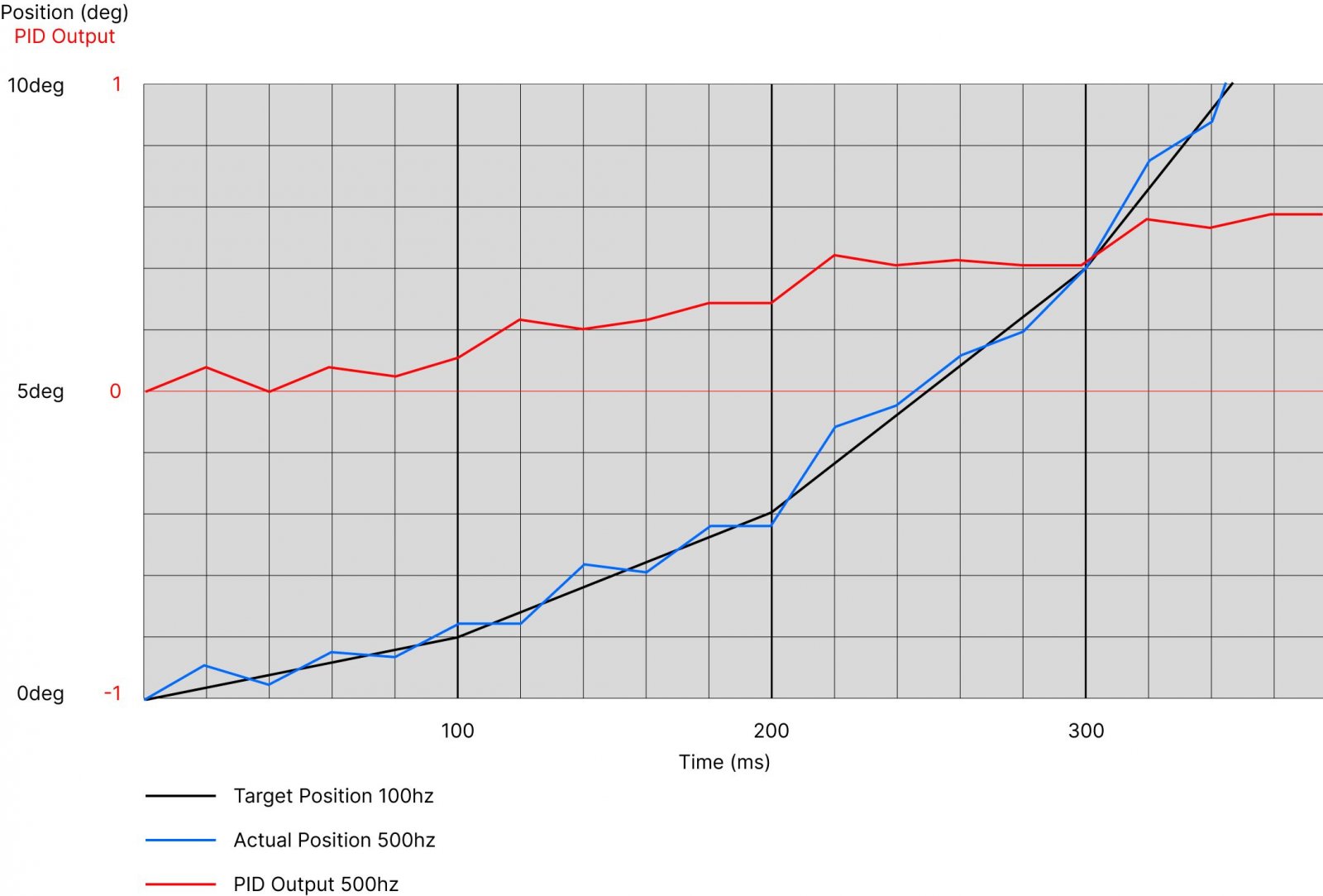

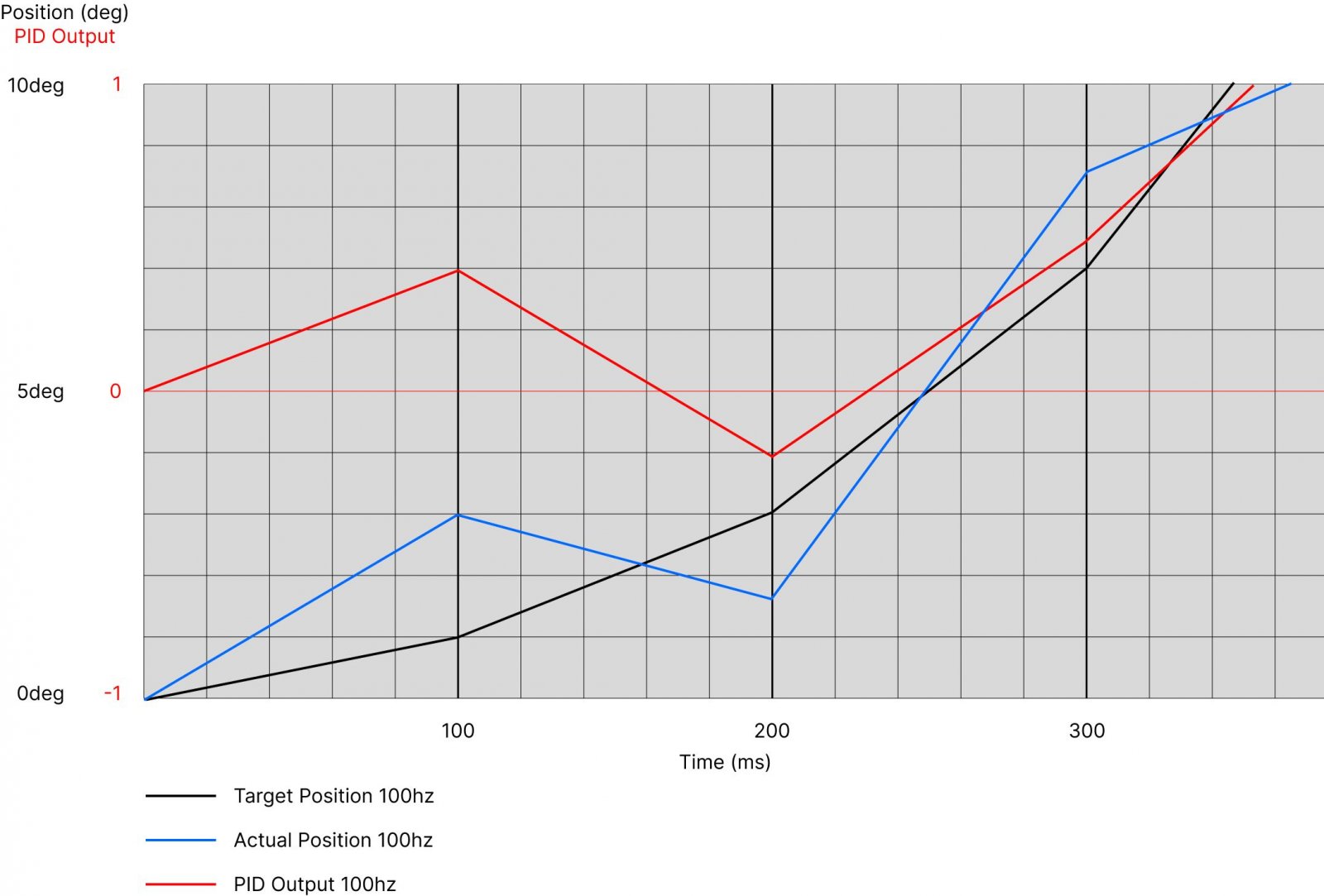

    4 kHz for the entire program isn’t too bad, but I think across three (possibly 4 PID loops if you add yaw axis) your maximum PID calculation rate could only ever be 1 kHz at best. I usually use a 50% reduction for the best theoretical rate particularly if you are communicating with third-party sources over USB, UART, SPI etc which can cause large deviations in the loop time. So the best PID rate you could probably get is about 500 Hz. I’d venture that you want at least double that for this purpose. And the reason is below.
    Okay, if XSimulator calculates the PID loops then ignore what comes after this sentence because it doesn’t apply. By this I mean the encoder data goes out via USB to XSimulator XSimulator calculates what the position and motor output should be and then sends this data back to your MCU.
    If XSimulator outputs position data only to your controller (Uno) and the controller is in command of the PID loop, then the graphs below will most probably apply. In this scenario we’ll call XSimulator the motion generator and your Uno the follower. The graphs don’t show any real data by the way it’s just a visual representation of what the data might look like with two different time bases.
    In the first graph all of the data is at 100 Hz. The black line is the target position provided by XSimulator. The red line is the output from the PID loop. For the purposes of these demonstration graphs the output is from 1 to -1.
    In this graph you can see that the actual position varies around the target position because the PID controller is only calculating a new output at the same rate as the target position. I’d like to point out that this is in ideal circumstances because there is no guarantee that target position provided by XSimulator will align with the PID loop calculation unless you run an interrupt which triggers the PID loop calculation every time the target position updates.
    In the second graph (the key is the same as above) the PID calculation is five times the target position update rate. You can see that the variance around the target position is much smaller. This is typical when the PID loop rate is higher than the target positions update rate.
    In this control scheme with a higher PID update rate than the target rate, the PID loop is able to adjust the output based on the current actual position and rate of change making the motion much smoother.

    I understand what you are saying about the PID calculation rate, but thank you for the graphs for reference.
    The microcontroller is calculating the PID, not Simtools. The 4 kHz rate I mentioned was for a complete program loop using SMC3 in the micro. So, it has read the feedback and done the calculations for all three motor outputs and checked for any new commands in each loop. I keep being amazed at just how much you can get out of these little micros.
    The different firmware I'm writing for 4 outputs still achieves that 4 kHz loop rate using the internal ADC, I've not implemented any SPI communications to test that, but I will. Big thing is that SMC3 is using Arduinos AnalogRead function, which sits there and waits for the ADC conversion to complete. I changed it so that I'm off calculating all the PID stuff for a channel while the ADC is doing the conversion on the next. That way I can slow the ADC clock down a lot and get better accuracy out of it. Since I do believe I can so something similar with the SPI core, I have hopes that I can make that just as fast.
