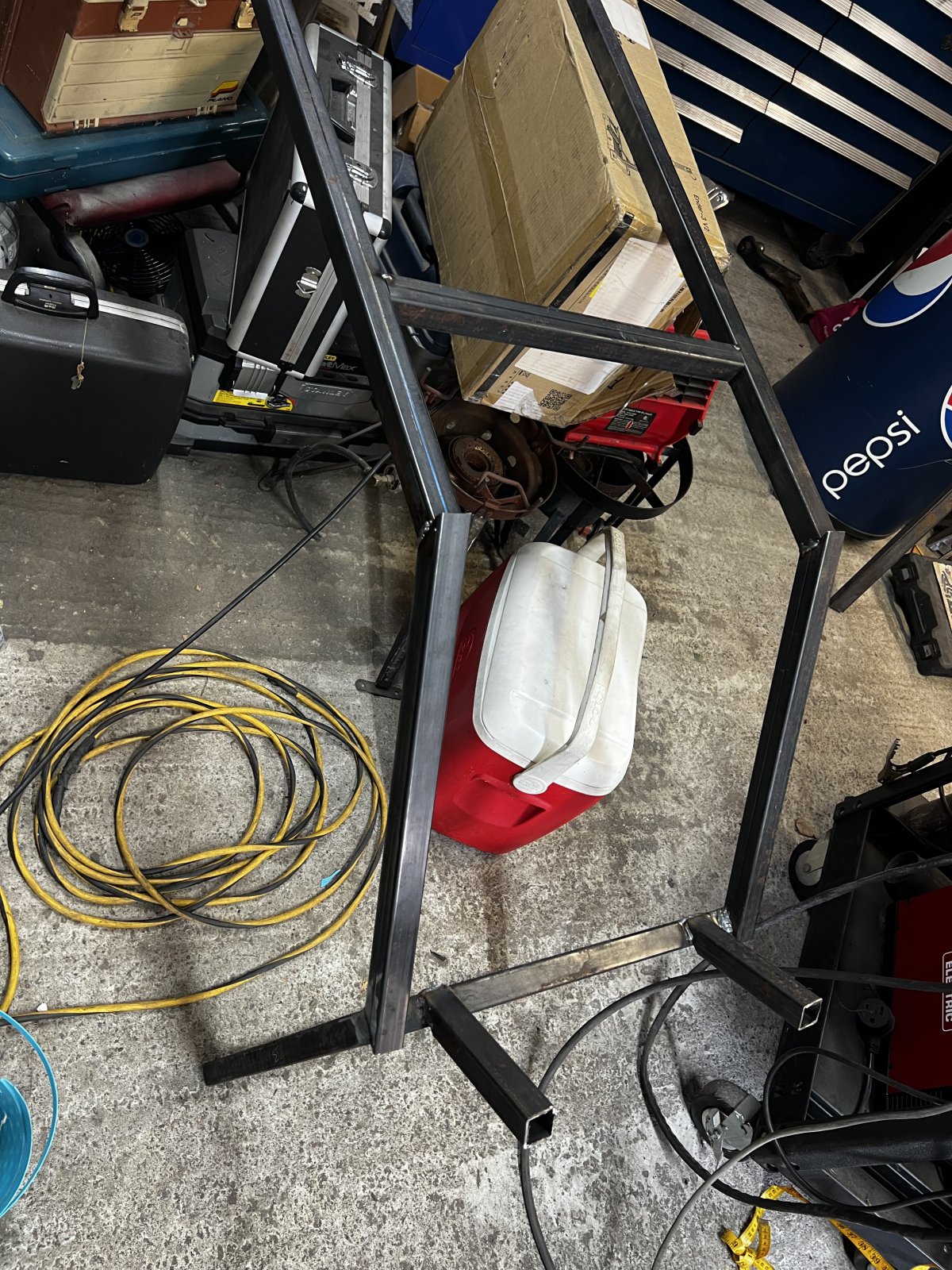

    That’s not gonna work, got to neaten that up

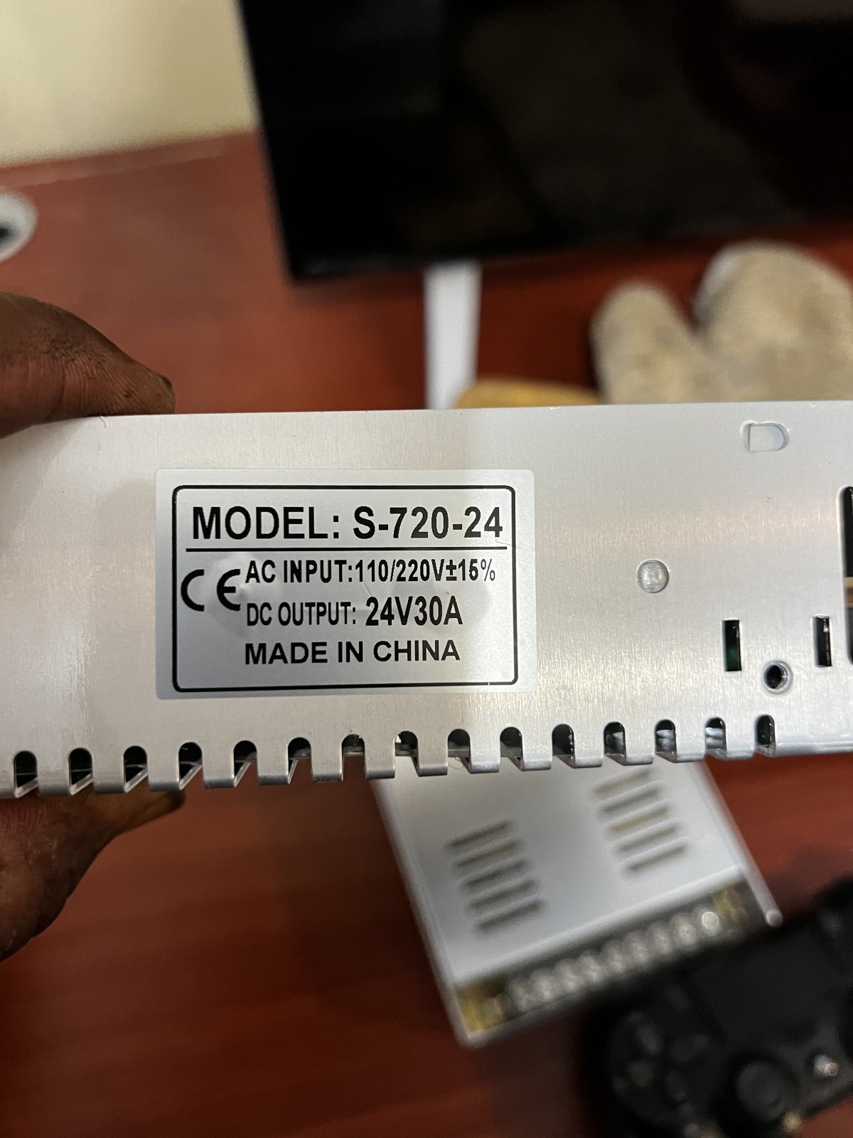

    We got POWER

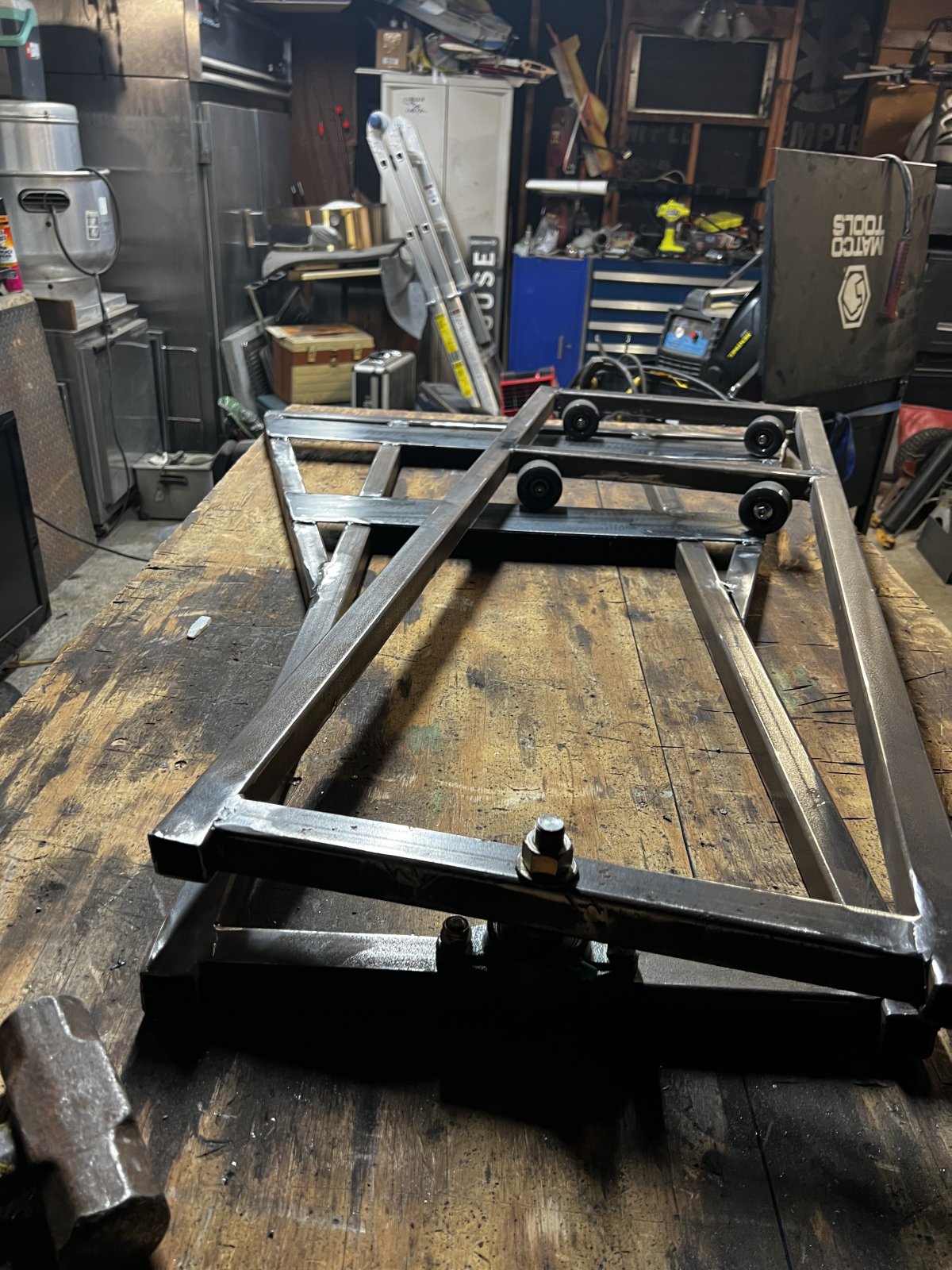

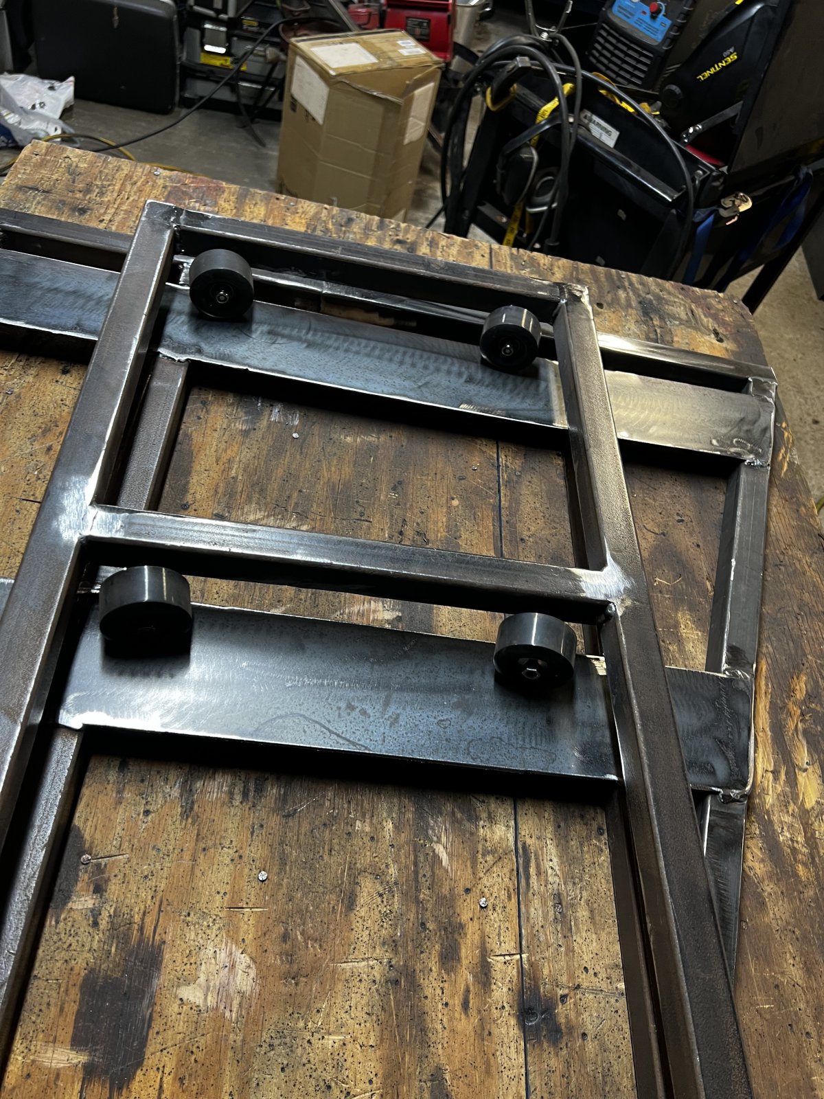

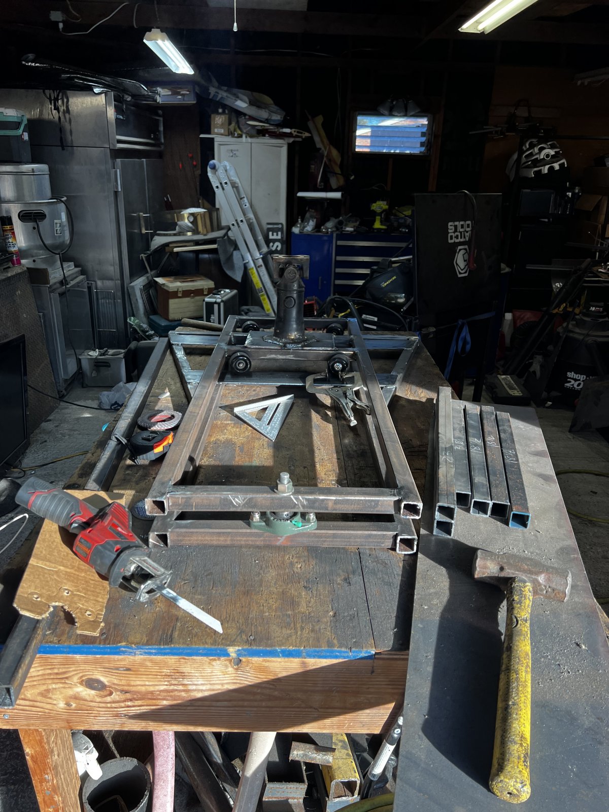

    Traction loss wheel plate done!
  7. stanley johnson
    stanley johnson Active Member
    Sep 14, 2022
    117
    Diesel tech
    Nashville
    82Coins
    +40 / 0 / -0

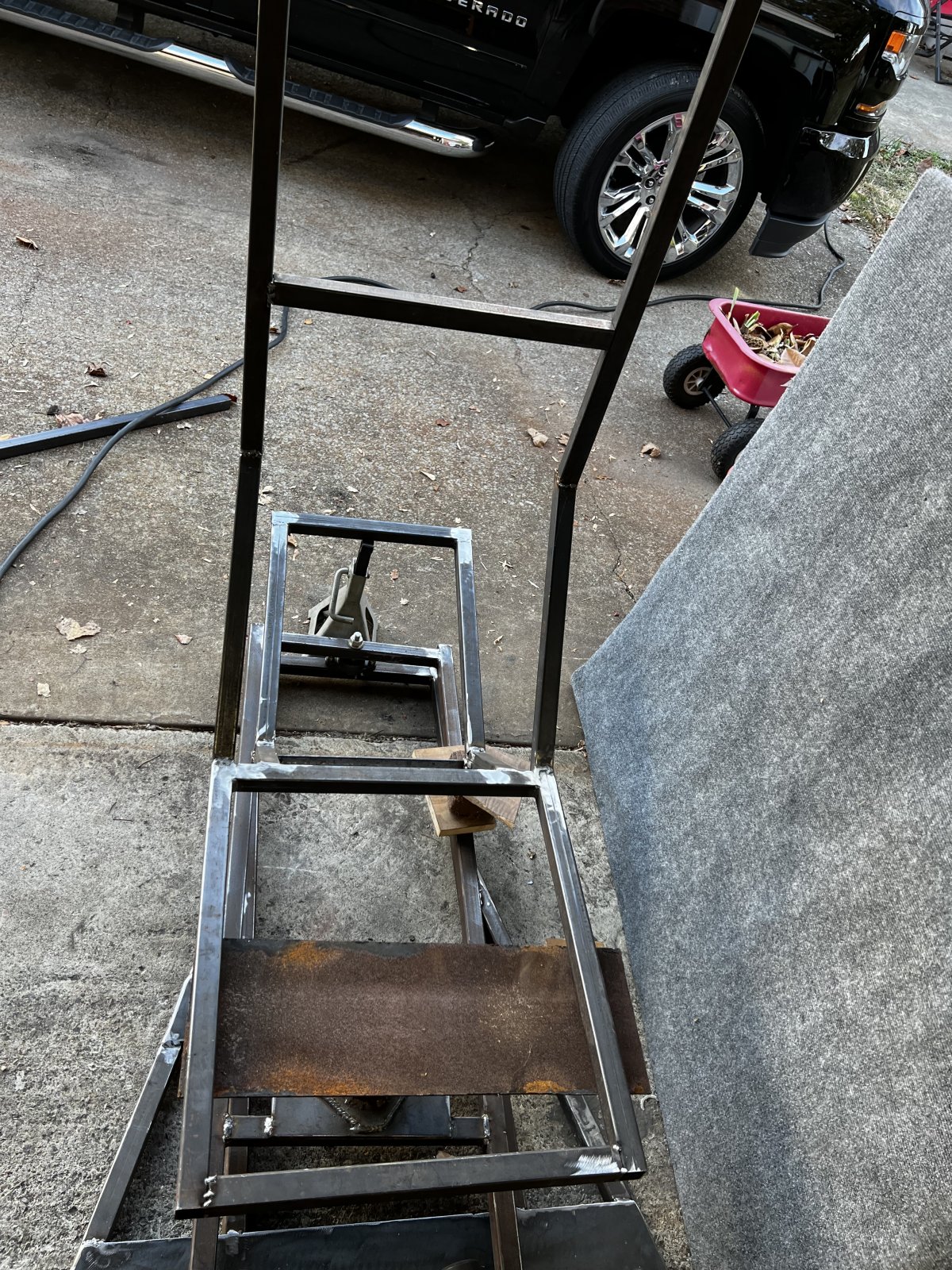

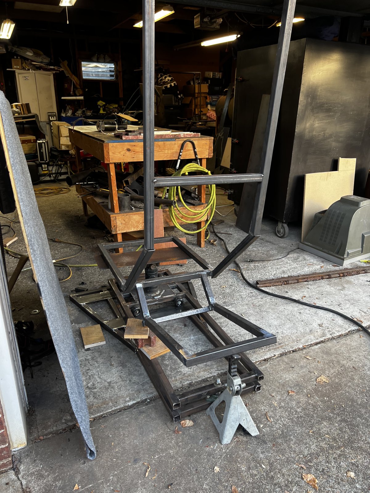

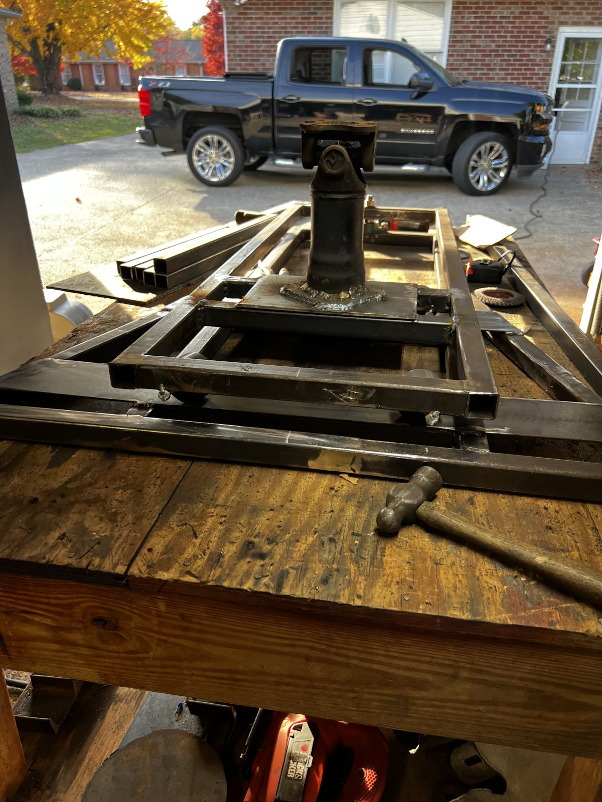

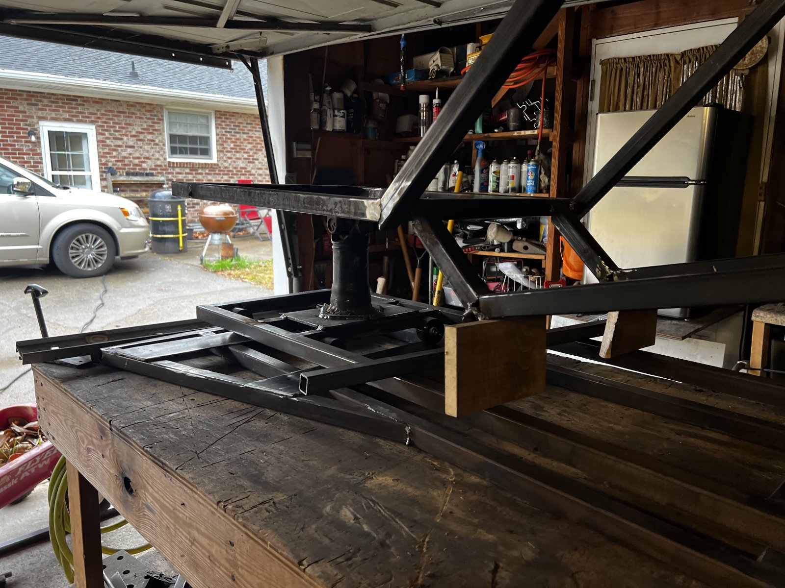

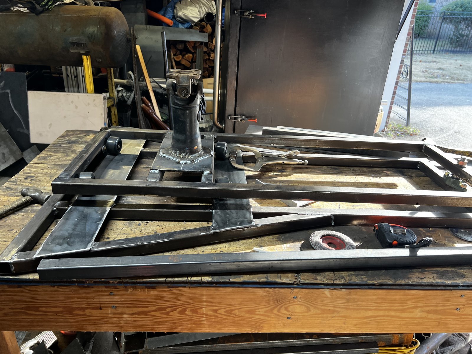

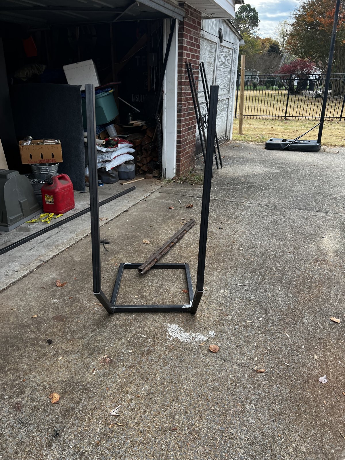

    Seat u-joint mounted, lower and mid frame done

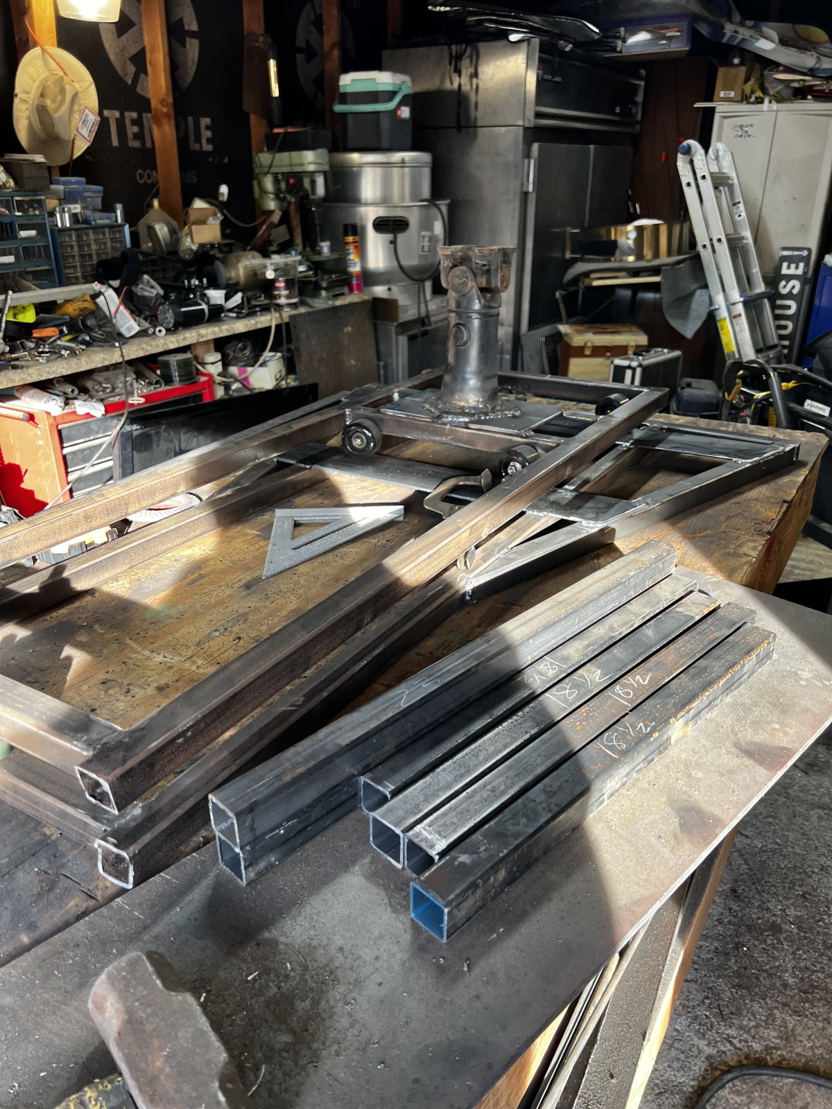

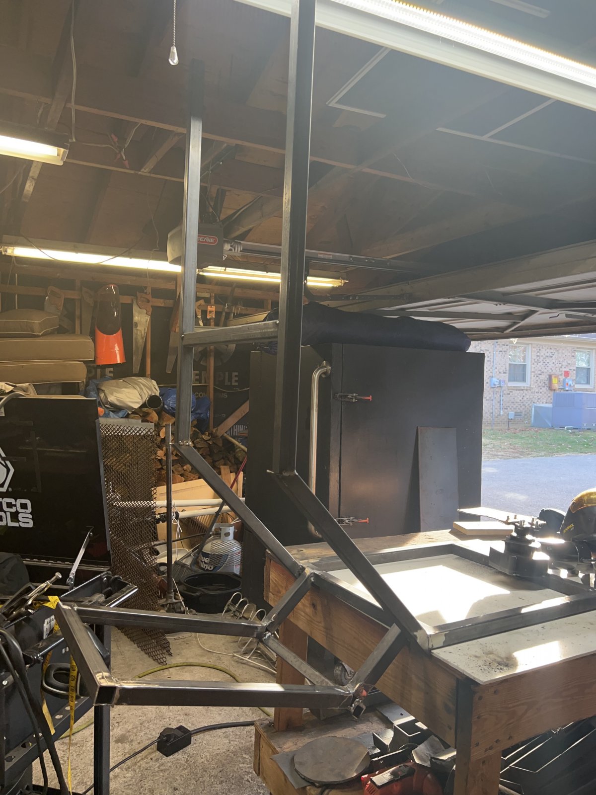

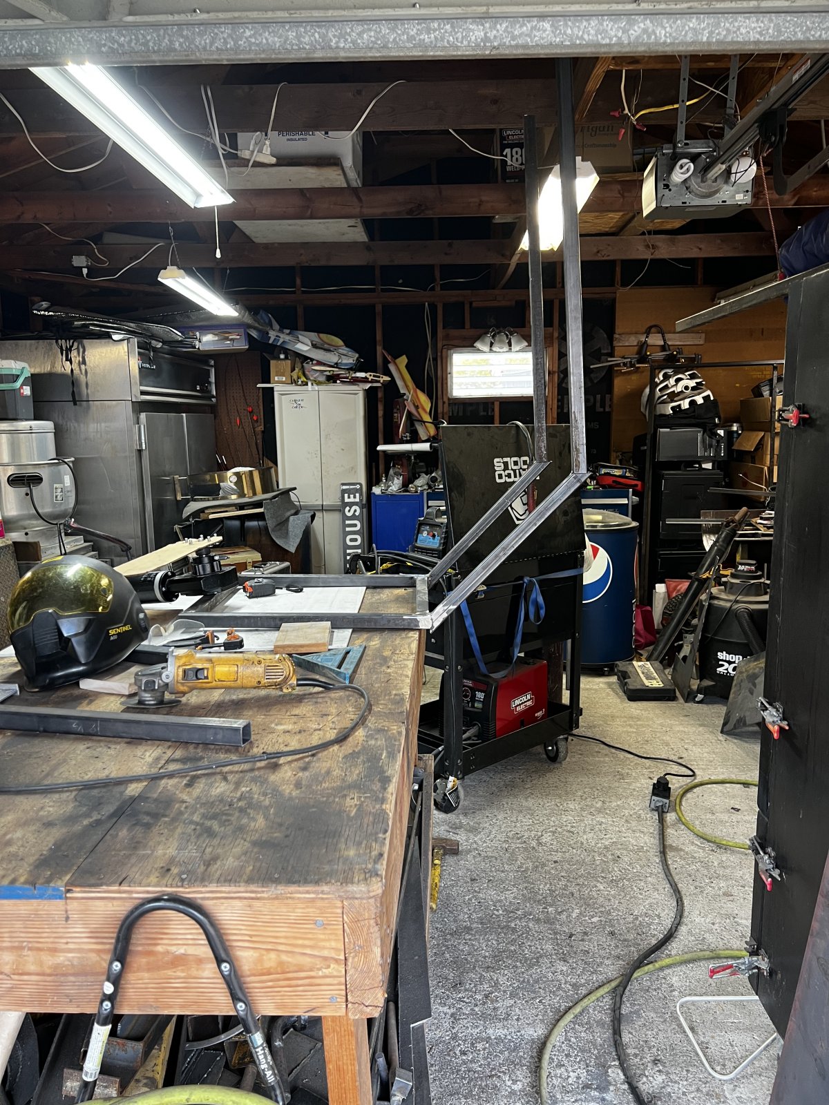

  8. stanley johnson
    Sep 14, 2022
    117
    Diesel tech
    Nashville
    82Coins
    +40 / 0 / -0

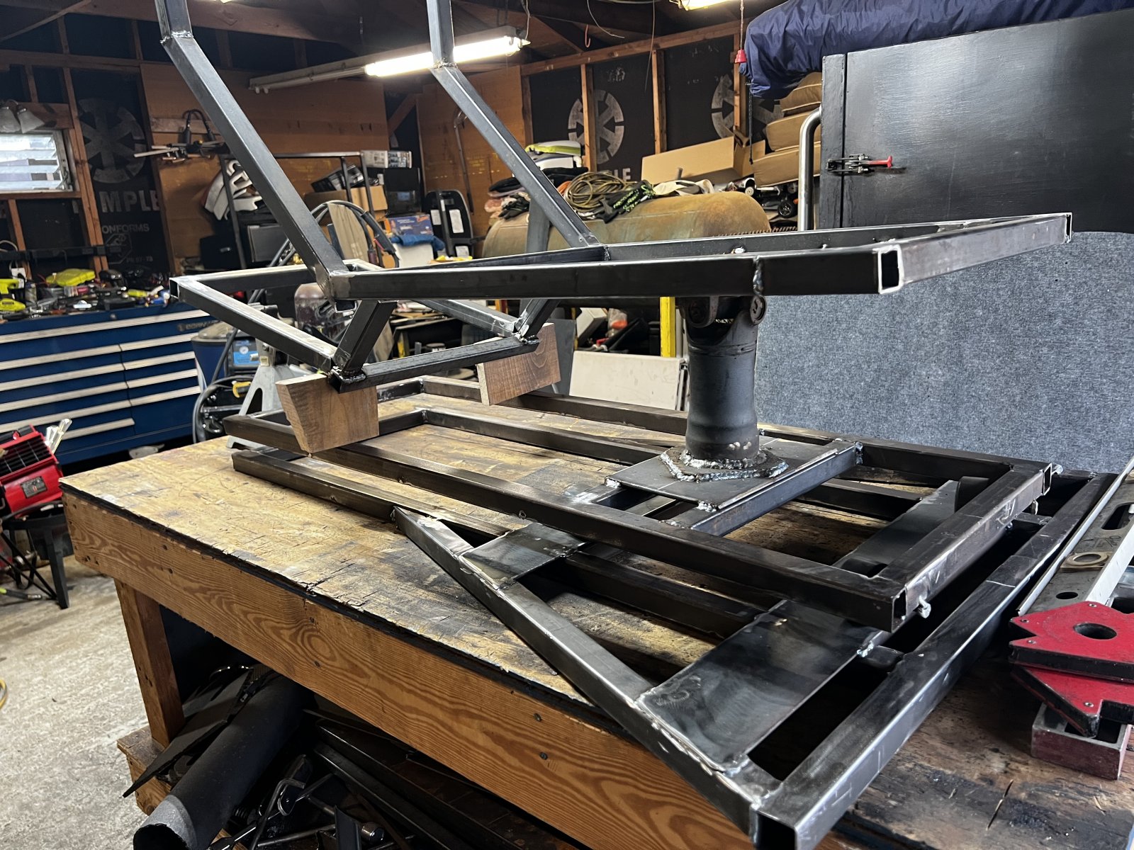

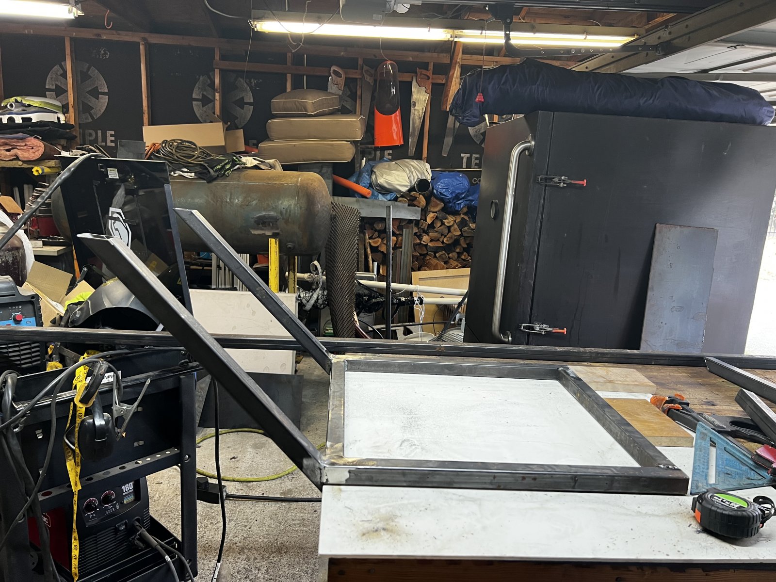

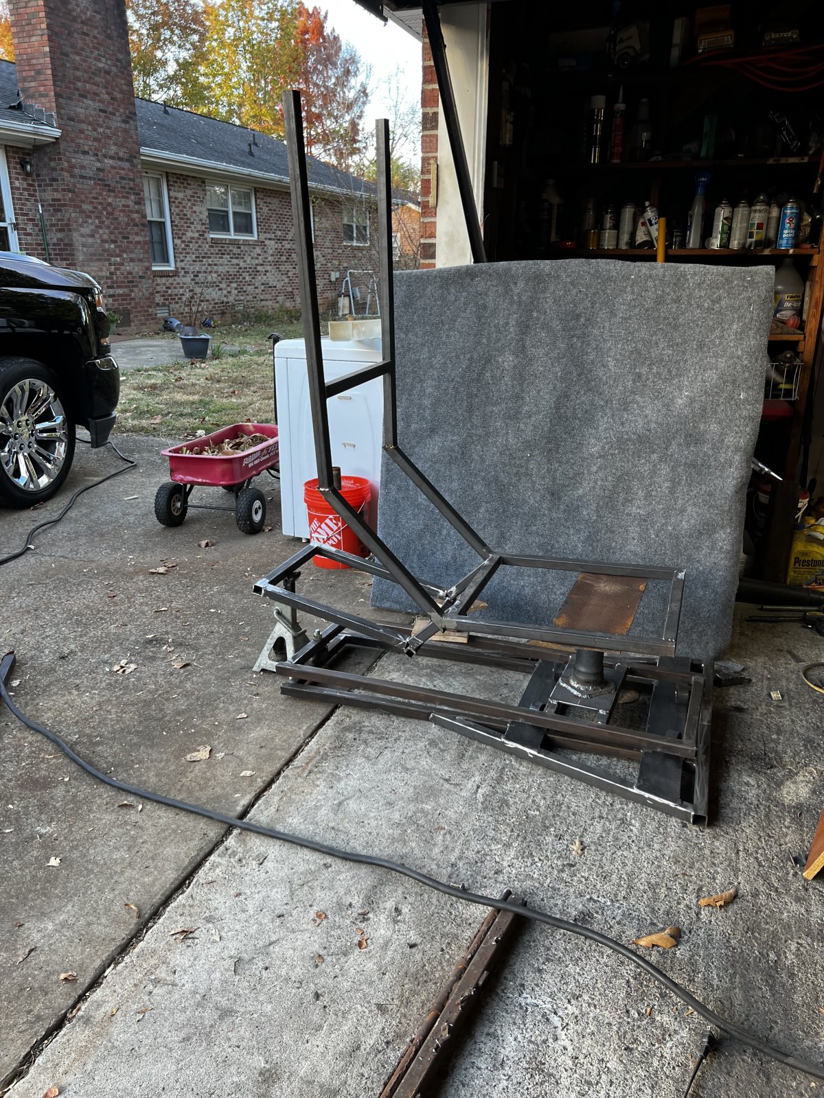

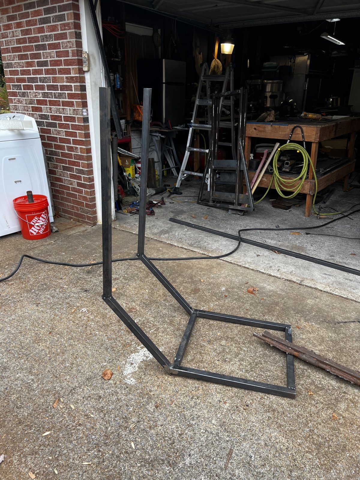

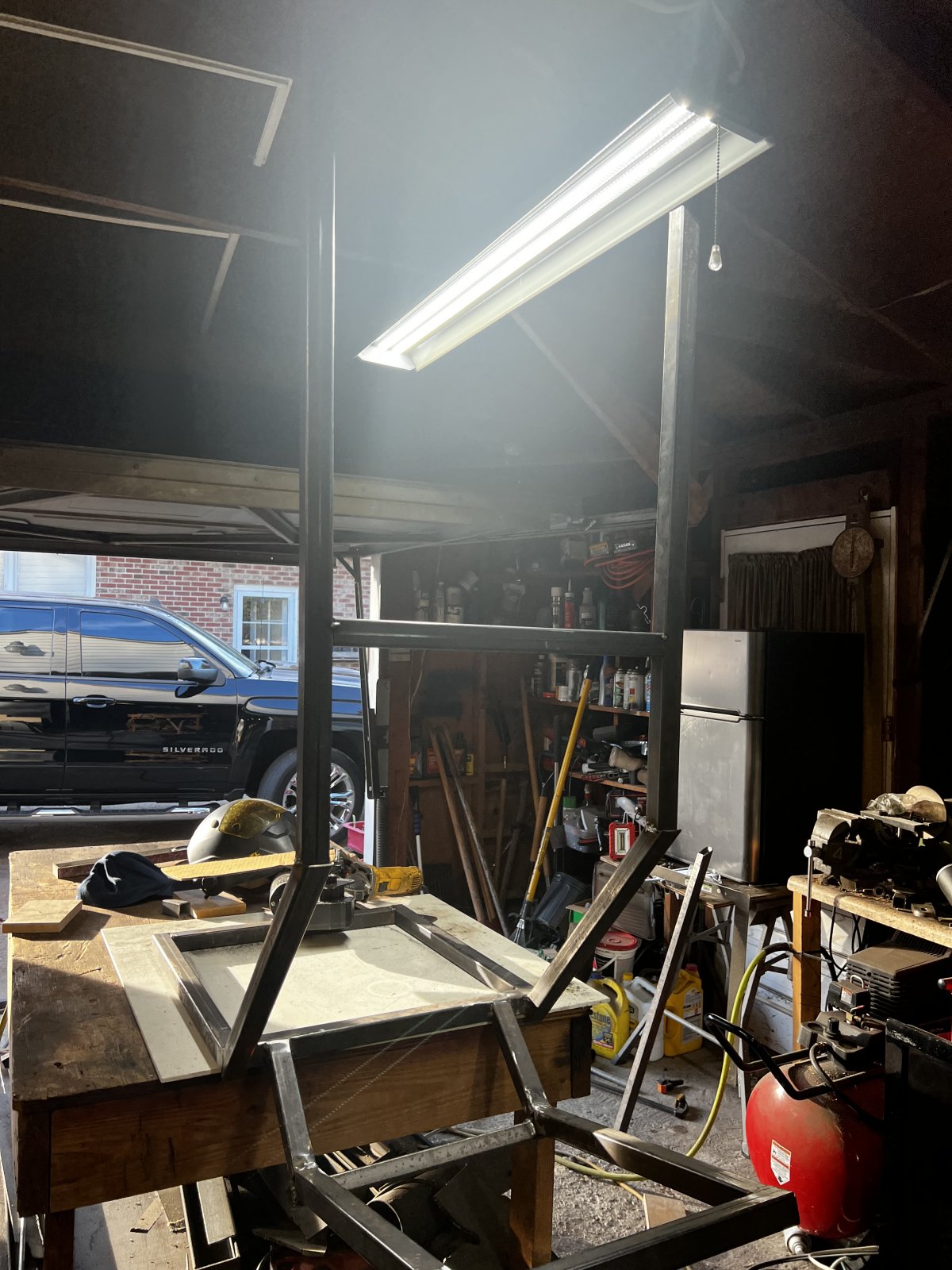

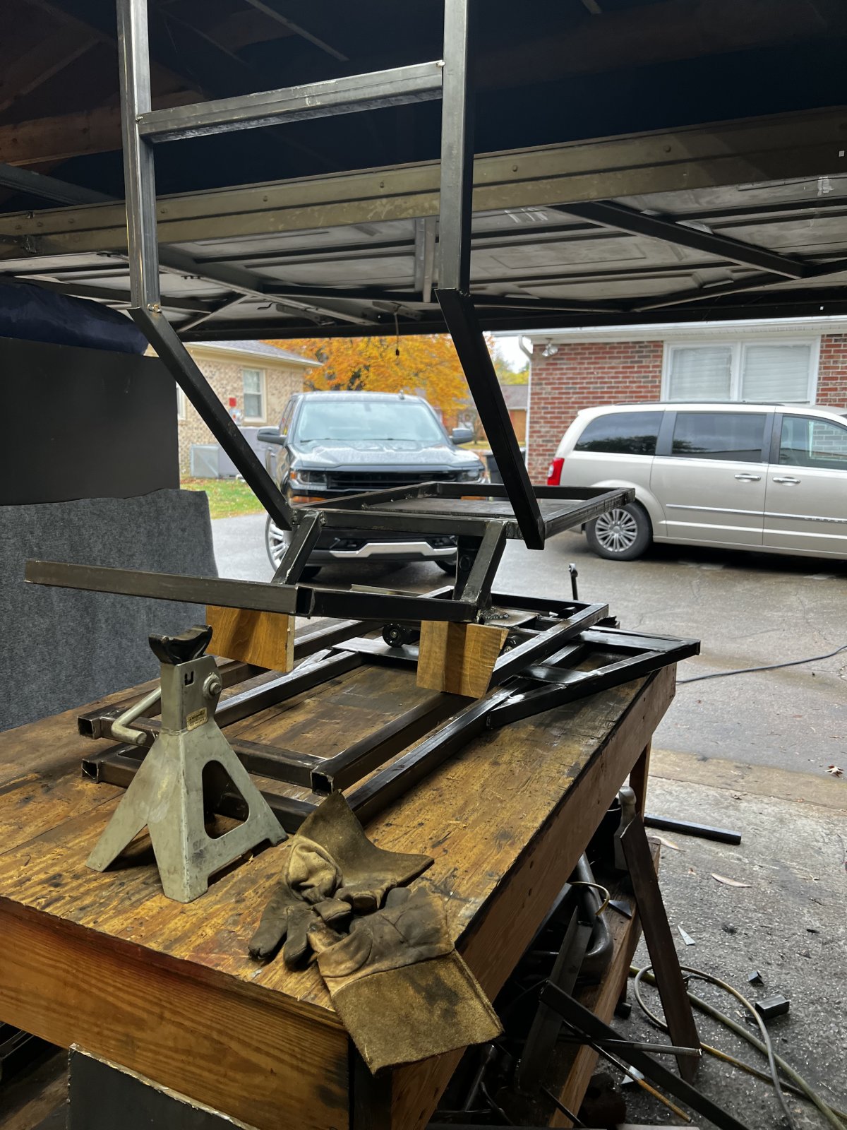

    08ED8092-C3FF-4F5B-9040-0664C3291635.jpeg 08ED8092-C3FF-4F5B-9040-0664C3291635.jpeg 188D0102-A527-4C3B-9B83-5410850E5427.jpeg Upper frame coming along

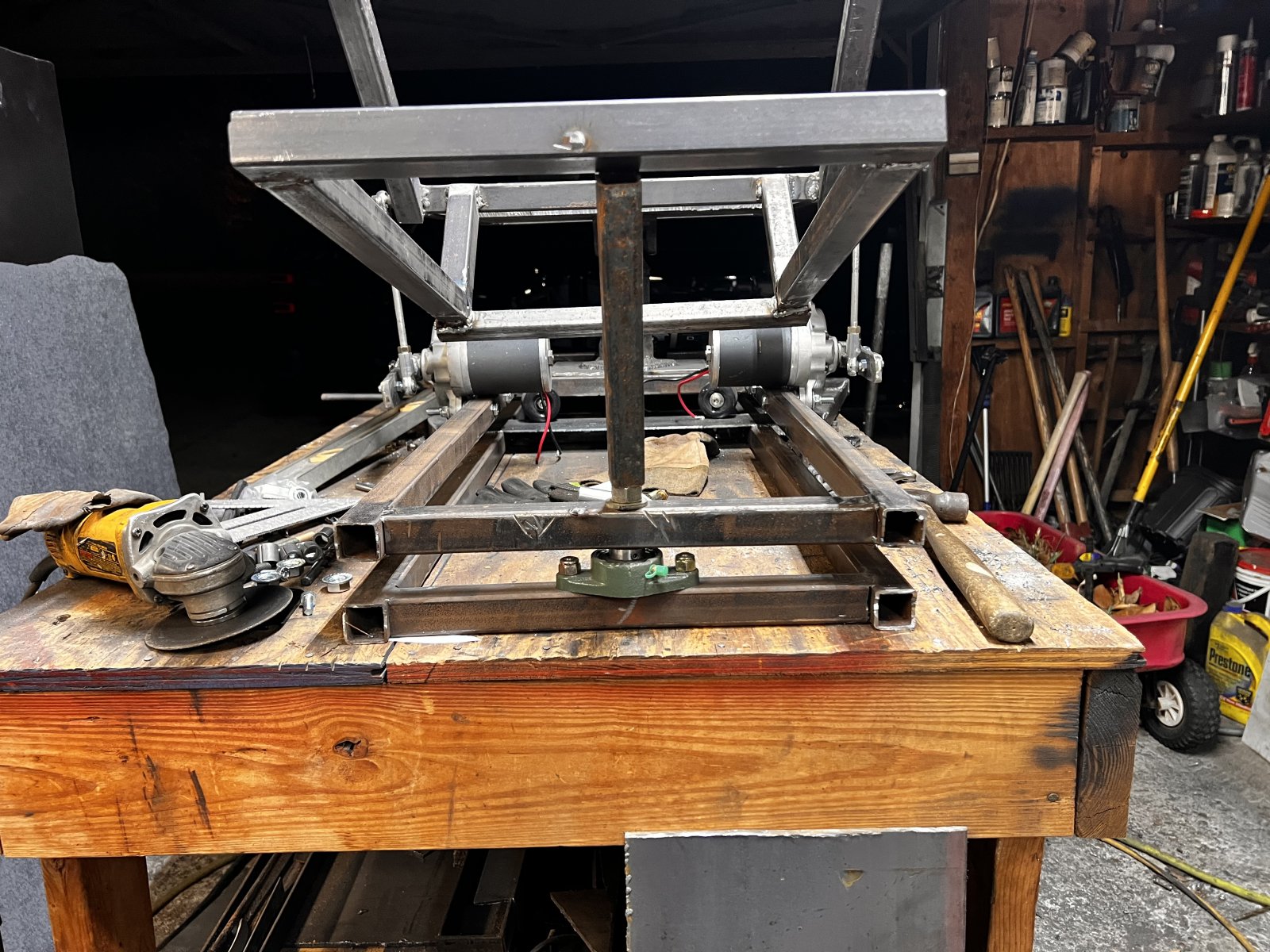

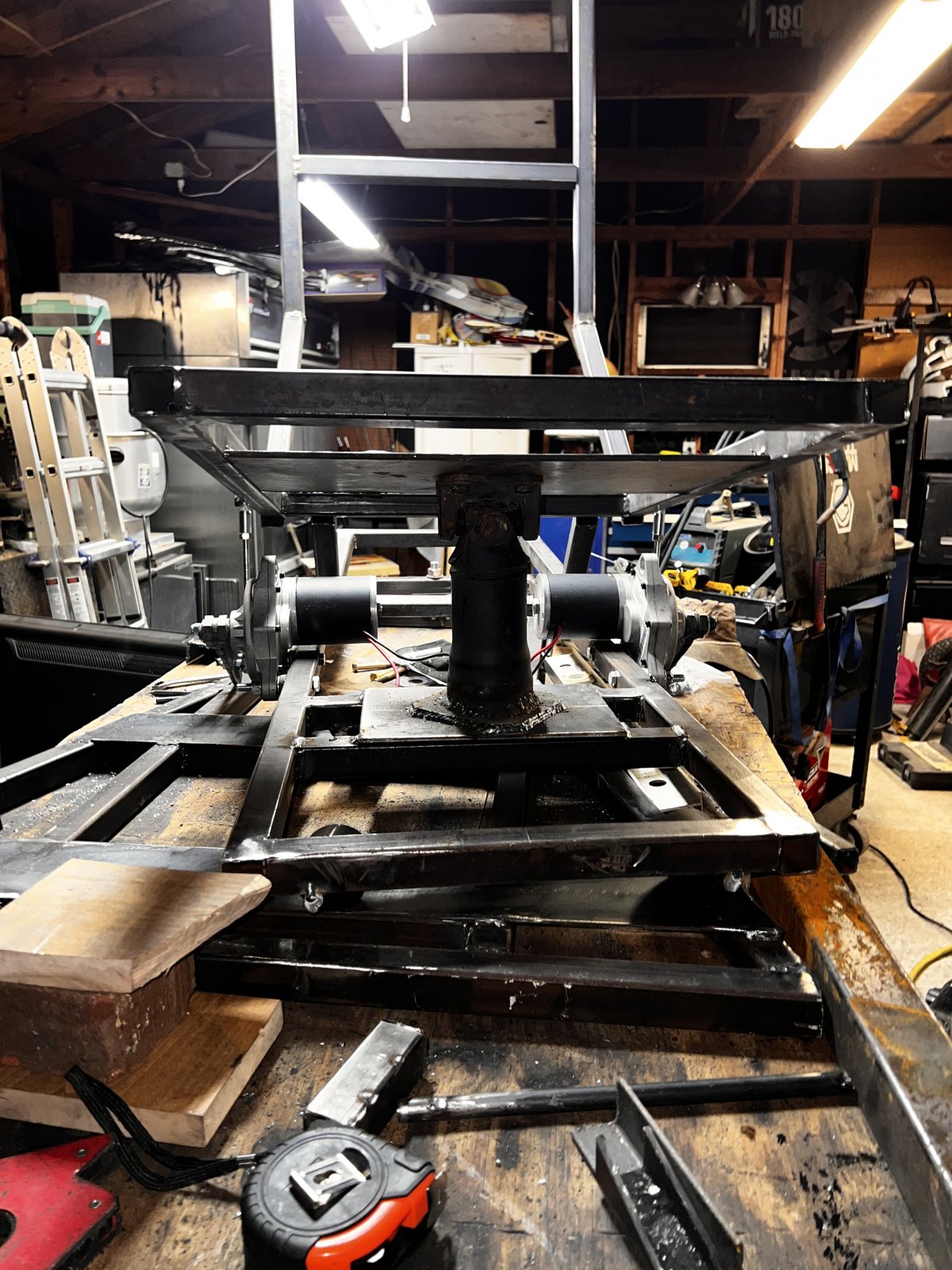

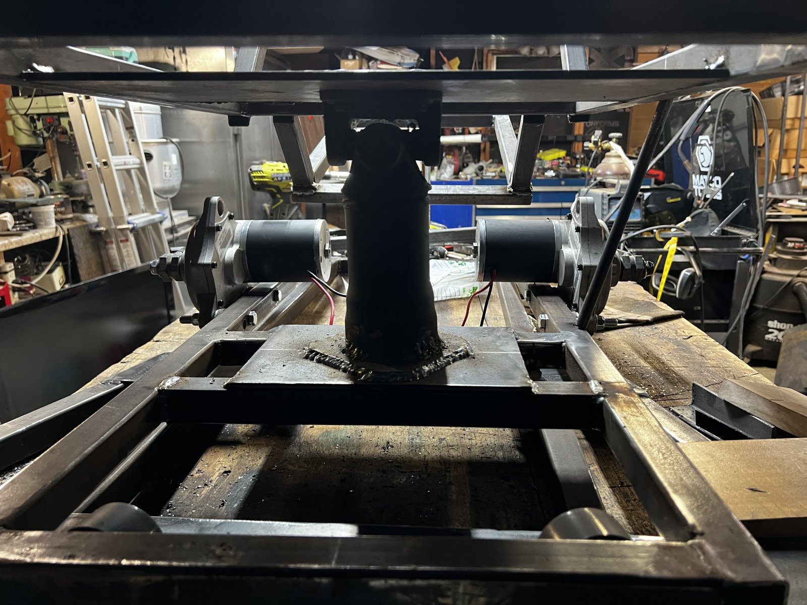

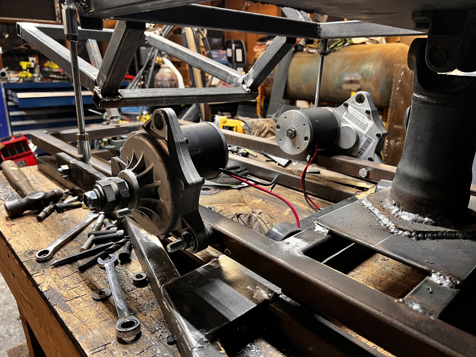

    It’s time to mount some motors!!! F7E4BFC2-4581-4DCF-A342-1FF595A0BEC9.jpeg 9C6D7865-74D2-4AD8-B9C4-B2FB1DA0D563.jpeg
  11. stanley johnson
    Sep 14, 2022
    117
    Diesel tech
    Nashville
    82Coins
    +40 / 0 / -0

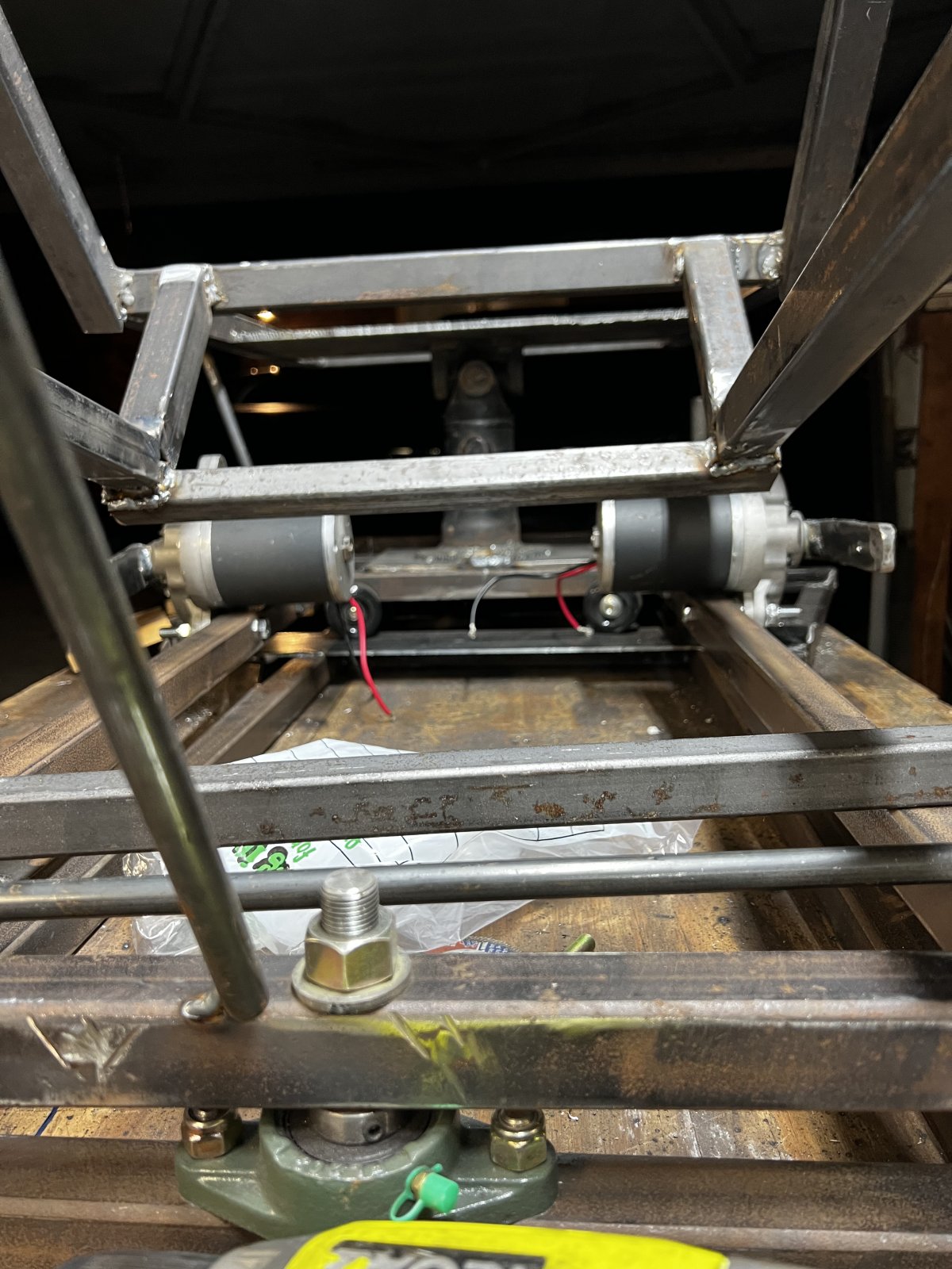

    Two motors mounted and one to go
  12. noorbeast
    21,634
    151,461Coins
    +11,038 / 56 / -2
    Nice progress :thumbs
    When do you plan hooking the motors up and conducting your first motion test?
  13. stanley johnson
    Sep 14, 2022
    117
    Diesel tech
    Nashville
    82Coins
    +40 / 0 / -0
    I will be hooking everything up this weekend, fingers crossed, lol

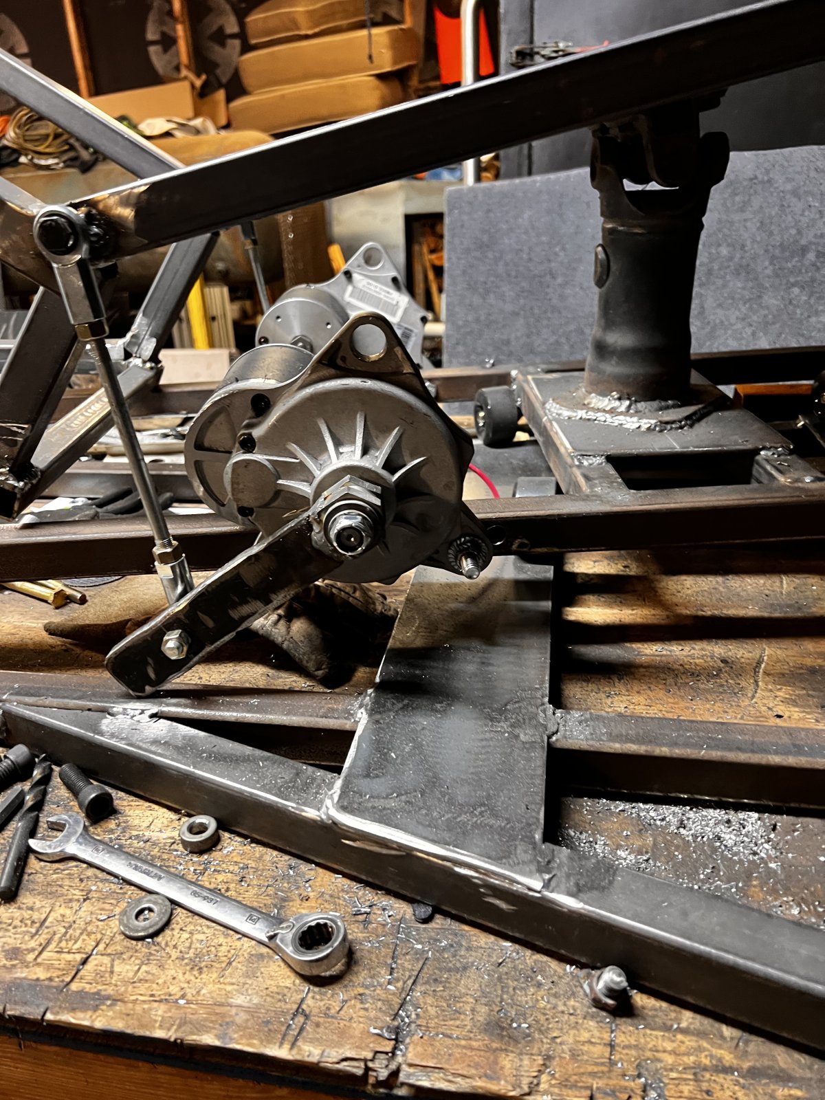

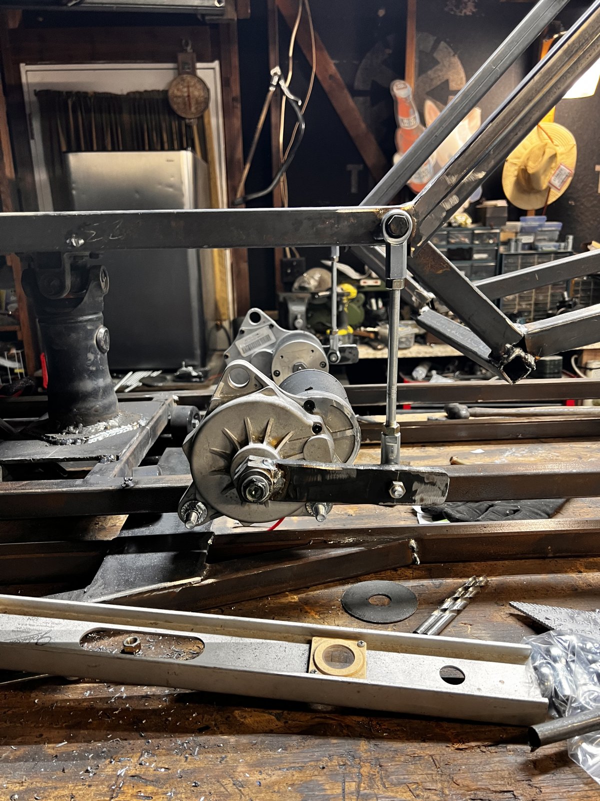

  14. stanley johnson
    Sep 14, 2022
    117
    Diesel tech
    Nashville
    82Coins
    +40 / 0 / -0

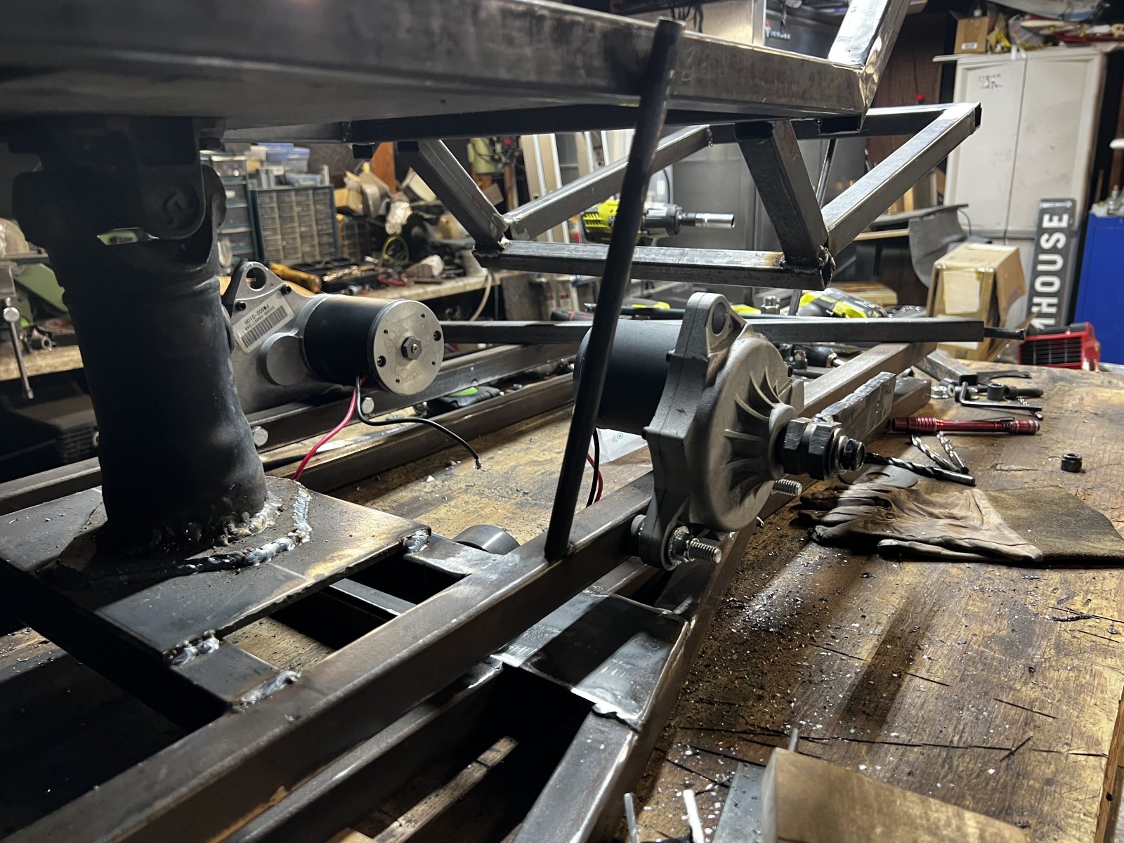

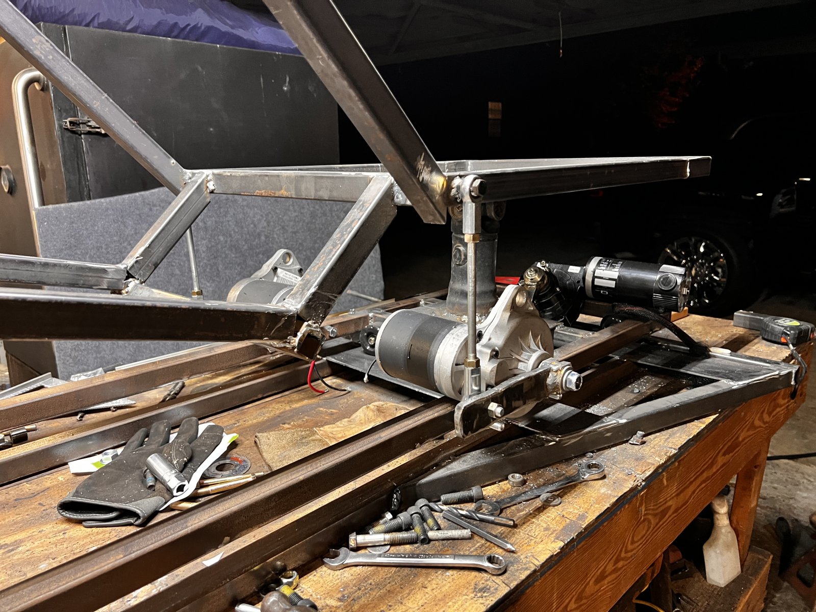

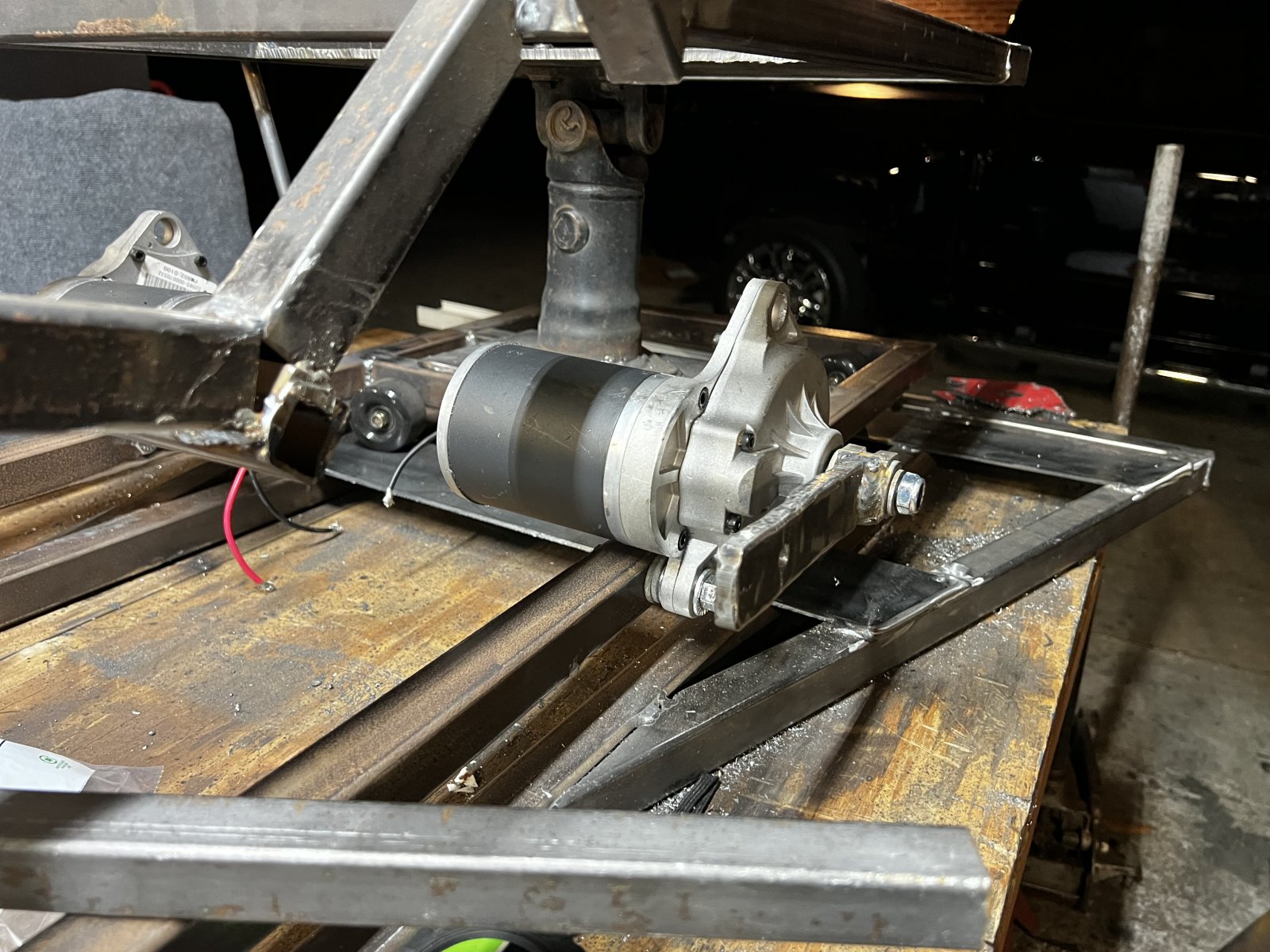

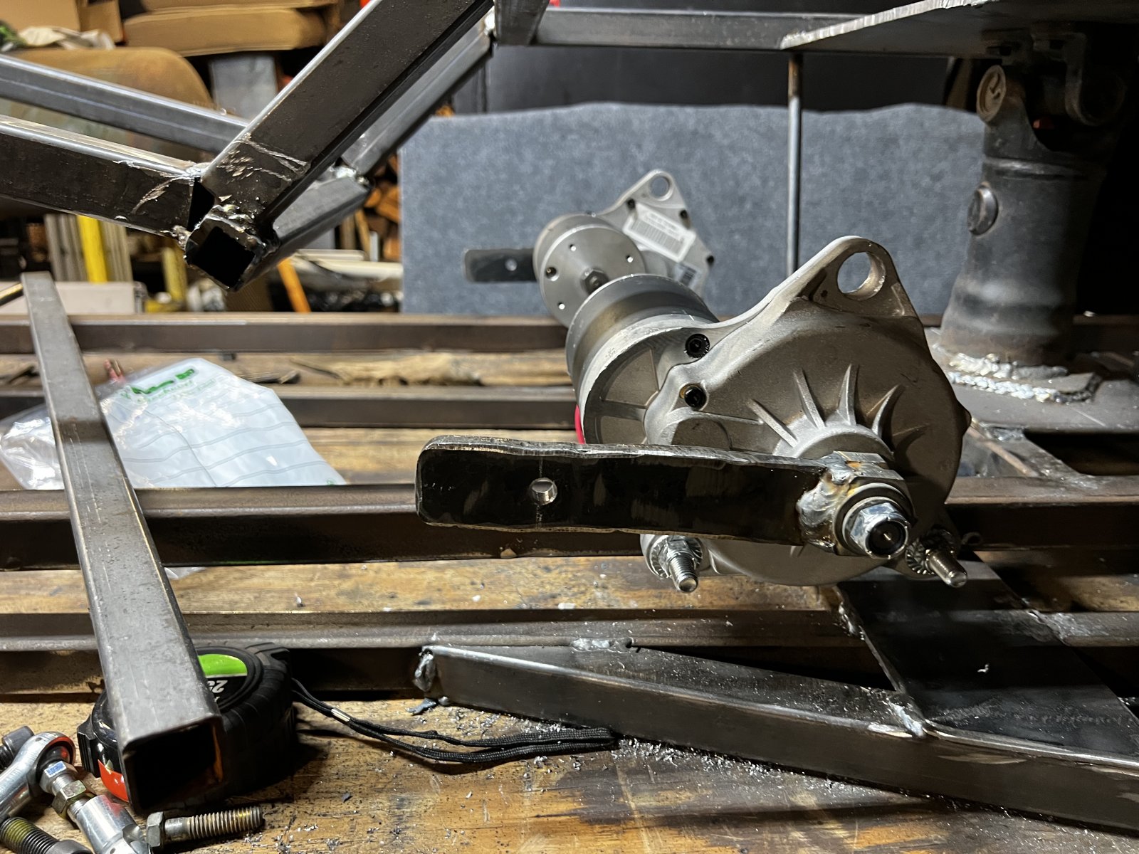

    Front motor linkage installed. F9B35A2C-239F-46CF-9135-4C39549EFE7B.jpeg 50BD7514-4833-443D-967E-E1E27307BDC6.jpeg 30877CEB-9576-4F94-BFDD-757EDECD0DD8.jpeg F9B35A2C-239F-46CF-9135-4C39549EFE7B.jpeg
  15. noorbeast
    21,634
    151,461Coins
    +11,038 / 56 / -2
    I am looking forward to seeing your initial test run, it is always a moment of trepidation followed by relief, if everything goes to plan.
    What is the CTC distance on the leavers, it looks pretty big for a full frame compact design?
  16. stanley johnson
    Sep 14, 2022
    117
    Diesel tech
    Nashville
    82Coins
    +40 / 0 / -0
    5 inches
  17. noorbeast
    21,634
    151,461Coins
    +11,038 / 56 / -2
    Testing will be interesting, my guess is that the lever CTC distance will possibly need to be reduced to about half of that.
    I use 60mm CTC on my compact rig.
  18. stanley johnson
    Sep 14, 2022
    117
    Diesel tech
    Nashville
    82Coins
    +40 / 0 / -0
    I was just guessing, if they are too long I will cut them back to 60mm. You thinking my throw will be too much?
  19. noorbeast
    21,634
    151,461Coins
    +11,038 / 56 / -2
    It is easy enough in the construction phase to add some CTC options, without compromising the strength of the lever too much, you don't need to cut the lever until you determine the ideal hole CTC for your rig.
    I would suggest you add a hole at 60mm, start with that in testing and see if it can be extended, which really comes down to the actual mass of the upper frame/peripherals/user, the power of the motor and the gear ratio used.
  20. stanley johnson
    Sep 14, 2022
    117
    Diesel tech
    Nashville
    82Coins
    +40 / 0 / -0
    So start at about 2.5 inches from center of shaft?
