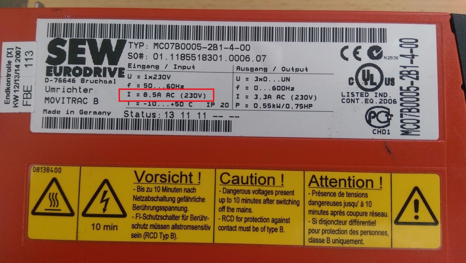

    Nice @misoswan :thumbs ... SEW Eurodrive Movitrac Type: MC07B005-2B1-4-00 and here is it's manual ... have you checked the input current for it ?

    just do not tell me I'm the wrong bought......
