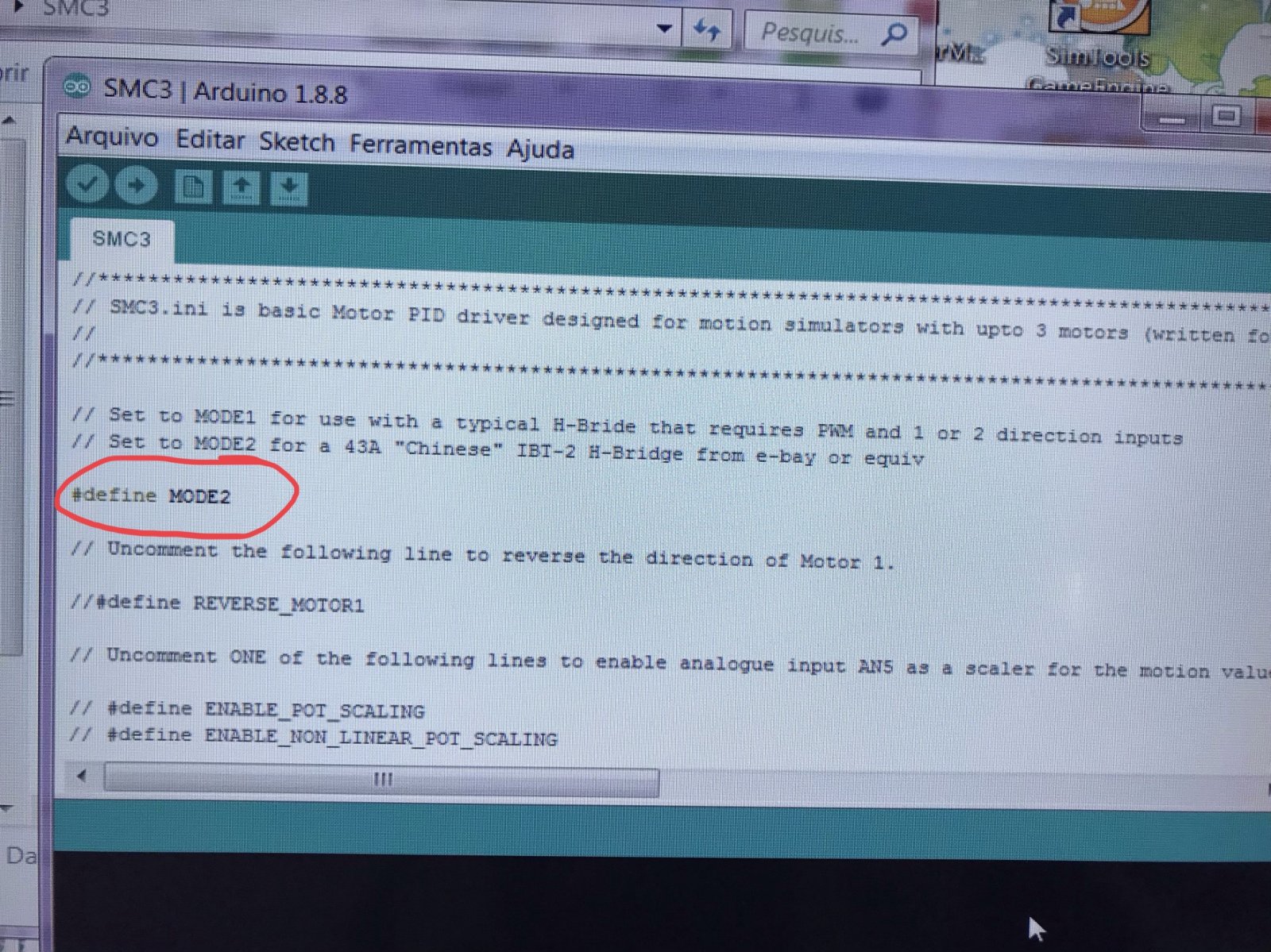

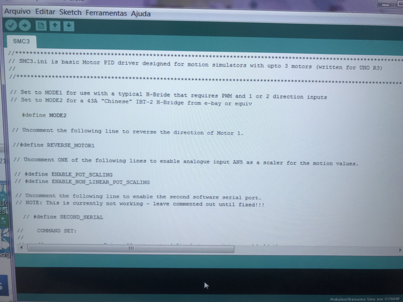

    It doesn't appear that you set smc3 to mode 2 in the sketch. It won't work with ibt-2 until you do.

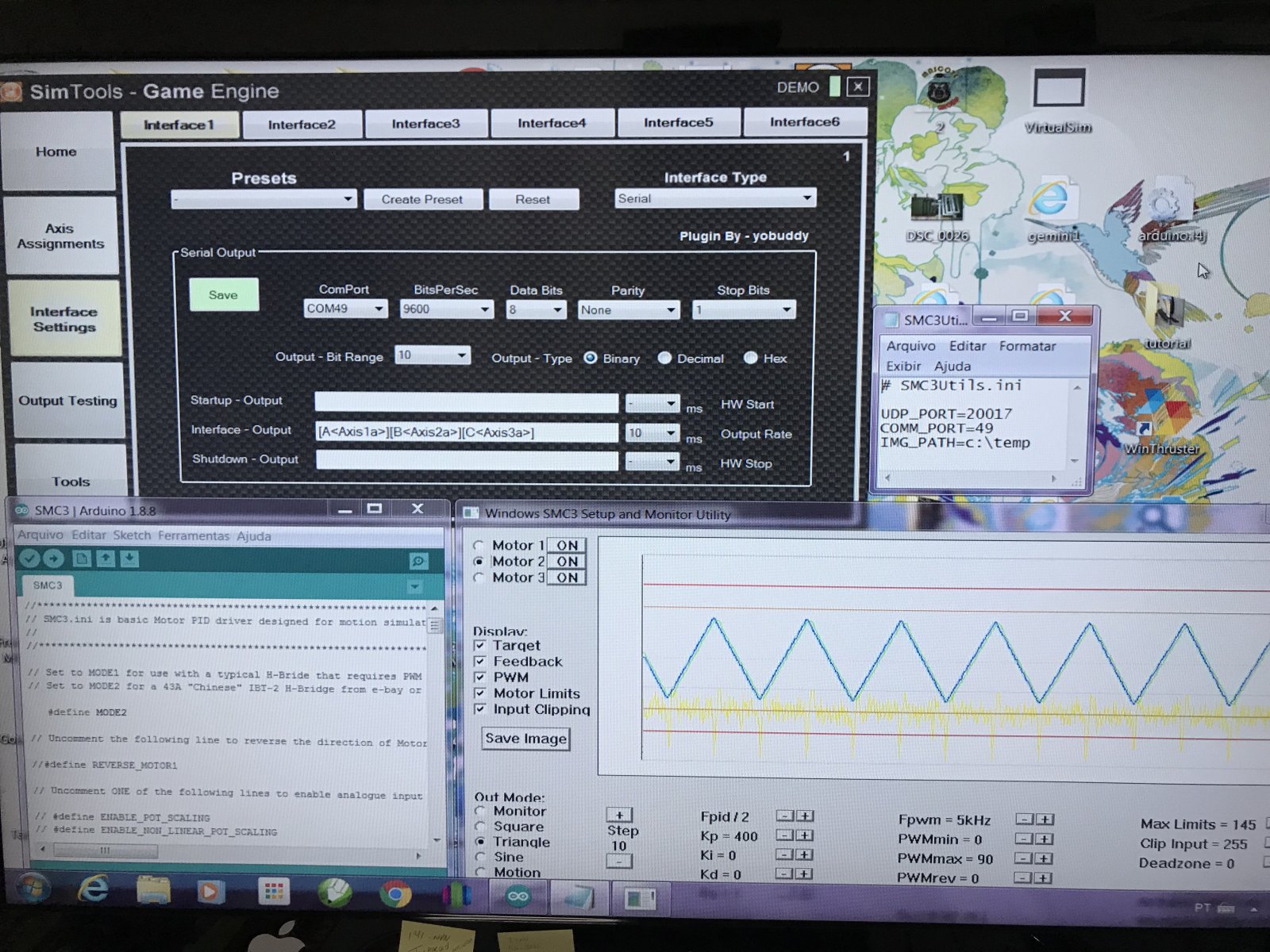

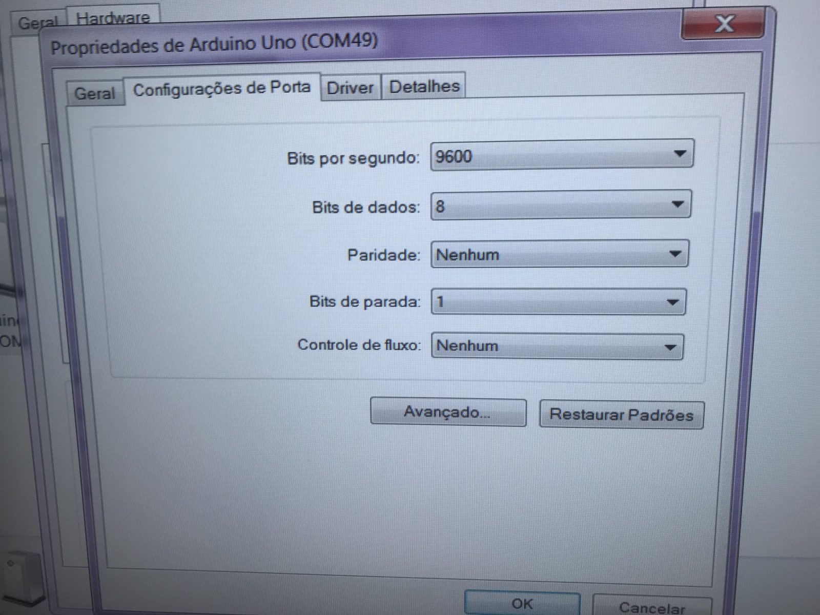

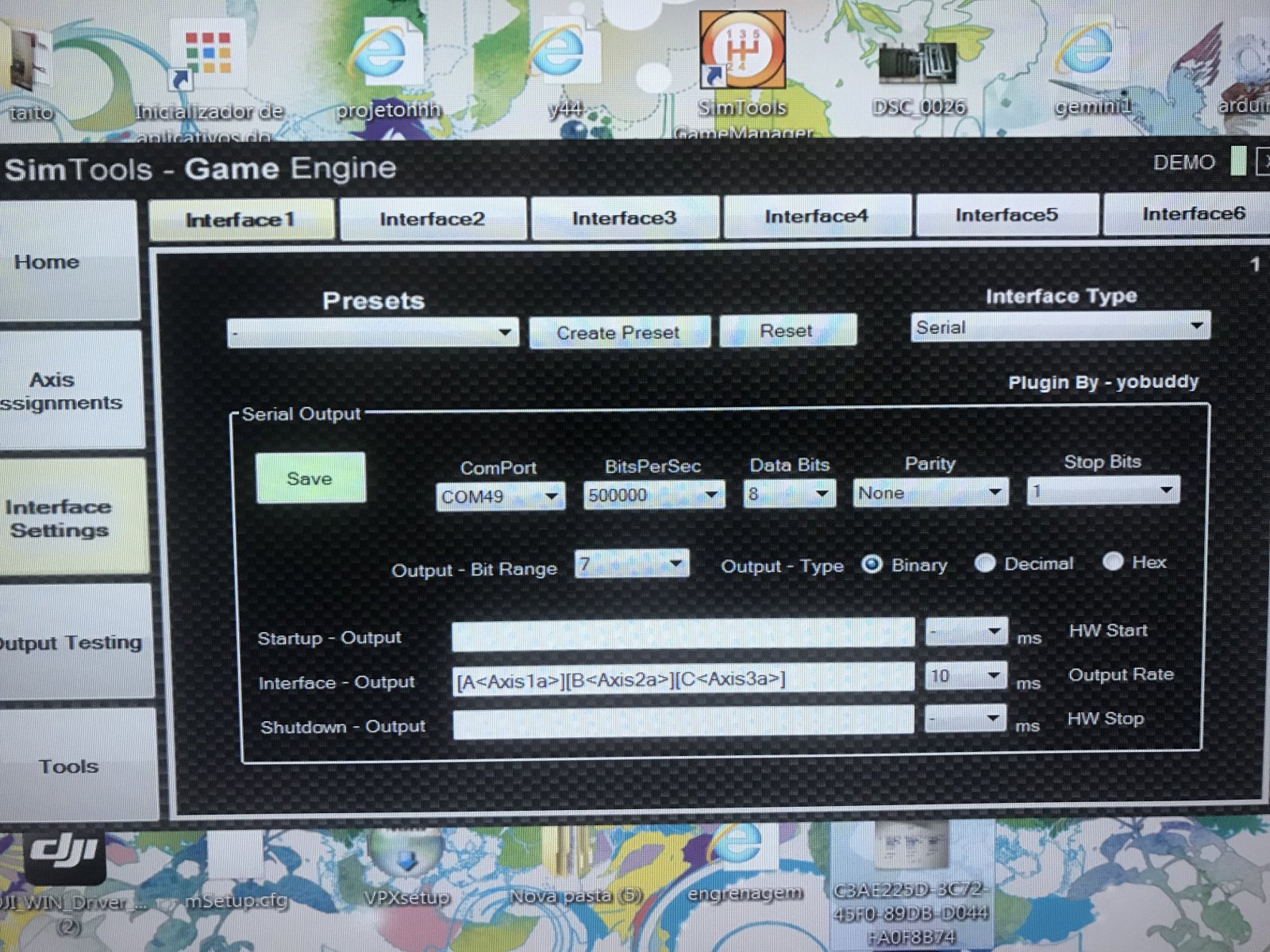

    You are using the wrong output settings for smc3.
    Setup for Simtools 2 is very straight forward:
    [A<Axis1a>][B<Axis2a>][C<Axis3a>]
    Set for 10bit binary output
    Baud rate 500000 , N , 8 , 1 (10ms delay)

    Really? :confused: Check your baud rate setting then look at my previous post again more carefully this time.

    Are you closing smc3 utilities before starting simtools? Two apps can't talk to an arduino on the same com port at the same time so the first one connected locks out the other.

    The video shows decimal output not binary.
    Please fix and try again.

    The Guru @yobuddy himself ;), honestly this issue has been discussed above and the solution has been posted by @BlazinH. IMHO we should advise our members reading the manuals at first before we are going gray o_O

    Look at my configuration
