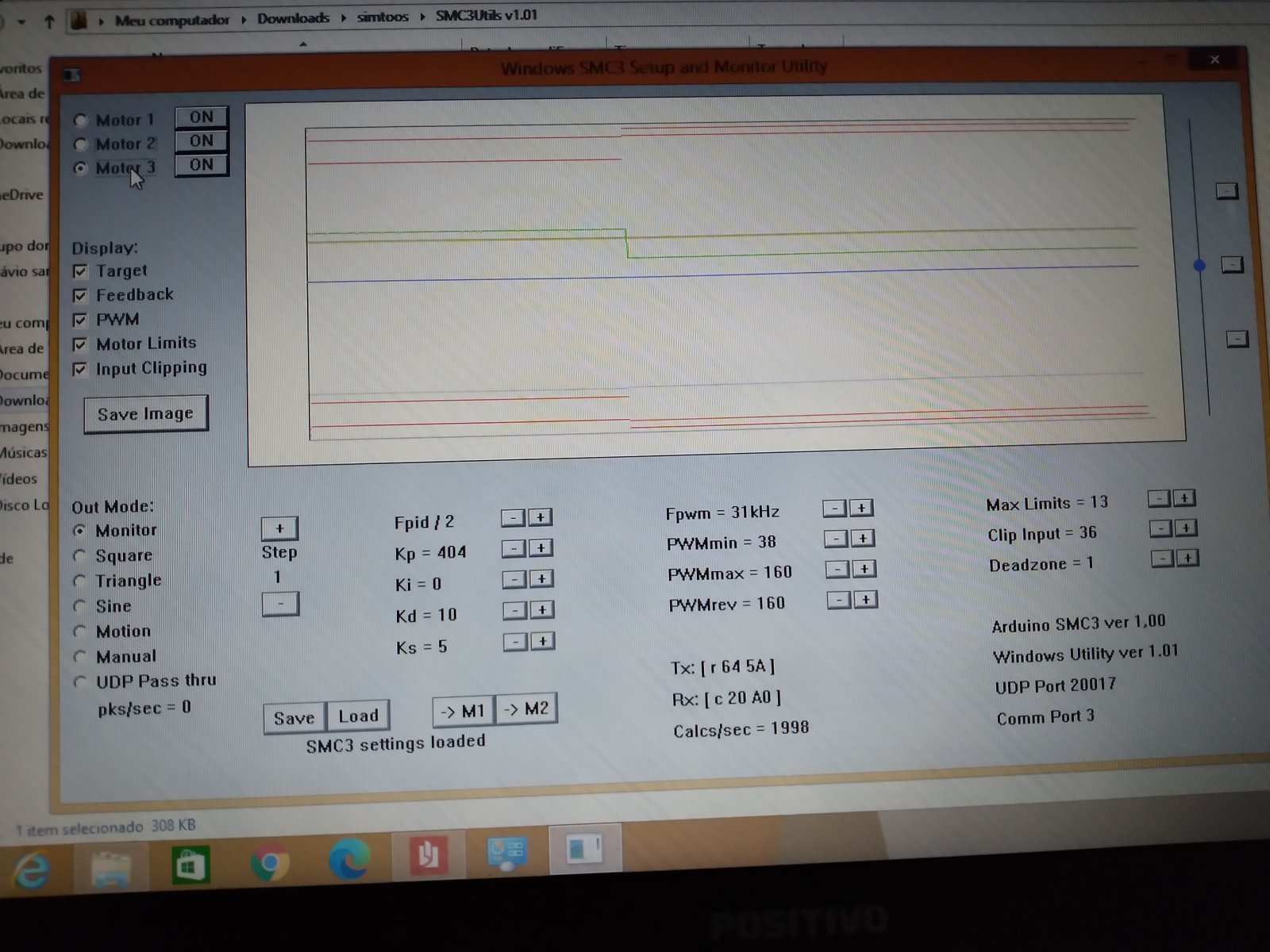

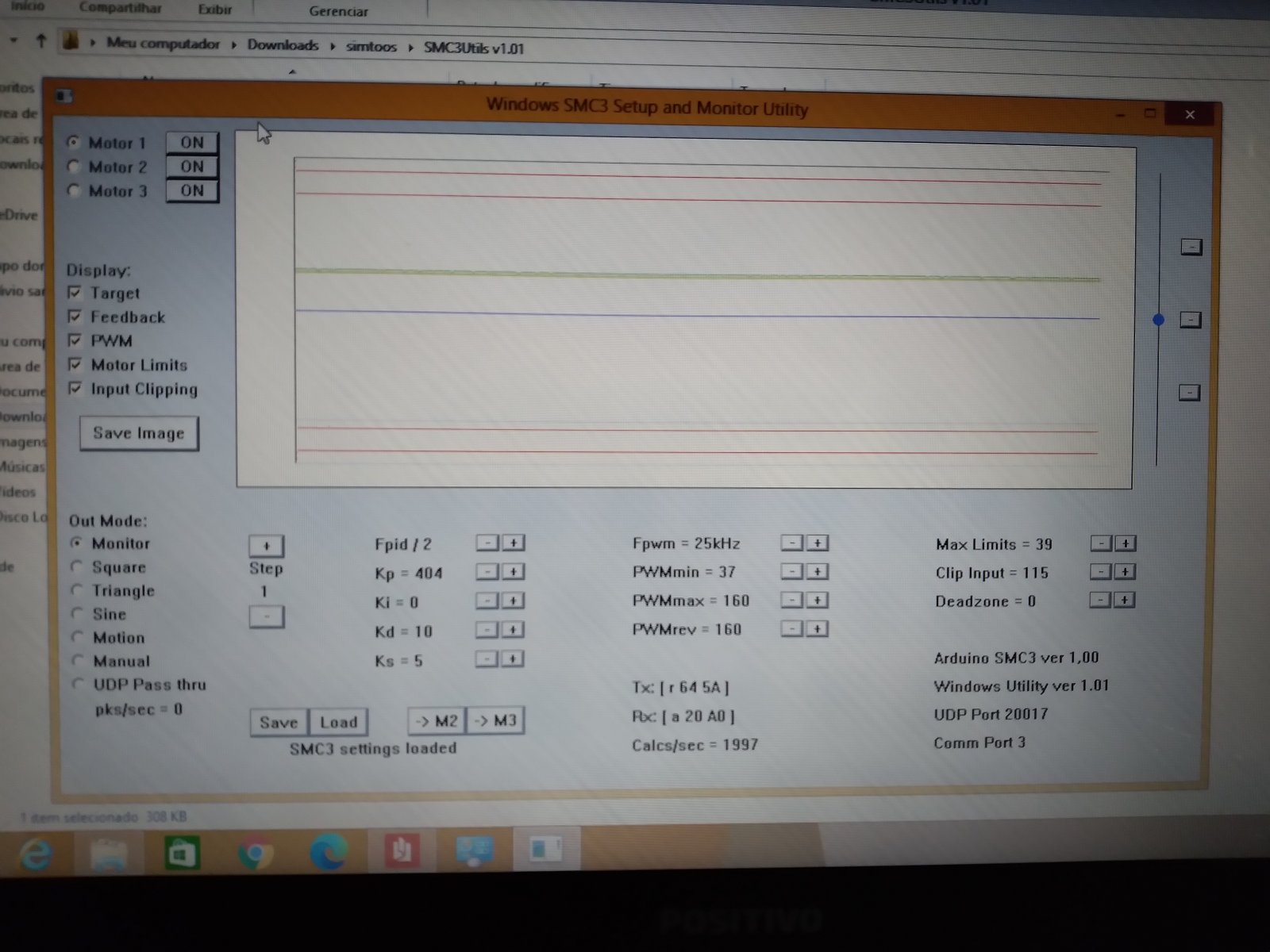

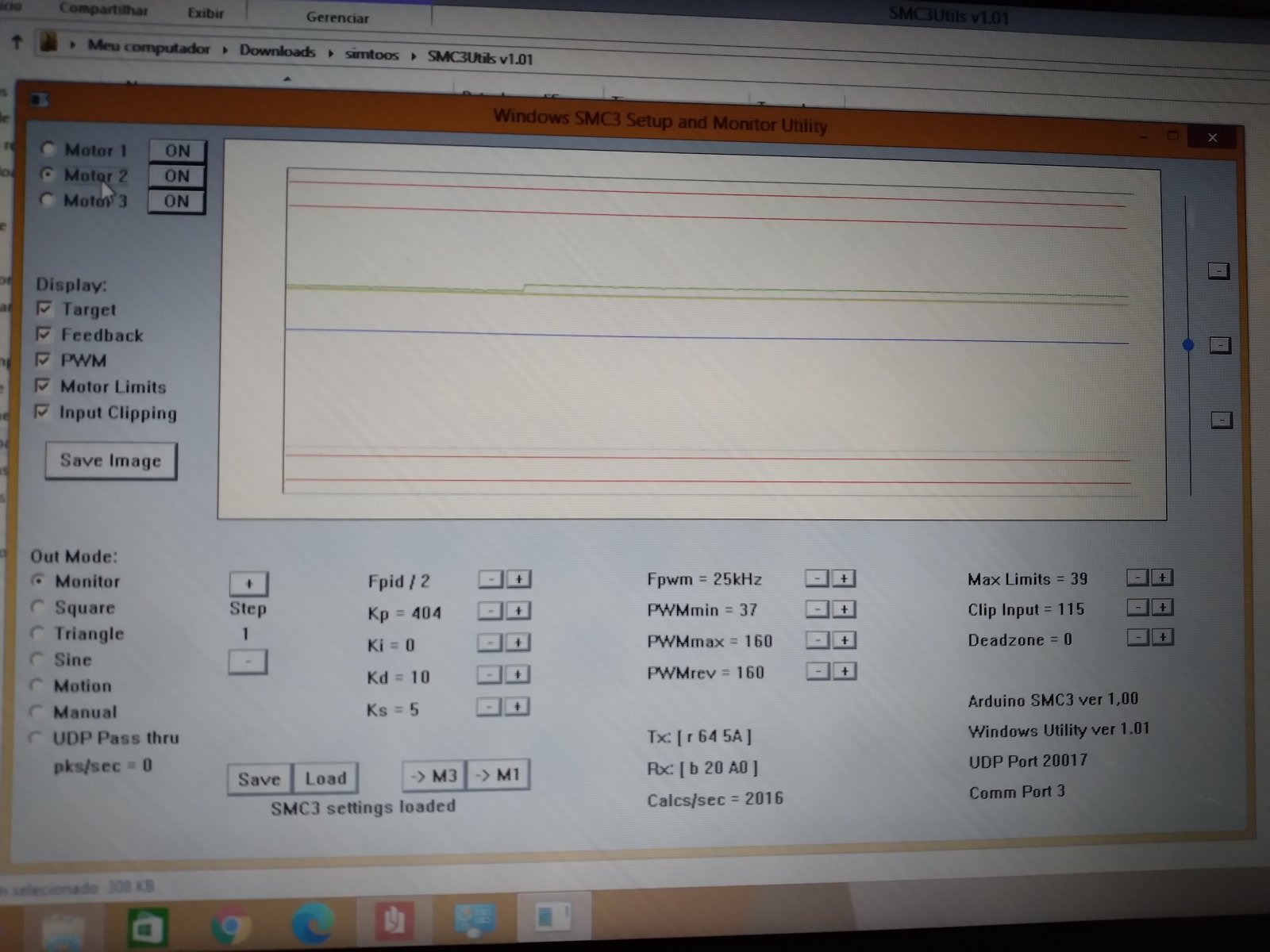

    good friends my smc3 does not turn on my engines, where in the smc3 you have the option of on/off of each engine, mine is only off, does not turn on, if the ibt2 is not powered, does the smc3 recognize it? I do not understand much more my problem and these any tips? remembering I'm using a 60amp car battery
  7. Saviosso
    Saviosso New Member
    Jun 7, 2021
    9
    102Coins
    when i started my engines for the first time without configuring smc3, smc3 was with its downloads configuration, accidentally the power was on in ibt2 my engine will run a little after it stopped and it didn't work anymore even after having configured smc3, it would be possible my ibt2 have burnt out from excess current i am using a 60 amp car battery for testing and electric glass motors

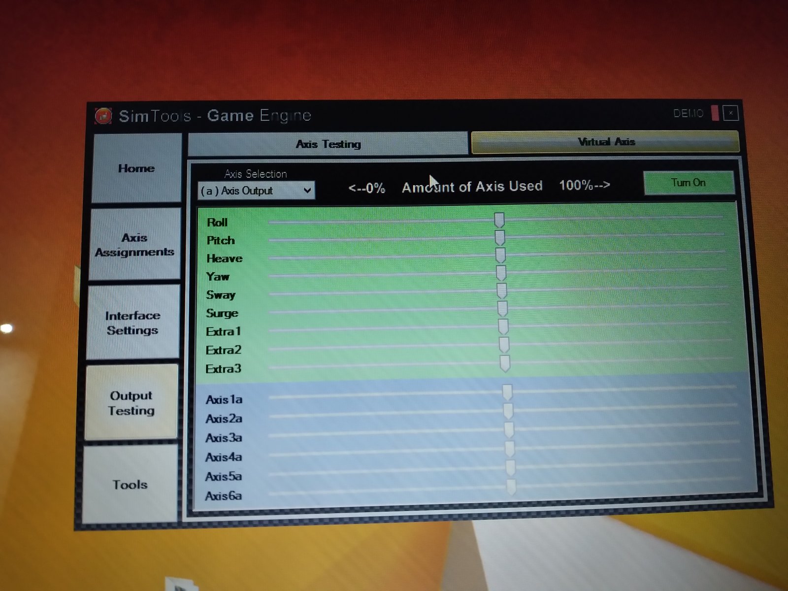

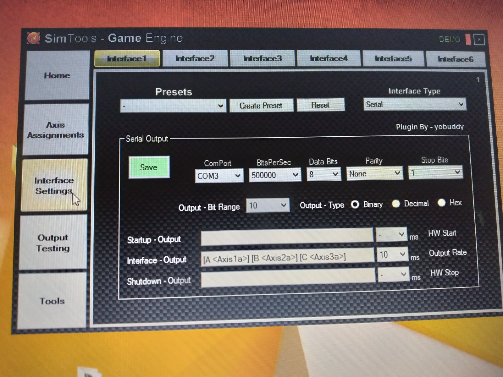

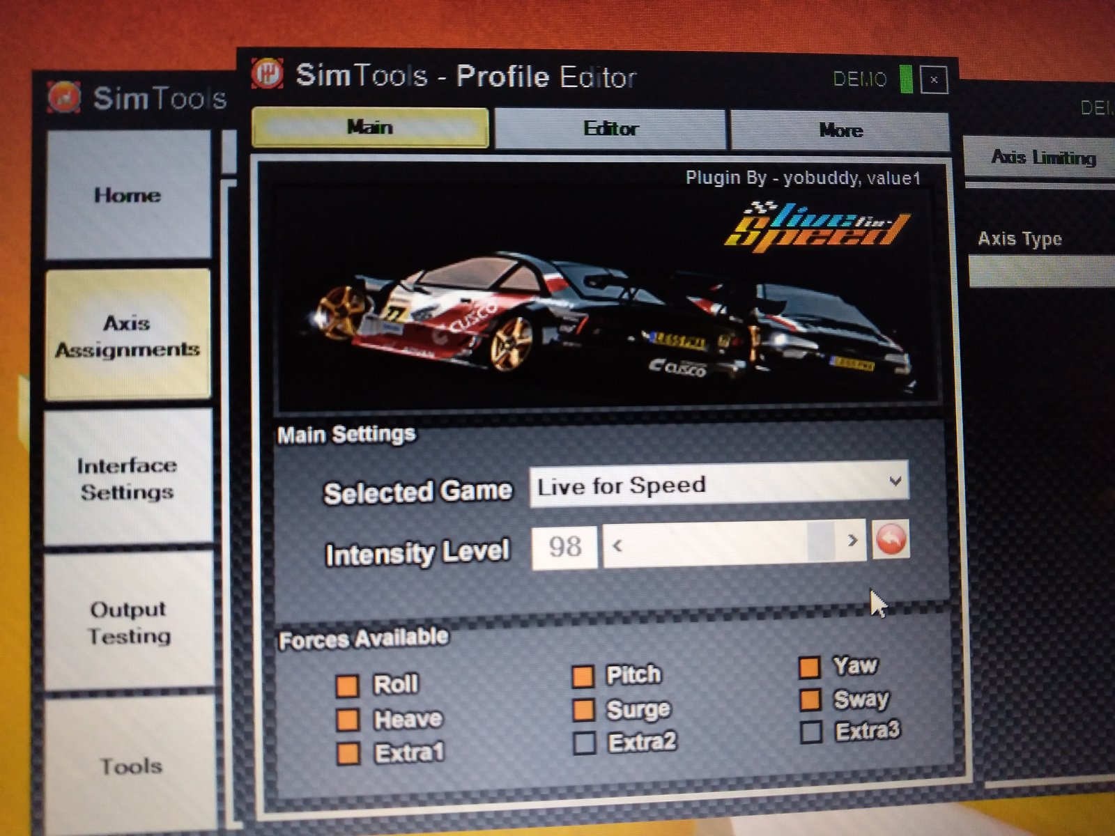

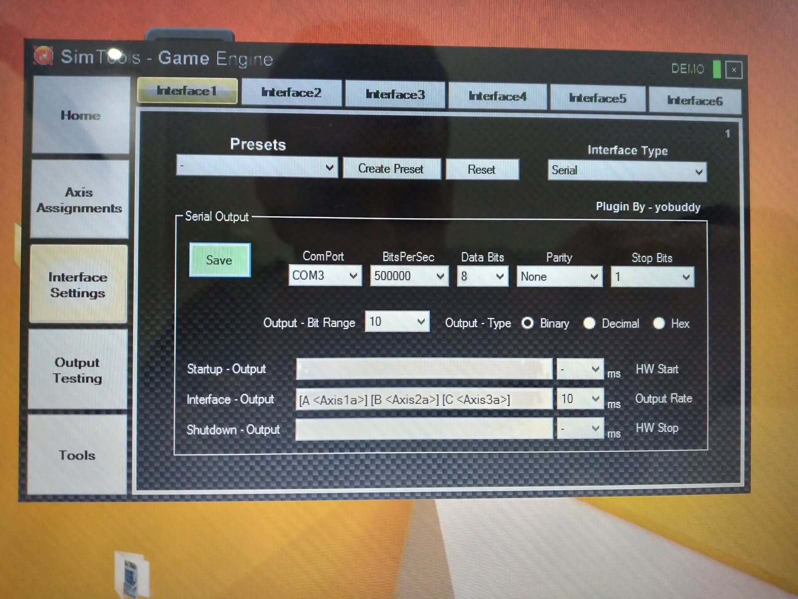

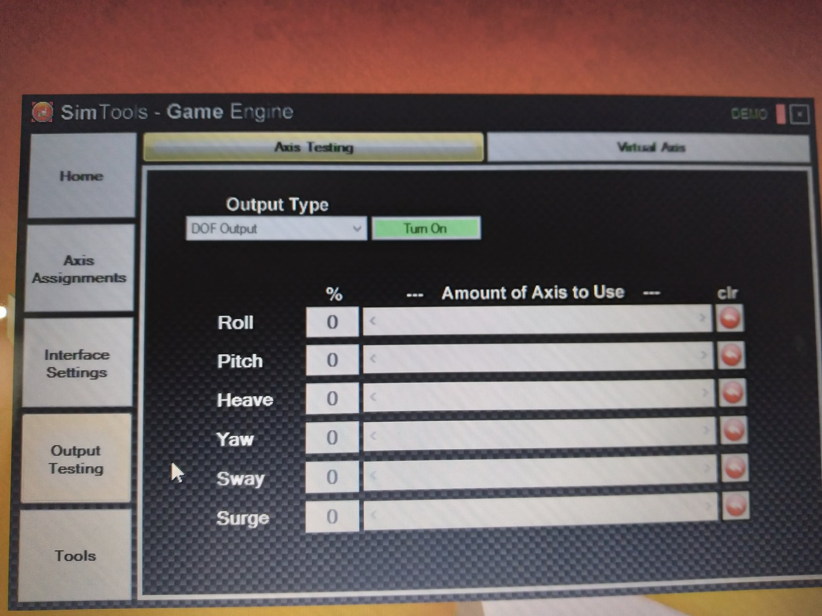

  9. Saviosso
    Saviosso New Member
    Jun 7, 2021
    9
    102Coins

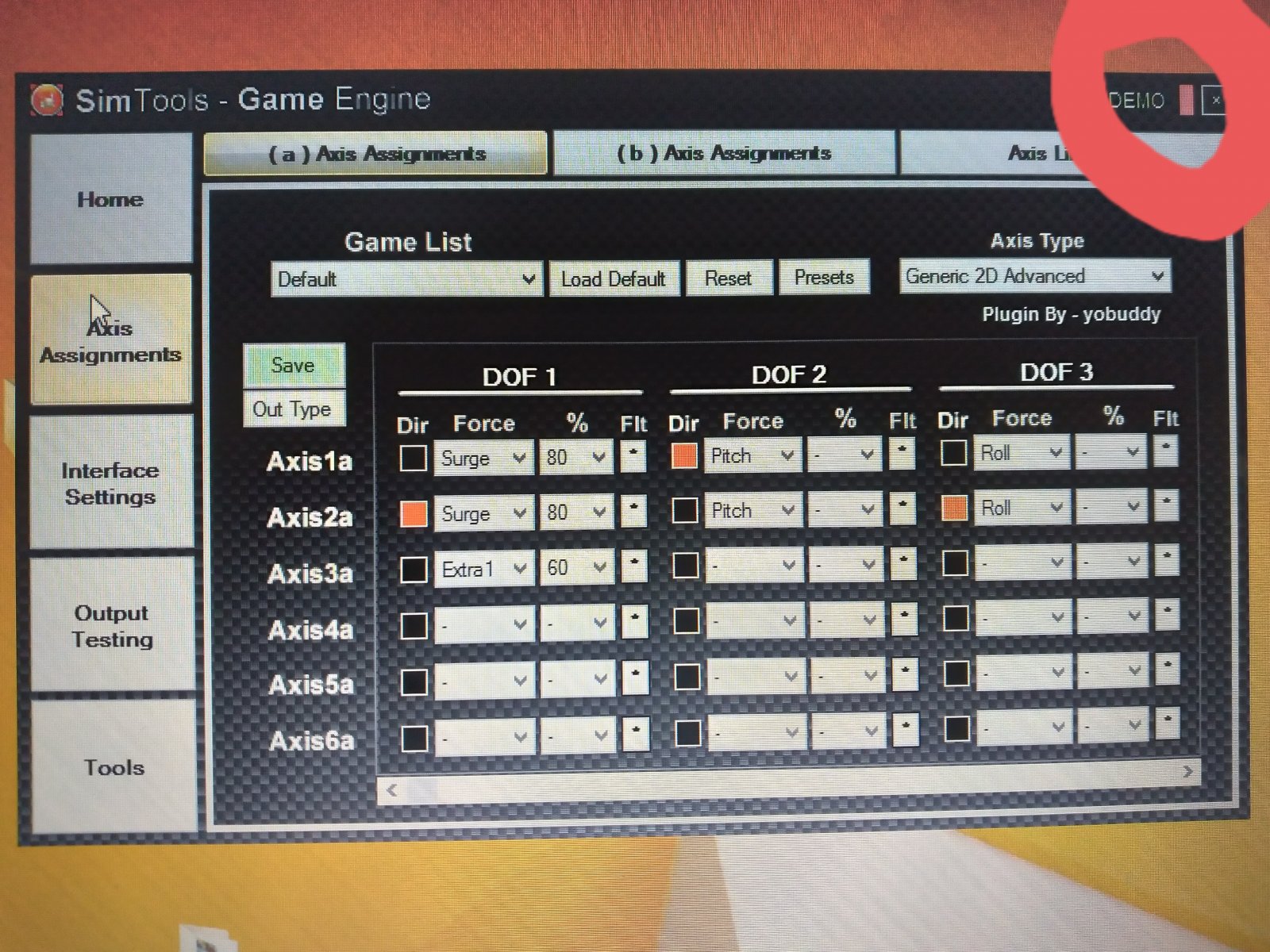

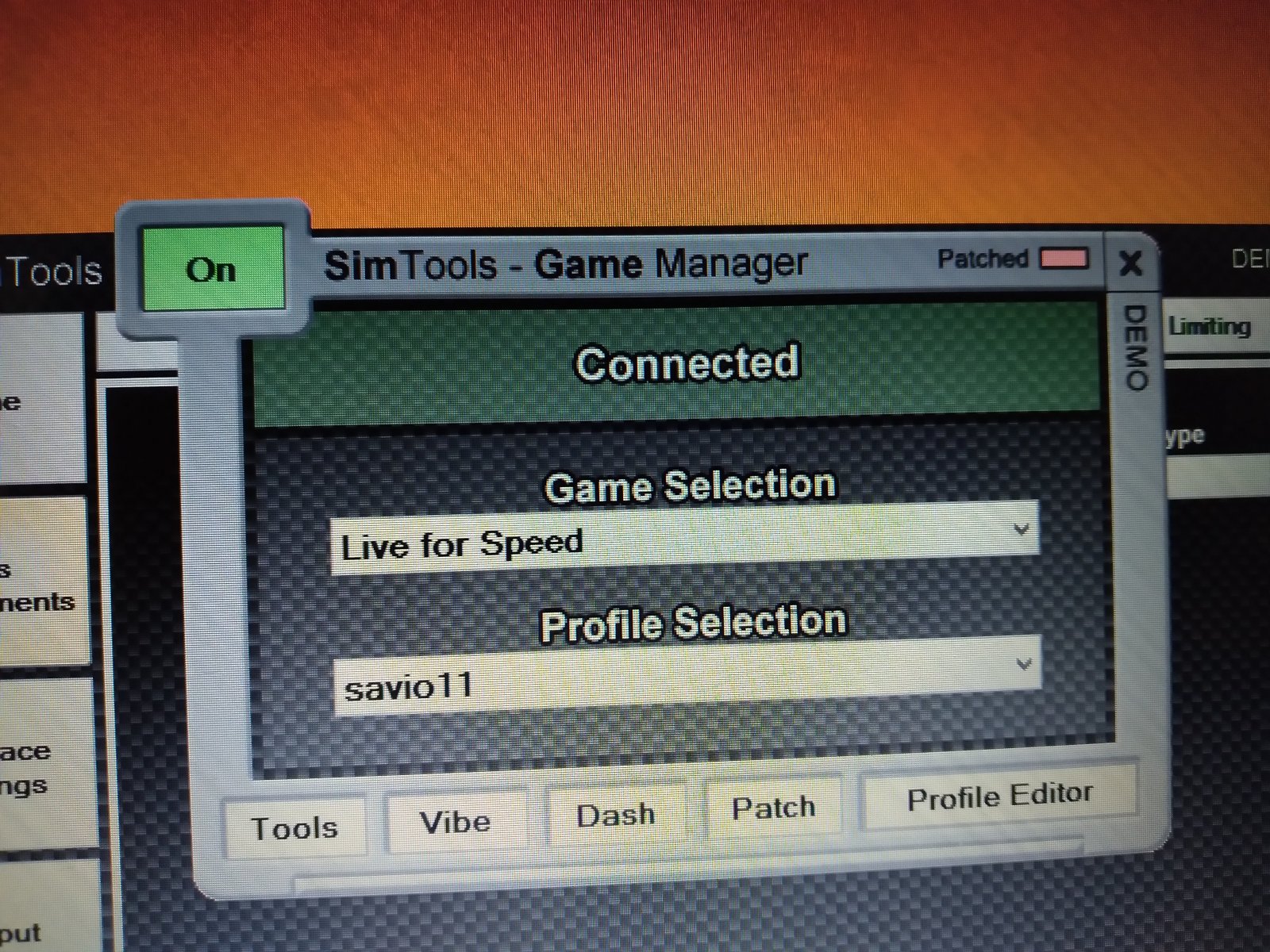

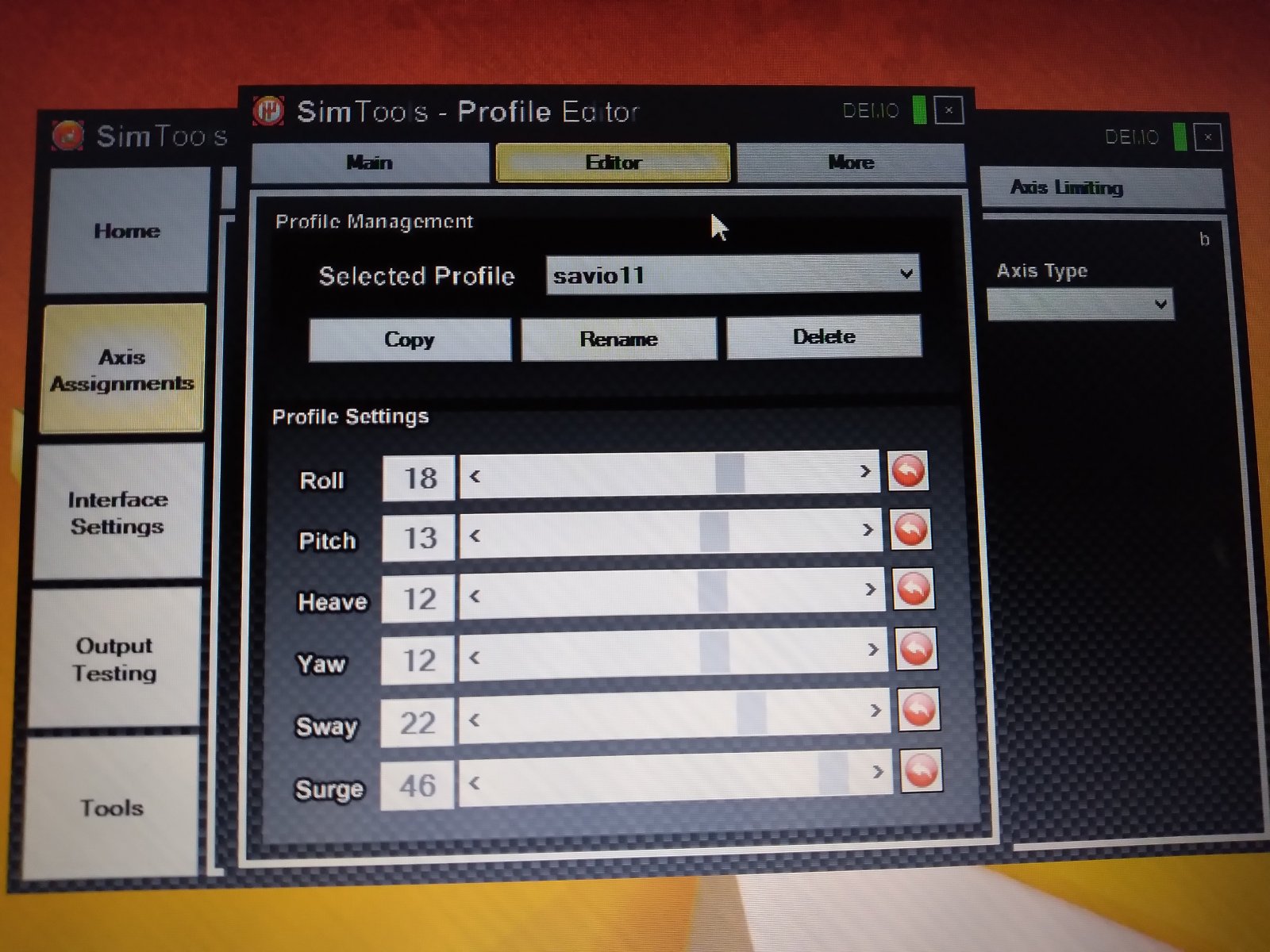

    Look at my settings, today when I opened the GameManager a black screen quickly appeared and I could only read something, but then the demo turned green I'm going to mark the photo thanks 20210707_064355.jpg 20210707_064453.jpg 20210707_064508.jpg 20210707_064517.jpg 20210707_064617.jpg 20210707_064627.jpg 20210707_064640.jpg 20210707_064806.jpg 20210707_064829.jpg 20210707_064846.jpg 20210706_223341.jpg
    22,183
    154,738Coins
    +11,195 / 57 / -2
    I am not sure how you got the settings you have, but for now make sure SimTools is shut down, as you don't mess with it until SMC3 works as expected, do follow the steps in the SMC3 instructions: https://www.xsimulator.net/communit...3dof-motor-driver-and-windows-utilities.4957/
    Initial Setup
    I strongly recommend you follow the steps below if this is the first time you are using SMC3 with your simulator to reduce the risk of damaging anything.
    8. Set Kp to about 400
    10. Do the above for each motor
  11. Saviosso
    Saviosso New Member
    Jun 7, 2021
    9
    102Coins
    good my friend the smc3 is already working all right, what's the next step?
  12. noorbeast
    22,183
    154,738Coins
    +11,195 / 57 / -2
    Once SMC3 is working as expected you can close it and open SimTools.
    First grab copy of the SimTools manual and keep it handy for reference: https://www.xsimulator.net/community/faq/rtfm-start-with-the-official-simtools-documentation.117/
    You first configure the Default profile in Axis Assignment: https://www.xsimulator.net/community/faq/output-testing-default-profile-required.344/
    Use Output Testing to check the rig is configured to move as SimTools expects: https://www.xsimulator.net/community/faq/which-way-to-set-simtool-axis-movements.230/
    If testing with LFS you must run a race in first person mode before patching it for motion: https://www.xsimulator.net/communit...run-in-first-person-mode-before-patching.365/
    Then see the tips here for refining a motion profile: https://www.xsimulator.net/community/faq/steps-to-create-a-motion-profile.228/
