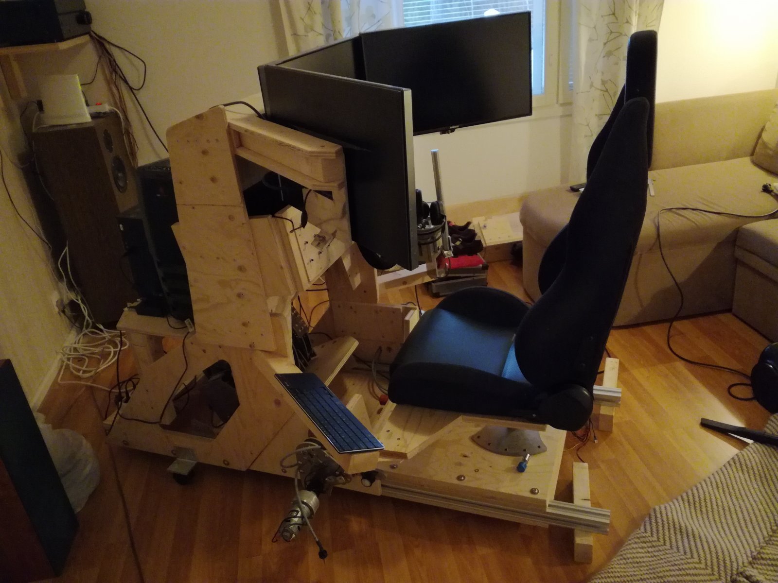

    IMG_20170130_154858.jpg Have to install the software and start testing the fuctionality...

    i am eager to see a video of your sim in action and read your feel about it ! nice work :thumbs

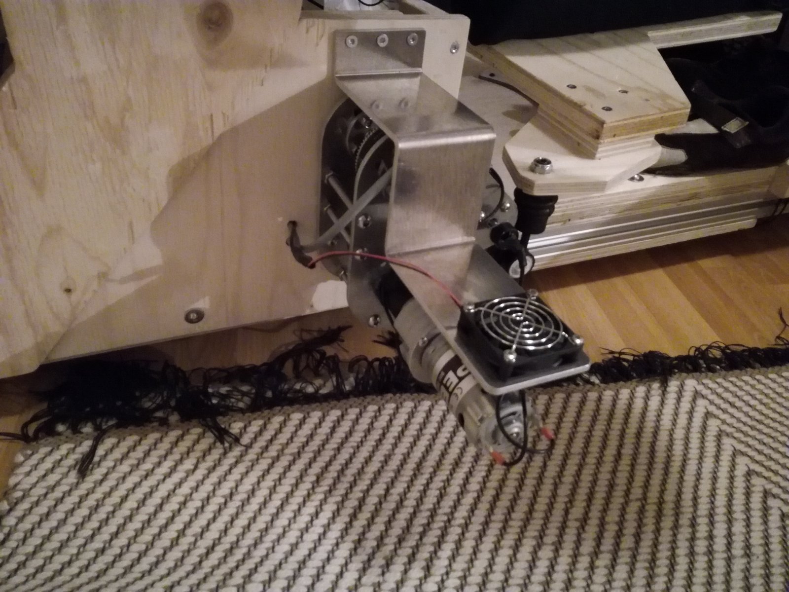

    IMG_20170316_201536.jpg Had to install fans to cool the motors. I also changed to SMC3 for better motor controll.
