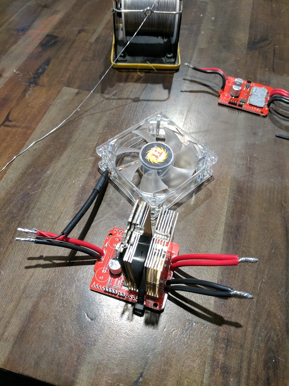

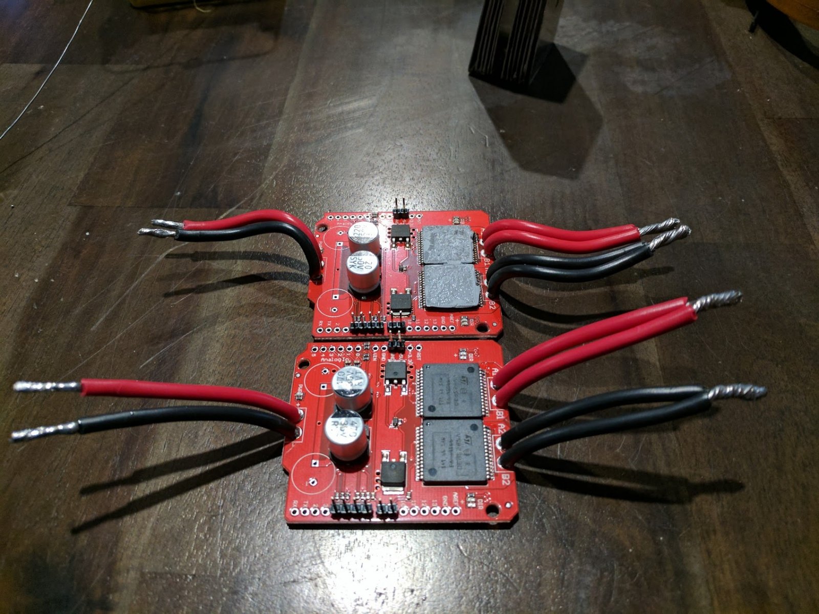

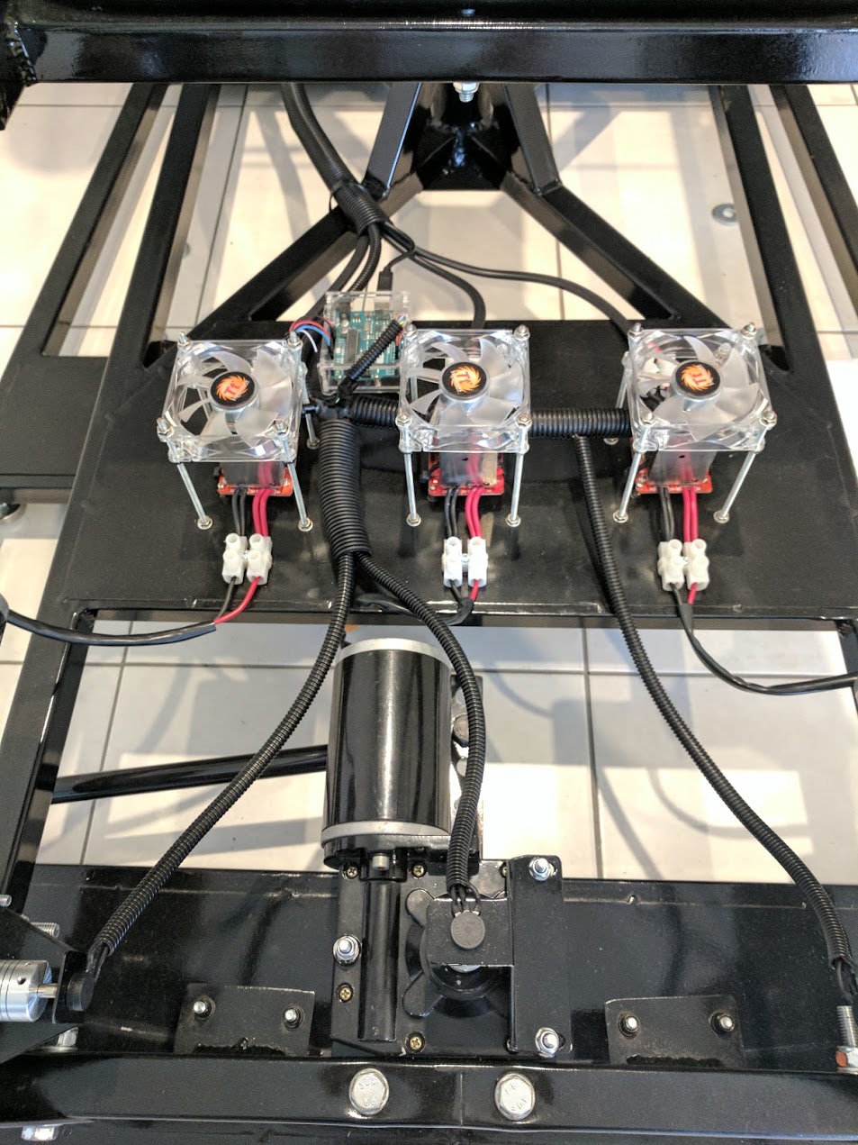

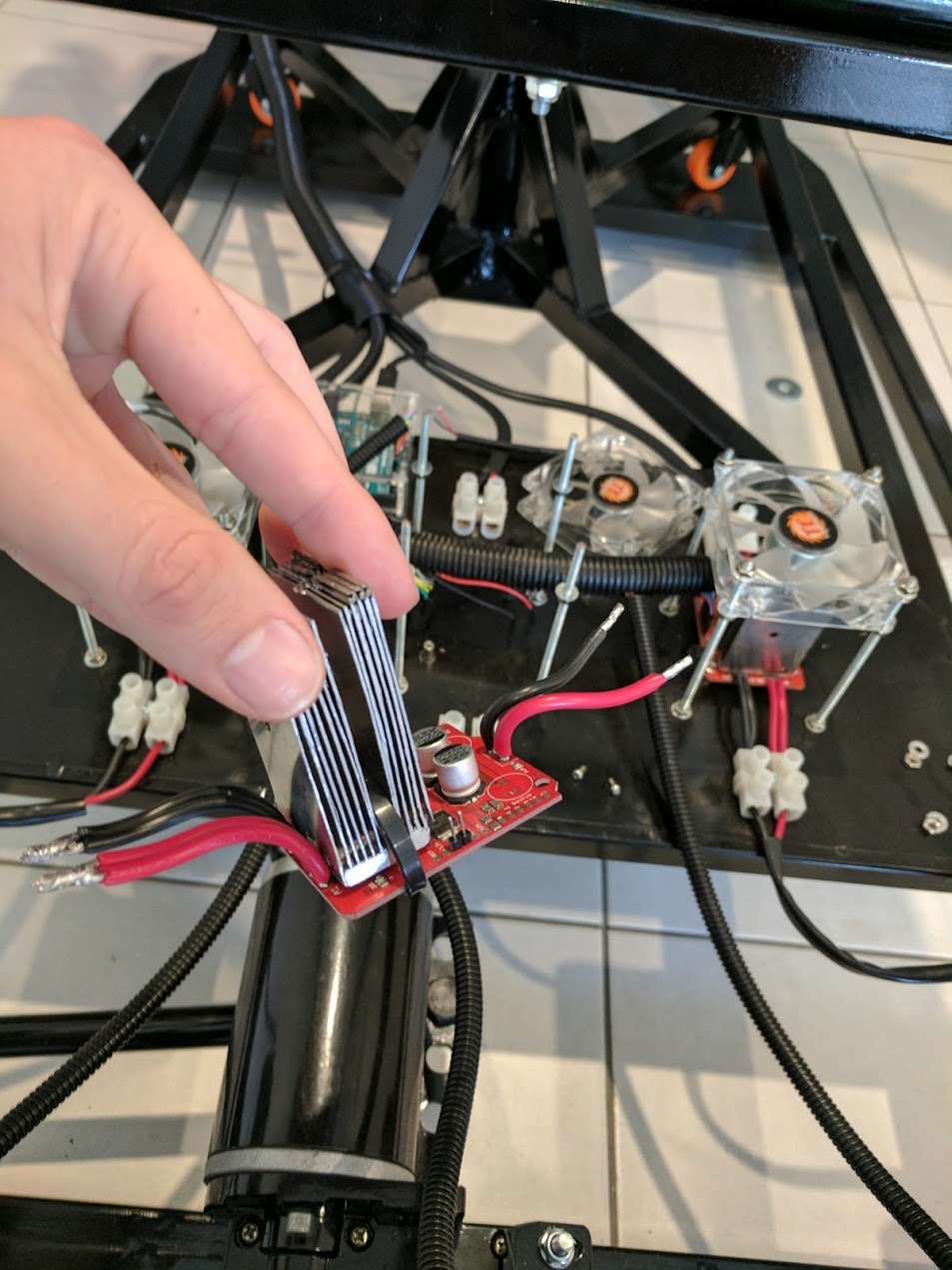

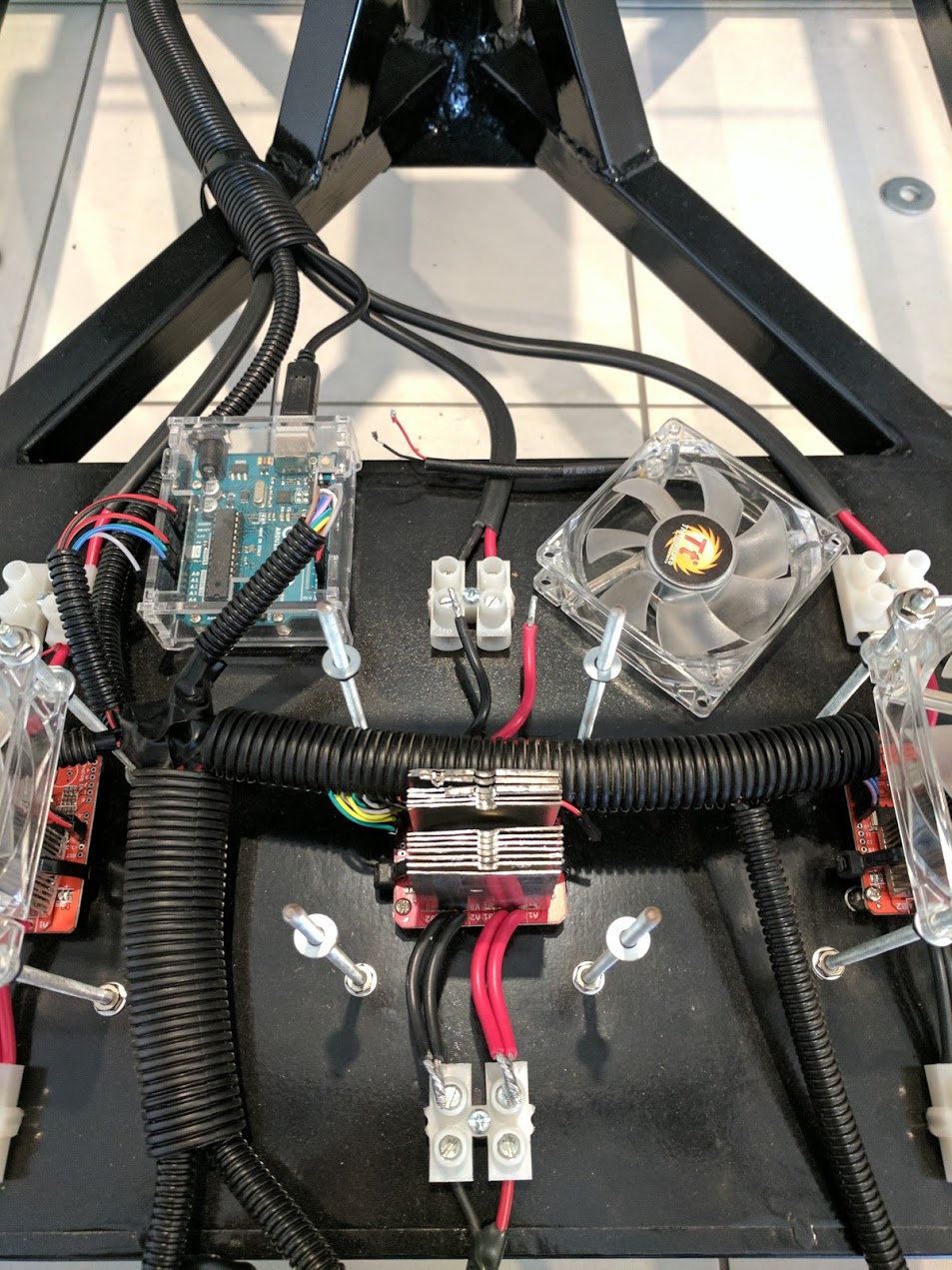

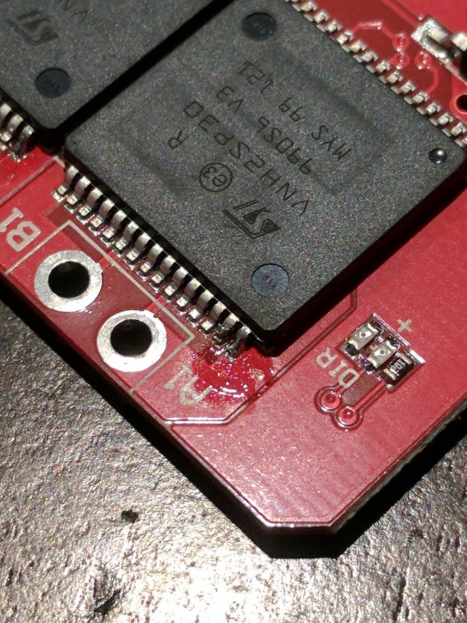

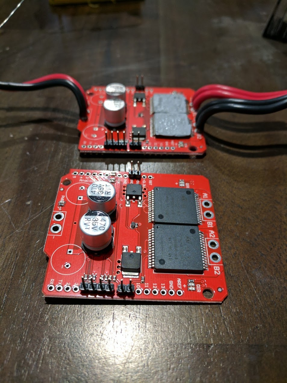

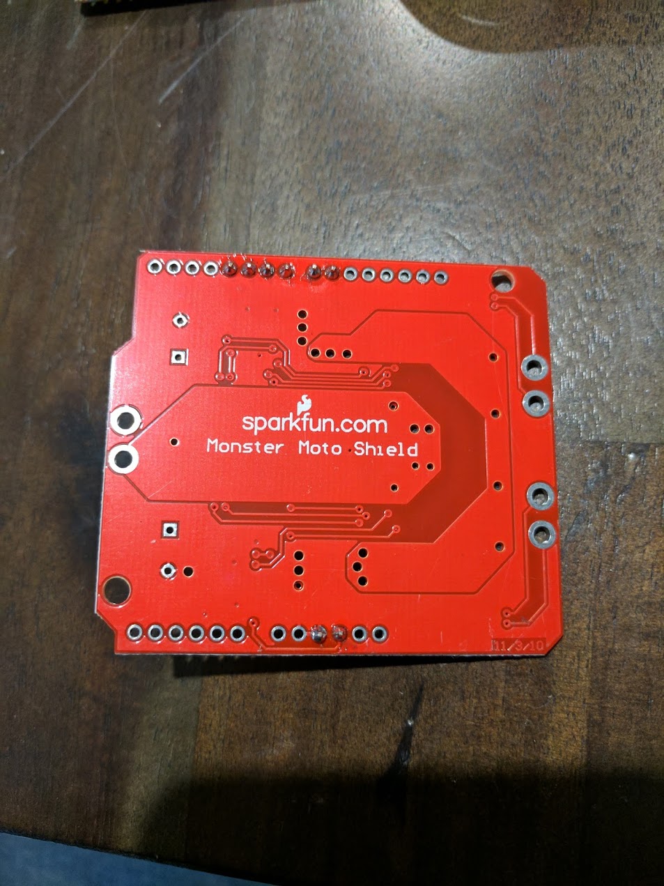

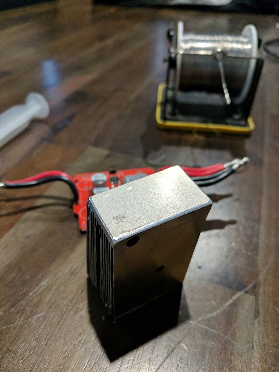

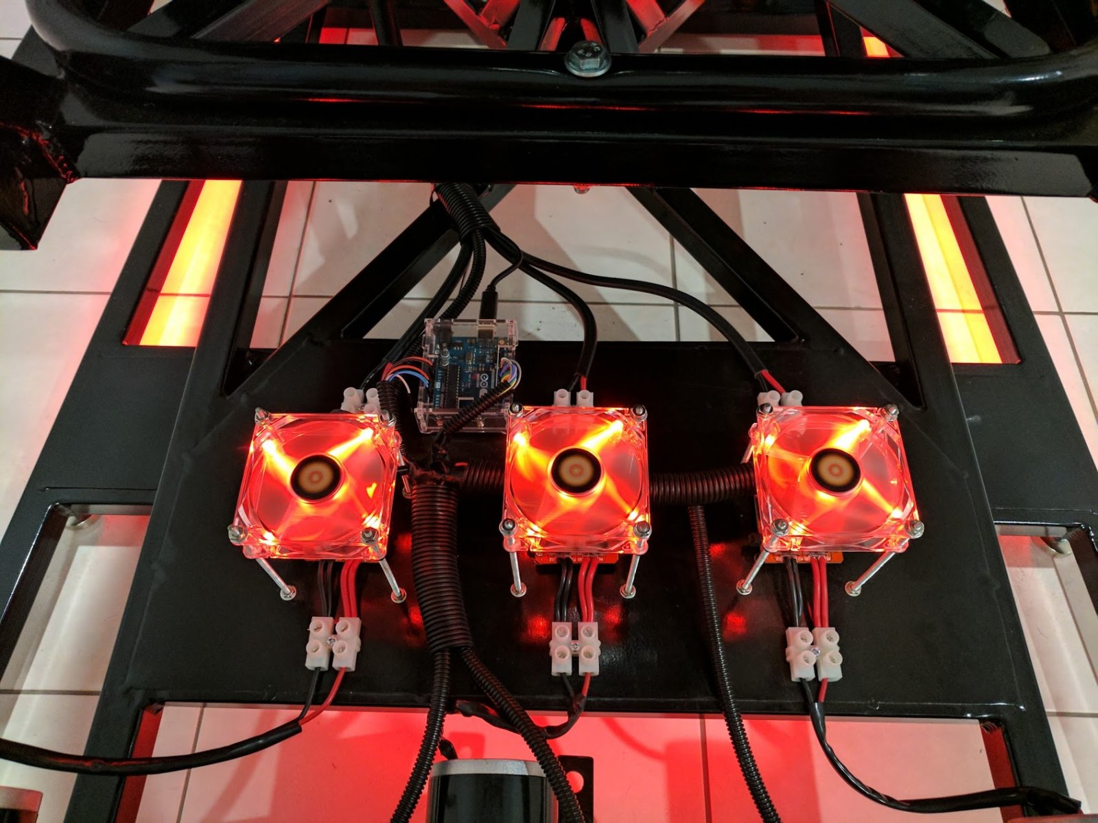

    Routine Moto Monster replacement. This is the 5th one of these I've replaced since completing this build; the 2nd time I've replaced the traction loss one.
    It's the middle one here
    Fan off, wires out

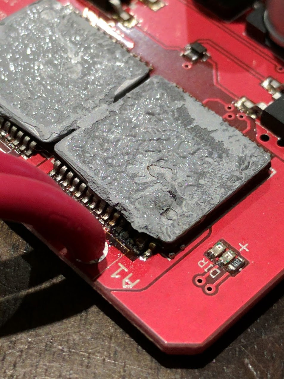

    With the heatsink removed we can see the burnt out chip. This is the first one I've had that actually burnt out, the other failures were less obvious
    Also a burnt out track on the back
    With the thermal paste removed you can see a burn mark now in my heatsink

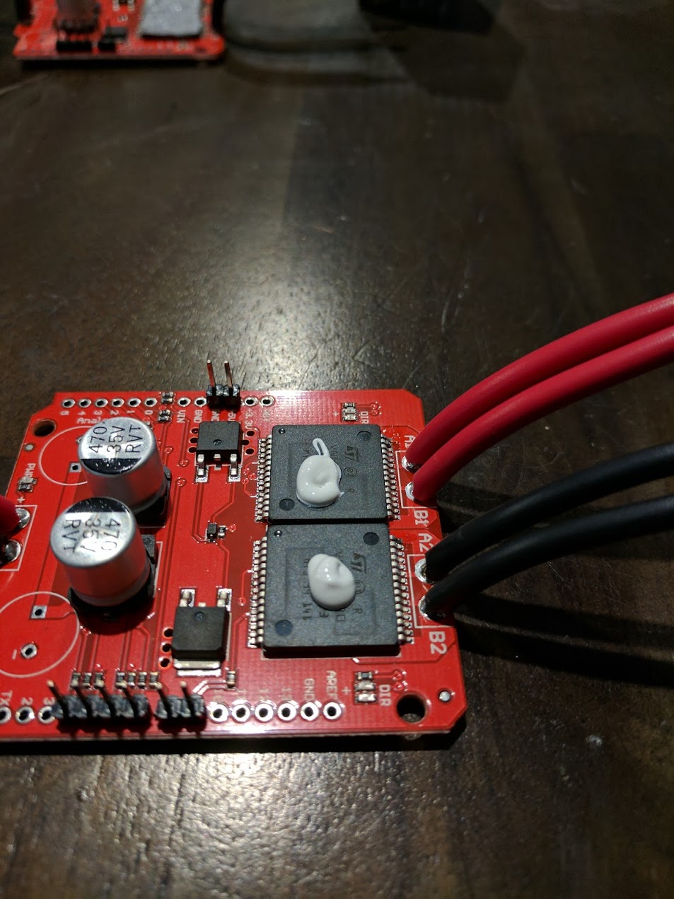

    New MM
    The fact that this one has had some hand soldering done gives me hope that there may have been some form of Quality Control involved .... not likely
    It's a "Sparkfun" board
    First I need to cut some new lengths of 2.5mm wire
    Solder these in to the board, then strip and tin the ends that will go into the screw terminals
    Bit of thermal paste
    Cable tie the heatsink back on. I also lightly soldered the fan on this time, as it was getting a bit difficult to use the tiny wires in the big screw terminals
    Back in and powered up. No smoke :D (yet)

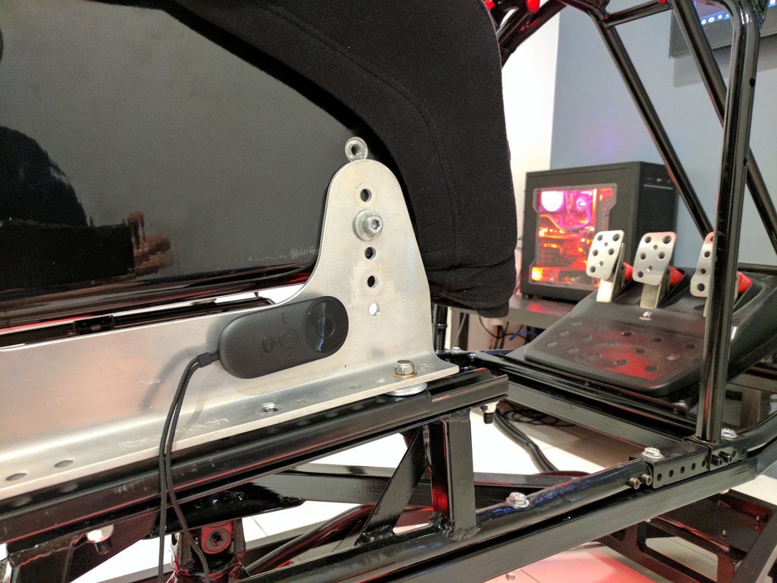

    Here's a little quality of life suggestion for Rift users. Use a velcro strip to mount the Oculus Remote to the side of seat, or anywhere within reach. It makes accessing the Oculus menus for resetting the view much easier.

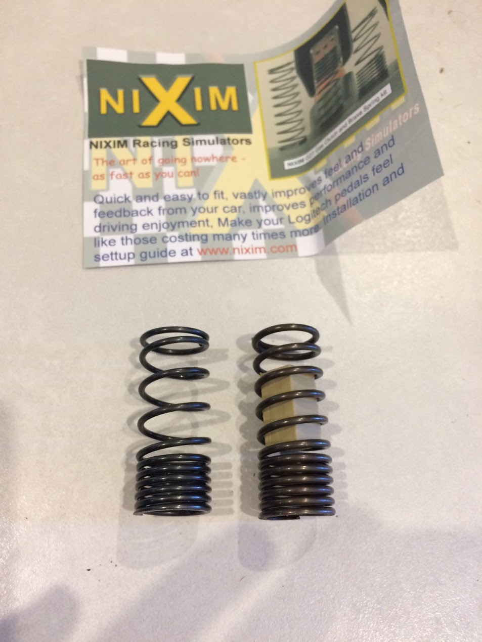

    I've also recently added some Nixim springs to my G27 pedals (http://www.nixim.com/). Really pleased with the feel from these, I no longer immediately hit 100% travel every time. Now that I've got some feel and control back, I can turn off ABS.

    Perhaps time to consider Sabertooth as a replacement!
  5. tougemonster
    tougemonster Member
    Apr 21, 2015
    37
    Systems Integrator
    422Coins
    +48 / 0 / -0
    I'm starting to think this way, yes.

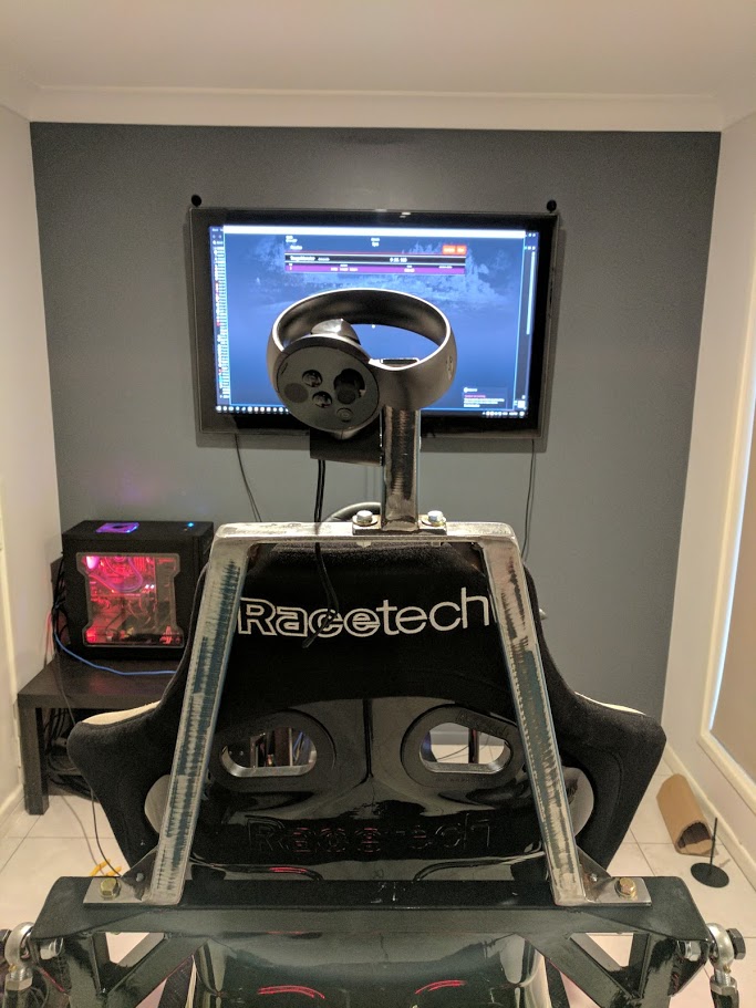

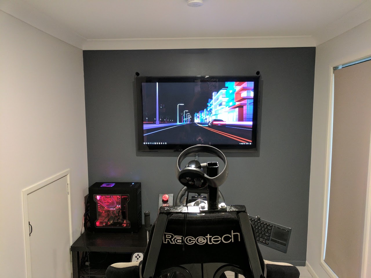

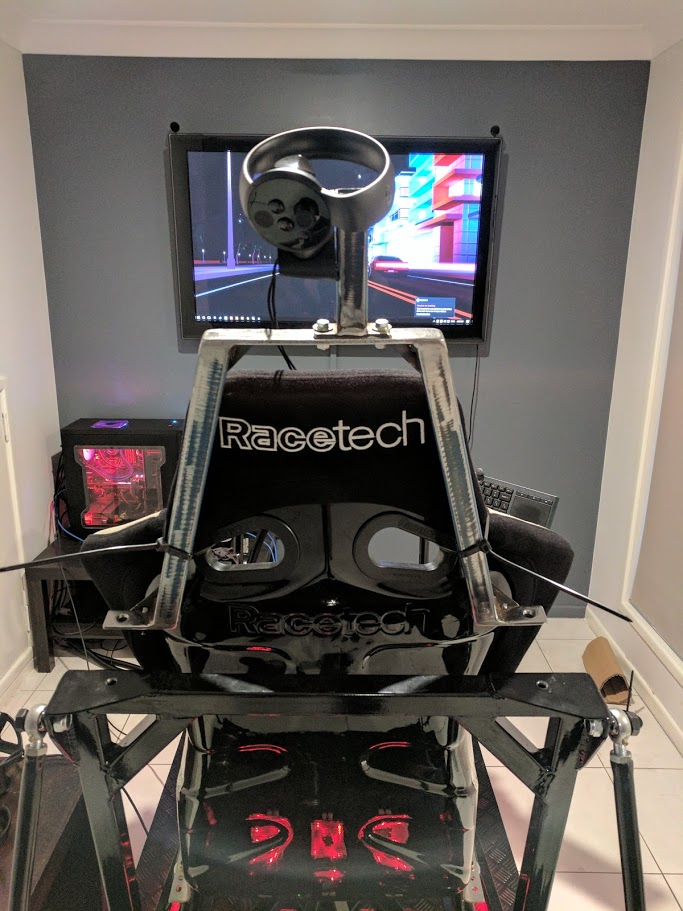

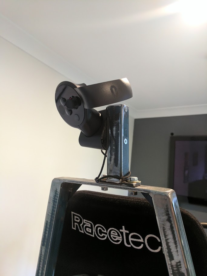

    With Oculus runtime 1.15 I began to suffer from tracking issues again, even after they'd disappeared for a few versions. Thankfully matzman666 came to rescue with his OpenVR Input Emulator with motion compensation.
    So I bought Oculus Touch controllers and went about mounting one to the sim up near my head.
    This is my old sensor location:
    I knocked up this frame and bolted it on:
    Using the Rockband controller mount:
    Unfortunately there was a massive amount of vibrations going through it with it mounted here. So I had to improvise and cable tie the frame to the back of the seat. This got rid of 90% of the vibration issues. This will be the solution until I build a new frame and bolt it directly to the seat.
    All painted, with now a pair of Oculus Sensors mounted on the display in front:
    My end game with all of this is to bin the Rift entirely, and use my Vive. I built the mount to accommodate either the Vive tracking puck or Oculus Touch. I think this will probably wait until Vive 2 though.
    Here's a before/after video showing results

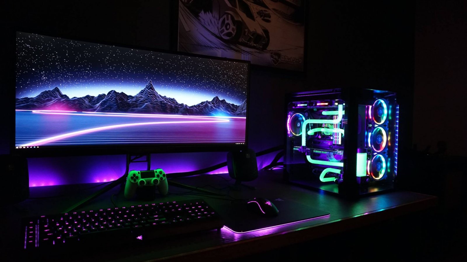

    Oh and since it has been a while since I updated this thread, a few months back I finished building my new PC. Which means my motion sim has finally received a permanent PC (3770K, 980Ti). My new PC is something I've dreamed of building for a long time, so happy with the result. A bit off-topic, but check it out anyway:
    "The Dream" specs -
    Intel Core i7 7700K (delid, liquid metal TIM)
    ASUS ROG Maximus IX Formula Motherboard
    G.Skill Trident Z RGB DDR4 4133Mhz - 32GB
    Nvidia Titan X Pascal
    Samsung 960 PRO NVMe M.2 1TB SSD
    Intel 600P Series 1TB M.2 SSD
    Seagate FireCuda 2TB Desktop SSHD
    Corsair AX860i Platinum Power Supply
    Windows 10 Pro
    Acer Predator X34 Curved 34in G-Sync IPS 3440x1440 @ 100Hz
    Lian-Li PC-O8WX Windowed Cube Chassis - Black
    EK-CoolStream XE 360 (Triple) Radiator
    EK-CoolStream SE 240 Slim Dual Radiator
    EK-HDC fittings
    EK-HD PETG 16mm tube
    EK-Ekoolant EVO Lime Green UV
    EK-XRES 140 DDC 3.2 PWM Elite (incl. pump)
    EK-Supremacy EVO Gold CPU water block
    EK-FC Titan X Pascal
    Koolance Coolant Inline Flow Meter w/ Temp Sensor
    Thermaltake Riing Plus 12 RGB Radiator Fan Premium x 6
    CableMod WideBeam Foam Adhesive LED Strip RGB 30cm x 3
    Nanoxia Rigid LED Strip 30cm UV x 2
    Razer Mamba Tournament Edition Chroma RGB
    Razer Firefly Chroma RGB Hard Gaming Mouse Mat
    Razer BlackWidow Chroma RGB Mechanical Gaming Keyboard
