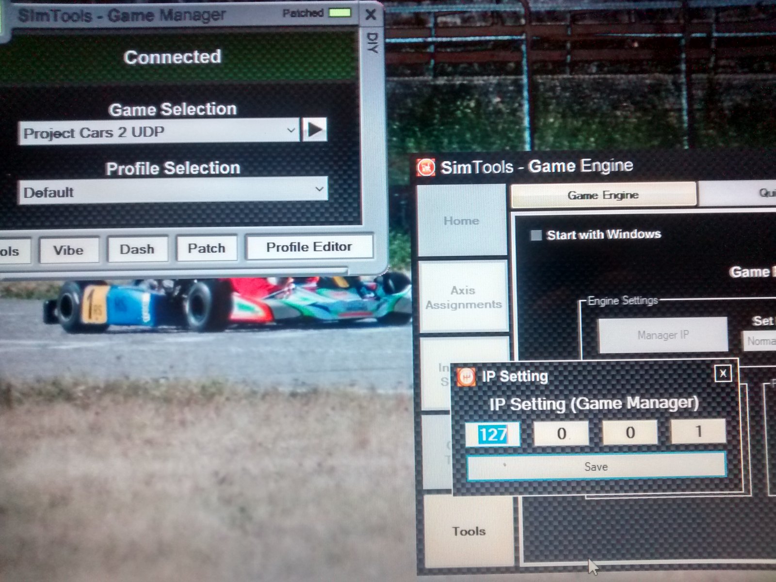

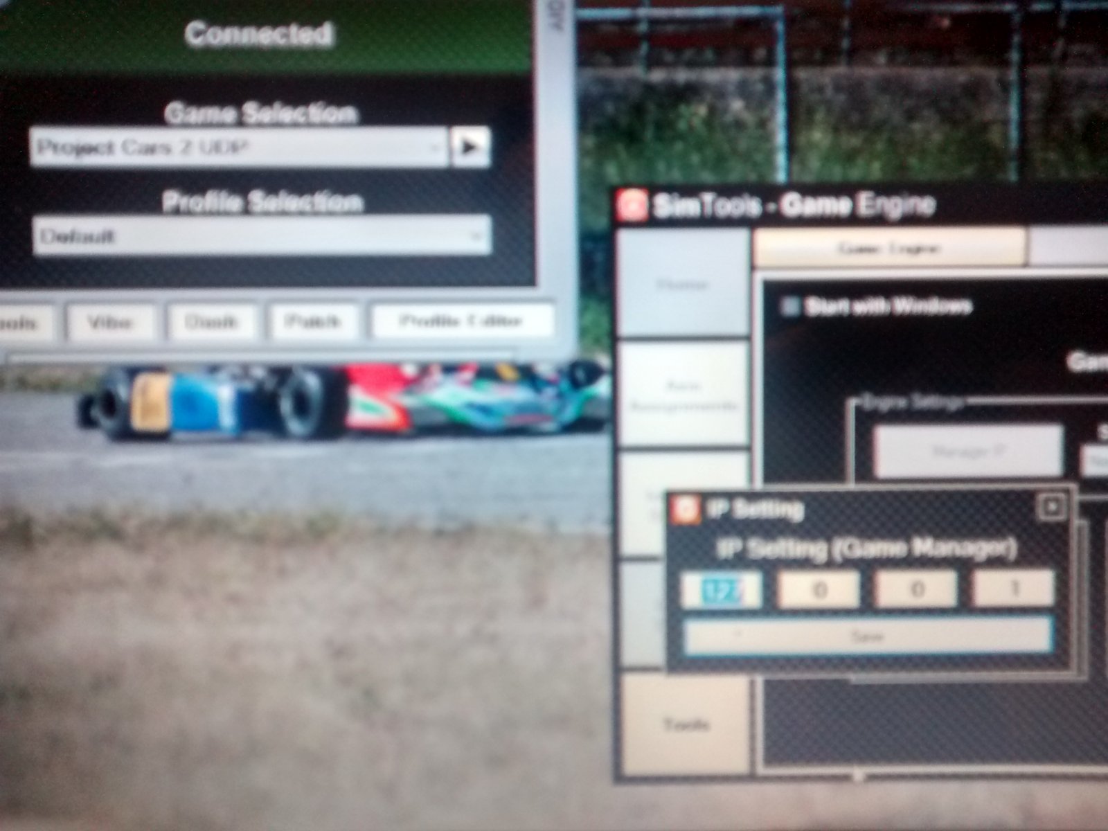

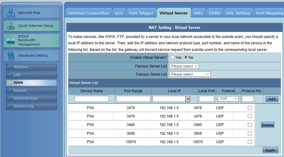

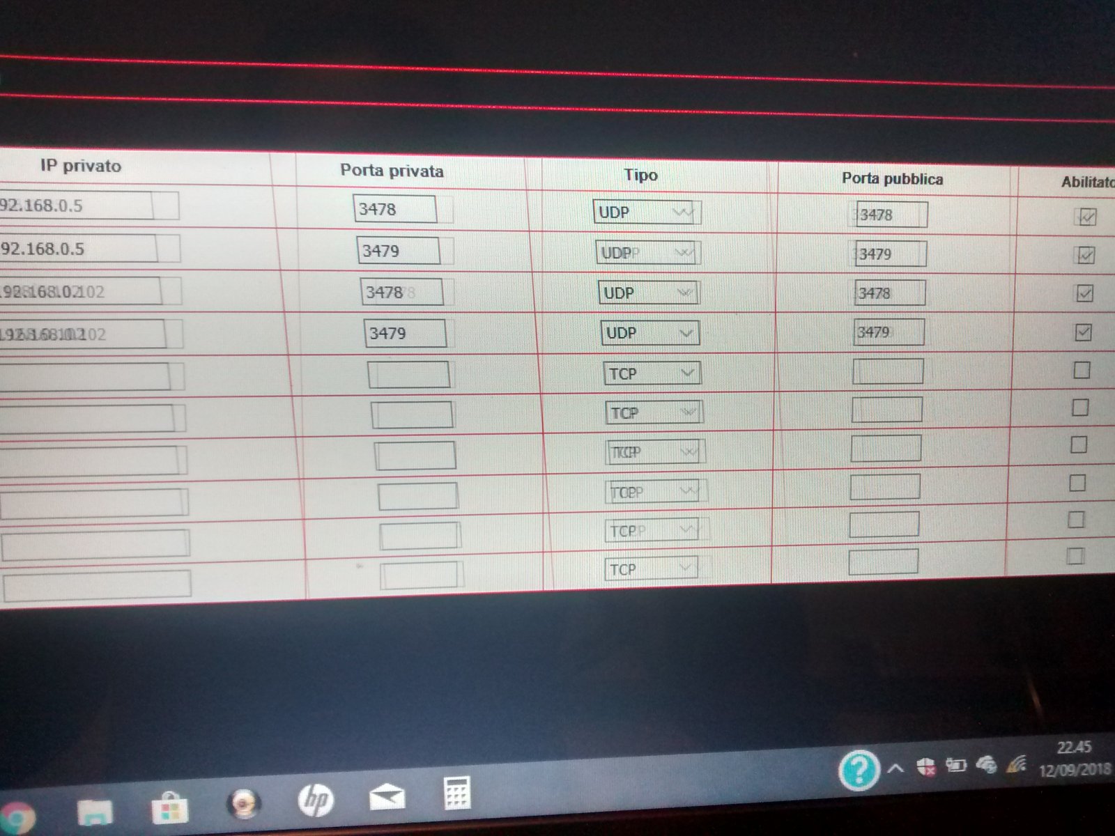

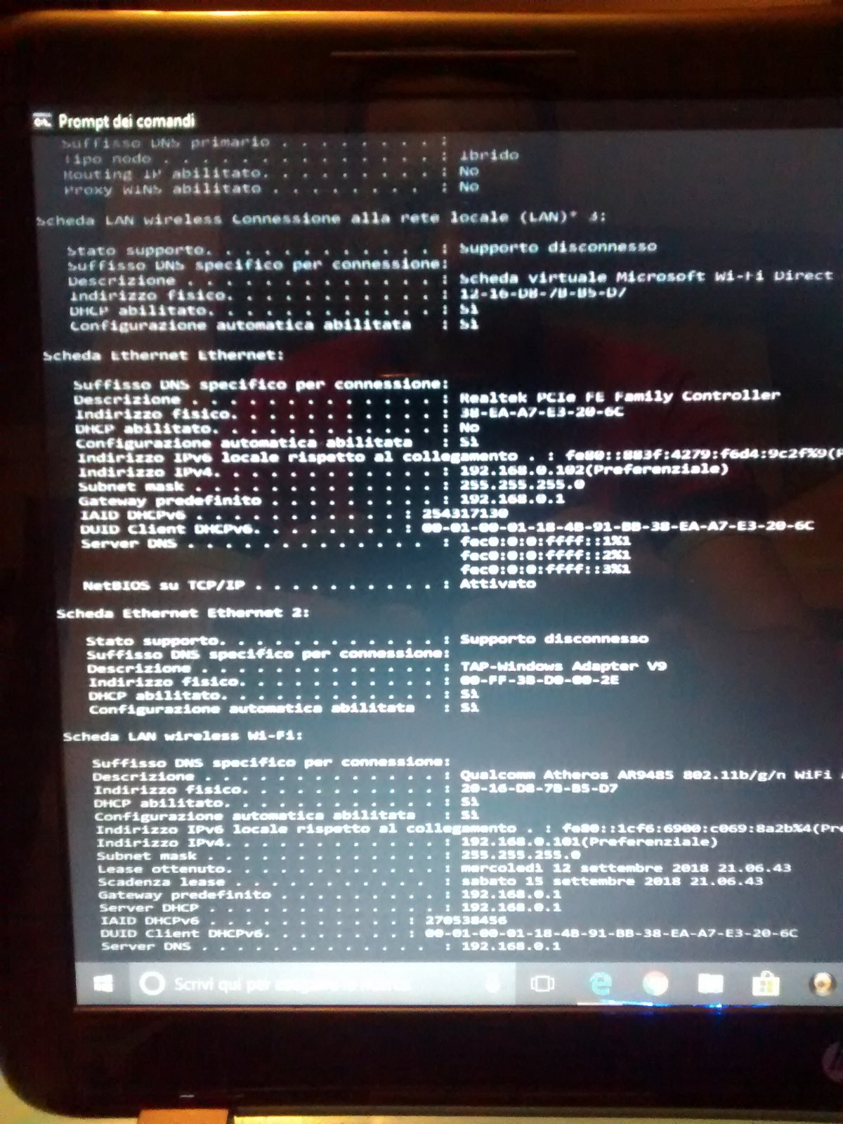

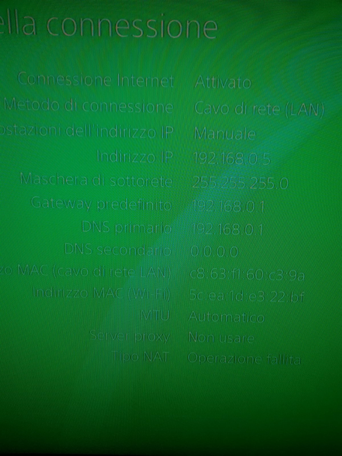

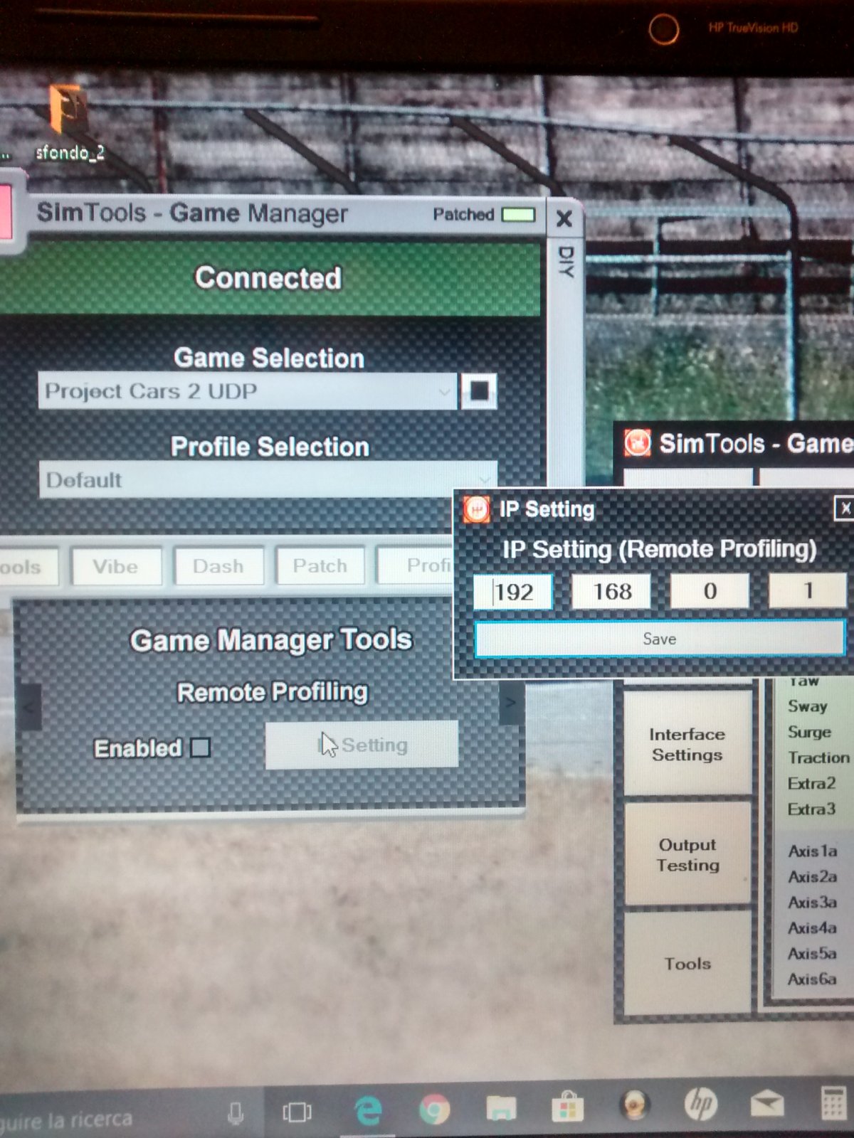

    I don't solve the problem about the connection PS4 with LAN to router and PC with LAN to router so I migth open UDP port n°3478-3479.
    In simtools there's game running when I start Projectcars2, but the sliders in outpu testing don't move.
    I attach some imagines about the ps4, pc, and router configuration, I hope in our help.
    192.168.0.102 IP scheda rete
    192.68.0.1 IP router
    192.168.0.5 IP PS4
    Bye
  12. hoyang
    hoyang handyman
    Dec 14, 2017
    94
    Bricoleur
    1,337Coins
    +93 / 0 / -0
    Ip setting (remote profiling)
    127.0.0.1

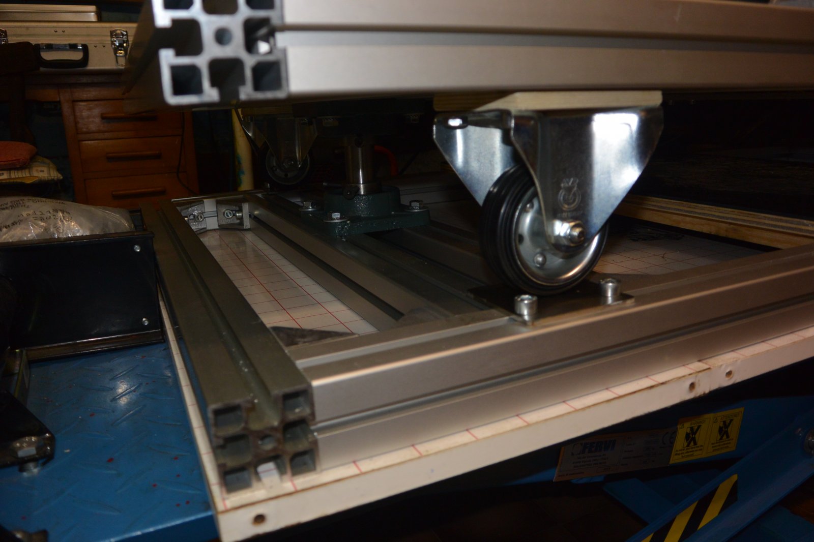

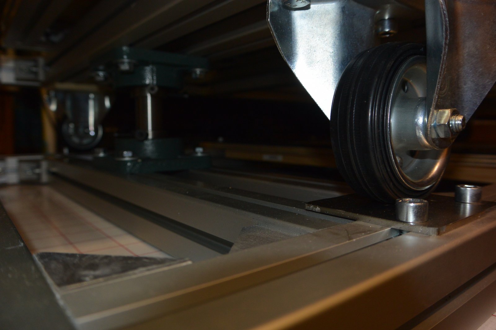

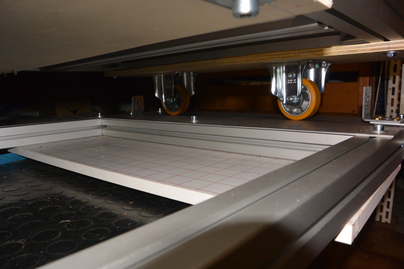

    Hello to all, Then the situation was dramatic for a moment when I had to replace the H bridge, but now everything seems ok. I would like to show you the solution of the support wheels for the future configuration for the traction loss and a video of how the station behaves, currently 2 dof that has gained in reactivity. However I realize that the setup is still far from excellent. In the meantime, I'm consuming all my energy to try to make PS4 communicate with PC via UDP using an external router.

    With moderate enthusiasm I would like to share with you the fact that this night I managed to move the self-built dynamic workstation by connecting via PS4 PRO router with PC using as software: 1) project cars 2 and Simtools.
    To do this it is necessary to enable the UDP protocol to open the respective ports of the console and, last but not least, to download the plugins needed by Simtools:
    https://www.xsimulator.net/simtools-game-engine/#Setting-up-a-Network-Interface
    Thanks to @vthinsel, hoyang, @santanadany and especially to spyderwash; to which I am sure I will still ask for help
    I don't forget noorbeast about his availability and passion.
    Of course the handling is still raw, but personally with the limited skills that I have, I think it is a great result that gives me new energy to continue in the project of the station, still under development.
    I apologize if some days have passed without news but to make it work I have downloaded the 07 version of the game and a series of files like Netframework.
    I show you the router setting to open UDP ports and as soon as possible I will document in more detail with pictures and videos what has been done.

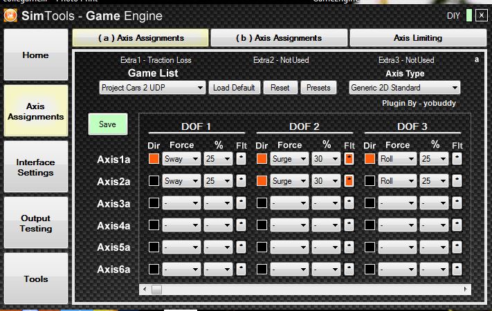

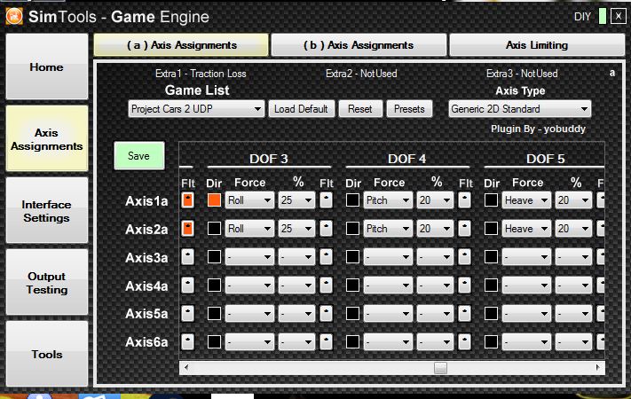

    A question:
    What do you think about this settings to project cars 2?
    See imagines
  16. noorbeast
    21,712
    151,979Coins
    +11,061 / 56 / -2
    I am guessing you have not finished the sim yet, so settings don't mean much until actually tested on and refined for your particular rig.
    That said this is the way SimTools expects a rig to be configured for movement and with your Roll and Sway they should be opposite, sway leans away from a corner and roll is set opposite that: https://www.xsimulator.net/community/faq/which-way-to-set-simtool-axis-movements.230/
    Your axis assignment percentage totals also look a bit high: https://www.xsimulator.net/community/faq/axis-assignment-percentage-totals.120/
    When you do get your rig moving try following these steps to create and refine motion profiles; https://www.xsimulator.net/community/faq/steps-to-create-a-motion-profile.228/

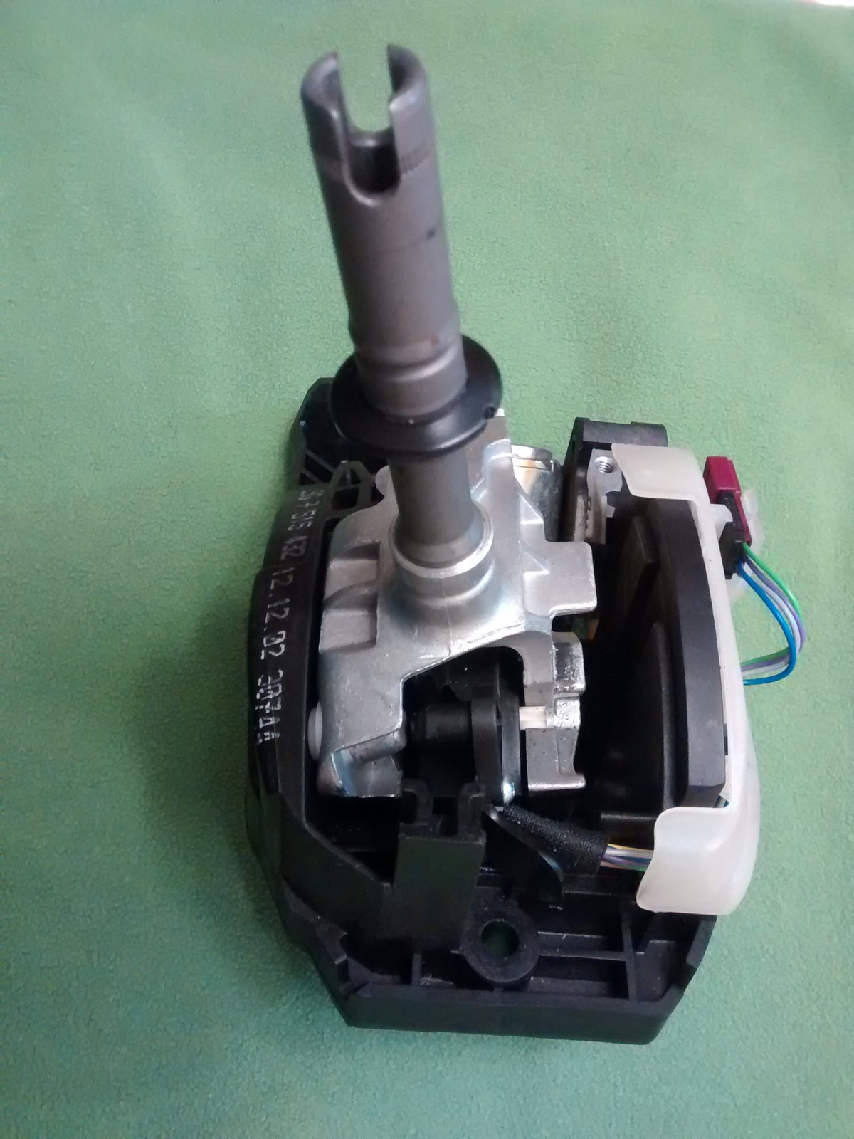

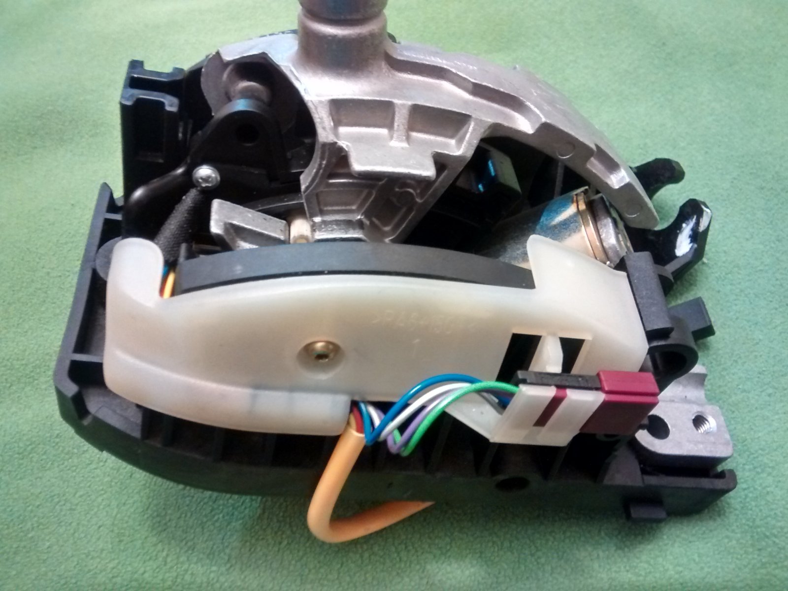

    I'm waiting to have news about the third engine from a shop, I got the sequential gearbox of the 2002 steptronic model.
    The attached photos show the group cleaned up by the components that do not need for the application I have to do.
    It seems in good condition and purchased at a cheap price, thank you for this Spyderwash about your suggests.
    Now the problem is that I'm always dealing with a PS4, so it is not obvious that by connecting an USB cable to the purple, blue and gray wires of the exchange this is felt as a device, as would happen if there was a PC.
    I found a guy who used a controller while using a steering wheel; Well, I tried it too but I didn't success.
    So I asked the Bandai Namco for clarification, because I think that Project cars 2 has responsibilities in my difficulties; in fact it seems to me that the one play with another game.

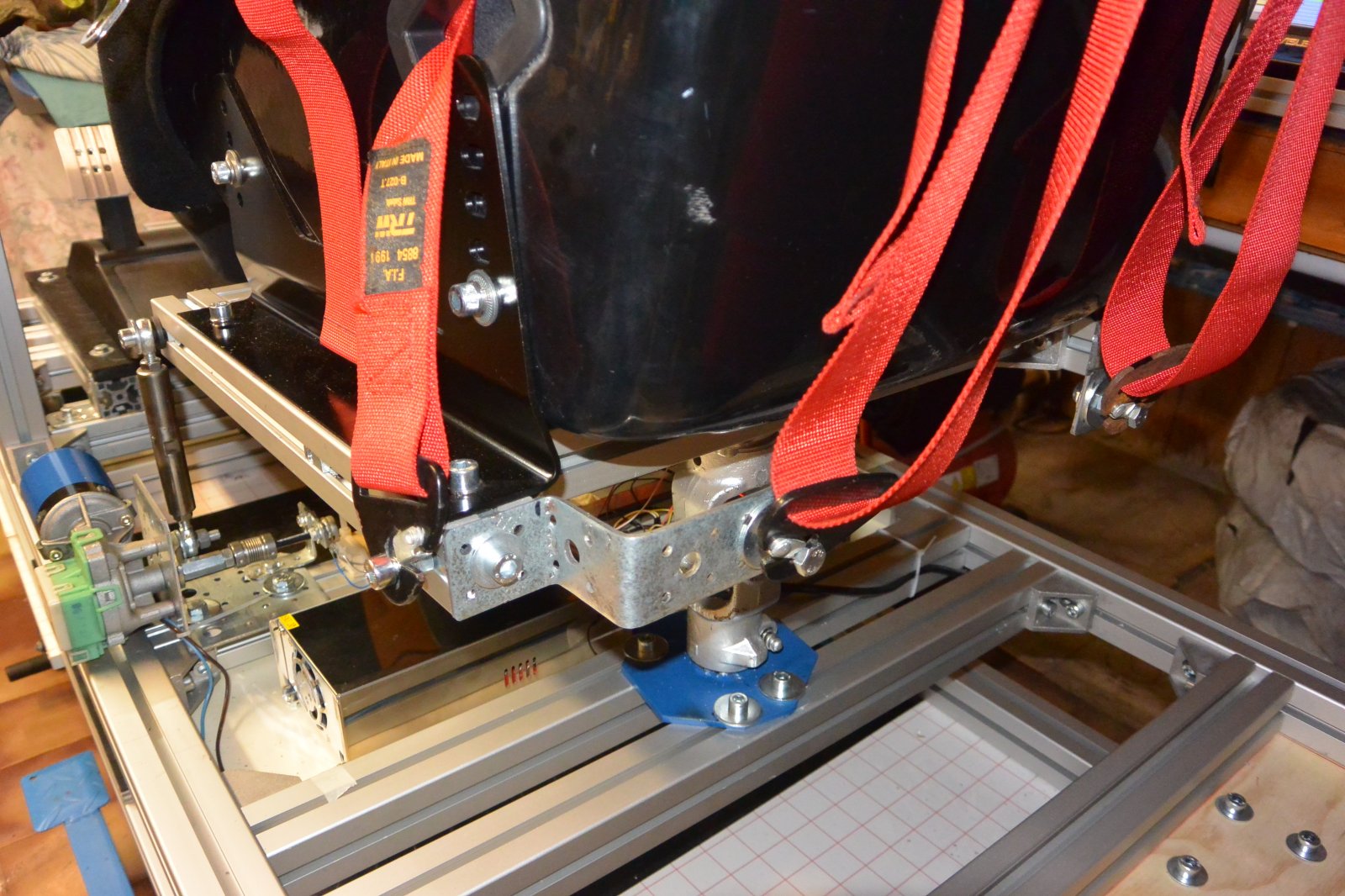

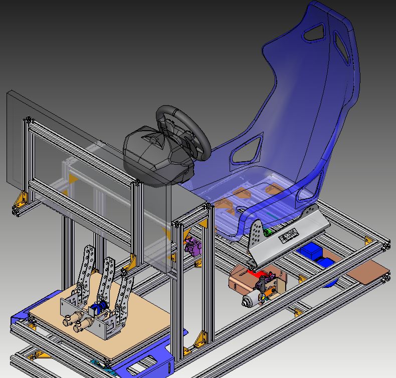

    I'm Waiting for the arrival of the traction loss motor, so I'm trying to find a solution for the support considering the choice of the kinematics chain solution. I show you some images of the solution v.00 of the support, it does not seem bad because the system provides the possibility to adjust the tension of the chain. The pinion that will be installed first will be with a primitive Ø of about 60mm. The geared motor data are:
    MT 190W motor with 12V DC 20A 3000rpm
    gearbox Varvel worm gear SRS40 I = 49/1 with a torque on slow shaft M=18Nm and n=60rpm

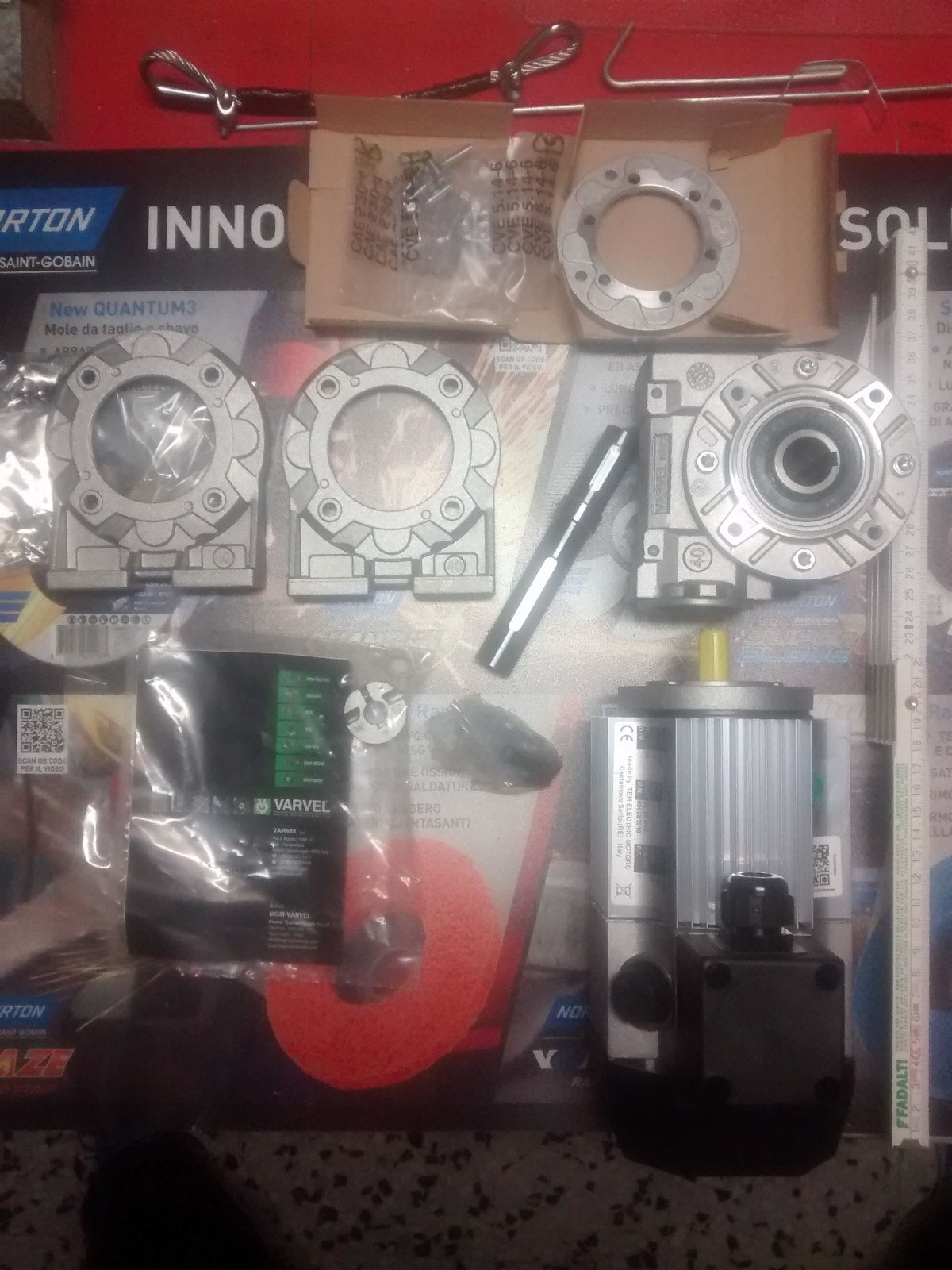

    Finally I received the gear motor for the Traction loss; the characteristics are as follows:
    MT 190W motor with 12V DC 20A 3000rpm power supply
    Varvel worm gear SRS40 I = 49/1 with a torque on a slow shaft M = 18Nm at n = 60rpm
    Now the support is under construction, while I'm still undecided whether to use a chain transmission more pinion or a system of levers.
    I am aware that the lever system is not simple from a constructive point of view, especially if you do not have a workshop at home.
    Show advantages, especially regarding ease of adjustment, in the case of the pinion you should have models with different numbers of teeth, while during operation the lever system should be less noisy. In the next days I will show the chosen solution.
    We accept considerations and suggestions.

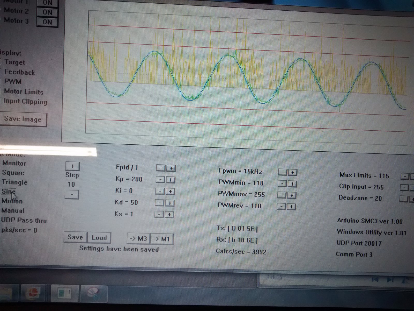

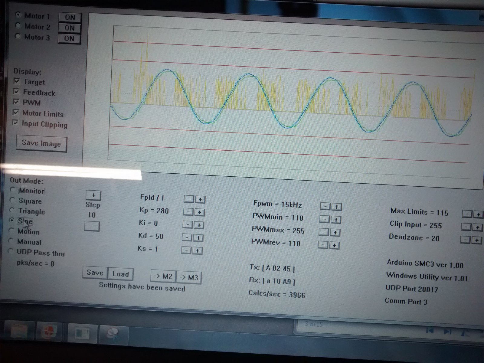

    I'm waiting to complete the assembly of the third engine for the traction loss I would like to bring to your attention the images obtained from SMC3 related to the two wiper motors for the 2 dof configuration.
    I would like to optimize the feedback curve, but I have doubts about the parameters to be modified, Kp or Fwmin.
    Thank you
