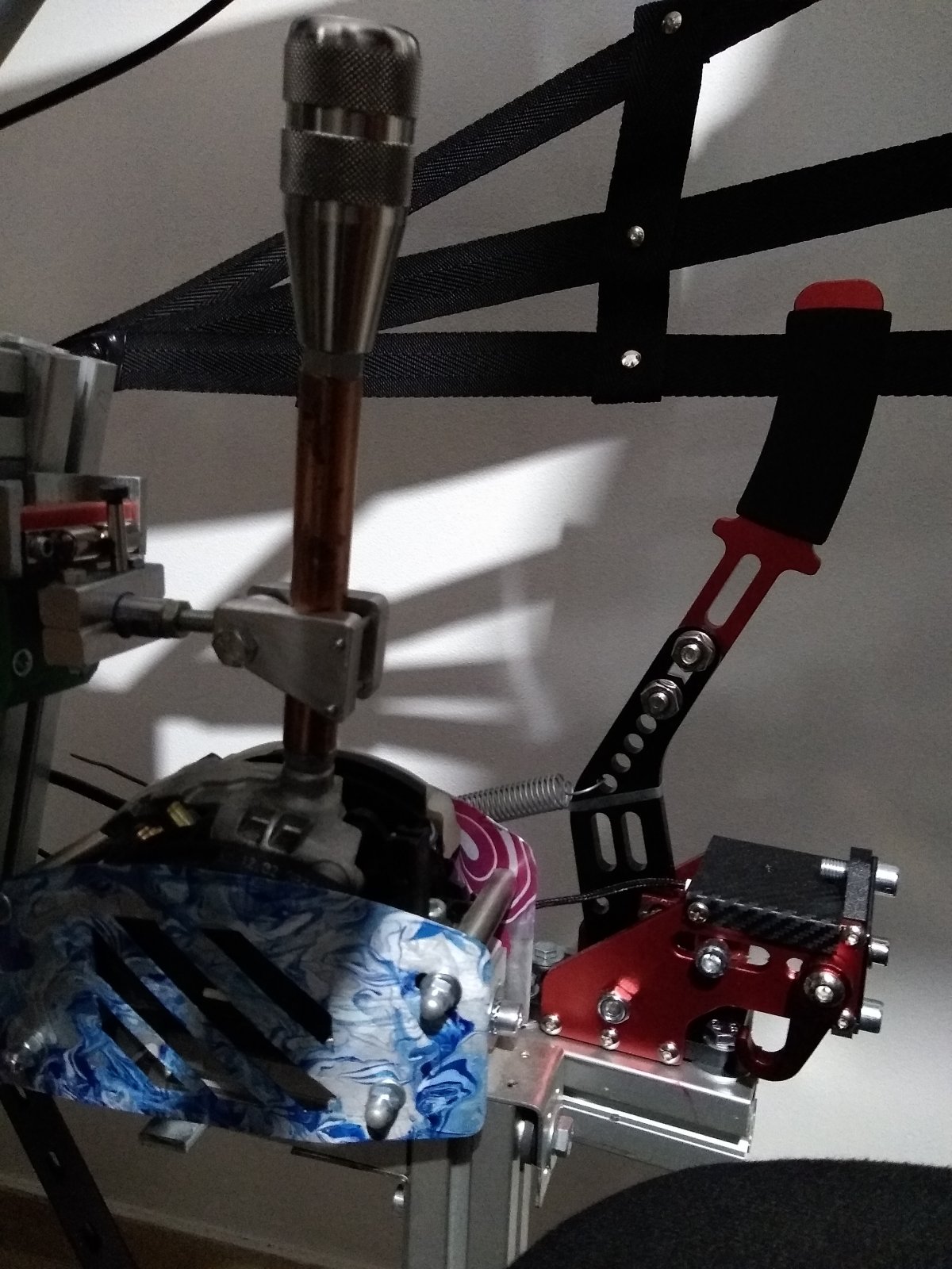

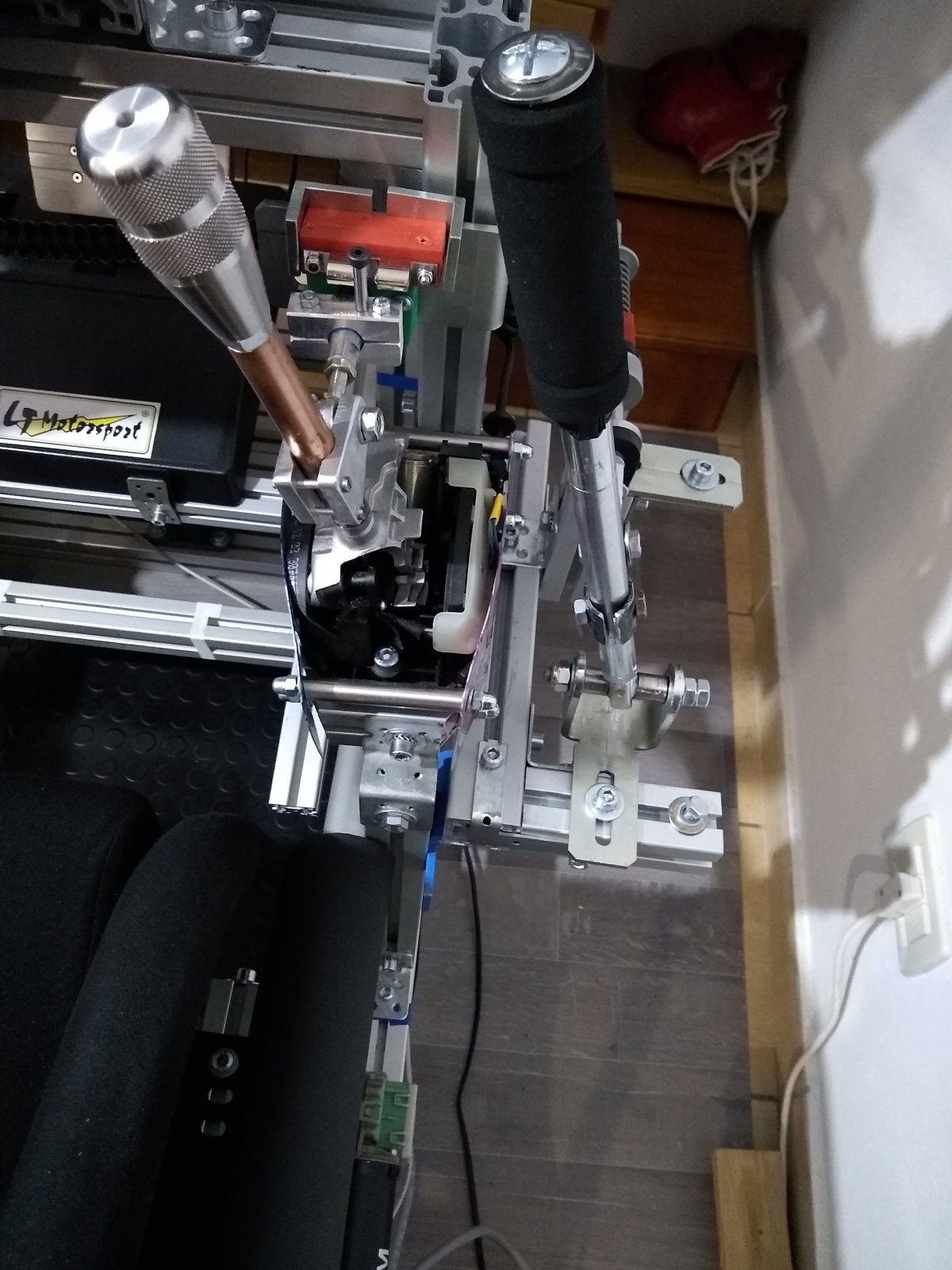

    Now I try to setup RFactor 2 and SimTools, but I'd like to show my new projects:
    - handbreak diy with micro arduino and linear potenz. 10kOhm.
    - sterring wheel like as Lamborghini Huracan GT3
    - finally my new assembled pc

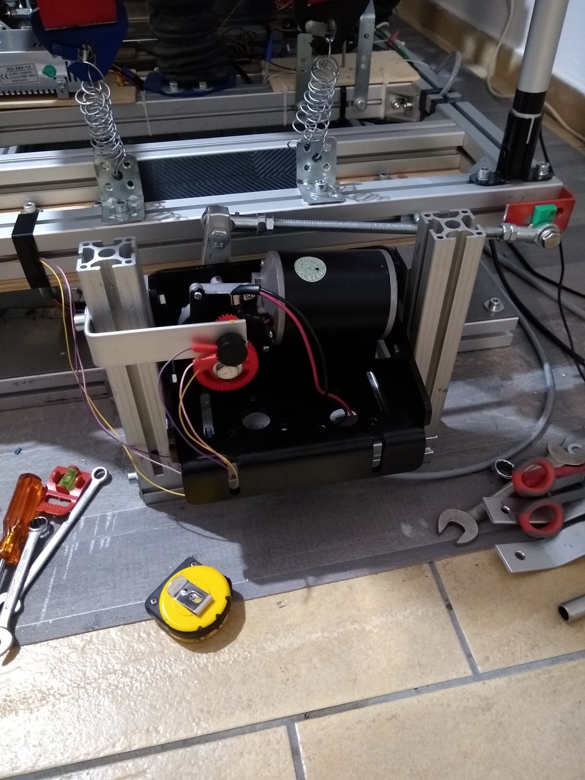

    currently for the traction loss I have used an engine equal to the other two, i.e. a wiper motor, but this for what it has to do is too small, for this I would like to evaluate a 12V gearmotor that can meet the characteristics required for the function it will have to perform.
    any suggestions.

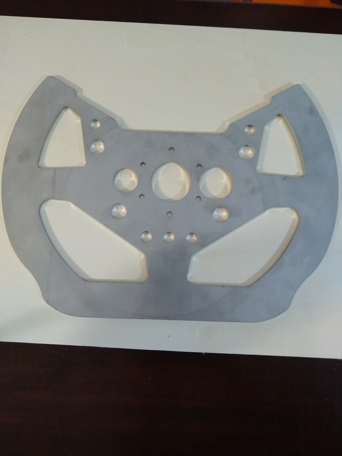

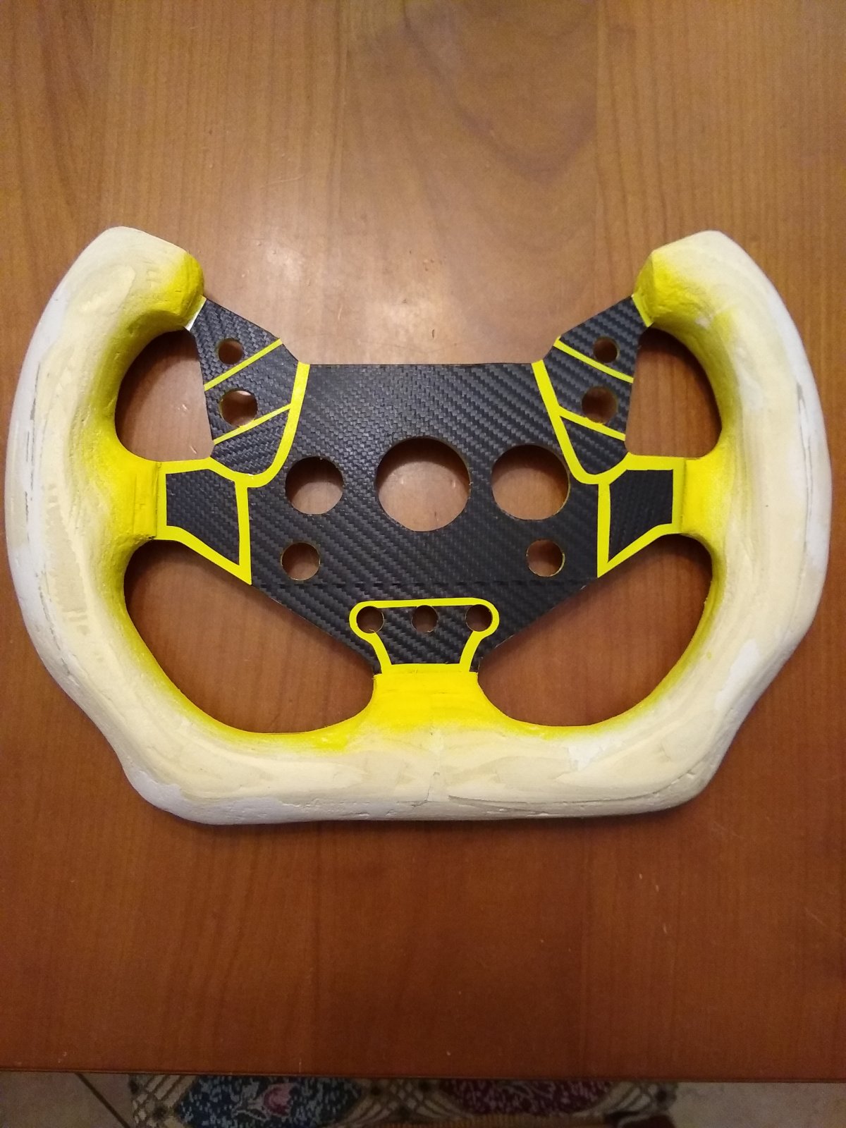

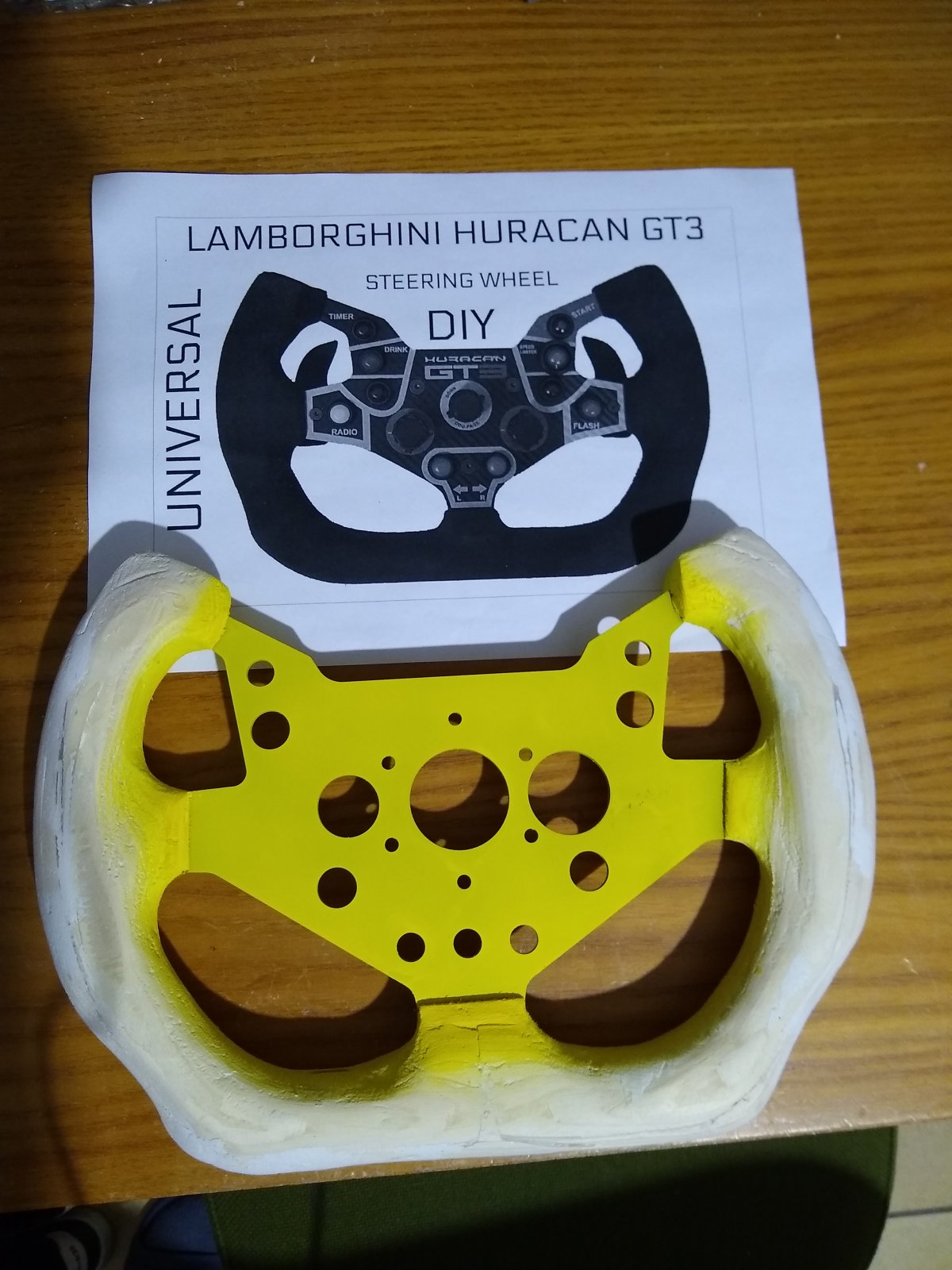

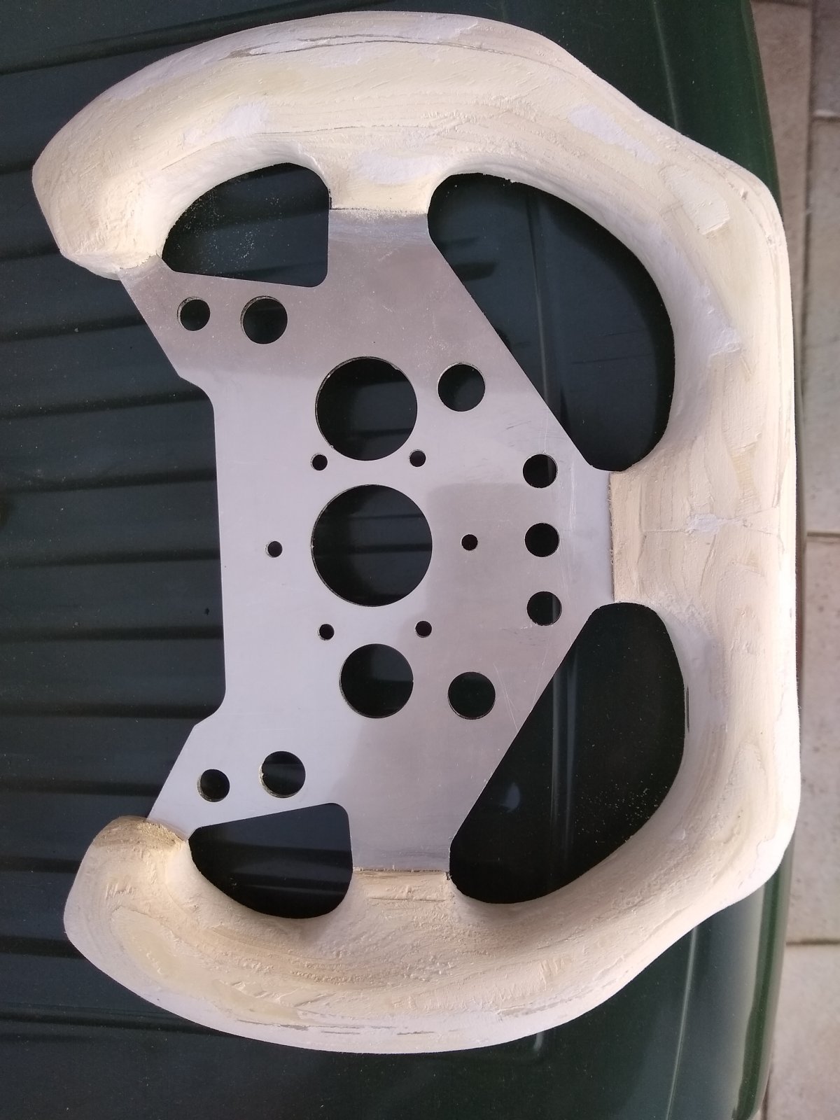

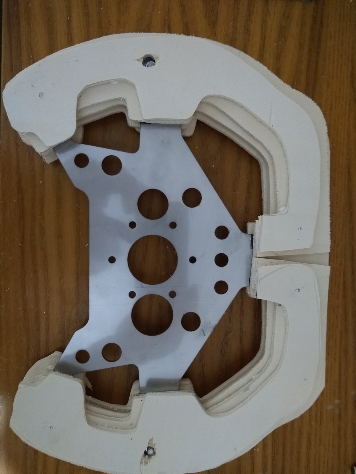

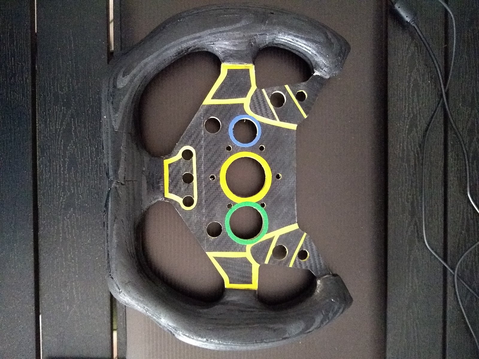

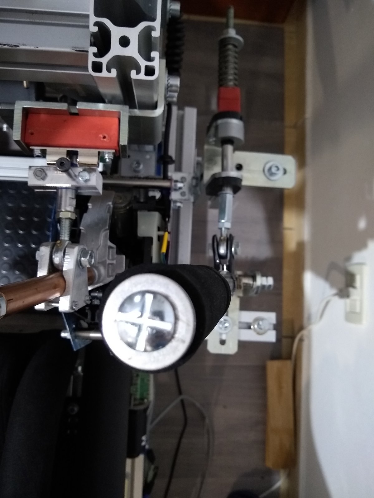

    I'd like to show my first diy sterring wheel for Thrustmaster T300 RS GT Edition. This want to look like to Lamborghini Huracan GT3 sterring wheel.
    See the follow photos, in the next day I try to clothe with some material, like alcantara.

    My frame has a fixed frame and a top frame for traction loss. On this second frame with an "L" support I mounted the wiper motors through the classic three fixing holes they are equipped with

    I'd like to show my last video about diy "XRED" playseat with Assetto Corsa Competizione.
    Now I've decided to substitute the traction loss motor, today a wiper motor, with a 120W 12V 40rpm motor and ratio i=40:1.
    Then I try to use a chain.
    Any suggestions?

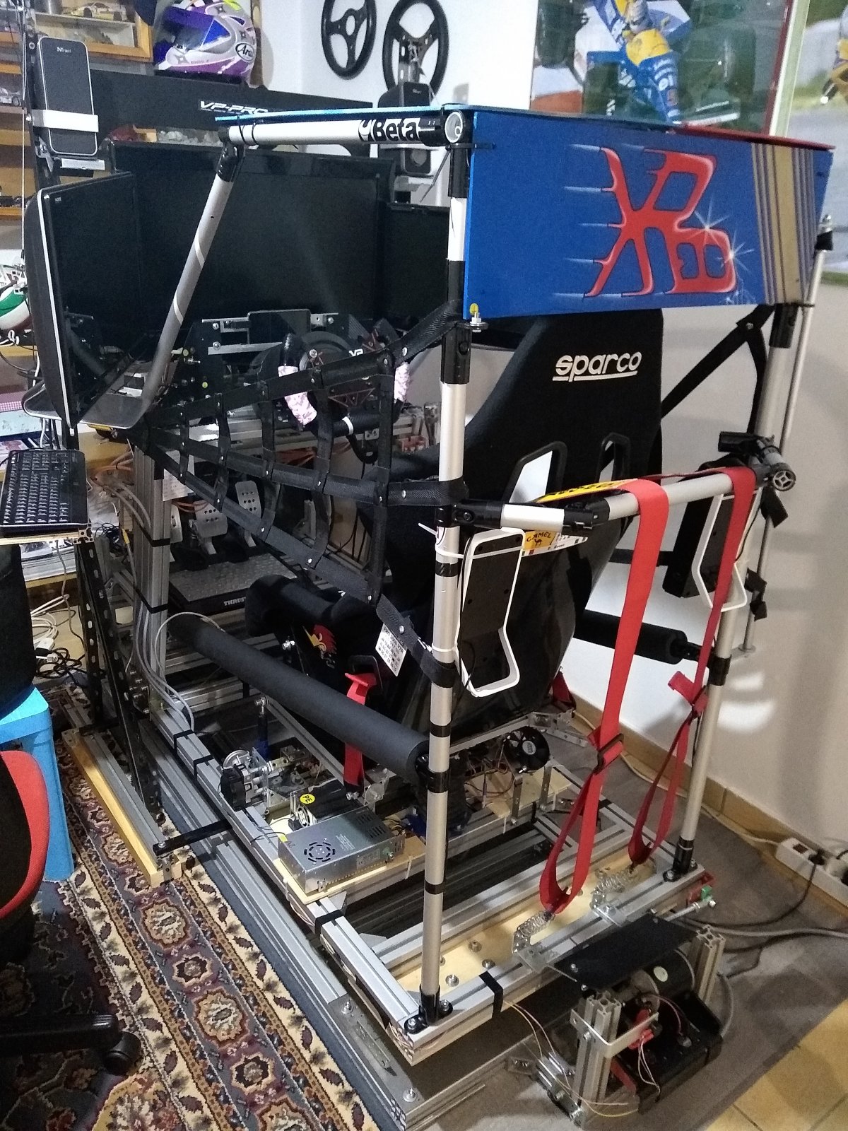

    Hello, I've updated my playseat:
    - Changed pedals and introduced an elastomer
    - Changed handbreak
    - Updated the setup about the sound and the cockpit
    Now I'm going to try to introduce the eccentric motors to pedals vibration; so I think to use the motors of my PS4 controller and an arduino.
    I'll show my project soon

    I'd like to upgrade my playseat about traction loss in this way:
    I want to introduce a second Arduino UNO, so the playseat will have:
    n°1 Arduino UNO and a motormonster to move two wiper motors about surge, sway, roll, pitch and heave
    n°1 Arduino UNO and a motormonster to move a traction loss simukit motor
    I'd like your help to define the setup in Simtools and the code to Arduino; I think I need change the Interface 1 and add the Interface 2.
    There're any examples about this application?
    Best Regards
  18. noorbeast
    22,185
    154,750Coins
    +11,196 / 57 / -2
    Code has to be loaded like you did for the original Arduino.
    In Interface Settings use Interface 2 and set up similarly as to how you will have Interface 1, but you will just have just [A<Axis1a>] in Interface 2 as you just have TL.
